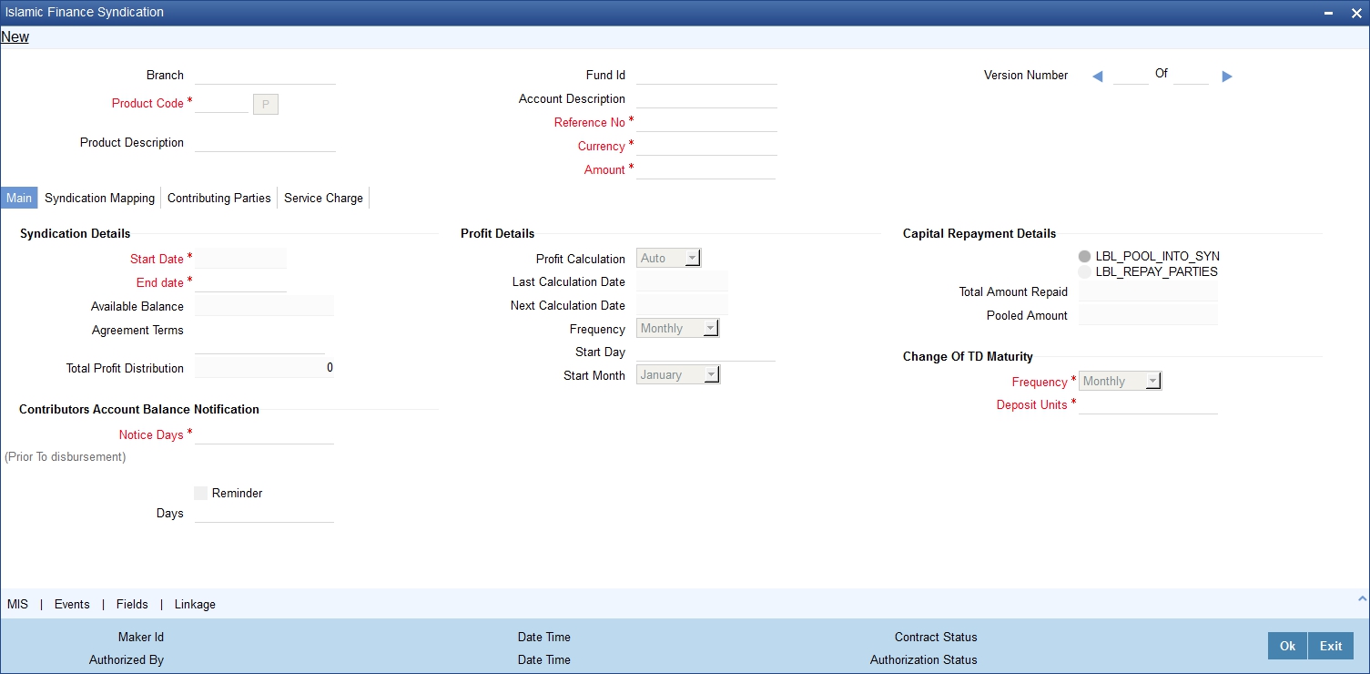

3.2.2 Main Tab
The additional information related to Islamic syndication fund is maintained in ‘Main’ tab. Click on the ‘Main’ tab to maintain additional information.
Syndication Details
You can maintain the following syndication details here:
Start Date
The system defaults current date as the start date for Islamic fund syndication and you cannot modify the same.
End Date
Specify the date till when you need to create Islamic fund syndication from the adjoining calendar.
Available Balance
The system computes the balance available for the specified syndication fund.
Agreement Terms
Specify terms agreed between the contributors and the Bank for fund syndication.
Total Profit Distribution
The system computes the total profit distributed among the contributors till the current date.
Profit Details
You can maintain the following profit details here:
Profit Calculation
Select a valid method to calculate profit for the specified syndication fund from the adjoining drop-down list. This list displays the following values:
Last Calculation Date
The system displays the date when the profit was last calculated.
Next Calculation Date
The system displays the date when the next profit calculation is due.
Frequency
Select a valid frequency period at which you need to calculate profit from the adjoining drop-down list. This list displays the following values:
Start Day
Specify a valid day from when you need to start calculating the profit.
Start Month
Select a valid month from when you need to start calculating the profit from the adjoining drop-down list, if the profit calculation mode is ‘Auto’. This list displays the names of months.
Capital Repayment Details
Select a valid method to repay the capital amount from the options available. The system displays the following values for selection:
Total Amount Repaid
The system computes the sum of amounts paid to syndication fund from various financing transaction, if ‘Capital Repayment Mode’ is maintained as ‘Repay to the Parties’.
Pooled Amount
The system computes the sum of amounts paid to syndication fund from various financing transaction, if ‘Capital Repayment Mode’ is maintained as ‘Pool into Syndication’.
Change of TD Maturity Details
You can maintain the following details related to TD Maturity changes:
Frequency
Select frequency at which you need to extend the maturity date of the deposit account from the adjoining drop-down list. This list displays the following values:
Units
Specify the number of units by which you need to move the TD maturity extension for selected frequency.
Contributors Account Balance Notification
You can maintain the following notification details related to contributors account balance:
Notice Days
Specify number of working days prior to which you need to issue the notice to the contributing parties for the amount to be disbursed.
Note
Value of notice days is the difference between the disbursement schedule due date and the current date of the system.
Reminder
Check this box if you need to send a reminder for the previously issued notice.
Days
Specify number of working days after which you need to send the reminder for the previously issued notice, if you have checked the ‘Reminder’ check box.

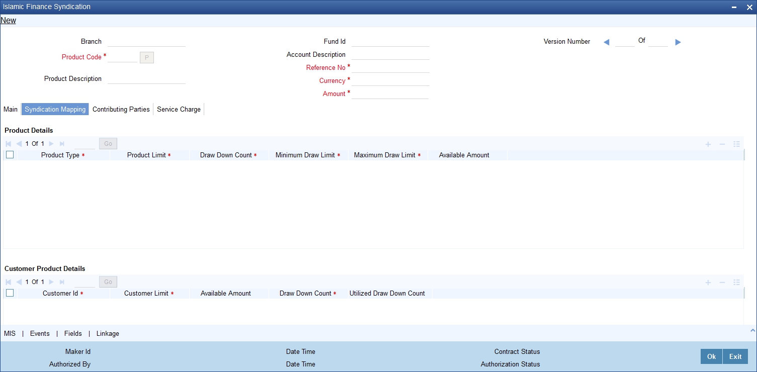

3.2.3 Syndication Mapping Tab
The system enables association or mapping of syndication fund to eligible product type with limit amount. These product types can in turn be mapped to the borrowers with limit amount.
You can map syndication fund, product types, and borrowers under ‘Syndication Mapping’ tab. Click ‘Syndication Mapping’ tab on ‘Islamic Syndication Fund’ screen.
You can maintain the following parameters here:
Product Details
The following product details can be maintained here:
Product Type
Specify a valid product type you need to maintain for the specified product. The adjoining option list displays all valid product types maintained for Islamic products. You can select the appropriate one.
Product Limit
Specify a valid limit you need to allow for the specified product type.
Draw Down Count
Specify number of times you need to disburse the fund for the specified product type.
Minimum Draw Limit
Specify minimum amount you want to disburse for the specified product type.
Maximum Draw Limit
Available Amount
The system computes the balance amount available for the specified product type.
Customer Product Details
You can maintain the following customer product details:
Customer ID
Specify a valid ID of the customer you need to maintain for the specified product. The adjoining option list displays all valid customer IDs maintained for Islamic products. You can select the appropriate one.
Customer Limit
Specify maximum amount you need to allow for the specified customer and product type combination.
Available Amount
The system computes the balance amount available for the specified customer and product type combination.
Draw Down Count
Specify number of times you need to disburse the fund for the specified customer and product type combination.
Utilized Draw Down Count
The system computed the number of times customer has utilised the allotted amount through CI contracts.

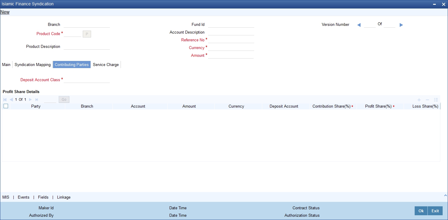

3.2.4 Contributing Parties Tab
Fund pooled by the contributors is equal to the syndication amount. That is, the sum of the contributors’ share is equivalent to the syndication amount. You can track the amount contributed by the individual party through a deposit account, created during EOD as part of capital subscription batch. You can maintain the details related to contributing parties under ‘Contributing Parties’ Tab. Click ‘Contributing Parties’ tab on ‘Islamic Syndication Fund’ screen.
Deposit Account Class
Specify valid account class you need to maintain for the generated deposit class. The adjoining option list displays account classes maintained for Islamic accounts, provided they are not associated with any fund ID. You can select the appropriate one.
Note
Profit Share Details
You can maintain the following profit share details here:
Party
Specify valid customer ID of the customer you need to maintain the contributing details. The adjoining option list displays all valid customer IDs maintained for Islamic accounts. You can select the appropriate one.
Branch
Current branch of the account is defaulted here.
CASA
Specify valid customer account you need to maintain for the specified party. The adjoining option list displays all valid Islamic accounts maintained for the selected contributing party. You can select the appropriate one.
Amount
The system calculates and displays the amount subscribed by the contributor, during capital subscription.
Currency
Syndication currency is defaulted here.
Deposit Account
The system displays deposit account number, created as part of capital subscription batch, for all parties involved in syndication.
Note
The deposit account is not created for the Bank
Contribution Share (%)
Specify percentage of amount invested by the specified party.
Profit Share
Specify percentage of profit gained by the specified party.
Loss Share
The system defaults the contribution share percentage as the loss share percentage while saving the fund.

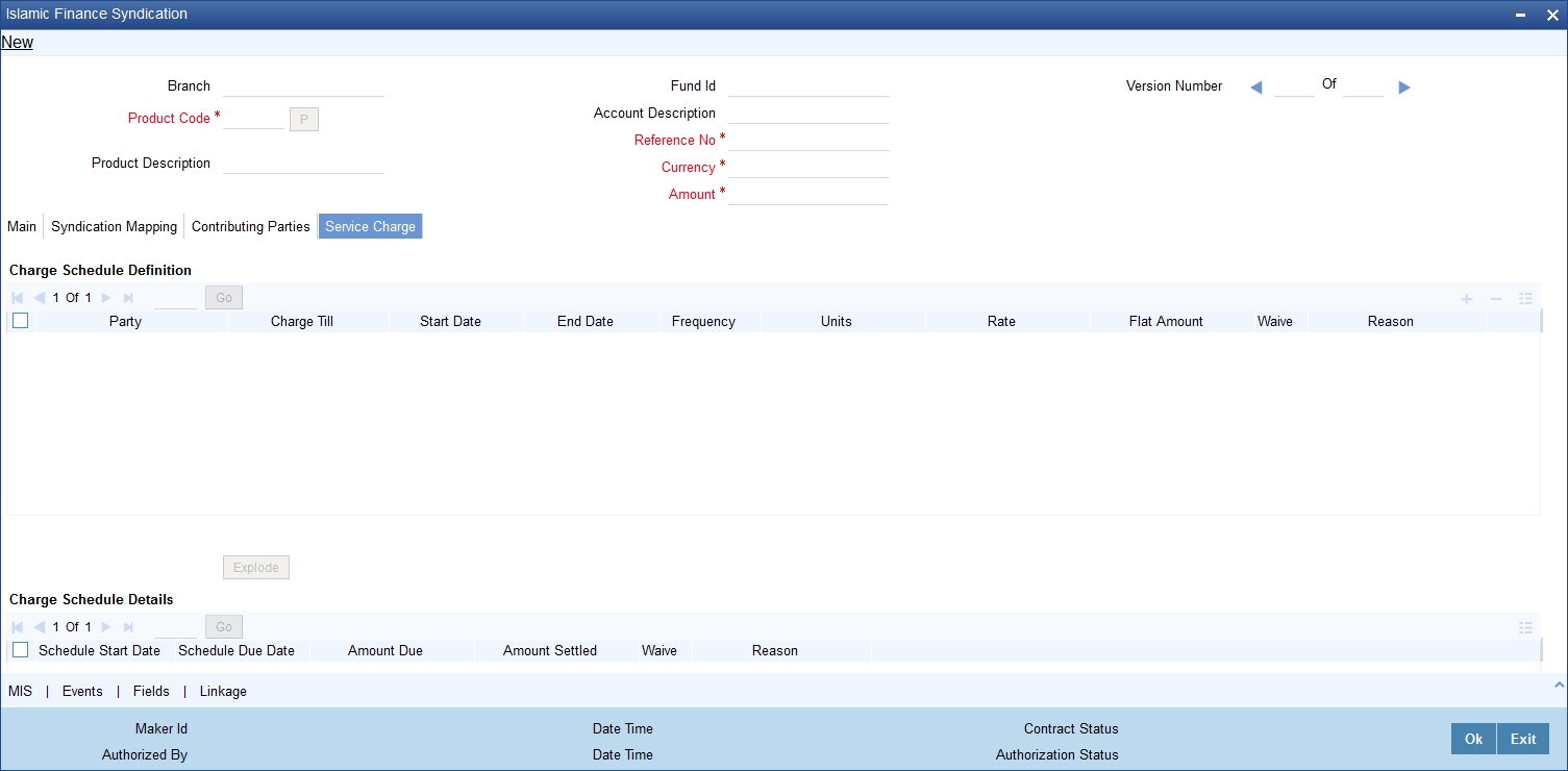

3.2.5 Service Charge Tab
Based on the predefined schedule, all the contributing parties pay service charge to the bank for their share of contribution. Charge schedule is maintained for individual contributing parties involved in the syndication fund. You can define charge schedule and compute the charge schedule based on the definition under ‘Services Charge’ tab. Click ‘Services Charge’ tab to maintain service charge details.
Charge Schedule Definition
You can define the following charge schedule details:
Party
Specify the contributor for whom the charge details have to be defined. The adjoining option list displays all valid customer IDs maintained for Islamic accounts. You can select the appropriate one.
Charge Till
Select period until which you need to charge the parties involved in syndication fund, from the adjoining drop-down list. This list displays the following values:
Start Date
Specify a valid date from when you need to collect charge from the adjoining calendar, if you have selected to charge till defined period.
End Date
The system defaults the end date for collection of charges based on the selected frequency and unit, if the charge till is defined period. Else, fund end date will be defaulted while saving the fund.
Frequency
Select frequency to define the charge calculation basis for the contributor, from the adjoining drop-down list. This list displays the following values:
Units
Specify the number of frequency units till which you need to calculate the charge, if the charge till is defined period. Else, the system derives the units based on the maintained frequency, start date and end date
Rate
Specify a valid percentage of the available deposit amount to be deducted as charge from the specified party.
Flat Amount
Specify a valid amount to be deducted as charge from the specified party.
Waive
Check this box if you need to waive charges to be collected from the specified party.
Reason
Specify a valid reason for waiving the charges, if you have selected to waive of charges.
Charge Schedule Details
Schedule Start Date
When you either save the fund or click the ‘Explode’ button, the system defaults the schedule start date as follows:
Schedule Due Date
When you either save the fund or click the ‘Explode’ button, the system derives the schedule due based on the values defined for units and frequency.
Amount Due
If the charge is defined as flat amount for the party, then the system defaults the same defaulted as the amount due. Else, the system will not display any value initially; however, during the charge schedule batch, the system calculates and displays the amount based on the percentage of the amount (rate % maintained in the charge definition grid) in the term deposit created for the party in the subsequent EODs.
Amount Settled
The system displays the amount debited from the contributor.
Waive
Check this box if you need to waive charges to be collected from the specified party for the specified schedule.
Reason
Click ‘Explode’ button to derive charge schedule details for the party specified in the ‘Charge Schedule Definition’ section. These details are computed based on the parameters maintained in the ‘Charge Schedule Definition’ section for the specified party. If the charge is not defined for any of the contributor along with the contributor’s ID, then the system displays the override message as, “Charge schedule is not defined for the party(s).”
If the charge basis is maintained as rate, then the system will not compute the ‘Amount Due’ when you click the ‘Explode’ button.

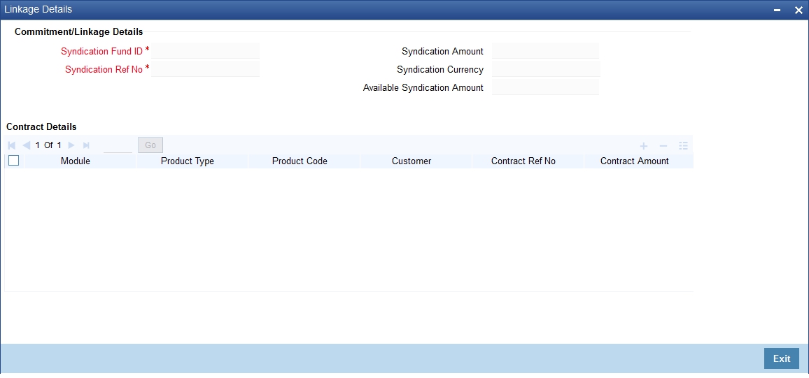

3.2.6 Viewing Linkage Details
Syndication fund is associated to various financing transactions. The system enable you to view the linkage details associated with the syndication fund in the linkage details screen. Click ‘Linkage’ button on the ‘Islamic Finance Syndication’ screen to invoke ‘Linkage Details’ sub screen.
You can view the following linkage details here:
