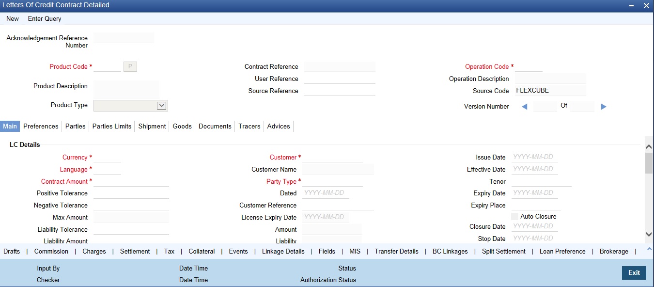

The buttons on the contract screen enable you to invoke a number of functions vital to the processing of an LC Contract.
These buttons have been briefly described below.

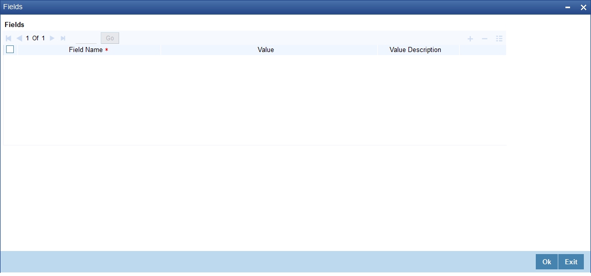

Fields
Click this button to specify values for the user defined fields (UDFs).

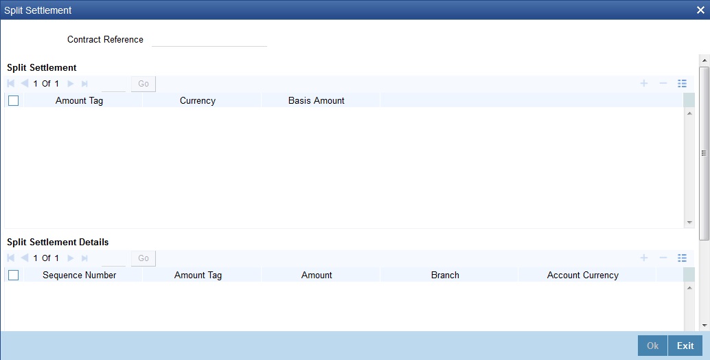

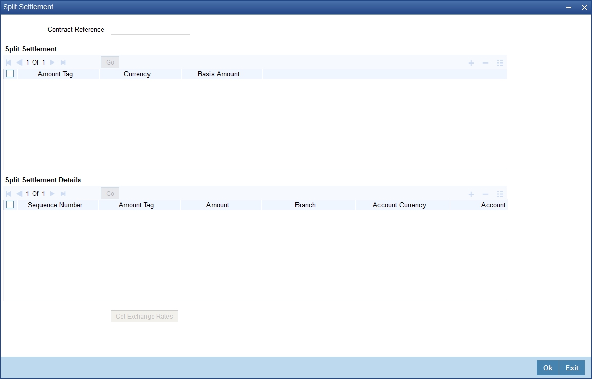

Split Settle­ment
Click this button to specify split settlement details

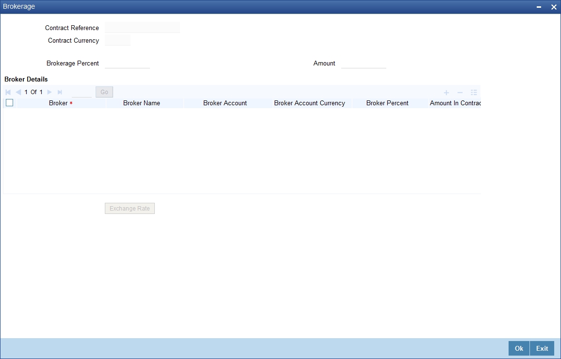

Brokerage
Use this button to capture the brokerage details for the LC contract and set your preferences for sharing the brokerage amount among multiple brokers.

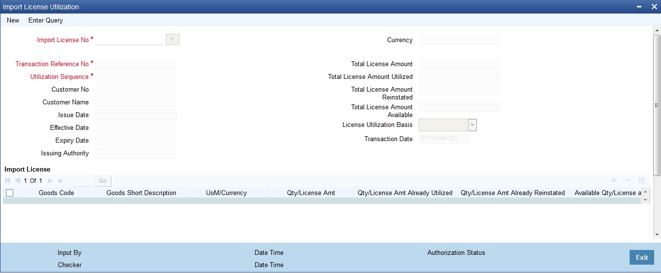

Import License
Click this button to capture import license details,

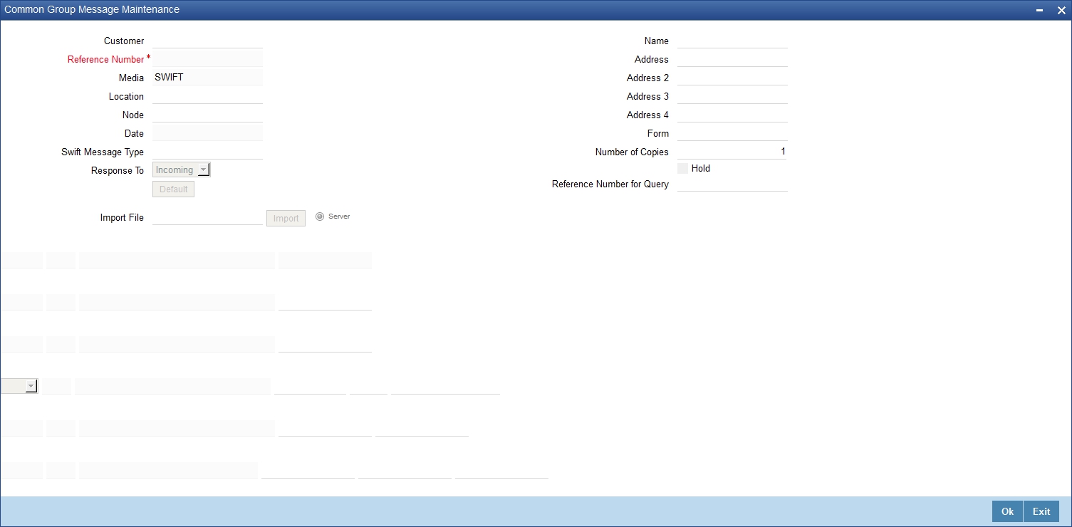

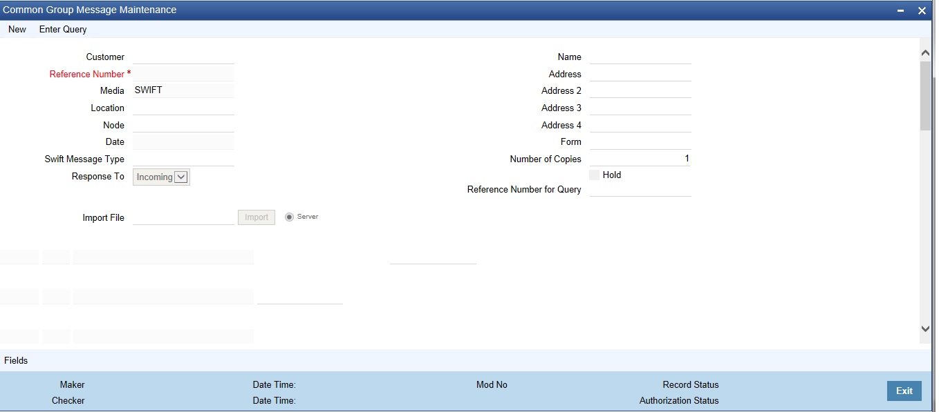

Common Group Message
Click this button to open the common group message call form

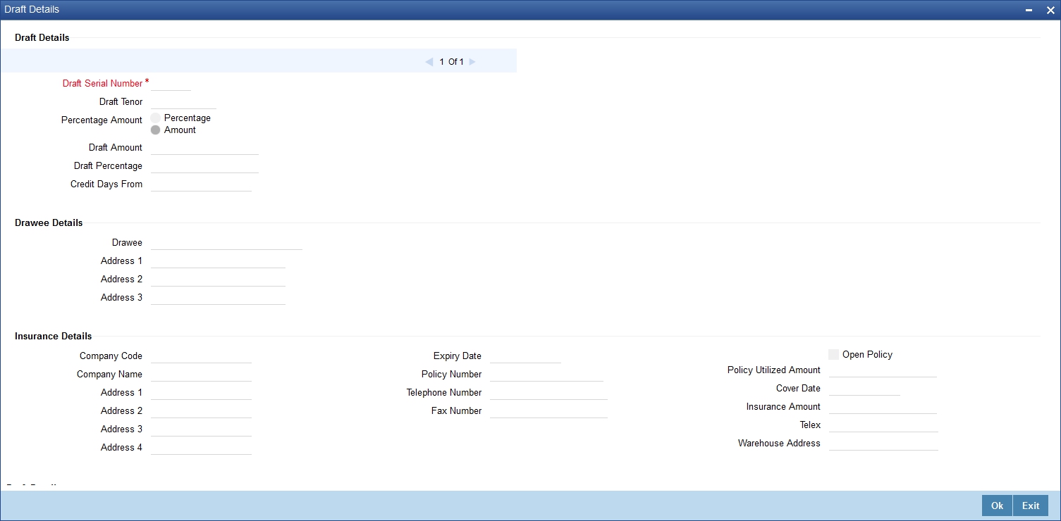

You can capture the details of the draft that is drawn for the LC, in the Drafts screen. In addition, you can also specify the name of the insurance company that is covering the goods traded under the LC. Click ‘Drafts’ button in the LC Contract to invoke the screen:
You can capture the following details:
Draft Tenor
Specify the tenor of the draft.
If the LC Type of an LC product is selected as 'Sight', then:
If the LC Type of an LC product is selected as 'Usance', then:
If either 'Minimum Draft Tenor' or 'Maximum Draft Tenor' is defined for the LC product, then on save of both LC contract creation and amendment, the value defined for the 'Draft Tenor' of LC contract will be validated against the 'Minimum Draft Tenor' (if 'Minimum Draft Tenor' is defined) or will be validated against 'Maximum Draft Tenor' (if 'Maximum Draft Tenor' is defined). If the validation fails, the system displays an override message.
Amount/Percentage
Specify whether the draft is a percentage of the LC amount or a Flat amount.
Subsequently, specify the Amount or the Percentage (based on your selection).
Credit Days From
The Date from which the tenor of the draft begins.
6.2.2 Specifying Drawee Details
Specify the following details.
Drawee
Specify the party on whom the draft is drawn. You can select the drawee’s CIF from the adjoining list. This will contain a list of all the open and authorized CIF maintained in the Customer Directory. This information is captured from the BIC directory.
Address 1 to 3
Specify the address of the drawee.

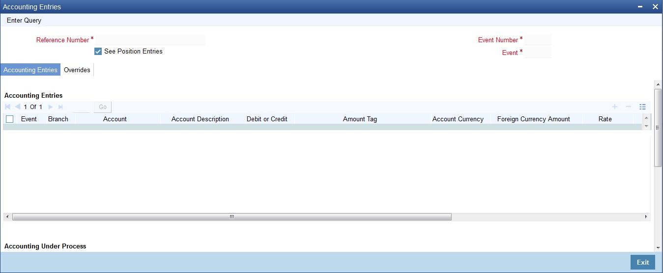

6.4.2 Viewing the Accounting Entries Passed for the LC
From ‘LC Contract - View Events’ screen, click ‘Accounting Entries’ to view the Accounting Entries for the event. The accounting entries that are passed depend on the type of LC that you are processing.
The following information is provided for each event:
Click ‘Exit’ or ‘Cancel’ to go back to the screen from where you invoked the Accounting Entries screen.

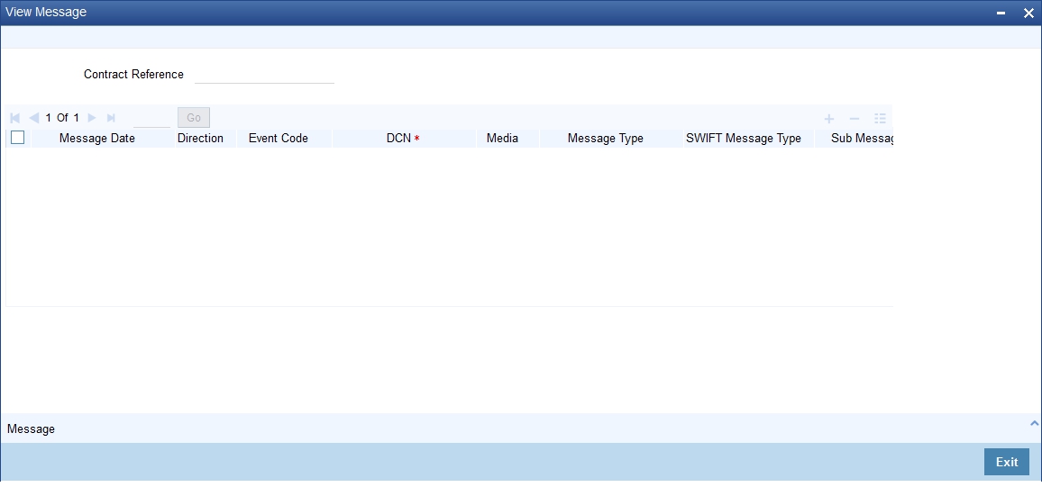

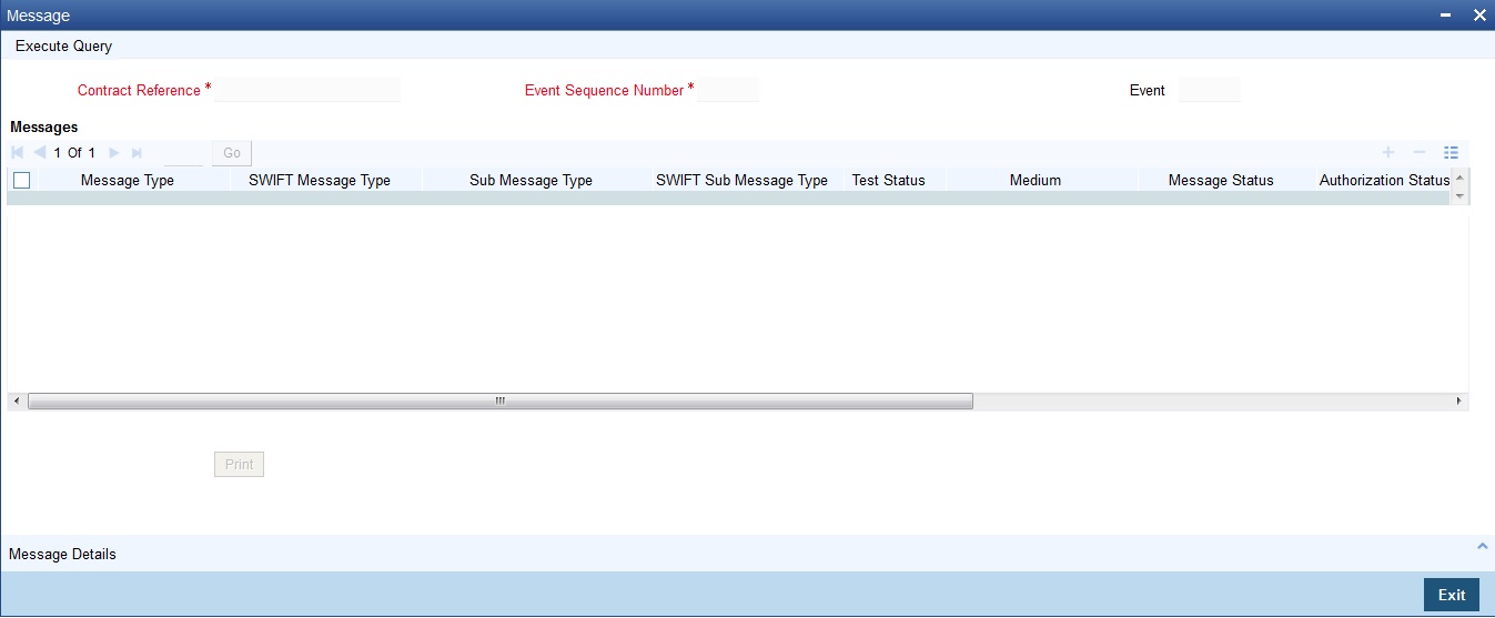

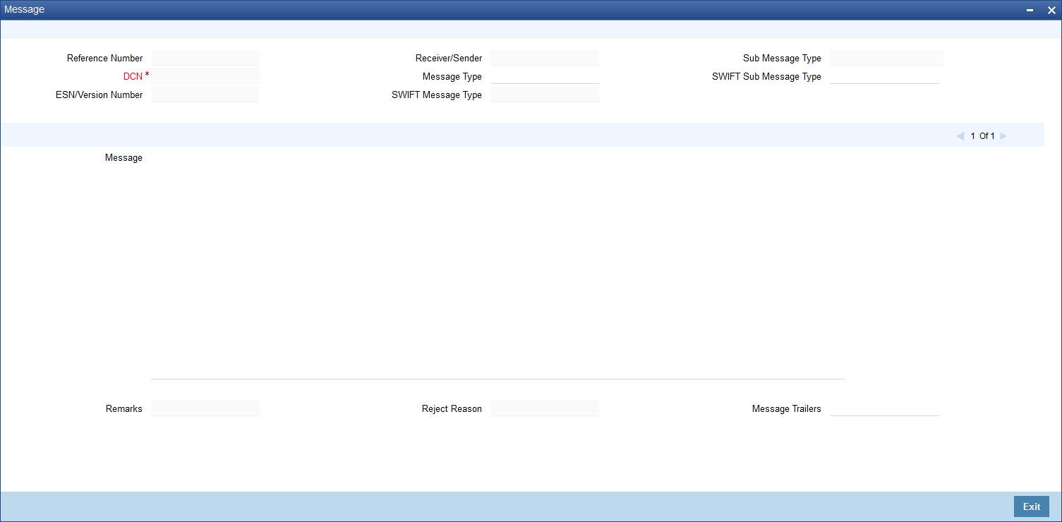

6.4.3 Viewing Advices Applicable to Contract
Click ‘Message’ from the View Events screen to view the list of advices applicable to a particular event in the lifecycle of the LC.
The following details of a message are displayed:
To view the text of a message, highlight the message and click on the ‘Message’ button. Click ‘Exit’ or ‘Cancel’ to exit the screen.

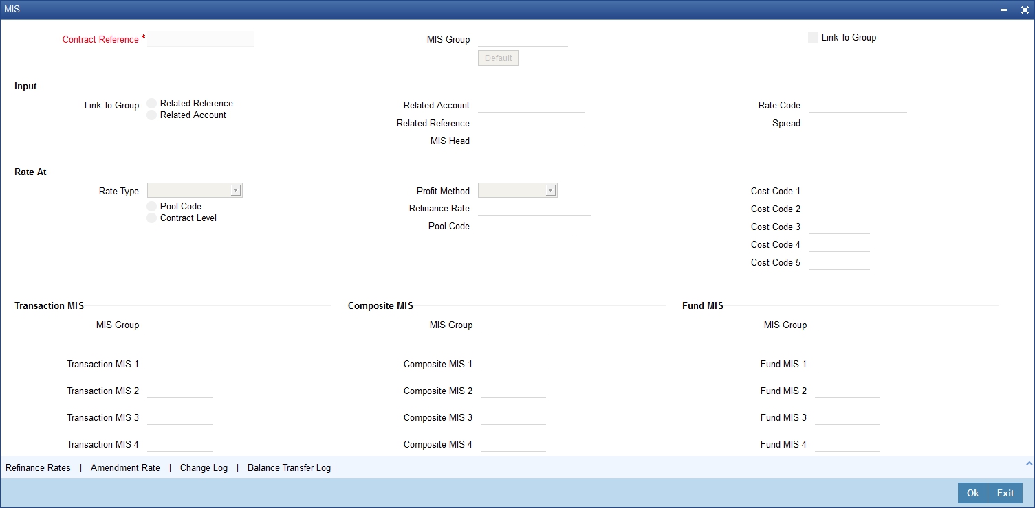

6.5 Capturing MIS Details
Click ‘MIS’ button to invoke the following screen.
Refer the MIS User Manual for further details on capturing MIS details.

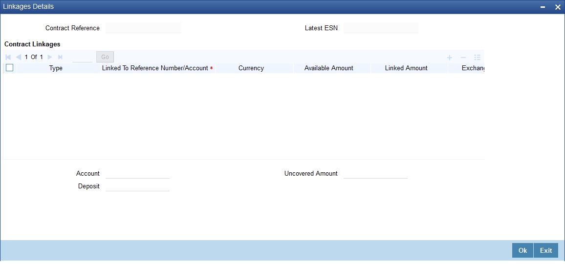

6.10 Linking Contracts to Deposits and Accounts
You can link an LC contract to deposits and accounts.
Type of linkage
Description
Linking a deposit
The entire LC amount, or a portion of it, can be linked to a deposit. The outstanding amount in the deposit should always be greater than or equal to the LC amount.
You can link several LCs to the same deposit, provided sufficient funds are available in the deposit.
Linking an account
You can link the entire contract amount or a portion of it, to a savings or current account that is maintained with you. The available balance in the account should always be equal to or greater than the contract amount that is outstanding. You can link any number of contracts to an account provided a balance greater than or equal to the total outstanding contract amount(s) is available in the account.
The entire contract amount or a portion of it can be linked to any number of deposits or account or to both. From the LC Contract Details screen, you can invoke the ‘Linkages Details’ screen by clicking ‘Linkage Details’ button.
In this screen, you can specify any account/deposit with you, and indicate the funds that you would like to block.
Type
In the Contract Details screen, you can specify the type of linkage. The LC can be linked to a:
If you select the EL type, then LC reference number will be available in Linked to Reference Number option list. Only Export type of LC is displayed in option list. You can link Export type of LC, only for bill availing under reimbursement type of LC.
Linked To Reference Number/Account
If the LC is linked to a deposit, you should enter the Reference Number of the deposit. The deposit should be a valid contract in Oracle FLEXCUBE, with a Value Date that is earlier than or the same as the Value Date of the LC contract. The Maturity Date should be the same as, or later than that of the contract.
If the linkage is with an account, enter the account number to which you are linking the LC. The account you specify has to be a customer account (a Current account or a Savings Bank account).
If the linkage is with LC, linked reference number will be the reference number that you entered in the main page.
Currency
The currency of the linkage type to which the LC is linked is displayed once the linkage details are specified.
Available Amount
The system displays the amount available against the linked contract or account.
Exchange Rate
If the currency of the LC is different from the currency of the deposit or account to which it is being linked, the mid-rate for the day will be picked from the Exchange Rate table and displayed in the screen.
Converted Linked Amount
The system displays the converted linked amount.
Linked Amount
Indicate the contract amount that has to be linked to the deposit or account. This amount can be the entire amount of the LC or a portion of it. The amount available for linkage, in the specified deposit or account, is arrived at, by taking into account other linkages and the uncollected and unauthorised balance (in the case of an account).
Once the linked amount is specified, the system displays the following values.
Account/Deposit
The system displays the amount linked to each contract or account.
Uncovered Amount
The system displays the contract amount that has not been linked, in the case of a partial linkage.

6.13 Capturing UDF Values
Click ‘Fields’ button to invoke the following screen.
The User Defined Fields (UDFs) maintained for the linked function id are displayed here. You can specify values for them.
Refer the User Manual titled ‘User Defined Field’ for details about defining UDFs.

6.15 Split Settlement Screen
This section contains the following details:
6.15.1 Split Settlement Screen
Click ‘Split Settlement’ button to invoke the following screen.
6.15.2 Specifying Settlement Split Master
You can specify the details of the settlement split master in the following fields:
Basis Amount Tag
Specify the amount tag involved in the contract. The adjoining option list displays all valid amount tags maintained in the system. You can choose the appropriate one. For example, on booking a new contract, the only tag allowed is PRINCIPAL. This is referred to as the basis amount tag.
Currency
The system displays the currency associated with the amount tag.
Amount
The system displays the basis amount associated with the amount tag. For example, the amount involved in the contract would be displayed against the amount tag ‘PRINCIPAL’. The amount is in terms of the currency associated with the amount tag.
You can use ‘Get Exchange Rate’ button to get the original exchange rates defaulted in the screen.
6.15.3 Specifying Settlement Split Details
For each spilt amount tag, you need to specify the following details:
Amount
Specify the amount for the split amount tag. This amount should not be greater than the amount of the corresponding basis amount tag. The split amount is in the currency of the basis amount tag. This is a mandatory field and you will not be allowed to save the details if you do not specify the amount.
Loan Account
Check this box to indicate that the specified account should be the loan account.
Exchange Rate
Specify the exchange rate that should be used for the currency conversion.
Negotiated Cost Rate
Specify the negotiated cost rate that should be used for foreign currency transactions between the treasury and the branch. You need to specify the rate only when the currencies involved in the transaction are different. Otherwise, it will be a normal transaction.
The system will display an override message if the negotiated rate is not within the exchange rate variance maintained at the product.
Negotiated Reference Number
Specify the reference number that should be used for negotiation of cost rate, in foreign currency transaction. If you have specified the negotiated cost rate, then you need to specify the negotiated reference number also.
Note
Oracle FLEXCUBE books then online revaluation entries based on the difference in ex­change rate between the negotiated cost rate and transaction rate.
6.16 Capturing Brokerage Details
You can capture the brokerage details for an LC contract and set your preferences for sharing the brokerage amount among multiple brokers using ‘Brokerage’ screen. To invoke the screen, click ‘Brokerage’ button on ‘Letters of Credit Contract Details’ screen.
Contract Reference
The system displays the reference number of the contract.
Contract Currency
The system displays the currency of the bills contract. You cannot modify the contract currency.
Brokerage Percentage
Specify the percentage of the contract amount that should be paid as brokerage. Based on the percentage set here, the system calculates the brokerage amount. The brokerage amount calculation takes place at the Bills contract level.
In case of Bills contracts, you may directly enter the brokerage amount. However, if you specify the brokerage percentage as well as the amount, the system ignores the amount and calculates it afresh based on the percentage specified here.
Brokerage Amount
Specify the brokerage amount to be paid. However, if you have entered the brokerage percentage, the system ignores the amount mentioned here and calculates it afresh based on the brokerage percentage.
You can directly enter the contract amount for Bills contracts only. In case of LC contracts, the system displays the amount based on the brokerage percentage and contract amount. You cannot modify the brokerage amount in that case.
Brokerage Details
You can share the brokerage amount among multiple brokers. Click add button to add more brokers to the list.You can define the percentage of brokerage amount to be paid to each broker selected under this list
Broker
Specify the broker ID. The option list displays all valid broker IDs maintained in the system. Choose the appropriate one.
You can maintain multiple records for the same broker ID.
Broker Name
Based on the broker ID selected, the system displays the name of the broker.
Broker Account
Specify the broker account. The option list displays all valid accounts maintained for the selected broker along with the Nostro accounts and GLs for which posting is allowed. Choose the appropriate one.
Broker Currency
The system displays the currency of the selected broker account.
Percentage
Specify the percentage of total brokerage amount that should be paid to the selected broker. This will make the selected broker eligible for that percentage of the total brokerage amount shown above.
You can allot a specific percentage of the brokerage to each broker selected here. The system will verify whether the percentages allotted for all brokers together equals to 100 or not.
Amount in Account Currency
The system displays the portion of brokerage amount allotted to the selected broker in terms of local currency.
Exchange Rate
The system displays the exchange rate between the local currency and the account currency. This rate is used to convert the brokerage amount into the account currency. You can modify the exchange rate.
Amount in Contract Currency
The system calculates and displays the portion of brokerage amount allotted to the selected broker in terms of contract currency.
Original Exchange Rate
The system displays the actual exchange rate. This rate is inclusive of all available customer spreads.
Negotiated Rate
Specify the rate of exchange agreed upon after the negotiations with the broker.
Negotiation Reference Number
Specify the negotiation reference number.
Once you have captured the details, save the contract. The system allows modification of brokerage details until its liquidation.
The system will default the brokerage details to the bill contracts associated with this LC. You may modify the brokerage details at the bills contract level.
You can use ‘Exchange Rate’ button to get the exchange rates between the broker account currency and bill currency for all the brokers listed in the screen.
The system defaults the brokerage details in ‘Spilt Settlements’ screen. Those details are then used in settlements. You can enter the routing details for the messages in case the settlement takes place through Nostro account. If you modify the default brokerage details in ‘Split Settlements’ screen, the system displays an error message.
During liquidation of the brokerage, the system generates credit advices for each of the brokers involved.

6.18 Viewing all Messages
Click ‘All Messages’ button to invoke the ‘View Message’ screen. This screen displays all the messages associated to the contract.
The following details are displayed:
Contract reference number – Displays Reference number of the contract, for which messages are generated.
Message Date – Displays the message generation date or received date
Direction – Displays whether the message is an incoming or outgoing message.
DCN – Displays document reference number of a contract.
Media – Displays whether the message is swift message or mail message.
Message Type – Displays the type of message
Swift Message Type – Displays the Swift MT number of the message sent or received.
Receiver/Sender – Displays Receiver or Sender ID.
Name – Displays the name of the Sender or Receiver.
Message Status – Displays current status of message.
Test Status – Displays the test status.
Authorized – System displays whether the status is authorized or unauthorized.
Acknowledgement Status – Displays the Ack/Nack Status of a message
PDE Flag – Displays the PDE flag.
6.19 Previewing Messages
You can preview the messages or advices that will be generated for the contract using ‘Message Preview’ screen. To invoke this screen, click ‘Message Preview’ button.
For the contract, you can view the following details of the messages:
You cannot preview the message after the authorization of the contract.
For preview of SWIFT MT700 and MT760 messages on hold, you need to view the Advices/ Settlement/Commission/Charges/Interest or Collateral sub-screen after contract input. The system performs the required validations and after that, you can keep the contract on hold and view the message in ‘Message Preview’ sub-screen.
Message preview functionality is available on save for all the LC module transactions and preview available for MT700 and MT 760 for hold transactions also. Along with the preview option, you will also be allowed to print the required message/advice from the preview screen.
6.19.1 Viewing Message/Advice
Select a message/ advice and click ‘View’ button to view the complete message/advice. The system will display the following details in a new window.
You can view the following details:
6.19.2 Printing Message/Advices
From the ‘Message Preview’ screen, you can print a message/advice using the ‘Print’ button. Select the message/advice and click ‘Print’ button to print the message.
6.20 Utilizing Import Licenses
You can link the import license to an import LC contract and update the utilization amount or quantity for the linked import licenses. You can utilize multiple import licenses for an import LC. Click on ‘Import License’ to invoke the import license screen.
Import License No
Select the import license number from the adjoining option list.The import licenses maintained for the party type ‘Applicant’ in the Import License Maintenance screen is displayed in the option list.
Goods Code
Select the goods code from the adjoining option list.
Goods Short description
The system displays the goods short description maintained in the ‘Bills and Collections Commodity Code Maintenance’ screen.
UoM/Currency
The system displays the unit of measurement or currency captured for the goods code of import license.
Note
If the basis is ‘Quantity’, then the system displays the UoM maintained for the goods code.
If the basis is ‘Amount’, then the system displays the currency maintained for the import license.
Qty/License Amount
The system displays the Quantity or License Amount captured for the goods code of import license.
Qty/License Amt Already Utilized
The system displays the sum total of Quantity or License Amount already utilized for the goods code.
Qty/License Amt Already Reinstated
The system displays the sum total of Quantity or License Amount already reinstated for the goods code.
Available Qty/License Amt
The system displays either the Available Quantity or Available License Amount for the goods code.
Qty/License Amt Utilized
Specify the quantity or the license amount utilized.
Note
If the license utilization basis is Quantity, then the system defaults the License Amount Uti­lized as Quantity Utilized * Rate/Unit.
Qty/License Amt Reinstated
Specify the quantity or the license amount reinstated.
Note
After authorization, you cannot modify or delete import licenses linked to a LC contract.
The utilizations and re-instatements maintained for an import license in ‘Import License Utilization’ Screen and Import License sub-system will be differentiated by the system based on the ‘Transaction Reference Number’.
On authorization of reversal of a contract, the utilizations of all linked import licenses will also be reversed i.e. the value of Qty / License Amt Already Utilized - Qty / License Amt Already Reinstated will be posted as Qty / License Amt Reinstated for the respective goods codes and Available Qty / Available License Amt values will be re-computed.
If an import licenses linked to an Islamic import LC contract is not completely availed i.e. sum total of availments are less than the liability amount of Islamic import LC, then at the time of closure of Islamic LC contract, the system will give an alert to reinstate un-utilized quantity / license amount of linked import licenses. If auto closure is enabled for such Islamic import LC contracts, then system will not perform the auto-closure.
Note
If the good is classified either as Licensed or as Prohibited and the import licence details are not entered in the LC or BC contract screens, then the system displays an override message as “Import license details are not entered for the contract.”
For import LC contract, the effective date should be between the effective date and expiry date of the linked import license.

6.22 Common Group Message
6.22.1 Common Group Message Maintenance
You can enter details of common group messages using the Common Group Message screen. Click on ‘Common Group Message’ to open this screen..
For field descriptions of the above screen refer the section ‘Common Group Message Maintenance’ in chapter titled ‘Defining Free Format Messages’ in ‘Messaging System User Guide’.
You can enter the details of the message and the message is saved when the contract is saved.. The saved messages can be viewed in the message preview subsystem before authorization. On authorization of the contract, the message is generated. After authorization, the messages can be viewed from ‘All Messages’ subsystem and ‘Events’ subsystem. The messages are linked with the relevant event in which the common group message is generated.
The common group messages which are supported are listed below:
MT
MT Name
n90
Advice of Charges, Interest and Other­Adjustments
n91
Request for Payment of Charges, Inter­est and Other Expenses
n92
Request for Cancellation
n95
Queries
n96
Answers
n98
Proprietary Message
n99
Free Format
6.22.2 MT759 - Ancillary Trade Structured Message – Common group Mainte­nance Screen (MSDCOMPM)
MT759 – Ancillary Trade Structured Message has been added to the existing list of SWIFT Message Types.
Click on Common Group Message subsystem. Added 759 in Swift Message when select­ed with appropriate LOV, will display MT 759 fields.
6.22.2.1 MT759 - Ancillary Trade Structured Message – Common group Maintenance Subsystem (LCDTRONL/BCDTRONL)
You can enter details of ancillary trade structured message using the Common Group Maintenance LCDTRONL subsystem screen. Click on ‘Common Group Message’ to open this screen.
You can enter details of ancillary trade structured message using the Common Group Maintenance BCDTRONL subsystem screen. Click on ‘Common Group Message’ to open this screen.
Provision to generate MT759 common group messages in LCDTRONL and BCDTRONL is enabled by enhancing Common Group Messages screen (MSCCOMPM)
LCDTRONL – Click on Common Group Message subsystem. Type LOV and few fields
are added to 759 in Swift Message
BCDTRONL – Click on Common Group Message subsystem. Type LOV and few fields are added to 759 in Swift Message
6.23 Specifying Import License Utilization
The transactions for licensed import goods can be executed from different banks. You can record the portion of import license utilized by other banks through ‘Import License Utilization’ screen. You can also reinstate the quantity or license amount marked as utilized for the physical import of goods.You can invoke this screen by typing ‘LCDILUTL’ in the field at the top right corner of the Application tool bar and clicking on the adjoining arrow button.
Specify the following here:
Import License No
Select the import license number for which utilization or reinstatement should be performed from the adjoining option list.
Transaction Reference No
The system displays the transaction reference number.
Utilization Sequence
The system displays the utilization sequence number.
Customer No
The system displays the customer id captured for the import license.
Customer Name
The system displays the name of the customer id.
Issue Date
The system displays the issue date recorded for the import license.
Effective Date
The system displays the effective date.
Expiry Date
The system displays the expiry date here.
Issuing Authority
The system displays the issuing authority of import license.
Currency
The system displays the currency of the sum total of the license amount.
Total License Amount
The system displays the total license amount.
Total License Amount Utilized
The system displays the sum total of licensed amount utilized for all goods code.
Total License Amount Reinstated
The system displays the sum total of license amount reinstated for all goods code.
Total License Amount Available
The system displays the sum total of available license amount of all goods.
License Utilization Basis
The system displays the utilization basis captured.
The system displays unique transaction number for each utilization.
Transaction Date
The system defaults the current date.
Import License
You can capture multiple goods code, quantity or amount details here.
Goods Code
The system displays the goods code.
Goods Short Description
The system displays the short description captured for the goods code.
UoM/Currency
If the basis is ‘Quantity’, then the system displays UoM maintained for the goods code.
Qty/License Amt
Available Qty/ License Amt
Qty/License Amount Utilized
If the license utilization basis is ‘Quantity’, then the system updates license amount utilized as (Quantity Utilized * Rate / Unit).
Qty/License Amount Reinstated
If utilization in Qty/License Amount is maintained for a goods code of an import license using Import License Utilization, then the system allows reinstatement of the same.
The value specified for Qty / License Amt Reinstated should be less than or equal to sum total of (Qty/License Amt Already Utilized - Qty/License Amt Already Reinstated) through ‘Import License Utilization’ screen.
Reinstatement is displayed on authorization of transaction. You can specify either Qty / License Amt Utilized or Qty/License Amt Reinstated for a goods code.
Internal Remarks
Specify remarks if any.

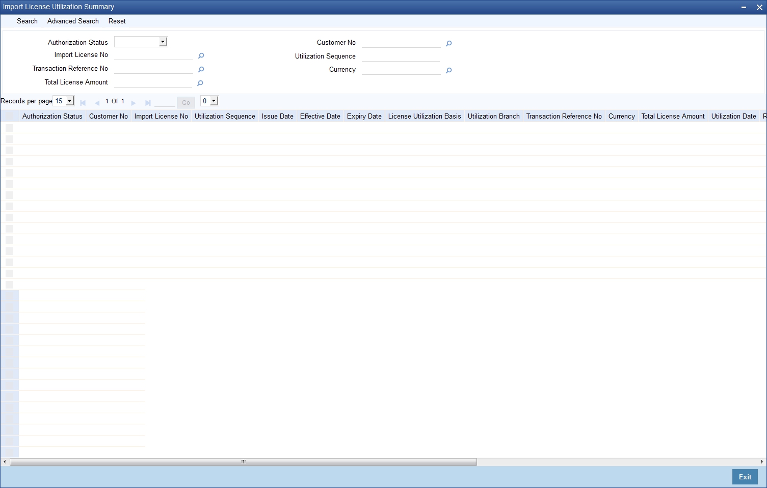

6.24 Viewing Import License Utilization Details
You can view the import license utilization details in Import License Utilization Summary Screen. You can invoke this screen by typing ‘LCSILUTL’ in the field at the top right corner of the Application tool bar and clicking on the adjoining arrow button.
In the above screen, you can base your queries on any or all of the following parameters and fetch records:
Select any or all of the above parameters for a query and click ‘Search’ button. The records meeting the selected criteria are displayed.
If you are allowed to query import license utilization details, then system displays the following details pertaining to the fetched records:
6.24.1 Operations on Import License Utilization
On an Import License record, you can perform of the following operations (if any icon is disabled in the application toolbar, it means that the function is not allowed for the record):
Please refer to the manual on Common Procedures for details of these operations.
