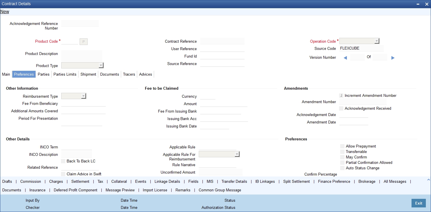

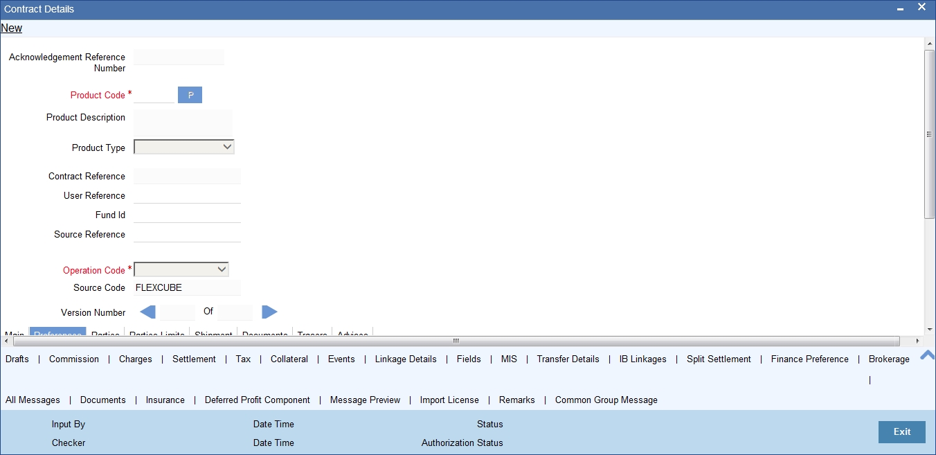

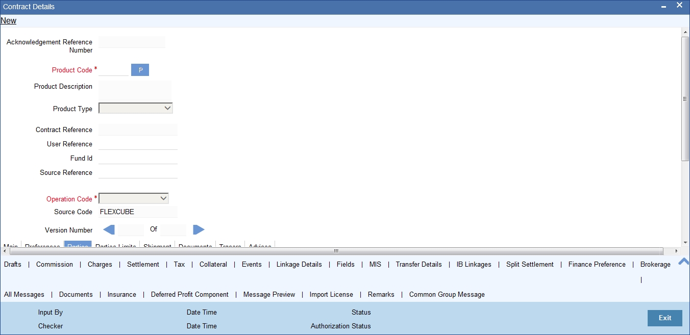

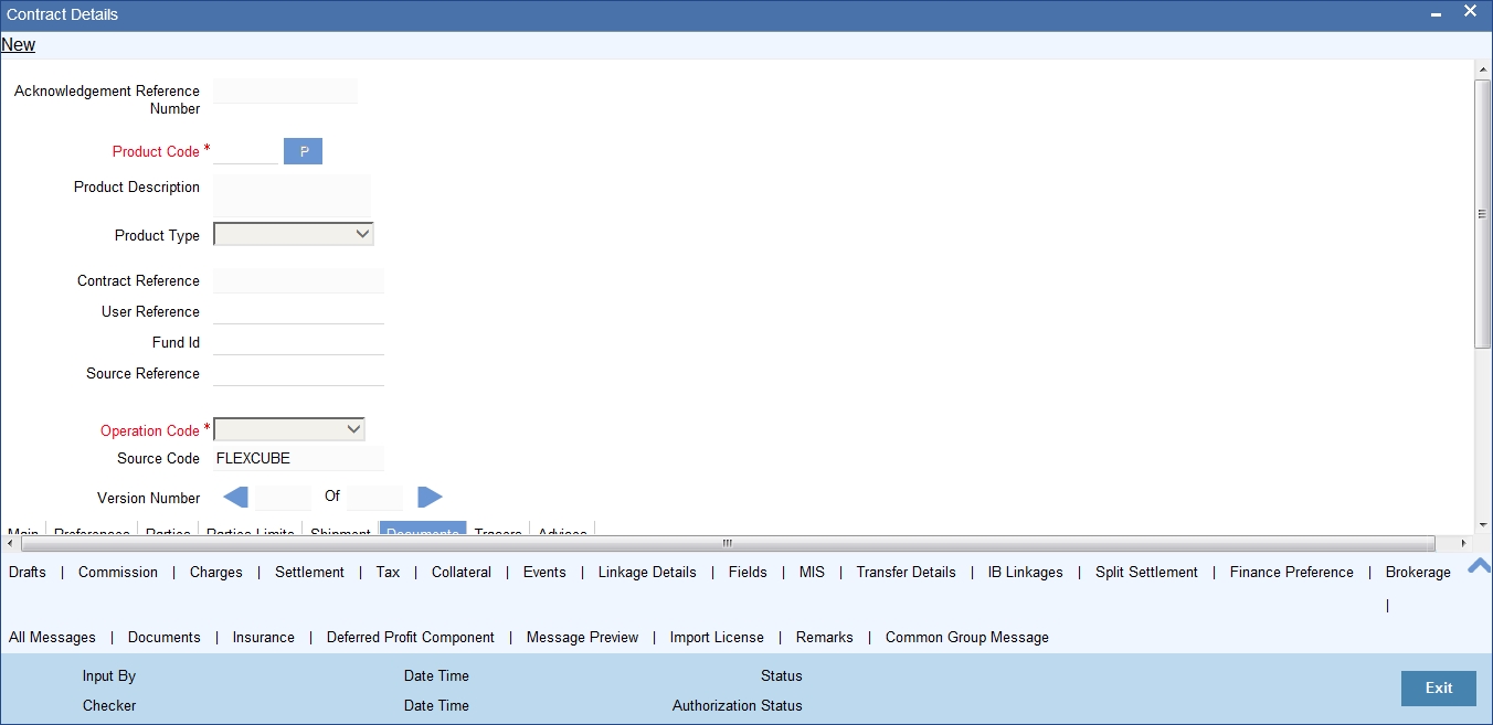

You can invoke ‘Islamic LC Contract Input’ screen by typing ‘LIDTRONL’ in the field at the top right corner of the Application tool bar and clicking the adjoining arrow button. Click ‘New’ icon in the application toolbar. The ’Islamic LC Contract Input’ screen with no values in the fields is displayed.
If you are calling a contract that has already been created, click on Summary view. You can invoke ‘Islamic LC Contract Summary’ screen by typing ‘LISTRONL’ in the field at the top right corner of the Application tool bar and clicking the adjoining arrow button. You can open an existing contract by double clicking the contract.
You can enter the following details here:
Acknowledgement Reference Number
Specify the acknowledgement reference number. Alternatively, you can select the reference number from the option list. The list displays all the acknowledgement reference numbers and type of registration maintained at LC registration screen which are authorized and unprocessed.
The system defaults the details captured in registration screen if acknowledgement is captured on clicking populate (P) button beside Product Code.
If Registration is for LC issuance and product code is selected BG Issue/SG issue, then the system displays configurable override on product default.
Note
System will update the status of registration as ‘Processed’ and contract reference no at registration screen, if acknowledgement reference number is captured at contract screen and (new) contract is created.
Product Code
Select the product from the list of products created in the Islamic LC. Click ‘Populate’ button for details of this product to get defaulted from the Product screen.
Product Description
Product description given for this product gets defaulted from the Product screen.
Contract Reference Number
The Contract Reference Number identifies a contract uniquely. It is automatically generated by the system for each contract. The Contract Reference Number is a combination of the branch code, the product code, the date on which the contract is booked (in Julian format) and a running serial number for the booking date.
The Reference Number consists of a three-digit branch code, a four-character product code, a five-digit Julian Date and a four-digit serial number.
The Julian Date has the following format:
YYDDD
Here, YY stands for the last two digits of the year and DDD for the number of day(s) that has/have elapsed, in the year.
Product Type
The type of product gets displayed here from the product screen, specifying if the product is of type import/export or revolving or non-revolving.
In addition, a contract is also identified by a unique User Reference Number. By default, the Contract Reference Number generated by the system will be taken as the User Reference Number. But you have the option to change the User Ref Number.
Oracle FLEXCUBE also provides you the facility to generate the user reference number in a specific format.
Note
You can specify a format for the generation of the User Reference Number in the ‘Sequence Generation’ screen available in the Application Browser. Refer to the Core Services User Manual for details on maintaining a sequence format.
Source Reference
The system automatically generates the Source Reference number. You can change it if required.
This message identification number will be used to identify an incoming message coming from an external system. This is defined as the ICN number. On upload of an incoming message into Oracle FLEXCUBE, this number, given by the external system, will be stored in Oracle FLEXCUBE and passed on to the contract generated as a result of the incoming message. If the incoming message results in an outgoing message, the ICN number will be linked to the outgoing message also.
This number will help you in creating a relationship between the incoming message, the resultant contract in Oracle FLEXCUBE, and the outgoing message, if any.
If an Incoming message results in an outgoing contract (outgoing message), Oracle FLEXCUBE will store the source reference number (ICN Number) at the following levels.
You can capture the same source reference number for LC advising and reimbursement contracts if LC Issuance (MT700) and LC Reimbursement Authority (MT740) are received from the same issuing bank.
Note
The system will not allow to capture, the same source reference number for more than one advising or reimbursing contracts.
Fund ID
Select the fund id from the adjoining option list. The system defaults the value of Default Mudarabah Fund as fund id.
Operation Code

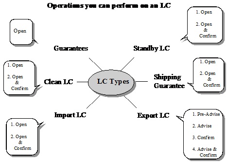

The operations that you can perform on an Islamic LC are determined by the type of Islamic LC being processed. The operation that you specify will determine the accounting entries that are passed and the messages that will be generated.
You can select operation code from the list of valid operation code value based on Product Type. The type of operation that you can perform on an Islamic LC has been diagrammatically represented below:
Through the screens that follow in this section, you can process all types of Islamic LCs (import, export, invoice, clean, guarantees, shipping guarantees).
You can choose to enter the details of a contract using the following methods:
To facilitate quick input, you only need to input the product code. Based on the product code, many of the fields will be defaulted. Overwrite on these defaults to suit your requirement. You can add details that are specific to the Islamic LC like the Islamic LC amount, details of the buyer and the seller, etc.
Oracle FLEXCUBE allows you to a facility to automatically upload Islamic LCs and Guarantees.
The MT 700 and MT 701 messages that you receive can be uploaded into Oracle FLEXCUBE as Islamic LC contracts. Depending on whether confirmation is required, the uploaded Islamic LCs will be of type ‘advice’ or ‘advice and ‘confirm’.
Similarly, you can upload MT 760 messages as Guarantee contracts and copy the details of the incoming guarantee from field 77c (and amend these details, if required). You only need to furnish minimal details such as the Currency, the Amount, the Parties, etc.
Upload processing will also upload the document reference of Shipping Guarantee Contracts.

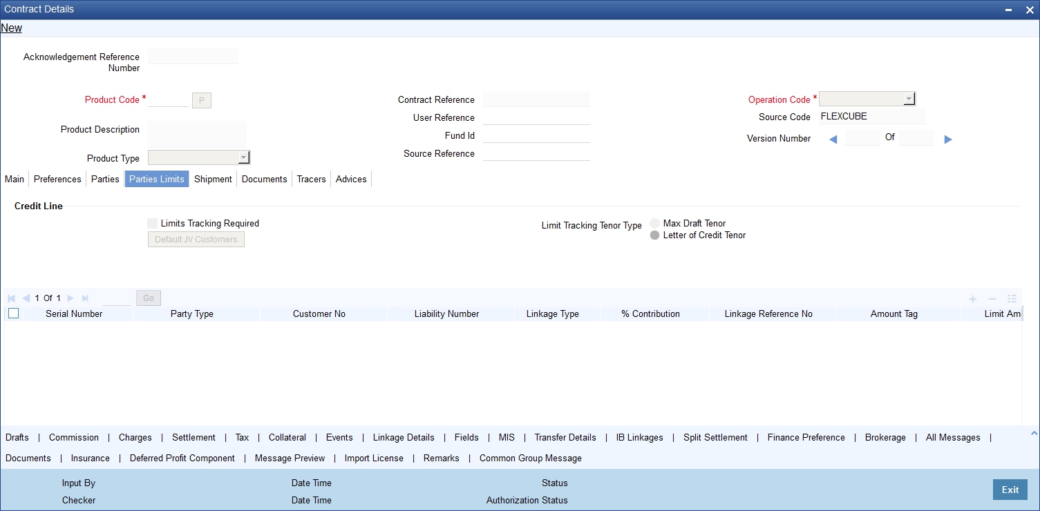

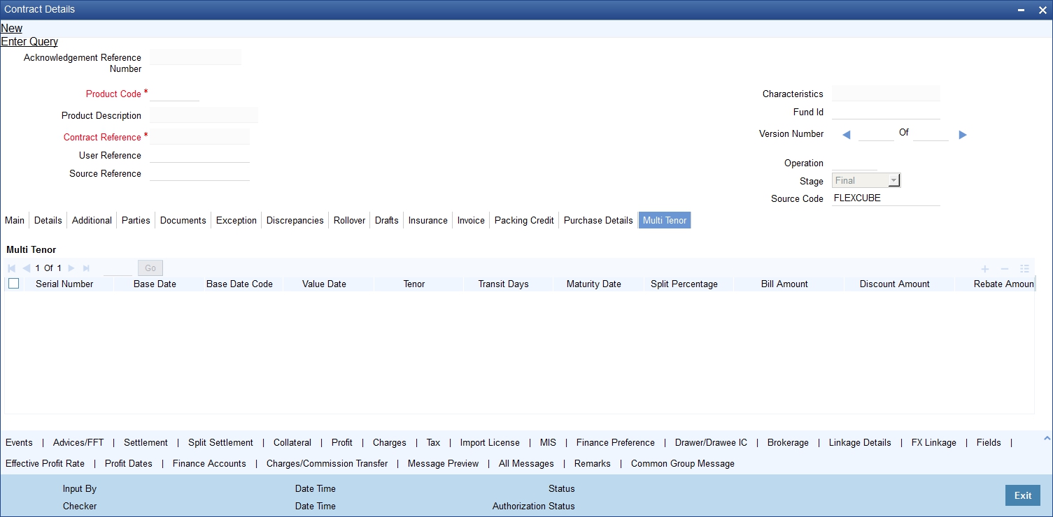

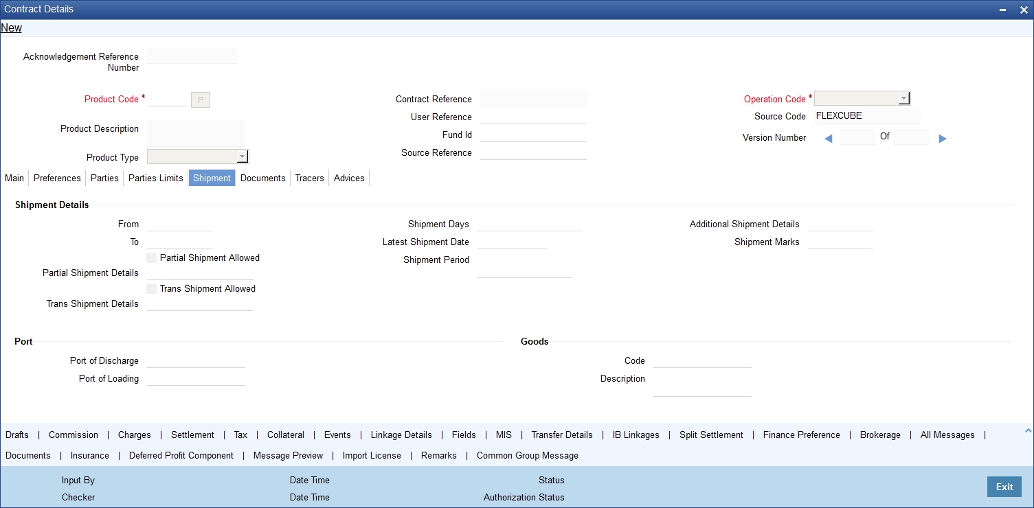

The Islamic LC Contract Details screen consists of a header and footer that contains fields specific to the contract being entered. Besides these, you will also notice six tabs and a horizontal array of icons along the lines of which you can enter details of the contract. Contract details are grouped into the various screens according to the similarities they share.
The Islamic LC Contract Screen contains six tabs along the lines of which you can enter details of the contract. The six tabs are:
Tabs |
Description |
Main |
Click this tab to enter the essential terms of the Islamic LC. This screen along with its fields has been detailed under the head Entering Main Contract Details. |

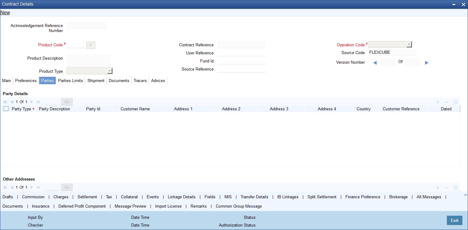

Parties |
In the screen that corresponds to this tab, you can enter the details of all parties involved in the Islamic LC. This screen along with its fields has been detailed under the head Entering Party Details. |

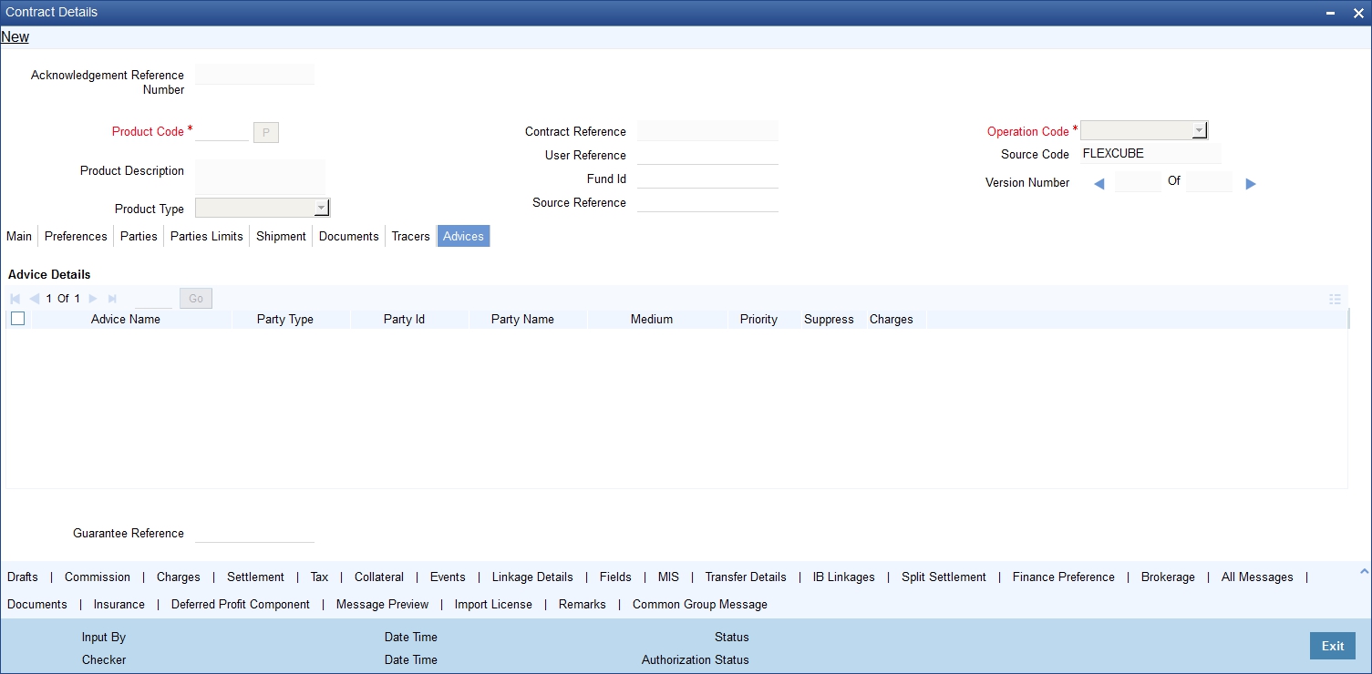

Advices |
In the screen corresponding to this tab you can view, suppress and prioritize the advices that are to be generated for a contract. This screen along with its fields has been detailed under the head Specifying Advises for an Islamic LC. |
Shipment |
In the screen that corresponds to this tab you can enter details of the documents required under an Islamic LC and the clauses that should accompany the documents. Besides, you can also specify a description of the merchandise traded under the Islamic LC and shipping instructions for the transportation of the merchandise. |
Tracers |
Click on this tab to enter details of the tracers that should be generated for an Islamic LC. |
Preference |
Click this tab to set the preferences |

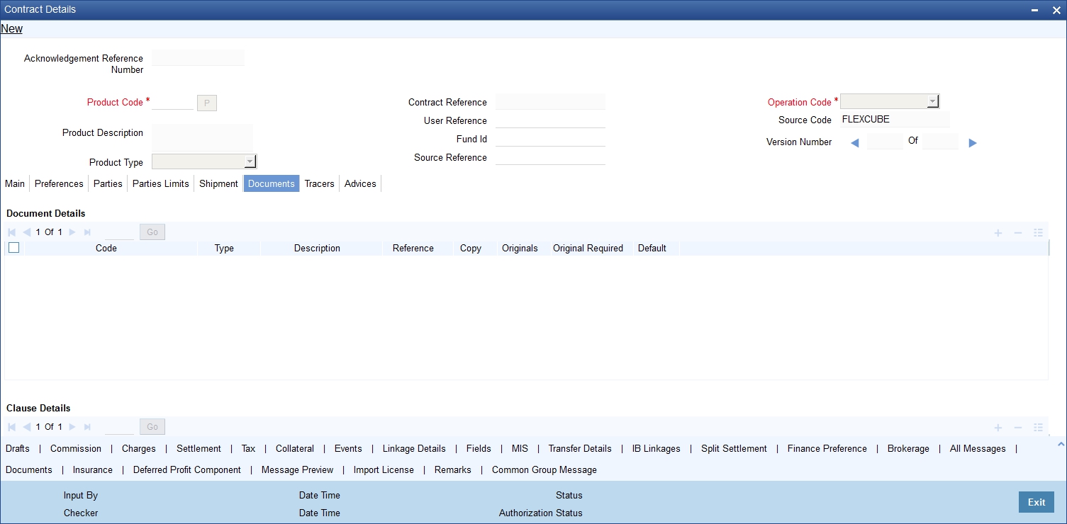

Documents |
Click this tab to capture the document details |

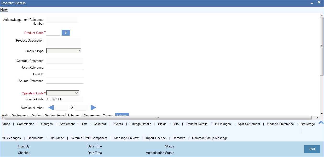

On the Contract Detailed screen are also displayed a horizontal toolbar. The buttons on this toolbar enable you to invoke a number of functions vital to the processing of an Islamic LC contract. These buttons have been briefly described below.
Buttons |
Description |

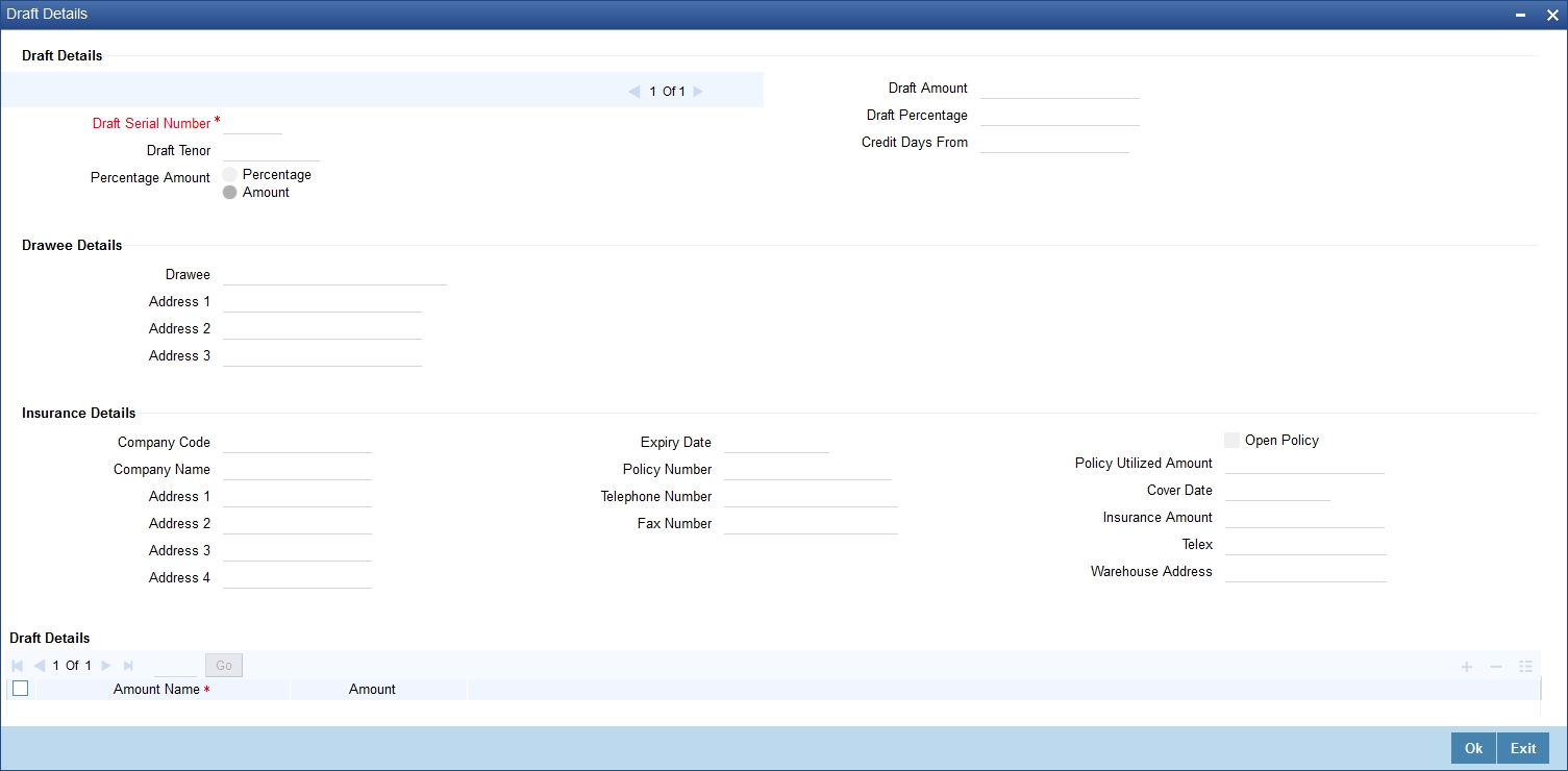

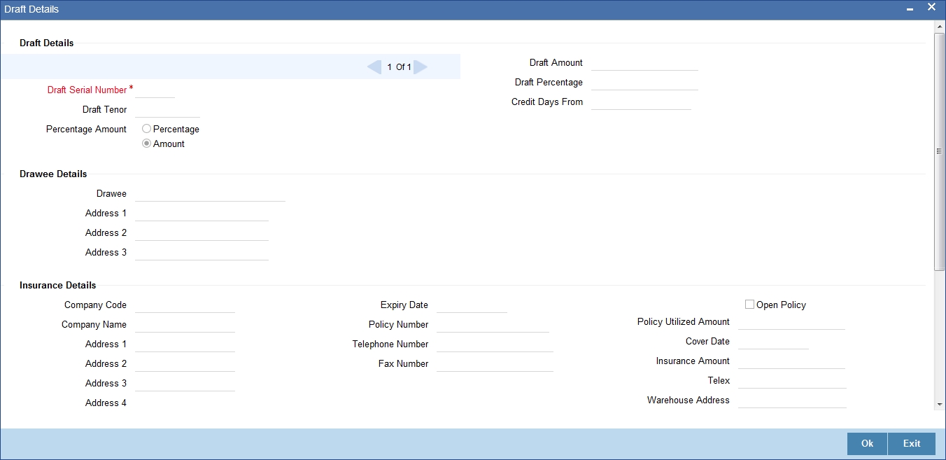

Drafts |
Click this button to capture the details of draft drawn for the LC. You can specify the name of the insurance company that is covering the goods traded under the LC. |

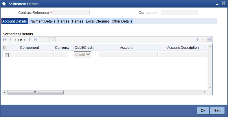

Settlement |
Click this button to invoke the Settlement screens. Based on the details that you enter in the settlement screens the Islamic LC will be settled. The details of these screens have been discussed in the Settlements manual. |
Events |
Click this button to view the details of the events and accounting entries that a contract involves. |
MIS |
Click this button to define MIS details for the Islamic LC. |
Commission |
On invoking this button Commission details of the contract are displayed |

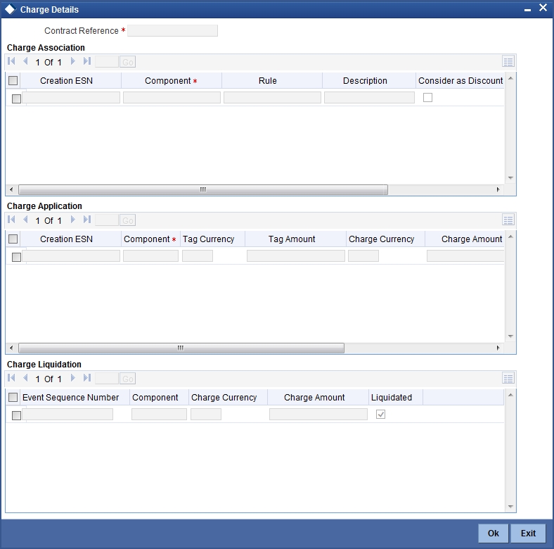

Charges |
This button invokes the Charges and Fees service. On invoking this function you will be presented with a screen where the ICCF rate, amount, currency and the waive charge parameter can be specified. The Processing Charges and Fees manual, details the procedure for maintaining charge rules. It also deals with the linking of a charge rules to a product and the application of the rule on an Islamic LC. The Processing Commissions manual, details the procedure for maintaining commission rules. It also deals with the linking of a commission rule to a product and the application of the rule on an Islamic LC. |

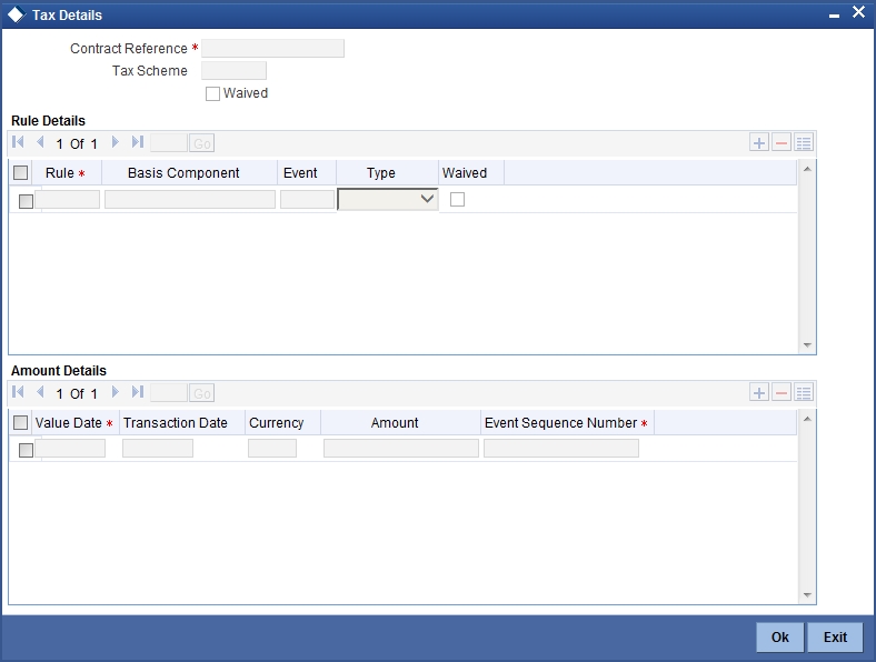

Tax |
This button invokes the Tax services. The Processing Tax manual details the procedure for maintaining tax rules and schemes. It also deals with the linking of a tax scheme to a product and the application of the scheme on an Islamic LC. |
Collateral |
In the screen that corresponds to this icon, you can specify details of the cash that you collect as collateral form a customer for the Islamic LC that you process. The details of this screen are discussed under the head Specifying Collateral details for an Islamic LC. |

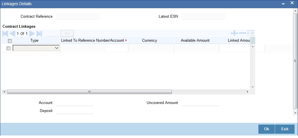

Linkage Details |
Clicking this button invokes the Contract Linkages screen. In this screen, you can link an Islamic LC to a deposit or account, and indicate the funds that you would like to block. |

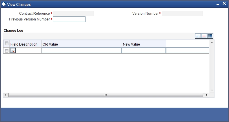

Change Log |
Click this button to view the changes made to a particular version of an Islamic LC contract. |
Transferred Components |
Click this button to view the deferred components details screen. |
Fields |
Click this button to view the user-defined fields linked to the product. |
Transfer Details |
If the LC is transferred to a new party then a transaction will be populated here. You can only view the details. |
Insurance |
Click this button to capture insurance details for the LC. |
Finance Preference |
Click this button to invoke the ‘Finance Preference Screen’. You can enter the details of the finance. |

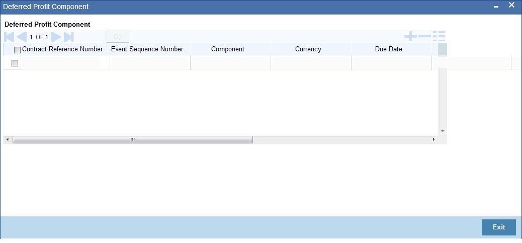

Deferred Profit Component |
Click this button view the components which are transferable to BC in Oracle FLEXCUBE |
IB Linkages |
Click this button to specify IB linkages |
Split Settlement |
Click this button to specify split settlement details |
Brokerage |
Use this button to capture brokerage details for the Islamic LC contract and set your preferences for sharing the brokerage amount among multiple brokers. |
Documents |
Click this button to capture the customer related documents in central content management repository. |
All Messages |
Click this button to view all messages associated to contract. |
Remarks |
Click this button to view ‘History of Remarks’ screen. |
Common Message Group |
Click this button to invoke the common group message screen.
Enter valid inputs into all the mandatory fields or you will not be able to save the contract. After making the mandatory entries for the Islamic LC, save the contract by either clicking ‘Save’ icon in the tool bar
A contract that you have entered should be authorized by a user bearing a different Login ID, before the EOD is run.
Note
You have the option to amend all the unauthorized entries made for an Islamic LC. However, after authorization, certain fields cannot be amended.
Click on ‘Exit’ button to go back to the Application Browser.
While defining a product, you defined a broad outline that can be applied on Islamic LCs. However, while processing an Islamic LC involving a product, you need to enter information specific to the Islamic LC.
This information is captured through the ‘Islamic LC Contract Details Main’ screen.
The following are the features of the contract details main screen.
The terms defined for an Islamic LC form the basis on which the Islamic LC will be processed.

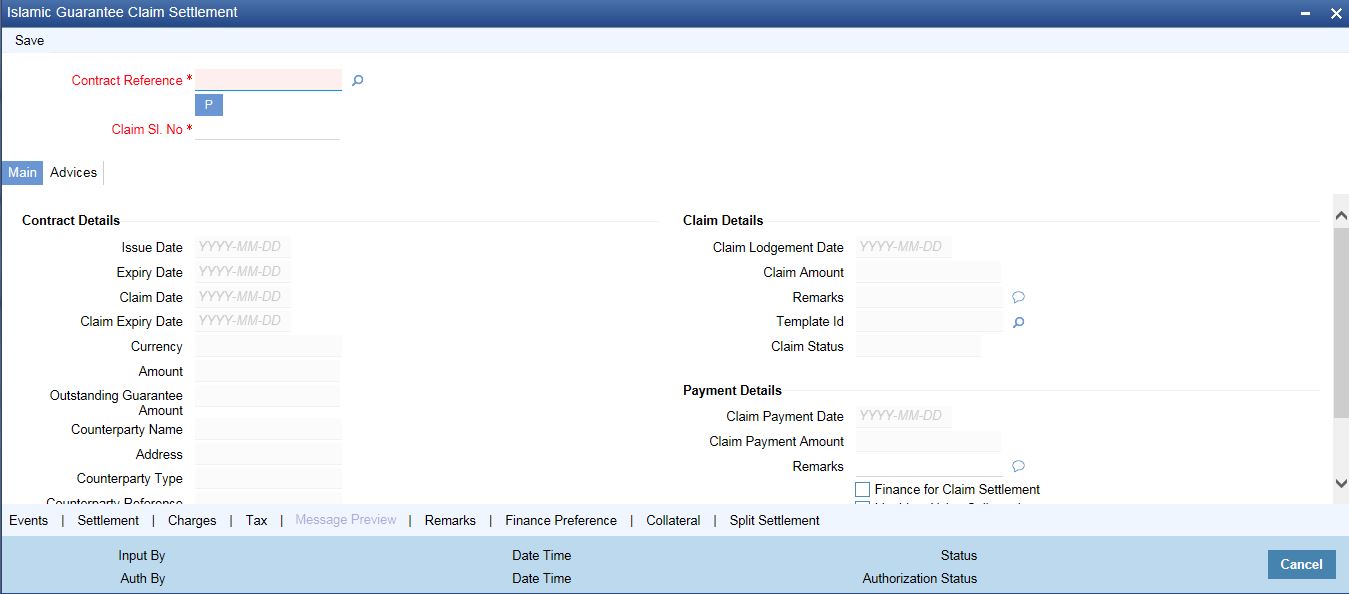

Claim Date
Select the claim date from the adjoining calendar. Claim date indicates the date by which all claims needs to be lodged for the guarantee. Claim Date should be on or before Claim Expiry Date.
Claim Expiry Date
Select the claim expiry date from the adjoining calendar. Claim expiry date indicates the date by which all claims lodged need to be settled. Claim Expiry Date = Expiry Date + Claim Days.
System defaults Claim Expiry date as Expiry Date + Claim Days on Product default. If Claim Days is zero, Claim Expiry date will be Expiry Date. Claim Expiry Date can be modified. On Save, system will validate the following:

You can capture the details of the draft that is drawn for the Islamic LC, in the ‘Drafts’ screen. In addition, you can also specify the name of the insurance company that is covering the goods traded under the Islamic LC. Click on ‘Drafts’ button in the ‘Islamic LC Contract’ screen to invoke the screen:
In this section, you can specify the following details:
Draft Serial Number
Specify the serial number of the draft.
Draft Tenor
Specify the tenor of the draft.
Credit Days From
Specify the Date from which the tenor of the draft begins.
Amount/Percentage
Specify whether the draft is a percentage of the Islamic LC amount or a Flat amount. Subsequently, specify the Amount or the Percentage (based on your selection).
In this section specify the following details:
Drawee
The ‘Drawee’ is the party on whom the draft is drawn. You can select the drawee’s BIC from the adjoining list. This will contain a list of all the open and authorized BIC maintained in the BIC Directory. Click option list to populate the Drawee field with the drawee’s name and address. This information is captured from the BIC directory.
Address
Specify the addresses of the drawee.
The following details are regarding the Insurance Company to be associated with the LC.
Company Code
You can select the appropriate company code from the option list. The list will display all authorized and active company codes. Upon selection of the company code, the following details will be automatically displayed by the system:
Company Name
Specify the full name of the insurance company.
Address
Specify the mailing address of the insurance company being defined. You can maintain a maximum of four lines of address.
Policy Number
Specify the insurance policy number here.
Telephone Number
You can also capture the telephone number of the insurance company.
Fax Number
Specify the Fax number of the insurance company.
Expiry Date
Enter the expiry date of the policy.
Policy Utilized Amount
Specify the utilized amount of the policy.
Cover Date
Specify the cover date.
Insurance Amount
Specify the insurance amount.
Telex
Specify the telex number.
Warehouse Address
Specify the warehouse address.
The breakup details of the draft will be displayed here as follows:
The draft amounts for the different components (Insurance, Profit, Invoice and Freight)
Note
You can also choose to associate an Insurance Company that is not maintained in the system. When you are specifying a company code that does not exist, the system will display an override (based on your requirement, you can configure the override to be a warning or an error message). On confirmation of the override, the company code will be automatically changed to ‘XXXXXXXXX’. Subsequently, you can specify any company name to be associated with the contract. The system will not perform any validations. The remaining fields in the screen will be disabled in this case.
You can capture the insurance details for an Islamic LC contract in the ‘Customer Insurance’ screen. To invoke this screen, click ‘Insurance’ button in the ‘Islamic LC Contract’ screen.
Here you can capture details for multiple insurance policies.
Policy No
Specify the insurance policy to be considered for the Islamic LC contract. The adjoining option list displays all the valid insurance policies maintained for the Islamic LC customer. You can select the appropriate one.
Currency
The system displays the currency of the chosen policy. If the currency of the Islamic LC is different from the currency of the insurance, then the system will convert the Islamic LC amount to insurance currency using standard mid rate.
Company Name
The system displays the company to which the insurance policy belongs.
Expiry Date
The system displays the date on which the chosen policy expires. If the expiry date of the insurance is prior to the expiry date of the Islamic LC, the system will display an override.
Insurance Amount
The system displays the available amount for the chosen policy in the contract currency. You can change it to suit the contract’s requirements. However, the amount cannot exceed the per bottom limit defined for the policy in the ‘Customer Insurance’ screen. If the amount exceeds the permissible limit, the system will display an override.
The total insurance amount linked to the Islamic LC should not be greater than the Islamic LC liability amount. If the total exceeds the limit, the system will display an override.
Utilization Lcy Amount
In case the contract currency is different from the insurance currency, the system displays the insurance amount in the insurance currency.
The Parties screen can be used to record the details related to all the parties involved in the Islamic LC. The documents, tracers and messages that are generated will be sent to the parties concerned, based on the details you specify in this screen.
You can maintain the following details here:
You should specify the following for each of the parties involved in the Islamic LC:
Party Type
The party type (beneficiary, accountee, applicant, advising bank, issuing bank, reimbursing bank, advice through bank, confirming bank).
Party Description
You can provide the description for the party type here.
Customer Identification File Identification
The CIF ID assigned to the party, if the party is defined as a customer in Oracle FLEXCUBE. If the applicant (APP) or beneficiary (BEN) is not a customer of your bank, you can use a walk-in customer ID.
Name
Enter the name of the Customer. The party name can be 150 characters in length. However, please note that in the SWIFT messages that you generate only 35 characters will be included.
Country
Enter the country to which the party belongs.
Address 1 to 4
Enter the address of the customer who has initiated the transaction.
Dated
Specify the date of transaction initiation.
Language
Specify the language in which advices should be sent to the customer.
Issuer
The issuer of Islamic LC is a bank or an individual. This is enabled only for the party type ISB (issuing Bank). The party type is defaulted from CIF maintenance. However, you can amend the value before authorizing the contract.
If issuer of Islamic LC is a bank, tags 52A and 52D will be populated. The message Types supported by these tags are MT710/MT720.
If issuer of Islamic LC is not a bank, 52B tag will be populated.
Template ID
Specify the template ID related to MT799 message types from the option list.
Note
You can enter the values only if the ‘Claim Advice in Swift’ field is checked.

The parties involved in an Islamic LC depend upon the type of Islamic LC you are processing. The following table indicates the minimum number of parties required for the types of Islamic LC that you can process.
Islamic LC type |
Parties applicable |
Mandatory parties |
Parties not allowed |
Import Islamic LC |
Applicant/Accountee Advising Bank Beneficiary Confirming Bank Reimbursing Bank |
Applicant and Beneficiary
Issuing Bank |
Export Islamic LC |
Applicant/Accountee Issuing Bank Advising Bank Beneficiary Confirming Bank Reimbursing Bank |
Beneficiary and Issuing Bank |
Advising Bank |
Shipping Guarantee |
Applicant/Accountee Advising Bank Beneficiary Confirming Bank Advice Through Bank Reimbursing Bank |
Applicant and Beneficiary |
Issuing Bank |
Guarantee |
Advising Bank Advise Through Bank Reimbursement Bank Issuing Bank |
Standby |
Applicant/Accountee Advising bank Beneficiary Confirming bank Reimbursing bank |
Issuing Bank |
Clean Islamic LC |
Applicant/Accountee Advising bank Beneficiary Confirming bank (for confirmed Islamic LCs only; could be more than one bank) |
Issuing Bank |
Note

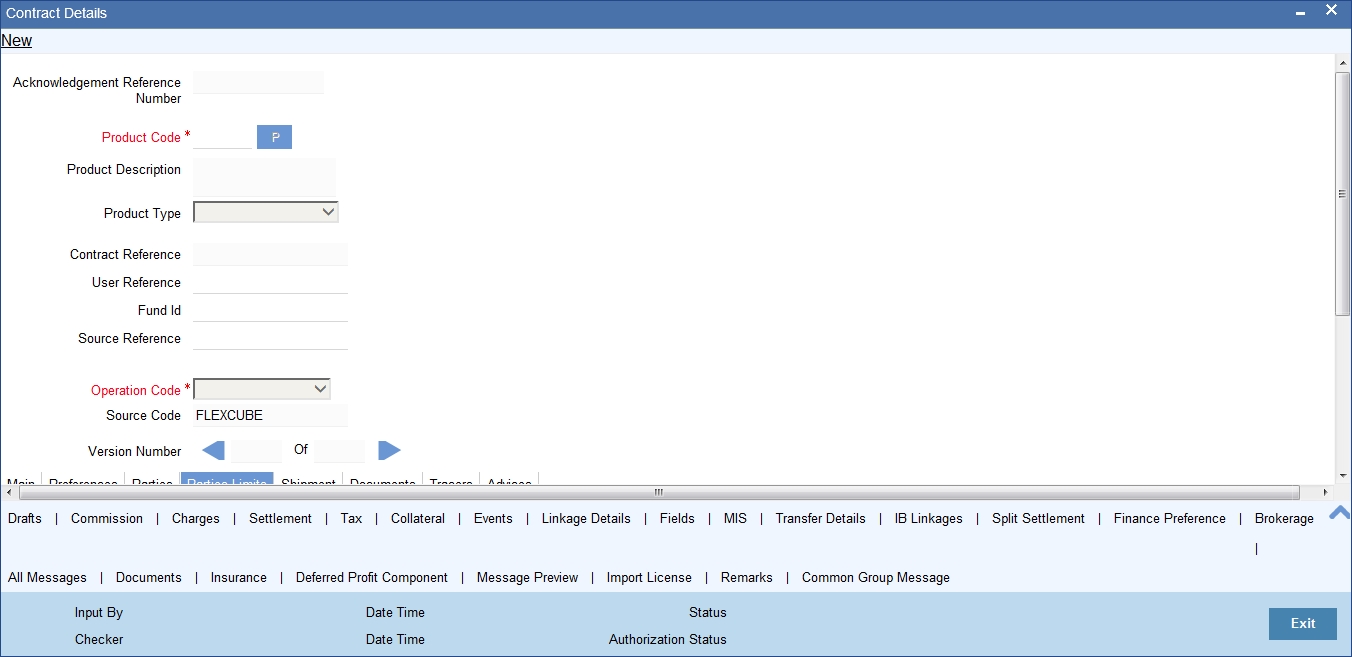

Oracle FLEXCUBE allows you to track the credit limits for joint venture customers who are parties to an Islamic LC contract. Using ‘Parties Limits’ tab, you can track the limits of multiple credit lines in an Islamic LC contract. Click ‘Parties Limit’ tab on ‘Islamic LC Contract Details’.
Specify the following details:
Limits Tracking Required
Check this box to indicate that limit tracking is required for the parties to the Islamic LC contract. If you check this box, the system will let you set the limits for multiple credit lines in the contract. If you do not check this box, the system will not track the parties’ limits.
On checking this box, the system enables ‘Default’ button. You can use this button to get the default values for the parties in the credit lines.
Limit Tracking Tenor Type
Choose the limit tracking tenor type from the following options:
Party Type
Specify the type of the party whose credit limits need to be tracked.
If you click ‘Default’ button, in the first row, the system defaults the joint venture party type based on the joint venture party selected under ‘Parties’ tab of ‘Islamic LC Contract Details’ screen. However, you need to make sure that the mandatory party details have been maintained under ‘Parties’ tab of the screen.
When you add another row to the list, you can manually select the party type as required. If you leave it blank, the system will automatically update the party type when you save the contract.
Customer No
Specify the customer number of the party whose credit limits need to be tracked. The option list displays the customer numbers of all the parties selected under ‘Parties’ tab. Choose the appropriate one.
You need to make sure that the customer number corresponds to the party type selected above. If the customer number and party type do not match, the system displays an error.
JV Parent
When you click ‘Default’ button, the system defaults the joint venture customer number of the party. This customer number is defaulted based on the details maintained in ‘Joint Venture’ sub-screen of ‘Customer Maintenance’ screen.
Liability Number
When you click ‘Default’ button, the system defaults the liability number from ‘Joint Venture’ sub-screen of ’Customer Maintenance’ screen.
Linkage Type
Specify the linkage type. The drop-down list displays the following options:
Linkage Reference No
Specify the reference number that identifies the facility, collateral pool or collateral. The option list displays all valid facilities and collateral pools specific to the liability. Choose the appropriate one.
In case you choose the same linkage reference for more than one record in the list, the system displays an override message. You may choose to cancel or proceed with the selection.
% Contribution
Specify the proportion of limits to be tracked for the credit line or collateral pool for the joint venture customer. When you click ‘Default’ button, the system defaults the percentage of contribution maintained under ‘Joint Venture’ sub-screen of ‘Customer Maintenance’ screen.
It is mandatory to indicate the percentage of contribution if the party is a customer under joint venture. This is not applicable to customers who are not a part of joint venture.
Note
For one joint venture, the total percentage of contribution in all applicable credit lines together cannot be more than 100%.
Amount Tag
Specify the amount tag. The system tracks the limits for non joint venture customers based on the amount tag. The amount tags applicable to export and import Islamic LC contracts are listed below:
Amount tags applicable to Export Islamic LC:
Amount tags applicable to Import Islamic LC:
Choose the appropriate one based on the type of Islamic LC contract. If you do not specify the amount tag, the system will track the limits based on the liability amount and facility.
For joint venture customers, you need to choose ‘Liability Amount’ as the amount tag. Other amount tags are not applicable to joint venture customers.
The system verifies the amount tag against the product type. If you choose an amount tag, which is not supported by the product type, the system displays an error message.
Amount
When you click ‘Default’ button, the system defaults the amount tracked for each credit line. In case of joint venture customers, the amount is derived on the basis of the percentage of liability amount. In case of other customers, the amount is derived based on the amount tag specified above.
You can add more rows to the list of credit lines using add button. Similarly, you can remove a selected row from the list using delete button.

An important part of processing an Islamic LC is the generation of various advices applicable for a contract.
The advices that can be generated for the events that occur during the lifecycle of an Islamic LC are defined for the product, to which the Islamic LC is linked. For example, you may have specified the following advices for a product:
The details of the advices for an event are displayed in the Advices screen. The party type to whom a specific advice should be sent is picked up automatically based on the type of Islamic LC being processed and the parties involved.
From the ‘Islamic LC Contract Details’ screen click on the ‘Advices’ tab. The advices screen is displayed. The advices defined for the event you are processing will be displayed. You can choose to suppress any of them. The address of the party to whom the advice is addressed to will be picked up by default, based on the media and address maintenance for the party.
These can be changed if required. For a payment message by SWIFT, you also have the option to change the priority of the message.
Suppress
By default, all the advices that have been defined for a product will be generated for the Islamic LCs involving it. If any of the advices are not applicable to the Islamic LC you are processing, you can suppress its generation by Checking against the suppress field.
Priority
For a payment message by SWIFT, you also have the option to change the priority of the message. By default, the priority of all advices is marked as Normal.
The priority of a payment message can be changed to one of the following:
Medium
The medium by which an advice will be transmitted and the corresponding address will be picked up based on the media and address maintenance for a customer.
You can, however, change either of these while processing the Islamic LC. Typically, if changed, both of them will be changed.
After selecting the advices to be generated for the Islamic LC, click on ‘Ok’ button to save it. Click on ‘Delete’ button to reject the inputs you have made. In either case, you will be taken to the Contract Main screen.

An Islamic LC, which is an instrument of trade finance, involves details of merchandise. Hence, you will need to specify the following details for the Islamic LC:
Click on the tab titled ‘Shipment’ to specify details of the goods and clauses that are part of the Islamic LC instrument.
You can also specify Preferences for the shipment of goods.
The following are the features of the Contract Ship screen:
There are certain standard clauses and conditions, associated with the shipment of the merchandise traded under an Islamic LC. You can specify the following shipping details for an Islamic LC that you process.
Partial Shipment Allowed
Check this option if partial shipment of the goods is allowed under the LC.
Trans Shipment Allowed
Check this option if Trans-shipment is allowed under the LC
From
The location from which the goods transacted under the LC should be shipped. In international trading parlance, this is called the Loading on board/Dispatch/Taking in charge at/from.
To
The destination to which the goods transacted under the LC should be sent. In international trading parlance, this is called the ‘For transportation’ to.
‘Shipment From’ and ‘Shipment To’ are linked to the tags 44A and 44 B respectively. These tags are applicable to the following message types:
Note
Specifying the ‘Shipment From’ and ‘Shipment To’ is optional.
Shipment Days
Specify the number of shipment days.
If you enter the shipment days and leave the field ‘Latest Shipment Date’ blank, on saving the contract, the system calculates the latest shipment date based on the number of shipment days and the effective date.
However, if you specify the latest shipment date, the system ignores the shipment days specified here. Instead, it recalculates the shipment days based on the latest shipment date and the effective date.
Specify the latest shipment date.
Besides these details, you can also specify shipping preferences like:
The details of the merchandise that will be traded under the Islamic LC should be clearly specified. You have maintained various codes that have been allotted, for commodities normally traded in your country. The commodities are available for selection in the form of an option-list. In addition, the list will also display whether a particular commodity is banned or not by indicating ‘YES’ (for a banned product) and ‘NO’ (for a product that is allowed for trade) against the product.
Goods Code
Specify the applicable code for the LC you are processing, from the list.
Description
The description of this code (which could be 6500 characters long), can be changed to suit the Islamic LC you are processing. You can also enter specifications such as the quality and quantity of the merchandise.
Description for Pre-advice
If pre-advice is one of the advices for the Islamic LC, you should enter the details of the Islamic LC briefly, as a pre-advice description. This will be a part of the pre-advice that is generated.
Typically, a pre-advice is sent by SWIFT or cable and contains brief details of the Islamic LC. This is be followed by the Islamic LC instrument, that contains all the details of the Islamic LC.
Specifying the Port Details
Port of Loading
Specify the name of the airport from where the goods transacted under the Islamic LC are loaded for shipping.
Port of Discharge
Specify the name of the destination port to which the goods transacted under Islamic LC should be sent.
Note
Port of Loading and ‘Port of Discharge’ are linked to the 44E and 44F tags respectively. These tags are applicable to the following message types:
It is not mandatory to specify the Port of Loading or Port of Discharge.
You can specify the documents that should accompany the goods in the ‘Documents’ tab. Click ‘Documents’ tab to specify details documents and clauses that are part of the Islamic LC instrument.
You can specify the following details:
There are some standard documents required under a documentary Islamic LC. In this screen you can specify the documents that are required under the Islamic LC being processed. These details will be a part of the Islamic LC instrument sent to the advising bank, the advice through bank or the beneficiary. All the documents specified for the product to which the Islamic LC is linked will be defaulted to this screen.
Code
Enter the document code.
Type
Enter the document type.
Description
Enter the document description of the document that is defaulted to suit the LC you are processing. This field will be enabled only if the LC type is ‘Shipping Guarantee’, but not mandatory.
During copy operation, the value of this field will not be copied to the new contract.
Reference
Enter the document reference number based on which the Shipping Guarantee issued.
Copy
Enter the number of copies of the document.
Originals
Enter the number of Original documents here.
Original Required
Enter the receipt details here.
You can add to or delete from the list of documents that are defaulted. To add a document for the Islamic LC, click on add button and then on option list positioned next to the Document Code field. Select the code of the appropriate document from the list of document codes maintained in the Documents Maintenance screen. The other details of the document will be defaulted to this screen.
To delete a document that is not required for the Islamic LC, highlight the document code and click on the delete button on the screen.
Specifying the Document Reference
For Shipping Guarantee type of Islamic LCs, you can specify the document reference based on which the Shipping Guarantee is issued in the ‘Doc reference’ field. This field will be enabled only if the Islamic LC type is ‘Shipping Guarantee’. However it is not mandatory to enter the document reference for ‘Shipping Guarantee’ contracts. Documents captured for a shipping guarantee contract, can exist with or without document reference.
In addition to the other details, the clauses specified for a document while defining the product, are also defaulted to this screen.
When you highlight a document code, all the clauses defined for the document are displayed in the Clauses window. You can add to or delete from, the list of clauses that are defaulted.
To add a clause to a document for the Islamic LC, click on the add button. Then, click on option list positioned next to the Clause Code field. Select the code of the applicable clause from the list of clause codes maintained, in the ‘Clause Maintenance’ screen. The description of the clause will be defaulted, based on the clause code that you select.
To delete a clause that is not required for the Islamic LC, highlight the Clause code and click on the delete button.

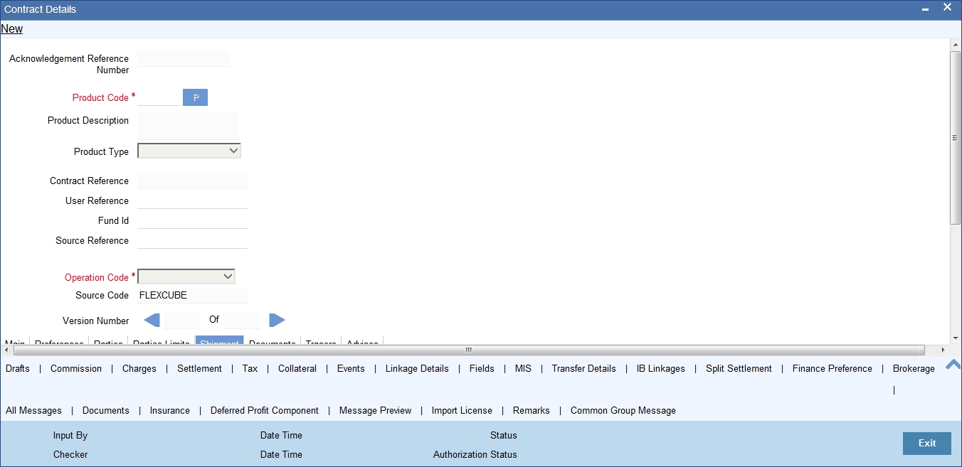

Through the settlement screens, you should specify the customer accounts to which entries for the commissions, charges, taxes and collateral should be posted.
Click on ‘Settlement’ button in the ‘Contract Main’ screen, for a display of the Settlements screen. Besides the account details, you can specify:
Note
If you have specified an account that uses an account class that is restricted for the product, an override is sought.
Fund Asset Management
The settlements processing is enabled only if ‘Allow Corporate Access’ has been checked while defining branch parameters in the Branch Parameters – Detail View screen.
Refer to the chapter titled ‘Making an Availment’ in this user manual for details.

The details of the charges that you can levy and the procedure for making them applicable to the Islamic LC you are processing has been detailed in the chapter titled Processing Charges on an Islamic LC.

If the Collateral Transfer Bridge option is selected in the ‘Letters of Credit Product – Preferences’, then the Collateral amount and currency input allowed on the ‘Bills - Contract Details’ screen are disabled.
You can enter the Collaterals to be transferred from the Islamic LC onto the bill in the COLLATERAL DETAILS screen. The decrease option is defaulted and will not be allowed to change. The amount entered here is displayed in the Bills – contract Details screen if the Collateral Transfer Bridge option is specified. The Collateral Currency is disabled for Bills under Islamic LC.
Once the collateral gets transferred from Islamic LC onto Bills contract, no further linkage of the collateral is maintained. Hence, subsequent to the linkage, further action on the bill will not back trace the collateral onto the Islamic LC.
Click Remarks button to view all the instructions captured on every transaction of the contract in ‘History of Remarks’ screen.
For more details on this screen refer to the section 6.18 titled ‘Remarks ‘in this user manual.
You can link an Islamic LC contract to deposits and accounts.
Type of linkage |
What it indicates |
Linking a deposit |
The entire Islamic LC amount, or a portion of it, can be linked to a deposit. The outstanding amount in the deposit should always be greater than or equal to the Islamic LC amount. You can link several Islamic LCs to the same deposit, provided sufficient funds are available in the deposit. |
Linking an account |
You can link the entire contract amount or a portion of it, to a savings or current account that is maintained with you. The available balance in the account should always be equal to or greater than the contract amount that is outstanding. You can link any number of contracts to an account provided a balance greater than or equal to the total outstanding contract amount(s) is available in the account. |
Note
Please note that the entire contract amount or a portion of it can be linked to any number of deposits or account or to both.
From the Islamic LC Contract Details screen, you can invoke the ‘Linkages Details’ screen by clicking ‘Linkage Details’ button. In this screen, you can specify any account/deposit with you, and indicate the funds that you would like to block.
Type
In the Contract Details screen, you can specify the type of linkage. The Islamic LC can be linked to a:
Linked to reference Number/ Account
If the Islamic LC is linked to a deposit, you should enter the Reference Number of the deposit. The deposit should be a valid contract in Oracle FLEXCUBE, with a Value Date that is earlier than or the same as the Value Date of the Islamic LC contract. The Maturity Date should be the same as, or later than that of the contract.
If the linkage is with an account, enter the account number to which you are linking the Islamic LC. The account you specify has to be a customer account (a Current account or a Savings Bank account). The currency of the deposit or account to which the Islamic LC is linked, is displayed once the linkage details are specified.
Exchange Rate
If the currency of the Islamic LC is different from the currency of the deposit or account to which it is being linked, the mid-rate for the day will be picked from the Exchange Rate table and displayed in the screen.
Linked Amount
In this screen, indicate the contract amount that has to be linked to the deposit or account. This amount can be the entire amount of the Islamic LC or a portion of it. The amount available for linkage, in the specified deposit or account, is arrived at, by taking into account other linkages and the uncollected and unauthorized balance (in the case of an account).
Once the linked amount is specified, the system will display the following amounts:
You can view the changes made in a specific version of an Islamic LC contract. To do this, navigate to the version of the contract that you would like to view in the ‘Contract Details’ screen. Click on ‘Change Log’ button on the ‘Contract Details’ screen.
The fields that were modified in the version will be displayed along with the old (inherited) and the changed values.
You can view the components which are transferable to BC in Oracle FLEXCUBE. Click ‘Deferred Profit Components’ button on the ‘Contract Details’ screen to invoke the ‘Deferred Components Details’ screen.
The system will display the deferred component details on this screen. You cannot enter or modify any details here.

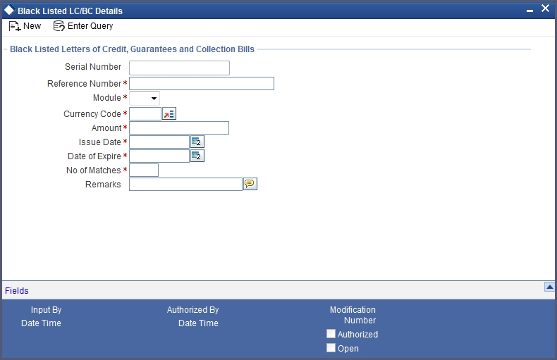

You can black list Islamic LCs and collection bills based on a set of criteria that you can define. You can define criteria for black listing Islamic LCs and bills in the ‘Black Listed Transaction Input’ screen invoked from the Application Browser. You can invoke ‘Black Listed Transaction Input’ screen by typing ‘TFDBKLST’ in the field at the top right corner of the Application tool bar and clicking the adjoining arrow button.
You can set up the following criteria for blacklisting Islamic LCs and Bills:
No of Matches
Now that you have set up the criteria for black listing contracts, you need to indicate the number of the above criteria that should be used to black list Islamic LCs and Bills.
For example, you indicate 2 in the field Number of Matches. All Islamic LCs/Bills that match atleast two of the blacklisting criteria that you specified will be displayed for blacklisting.
After you indicate the blacklisting criteria, click ‘Save’ icon from the tool bar to save the record. A message with the Reference Number of the Islamic LCs / Bills that matches the blacklisting criteria that you specified is displayed. You can choose to blacklist the contract or ignore the message.
If you enter a new Islamic LC/Bill that matches the blacklisting criteria, you will be prompted for an override. Similarly, if you attempt to amend the details of a blacklisted Islamic LC/Bill, you will be prompted with an override.

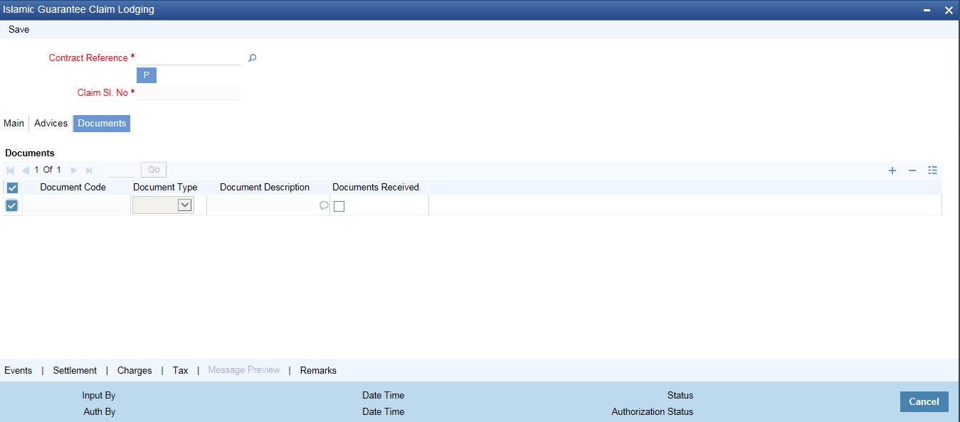

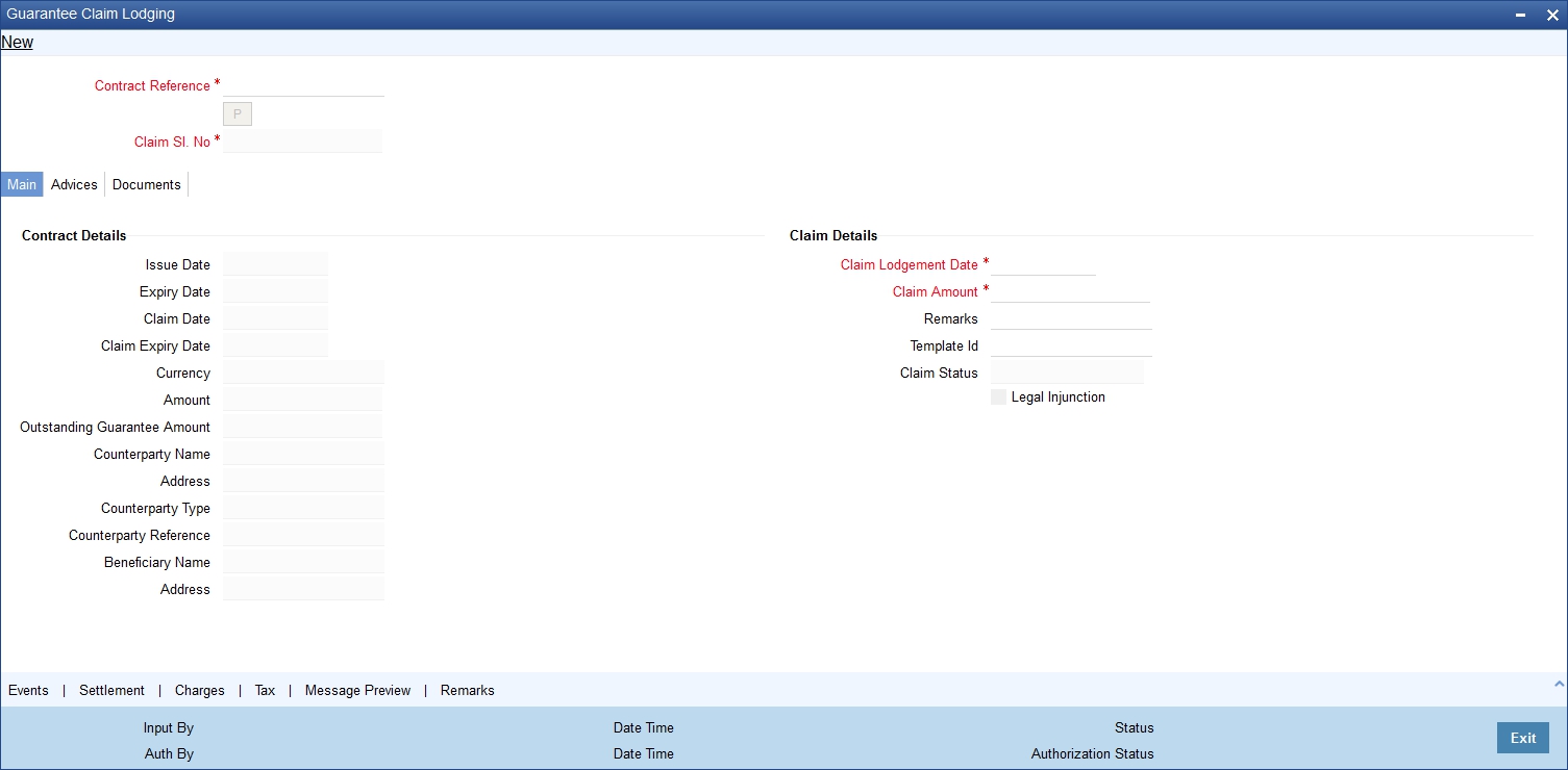

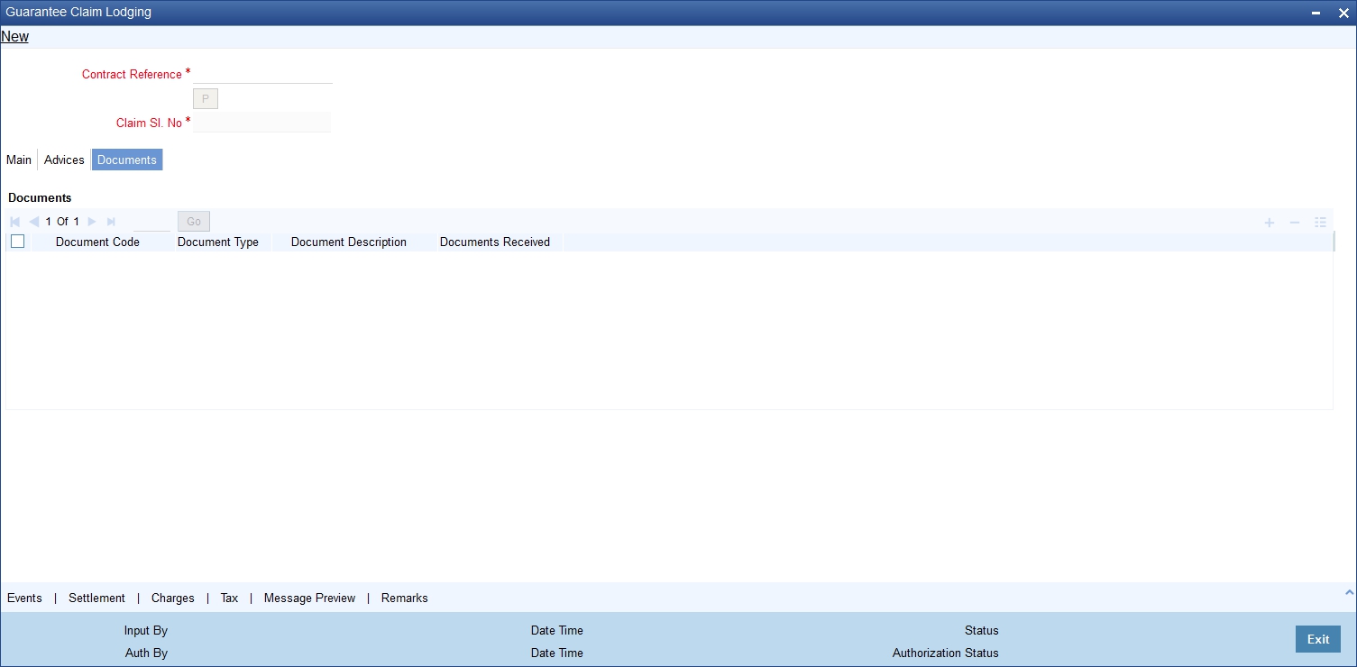

You can lodge claim on guarantee contract through ‘Islamic Guarantee Claim Lodging’ screen. You can invoke this screen by typing ‘LIDGCLM’ in the field at the top right corner of the Application tool bar and clicking the adjoining arrow button.
You can specify the following here:
Contract Reference
Select the guarantee contract reference number from the adjoining option list.
Claim Sl. No
The system displays the claim serial number.
The system displays the following contract details:
Claim Lodgement Date
Select the date on which claim is lodged.
Claims have to be lodged on or before Guarantee Claim Date. If claims are lodged after the Guarantee Claim date, system displays a configurable override error message.
Claim Date
The claim date should not be greater than the expiry date and the current business date of the system.
Note
If multiple claims are lodged against a contract and the claim date is same for all claims, then the system displays an override message.
Claim Amount
Specify the amount of the claim.
The claim amount should not be greater than the guarantee amount and the outstanding guarantee amount.
Claim Status
The status of the claim is displayed here. The statuses are as follows:
Legal Injunction
Check this box to indicate that there is a legal injunction received against the claim, to be captured during Claim Amendment.
Note
System triggers GCAM event and Claim Status is updated as 'Injunction Received'
Remarks
Specify remarks, if any.
Template Id
Select the template ID from the adjoining option list.Template ID is applicable only when the party type is applicant bank or issuing bank.
Note
The claim message is generated only if the template is selected.

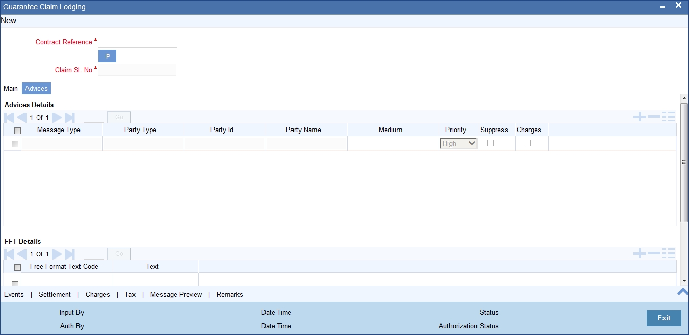

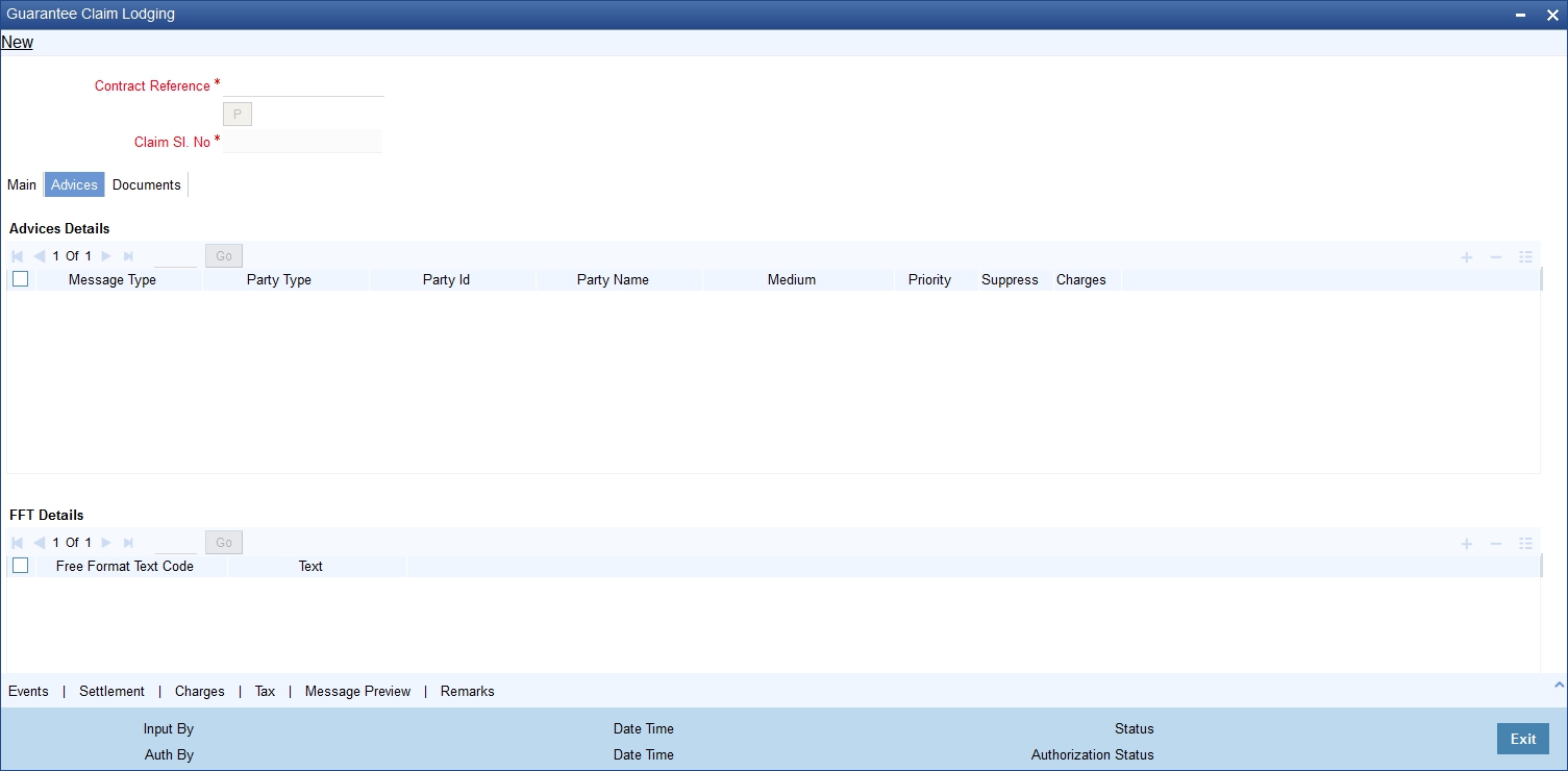

Click on the ‘Advices’ tab to capture the advise details.
Message Type
The system displays the message type of the advice generated.
Party Type
The system displays the party type for which the message is generated.
Party Id
The system displays the party ID for which the message is generated.
Party Name
The system displays the name of the party for which the advice is generated.
Medium
Select the medium through which the message has to be sent from the adjoining option list.
Priority
Select the priority of sending message from the adjoining drop-down list.
Suppress
Check this box to suppress the message.
Charges
The system displays the charges configured.
Free Format Text Code
Select the free format text code from the adjoining option list.
Text
The system displays a brief description on free format text.
Click on “Documents” tab to capture document details.
Documents captured during Guarantee Issuance are defaulted when claim is lodged
Document Code
The code of the document captured during guarantee issuance is defaulted here.
Document Type
The type of document captured during guarantee issuance is defaulted here.
Document Description
The description of the document is defaulted here.
Documents Received
Check this box to indicate that documents are received.
Click on ‘Event’ link of the ‘Islamic Guarantee Claim Lodging’ screen to view the event details.
The system displays the events, accounting entries and advices here.
Click on ‘Settlement’ link of the ‘Islamic Guarantee Claim Lodging’ screen to view the settlement details.
The system displays the settlement information for charges here.
Click on ‘Charges’ link of the ‘Islamic Guarantee Claim Lodging’ screen to view the charge details.
The system displays the charges configured for the event at product definition here.
For more details on the Charges Details screen, refer section ‘Contract Charge Details’ in Charges and Fees User Guide under Modularity.
Click on ‘Tax’ link of the ‘Islamic Guarantee Claim Lodging’ screen to view the tax details.
The system displays the details of the tax configured in the screen.
Click on ‘Preview Message’ link of the ‘Islamic Guarantee Claim Lodging’ screen to view the message details.
You can view the message or advice generated in the screen.
For more details on this screen, refer Capturing Additional Details chapter in this user manual.
For more details on this screen refer to the section ‘Remarks ‘in this user manual.

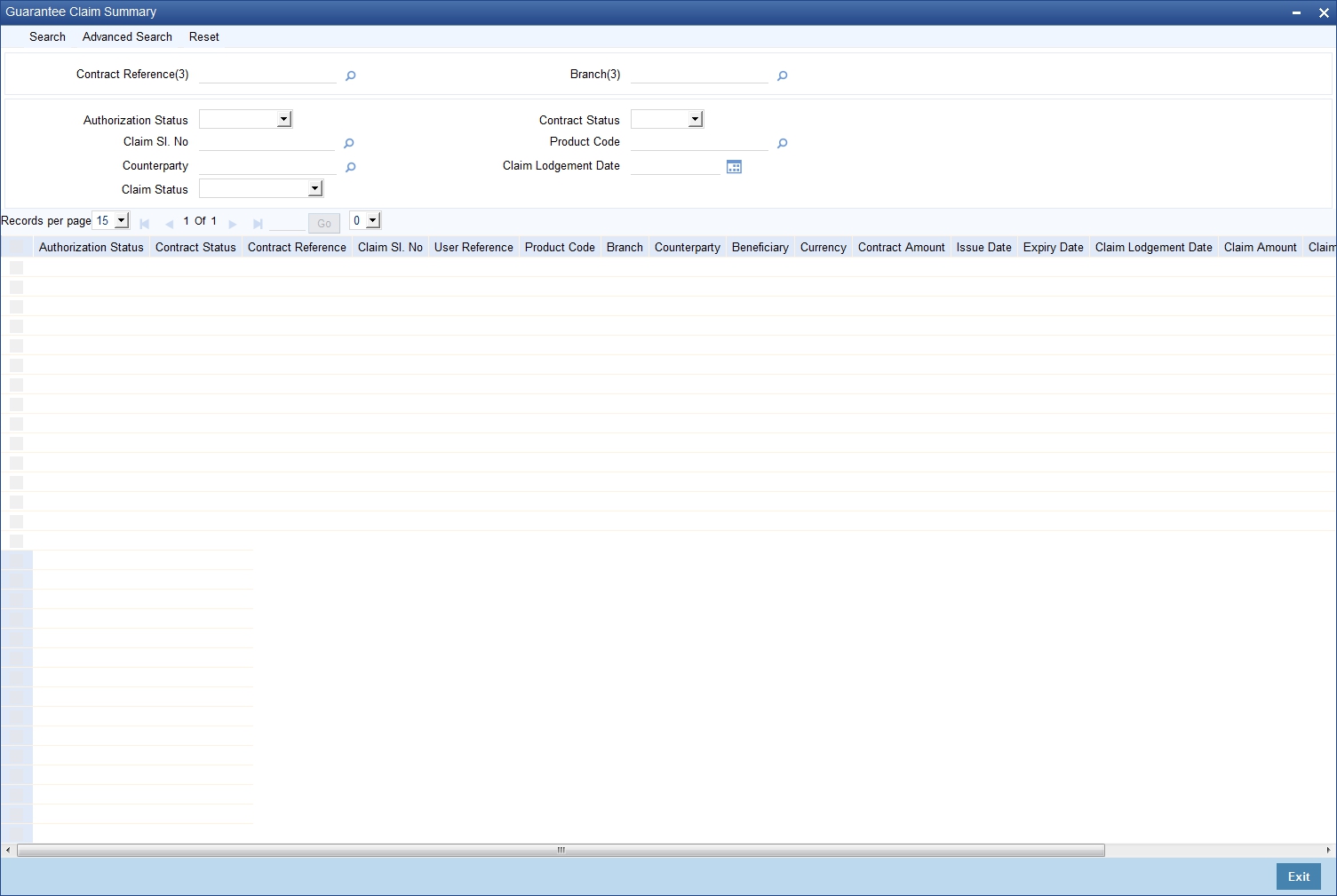

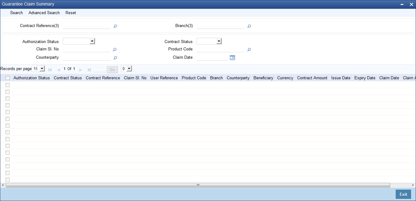

You can view the guarantee claim details maintained in the ‘Islamic Guarantee Claim Lodging’ screen using the ‘Islamic Guarantee Claim Summary’ screen. You can invoke this screen by typing ‘LISGCLM’ in the field at the top right corner of the Application tool bar and clicking on the adjoining arrow button.
In the above screen, you can base your queries on any or all of the following parameters and fetch records:
Select any or all of the above parameters for a query and click ‘Search’ button. The system displays the following records meeting the selected criteria:
This section contains the following details:
You can settle guarantee claims using the ‘Guarantee Claim Settlement’ screen. Claims have to be settled in the sequence it is lodged. All claims in Lodged Status will be available for settlement.
You can invoke the ‘Guarantee Claim Settlement’ screen by typing ‘LIDGCLP’ in the field at the top right corner of the Application tool bar and clicking the adjoining arrow button. Click New icon.
The following details are captured here:
Contract Reference
Specify the Guarantee contract Reference against which the claim is received by the bank and settlement needs to be done. Alternatively you can also select the contract reference from the drop-down list. The list displays only claims for which the status is ‘Lodged’.
Claim Serial No
Specify the claim serial no. for which settlement needs to be done.System validates that the entered unsettled claim is as per the sequential order of lodgement and status of the claim is ‘Lodged’.
Issue Date
System defaults the contract issue date here.
Expiry Date
System defaults the contract expiry date here.
Claim Date
System defaults the guarantee claim date here.
Claim Expiry Date
System defaults the guarantee claim expiry date here.
Currency
System defaults the guarantee currency here.
Amount
System defaults the guarantee amount here.
Outstanding Guarantee Amount
System defaults the outstanding guarantee amount here.
Counterparty Name
System defaults the name of the counterparty here.
Address
System defaults the address of the counterparty here.
Counterparty Type
System defaults the party type of the counterparty here.
Counterparty Reference
System defaults the reference no. of the counterparty here.
Beneficiary Name
System defaults the name of the beneficiary here.
Address
System defaults the address of the beneficiary here.
System defaults the date of claim lodged.
Claim Amount
System defaults the claim payment amount as claim amount.
Remarks
Enter remarks if any for the claim.
Template ID
System defaults the template id of the claim lodged.
Claim Status
System defaults the status of the claim lodged.
Collateral Funding By Loan:
Check this box to indicate if collateral needs to be utilised for claim settlement.
Claim Payment Date
System defaults the claim payment date here.
Claim Payment Amount
System defaults the claim payment amount here.
Remarks
Enter remarks if any for claim payment.
Finance for Claim Settlement
System defaults the value maintained at product level. You can check/un-check this box to indicate that finance needs to be created or not for this claim settlement.

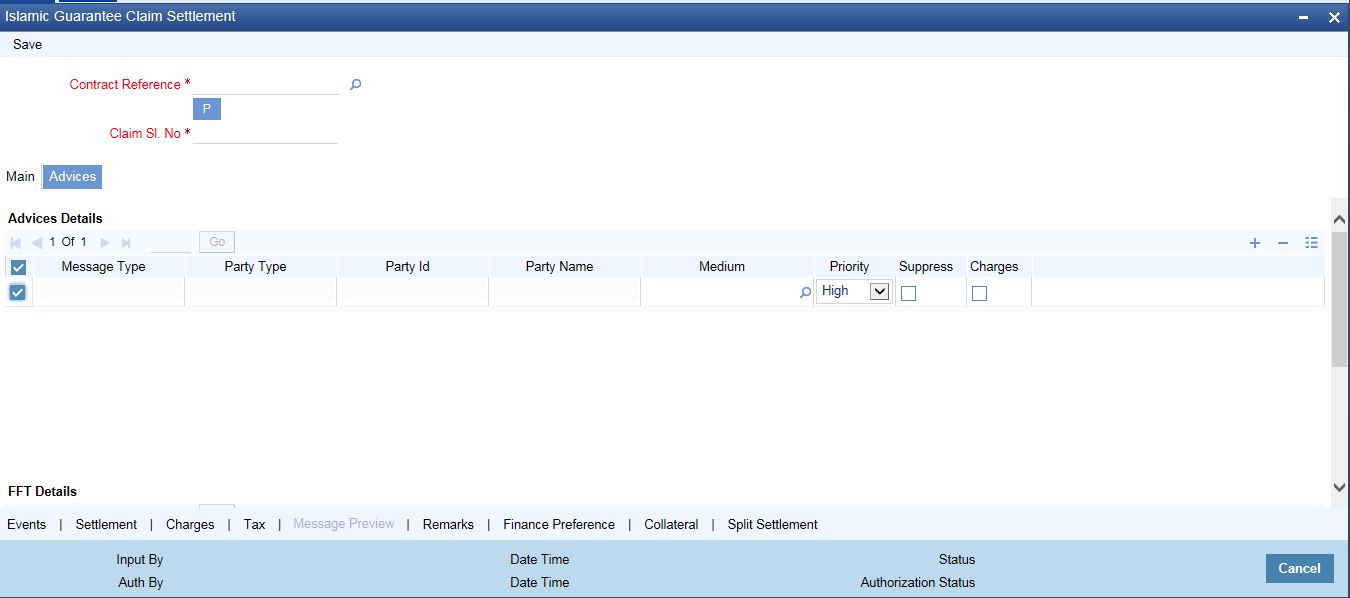

Message Type
System displays the message type of the message/advice generated.
Party Type
System displays the party type for which the message/advice is generated.
Party ID
System displays the party id for which the message/advice is generated.
Party Name
System displays the party name for which the message/advice is generated.
Medium
System defaults the medium in which the message has to be sent for the party. You can modify this.
Priority
System defaults the priority value of sending the message maintained at product level. You can modify this.
Suppress
Charges
System displays the charges for the claim.
Specify the free format text code.
Text
Specify the free format text here.
The details for the following subsystems are defaulted from LC contract level.
Guarantee Collateral will be utilized proportionately for claim settlement and customer available balance will be utilized for the remaining amount. In case of inadequate funds in customer account, finance can be created for the remaining amount. On Save, Loan is created and the generated Loan Reference Number is made available in Linkages Subsystem.

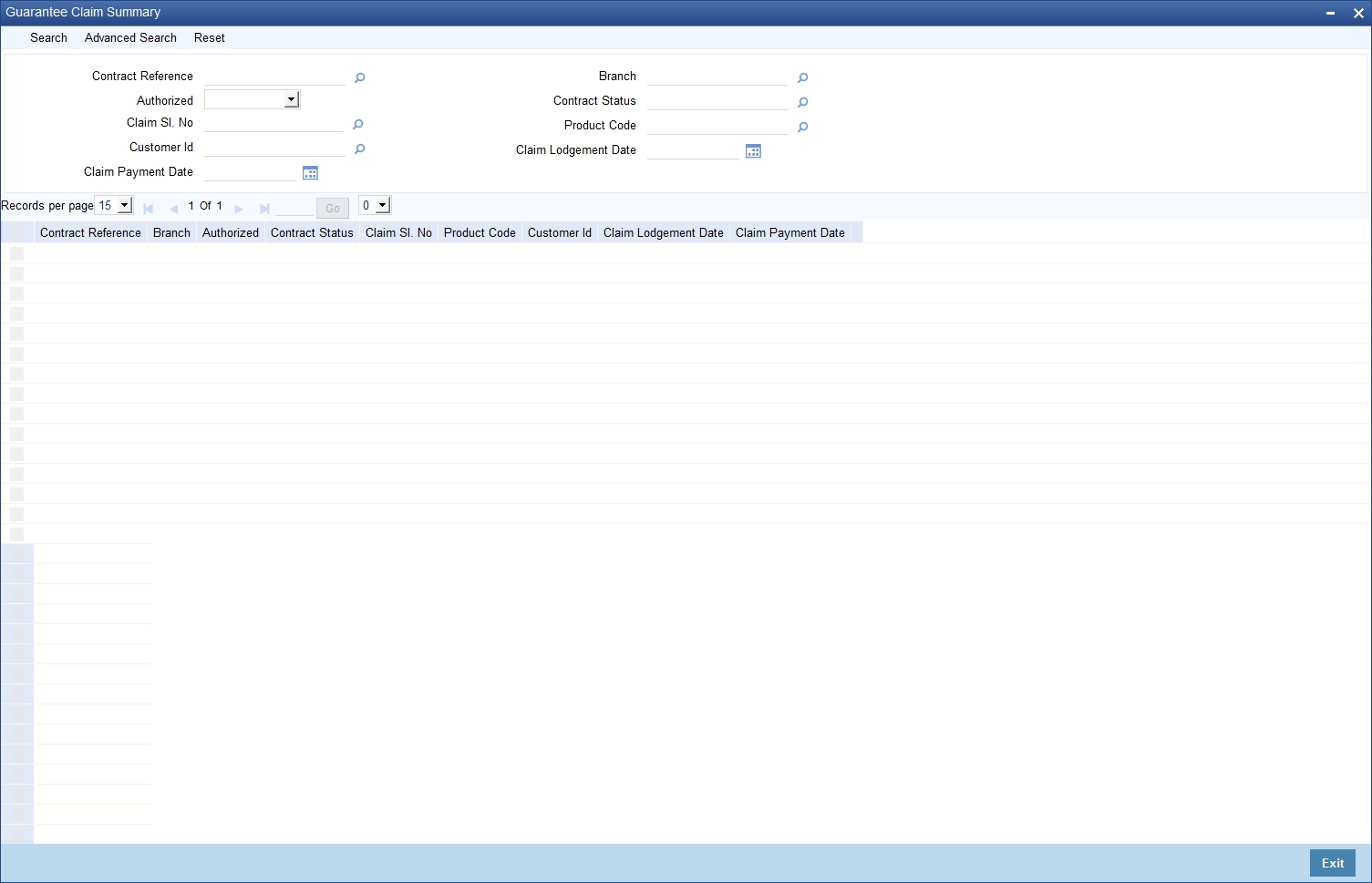

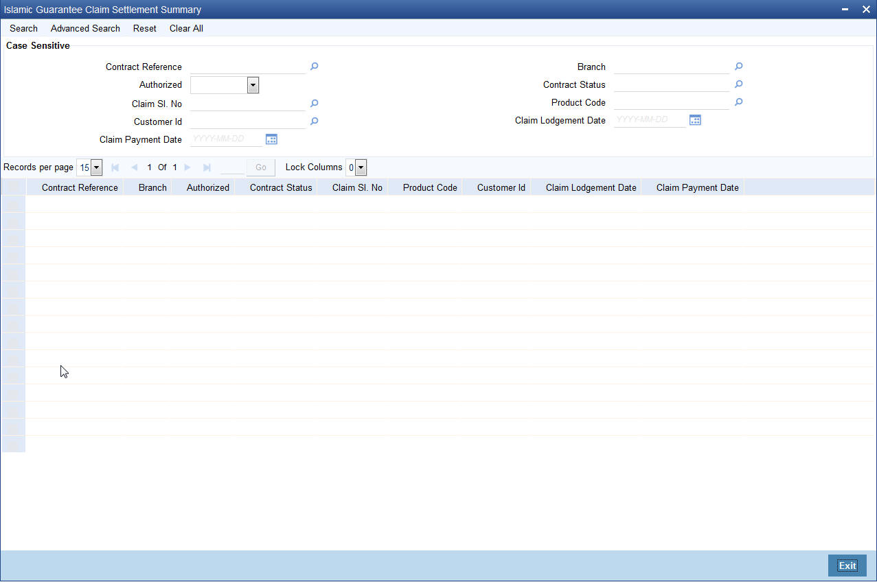

You can view the guarantee claim settlement details maintained in the ‘Guarantee Claim Settlement’ screen using the ‘Guarantee Claim Settlement Summary’ screen. You can invoke this screen by typing ‘LISGCLP’ in the field at the top right corner of the Application tool bar and clicking on the adjoining arrow button.
Select any or all of the above parameters for a query and click ‘Search’ button. The system displays records meeting the selected criteria and the following details of the records will be displayed:
