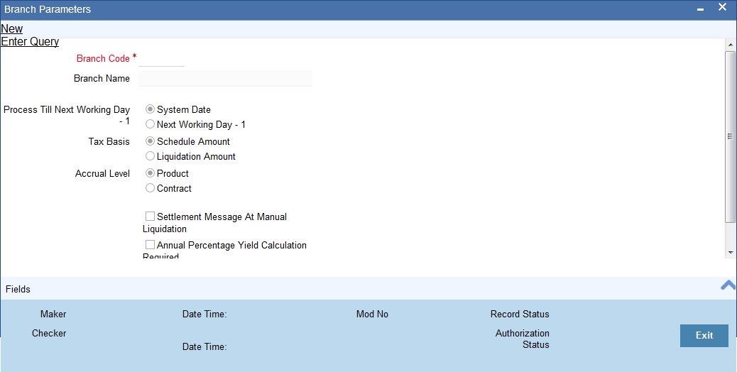

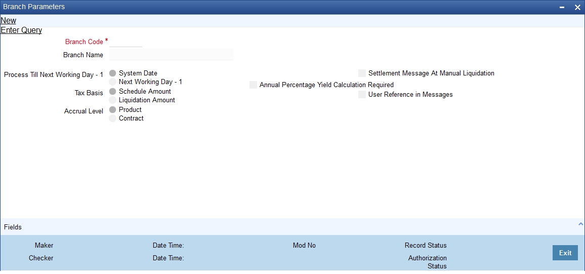

8.2 Specifying Branch Parameters
A set of rules that govern the deals that a particular branch (of your bank) enters into are defined through the Branch Parameters screen.
System Date
If you specify that processing of automatic events should be done upto the System Date, automatic events scheduled till (inclusive of) the current system date will be processed.
Assume today is October 20, 1997, and October 21, 1997 and 22 October 1997 are holidays. If you specify that processing has to be done till the system date, during the Automatic Batch Update function run, the system will process only the events scheduled for October 20, 1997.
The events scheduled for the holidays, that is, October 21, 1997 and October 22, 1997 will be processed during the Automatic Batch Update function run during beginning of day operations on October 23, 1997.
Next Working Day - 1
You can indicate whether events should be processed till the day before the next working day, when the Automatic Batch Update function is run. If you do so, all the events that fall on days between the current system date and the next working date will be processed.
Assume that today is October 20, 1997, and October 21, 1997 and October 22, 1997 are holidays. If you specify that processing has to be done till the day before the next working day, when you run the Automatic Batch Update function during end of day processing on October 20, 1997, all the events scheduled for October 21, 1997 and October 22, 1997 will be processed.
Tax Basis
On a deal, you may have to pay tax to the Government on the profit earned. The tax can be paid on the basis of the following:
For your branch, you can specify the amount on which tax has to be applied, in the Branch Parameters screen. The following example illustrates how this works.
Accrual Level
To recall, at the time of creating a product, you specify
A Murabaha MM deal will inherit the accrual frequency defined for the product associated with it.
Since the accounts (the accrual account and the income account) are defined for a product, the accrual entries for all deals involving the product will be passed to the same accounts.
These entries can be passed in two ways:
The idea of generating a single entry for all deals involving a product is to reduce the number of entries and thus, the processing time. The details of entries passed for each deal will be available in the Accrual Control Journal, a report that should be generated after the accruals have been made.
Whether profit accrual entries are passed as a single consolidated entry for a product, or as an individual entry for each deal, should be specified for a branch.
Note
This specification is applicable only for automatic periodic accrual entries. When there is an accrual necessitated by a payment or a change in the terms of a deal, the entries will be for the specific deals affected by the change.
Residual Amount
The value that you specify (as the residual amount) indicates the limit for the residual balance when a placement with zero principal balance, but with other outstanding components can be automatically liquidated.
The residual amount (profit, commission, or fees) will be checked against the amount that you specify. The placement will be liquidated only if the pending components are individually less than or equal to the amount specified.
Note
The amount that you specify as the residual amount is expressed in local currency. For placements in foreign currencies, the standard exchange rate will be picked up from the Exchange Rate Table. The exchange rate that is used for conversion is defined for the product the deal involves.
While automatically liquidating the placement, the outstanding amounts will be reversed to the accounts to which the accruals have been booked. These amounts are however retained in the corresponding fields for information purposes.
The following are the maximum limits accepted:
Enter ‘0’ if you do not wish to allow residual amounts. This means that all the components should have zero balances for the placement to be marked as liquidated.
When this amount is increased or decreased, all placement meeting the conditions will be liquidated during the next Automatic Batch Update.
Residual TXN Cd
This is the transaction code for the accounting entries to be passed when the residual amount is liquidated.
User Ref. No. in Messages
If this option is checked then the user reference number will be used instead of the contract reference number in the following messages.
8.2.1 Confirmation Messages
SWIFT
Mail
8.2.2 Account Statement
If the ‘User Ref No. in messages’ option is checked in the ‘MM Branch Parameter’ screen then in the Field 61(statement line) the user ref no would be populated in sub field 8 account servicing institution's ref no. If it is left unchecked, then it will be picked up from the child contract reference number.
