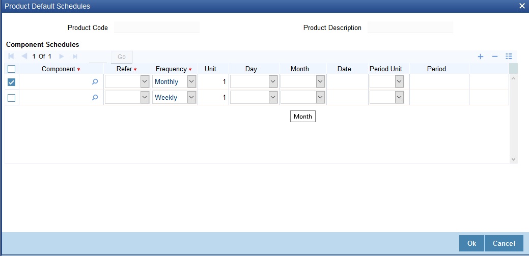

You can define schedules for each component for the product through the Product Default Schedules screen. This involves specifying the reference date, the frequency, the month and date for each component.
5.3 Features of the Product Default Schedules Screen
When creating a product (in the Product Default Schedules screen), you can define schedules for all deal components. This involves specifying the reference date, the month and the date for each component etc. All deals, involving the product, will acquire these attributes.
The system generates multiple schedules for principal schedule as per the maintenance and the interest is calculated based on the principal due.
The multiple partial payment of principal component is possible only if MULTI_SCH_PRIN is installed. You can check it through the CSDFEMNT screen.
Component Schedules
Component
You can define different repayment schedules for the different components according to your needs. First of all, you should specify the component for which you want to define the schedule. All components − the principal and any other component depending upon your ICCF definition for the deal − are available in the adjoining option list. You will have to define schedules for each of them.
When defining repayment schedules for specific deals, the amounts for components like interest, commission, and fee will be calculated by the system automatically, depending on the repayment date and amount of the principal. However, for deals with special interest, you will also have to provide the interest amount.
Refer
Indicate whether the dates of repayment schedules should be calculated based on the Value Date (date of initiation of the deal) of the deal involving the product, or a Calendar Date. If you specify that the Reference is the Value Date (date of initiation of the money market deal), the dates for schedule repayments will be based on this date and the Frequency.
If the Reference is specified as the Calendar Date, the dates for schedule repayments will be based on the Start Date (specified by you), the Month and the Frequency. The following example illustrates this concept.
If Reference is set to Value Date (deal initiation date), you need to specify only the Frequency (monthly, quarterly etc.) and the unit of frequency (if you specify the frequency as weekly and the unit as 1, it means once a week). The system will set the schedule according to the Frequency and Unit of Frequency you have specified, beginning on the Value Date.
Frequency
You can have multiple schedules for payment of partial principal component.The list displays the following frequencies:
The frequency is based on the requirements and the units should be 1.
By default, the frequency will be Bullet, meaning all the repayments will be made on maturity. If the frequency is defined as Bullet, you cannot enter a value into the subsequent fields.
Unit
You can specify the number of units for the frequency you have set for a particular component.
For example, if you want a payment every 15 days, you will have to specify
For payments every three weeks, you will have to define
Day
If you have set the Reference as Calendar Date and the frequency as weekly, quarterly, half-yearly or annual indicate the day on which the first schedule falls due. Based on this, the subsequent schedule dates will be calculated.
Month
If you have set the Reference as Calendar Date and the frequency as weekly, quarterly, half-yearly or annual indicate the month in which the first schedule falls due. Based on this, the subsequent schedule dates will be calculated.
Date
If you have set the Reference as Calendar Date, you should indicate the date on which the schedule should fall due. Specify 31 to indicate that the schedule should fall due on the last day of the month (that is, 31 for months with 31 days, 30 for months with 30 days and 28 or 29, for February).
The schedule repayment dates will be computed using the Frequency, (Start) Month and the (Start) Date.
A schedule date:
Period Unit
You need to specify the unit for the interest period. The available options are as follows:

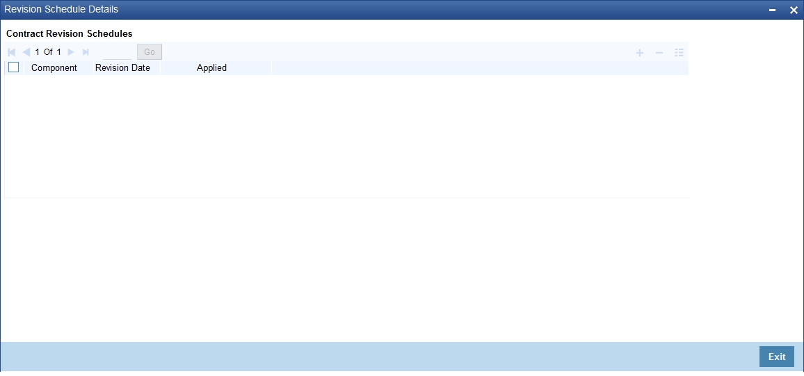

5.7.1 Interest Rate Revision Schedule
A Floating Rate Table - that contains the market rates for the day − is maintained in the ICCF sub-system so that the latest rates can be applied to deals.
The market rates vary on a daily basis and are maintained in this table. The rates can be applied either every time they change or at periodic intervals. Usually, for Money Market deals, floating rates are applied, i.e., the latest market rate is applied (see the section on Specifying Rate Code Usage in the chapter ‘Processing Interest, Charge and Fee’). You can also apply these rates on a periodic basis so that you are in tune with the market rates (as opposed to fixed interest rates which remain the same for the entire period of the deal), and at the same time you do not have to apply the market rates on a daily basis.
You can specify whether the latest market rates have to be applied every time they change, or if they have to be applied periodically, by defining an attribute called the Rate Code Usage through the Product ICCF Details screen for a floating interest type. If you specify ‘auto’ rate code usage, all the rate changes made during the liquidation or accrual period will be considered. If you specify ‘periodic’ rate code usage, the rates will be periodically refreshed and the rates as of a specific frequency, or date, will be applied.
For a deal that has been defined with Periodic Interest that has to be applied at periodic intervals, you can specify the following:
5.7.2 Specifying the Rate Revision Frequency
In the MM Contract Schedules screen, select the component, for which the Rate Revision frequency has to be, defined (say INTEREST1). Select the Type as 'R' (Revision), then enter your specifications in the frequency (it could be daily, weekly, etc.), the number, and unit fields. Also give the Start Date on which the first revision has to take place.
For example, if you specify the frequency, as weekly, the revision will take place every week beginning on the Start Date that you have specified.
5.7.3 Specifying the Rate Revision Dates
Revision frequency has to be defined (say INTEREST1).
Then, instead of specifying the other schedule details like the frequency, the number and unit, indicate the date in the Start Date field. The rate revision will be done on that date.

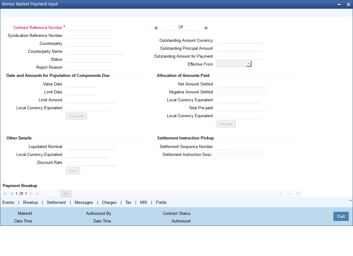

5.9 Viewing Schedule Details
When you click on the 'Default' button in Schedules tab, you will see the ‘Payment Schedule Details’ screen. Here you can view the details of the schedules for a particular deal.

5.10 Viewing Revision Schedule Details
When you click on the Revision Details sub screen you will see the ‘Revision Schedule Details’ screen. Here you can view the details of the revision schedules for a particular deal.
In this screen you can see the following details for the component:
5.11 Making Manual Payments
The various components in a deal can be liquidated either automatically or manually. The mode of liquidation of each component is specified at the time of defining a product and then again, at the time of deal processing. An automatic liquidation is done on schedule payment days by the Automatic Contract Update program.
Even if you have defined a deal with automatic liquidation, you can liquidate it manually a day before the schedule date. However, payment will not be allowed if the Rollover Instruction Status for the contract is ‘Complete’.
You can invoke the ‘Money Market Payment Input’ screen from the Application Browser by typing ‘MMDPAMIN’ in the field at the top right corner of the Application tool bar and clicking the adjoining arrow button.
You can do the following operations the manual payments function:
The manual payments made through this function can be:
The value date you have entered will be used for all the entries generated by the system.
5.11.1 Input of Manual Payments
Once you enter the deal reference number in the Contract Schedule Payments you will see the following details displayed on the screen:
The Value Date here, is the date on which the liquidation entries will be passed. When you enter a Value Date in this screen, if there are any payments due on that date, they will be displayed and you can liquidate them.
If there are no schedules due on that date, the schedule becomes a prepayment. But this is only if the Value Date is not a back valued date. You can have a back valued date but it cannot be earlier than the last schedule that was due. (You can also liquidate back valued schedules by entering a Limit amount).
If the Value Date is today or a date in the future, the prepayment is processed.
The Payment Limit Date or Amount of the payment should be given at the time of payment. If you have given a payment limit date, the system shows all the components, which are due till the limit date. If you have given the amount limit in the Amount field, it shows all the schedules for the limit amount.
Note
While the Prepayment Limit Date is used to pick up the schedules pending as of that date, the Value Date is taken into account by the system for passing accounting entries.
Alternatively, the system picks up a schedule according to the amount being paid. You will see the next schedule, which is due, within the limit of this amount. If the amount being paid is more than the total amount payable for the next schedule, the next schedule will be considered. The total amount due for these schedules is displayed.
You have to enter the actual amount being paid in the Net Amount Settled field. If there are both positive and negative amount to be settled, then the net amount should be specified here. This amount can either be allocated to the various components manually, by entering the break up of the amount against the various components, or automatically by clicking the Allocate button. The total negative amount that should be settled is displayed in Negative Amount Settled field. Partial payment of negative amount is restricted. Back dated payment of interest amount is allowed till last payment date or amendment date, whichever date occurs later.
The automatic allocation is done based on the Liquidation order you have defined for the product. If you have not specified the order of liquidation for the principal and the interest type of components, the amount will be allocated for liquidation in the following order:
Note
If a payment that covers both past and future schedules is made, the system will force you to pay out the past schedules before the future schedules are paid. If an ICCF component is based on the outstanding principal you will not be able to make a payment where the amount is more than what is due for the component as of the system date.
In the Contract Schedule payment screen, you have a set of icons using which you can navigate to the following screens:
‘Settlements’ - Click to go to the Settlement Message Details screen
‘Tax’ - Click to see the Tax details screen
‘Advices’ - Click to see the Advices screen. You can suppress advices using this screen.
‘Breakup’ - Click to view the Schedule Breakup screen.
‘Events’ - Click to view the Events screen.
Settlement Sequence Number
Choose a settlement instruction by specifying a settlement sequence number. You can skip this field if any default settlement instruction is already provided.
Note
At the time of specifying settlement instructions, it is now possible to choose from multiple instructions that are maintained for the same branch, customer, currency, module and product combinations. You can choose any settlement instruction from a list of values. The list of values displays the Settlement Sequence Number and Settlement Instruction De­scription.
Settlement Instruction Description
