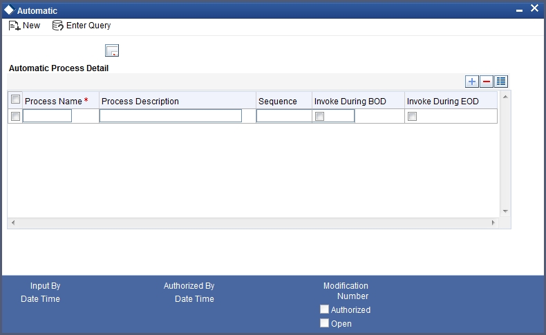

You have the facility to configure the batch processes to be executed either at EOD or BOD or both, as per the bank’s requirement. This is achieved through the ‘Automatic Process Definition’ screen. You can invoke this screen by typing ‘CLDTPROC’ in the field at the top right corner of the Application tool bar and clicking on the adjoining arrow button.
In this screen, you can amend the order of the various operations in the Mortgage batch and choose to trigger them at EOD or BOD or both.
The default configuration is given below:
Batch Operation
BOD/EOD
Forward Init of Mortgage Accounts
BOD
Calculation
EOD/BOD
Accruals
EOD/BOD
Auto Liquidations
EOD/BOD
Auto Disbursements
BOD
Rate Revisions
BOD
UDE Cascade
EOD
Maturity processing – Rollovers , Auto Closures
BOD/EOD
Automatic Status Change Processing
BOD
FEES
BOD
INTP (Interest Posting)
BOD
Billing & Payment Notices
BOD
Statements generation
EOD
Penalty Computation
BOD
Forward VAMIs
BOD
Revaluation
EOD
Readjustment
EOD
These batch processes are factory shipped for your bank. Note that you need to set the ‘UDBATEVT’ batch as a predecessor to the Mortgages batch ‘MODBATCH’.

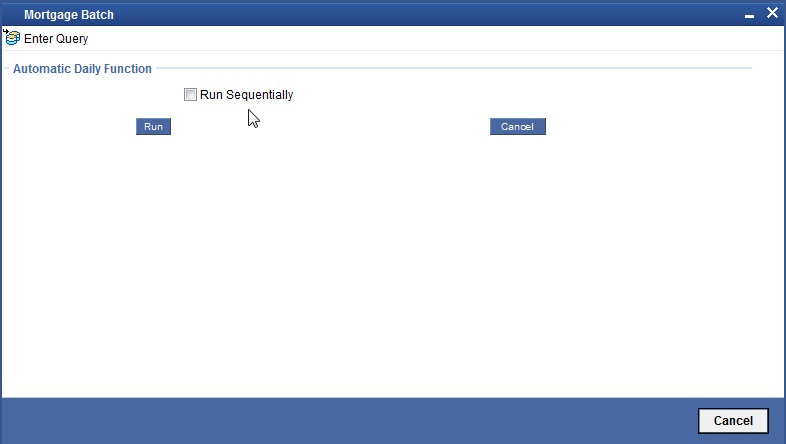

10.1.3 Initiating the Batch Process
If you have opted to trigger the Mortgage batch programs at EOD, the same will be executed as part of the ‘End of Cycle Operations’ after marking the ‘EOTI’ for the day. If the trigger is maintained as ‘BOD’, the programs will be executed before the start of ‘Transaction Input’. However, the programs will be triggered both at EOD and BOD if you opt to trigger it at both the instances.
You also have the option to execute the batch programs through the ‘Mortgage Batch’ screen. You can also invoke this screen by typing ‘MODBATCH’ in the field at the top right corner of the Application tool bar and clicking on the adjoining arrow button.
Run Sequentially
Check this box to opt to execute the processes as per the sequence maintained in the ‘Automatic Process Definition’ screen.
Click ‘Run’ button to run the batch process. Click ‘Cancel’ button to cancel the batch execution.
For the accounts wherein notary confirmation is required and yet to be received, the system will check if NCON event has been triggered or not, before initiating the mortgage. For accounts wherein confirmation has been received before mortgage creation, the system will trigger initiation and disbursement without any check of the NCON event.

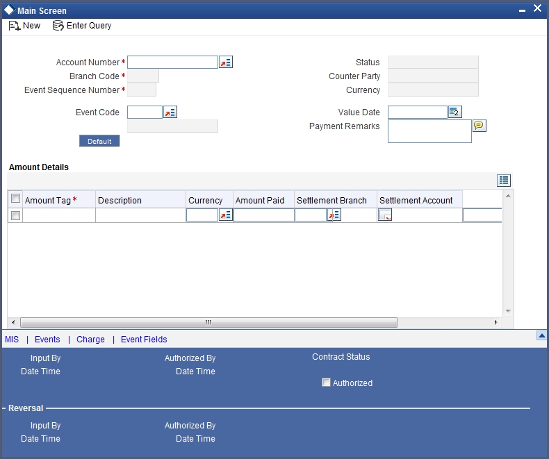

You can use the ‘CL User Defined Events Triggering’ screen to manually trigger the user defined events for mortgage accounts. You can this screen by typing ‘UDDCLEVT’ in the field at the top right corner of the Application tool bar and clicking on the adjoining arrow button.
Here you need to specify the following details:
Account Number
Specify the account for which you want to trigger the user defined event. The adjoining option list displays all valid account numbers available in the system. You can select the appropriate one.
Branch Code
The system displays the code of the branch where the account resides.
Click ‘Default’ button. The system fetches values for the following fields based on the selected contract and displays them:
Event Sequence Number
The system displays the event sequence number.
Event Code
Specify the event that needs to be triggered for the selected account. The adjoining option list displays all events linked to the account. You can select the appropriate one.
Value Date
If the value date derivation rule has been maintained for the event code, the system will calculate the value date and display it here. However, you can change it.
Payment Remarks
Specify remarks pertaining to the payment on the account.
Amount Details
Specify the following details.
Amount Tag
The amount tag is displayed based on the product-level maintenance of the specified account.
Description
The system displays a brief description of the amount tag.
Currency
If a derivation rule has been maintained for the event code, the system will derive the currency as per the rule and display it here. However, you can change it.
Amount Paid
If a derivation rule has been maintained for the event code, the system will derive the amount as per the rule and display it here.
Settlement Branch
Specify the branch where the settlement account resides. The adjoining option list displays all valid branch codes maintained in the system. You can select the appropriate one. Alternatively, if you have specified the settlement account, the system will display the corresponding branch code here.
Settlement Account
Specify the account that should be debited or credited. The adjoining option list displays all valid accounts maintained in the system. If you have specified the settlement branch, the option list will display all accounts available in that branch. You can select the appropriate one.

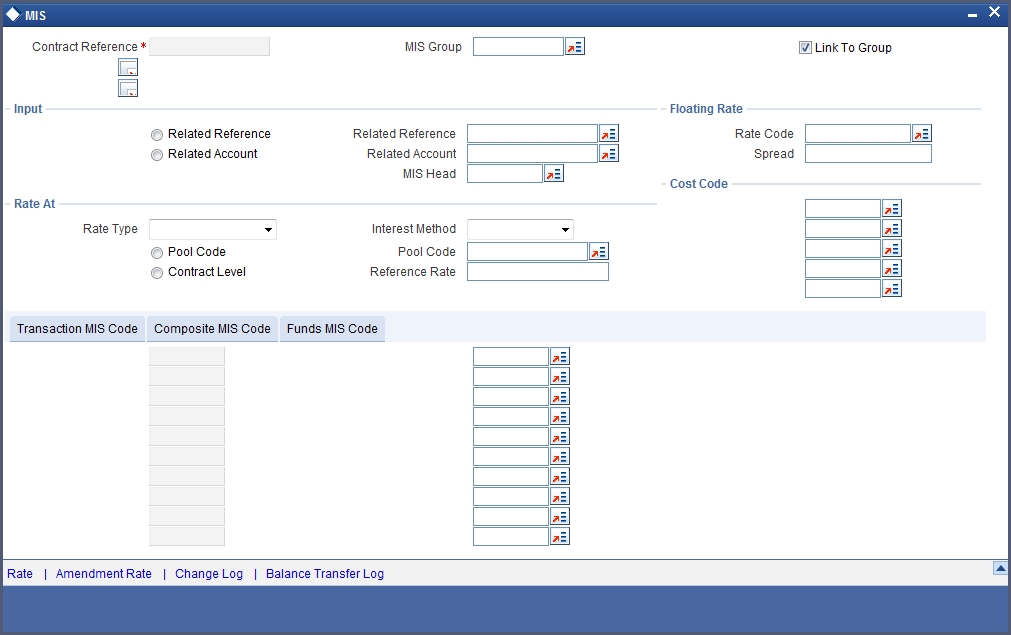

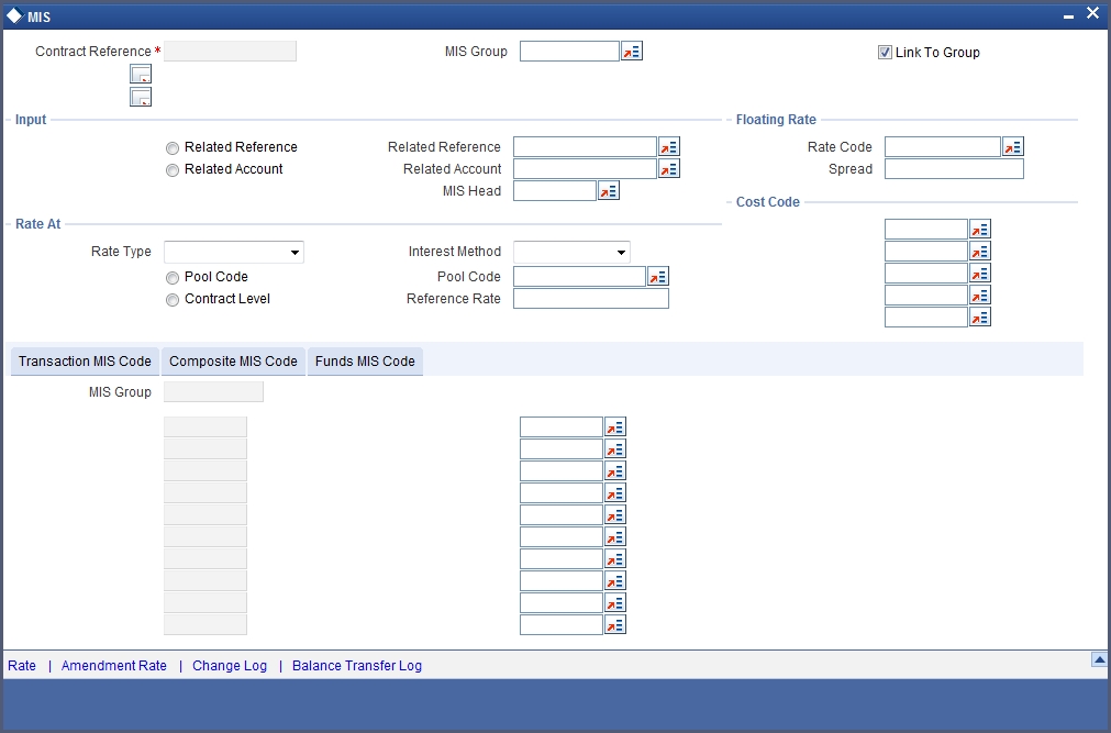

10.2.2 Viewing MIS Details
Click ‘MIS’ button the screen and invoke the ‘MIS’ screen.
You can view the following details:
The ‘Transaction MIS’ tab opens by default.
Here you can view the transaction MIS codes.
10.2.2.1 Composite MIS Code Tab
Click this tab to view composite MIS codes.
10.2.2.2 Fund MIS Tab
Click this tab to view fund MIS codes.

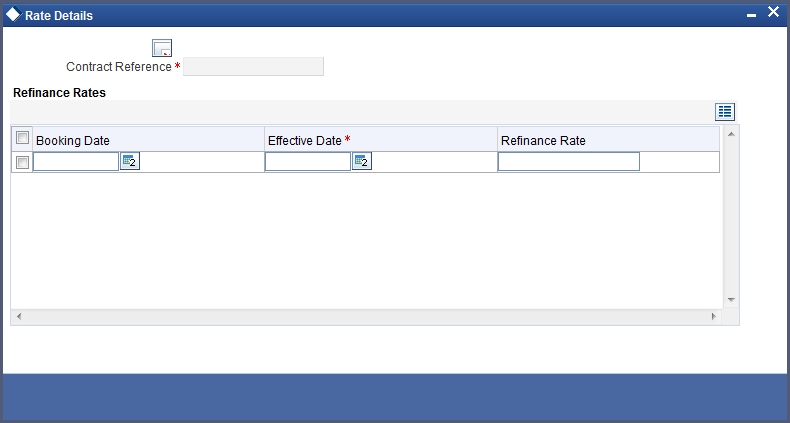

10.2.3 Viewing Rate Details
Click ‘Rate’ button on the ‘MIS’ screen and invoke the ‘Rate Details’ screen.
Here you can view the following details:

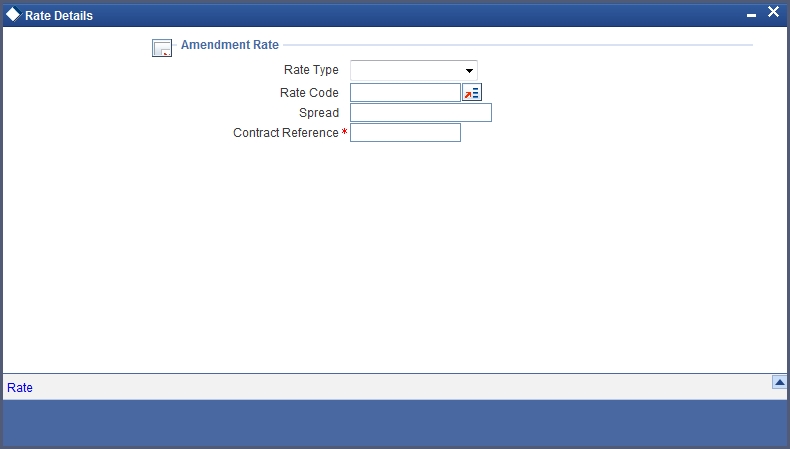

10.2.3.1 Viewing Amendment Rate Details
Click ‘Amendment Rate’ button and invoke the ‘Rate Details’ screen.

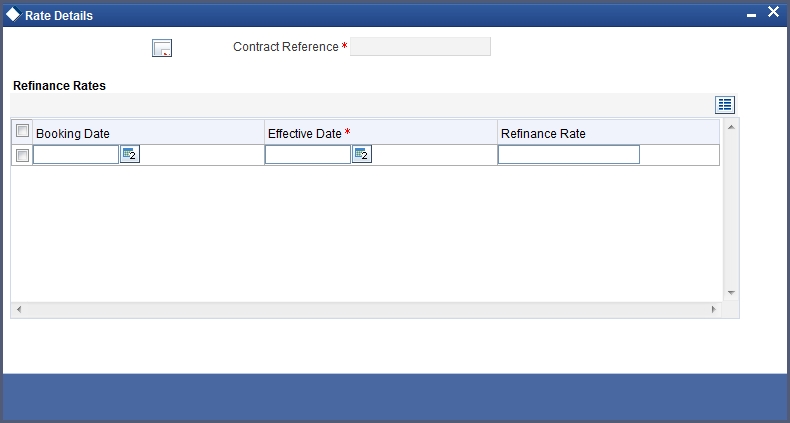

10.2.3.2 Viewing Rate Details
Click ‘Rate’ button on the ‘Rate Details’ screen and invoke the ‘Rate Details’ screen.

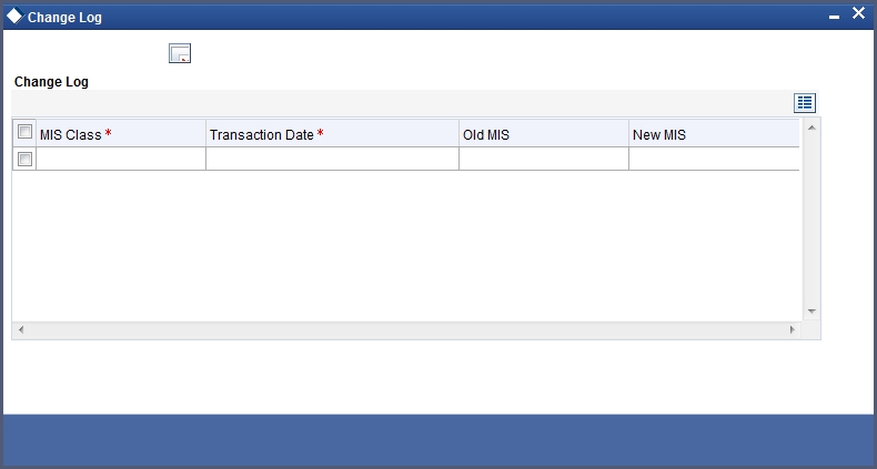

10.2.3.3 Viewing Change Log
Click ‘Change Log’ button on the ‘MIS’ screen and invoke the ‘Change Log’ screen.
If MIS reclassification occurs, through changing the MIS codes for transaction or composite classes, the System stores the changes made, in a Contract MIS Change Log. The following details are stored in the Contract MIS Change Log for the contract in respect of which the MIS reclassification occurred:

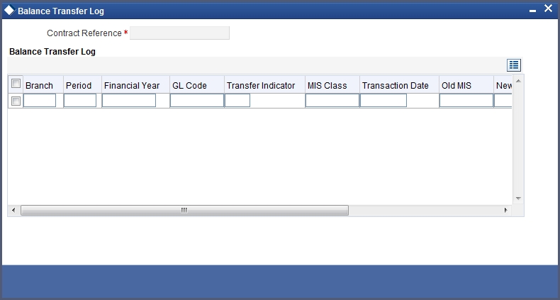

10.2.3.4 Viewing Balance Transfer Log
Click ‘Balance Transfer Log’ button on the ‘MIS’ screen and invoke the ‘Balance Transfer Log’ screen.
When an MIS reclassification occurs in respect of a the account, the balances in a GL associated with the old MIS code in each case are transferred to the GL for the new MIS code, if the option of transferring MIS balances upon reclassification has been set in the ‘Chart of Accounts’ screen for the GL.

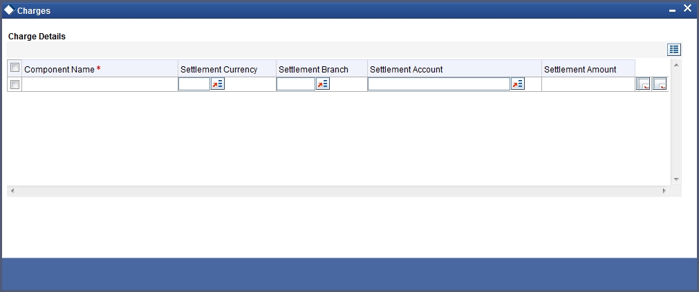

10.2.4 Viewing Charge Details
Click ‘Charge’ button on the ‘CL User Defined Events Triggering’ screen and invoke the ‘Charges’ screen.

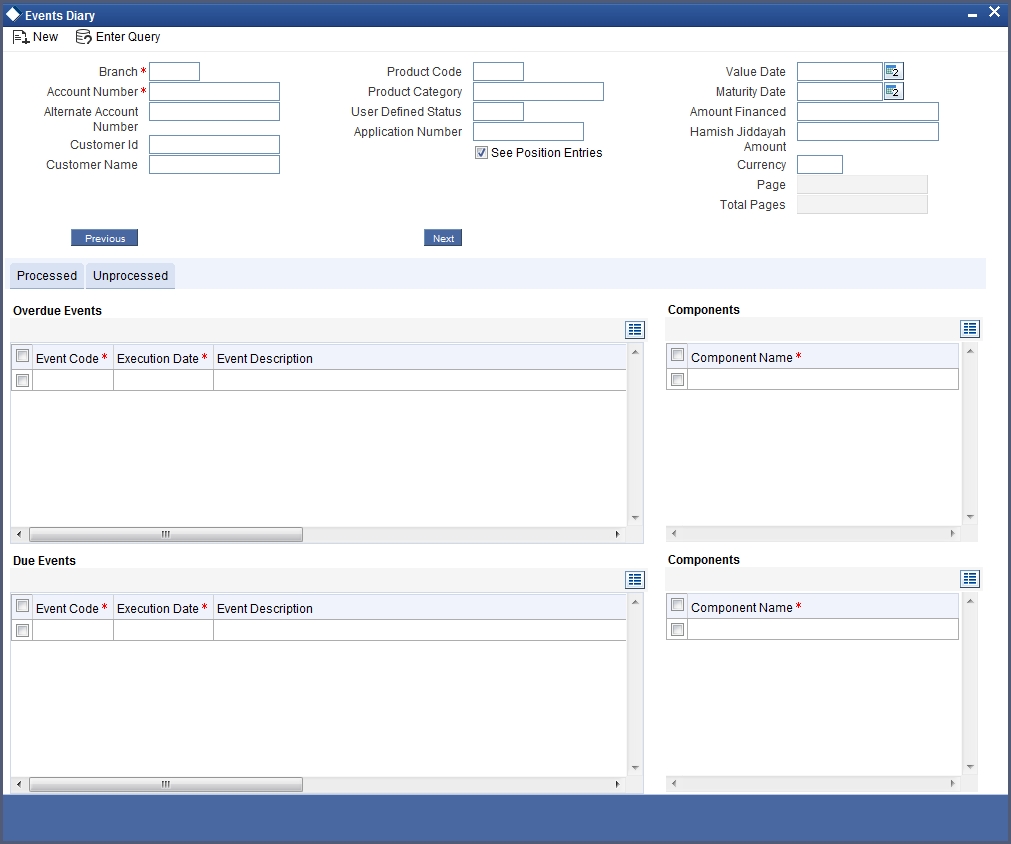

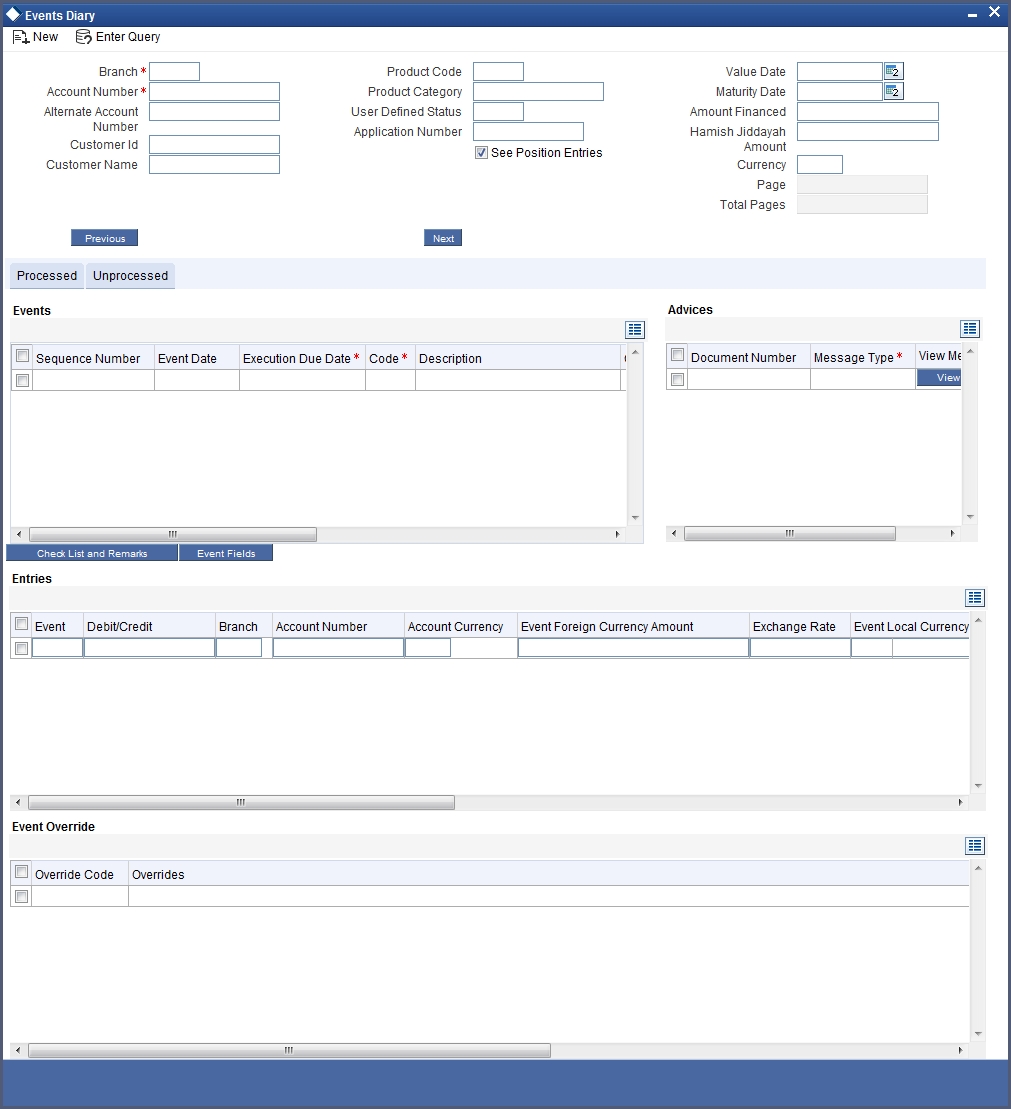

10.2.5 Viewing Event Details
Click ‘Events’ button on the ‘CL User Defined Events Triggering’ screen and invoke the ‘Events Diary’ screen.
10.2.5.1 Unprocessed Tab
Click this tab to view the unprocessed event details.
Refer the section ‘Events Diary’ in the chapter titled ‘Account Creation’ in this User Manual for details about the ‘Events Diary’ screen.

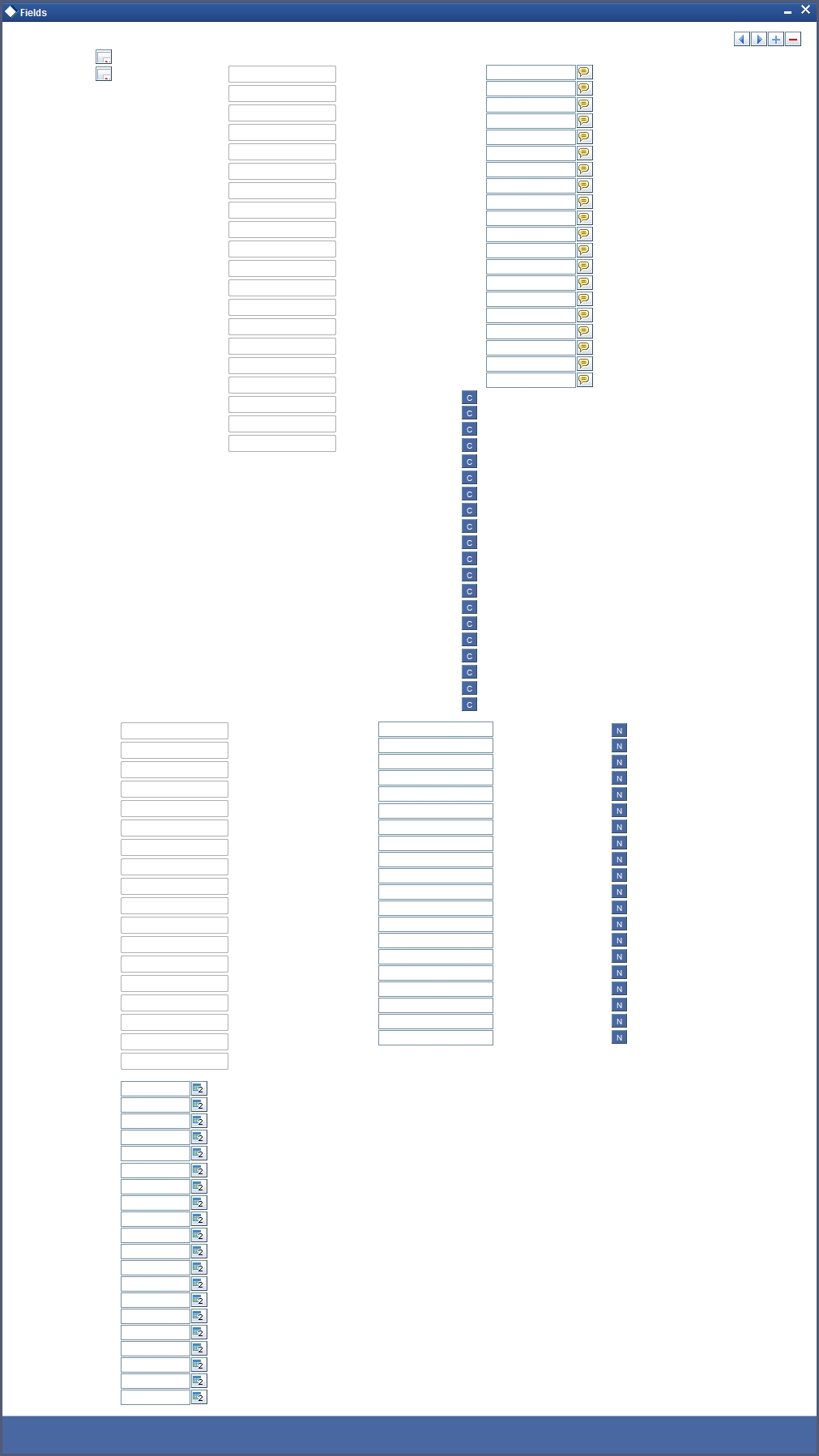

10.2.6 Viewing Event Fields
Click ‘Event Fields’ button on the ‘CL User Defined Events Triggering’ screen and invoke the ‘Fields’ screen.
Here you can view the UDFs and their values linked to the account.

You can manually liquidate the stamp duty tax using the ‘User Defined Event Triggering’ screen. Before doing a full liquidation, you have to manually trigger the STDX event.
