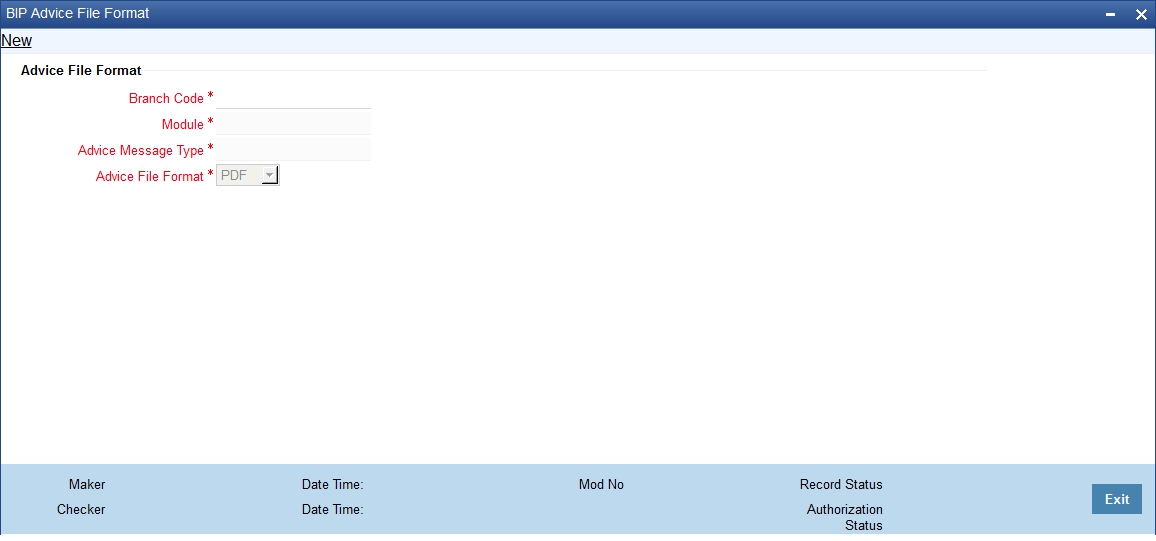

You can maintain BIP advice file format using BIP Advice File Format screen. You can invoke the ‘BIP Advice File Format’ screen by typing ‘MSDADFTP’ in the field at the top right corner of the Application tool bar and clicking on the adjoining arrow button.
The screen is as shown below:
You can maintain the following parameters here:
Branch Code
Specify branch code for which you need to maintain BIP advice file format, from the adjoining option list
Module
Advice Message Type
Specify advice message type of the BIP advice file format, from the adjoining option list.
Advice File Format
Select a valid file format in which you would prefer to generate the BIP message, from the adjoining drop-down list. This list displays the following:

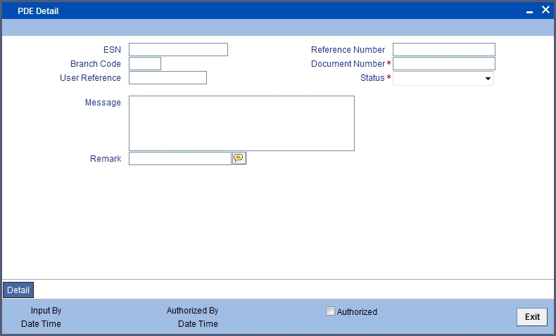

System identifies outgoing messages with a PDE (Possible Duplicate Emission) trailer and parks it in the PDE queue. From the PDE queue you can opt to either release the message with/without the PDE trailer or reject the message. You can release or reject an outgoing message with a PDE Trailer using the PDE Detailed screen. You can invoke the ‘PDE Detailed’ screen by typing ‘MSDETPDE’ in the field at the top right corner of the Application tool bar and clicking on the adjoining arrow button.
The following details of the message are displayed in the above screen:
You need to capture the following information in the above screen:
Status
Select the status of the message from the drop-down list. The options available are:

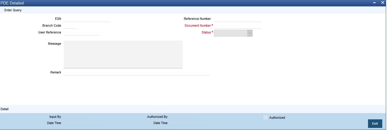

In order to view the details of the record click ‘Detail’ button. The details of the record are displayed in the ‘PDE Detail’ screen.
The following details of the message are displayed:

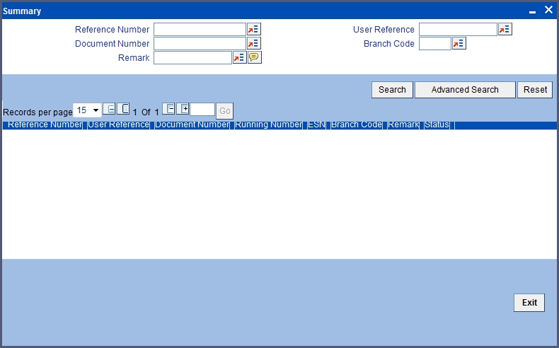

You can view all the PDE messages parked in the PDE queue using the ‘PDE Summary’ screen. You can invoke the PDE Summary screen by typing ‘MSSETPDE’ in the field at the top right corner of the Application tool bar and clicking on the adjoining arrow button.
In the above screen you can query for a record based on any of the following parameters:
Based on the query, the following details of the record which match the query parameter are displayed:
In order to view the details of each record select the record and click ‘Detail’ button. The details of the selected record are displayed in the ‘PDE Detail’ screen.
