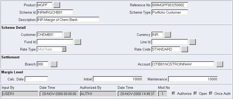

The ‘Margin Scheme definition’ screen is available in the Oracle FLEXCUBE Browser under the Maintenance tab.

After you associate a margin product with the scheme the system displays the Scheme Type as Portfolio Customer or Broker depending on the product type associated with the scheme.
The Reference Number and the Scheme ID
Each time you maintain the details of a new scheme the system automatically assigns a unique Reference Number to the scheme. You have the option of modifying this reference number.
The Scheme ID is also generated by the system. You will not be allowed to modify the Scheme ID since it is assigned by the system.

As part of specifying the scheme details firstly you have to indicate the code of the customer for whom you are creating the particular scheme.
After you indicate the Customer Code, you have to specify the currency in which the scheme is to be maintained. Click on the option list positioned next to the respective fields and select the Customer Code and Currency from the lists that get displayed.
In addition to specifying the Customer Code and Currency you have to indicate the Rate Code and Rate Type that is to be associated with the currency. The different rates maintained in the Exchange Rates screen are identified by unique Rate Codes. The Rate Code identifies the corresponding rate maintained in the Exchange Rate table. Whenever a conversion is done this rate will be picked up and applied on the margin transaction associated with the scheme.
Similarly, the Rate Type indicates whether the rate to be applied on the margin transaction is the Mid Rate or the Buy/Sell Rate.
Specifying the Settlement details
You have to indicate the default account that should be involved in the accounting entries for settling margin transactions in the particular scheme. The currency of the Settlement Account should be the same as that of the Scheme Currency
After indicating the Settlement Account, you have to indicate the code of the branch to which the settlement account belongs.

You can indicate the minimum Initial and Maintenance margin amounts for the scheme that you are maintaining.
