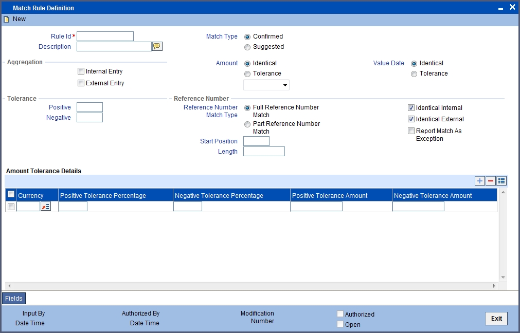

You can invoke the ‘Reconciliation Rule Maintenance’ screen by typing ‘REDRULDF’ in the field at the top right corner of the Application tool bar and clicking on the adjoining arrow button.
If you are maintaining details of a new rule, click the new button on the Application toolbar.
The ‘Reconciliation Rule Maintenance’ screen is displayed without any details.
If you are calling a Rule Definition record that has already been defined, double-click a rule of your choice from the summary screen.
Assigning the Reconciliation Rule a Code
In Oracle FLEXCUBE, each matching rule that you define is identified by a fifteen-character code called a Rule Code. You can follow your own convention for devising this code.
The code that you assign to a rule should be unique as it is used to identify the rule across the branches of your bank. When you need to make the rule applicable while reconciling nostro entries, you need to just specify the code assigned to the rule. The attributes of the rule will automatically become applicable for matching transactions.
After you assign a matching rule a code, you can specify the parameters based on which internal and external transactions should be matched when the rule is used. The parameters that you can use to define a rule are the:
You can specify several rules using various combinations of the above parameters.
Determining Match Type
You can decide whether the Automatic matching process should perform a confirmed match or suggested match.
You can choose to either confirm or reject suggested matches. On confirmation the match status will be changed from ‘Suggested’ to ‘Open’. If confirmed, system will pass adjustment entries.

Using the Value Date as a Matching Rule Parameter
While defining a rule, you can indicate preferences for the matching criterion - Value Date. You have either of the option to indicate whether:
Indicating Identical Value Dates
Choose this option to indicate that the automatic matching process should match an external transaction with an internal transaction, only if the value date of the internal transaction is identical with the value date of the external transaction.
Indicating a Tolerance Range
You also have the option to specify that the automatic matching process should match an external transaction with an internal transaction, if the value date of an external transaction is within a permissible tolerance range.
If you choose this option you should also specify the upper (positive) and a lower (negative) limit of the tolerance range.
The positive and negative tolerance is taken into consideration while the automatic matching process is run. This process will match those external transactions with a value date greater than or lesser than the value date of the internal transaction within the tolerance range that you indicate.
Using Reference Number as a Matching Rule Parameter
You can use the reference number assigned to the transaction as a parameter for matching and reconciling Nostro entries. You have the option to use either the internal or external reference number as a matching criterion or you could use both.
In Oracle FLEXCUBE, you can indicate whether the full reference number or a part of it should be used for matching entries.
Using the Full Reference Number for Matching
If you indicate that full numbers need to be matched, you need to indicate whether the internal or external reference number should be matched. Your internal reference is the other entity’s external reference and their internal reference is your external reference.

Using Partial Reference Numbers for Matching
If you indicate partial matching, you can indicate the portion of the reference number that needs to be matched. In the case of partial matching you need to indicate the:
This will apply to both internal as well as external reference numbers.

Using Amount as a Matching Parameter
The two options are:
You can further detail Amount Tolerance as:
These parameters can be defined for each currency. When a currency amount is not defined, tolerance amount will be considered to be zero by default.
Currency
All valid currencies in the system will be available for selection here. The tolerance limits can be different for different currencies.
Positive Percentage Tolerance
You can capture the percentage of positive deviation from a possible match. This will be allowed if the rule definition allows a tolerance for the amount and tolerance type is defined as percentage.
Negative Percentage Tolerance
You can capture the percentage of negative deviation from a possible match. This will be allowed if the rule definition allows a tolerance for the amount and tolerance type is defined as percentage.
Positive Amount Tolerance
You can use this to capture the positive deviation in amount for a possible match. This will be allowed if the rule definition allows a tolerance for the amount and tolerance type is defined as Amount.
Negative Amount Tolerance
You can use this to capture the negative deviation in amount for a possible match. This will be allowed if the rule definition allows a tolerance for the amount and tolerance type is defined as Amount.
