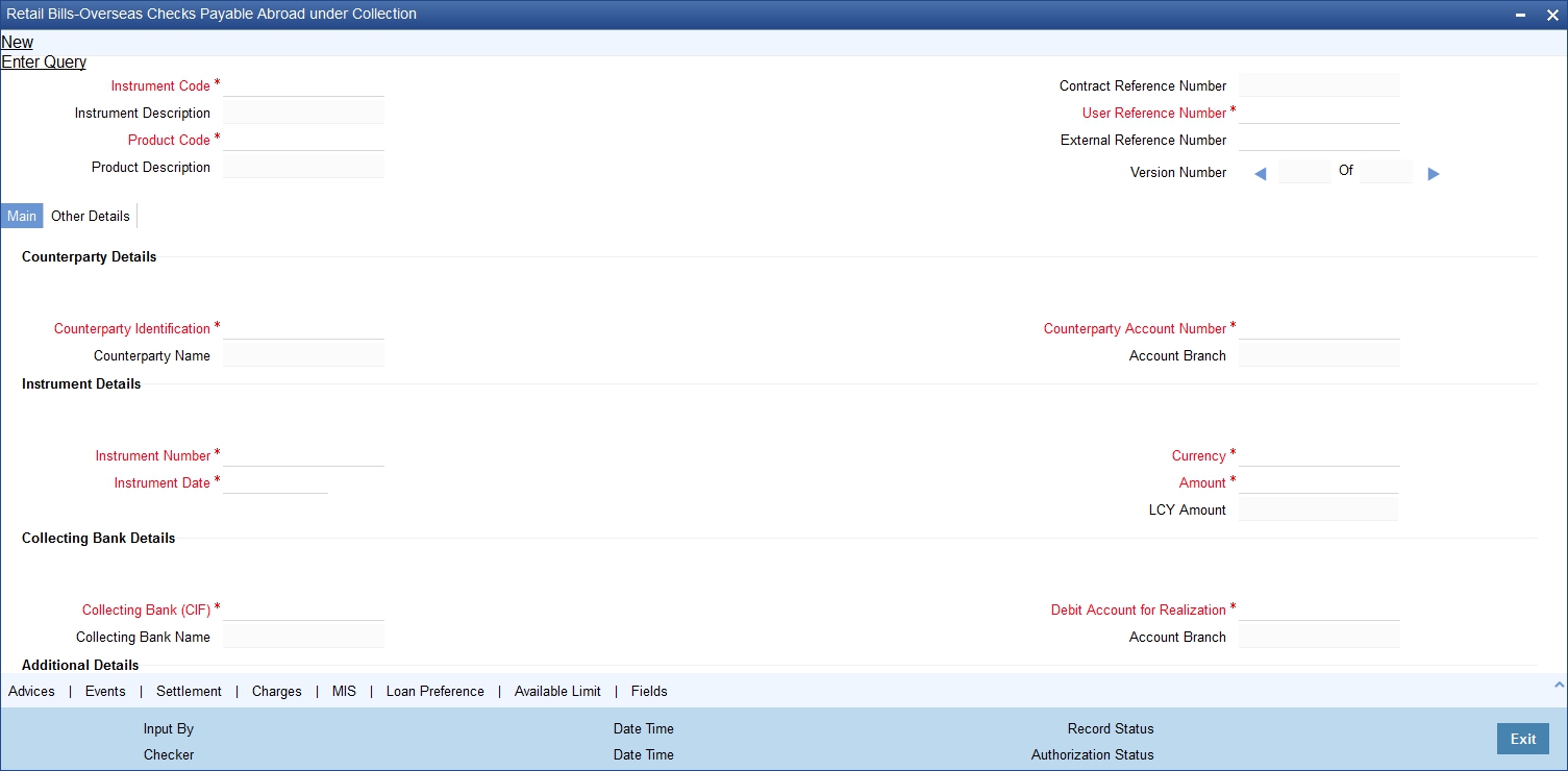

You can capture the details of the overseas cheques payable abroad on collection basis using ‘Retail Bills - Overseas Cheques Payable Abroad under Collection’ screen. To invoke this screen, type ‘RBDOCPAY’ in the field at the top right corner of the application toolbar and click the adjoining arrow button.
Specify the following details:
Instrument Code
Select the instrument code from the adjoining option list.This list displays the instrument codes associated with the Product type ‘Overseas Cheques Payable Abroad under Collection’.
Instrument Description
System displays the description of the instrument code selected.
Product Code
Select the product code from the adjoining option list. The option list displays all valid product codes that are of type ‘Overseas Cheques Payable Abroad under Collection’.
Product Description
System displays the description for the product code selected above.
Contract Reference Number
System displays a unique reference for the contract which is being booked.
User Reference Number
By default, the system displays the contract reference number in this field. However you can modify this and specify a different user reference number.
External Reference Number
The External Reference Number is used when the contract is being uploaded from an external system. During Manual booking, system will default the contract reference number In this field.However,you can edit this value when required.
Click ‘Main’ tab to capture the details under this tab
Counterparty Identification
Select the customer number of the person who has submitted the instrument for collection. If you do not select the counter party id, then the system will display the counterparty ID when you specify the ‘Counterparty Account number’.
Counterparty Name
Based on the counterparty identification, the system displays the name of the customer.
Counterparty Account Number
Select the account number of the counterparty from the adjoining option list.
If you have already specified the counterparty identification, then the option list will display all valid accounts of that counterparty. If you have not specified the counterparty identification, then the option list will display all valid account numbers maintained in the system.
To view the joint holder’s details of an account and the mode of operation maintained at the account level, place the cursor on the Counterparty Account Number field and press Ctrl+J. The system displays the ‘Joint Holder’ screen.
For more information on the ‘Joint Holder’ screen refer to the section ‘Joint Holder Maintenance’ in the Core User Manual.
Account Branch
The branch to which the customer belongs is defaulted by the system.
Instrument Number
Specify the cheque number here.
Instrument Date
Specify the date of the cheque. You may specify a past date in case of a backdated instrument. But the instrument date should not be earlier than the date arrived at by considering the stale days specified in ‘Instruments Maintenance’ screen.
Currency
Select the cheque currency from the adjoining option list.
Amount
Specify the cheque amount.
LCY Amount
Collecting Bank (CIF)
Specify the bank to which the FCY cheques can be sent under collection. You can select the appropriate one from the option list.
You can also select the walk-in customer id maintained in the ‘Branch Parameter Maintenance’ screen.
Collecting Bank Name
The system displays the name of the collecting bank.
Debit Account for Realization
Select the debit account for realization from the option list. This is the account debited at the time of realization of proceeds. The option list displays all Nostro accounts applicable. Select the appropriate one.
To view the joint holder’s details of an account and the mode of operation maintained at the account level, place the cursor on the Debit Account for Realization field and press Ctrl+J. The system displays the ‘Joint Holder’ screen.
Account Branch
The system displays the debit account branch.
Booking Date
System displays the application date as the booking date. This is the date on which the instrument is being booked.
Due Date for Payment
System displays a date on which the proceeds are expected from the collecting bank.
Transit Days
The system displays the number of transit days.
If country of the collecting bank is the same as the country of the Nostro account, then the system displays the direct transit days maintained for the currency - Nostro account combination in ‘Float Days’ tab of ‘Retail Bills Branch Parameters Maintenance’ screen.
If country of the collecting bank and country of Nostro account are different, then the system displays the indirect transit days maintained for the currency - Nostro account combination in ‘Float Days’ tab of ‘Retail Bills Branch Parameters Maintenance’ screen.
Auto Liquidation
Check this box to indicate that the instrument should be liquidated automatically on due date.
Other Party Name
Specify the name of the other party.
Drawee Bank Name
Specify the name of the bank on which the cheque is drawn.
Internal Remarks
Specify your remarks on the transaction.

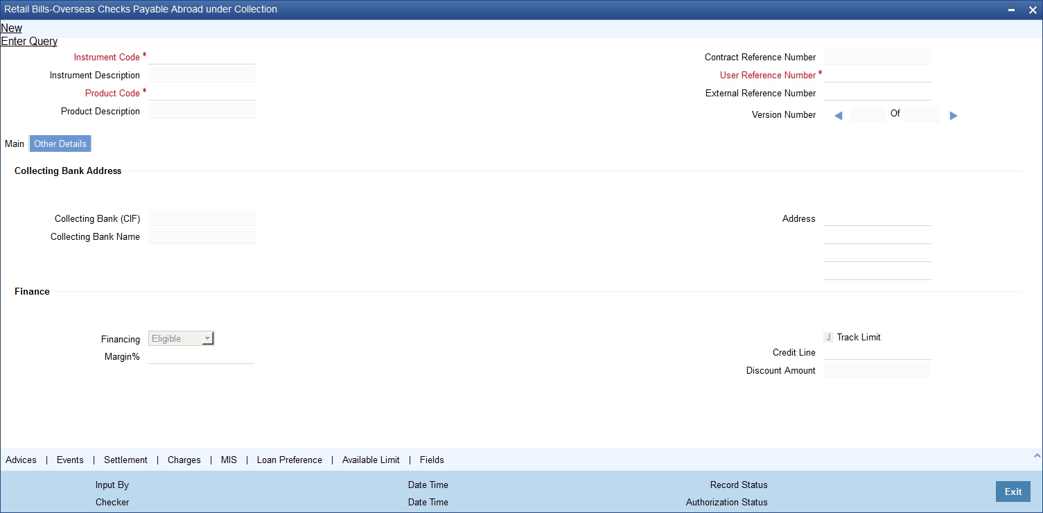

Click ‘Other Details’ tab to capture the additional details.
Select the Collecting Bank CIF from the adjoining option list.
System displays the name of the collecting bank.
Address
Based on the collecting bank (CIF) or walk-in customer id, the system displays the address of the collecting bank/walk-in customer. However, you can modify this address if the collecting bank (CIF) id is selected as walk-in customer.
Financing
If the contract is eligible for financing, then the system defaults the value as 'Eligible'.You can change the value to 'Financed'.If the system defaults the value as 'Not eligible’, then you cannot change the contract value to 'Financed'.
Margin%
System defaults the margin% from instrument maintained. You can edit this value if needed.
Track Limit
Check this box to indicate that the counterparty limits should be tracked when the instrument is financed.
Credit Line
Select the facility Id of the customer from the adjoining option list. It is used for limit validation.
‘Credit line’ field is Mandatory if the instrument is considered for financing.
Note
If you select ‘Eligible’ or ‘Not Eligible’ in the field ‘Financing’, then the system will nullify the values in fields ‘Credit Line’ and ‘Track Limit’. Appropriate override messages will be displayed.
Discount Amount
System computes and displays the amount being financed as the discount amount. Here, Discount amount = Instrument amount - Margin.
For capturing additional details, an array of buttons are provided at the bottom of ‘Retail Bills - Overseas Cheques Payable Abroad under Collection’ screen. You can capture the following additional details for a cash letter contract:
For further details on these sub-systems, refer to the section 'Capturing Additional Details for FCY Cheques under Cash Letter' in this user manual.
Once you have captured the details, click ‘Save’ button.

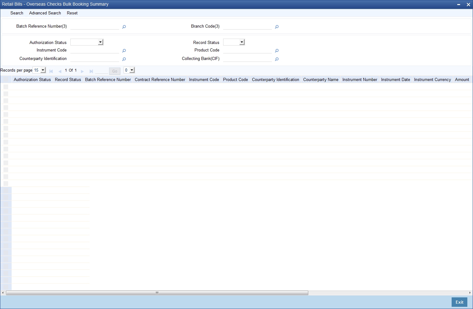

You can view a summary of overseas cheques payable abroad under collection using ‘Overseas Cheques Payable Abroad under Collection Summary’ screen. To invoke this screen, type ‘RBSOCPAY’ in the field at the top right corner of the application toolbar and click the adjoining arrow button.
You can search for the records based on one or more of the following parameters:
Once you have specified the search parameters, click ‘Search’ button. The system displays the following details of the records that match the search criteria.

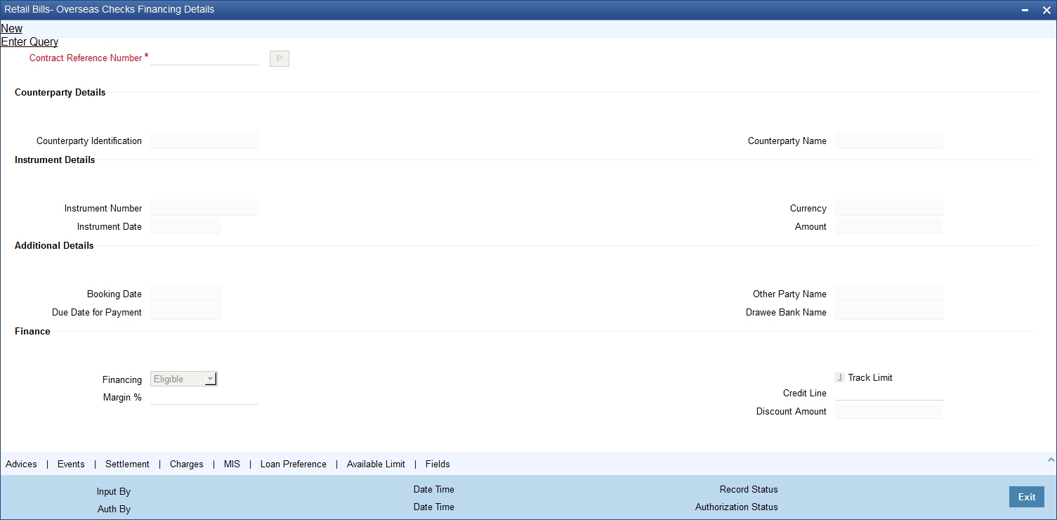

You can finance an overseas cheque using ‘Retail Bills - Overseas Cheques Financing Details’ screen. To invoke this screen, type ‘RBDOCFIN’ in the field at the top right corner of the application toolbar and click the adjoining arrow button.
Specify the contract reference number of the cheque for which financing is required. You can select the contract reference number from the option list. The option list displays all valid contracts which are eligible for financing.
Once you have specified the contract reference number, click 'P’ button to populate the details of the contract.
System displays the customer id based on the contract reference number selected.
Counterparty Name
System displays the name of the customer here.
Instrument Number
The system displays the cheque number based on the contract reference number selected.
Instrument Date
System displays the date of the cheque based on the contract reference number selected.
Currency
The system displays the cheque currency.
Amount
The system displays the cheque amount.
Booking Date
System displays a date on which the instrument is being booked.
System displays the due date for payment based on the contract reference number selected.
Other Party Name
System displays the name of the other party.
Drawee Bank Name
System displays the name of the bank on which the cheque is drawn.
Financing
The system displays whether the instrument is eligible for financing or not, based on the instrument selected. If the financing status is ‘Eligible’, then you can change it to ‘Financed’.
Margin %
Track Limit
Check this box to indicate that the counterparty limits should be tracked.
The value is defaulted by the system as 'Yes'. However, the value can be changed later from 'Yes' To 'No', the system displays an override at the time of saving a record
Credit Line
Select the facility id of the customer from the adjoining option list.The list contains only those lines that belong to the counterparty. It is applicable only if the track limit is set to YES.
Discount Amount
System computes and displays the amount being financed as the discount amount. Here, Discount amount = Instrument amount - margin.
For capturing additional details, an array of buttons are provided at the bottom of ‘Retail Bills - Overseas Cheques Financing Details’ screen. You can capture the following additional details for a cash letter contract:
For further information on the above buttons, refer to the section ‘Capturing Additional Details for Cash Letter Contracts’ in this user manual.
Once you have captured the details, click ‘Save’ button. The system will create a loan account for the discounted amount in Retail Lending module.

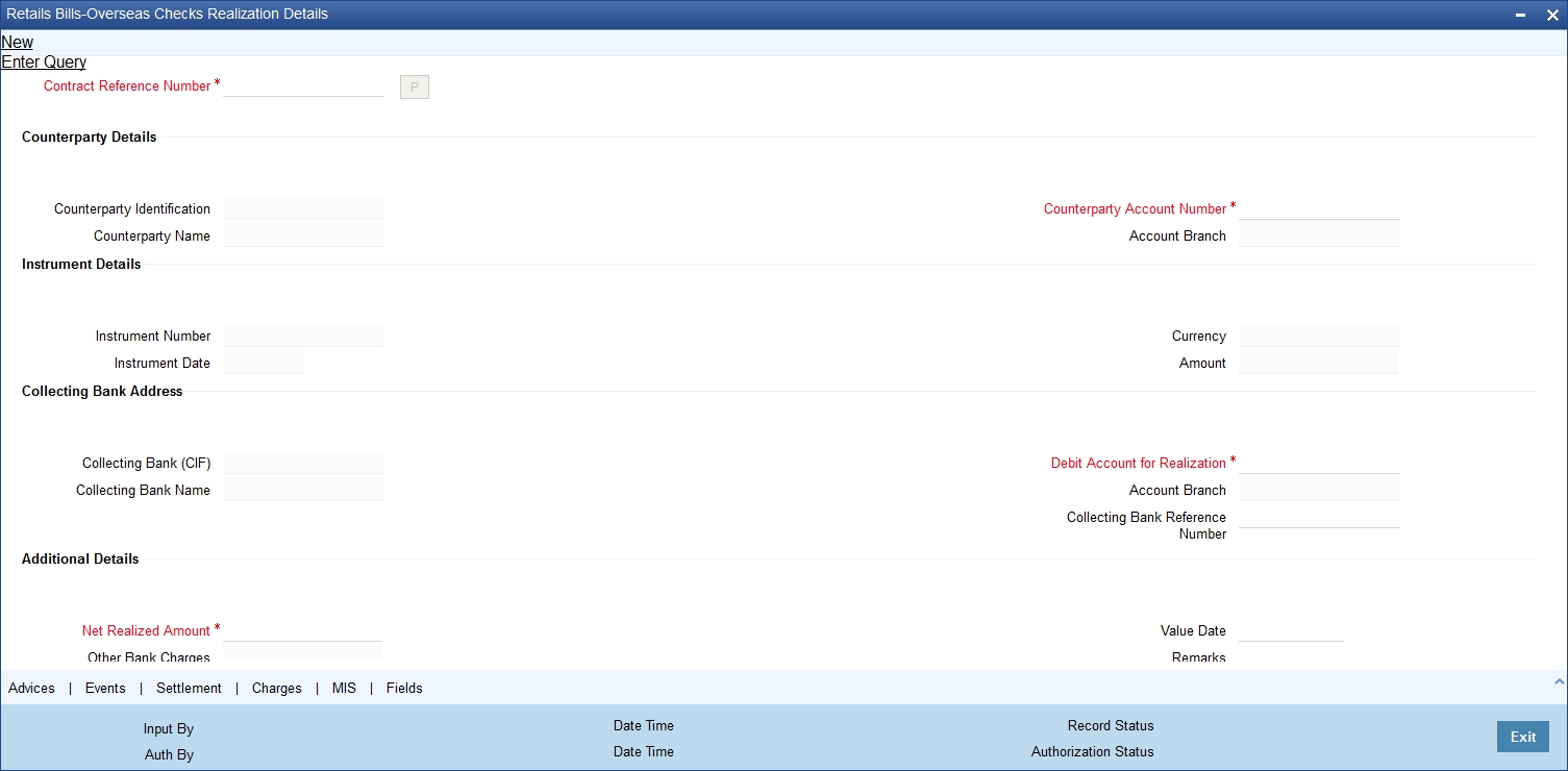

You can realize the individual overseas cheques that were sent for collection using ‘Retail Bills’ Overseas Cheques Collection Details’ screen. To invoke this screen, type ‘RBDOCREA’ in the field at the top right corner of the application toolbar and click the adjoining arrow button.
Specify the contract reference number that you need to realize. You can select the contract reference number from the option list. The option list displays all valid and active contracts.
Once you have specified the contract reference number, click ‘P' button to populate the details of the contract.
Counterparty Name
System displays the customer name based on the contract reference number selected.
The system displays the account number of the counterparty.
Account Branch
The system displays the branch to which the customer belongs.
Instrument Number
The system displays the cheque number as the instrument number.
Instrument Date
The system displays the date of the cheque.
Currency
Amount
System displays the collecting bank code based on the contract reference number selected.
Select the account from the option list. It is the account debited at the time of realization of proceeds.
Account Branch
Collecting Bank Reference Number
Specify the reference number of the collecting bank if the value is not available in the contract details.
Net Realized Amount
Specify the net realized amount here.
Other Bank Charges
The system displays the other bank charges. This is calculated by deducting the net realized amount from instrument amount.
If the other bank charges exceeds the tolerance limit specified in ‘Branch Parameters Maintenance’, then the system displays an override message.
Value Date
System defaults the Current system date as the value date and you can edit this value.
Remarks
For capturing additional details, an array of buttons are provided at the bottom of ‘Retail Bills - Overseas Cheques Realization Details’ screen. You can capture the following additional details for a cash letter contract:
Once you have specified the above details, click ‘Save’ button. The system triggers LIQD event.
In case of financed instruments, the system initiates liquidation of the loan account in CL module.

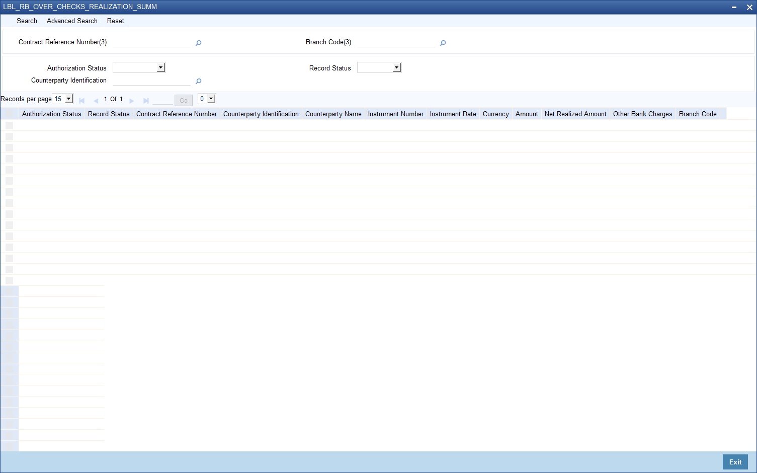

You can view a summary of realization of overseas cheques payable abroad under collection using ‘Overseas Checks Realization Summary’ screen. To invoke this screen, type ‘RBSOCREA’ in the field at the top right corner of the application toolbar and click the adjoining arrow button.

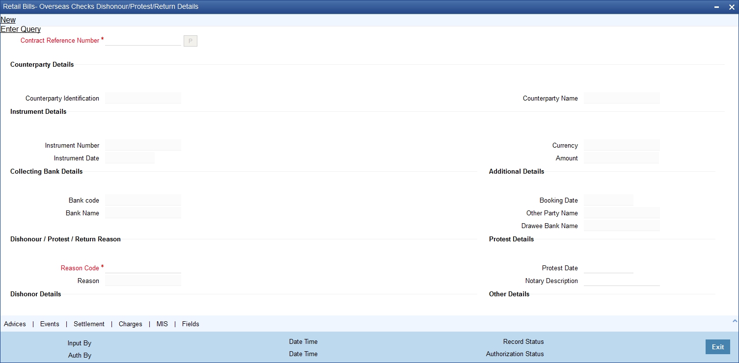

In the event of non payment of a cheque, you can capture the dishonour, protest or return details using ‘Retail Bills - Overseas Cheques Dishonour - Protest - Return Details’ screen. To invoke this screen, type ‘RBDOCDPR’ in the field at the top right corner of the application toolbar and click the adjoining arrow button.
The 'Retail Bills-Overseas Cheques Dishonour-Protest-Return Details' screen is used for handling the dishonour, protest and return of retail instruments.
Specify the contract reference number of the instrument which needs to be dishonoured/protested/returned. You can select the appropriate contract from the option list. The option list displays all valid and active contract reference numbers.
Once you have specified the contract reference number, click ‘P’ button to populate the contract details.
System displays the Customer Id based on the contract reference number selected.
Counterparty Name
System displays the counterparty Name based on the contract reference number selected.
Instrument Number
The system displays the cheque number here.
Instrument Date
Currency
Amount
Bank code
The system displays the collecting bank code based on the contract reference number selected.
Bank Name
The system displays the collecting bank name associated with the bank code.
Booking Date
System displays the booking date based on the contract reference number selected.
Other Party Name
Drawee Bank Name
Reason Code
Select a reason code from the adjoining option list.
Reason
System displays a reason description based on the reason code selected.
Dishonour Date
Specify a date of dishonour and it should not be earlier than the booking date or later than the system date.
Protest Date
Specify the date of protest.
The protest date should not be -
Notary Description
Specify the notary description.
Return Date
Specify the date of return of the instrument. The return date should not be -
Discount Amount
System displays the financed amount as the discount amount, if the instrument is financed.
Other Bank Charges
Specify the Charges that are claimed by the other bank.
Remarks
For capturing additional details, an array of buttons are provided at the bottom of ‘Retail Bills - Overseas Cheques Dishonour - Protest - Return Details’ screen. You can capture the following additional details for a cash letter contract:
Based on the details that you have captured, the system will perform one of the following actions when you save the record:

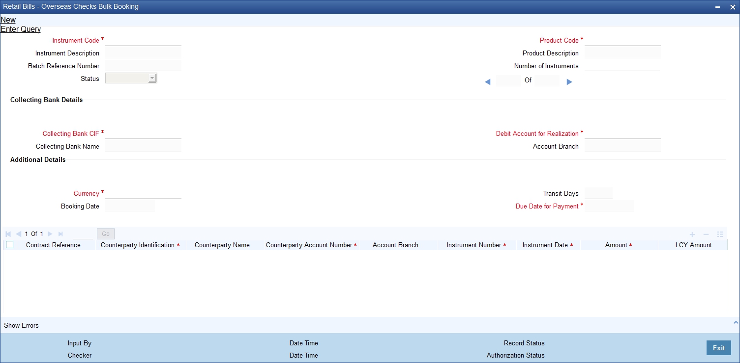

You can capture multiple overseas cheques payable abroad under collection using a single screen- 'Retail Bills-Overseas Cheques Bulk Booking'. You can invoke this screen by typing ‘RBDBOCPA’ in the field at the top right corner of the Application tool bar and clicking on the adjoining arrow button.
Instrument Code
Select the instrument code from the adjoining option list. The list contains only those instruments which are linked to product of type’ Overseas Cheques payable abroad for collection’.
System displays instrument description for the instrument code selected in the above case.
Batch Reference Number
System generates and displays a unique reference number for the batch of instruments being booked.
Status
System displays the status of the booking here. This record can have one of the following statuses:
Product Code
Select a product code under which the contract is booked from the adjoining option list.
Product Description
System displays the description of the Product code selected.
Number of Instruments
Specify the number of instruments that are being booked in the batch. When you save the record, the system verifies whether this number equals the number of entries in the grid. If the number of entries in the grid and the number of instruments specified here do not match, then the system displays an error message.
Collecting Bank CIF
Select the CIF of the collecting bank/walk-in customer from the adjoining option list.
Select the account number which needs to be debited during realization from the adjoining option list. The list contains the Nostro accounts of the cheque currency.
Account Branch
System displays the debit account branch.
Currency
Select the currency of the cheque from the adjoining option list.
Booking Date
System displays the date on which the batch is booked.
Transit Days
The system displays the due date for payment. This date is calculated by adding the number of transit days for the currency to the booking date.
Contract Reference
The system generates and displays a unique reference number for the contract on authorization. This reference is used in all accounting entries and transactions related to this contract.
Specify the customer id of the counterparty. The counterparty is the party who has submitted the instrument. If you do not specify the counterparty id, then the system will display it when you specify the counterparty account number.
Counterparty Name
Specify the account number of the counterparty.
If you have selected the counterparty identification, then the option list displays only the valid account numbers of the selected counterparty. If you have not specified the counterparty identification, then the system will display all the valid account numbers maintained in the system.
Account Branch
System displays the account branch here.
Instrument Number
Instrument Date
Specify date of cheque.
Amount
Specify a cheque amount.
LCY Amount
The system defaults the base amount as the Local Currency Amount on save or subsystem visit.
Other Party Name
Specify the name of the other party here.
Drawee Bank Name
Auto Liquidation
Check this box to indicate that an instrument should be liquidated automatically on due date. The value is defaulted from the product and can be modified by the user.
Financing
If the contract is eligible for financing, then the system displays the value as ‘Eligible’. You can change the value to ‘Financed’. If the value defaulted by system is 'Not Eligible', then the contract cannot be financed and you cannot change the value to ‘Financed'.
Margin%
Track Limit
Credit Line
Select the facility Id of the customer from the adjoining option list. The list contains only those lines that belong to the counterparty. It is applicable only if the track limit is set to ‘Yes’.
Discount Amount
It depends on the contract amount captured and margin% for the batches, where the financing value is ‘Financed’.
Internal Remarks
Status
System displays the status value here.

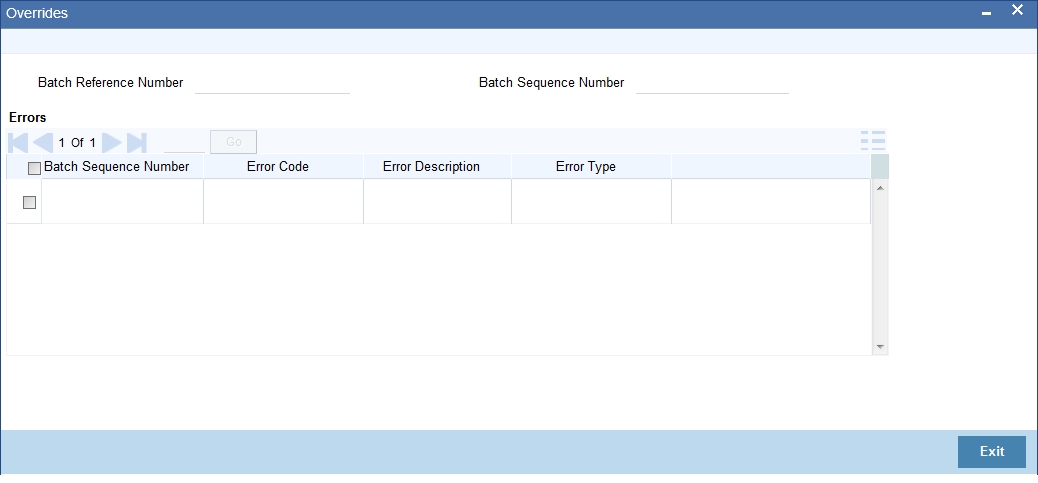

You can view the errors and overrides that took place in the bulk overseas cheque booking process using ‘Overrides’ screen. Click ‘Show Errors’ button to invoke this screen.
You can view the following details of errors/overrides in the process:
Once you have captured the details, click ‘Save’ button. On authorization, the system triggers BOOK event for all the contracts that you have requested to create as part of this batch.

You can view a summary of bulk booking of overseas cheques payable abroad under collection using ‘Retail Bills - Overseas Checks Bulk Booking Summary’ screen. To invoke this screen, type ‘RBSBOCPA’ in the field at the top right corner of the application toolbar and click the adjoining arrow button.

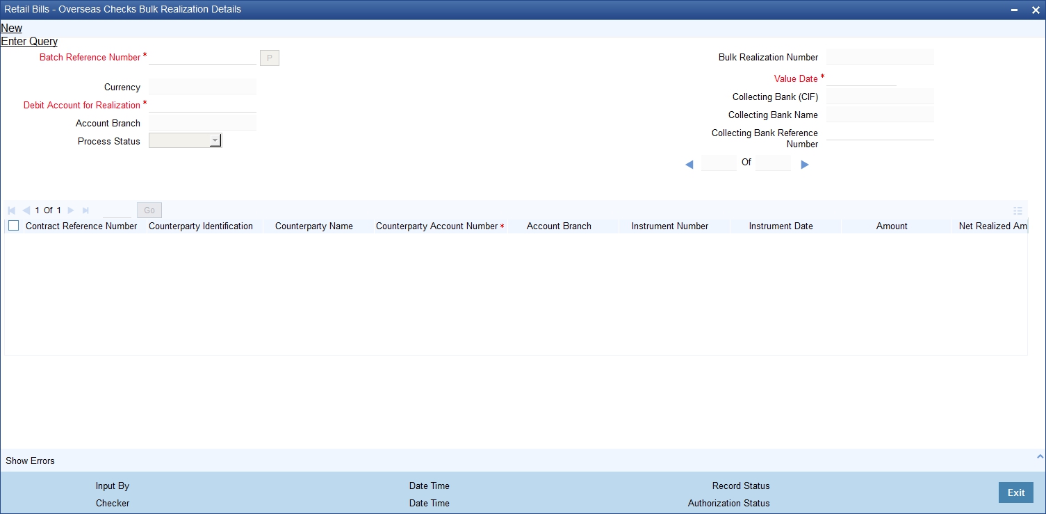

You can realize all overseas cheques sent under a batch using 'Retail Bills-Overseas Cheques Bulk Realization Details' screen. This screen allows you to identify a batch under which the selected set of instruments will be realized.
You can invoke this screen by typing ‘RBDBOCRE’ in the field at the top right corner of the Application tool bar and clicking on the adjoining arrow button.
Select the Batch Reference number from the adjoining option list for which the bulk realization has to be done.
Once you have specified the above details, click 'P' button to populate the details of the instruments in a batch.
Currency
System displays the currency based on the batch reference number selected.
System displays the Debit Account for Realization based on the Batch Reference Number selected. You can edit the same.
Account Branch
Process Status
Based on the batch reference number, the system displays the process status. The process status can be one of the following:
Bulk Realization Number
System generates and displays a unique bulk realization number.
Value Date
The system displays an application date as a value date. You can edit this value.
System displays the collecting bank code based on the batch reference number selected.
System displays the collecting bank name based on the batch reference number selected.
Specify a reference number provided by the collecting bank for payment.
System displays the contract reference number of the contracts which are due for realization.
System displays the counterparty ID of the contracts which are due for realization.
Counterparty Name
System displays the name of the counter party.
System defaults counterparty account number based on contract input.
Account Branch
System displays the branch associated with the account number mentioned above.
Instrument Number
System displays the instrument number of the contracts which are due for realization
Instrument Date
System displays the instrument date of the contracts which are due for realization
Amount
System displays the amount for the selected contract.
Net Realized Amount
Specify the net realized amount here. If no value is captured for this field, then the system considers the instrument amount as net realized amount.
Other Bank Charges
System computes and displays the Instrument amount minus Net realized amount as other bank charges.
Internal Remarks
Process Status
System displays the status of the contract available for bulk realization as part of this batch.
You can view the errors and overrides that took place in the bulk overseas cheque realization process using ‘Overrides’ screen. Click ‘Show Errors’ button to invoke this screen.
Once you have specified the above details, click ‘Save’ button to save the contract. The system triggers LIQD event for all instruments selected for realization. In case of financed instruments, the system initiates liquidation of the loan account as well.

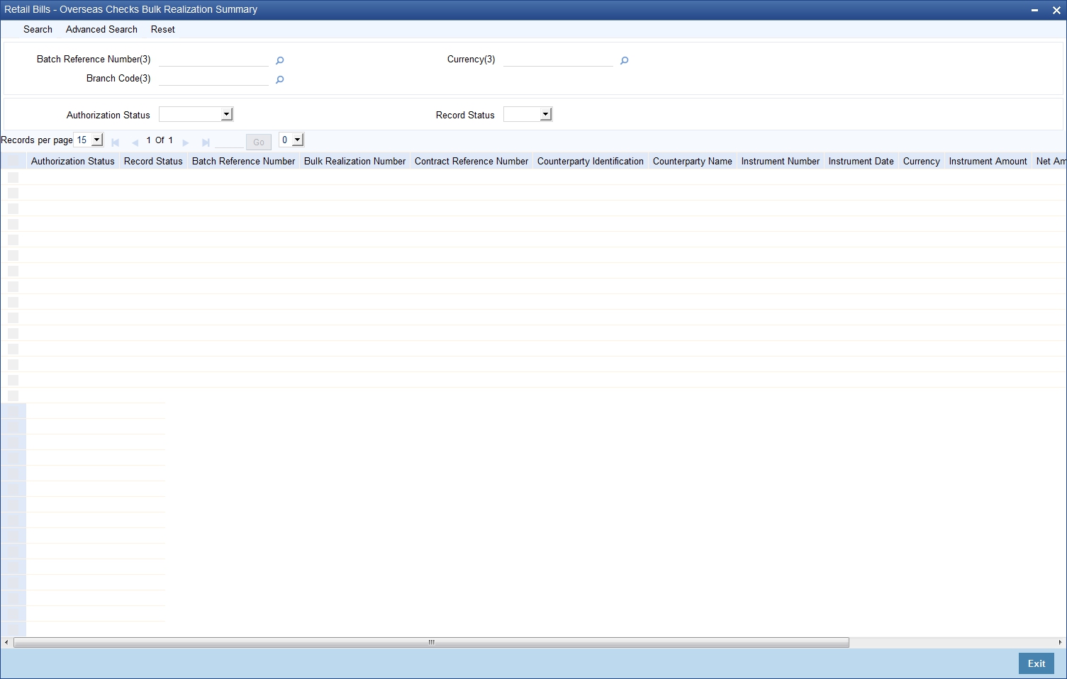

You can view a summary of bulk realization of overseas cheques payable abroad under collection using ‘Retail Bills - Overseas Checks Bulk Realization Summary’ screen. To invoke this screen, type ‘RBSBOCRE’ in the field at the top right corner of the application toolbar and click the adjoining arrow button.
