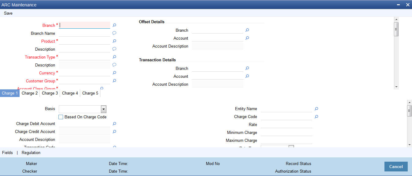

In the ARC Maintenance screen, you maintain accounting and charges information that would be applicable for processing retail teller transactions involving a specific branch, retail teller product and specific currency combination.
You can invoke the ‘ARC Maintenance’ screen from the application browser. You can invoke this screen by typing ‘IFDATMMN’ in the field at the top right corner of the Application tool bar and clicking on the adjoining arrow button.
In the ARC Maintenance screen, you maintain accounting and charges information (known as ARC details) that would be applicable when processing retail teller transactions involving a specific branch, retail teller product and specific currency combination.
Note
It is recommended that you maintain ARC details for all possible combinations of retail teller branch, product, offset currency, transaction currencies, customer and customer group. If you do not maintain specific records for each currency, customer and branch combination, you can use the ‘*.* ‘ option.
Product
While maintaining the ARC details, you have to indicate the retail teller product, transactions involving which the details would apply. Each product in Oracle FLEXCUBE is identified with a unique four character alphanumeric code. You can indicate the appropriate product.
It is recommended that you maintain ARC details to be applicable for each retail teller product that you set up.

You can specify the offset account or GL into which offset entries are to be booked, as a result of the teller transaction involving the product, branch and currency.
You can also indicate the branch in which the offset account resides. You can also choose the “ALL” option, which the system interprets as the branch in which the transaction is being input.
Indicating the offset account as the debit account
You could indicate that the offset account is to be the debit account for the transaction, in teller transactions involving the product, branch and currency combination. To indicate this, select the ‘Offset Account’ option in the Debit Account field on this screen.
Indicating the offset account as the default charge account
You could indicate that the offset account is to be the default charge account for the transaction, in teller transactions involving the product, branch and currency combination. This means that the charges would be recovered from this account. To indicate this, select the ‘Offset Account’ option in the Charge From Account field on this screen.

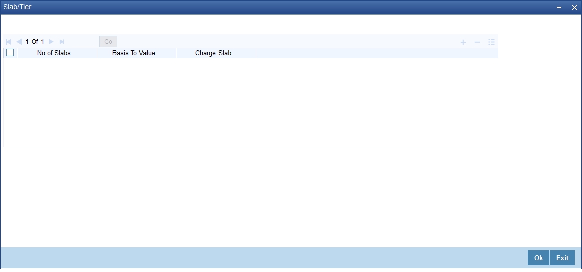

Slab type
Select whether the Charge computation has to be over different Amount Slabs or Tiers (0-100 @ 10, 101-500 @ 15 etc.).

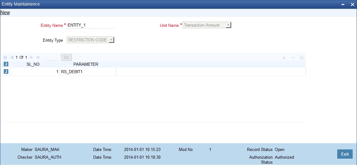

Entity Name
The field is enabled if ‘System Entity’ is selected in the ‘Basis’ field. Select the Entity Name, from the adjoining option list. The list of values are populated from the ‘Entity Maintenance’ screen (STDENMNT). Further details on the ‘Entity Maintenance’ screen is provided in subsequent sections of this chapter.

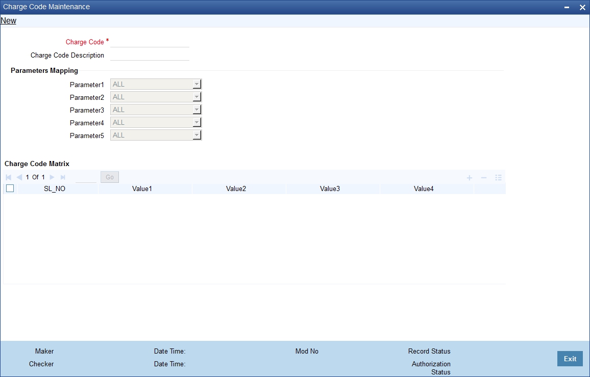

Based on Charge Code
Check this box to indicate whether the charge is based on the charges maintained in the ‘Charge Code Maintenance’ screen. If this field is checked, then the system checks the parameters applicable to the selected charge code from the ‘Charge Code Maintenance’ screen (which is detailed in the subsequent section) and passes the relevant parameter value(s). The system also passes the “Basis” amount to the charge code as the basis is captured at ARC charge level.
If the system is unable to pass a parameter value to a charge code because of unavailability of data, the same parameter is treated as *.*.
Charge Code
This field is enabled if ‘Based on Charge Code’ field is checked. Select the charge code from the adjoining option list. All charge codes as maintained in the charge code maintenance screen is listed in this field.

Note
The charge amount will be deducted in the currency that you specified earlier.
MIS Head
Specify the MIS Head that is applicable for the charge-related accounting entry.
Description
You can indicate a short description for the charge.
Charge Tracking Preference
Select charge tracking preference from the adjoining drop-down list. The options available are:
Note
Note
Liquidation Preference for Tracked Charges
Note
If track receivable is checked at RT product level, then the non sufficient treatment or charge tracking preference at ARC maintenance level is ignored by the system.
If track receivable is not checked at RT product level, the non sufficient treatment or charge tracking preference selected at ARC maintenance level for the product is applicable. The non sufficient treatment or charge tracking preference at ARC level is applicable to charges and not for the original transaction amount. For ARC product, the processing is done by RTAUTDLY batch.
If one charge has been used as a basis to arrive at another charge, then the ‘Charge Tracking Preference’ will be same for both the charges.
During evaluation of charge tracking preference for a transaction with multiple charges, the system calculates all the charges and then considers charges from 1 to 5.
The system displays override messages when:
The non sufficient funds tracked transactions can be reversed on the same day only, next day reversal is not allowed.
If netting is disabled for credit transactions, the charges will be deducted from the account. Hence, NSF charge tracking preference will be applicable if system is unable to collect the charge amount.
If ‘Charge Tracking Preference’ is selected as ‘Part track’ or ‘Full track’ then, once the amount for tracking has been calculated then the system does the following:
Whenever an account is credited for which there are tracked receivables, the system will do the following:
During EOD the does the following to liquidate the tracked receivables:
If apportioned amount is less than the tracked amount and liquidation preference is ‘Partial’, system will liquidate partially and the tracked amount will be reduced.
In the ‘Charge Code Maintenance’ screen, charges based on some additional parameters which are not a part of ‘ARC maintenance’ can be maintained. The charge matrix in this screen can be attached to the ARC maintenance screen for arriving at charges based on additional parameters.
You can invoke this screen by typing ‘STDCHGCD’ in the field at the top right corner of the Application tool bar and clicking the adjoining arrow button.
Specify the following details in this screen:
Charge Code
Specify a unique identifier to identify a charge code.
Charge Code Description
The description of the charge code is defaulted here.
Parameters Mapping
In this section, parameters based on which charges are differentiated are mapped to fixed parameter IDs. There are 5 parameter IDs provided in this section. At least one parameter should be mandatorily defined. Select the appropriate value from the adjoining option list. This list contains the following values:
The list of factory shipped parameters which is made available in this screen are as follows:
Parameter Specific To |
Differentiating Parameter |
Description |
Applicable to transaction |
Customer |
CUSTOMER_CATEGORY |
Customer category specified at customer CIF level |
ALL |
GROUP_CODE |
Group code specified at customer CIF >Additional tab level |
ALL |
CLEARING_GROUP |
Clearing group specified at customer CIF >Additional tab level |
ALL |
TAX_GROUP |
Tax group specified at customer CIF >Additional tab level |
ALL |
CUSTOMER_CLASSIFICATION |
Customer Classification specified at customer CIF >Additional tab level |
ALL |
NATIONALITY |
Nationality specified at customer CIF level> personal/corporate tab |
ALL |
Transaction |
TRANSACTION_BRANCH |
Branch code at which transaction is being done |
ALL |
TRANSACTION_BRANCH_GROUP |
Branch group to which transaction branch belongs to |
ALL |
ACCOUNT_BRANCH |
Branch code of the transaction account |
ALL |
ACCOUNT_BRANCH_GROUP |
Branch group to which account branch belongs to |
ALL |
PAYABLE_BANK_CODE |
Payable bank code for BC/DD/TT |
BC/DD/TT |
PAYABLE_BRANCH_CODE |
Payable Branch for BC/DD/TT |
BC/DD/TT |
TO_ACCOUNT_BRANCH |
Branch code of the Credit account |
LOCH and Account to Account transfer |
TO_ACCOUNT_BRANCH_GROUP |
Branch group to which credit account branch belongs to |
Values 1 to 5
Values 1 to 5 correspond to the respective parameter value in the Parameter Mapping section. For example: Value 1 corresponds to the Parameter Value 1 and so on and so forth. Select the specific values from the adjoining option list.
Charge Type
Select the charge type from the drop down list. The charge type can be flat or percentage.
Amount
Specify the charge amount in this field.
Rate
Specify the rate in this field.
Minimum Charge
Specify the minimum charge in this field.
Maximum Charge
Specify the maximum charge in this field.
Slab Type
Select the Slab Type as Slab or Tier from the drop down list. If Slab Type is Slab or Tier, then provide the slab or tier details in the slab or tier sub-screen by clicking ‘S’ button.
In this screen, you need to specify the number of slabs, the basis to value, and charge slab details.

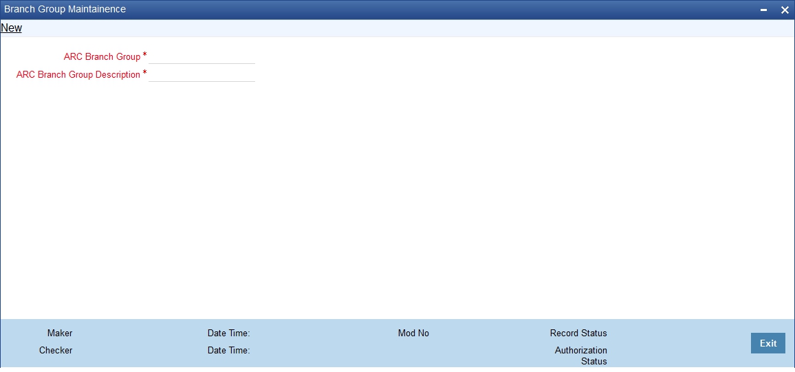

To define branch groups which are equivalent to cities or regions that the bank operates in, invoke the ‘ARC Branch Group Maintenance’ screen by typing ‘STDBRGMT’ in the field at the top right corner of the application tool bar and clicking the adjoining arrow button.
ARC Branch Group
Specify a group code to identify a group of branches.
ARC Branch Group Description
Specify a description for the branch group.
After specifying details in the ‘ARC Branch Group Maintenance’ screen, all the ARC branch groups are displayed in the ‘Branch Parameter Maintenance’ screen (STDBRANC). Select the branch group from the ‘ARC Branch Group’ field.

In the ARC Maintenance screen, fees or charges as a percentage of the transaction amount can be calculated for transactions exceeding the restriction amount. To calculate this fee or charge, you need to select ‘System Entity’ in the ‘Basis Field’ in the ARC Maintenance screen. Thereafter, the ‘Entity Name’ field is enabled which displays values obtained from the ‘Entity Maintenance’ screen. You can invoke this screen by typing ‘STDENMNT’ in the field at the top right corner of the application tool bar and clicking the adjoining arrow button.
Specify the following in this screen:
Entity Name
Specify the entity name to be considered for fee maintenance.
Unit Name
Select a value for charge consideration from the drop down list. The value provided in the drop down list are as follows:
During ARC Maintenance, the following scenarios are considered if exceeded amount is selected:
During ARC Maintenance, the following scenarios are considered if transaction amount is selected
Entity Type
Select the Entity Type from the drop down list. The values provided in the drop down list are as follows:
Parameter
Select the Parameter if ‘Restriction Code’ is selected in the Entity Type field, from the adjoining option list. All active restriction codes as maintained in the system are displayed in this field. For more information on restriction code maintenance, refer to the section ‘Restriction Amount Maintenance’ in the Core Services Module.

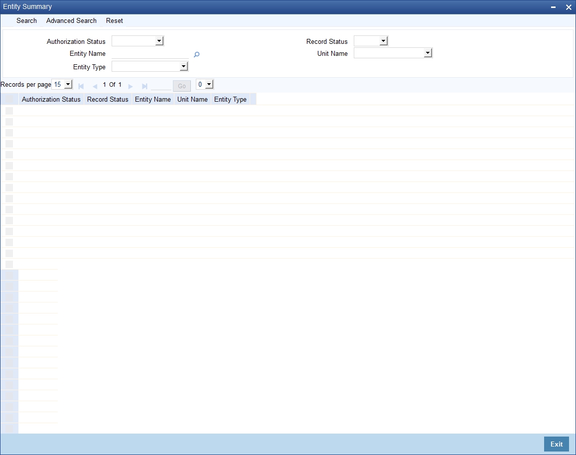

You can view the entity types in the ‘Entity Summary’ screen. You can invoke this screen by typing ‘STSENMNT’ in the field at the top right corner of the application tool bar and clicking the adjoining arrow button.
You can search for entities by specifying values in the following fields:
On updating these details and clicking the ‘Search’ button, the following columns are populated:

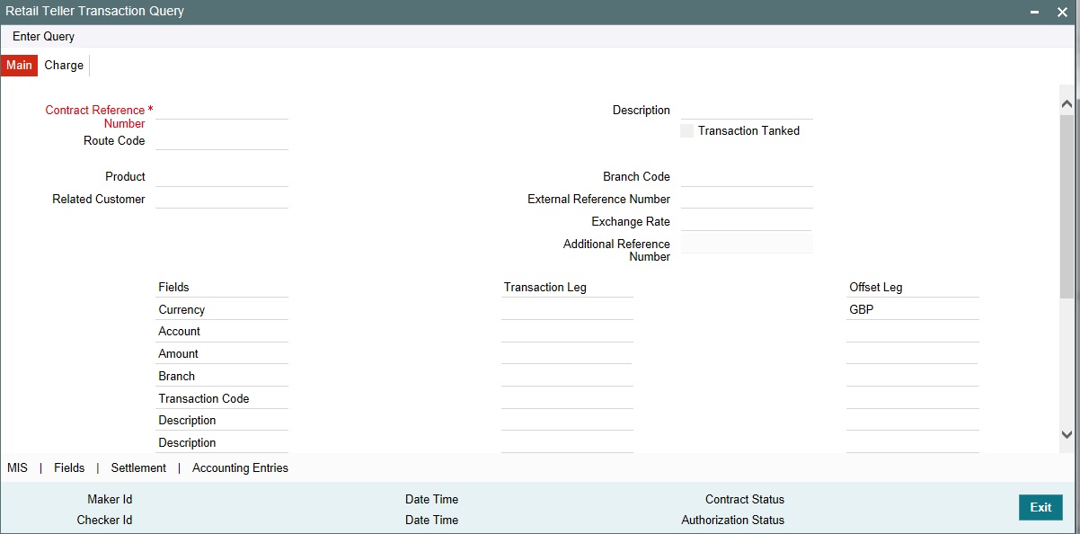

You can view retail teller transactions in the ‘Retail Teller Transaction Query’ screen. Invoke this screen from the application browser.
You can invoke this screen by typing ‘DEDQUERY’ in the field at the top right corner of the Application tool bar and clicking on the adjoining arrow button.
In this screen, you can view the following details for each teller transaction:

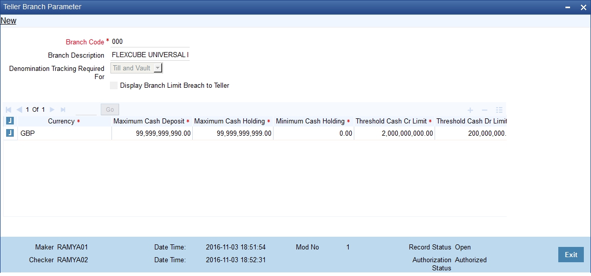

You can maintain branch level cash deposit and cash holding details of Retail Teller. You can invoke this screen by typing ‘STDTBRAN’ in the field at the top right corner of the Application tool bar and clicking on the adjoining arrow button
You can specify the following in this screen:
Branch Code
Select the branch code from the available option list.
Branch Description
System displays the branch description based on selected branch.
Denomination Tracking Required For
Select the denomination tracking preference from the drop-down list. The list displays the following values:
Display Branch Limit Breach to Teller
Check this box to display the branch limit breach to the teller. If you check this box, both till and branch breaching override messages will be displayed to the teller. If you do not select this check box, only till breaching override messages will be displayed to the teller.
Currency
Select the currency code from the available option list.
Maximum Cash Deposit
Specify the maximum deposited cash amount.
Note
Minimum Cash Holding
Specify the minimum cash holding amount.
Maximum Cash Holding
Specify the maximum cash holding amount.
The maximum cash holding amount should not be less than minimum cash holding amount.
Threshold Cash Credit Limit
Specify the threshold amount for cash credit limit.
Threshold Cash Debit Limit
Specify the threshold amount for cash debit limit.

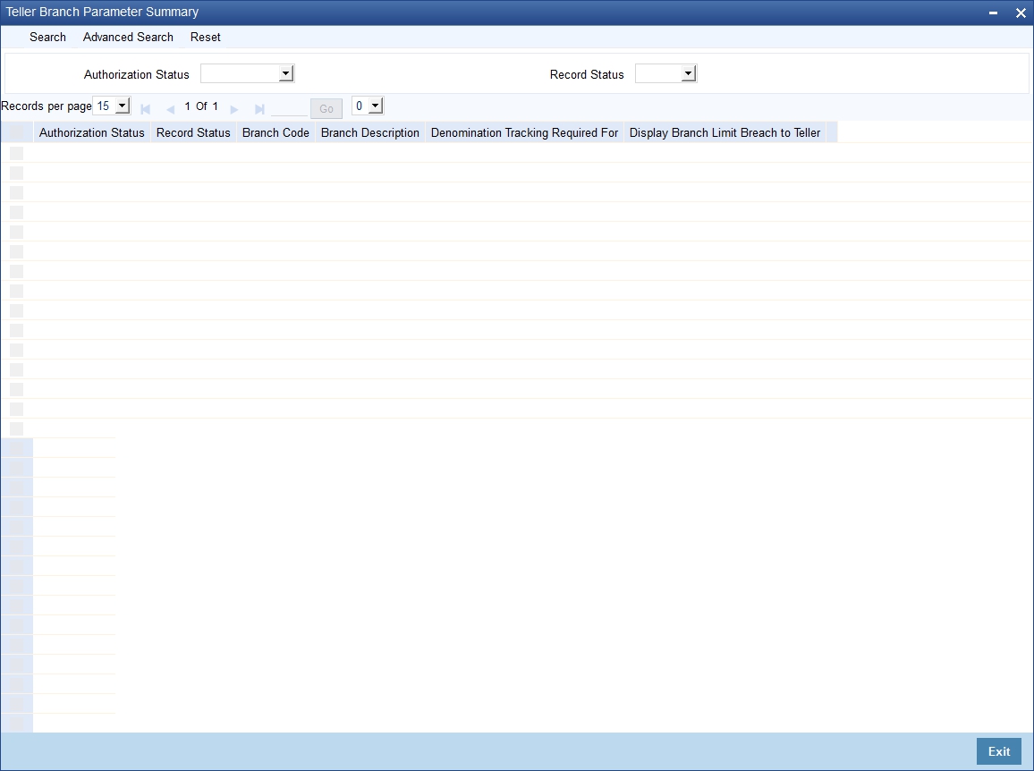

You can view retail teller branch parameters in the ‘Teller Branch Parameter’ screen. You can invoke this screen by typing ‘STSTBRAN’ in the field at the top right corner of the Application tool bar and clicking on the adjoining arrow button.
You can view the following details here:
