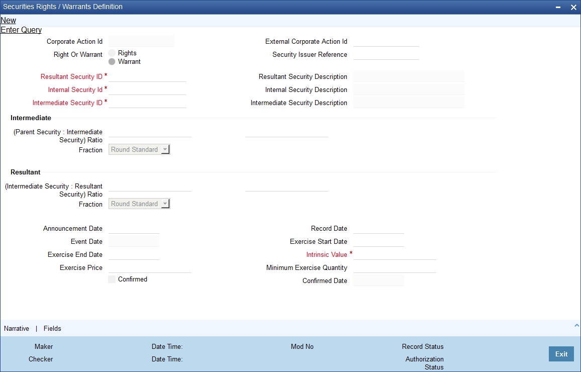

Rights and warrants can be defined through the Securities Rights and Warrants Corporate Action maintenance screen. The details that you maintain here relate to the ratio at which rights and warrants are issued, the resultant security id, the resultant ratio, the exercise start and end date, etc.
You can invoke the ‘Securities Rights/Warrants Definition’ screen by typing ‘SEDXRWDF’ in the field at the top right corner of the Application tool bar and clicking on the adjoining arrow button.
If you are defining details of a new right or warrant, click on new icon from the tool bar. The Rights and Warrants Corporate Action maintenance detailed screen will be displayed without any details.
If you are calling a record that has already been created, click on Summary view. The details of existing records will be displayed in a tabular form. Highlight the record you wish to view and double click on it.
You can specify whether you are maintaining details for Rights or Warrants by clicking on the appropriate button.

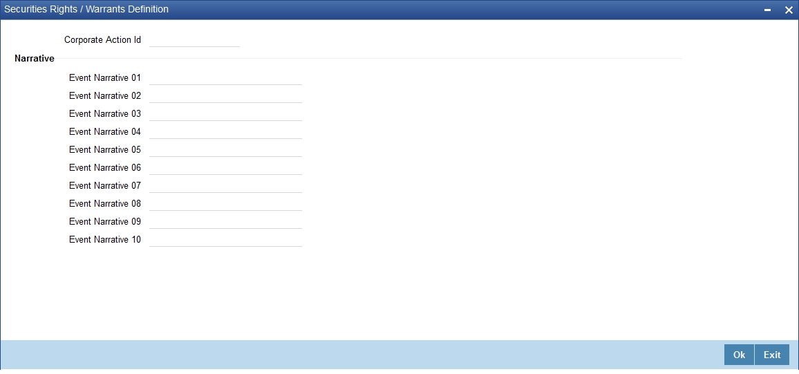

For both rights as well as warrants, you can enter a free format narrative for the event being defined. The narrative or message that you enter here will be used while generating SWIFT messages for Rights/Warrants.
Click on the ‘Narrative’ button, the event narrative screen is displayed.
You have the option of entering a free format narrative for the rights/warrants event or leaving this screen blank. If you choose to define a narrative, it will be associated with the security of rights/warrants type, for which you have defined the event. You can also choose to leave this field blank.
After you have defined the mandatory attributes for a right/warrant, click save in the toolbar or choose Save from the Actions menu to save the record. A message prompting you to confirm the saving of the record is displayed. The Event date is defaulted with the Issue/Tearoff Date as maintained at the Instrument Definition of the respective Right/Warrant Security when you save the record.
Click ‘Exit’ button to exit the Rights/Warrants Definition screen. You will be returned to the Application Browser.

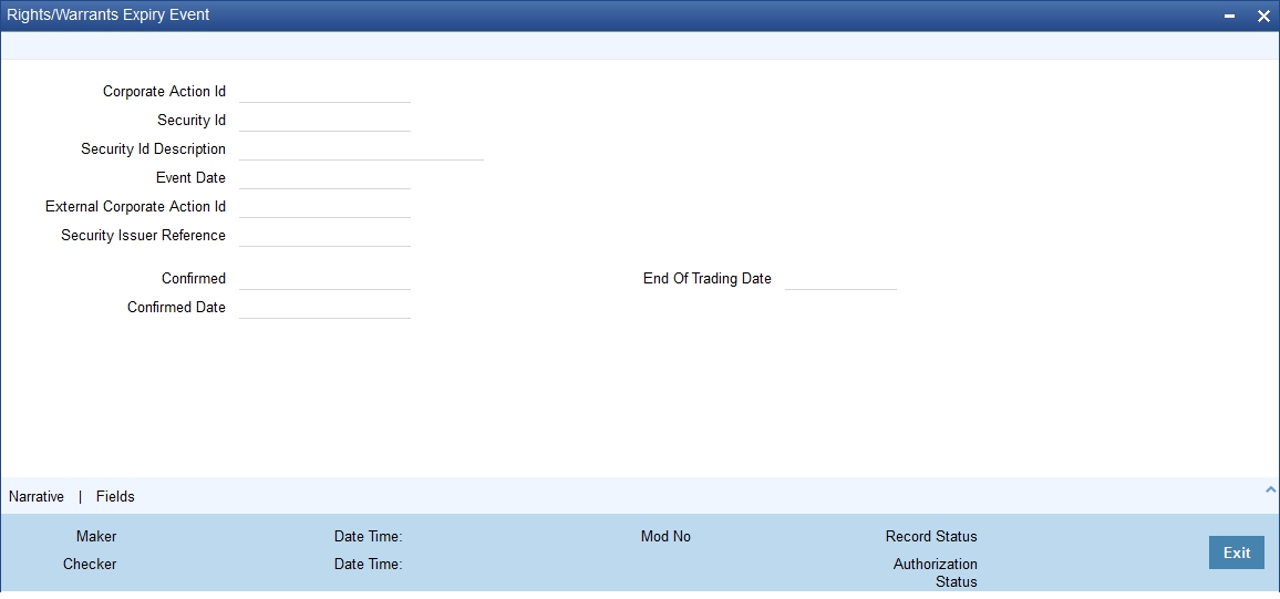

The Rights and Warrants Expiry definition screen, allows the capture of some additional details of an expiry event, for a security of rights / warrants type.
You can invoke the ‘Rights/Warrants Expiry Event’ screen by typing ‘SEDXEXPD’ in the field at the top right corner of the Application tool bar and clicking on the adjoining arrow button.
If you are calling a record that has already been created, click on Summary view. The details of existing records will be displayed in a tabular form. To open a record, double click on it.
You can amend the details of an existing rights/warrants type of security by clicking on the unlock icon in the toolbar or by choosing Unlock from the Actions Menu.
Note
Please remember that you can change the details of an existing rights/warrants type of security only if it is not yet authorized. Once a record is authorized and confirmed it will be processed as of the event date.
The event date or the date on which holdings in the security would expire is picked up from the Security Definition screen. You are only allowed to indicate the date on which, the trading in the rights / warrants security, is to be suspended.
You can indicate that trading is to be suspended on the security, on either the event date or a few days before the event date. For instance, if the Event date is 31 March 2000, you can specify the same end of trading date or specify 28 March 2000 as the date on which, trading in the security is to be suspended.
To define an event narrative, to be used while generating SWIFT messages, click ‘Narrative’ button.The event narrative screen is displayed. To exit from the screen without saving the text, click ‘Exit’ button.

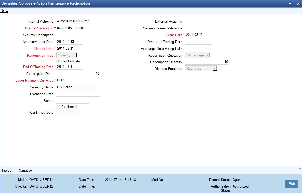

One of the methods of retiring a bond is to redeem it. The Securities Corporate Action Event Maintenance - Redemption screen, allows you to define and maintain details of redeemable securities.
You can invoke the ‘Securities Corporate Action Maintenance Redemption’ screen by typing ‘SEDXREDF’ in the field at the top right corner of the Application tool bar and clicking on the adjoining arrow button.
If you are defining details of a new redeemable security, click new icon from the tool bar. The Corporate Action Maintenance Redemption detailed screen will be displayed, without any details.
If you are calling a redeemable security record that has already been created, click on Summary view. The details of existing records will be displayed in a tabular form. From the Summary screen choose an existing record to open it.
Redemption Type
The Redemption type for a security will be defaulted as defined at the Security Instrument. While defining redeemable securities you can specify the method in which the security is to be redeemed. You can indicate whether the redemption type is to be Bullet, Quantity or Series.
In a bullet type of redemption all the holdings in the security will be redeemed on maturity.
For quantity redemption the nominal held in the security is redeemed by a specific percentage on a date different from the maturity date. While redeeming the security either the face value of the security or the number of units held in the security will be reduced by the percentage you specify.
In a series type of redemption, the holdings in the specified security pertaining to the specified list will be redeemed on a date other than the maturity date.
For securities which are redeemable on call and with redemption type Quantity, you can choose to redeem a specific amount of the face value by entering the requisite percentage/factor or cashflow amount in the ‘Redemption Quantity’ field.
In case of quantity redemption, the nominal value held in a security is redeemed by a specific percentage on a date different from the maturity date. The face value of the security is reduced by the percentage you specify. The total number of units held in the security remains unchanged.
For example, if you are holding 10 units of a security of face value 1000 USD, then, after a quantity redemption of 30%, your holdings will become 10 units at a face value of 700 USD each.
When you insert a redemption schedule, the redemption price of the last schedule is adjusted.
For example, you have initially set up a security for 100% redemption on maturity at a price of 1,200 USD. The face value of the security is 1,000 USD.
Now, you specify a 30% redemption schedule at 360 USD. The system changes the redemption schedule:
FROM the original 100% at 1,200 USD
TO 30% at 360 USD and 70% at 700 USD.
You will have to unlock the Securities Corporate Action Maintenance – Redemption screen and amend the redemption price for the last schedule – in this case, to 840 USD, if you wish to maintain the same total redemption premium. You can, however, change the redemption price of the last schedule to any value that you desire.
When a new redemption schedule is maintained, discount/premium accruals are completed up to the event date using the old yield. The YTM re-computation is done as of the event date.
You can insert back dated redemptions for a security, provided the back-dated redemption does not go beyond the previous coupon payment date. For specifying back dated redemptions, the quantity quotation for the security has to be ‘Nominal’. Also, you should have maintained the security as a callable one is the Security Definition screen. However the effective date cannot be before the last coupon date. Amendment is allowed only for unconfirmed schedules. Secondly, back-dated amendment will not be allowed if the DSTL date falls on or after the event date of the redemption schedule.
In the case of back-dated amendment, corporate action for redemption is processed during End Of Day (EOD) processing. In the case of insertion of back-dated schedule, the redemption processing is done during Beginning Of Day (BOD) processing of the next working day.
Back-dated amendment or insertion of redemption schedules cannot be done beyond the last coupon date.
For example, if the system date is January 18, 2003 and the last coupon payment happened on January 01, 2003, then a back dated redemption schedule can go only as far back as January 01, 2003.
Also, an inserted redemption schedule date must correspond with a coupon payment date. If it does not, then a coupon schedule will automatically be inserted by the system.
For example, suppose that a security has a coupon period from January 01, 2003 to July 01, 2003. The system date is June 15, 2003 and the redemption schedule was inserted on March 31, 2003.
The system breaks the existing coupon period into two:
Note
Any deals booked after the Record Date of the inserted redemption schedule will have to be manually reversed and then re-booked by you after authorizing the inserted redemption schedule. This is because the status of these deals will change from ‘Cum’ to ‘Ex’ due to the insertion of the coupon/redemption schedule.
Following the insertion of the redemption schedule, the system will automatically adjust the ALPL and DPRP events of all deals and rebook them.

In case accruals is due, then the accrual of interest, premium, discount and redemption premium are consolidated by running the ACIN and ACPD events. The liquidation events (RDSL and RDLL) are run only after that. Once you run the accrual event the tax and ICCF details will also get updated.
Note
The initiation collection and disbursement events are synonymous.
If the redemption quotation type is ‘Factor’, then the redemption amount due for the intermediate redemption schedules will be calculated as follows:
Redemption Amt = Holdings * (Redemption factor of previous period – Redemption factor of current period)
If redemption quotation type is ‘Cashflow’, then the redemption amount due for the intermediate redemption schedules will be calculated as follows:
Redemption Amt = Holdings * (Redemption price/Initial FV)
For final redemption, the remaining holdings are redeemed.
On running the YTM recalculation batch, the system recalculates the price of the redemption schedules based on the current coupon rate in case of coupon rate revision.
Note
Batch processing is applicable only for securities under ‘Cashflow’ type of redemption quotation. Recalculation is done only for the redemption schedules on or after the current coupon period.
Securities, which are due to mature end of trading days before the maturity date, will be picked up for the End of Trading processing.
Those securities with the end of trading date less than or equal to today, are picked up and the EOTR event is triggered.
You can amend future-dated redemption schedules. In such a scenario, accruals linked to DPRP event are completed based on the old yield and old cash flows till the application date. New cash flows are built on the application date. The YTM for all the existing deals is recalculated as of the application date based on new cash flows. Also, future accruals linked to DPRP event are calculated based on the new YTM.
During amendment of back-dated redemption schedules, accruals linked to DPRP event are completed based on the old yield and old cash flows till the event date of redemption. New cash flows are built as of the event date. The YTM for all the existing deals is recalculated as of event date based on the new cash flows. For re-computation of YTM, the following formula is used for NPV calculation:
NPV = Face value – Un-accrued Discount + Un-accrued premium.
Future accruals linked to DPRP event are computed based on the new YTM. coupon accruals are also adjusted based on the new face value.
Back-dated redemption processing on amendment is done at EOD.

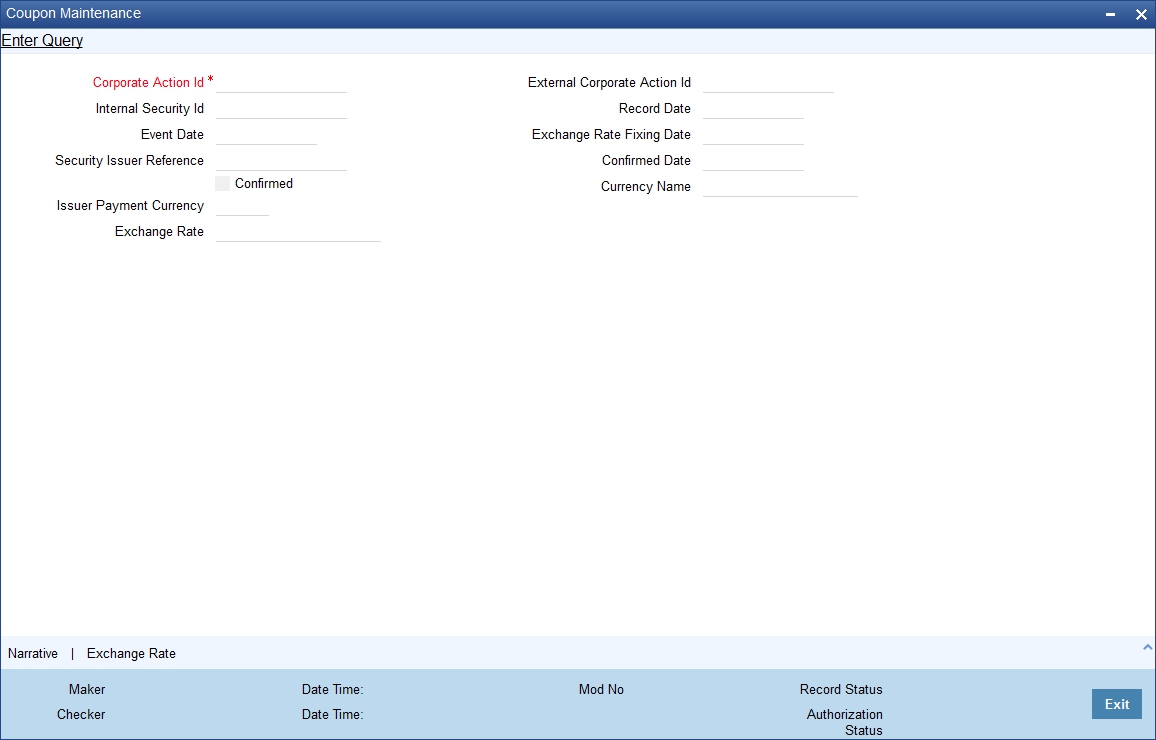

The securities coupon definition screen allows capture of additional details of a coupon event, for a security of bond type. The details that are displayed in this field (such as the Internal action ID, the Internal Security ID and description, the Event date etc.) are picked up from the Security Definition screen.
You are only allowed to amend existing details, like the currency in which the issuer would make the cash payments, the exchange rate between the security currency and the issuer payment currency and the date on which the exchange rate will be announced.
You can invoke the ‘Coupon Maintenance’ screen by typing ‘SEDXCPND’ in the field at the top right corner of the Application tool bar and clicking on the adjoining arrow button.
If you are calling a coupon maintenance record that has already been created, click on Summary view. The details of existing records will be displayed in a tabular form. From the Summary highlight the record you wish to view details of and double click to open it.
To amend the details of an existing coupon, click on unlock icon in the toolbar or choose Unlock from the Actions Menu.
Note
You are allowed only to amend the details of future dated records that are not yet confirmed. Once a record is authorised and confirmed it will be processed as of the event date. You will not be allowed to make any changes to a confirmed record.

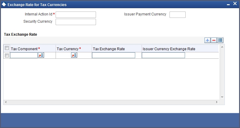

Exchange Rate and the Exchange Rate Fixing Date
If the issuer payment currency is different from the security currency, then you can specify the exchange rate between the security currency and the issuer payment currency. In addition you can also indicate the date on which the exchange rate between the security currency and the issuer payment currency will be announced.
The exchange rate that you define in this screen will be used for conversion when the security is being processed. If no exchange rate has been maintained, then the mid-rate will be used for conversion.
An interest component can be the basis amount tag of one or more tax components. Since each coupon that is maintained can have a number of interest components you need to link each of these components to the tax components.
The interest components can also be in a currency other than the tax currency. Therefore, in addition to linking an interest component with the tax component you need to specify the tax currency. If the currency of the interest component is different from the tax currency, then specify the tax exchange rate.
To link an interest component with a tax component and to specify the tax currency for the exchange rate, click ‘Exchange Rate’ in the Coupon Maintenance screen. The Exchange Rate for Tax Currencies screen is displayed.
You also need to specify the exchange rate between the issuer payment currency and the tax currency.
You can add or delete a tax component from the list of tax components maintained. To add a new component, click add icon and select the new component from the picklist. To delete an existing tax component, highlight it and click delete icon.
You can maintain a free format message, of the coupon event. This narrative or message will be used while generating SWIFT messages. Click ‘Narrative’ button, the Event narrative screen is displayed.
In this screen, you can either enter a free format narrative for the coupon event or leave this screen blank. If a narrative is defined, it will be associated with the security of bond type for which the coupon event has been defined.

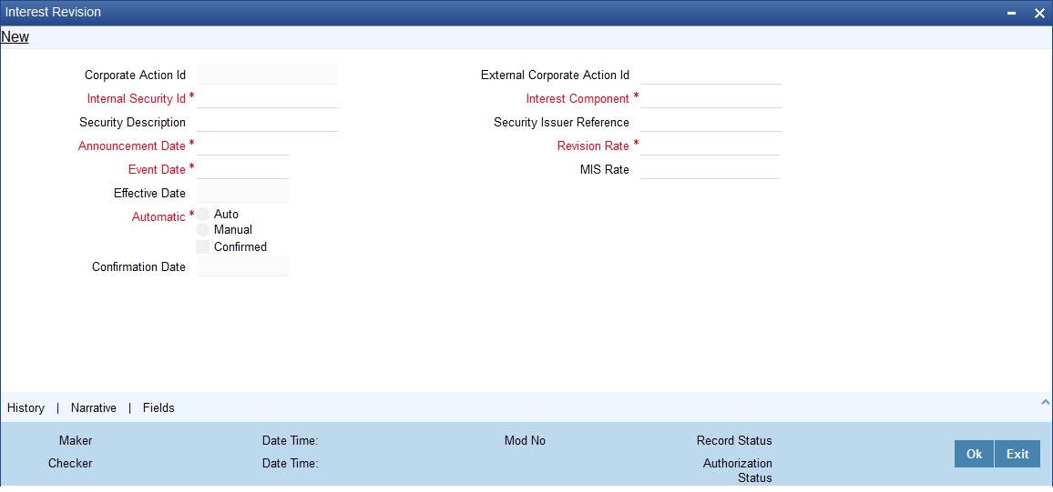

You can capture the interest rate revision details for a security that has already been defined, through the Interest Revision screen. You can capture details like the date on which the interest rate was announced, the date on which the interest rate revision would be processed and the value date of rate revision.
You can invoke the ‘Interest Revision’ screen by typing ‘SEDXRVND’ in the field at the top right corner of the Application tool bar and clicking on the adjoining arrow button.
To enter interest rate remission details, click new icon on the toolbar.
If you are calling an interest revision record that has already been created, click on Summary view. From the summary screen you can choose to open an existing record. The details of the record that you have created will be displayed in a tabular form.
Corporate Action Identification
This is the system generated ID to uniquely identify the interest revision.
External Corporate Identification
This is the Id assigned to the event at the time of event declaration. Enter the Id associated with the event to uniquely identify it.
Issuer Reference
Indicate the issuer reference for the interest rate revision event.
Announcement Date
Enter the date on which the issuer would have declared the interest revision event.
Event Date
Each Rate Revision defined is having a event date from when it will be applicable. From this date the interest revision rate will be effective.
MIS Rate
For the Securities module you only have the option of maintaining a fixed rate for MIS refinancing.
Enter the MIS refinance rate in this field.
Confirmed
Check this box to indicate if the occurrence of the event is confirmed.
Confirmation Date
When you select the check-box, and save the record the confirmation date will be defaulted with the current date.
Parent Security Identification
You have to indicate the code or ID of the bond type for which you are defining the interest revision rate.
The Security ID or Code is picked up from the Security Definition screen. This short description of the security is for information purposes only and will not be printed on any customer correspondence.
Interest Component
You can specify the component of the security for which you are defining the interest revision rate.
At the time of defining a security, you can maintain different interest components for the security. The interest component(s) maintained will be reflected in the picklist available for this field.
Effective Date
Each rate that is defined for a Security ID and Interest Component combination should have an Effective Date associated with it. This is the date from which the interest revision rate will be effective. Once a rate comes into effect, it will be applicable till another Effective Date is defined for the same Security ID and interest component combination. When you save a record the effective date gets defaulted with the Event Date of Rate Revision.
While specifying the interest revision rate, you can indicate whether the interest revision for the particular security is to be automatic or manual. If automatic revision is specified, then revised rates will be applied and liquidations made as part of the Beginning of Day process. Otherwise revisions will have to be made manually by you.
Revision Rate
The revision rate that you enter here will be effective as of the Value date defined.
You can also enter a free format narrative, of the interest rate revision event. This narrative or message will be used while generating SWIFT messages. Click ‘Narrative’ button, the Event Narrative screen is displayed. The message entered will be associated with the interest revision event. This field can be left blank if necessary.

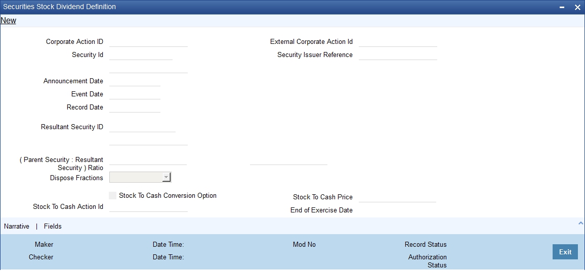

In the Stock Dividend or Bonus Definition screen, you can maintain details of the stock dividend declaration event, for a security. The essential details that you need to capture for a security include the resultant Security ID and the dispose fraction. Details like the stock to cash price, the issuer pay currency and the end of exercise date can be captured only if you specify that stock is to be converted to cash.
You can invoke the ‘Securities Stock Dividend Definition’ screen by typing ‘SEDXDVDF in the field at the top right corner of the Application tool bar and clicking on the adjoining arrow button.
To maintain details of a new declaration, click new button on the toolbar.
If you are calling an event record that has already been created, click on Summary view. The details of the existing event records will be displayed in a tabular form.
From the Summary screen you can choose to open an existing record by double clicking on it.
When you click on the new icon the system automatically assigns a unique internal action ID to the corporate event. The system date is defaulted as the date on which the dividend event was announced.
However the Announcement Date or the date on which the event was declared can be changed to a previous date.
This is the system generated ID to uniquely identify the declaration of Stock Dividend.
External Corporate Action Identification
Specify the code or ID of the of equity type security for which the dividend declaration is being defined. The codes displayed, in the picklist available for this field are picked up from the Security Definition screen.
Security Issuer Reference
Indicate the issuer reference number for the stock dividend event.
Announcement Date
This is the date on which the issuer would have declared the stock dividend event.
Enter the announcement date of the event.
Event Date
Enter the date on which the cash payment will be made by the issuer.
Record Date
Enter the date on which the issuer determines the beneficiary eligible for the dividend based on the registered owner of the securities.
The Record Date is computed from the ex days set up defined for the local market of issue.
Resultant Security Identification
Indicate the security of the equity type in which shares would be awarded.
Resultant Ratio and Dispose Fractions
Select the of equity type of security in which shares should be awarded. After this you are required to specify the ratio of, the quantity of the new security awarded to the quantity of current holdings, in the existing security.
Also indicate how the fractional elements in the parent security should be handled. You can choose the following options:
Options |
Description |
Retain |
The fractional units would be retained |
Round Up |
Entitlements will be rounded up to the next full unit |
Round Down |
Entitlements will be rounded down to the previous full unit |
Round standard |
If the fractional unit is above 0.5, entitlements will be rounded up to the next full unit, otherwise the entitlements will be rounded down to the previous full unit. |
Stock to Cash Conversion
Check this option to convert stock dividend declared to cash. In such a case you are required to specify, the date by which the stock to cash conversion option, is to be exercised.
In addition, also specify the price per unit. This is the price at which the stock dividend would be converted into cash.
Stock to Cash Price
Enter the price at which the stock dividend would be converted into cash.
End of Exercise Date
Enter the date before which the stock to cash conversion option is to be exercised.
Stock to Cash Action Identification
This is a unique event ID which is generated by the system on saving the Stock Dividend Definition record.
Issuer Pay Currency
In case of stock to cash conversion you can indicate the currency in which the issuer should make the cash payments. From the picklist available select the payment currency.
Confirmed
Check this box to indicate that the occurrence of the event is confirmed.
Confirmed Date
When you select the check-box, and save the record the confirmed date will be defaulted with the current date.
Exchange Rate
When the issuer payment currency is different from the security currency, the exchange rate between the security currency and the payment currency has to be indicated.
Specify the exchange rate.
This is the date on which the exchange rate will be announced. Indicate the exchange rate announcement date.
Note
You can enter a free format event narrative for the event being defined or leave this field blank. If you enter a free format text it will be associated with the event while generating SWIFT messages.
After entering the relevant details click save icon in the toolbar or Save from the Actions Menu, to save the event record.

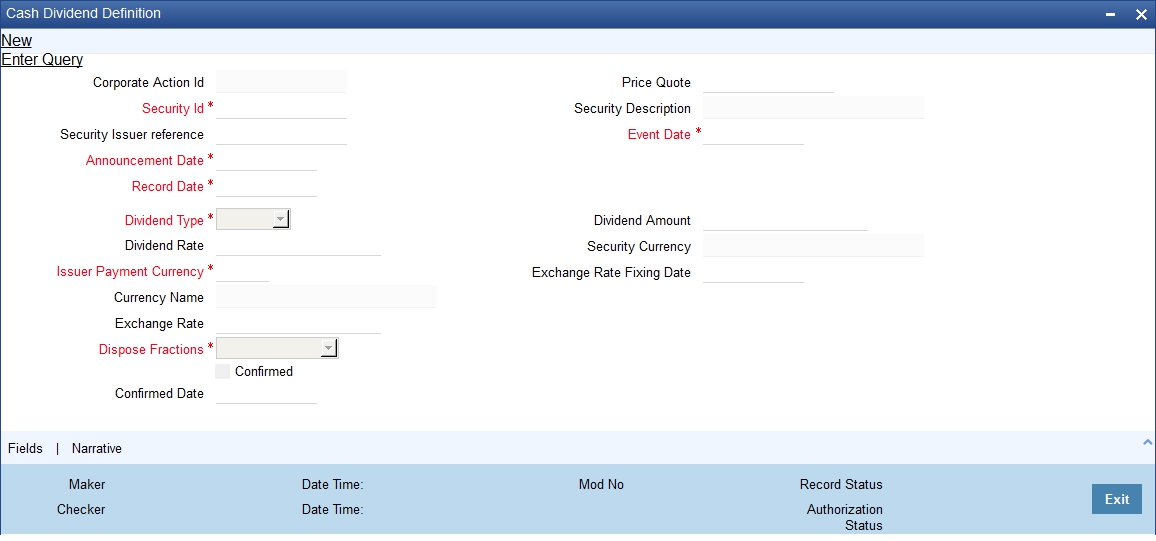

The details of a cash dividend declaration can be captured through the Cash Dividend Definition screen. Through this screen you can capture relevant details such as the dividend type (rate or amount), the issuer payment currency, the exchange rate and the rate fixing date.
You can invoke the ‘Cash Dividend Definition’ screen by typing ‘SEDXCDVD’ in the field at the top right corner of the Application tool bar and clicking on the adjoining arrow button.
You can create a new record by clicking on new icon on the toolbar.
You can call an event record that has already been created, through the Summary View screen. From this screen choose an existing record and double click it. The details of the highlighted record will be displayed in a tabular form.
This is the system generated ID to uniquely identify the declaration of Cash Dividend.
Specify the security Id of the equity type for which the cash dividend event is to be defined.
The description associated with the specified code will be displayed in the adjacent field.
Indicate the issuer reference for the cash dividend event.
Announcement Date
This is the date on which the issuer would have declared the cash dividend event.
Event Date
Record Date
Dividend Type
You can indicate the type in which the dividend amount should be declared. It could be a percentage of the face value of the security or it could be the amount per unit of the security.
Dividend Amount
This field indicates the amount per unit.
Specify the amount per unit to be used in calculating the cash dividend.
Dividend Rate
This field indicates the rate as a percentage of the face value. Enter a percentage of the face value to be used in calculating the cash dividend.
Issuer Payment Currency
Indicate the currency in which the issuer will make the cash payment. Click the adjoining option list for a list of valid currency codes. Select the appropriate.
Dispose Fractions
Indicate how fractions should be handled. The options available are:
Retain |
Fractions will be retained as they are |
Round Up |
Entitlement will be rounded up to the next full integer |
Round Down |
Entitlement will be rounded down to the previous full integer |
Round Standard |
Entitlement will be rounded up to the next full integer if the fraction is greater than 0.5. Else it will be rounded down to the previous full integer. |
Confirmed
Confirmed Date
Exchange Rate and Exchange Rate Fixing Date
When the issuer payment currency is different from the security currency, the exchange rate between the security currency and the payment currency has to be indicated. Along with this, the date on which the exchange rate will be announced should also be entered.
Only those records, which have been authorised and confirmed, will be picked up for processing.

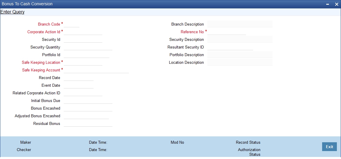

When you specify that stock is to be converted to cash, in the Stock Dividend definition screen, details of that event will be picked up and stored as, a Bonus to Cash conversion record. You are only allowed to maintain some additional stock to cash conversion details, such as the bonus to be encashed, the total bonus encashed, the residue bonus due. This is maintained so on in the Bonus to Cash conversion screen.
Invoke this screen by clicking on Bonus to Cash and then on the Detail option, under Securities CA Maintenance. This is invoked from the Application Browser. To view the details of a previously created record, go to the Summary View screen. The details of existing records are displayed in a tabular form. Highlight the record you want to view of and double click it.
You can invoke the ‘Bonus to Cash Conversion’ screen by typing ‘SEDXBNCS’ in the field at the top right corner of the Application tool bar and clicking on the adjoining arrow button.
In the Bonus to Cash conversion main screen enter the security ID, the portfolio ID and the SK location Id from where bonus due, is to be received.
Branch Code
Specify the branch code.
Corporate Action ID
This is the system generated ID to uniquely identify the declaration of Stock Dividend. This value is defaulted.
Reference Number
This is the system generated ID to uniquely identify the Corporate action of Stock to cash conversion.
Security Id
This is the security Id of the equity for which the bonus to cash details are being maintained.
The description associated with the specified code is displayed in the adjacent field.
Security Quantity
This is the quantity of security for which the bonus was declared.
The resultant security Identification to which shares have been awarded is defaulted here.
Portfolio Id
This is the portfolio ID of the equity for which the bonus to cash conversion details are being defined.
Stock Keeping Location
This is the SK location where the security is lodged and for which cash payment is to be received.
Stock Keeping Account
This is the account number which is to be credited when the payment due is received.
Record Date

Initial Bonus Due
This field indicates the bonus amount that is due to be paid.
Bonus Encashed
You can choose to convert either a part of or the entire bonus that is due. Specify the amount to be encashed, in the Bonus to be Encashed field. If you choose to encash only a part of the amount due, then the residue bonus will be automatically calculated and displayed, in the Residue Bonus Due field.
Assume that you have a holding of 500 units in a particular security. Bonus is declared in the ratio of 2:1. Therefore, you are liable to get 250 units of shares free.
If you indicate that bonus is to be encashed for 125 units only then the remaining 125 units, which need to be encashed, will be reflected in the Residual Bonus field. You can choose to encash them at a later date.
Adjusted Bonus Encashed
The adjusted bonus is calculated by the system and displayed in this field.
The calculations are such that, the net bonus encashed minus the adjusted bonus will be equal to the initial bonus.
Residual Bonus
If the bonus is encashed in parts then the residual amount due is displayed here.

Coupon |
Click on this icon to view the coupon details. This is a view only screen, you are not allowed to modify any details displayed here. The coupon events are displayed only for a corporate action event coupon. |
