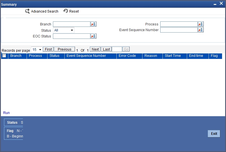

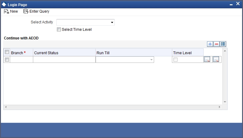

To run the Batch process, invoke the ‘End of Day Batch Process’ screen.
You can invoke the ‘End of Day Batch Process’ screen by typing ‘AEDEODST’ in the field at the top right corner of the Application tool bar and clicking on the adjoining arrow button.
The system picks up the batch in accordance with the mandatory batch programs maintenance. Click ‘Ok’ button to run the batch. To exit the screen without running the batch, click on the ‘Exit’ button.
Once you have run the batch, the system will prompt you to verify the status of the activity from the monitor screen. The screen displays the details as shown.

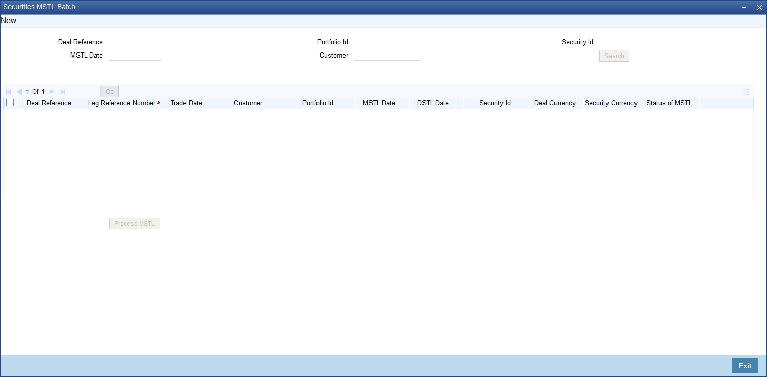

If the account has sufficient balance during the day, you can manually process MSTL using 'Securities MSTL Batch' screen.
To invoke this screen, type ‘SEDINTBT’ in the field at the top right corner of the application toolbar and click the adjoining arrow button.
Based on one or more of the following criteria, you can search for the transactions within the current branch that failed during EOD or BOD operations.
MSTL Date
If you wish to filter the search results based on the MSTL date, specify the date here. The system will show all the transactions which are not processed till this date.
Customer
If you wish to filter the search results based on the customers, specify customer number whose details will be displayed. The system will show all the transactions of a respective customer for those MTSL that failed.
Portfolio
You can choose to search the deals of a particular portfolio. Specify the portfolio ID.
Security ID
You can choose to search the deals of a security code and process the code of MSTL based on this.
Deal Reference
You can choose to search the deals based on deal reference number and process the MSTL for a single deal.
Once you click ‘Search’ button, the system displays the list of deals that match the selection criteria. Click ‘Process MSTL’ button to manually process MSTL for the selected deals.
You can process the records based on the filter criteria. However you cannot process selective records.
