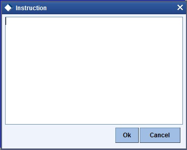

5.1.4 Capturing Details of Instruction
You can key-in the details of the instruction that is to be associated with particular Account/Customer in a free format text format. Click the icon positioned next to this field.
The Instruction Details screen will be displayed. Key-in the instruction and click on the ‘Ok’ button.

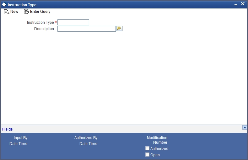

5.2 Instruction Types
5.2.1 Maintaining Instruction Types
While maintaining the details of a special instruction, you have to associate the instruction with an appropriate instruction type as per the nature and purpose of the special instruction. Therefore, you need to categorize instructions into different types.
You can do this through the ‘Instruction Type’ screen. You can invoke this screen by typing ‘SIDINSTR’ in the field at the top right corner of the Application tool bar and clicking the adjoining arrow button.
In this screen, you have to specify an appropriate name to group together a set of instructions that share a common purpose. For instance, let us assume that you have maintained an instruction type called Misc-PR with the description – Miscellaneous Public Relations activity.
You are maintaining three separate special instructions in the SI Diary maintenance screen. The details of each are as follows:
Special Instruction I
You would like to send birthday greeting to Mr. Silas Marner before the 25th of January 2001 wishing him on his birthday.
Special Instruction II
You would like to send a New Year card to Mrs. Wendy Klien before the 30th of December 2001, greeting her on the occasion of the New Year.
Special Instruction III
You would like to send a congratulatory message to Mr. Sandy Brown on the purchase of his new car since he has availed of your car finance scheme.
You can associate all three of these instructions under the single Instruction Type Misc-PR, since the purpose and nature of all the three instructions is the same – it is a public relations activity for your bank and it is miscellaneous in nature.

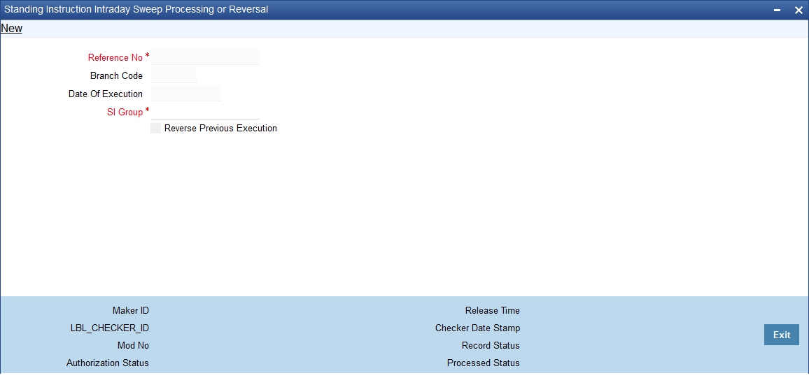

5.3 Intraday Sweep Processing/Reversal
5.3.1 Maintaining Instruction Intraday Sweep Processing/Reversal
You can maintain the instruction for processing an intra day sweep or reverse the previous execution using this screen. To invoke this screen, type ‘SIDINDPR’ in the field at the top right corner of the application toolbar and click the adjoining arrow button.
In this screen, you can specify the following details:
Reference No.
The system displays the reference number. It is a unique number which is system generated every time this screen is invoked.
Branch Code
The system displays the branch code.This will be the current branch code.
Date of Execution
The system displays the date of execution. This will be the current system date.
SI Group
Specify the SI Group to be processed or reversed. Alternatively, you can select the SI group form the option list. The list displays all the opened and authorized SI groups maintained in the static type maintenance under the type ‘SIGROUP’.
Reverse Previous Execution
Check this box to reverse the intra day sweep transaction of the selected SI group. If left unchecked, the system processes the selected intra day sweep.
On authorization of the record, the processing/reversal of the intra-day sweep will start. Record status will be updated as ‘Processed’ if the execution/reversal of the record was complete else it will be displayed as Un-Processed’
For a branch and SI group combination, if an intraday sweep processing/reversal is either in ‘Un-processed’ or “Un-authorized’ status, then another processing/reversal record cannot be created. Before the Mark-EOTI stage, all the records should be in ‘Processed’ status for the branch.
