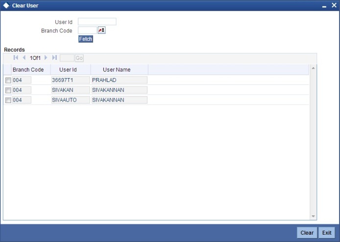

Sometimes you may require to force-logout a user from Savings. You can do this if you are a supervisor with the necessary rights to logout a user from the branch. The supervisor also has the facility to force log off all the users at any given point of time. Typically, the force-logout right is given to only one administrator role user in the branch.
You can invoke the ‘Clear User’ screen by typing ‘CLRU’ in the field at the top right corner of the Application tool bar and clicking the adjoining arrow button. The following screen will be displayed:
You can search for the users based on the following parameters:
Once you have specified the parameters click 'Fetch' button. The system lists the following details of the users who have logged into the application:
To force log out a user, check the box against the relevant user record and click 'Clear' button. The system will display a message to confirm the clear operation. To force log out all the users in a page, check the box against the header row, which will select all the users in the page. Further click the 'Clear' button. The selected users are logged off from the application.

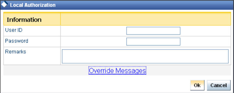

Local Authorization
The supervisor can authorize the transactions from the teller screen by entering the ID and password. In case of local authorization, the authorizer can allow or cancel the transaction. The following screen is used for local authorization:
The authorizer can only view the transaction details here. He or she will have to enter the following details:
Userid
Specify the user ID of the authorizer.
Password
Enter the password to authorize or reject the transaction.
Remarks
Specify some remarks pertaining to the transaction.
Click ‘OK’ button to authorize the transaction. On successful validation of the User ID and password, the transaction will proceed to the next stage as per workflow. The validations for User ID will be same as in Remote Auth. The user credential validation includes ‘Holiday Maintenance’ check also. However, if you click ‘Cancel’ button, the transaction will move to unassigned queue.
You can view the override messages by clicking ‘Override Messages’.
Note
Local Authorization option is not available when user authentication is via Single Sign On (SSO).

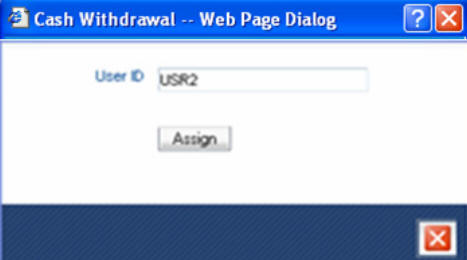

In this type, the Maker will assign the transaction to an authorizer using theRemote Authorization screen. This screen will appear during the appropriate stage as per the Workflow definition.
In this screen, the Maker has to specify the name of the authorizer and then click the ‘Assign’ button. Upon successful assignment, a confirmation message “Successfully assigned to OFFICER” with the name of the assignee is displayed.
The authorizer, to whom the Maker assigns the transaction, will see the same in the pending Tasks List from where he/she can fetch the transaction for approval or rejection, as the case may be.
Irrespective of whether the supervisor approves or rejects, the transaction will be re-assigned to the Maker. If the supervisor approves, the Maker can fetch and see the response from his/her Task List.

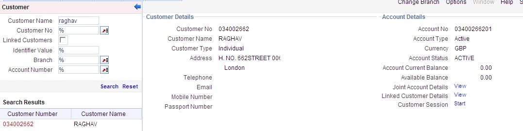

In Savings, you have the facility to process multiple transactions for the same customer without having to key in the customer and account details every time. You can achieve this by starting a Customer Session after logging into the Savings.

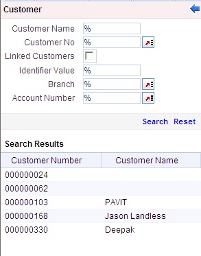

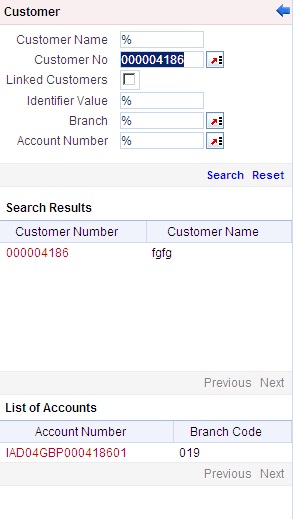

To start a Customer Session, go the Customer Search frame and search for a customer.
In this screen, you have to enter any search criteria for whom multiple transactions have to be processed and then click on the ‘Search’ button. The system will display the details of the selected customer in a format as shown above.
When you click on the hyperlink provided for ‘Customer Name’ in the screen above, the account details of the customer will be displayed in a separate screen, as shown below also the following customer details are displayed:
The system will list all the accounts created for the selected customer. The following account details are displayed on click of any Account no:
On selecting a loan account, the following summary details of the loan account will be displayed:
To set a customer for a session, click ‘Start Session’ button.The message “Do you want to set this Account Number and Details to the Session?” is displayed.
Click ‘OK’ if you wish to process multiple transactions for the account. The system will display “Customer session is opened for Account Number 100000001, Customer Number: DMP003IND” message to confirm the same.

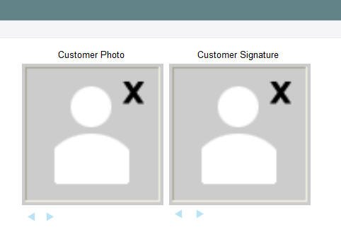

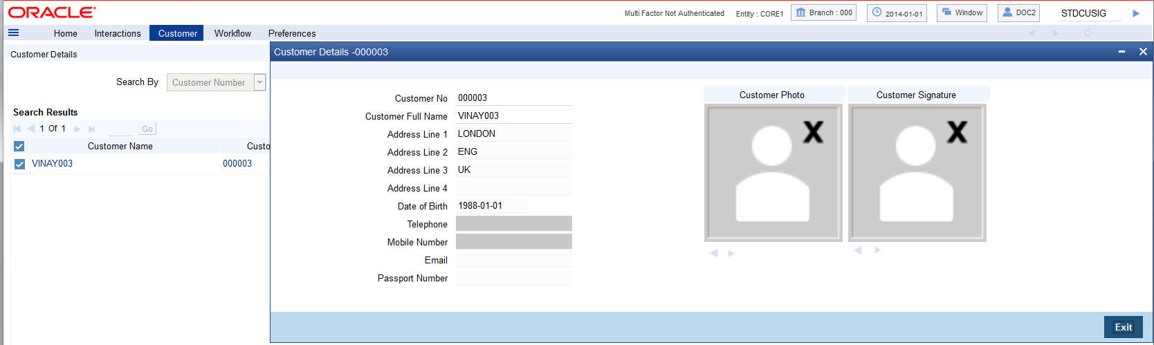

The page also contains the customer’s Image (including those of other signatories of the account), if available, and the Operating Instructions etc. will be displayed, as shown below:
You can go through the signatory details and view all customer Photos and customer signature images using the Links ’Prev‘and ’Next’.

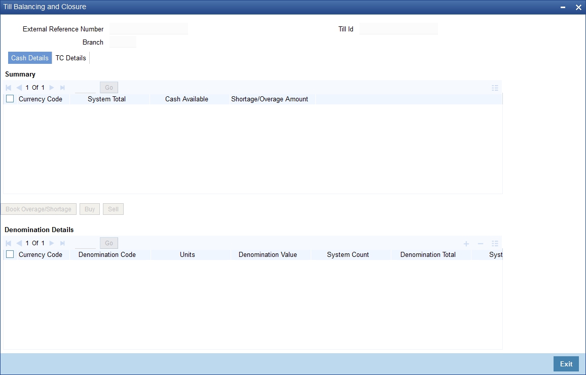

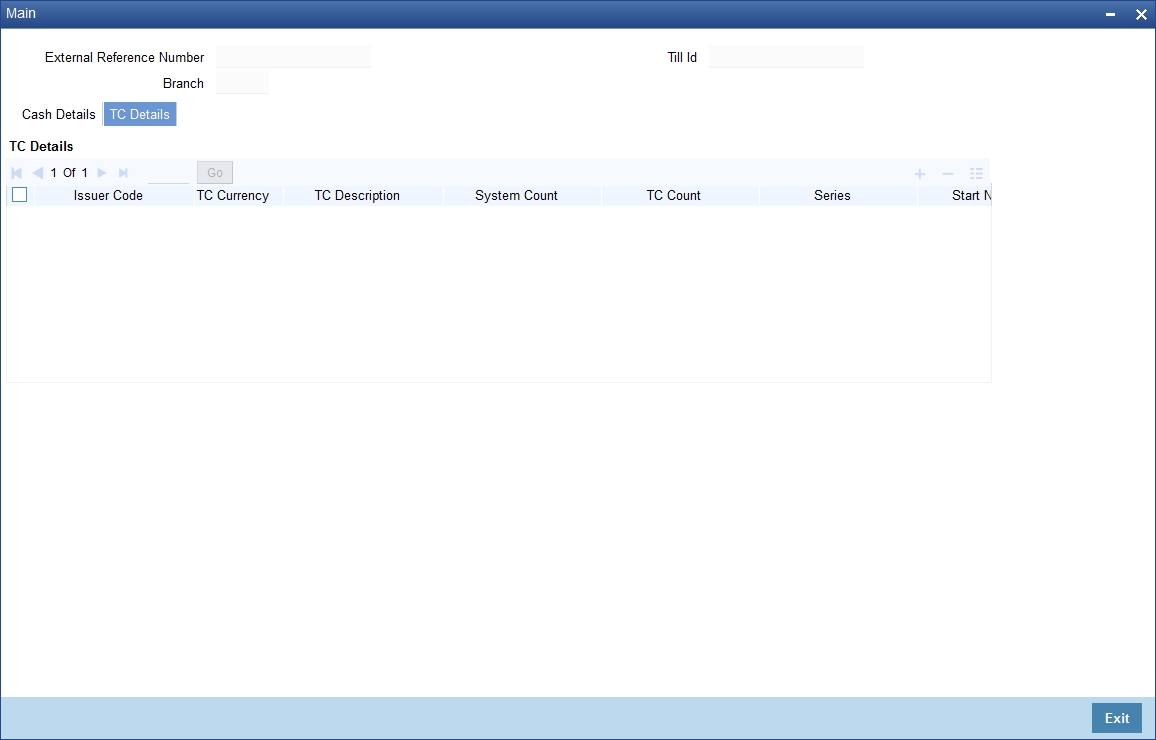

You can balance and close a Till through the ‘Till Balancing and Closure’ screen. You can launch the ‘Till Balancing and Closure’ screen by typing ‘TVCL’ in the field at the top right corner of the Application tool bar and clicking the adjoining arrow button.
The following information is available in this screen:
External Reference
This is a system generated sequence number for the transaction.
Till Id
The identification code assigned to the corresponding teller’s Till.
Branch Code
The system specifies the code of the corresponding branch.
The following information is specified in ‘Cash Details’ tab:
Currency Code
The system displays the currency code.
System Total
The system displays the total value of individual currencies used by the corresponding teller.
Cash Available
The system displays the current balance of the Till.
Shortage/Overage Amount
If the number of units for the individual currencies and the corresponding system count does not match with the denomination details, the system will display the corresponding Shortage or Overage Amount.
Book Overage/Shortage
To book the Overage/Shortage Amount, select the corresponding currency and click on the ‘Book Overage/Shortage’ button. In case of Shortage amount, it will launch the 7551 screen and in case of Overage amount, it will launch the 7552 screen.
Buy
Select the corresponding currency and click on the Buy button to invoke the ‘Buy Cash From Central Bank’ screen with the selected currency as the default currency. The function id of this screen is 9009.
Sell
Select the corresponding currency and click on the Sell button to invoke the ‘Sell Cash To Central Bank’ screen with the selected currency as the default currency. The function id of this screen is 9010.
Denomination Details provides the following information:
Update Overall Position
After booking the shortage/overage units, click the ‘Update Overall Position’ button to update the system count with the latest shortage/overage units.
TC Denomination details are available in ‘TC Details’ tab. The field values are defaulted with the currency values handled by the corresponding teller.
The system displays the following information:
After capturing the required details, click the ‘OK’ button to continue. If the balancing is correct, the Till closure is initiated. The system will confirm with the message “Transaction Completed Successfully”.
The till closure has to be authorized by another user having sufficient privileges. This feature can be enabled by checking ‘Default Authorization’ checkbox at Workflow for the function ID ’TVCL’.

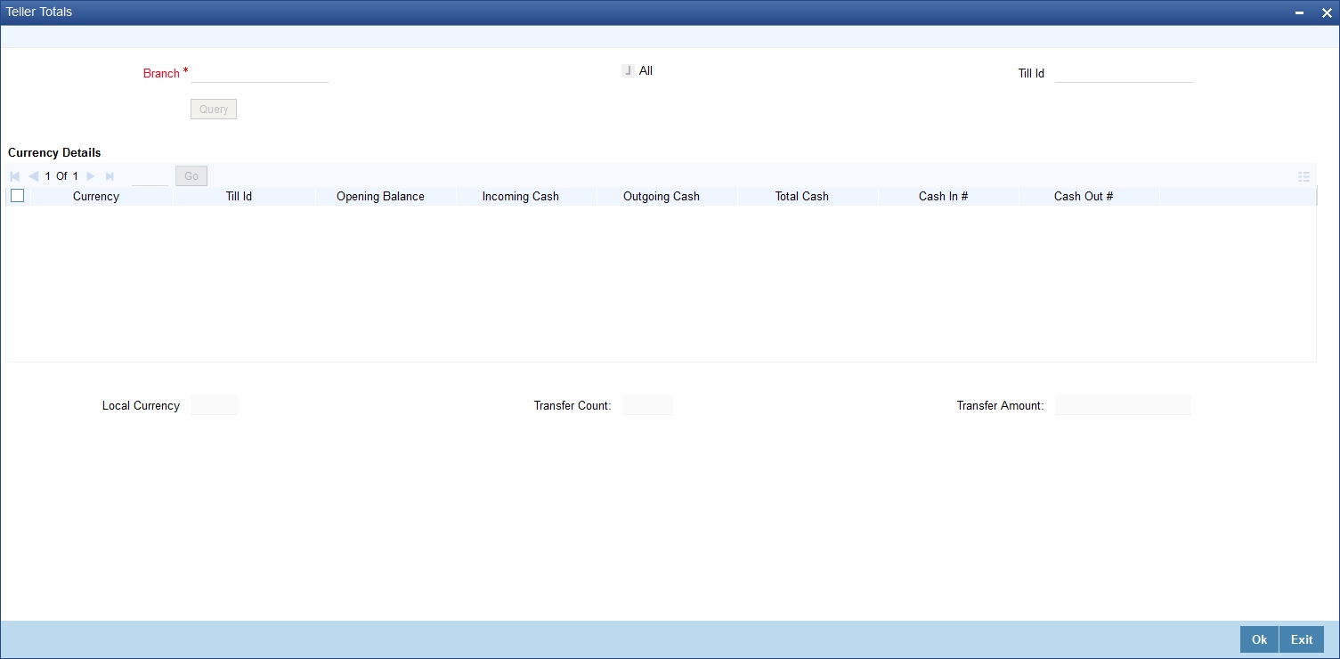

You can view the cash and transfer details from the ‘Teller Totals’ screen. The system will display the vault’s cash details for a customer in the corresponding branch. You can invoke the ‘Teller totals’ screen by typing ‘TLTT’ in the field at the top right corner of the Application tool bar and clicking the adjoining arrow button.
The screen consists of the following fields:
Branch Code
The system defaults the Branch Code of the corresponding branch. However, you can modify the branch code as per the requirement.
All
The system checks the ‘All’ check box, by default. It displays the details of all the Till Ids in the corresponding branch.
Till Id
If you specify a Till Id, you will be able to query the details of the corresponding Till Id.
Currency
The system displays the currency of the cash transaction.
Till Id
The system displays the Till Id of the corresponding Till.
Opening Balance
The system specifies the opening balance of the Till id.
Incoming Cash
The system specifies the incoming cash for the corresponding currency.
Outgoing Cash
The system specifies the outgoing cash for the corresponding currency
Total Cash
The system specifies the total amount available in the corresponding account. The total amount is calculated with the following equation:
Total Cash = Opening balance + (Incoming cash – Outgoing cash)
Cash in#
The system specifies the count of the cash deposits for the corresponding Till.
Cash Out#
The system specifies the count of the cash withdrawals for the corresponding Till.
Local Currency
The system displays the local currency of the logged-in account.
Transfer Count
The system displays the total count of the cheque and transfer transactions.
Transfer Amount
The system displays the total amount of the cheque and transfer transactions.
Clicking ‘Query’ button, the system validates if all the mandatory details are specified. This button will be disabled after the first click.
