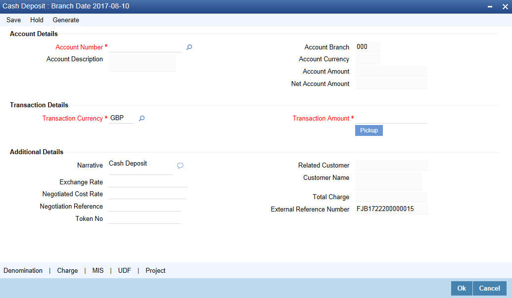

You can capture a cash deposit transaction through the ‘Cash Deposit’ screen. You can invoke this screen by typing ‘1401’ in the field at the top right corner of the Application tool bar and clicking on the adjoining arrow button.
The cash deposit can be done in single step or two step process. The single step process is the single screen approach. For the single step cash deposit, the teller accepts the cash and accounting entries are passed in a single step. In two step process, the teller just collects the information and posts the transaction where no accounting entries are passed. The cashier accepts the cash and then the accounting entries are passed in the second step.
You can also specify Virtual Accounts in this screen. These virtual accounts can be used as a routing account to credit the underlying physical account.
If a virtual account number is specified in this screen, then the F10, F11, and F12 keys will not display any value, however the following error messages will be displayed for each of these keys:
Click the OK button and you will be able to proceed further with the transaction.
Here the teller can capture the following details:
Account Number
Physical Account Number:
Specify the customer account number into which the cash needs to be deposited. You can also select an account number from the list displayed by clicking on the adjoining option list.

Transaction Amount
Specify the amount that should be credited to an account in terms of transaction currency. If the account to be credited is a Trust account, this amount should be within the cash deposit limit defined for the credited account class.
Pickup
Click on pickup to default the data into the Denominations, Charges, MIS, UDF and Project details. It is mandatory to click on ‘Pickup’ button before save.

The system displays ‘Cash Deposit’. You can modify it, if required.

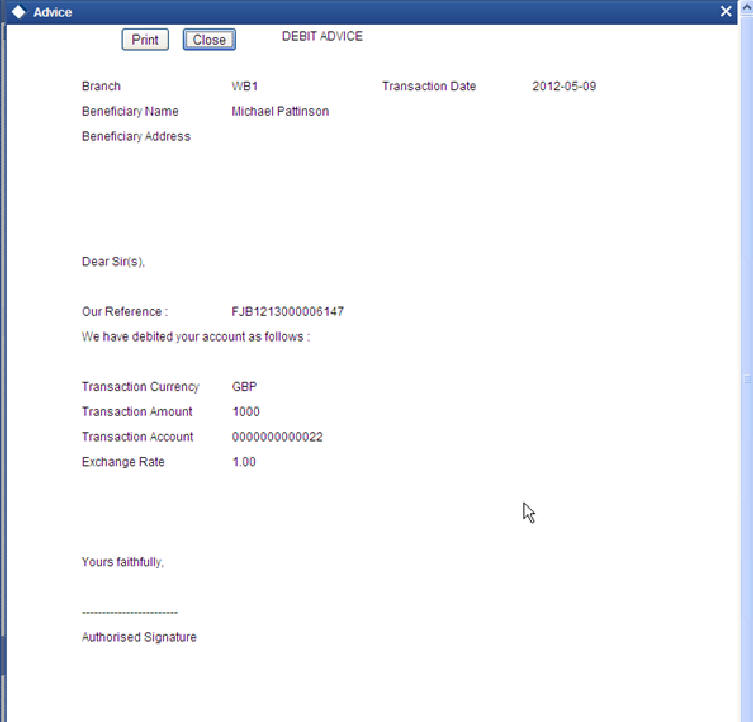

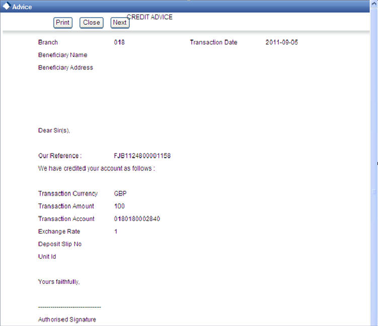

The system generates the advice on click of ‘OK’ button or save after providing all the details.

You can generate a transaction slip by clicking on ‘Generate’ button after providing account number, transaction amount and clicking on pickup button. It is produced to the customer to sign and confirm the transaction.
Note
When Duplicate Advice Tracker field is checked and you click the EXIT button on the advice generation screen, the system displays a message “Print Successful?”. Click OK button to confirm the successful printing. Every subsequent print of the advices will be considered as duplicate advice. For more information on Duplicate Advice Tracker refer to section “Messaging Branch Parameters Maintenance” in the Core User Manual

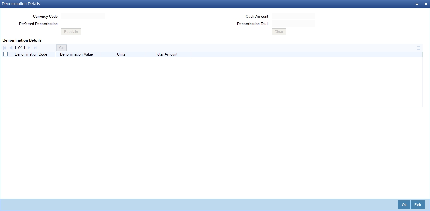

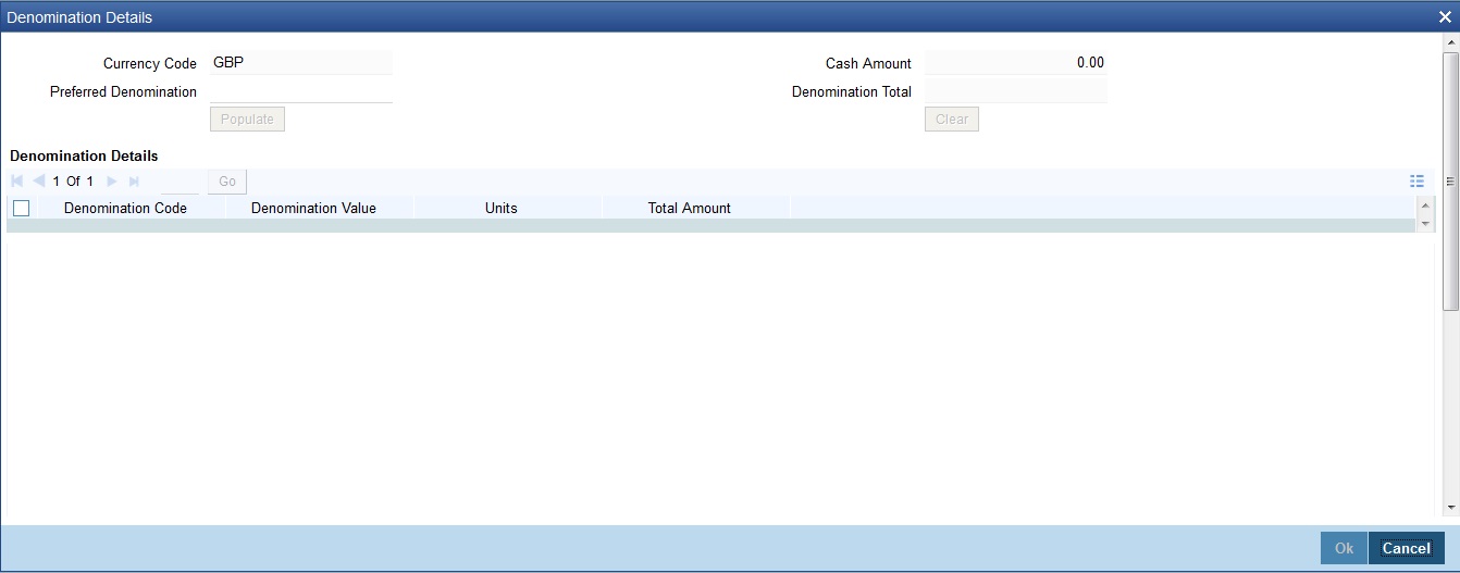

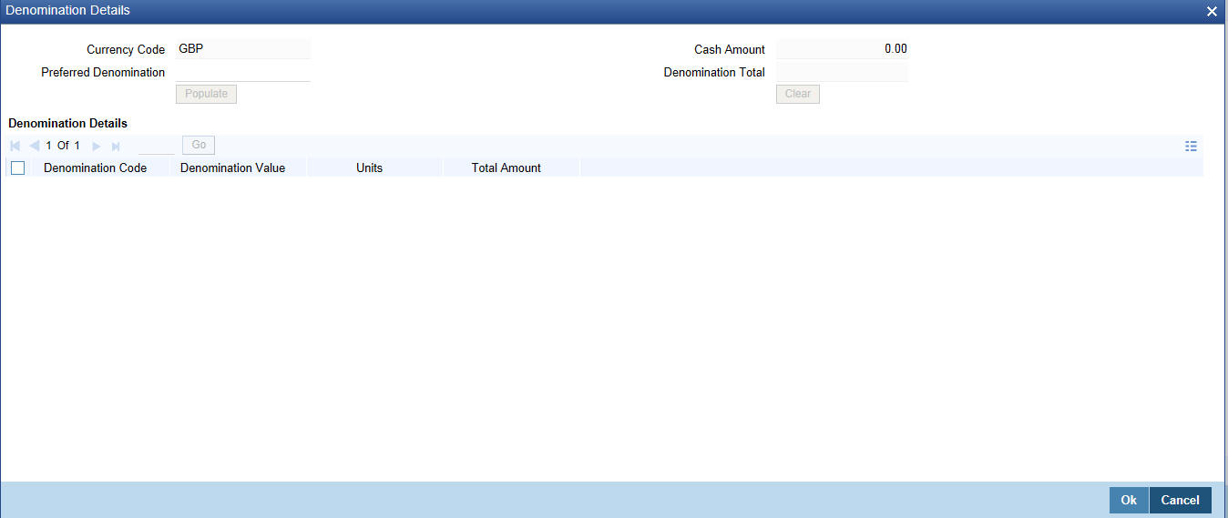

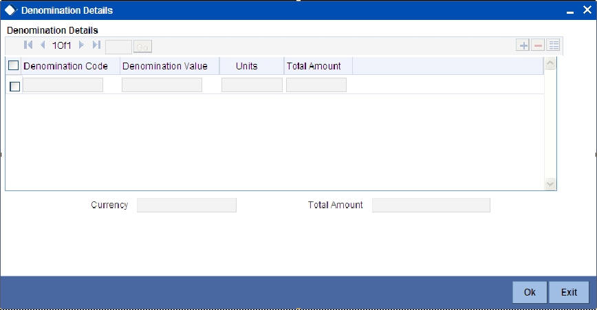

In this block, you can capture details of the currency denominations involved in the transaction through the following fields:
Currency Code
The system displays the currency of the account.
Cash Amount
The system displays the amount for which the denominations have to be captured.
Preferred Denomination
Specify the preferred denomination.
Denomination Total
The system displays the total denomination.
Denomination Code
For every currency, the various denominations are assigned separate denomination codes. These codes are displayed here.
Denomination Value
The system computes the face value of the denomination and displays it. For instance if the denomination code represents a USD 100, the value will be displayed as ‘100’.
Units
Indicate the number of units of the specified denomination. By default, till contents are incremented for inflow transactions like cash deposit. To reverse this default behaviour, you can specify units in negative.
Total Amount
The system computes the denomination value by multiplying the denomination value with the number of units. For instance, if the denomination code represents a USD 100 and the number of units is 10, the denomination amount will be ‘1000’.
Click ‘OK’ to validate the denominations with the cash amount. If you click on ‘Cancel’ then the data specified will not be available.

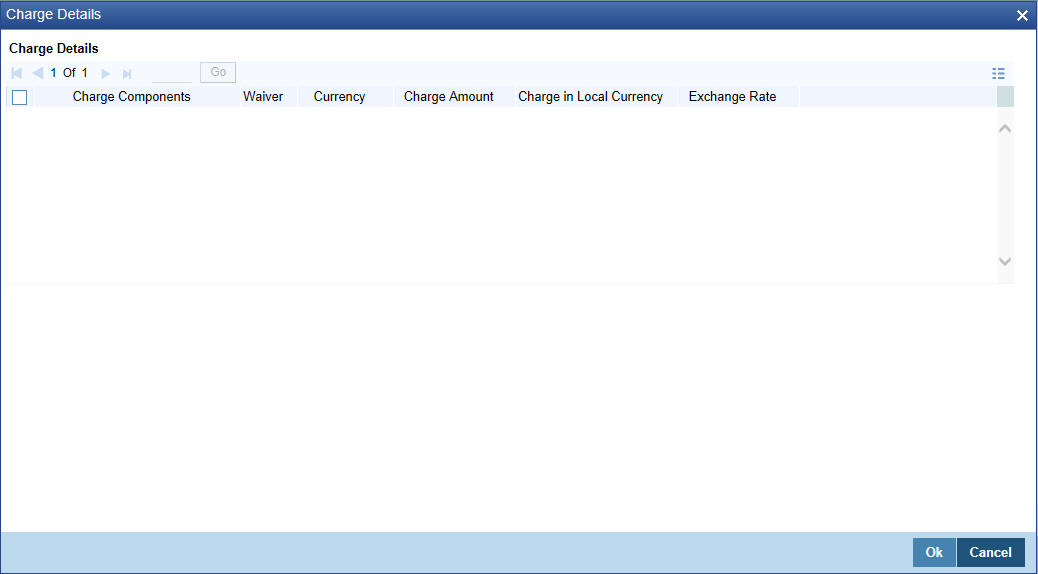

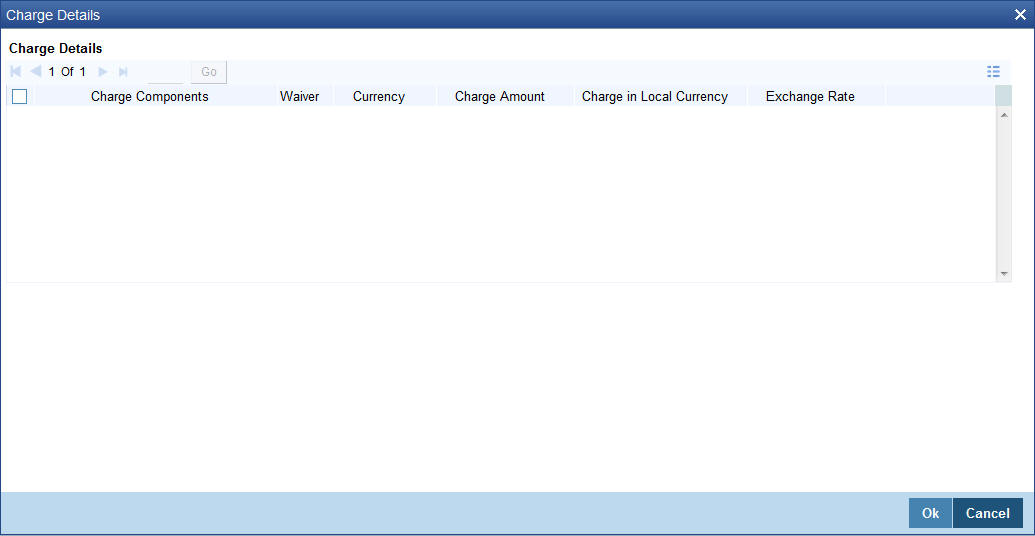

This block allows you to capture charge related details. Click on ‘Charges’ button to invoke the following screen.
Here you can capture the following details:
Charge Component
The system defaults the charge components applicable to the transaction.
Waiver
You can waive a certain charge for the customer by checking this box against the charge component.
Currency
The system displays the currency in which the charge has to be deducted.
Charge Amount
The system displays the charge amount to be deducted for the corresponding charge component. You can edit the amount.
Charge in Local Currency
In case the transaction currency is different from the local currency, the system will compute the local currency equivalent of the charge and display it here.
Exchange Rate
The exchange rate used for the currency conversion is displayed here. If the charge currency is the same as the transaction currency, the system will display ‘1’ as the exchange rate.
You can modify the charges by clicking on the charges button. You can edit the charge amount and Click “OK” button. The system displays the new charges in the main screen against ‘Total Charge’, which subsequently updates the changes in ‘Net Account Amount’ too.

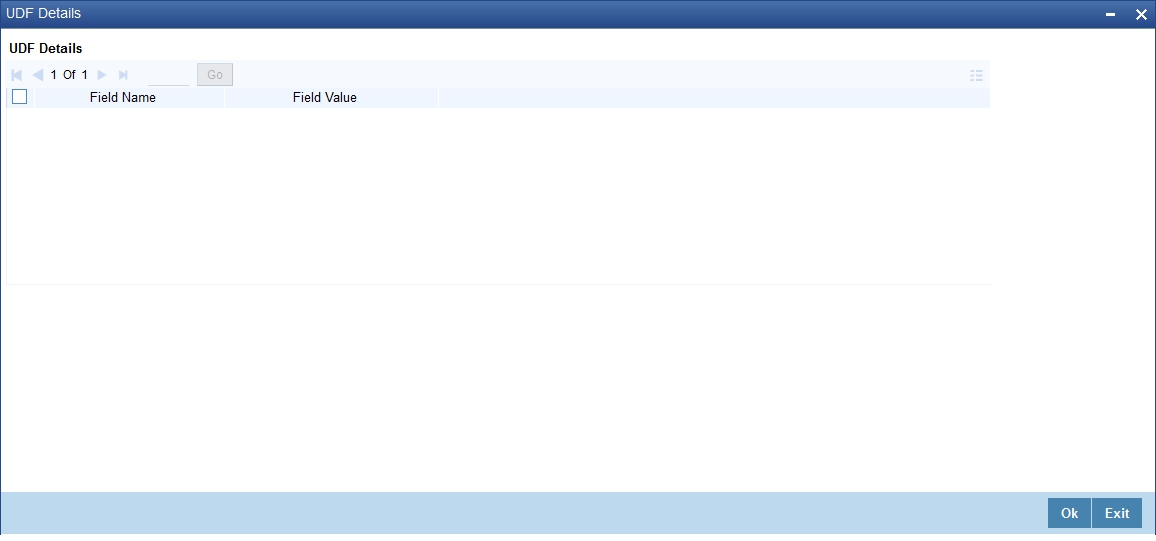

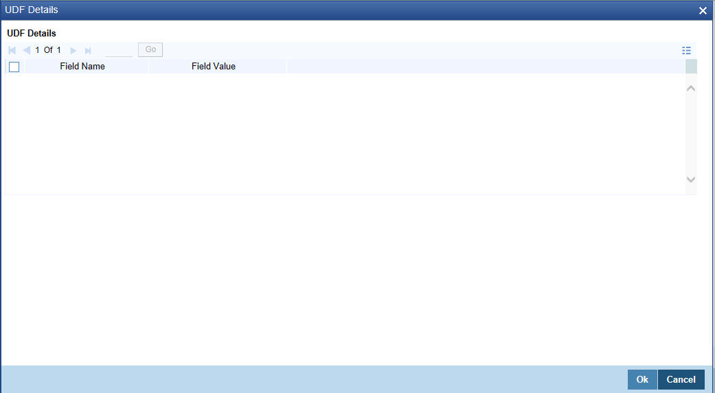

You can capture the UDF details under ‘UDF’ button.
Field Name
The system displays the various User-Defined Fields (UDFs) that you have maintained for the product in the Host.
Field Value
Specify the value for the each UDF that is displayed.

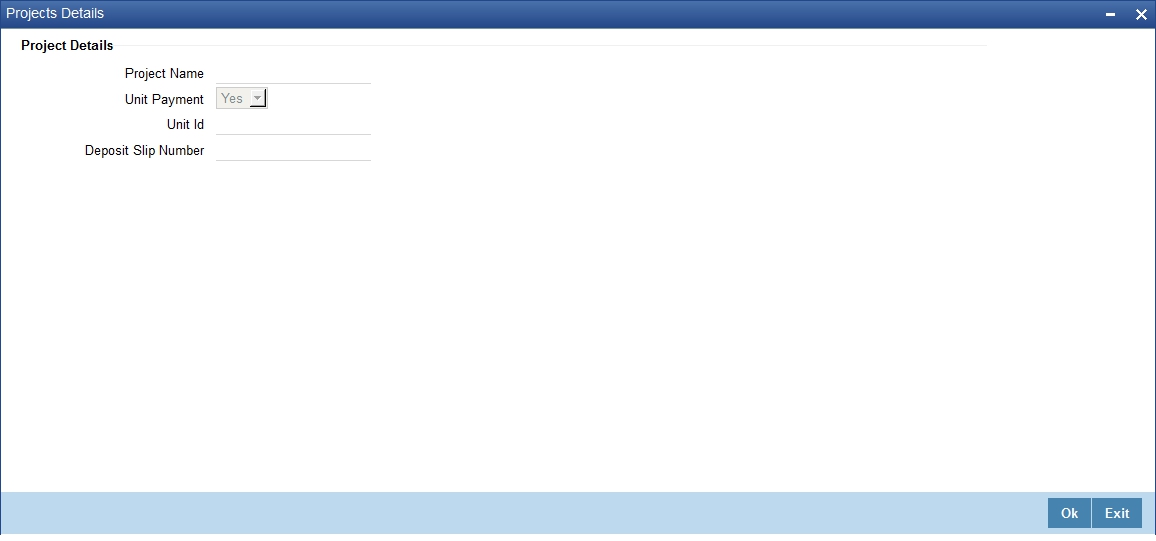

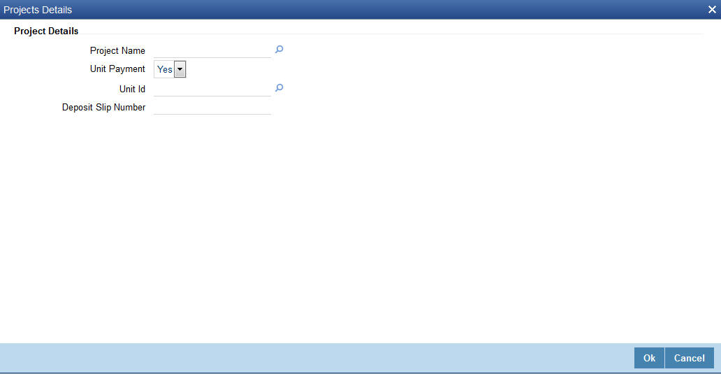

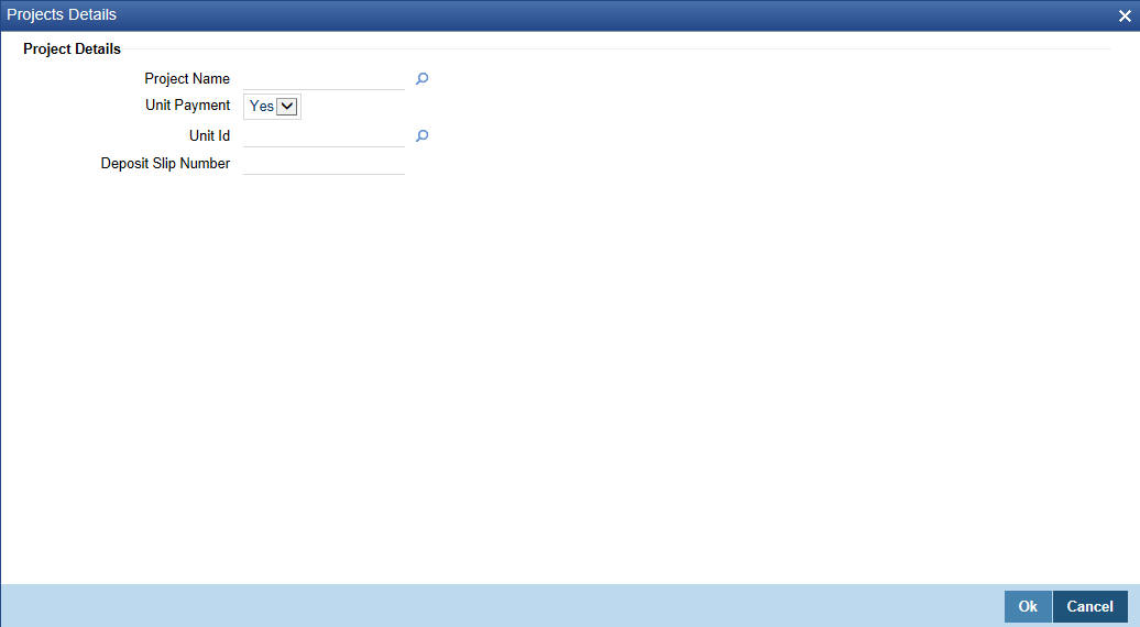

You can capture project details under ‘Project Details’ button. Note that this button will be applicable only if the cash is being deposited in a Trust account.
Specify the following details:
Project Name
Specify the developer project name for which payment is being made. The adjoining option list displays all valid projects maintained in the system. You can select the appropriate one. Input to this field is mandatory.
Unit Payment
Indicate whether the transaction is a unit payment or not by choosing the appropriate value from the adjoining drop-down list. The following values are available:
Unit ID
Specify the unit ID of the project. This field will be enabled only if you have selected ‘Yes’ against ‘Unit Payment’. The adjoining option list displays all unit IDs along with the unit holder names corresponding to the project name chosen. You can select the appropriate one.
Deposit Slip Number
Specify the deposit slip number for the payment.

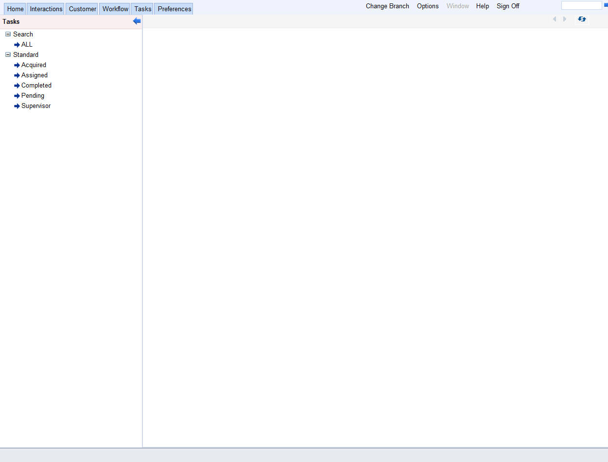

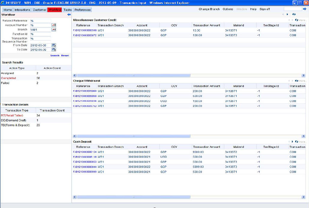

The supervisor can view the transactions pending authorization in his or her task list as shown below. You can view this list by choosing the ‘Workflow’ option in the application.
The person needs to click on the ‘Assigned’ option to view all transactions assigned to you.
In case of auto assign, the transaction will get assigned to all the eligible authorizers as per the assignment criteria maintained at your branch. All these eligible supervisors will be able to view these transactions in their ‘Pending Tasks’ lists. The first authorizer to fetch the transaction from his or her task list will lock the same and then can either approve or reject it. This process is similar to the remote authorization flow described earlier. You can view the tasks that are approved by other supervisors in the ‘Approved’ lists and also you can view the history of authorization in the ‘Auth-History’ lists.
Irrespective of the supervisor’s action (approve or reject), the transaction will be re-assigned to the maker.
You can fetch and see the response from your task list.

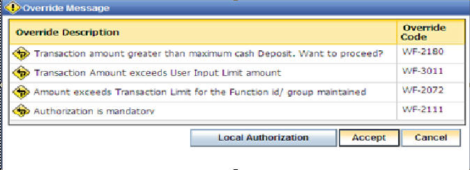

When overrides are raised by the system and have to be approved, the teller will have the option to choose between remote and local authorization. By default remote authorization will be selected. If the teller wants local authorization then the choice has to be made explicitly.

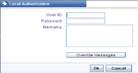

In case of local authorization, the authorizer can allow or cancel the transaction. The following screen is used for local authorization:
The authorizer can only view the transaction details here. He or she will have to enter the following details:
User Id
Specify the user ID of the authorizer.
Password
Specify the password with which he or she can either authorize or reject the transaction.
Remarks
The authorizer can specify some remarks pertaining to the transaction.
Click ‘OK’ button to authorize the transaction. On successful validation of the User ID and password, the transaction will proceed to the next stage as per workflow. The validations for User ID will be same as in Remote Auth. The user credential validation includes ‘Holiday Maintenance’ check also. However, if you click ‘Cancel’ button, the transaction will move to unassigned queue.

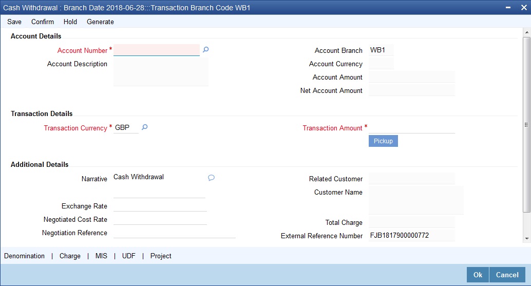

You can capture a cash withdrawal transaction through the ‘Cash Withdrawal’ screen. You can invoke this screen by typing ‘1001’ in the field at the top right corner of the Application tool bar and clicking on the adjoining arrow button.
Note
When you press the ‘Tab’ key, you can move from one field to another based on the order of field alignment. The cash withdrawal can be done in single step or two step process. The single step process is the single screen approach. For the single step cash withdrawal, the teller disburses the cash and accounting entries are passed in a single step. In two step process, the teller just collects the information and posts the transaction. In the first step accounting entries will be passed where the customer accounts will get debited. The cashier accepts the cash and then the accounting entries are passed in the second step. In two step process accounting entries will be passed in steps 1 and 2.
Account Number
Specify the customer account number into which the cash needs to be deposited. Upon keying the account number, the system will default the Account Number, Account Branch and Account Currency for the corresponding account.
Note
In case of multiple accounts with the same account number, the system will pop-up a list of account numbers with account branch to select.
Account Branch
The system displays the logged-in branch. If you specify another account number and tab out of the Account Number field, the system displays the corresponding account branch.
Account Description
The system displays the description of the account number chosen.
Transaction Currency
The system displays the local currency. If you specify another account number and tab out of the Account Number field, the system displays the currency associated with the specified account.
Account Currency
Transaction Amount
Specify the amount that should be debited from account in terms of transaction currency. If the account to be debited is a Trust account, this amount should be within the cash withdrawal limit defined for the debited account class.
Pickup
Account Amount
The system displays the transaction amount in terms of account currency.
Total Charge
The system computes the charges applicable for the transaction and displays it here.
Net Account Amount
The system displays the net amount to be debited from the account (in the account currency) after calculating the applicable charges. This amount depends on the charge method – whether inclusive or exclusive.
Related Customer
The system defaults the related customer.
Customer Name
The system defaults the customer name.
Exchange Rate
The system displays the exchange rate used to convert the transaction currency into account currency. If the transaction currency is the same as the account currency, the system will display the exchange rate as ‘1’.
Negotiated Cost Rate
Specify the negotiated cost rate that should be used for foreign currency transactions between the treasury and the branch. You need to specify the rate only when the currencies involved in the transaction are different. Otherwise, it will be a normal transaction.
Negotiation Reference Number
Specify the unique reference number that should be used for negotiation of cost rate, in foreign currency transaction. If you have specified the negotiated cost rate, then you need to specify the negotiated reference number also.
Note
Oracle FLEXCUBE books then online revaluation entries based on the difference in exchange rate between the negotiated cost rate and transaction rate.
Token No
Specify the token number.
Narrative
The system displays ‘Cash Withdrawal’. You can modify it, if required.
Click OK button or save after providing all details to generate advice with token number.
External Reference Number
The system generates a unique number based on the branch specific sequence number generation logic and displays it here. The Host system identifies a branch transaction with the external reference number.
Account Amount

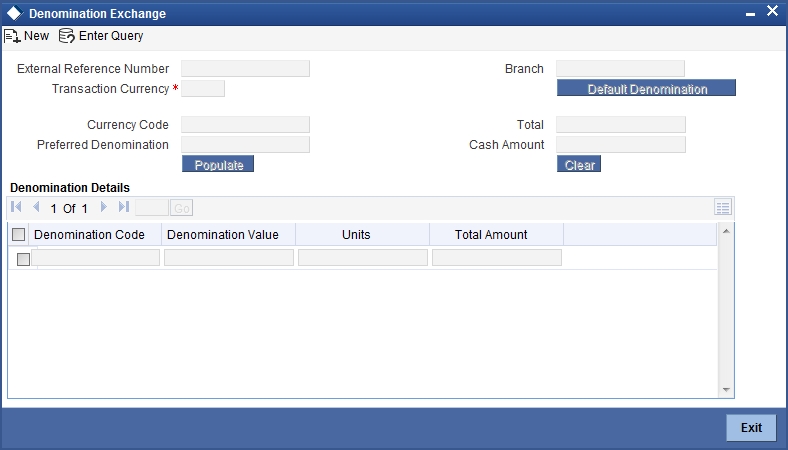

In this block, you can capture details of the currency denominations involved in the transaction.
Specify the denomination code that should be preferred. The system processes the transactions with the preferred denominations. If the transaction amount is less than the preferred denomination, the system will use the low valued denomination than the preferred denomination based on the defaulting rule.
If the preferred denomination is not captured, the system will consider the highest available denomination as the preferred denomination.
If the denomination is not available, the system will display ‘Denomination not available’ message.
Click ‘Populate’ button to display the units of currency denomination based on the defaulting rule.
Note
Refer the section titled ‘Specifying denomination details’ under ‘Depositing Cash’ for further details.
This block allows you to capture charge related details. You need to click on the ‘Charges’ button to invoke the following screen.
Refer the section titled ‘Specifying charge details’ under ‘Depositing Cash’ for further details.

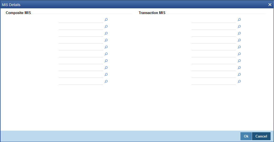

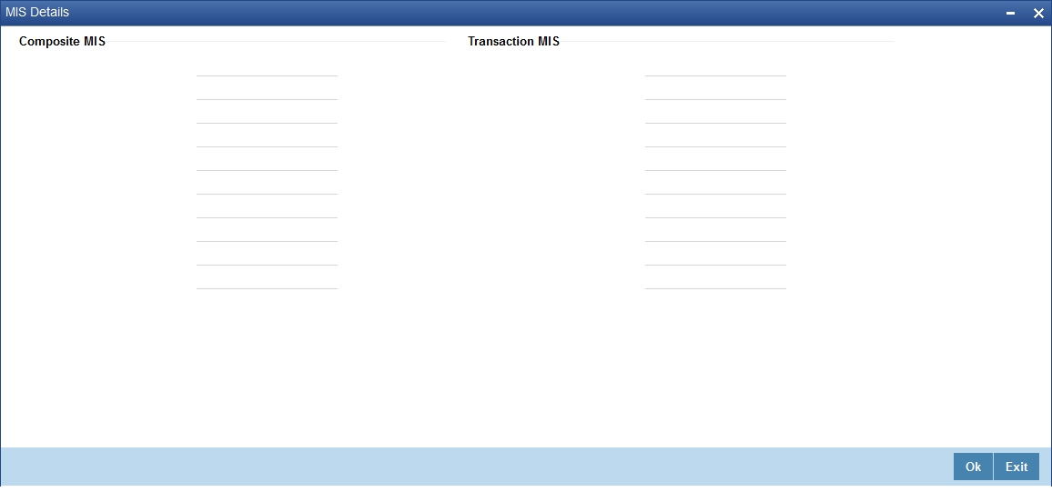

This block allows you to capture details pertaining to MIS. Click on the ‘MIS’ button to invoke the following screen:
Refer the section titled ‘Specifying MIS details’ under ‘Depositing Cash’ for further details.
Refer the section titled ‘Specifying the UDF details’ under ‘Depositing Cash’ for further details.
Project Name
Unit Payment
Unit ID
Deposit Slip Number

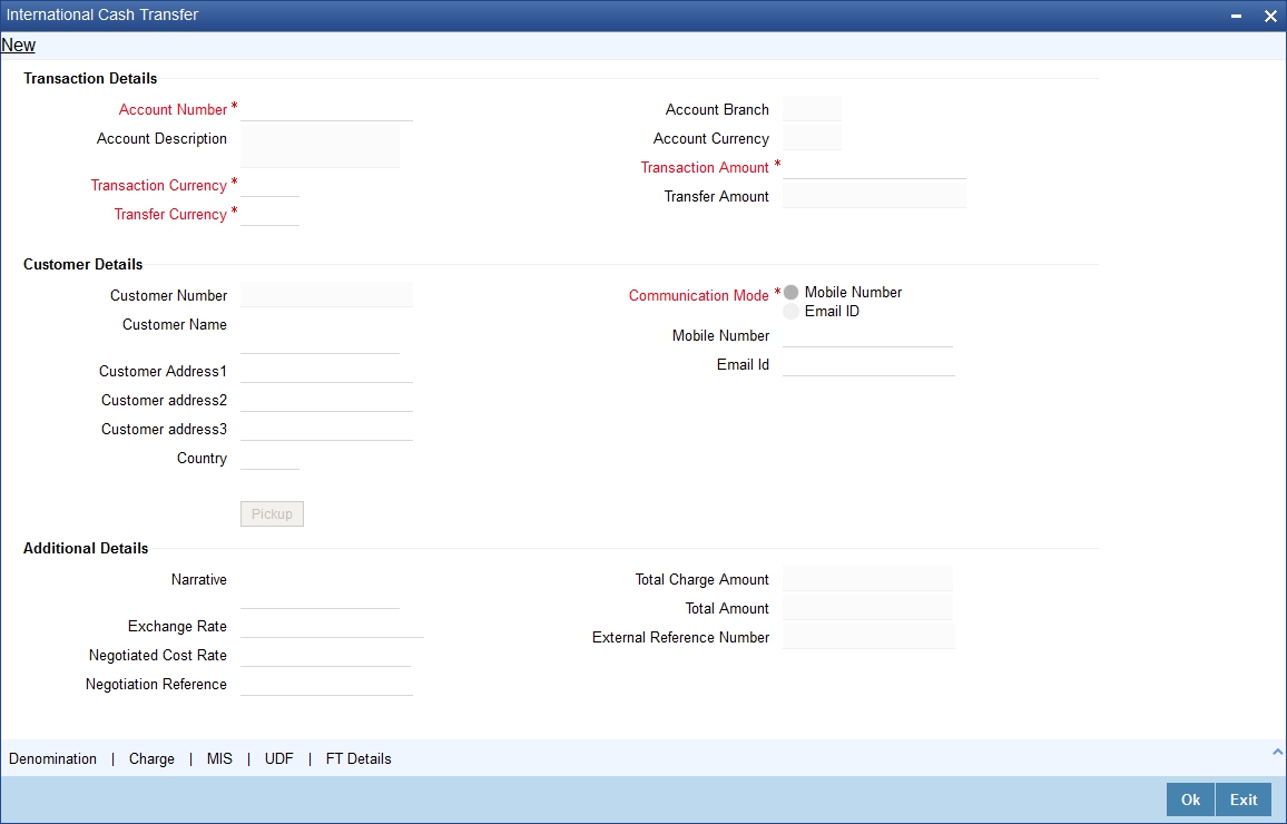

Oracle FLEXCUBE facilitates international funds transfer by cash. A Walk in customer or an account holder of the Bank can perform the transfer by remitting cash in foreign currency.You can process International Cash Transfer for an account holder or for a walk-in customer, if the Product Code is defaulted as ‘CXTR’ and the International Payment Transaction check box is selected in the RT Product Preference (DEDRTPRM) screen.
You can process international cash transfer through the ‘International Cash Transfer’ screen. You can invoke this screen by typing ‘1406’ in the field at the top right corner of the Application tool bar and clicking on the adjoining arrow button.
You can specify the following details:
Account Number
Specify the account number for the transaction. Alternatively, you can select the account from the option list. The list displays all valid accounts maintained in the system. In case of walk-in customer, this field is left blank.
Account Description
The system displays the description of the account number.
Account Branch
The system displays the branch of the main account of the transaction.
Account Currency
Specify the currency of the transaction. Alternatively, you can select the transaction currency from the option list. The list displays all the currencies maintained in the system.
Transfer Currency
Specify the transfer currency in which the amount has to be transferred. Alternatively, you can select the transfer currency from the option list. The list displays all the currencies maintained in the system.
If the customer wants the deposited FCY cash to be transferred in another currency to the Beneficiary account, you need to specify the transfer currency for International Payment transaction in the ‘Transfer currency’ field. The system converts the transaction amount into the transfer currency and credits it to the beneficiary account using the specified exchange rate.
Transaction Amount
Specify the transaction amount.
Transfer Amount
The system displays the transfer amount based on the transfer currency selected and the derived exchange rate.
Customer Number
The system displays the customer Id. If the customer number is a walk-in customer, the walk-in customer number maintained at the branch parameter level is defaulted.
Customer Name
The system displays the customer name. If the customer number is a walk-in customer, specify the customer name.
Note
If the customer is a Walk-in Customer, you can specify the customer name in the Customer Name field.
Customer Address1
Specify the first line of the customer address.
Customer Address2
Specify the second line of the customer address.
Customer Address3
Specify the third line of the customer address.
Country
Specify the country code of the ordering customer. Alternatively, you can select the country code from the option list. The list displays all the country codes maintained in the system.
Communication Mode
Select the mode of communication for the funds transfer. The options are as follows:
Mobile Number
Specify the mobile number of the customer. If you select the mode of communication as ‘Mobile Number’, it is mandatory to specify the mobile number of the customer.
Email ID
Specify the email Id of the customer. If you select the mode of communication as ‘Email ID’, it is mandatory to specify the email Id of the customer.
Narrative
Specify any remarks pertaining to the transaction.
Exchange Rate
The system displays the exchange rate, if the transaction currency and transfer currency are different. This exchange rate used to convert the transaction currency into transfer currency and derive the transfer amount.
Specify the negotiated cost rate that should be used for foreign currency transactions between the treasury and the branch. You should specify the rate only when the currencies involved in the transaction are different. Else, it will be a normal transaction.
Negotiated Reference
Specify the unique reference number that should be used for negotiation of cost rate, in foreign currency transaction. If you have specified the negotiated cost rate, then it is mandatory to specify the negotiated reference number.
Note
Oracle FLEXCUBE books an online revaluation entries based on the difference in exchange rate between the negotiated cost rate and transaction rate.
Total Charge Amount
The system displays the total charge amount of the transaction in the transaction currency.
Total Amount
The system displays the total amount of the transaction. In case of walk-in customer, the total amount would be the total transaction amount with the applicable charges.
If the customer is a walk-in customer, the system displays the charges as the total amount. If the customer is an Account Holder, the system displays the transaction amount as the total amount.
The system displays the external reference number maintained in the system.
Click ‘Pickup’ button to populate the data such as total Amount, total charge amount in transaction currency, customer number, customer name, and address details. In case of walk-in customer, you need to enter the customer name, address, country code and communication mode. It is mandatory to click ‘Pickup’ button to populate the data in the Denomination, Charge, MIS, UDF and International Payment Details screens.
After clicking ‘Pickup’ button, if you modify the Transaction Amount, Transaction Amount Currency or Account then it is mandatory to click ‘Pickup’ button before saving the transaction.

You can capture MIS details in the ‘MIS Details’ screen. Click the ‘MIS’ button to invoke the screen.
For more information on MIS details, refer to the section ‘Specifying the MIS details’ in chapter ‘Depositing Cash’ in this User Manual.

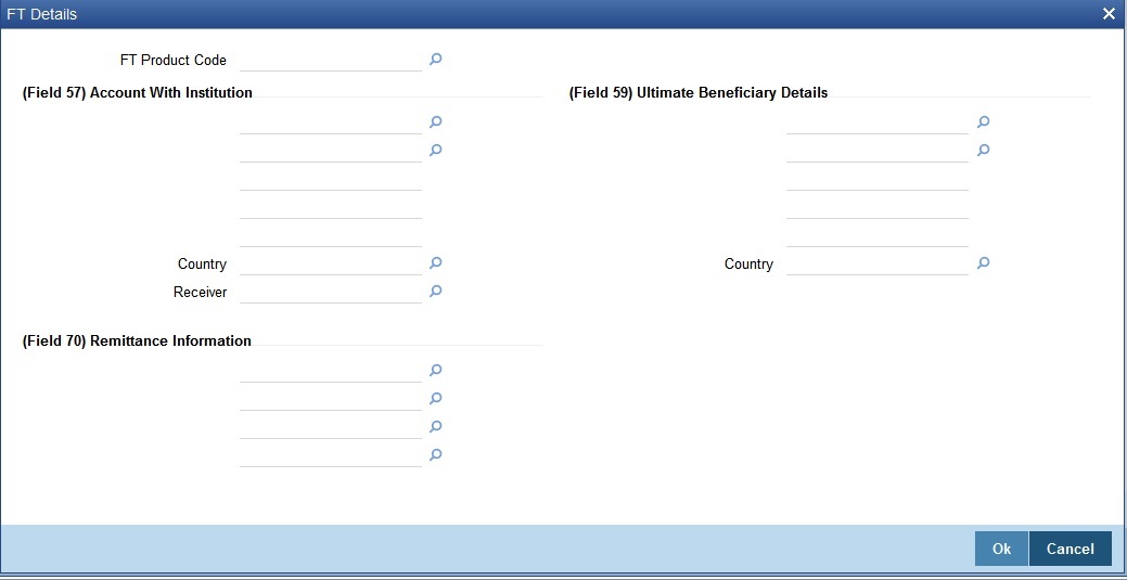

You can capture International Payment details in the ‘International Payment Details’ screen. Click the ‘International Payment Details’ button to invoke the screen.
You can specify the following details here:
International Payment Product
Specify the International Payment product code. The system allows only outgoing International Payment product codes to be specified. Alternatively, you can select the product code from the option list. The list displays all product codes maintained in the system.
(Field 57) Account with Institution
Specify the account with institution details. Alternatively, you can select the account from the option list. The list displays all accounts with institution details maintained in the system.
Country
Specify the country code. Alternatively, you can select the country code from the option list. The list displays all the country codes maintained in the system.
Receiver
Specify the receiver BIC code. Alternatively, you can select the code from the option list. The list displays all the receiver BIC codes maintained in the system.
(Field 70) Remittance Information
Specify the remittance information. Alternatively, you can select the remittance details from the option list. The list displays the remittance details maintained in the system.
(Field 59) Ultimate Beneficiary
Specify the ultimate beneficiary details. Alternatively, you can select the beneficiary from the option list. The list displays all the beneficiary maintained in the system.

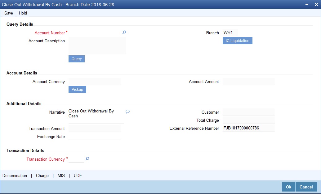

You can capture a close out withdrawal transaction through the ‘Close Out Withdrawal by Cash’ screen. You can invoke this screen by typing ‘1301’ in the field at the top right corner of the Application tool bar and clicking on the adjoining arrow button.
Account Number
Specify the account number that needs to be closed. The adjoining option list displays all the accounts maintained in the Host. You can select the appropriate account number.
To view the joint holder’s details of an account and the mode of operation maintained at the account level, place the cursor on the Account Number field and press Ctrl+J. The system displays the ‘Joint Holder’ screen.
For more information on the ‘Joint Holder’ screen refer to the section ‘Joint Holder Maintenance’ in the Core User Manual.
Account Branch
The current logged-in branch code is displayed here. However, you can modify it. Specify the branch where the customer account which needs to be closed resides.
Account Description
The system displays a brief description on the selected account.
Account Currency
The system displays the account currency here.
Account Amount
The system displays the available amount in the account.
Customer ID
The system displays the customer ID based on the account specified.
Narrative
The system defaults ‘Close Out Withdrawal by Cash’ here. However you can modify this.
External Reference
The system generates a unique number based on the branch-specific sequence number generation logic and displays it here. The Host system identifies a branch transaction with the external reference number.
In the single stage flow, if there is an transaction level override or error during approval then the transaction will be moved to the pending queue. Without save action being initiated, the transaction will not be in pending queue.
On clicking Pickup button, the system populates the values in all the callforms of the screen and clicking pickup button is mandatory if you make any changes to the Transaction amount and exchange rate after first pickup.
Once you click ‘Pickup’ button, then on amendment of xrate, amount, charge, pickup will be mandatory before save. On pick up, the fields that are currently enabled in the enrich stage will alone be retained as enabled fields.
Note
The Close out Withdrawal of Account transactions are processed without any change till the ‘Branch Available’ status is marked as ‘Yes’. If the branch available status is ‘No’ or branch date is ahead of host date, the transactions are not allowed.
Clicking ‘Pickup’ button, the system defaults the following details:
Account Title
The system displays a brief title for the chosen account.
Customer ID
Account Currency
Account Amount
The system displays the net cash to be disbursed to the customer after deducting the applicable charges.
Note
A transaction slip is generated at the time of input stage completion and is produced to the customer to sign and confirm the transaction.

This block allows you to capture details pertaining to MIS. Click on the ‘MIS’ tab to specify the MIS details.
You can capture the following details in the ‘UDF’ tab of the screen.
Field Description
The system will display all the User-Defined Fields (UDF) maintained for the product.

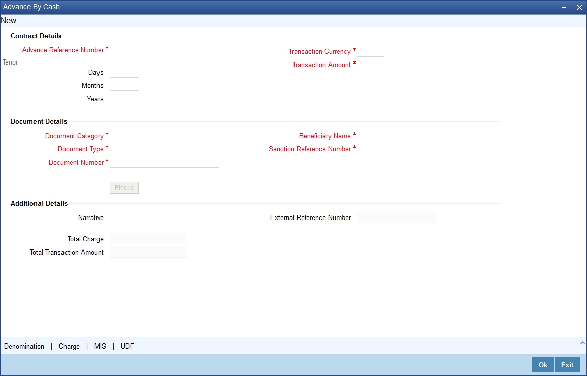

You can release cash advances through the ‘Advance By Cash’ screen. When a credit card customer submits a request for advance by cash, you can disburse the cash advances that are maintained in the external system where cash withdrawal from GL is allowed. You can also perform reversal of transaction in this screen.You can invoke this screen by typing ‘1461’ in the field at the top right corner of the Application tool bar and clicking on the adjoining arrow button.
Product type in the Retail Product Parameter Definition screen ‘DEDRTPRM’ should be ‘EC’-External Cash Advance. ARC setup should be done to track denominations and the credit account should be CASH GL. in IFDATMMN an ARC maintenance is created, where the charge type will be percentage and basis will be transaction amount
Advance Reference Number
Specify the advance reference number. For example if the Nature of Advance is Loan the loan account number should be specified and if the Nature of Advance is credit card then the Credit Card number should be specified.
Transaction currency
Specify the currency in which cash advance transaction is initiated. Alternatively you can select the transaction currency code from the option list. The list displays all valid transaction currency maintained in the system.
Transaction Amount
Specify the transaction amount that needs to be sanctioned.
You can specify the tenor of the advance in Days/Months/Years
Days
Specify the tenor of advance in days. The range of value that you can specify is “0-30”. If you specify a value beyond permissible range, the system will display an error message.
If you specify the tenor value of date in decimal, then the system displays an error message “Invalid Tenor Value”.
Months
Specify the tenor of advance in months. The range of value that you can specify is “0-11”. If you specify a value beyond permissible range, the system will display an error message
If you specify the tenor value of month in decimal, then the system displays an error message “Invalid Tenor Value”.
Years
Specify the tenor of advance in years.
If you specify the tenor value of year in decimal, then the system displays an error message “Invalid Tenor Value”.
Document Category
Specify the category of the document that is uploaded. Alternatively you can select the category of the document from the option list. The list displays all valid document categories maintained in the system.
Document Type
Specify the type of document submitted by the customer. Alternatively you can select the type of document from the option list. The list displays all valid document types maintained for a document category.
Document Number
Specify the document reference number submitted by the customer.
Beneficiary Name
Specify the beneficiary name.
Sanction Reference Number
Specify the approval number obtained from the third party.
When a transaction is reversed and initiated again with the same Sanction Reference Number and application number combination, then the system displays an configurable override message “Sanction Reference Number should be unique”.
Narrative
Specify the remarks about the transaction.
Total Charge
Specify the total charge applicable.
Total Transaction Amount
The system displays the total transaction amount inclusive of all applicable charges.
The system displays a unique number generated based on the branch specific sequence number generation logic. The Host system identifies a branch transaction with the External reference number.
The following transactions will be performed in this screen:

You can capture denomination related details in this screen. Click ‘Denomination’ button to invoke this screen.
For more information on denomination details screen, refer to the section ‘Specifying denomination details’ in the chapter ‘Depositing Cash’ in this User Manual.
You can capture charge related details in this screen. Click ‘Charge’ button to invoke this screen.
For more information on charge details screen, refer to the section ‘Specifying charge details’ in the chapter ‘Depositing Cash’ in this User Manual.
You can capture details pertaining to MIS. Click on the ‘MIS’ button to invoke the screen.
For more information on MIS details screen, refer to the section ‘Specifying the MIS details’ in the chapter ‘Depositing Cash’ in this User Manual.
You can capture the UDF details in the ‘UDF details’ screen. Click ‘UDF’ button to invoke this screen.
For more information on UDF screen, refer to the section ‘Specifying the UDF details’ in the chapter ‘Depositing Cash’ in this User Manual.
A customer may approach your bank to exchange currency denomination. That person may or may not be an actual bank customer (with a valid CIF or customer account). He or she may give you two notes of USD 50 each and ask for 10 notes of USD 10 each. This transaction involves only denomination exchange from your till. The total value in the till will remain the same. Hence there won’t be any accounting entries for this exchange. However, the denomination count in the till will change and hence it needs to be updated. You can capture such a transaction through the ‘Denomination Exchange’ screen. You can invoke this screen by typing ‘DENM’ in the field at the top right corner of the Application tool bar and clicking on the adjoining arrow button.
Branch Code
The system displays the current logged-in branch code.
Specify the currency in which your customer wishes to exchange denominations. The adjoining option list displays all the currency codes maintained in the system. Choose the appropriate one.
This block allows you to capture exact details of the denominations being exchanged.
Currency Code
Specify the currency in which the transaction is being performed. You can select the appropriate code from the adjoining option list.
Denomination Code
Specify the denomination of the currency used in the transaction. For every currency, the various denominations are assigned separate denomination codes. These codes are displayed in the adjoining option list. Choose the appropriate one.
Value
Units
By default, a positive value is considered to be an inflow unit. To reverse this default behaviour and to enter the units for denominations going out, you can specify a negative value. The summation of the total amount should be zero.
If the total value is not zero, the system will display an error message.
Total Amount

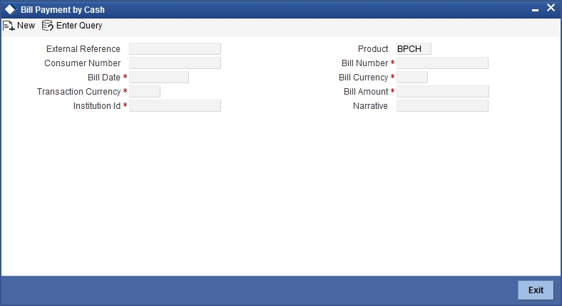

This module allows you to undertake cash transactions for payments of all the utility bills. To enter into such transactions, you need to invoke the ‘Bill Payment by Cash’ screen. You can invoke this screen by typing ‘1025’ in the field at the top right corner of the Application tool bar and clicking on the adjoining arrow button.
Product Code
The system displays the code of the retail teller product maintained in the system that will be used for processing the transaction.
Consumer Number
Specify the consumer number for the transaction.
Bill Number
Specify the bill number here.
Bill Date
Specify the date on which the bill has been issued. The adjoining button when clicked invokes a calendar in which you need to double-click on the appropriate date. The chosen date will then be seen in the ‘YYYYMMDD’ format.
Bill Currency
Specify the currency in which the bill should be paid. You can select the appropriate code from the adjoining option list that displays all the currency codes maintained in the system.
Specify the currency in which the payment is being made by your customer. You can select the appropriate code from the adjoining option list that displays all the currency codes maintained in the system.
Institution Id
Specify the unique ID corresponding to the institution towards which the bill payment is being made. You can select the appropriate code from the adjoining option list that displays all the institution codes maintained in the system.
Bill Amount
Specify the amount that should be paid towards the bill.
Narrative
You may enter remarks about the transaction here. This is a free format text field.
Exchange Rate
The system displays the exchange rate used to convert the bill amount in the bill currency to transaction currency. If the transaction currency is the same as the bill currency, the system will display the exchange rate as ‘1’.
Charges
This block allows you to capture charge related details. Refer the section titled ‘Specifying charge details’ under ‘Depositing Cash’ for further details.

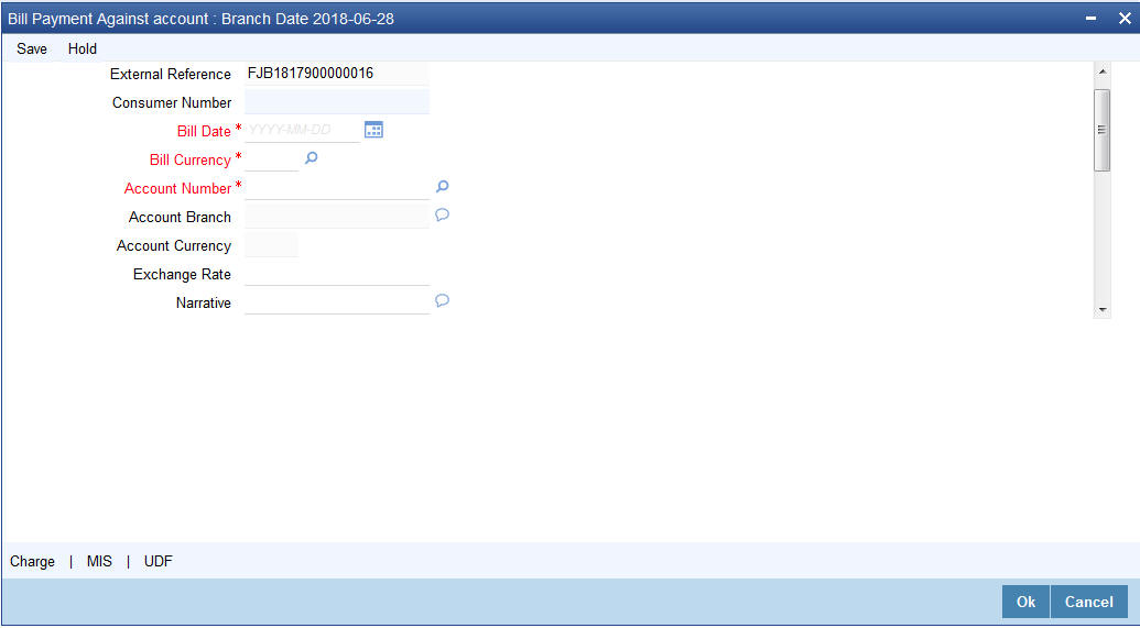

You can capture a bill payment transaction against account through the ‘Bill Payment (Against Account)’ screen. You can invoke this screen by typing ‘1075’ in the field at the top right corner of the Application tool bar and clicking on the adjoining arrow button.
Product Code
Bill Number
Consumer Number
Bill Date
Institution Id
Bill Currency
Bill Amount
Account Number
Specify the account number of the customer against which the bill should be paid. You can select the appropriate number from the adjoining option list that displays all the accounts maintained in the system.
Account Branch
The branch where the chosen account resides is displayed here.
Narrative
Account Currency
The system displays the currency in which the chosen account is maintained.
Customer ID
Account Title
Exchange Rate
The system displays the exchange rate used to convert the bill amount in bill currency to transaction amount in transaction currency. If the transaction currency is the same as the bill currency, the system will display the exchange rate as ‘1’.
Total Charge
Total Amount
The system displays the total amount inclusive of the bill amount and the charges.

You can capture these details in the ‘UDF’ tab of the screen.
Field Description
Field Value
Specify the value for the required UDFs.

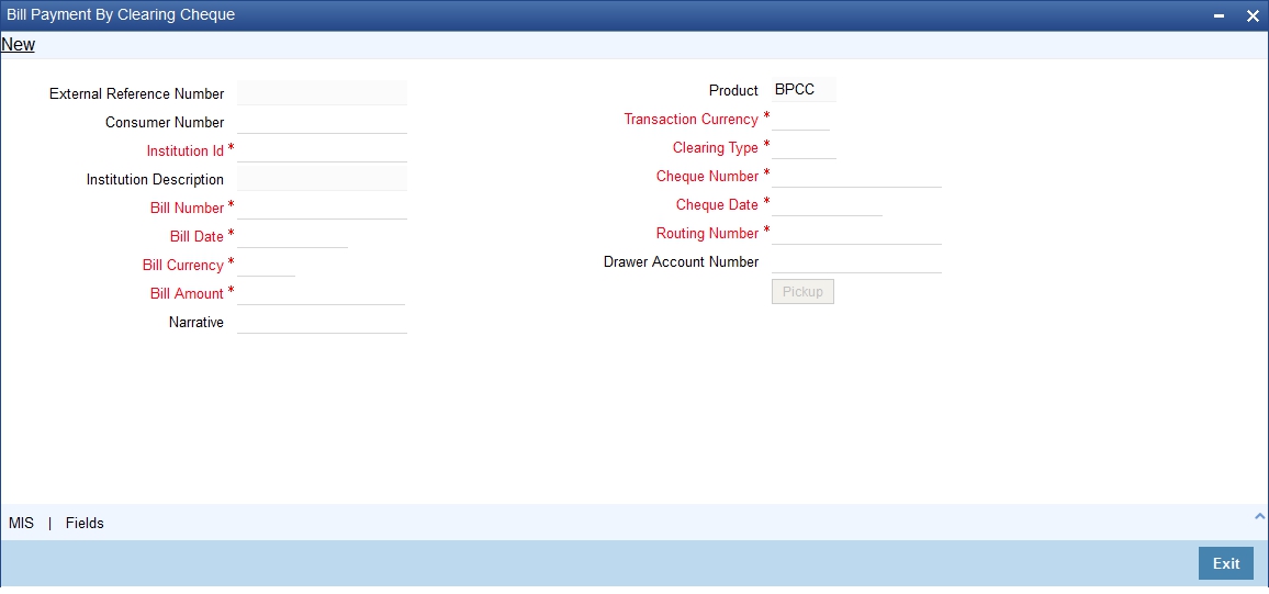

You can undertake other bank cheque transactions for the payment of all the utility bills through ‘Bill Payment By Clearing Cheque’ screen. You can invoke this screen by typing ‘1045’ in the field at the top right corner of the application tool bar and clicking on the adjoining arrow button.
You can capture the following details:
The system displays the external reference number.The system generates a unique number based on the branch-specific sequence number generation logic and displays it here.
Consumer Number
Institution Id
Specify the unique Id corresponding to the institution towards which bill payment is being made. Alternatively, you can select the institution id from the option list. The list displays all institution code maintained in the system.
Institution description
The system displays the description of the biller institution.
Bill Number
Specify the bill number.
Bill Date
Select the date on which the bill has been issued from the adjoining calendar.
Bill currency
Specify the currency in which the bill should be paid. Alternatively, you can select the currency from the option list. The list displays all bill currency maintained in the system.
Bill Amount
Specify the bill amount.
Narrative
Product
The system displays the utility payment product. The Product ‘BPCC’ will be defaulted for the transaction pertaining to the bill payment for clearing cheques.
Specify the currency in which the payment is made by the customer. Alternatively, you can select the transaction currency from the option list. The list displays all transaction currency maintained in the system
Clearing Type
Select the clearing type. Alternatively, you can select the type of clearing from the option list. The list displays all clearing products maintained in the system.
Cheque Number
Specify the cheque number provided by the customer. Alternatively you can select the cheque number from the option list. The list displays all the cheque numbers of the customer maintained in the system.
Cheque Date
Select the date on which cheque has been issued from the adjoining calendar.
If the cheque is issued before three months, the system displays an error message “Cheque is a stale one”.
Routing Number
Specify the routing number. Alternatively you can select the routing number from the option list. The list displays all routing number maintained in the system.
Drawer Account Number
Specify the drawer account number.
Pickup Button
Click on pickup to default the data into the MIS and fields details. It is mandatory to click on ‘Pickup’ button before save.
You can capture details pertaining to MIS. Click on the ‘MIS’ button to invoke this screen.
You can capture the UDF details in the ‘UDF details’ screen. Click ‘Fields’ button to invoke this screen.
For more information on UDF screen refer to the section ‘Specifying the UDF details’ in the chapter ‘Depositing Cash’ in this User Manual.

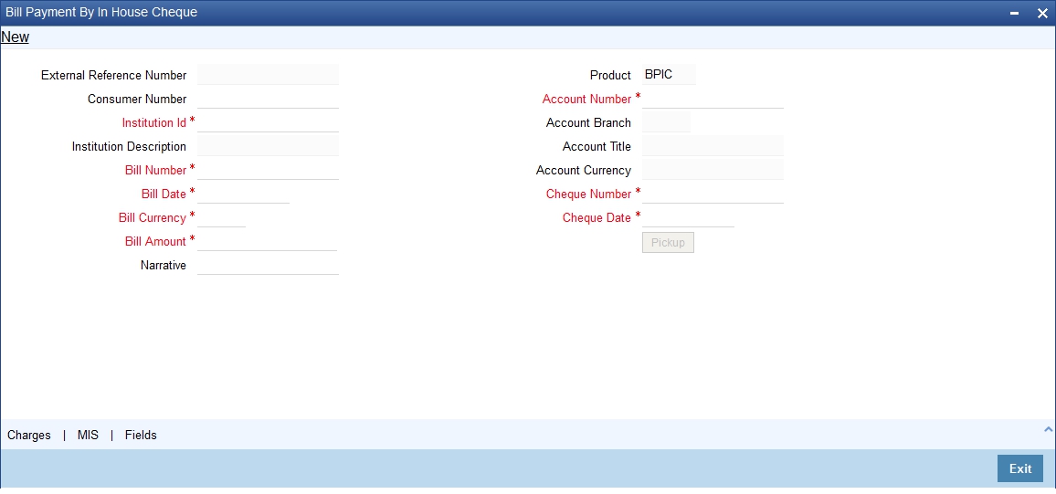

You can pay all the utility bills using same bank cheque. You can maintain these transactions, in the ‘Bill Payment By In-house Cheque’ screen. You can invoke this screen by typing ‘1035’ in the field at the top right corner of the application tool bar and clicking on the adjoining arrow button
Consumer Number
Institution Id
Bill Number
Bill Date
Bill currency
Bill Amount
Narrative
Product
The system displays the utility payment product. The Product ‘BPIC’ will be defaulted for the transaction pertaining to the bill payment for in-house cheques.
Account Number
Specify the account number of the customer against which the bill should be paid. Alternatively, you can select the account number from the option list. The list displays all the accounts maintained in the system
Account Branch
The system displays the branch where the chosen account resides.
Account Title
Account Currency
The system displays the currency in which the account is maintained.
Cheque Number
If the cheque is cancelled, the system displays an error message “Selected cheque is cancelled”.
If the cheque has stop payment, the system displays an error message “There is a stop payment on the selected cheque”
Cheque Date
Pickup Button
Click on the Pickup button to default the data into the Charges, MIS and Fields details. It is mandatory to click on ‘Pickup’ button before save.

You can capture the UDF details under ‘UDF’ tab.
You can capture project details under ‘Project Details’ tab. Note that this tab will be applicable only if the funds are being transferred to a Trust account.
Project Name
Unit Payment
Unit ID
Deposit Slip Number
Click save icon to save the transaction. On saving, the system checks whether the accounts mentioned in the ‘from’ and ‘to’ leg of the transaction belong to the same netting group or not. If they belong to the same netting group, the entries will not be posted. Instead the transaction will be logged for the netting batch. On authorisation, the transaction will be made available for the netting batch if logged for netting batch. The rest of the authorization process is similar to that of cash deposit.

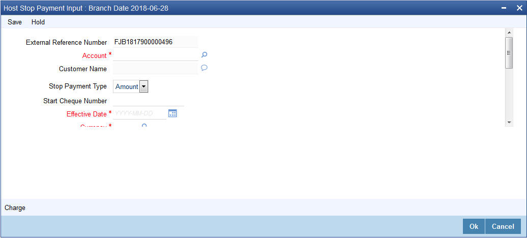

Based on a customer’s request, you can stop a cheque drawn on an account maintained in your bank. You can capture such a transaction through the ‘Stop Payment’ screen. You can invoke this screen by typing ‘1056’ in the field at the top right corner of the Application tool bar and clicking on the adjoining arrow button.
The system generates and displays a reference number for the transaction as soon as the screen is invoked.
Branch
The system displays the branch code where the chosen account resides.
Account Number
Specify the account on which the stop payment needs to be imposed. You can select the appropriate number from the adjoining option list that displays all the accounts maintained in the system.
Stop Payment Type
Specify whether the stop payment is on the amount of a cheque or a cheque drawn on an account. The drop-down list displays the following values:
Select the appropriate one.
Start Cheque Number
In case of a stop payment on a cheque, you need to specify the cheque number of the first leaf.
End Cheque Number
In case of a stop payment on a cheque, you need to specify the cheque number of the last leaf.
Note
The above two fields are applicable in cases wherein the customer has lost a cheque book. So in order to prevent misuse, you can capture the cheque numbers of the lost cheque book and impose a stop payment on all cheques in that book.
Effective Date
Specify the date from which you wish to impose the stop payment. The adjoining button when clicked invokes a calendar in which you need to double-click on the appropriate date. The chosen date will then be seen in the ‘YYYYMMDD’ format.
Expiry Date
Specify the date until which the stop payment needs to be active. The adjoining button when clicked invokes a calendar in which you need to double-click on the appropriate date. The chosen date will then be seen in the ‘YYYYMMDD’ format.
Amount
Specify the amount based on which you wish to impose a stop payment. This field is applicable only if the ‘Stop Payment Type’ is specified as ‘Amount’.
Narrative
Account Title
Account Currency
Click save icon to save the transaction. The authorization process is similar to cash deposit.
You can specify charge details under the ‘Charge Details’ tab. You can specify the following details here:
Charge Components
Specify the charge component name.
Waiver
Check this box to indicate that charge is waivered.
Charge Amount
The system displays the computed charge amount.
Currency
The system displays the charge currency.
Specify the charge in local currency.
Exchange Rate
The system displays the exchange rate if the transaction currency and account currency are different.
Refer the corresponding section under ‘Depositing Cash’ for further details.

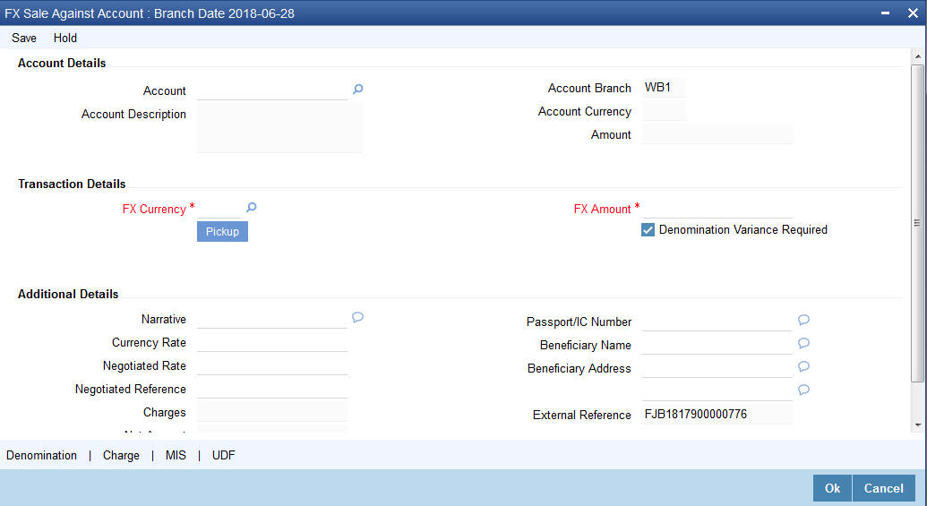

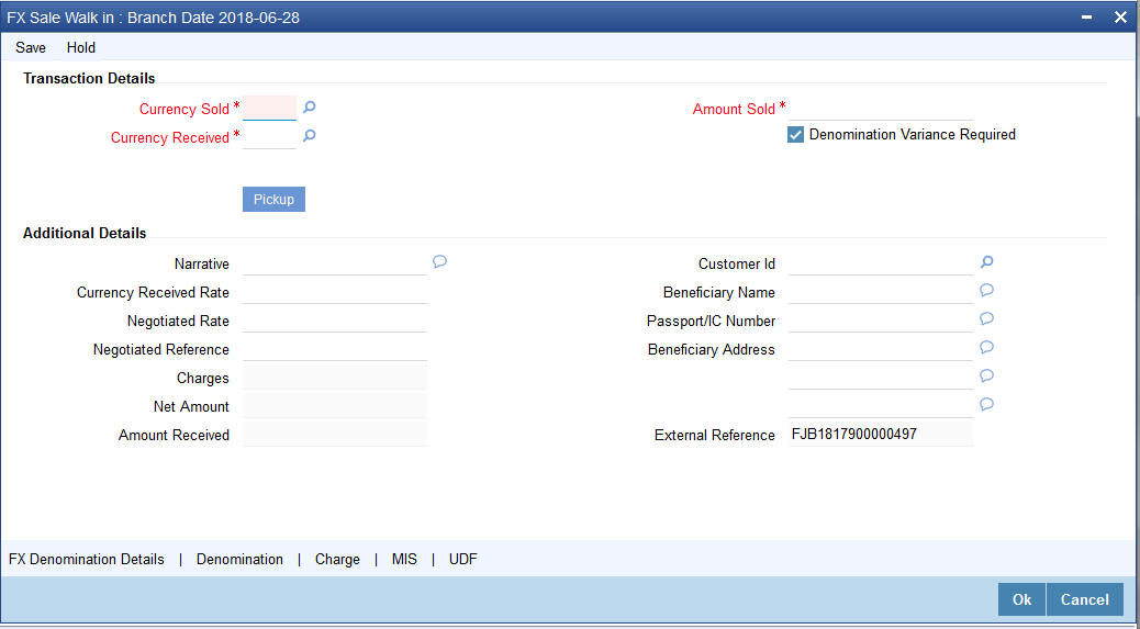

You can sell a foreign currency to a walk-in customer in return for the equivalent amount in another currency. To achieve this you need to invoke the ‘FX Sale (Walk-in)’ screen by typing ‘8203’ in the field at the top right corner of the Application tool bar and clicking on the adjoining arrow button.
Product
Currency Sold
Specify the currency that you are selling to the customer. You can select the appropriate code from the adjoining option list that displays all the currency codes maintained in the system.
Amount Sold
Specify the amount that is being sold in the sold currency.
Currency Received
Specify the currency that you have received from the customer in return for the currency sold. You can select the appropriate code from the adjoining option list that displays all the currency codes maintained in the system.
Customer ID
Specify the customer ID. Alternatively, you can select customer ID from the option list. The list displays all valid customer ID maintained in the system.
Narrative
Here, you can enter your remarks pertaining to the transaction.
Beneficiary Name
Here, you can capture the beneficiary customer’s name.
Passport/IC No
Here, you can enter the passport or other unique identification number of the beneficiary.
Beneficiary Address
Here, you can capture the address of the beneficiary customer.
Denomination Variance Applicable
This Check box will have the value Y by default only if you have set the required parameter to ‘Yes’ in ‘FBTB_PARAMS’.
By default, the system displays the status of the check-box as checked. However, you can modify this based on the transaction requirements.
If this box is checked, then based on the denominations of the currency, the system will apply the respective variance to the rate of exchange. The variance is applied based on the variance maintained for the currency pair involved in the transaction.
If you check this box, it is mandatory to specify the denominations in ‘FX Denominations’ sub-screen.
On clicking the Pickup button, the following details are defaulted:In addition to the details defaulted from the previous stage, you can view the following details:
Currency Received Rate
The system displays the exchange rate to be used for the foreign exchange sale.
Negotiated Rate
Specify the negotiated rate to compute profit or loss of this transaction.
Specify the negotiated reference details.
Charges
The system displays the charge to be levied on the customer for the transaction.
Amount Received
Based on the exchange rate and amount bought, the system computes and displays the amount that needs to be received from the customer in the received currency.
Net Amount
The system displays the net amount.
If you have manually changed the exchange rate, then you can recalculate the net amount by clicking ‘Recalculate’ button.
If you have checked the check-box ‘Denomination Variance Applicable’, then the system will apply the variance for each denomination and calculate the net amount.
In the ‘Denomination’ screen, you can capture details of the currency denominations involved in the transaction. You can invoke this screen by clicking the ‘Denomination’ button.
In the ‘FX Denomination’ screen, you can capture details of the foreign currency denominations involved in the transaction. If you have checked the check-box ‘Denomination Variance Applicable’, then you must capture the ‘FX denomination details’ before Pickup stage. You can invoke this screen by clicking the ‘FX Denomination’ button.

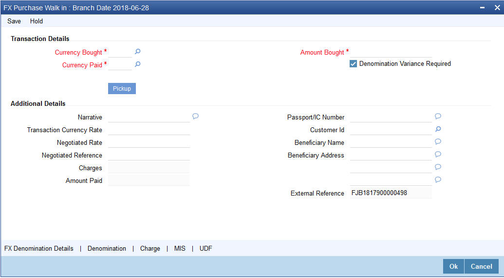

You can buy a foreign currency from a walk-in customer in return for the equivalent amount in another currency. To achieve this you need to invoke the ‘FX Purchase (Walk-in)’ screen by typing ‘8004’ in the field at the top right corner of the Application tool bar and clicking on the adjoining arrow button.
Product
Currency Bought
Specify the currency that you have received from the customer. You can select the appropriate code from the adjoining option list that displays all the currency codes maintained in the system.
Amount Bought
Specify the amount that is being purchased in the bought currency.
Currency Paid
Specify the currency that you are paying the customer in return for the currency bought. You can select the appropriate code from the adjoining option list that displays all the currency codes maintained in the system.
Narrative
Beneficiary Name
Passport/IC No
Here, you can enter the passport or other identification number of the beneficiary.
Beneficiary Address
On clicking the ‘Pickup’ button the following details will be displayed:
Transaction Currency Rate
The system displays the exchange rate to be used for the foreign exchange purchase.
Negotiated Rate
You can book profit or loss for each retail FX transaction based on the negotiated rate and transaction rate.
The formula for computing Profit/Loss is as follows:
Direct Method (Stronger currency to Weaker currency) = Negotiated Cost Rate – Transaction Rate) * Transaction Amount
Indirect method (Weaker currency to Stronger currency) = (1/Negotiated Cost Rate – 1/Transaction Rate) * Transaction Amount
If both the currencies of transaction are Foreign currency, then revaluation will be as follows:
Revaluation method = Amount * (Transaction Rate–Negotiated Cost Rate) * Revaluation MID Rate of CCY2
At the time of booking, the profit or loss generated by the transaction will be booked as part of REVL. This profit or loss will be booked under separate GLs as per ARC maintenance.
If Negotiated rate and transaction rate are same there will not be any accounting entry for profit or loss.
For the negotiated transactions, the negotiation reference number and negotiated rate will be provided by the treasury which needs to be manually captured during transaction input.
Charges
Amount Paid
Based on the exchange rate and amount bought, the system computes and displays the amount that needs to be paid to the customer in the paid currency.
In the’Denomination’ screen, you can capture details of the currency denominations involved in the transaction. You can invoke this screen by clicking the ‘Denomination’ button.
This screen allows you to capture charge related details. You need to click on the ‘Charges’ button to invoke the screen.Refer the section titled ‘Specifying charge details’ under ‘Depositing Cash’ for further details.
This screen allows you to capture details pertaining to MIS. Click on the ‘MIS’ screen to invoke the screen:
You can capture the UDF details under ‘UDF’ screen. Refer the section titled ‘Specifying the UDF details’ under ‘Depositing Cash’ for further details.
Oracle FLEXCUBE facilitates purchase of foreign currency from the branch using CASA account. While purchasing, you can maintain denomination details for the foreign currency amount. On completion of the transaction successfully, the system generates an advice for the same.
You can generate the details from the purchase of foreign currency by crediting CASA account using ‘FX Purchase against Account’ screen. You can invoke ‘FX Purchase against Account’ screen by typing ‘8207’ in the field at the top right corner of the Application tool bar and clicking on the adjoining arrow button.
You can maintain the following parameters here:
Account
Specify the account number. Alternatively, you can select the account number from the option list. The list displays all valid account numbers maintained in the system.
Account Description
Specify the description of the specified customer account. For a virtual account, the virtual account name is displayed here.
Account Branch
The system displays the branch code of the branch to which the specified customer account belongs.
Account Currency
Currency of the specified customer account is defaulted here.
For a Virtual Account, the FX currency is defaulted as the account currency.
The physical account number is identified based on the account currency and virtual account number combination. If physical account number is available then the account currency remains the same.
If the physical account number is not available, then the default physical account number is selected and the account currency changes as per the default physical account number.
Amount
The actual amount equivalent to the foreign currency which is credited to the customer account is defaulted here.
FX Currency
Specify a valid currency purchased by the customer from the adjoining option list. The option list displays list of foreign currencies maintained by the bank.
FX Amount
Specify the amount of the foreign currency purchased by the customer.
If you check this box, it is mandatory to specify the denominations in ‘Denominations’ sub-screen.
Narrative
Specify additional remarks pertaining to the transaction, if any. If virtual account number is entered in the account number field, then that virtual account number will be displayed in the Narrative field.
Currency Rate
The current exchange rate of the currency is defaulted here.
Negotiated Rate
Charges
The charge amount in account currency, if any, associated with the retail teller product FXSP is defaulted here.
Net Amount
Sum of the actual amount credited and the charges in account currency is defaulted here.
Passport/IC Number
Specify the passport or unique identification number of the beneficiary.
Beneficiary Name
Specify the name of the beneficiary customer.
Beneficiary Address
Specify the address of the beneficiary customer which should appear in the advice.
In the ‘Denomination’ screen, you can capture details of the currency denominations involved in the transaction. You can invoke this screen by clicking the ‘Denomination’ button. If you have checked the check-box ‘Denomination Variance Applicable’, then you must capture the ‘FX denomination details’ before Pickup stage in the Denomination screen.
Refer the section titled ‘Specifying Denomination Details’ under ‘Depositing Cash’ for further details.
You can maintain the charge related details of the transaction. Click on the ‘Charges’ button to invoke the screen.
Refer the section titled ‘Specifying Charge Details’ under ‘Depositing Cash’ for further details.
You can maintain the MIS related details of the transaction. Click on the ‘MIS’ button to invoke the screen:.
Refer the section titled ‘Specifying MIS Details’ under ‘Depositing Cash’ for further details.
You can capture the UDF related details of the transaction. Click on the ‘UDF’ button to invoke the screen.

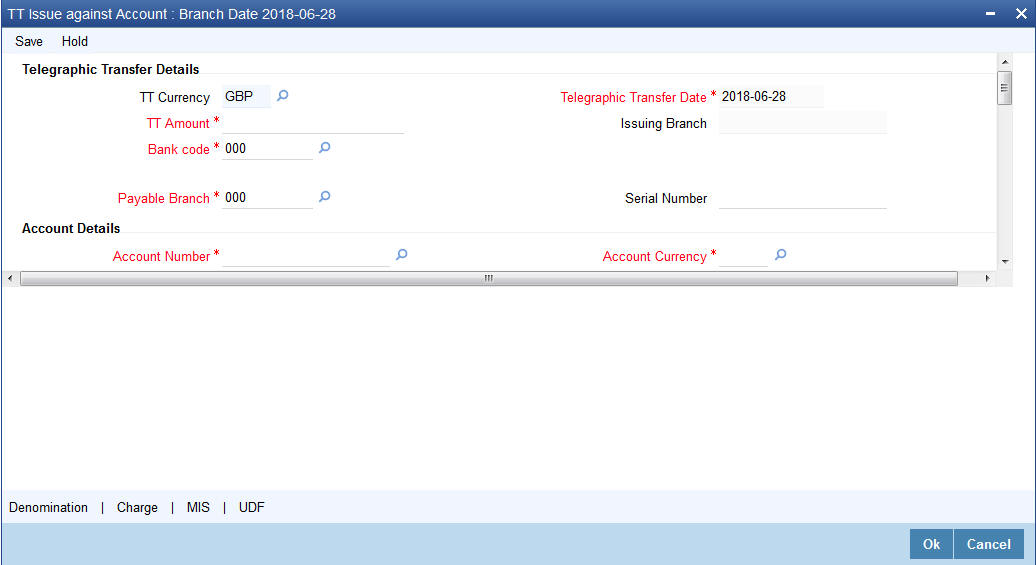

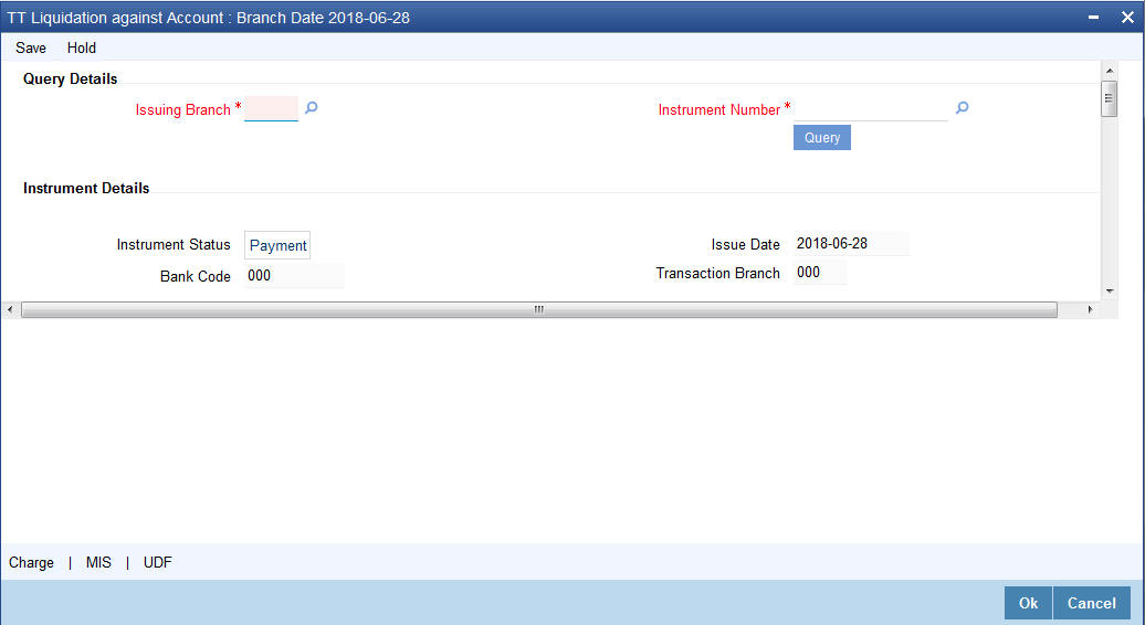

You can issue a Telegraphic Transfer drawn on your branch against an account through the ‘TT Issue Against Account’ screen. You can invoke this screen by typing ‘8318’ in the field at the top right corner of the Application tool bar and clicking on the adjoining arrow button.
When you invoke the screen, the External Reference Number is displayed.
You need to specify the following details:
Bank Code
Specify the clearing bank code for the transaction.
TT Currency
Specify the TT currency or select a currency for the TT from the list of values.
Account Currency
Specify the currency of the account or select the account currency from the list of values.
Remitter Name
Specify the name of the remitter.
Remitter Address
Specify the address of the remitter
Remitter Phone Number
Specify the phone number of the remitter.
Remitter ID Number
Specify a unique identification value of the remitter.
Beneficiary A/C number
Specify the account number to which the proceeds have to be credited.
Beneficiary ID Number
Specify the beneficiary ID number.
Beneficiary Phone Number
Specify the phone number of the beneficiary.
Charge by Cash
Check this box “Charge by Cash” to select the charge mode, that is by cash or from account.
Note
For the TT where Charge by “Cash” is selected, then all the TT transactions are treated as cash transactions.
Payable Branch
Specify the branch where the transfer amount should be paid out.
Account Number
Specify the account number of the customer or select an account number from the list of values.
To view the joint holder’s details of an account and the mode of operation maintained at the account level, place the cursor on the Account number field and press Ctrl+J. The system displays the ‘Joint Holder’ screen.
TT Amount
Specify the transfer amount.
Telegraphic Transfer Date
The date on which the instrument is issued is displayed here.
Serial Number
Specify the serial number printed on the TT.
Narrative
Here, you can enter remarks pertaining to the transaction.
Beneficiary Name
Specify the name of the beneficiary of the TT.
Beneficiary Address
Specify the address of the beneficiary.

In this block, you can capture details of the currency denominations involved in the transaction. These details need to be mandatorily updated if ‘Charge by Cash’ is selected.
Refer the section titled ‘Specifying denomination details’ under ‘Depositing Cash’ in this manual for further details.
Click on the ‘Charges’ tab to capture charge related details.
Refer the section titled ‘Specifying the charge details’ under ‘Depositing Cash’ for further details in this manual.
Refer the section titled ‘Specifying UDF details’ under ‘Depositing Cash’ for further details in this manual.

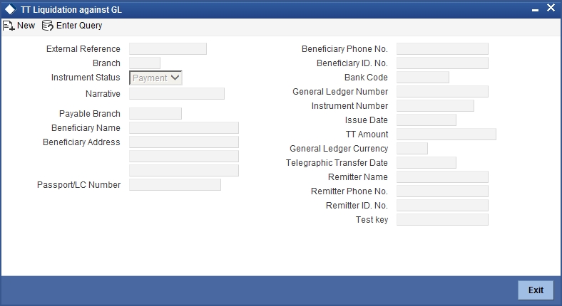

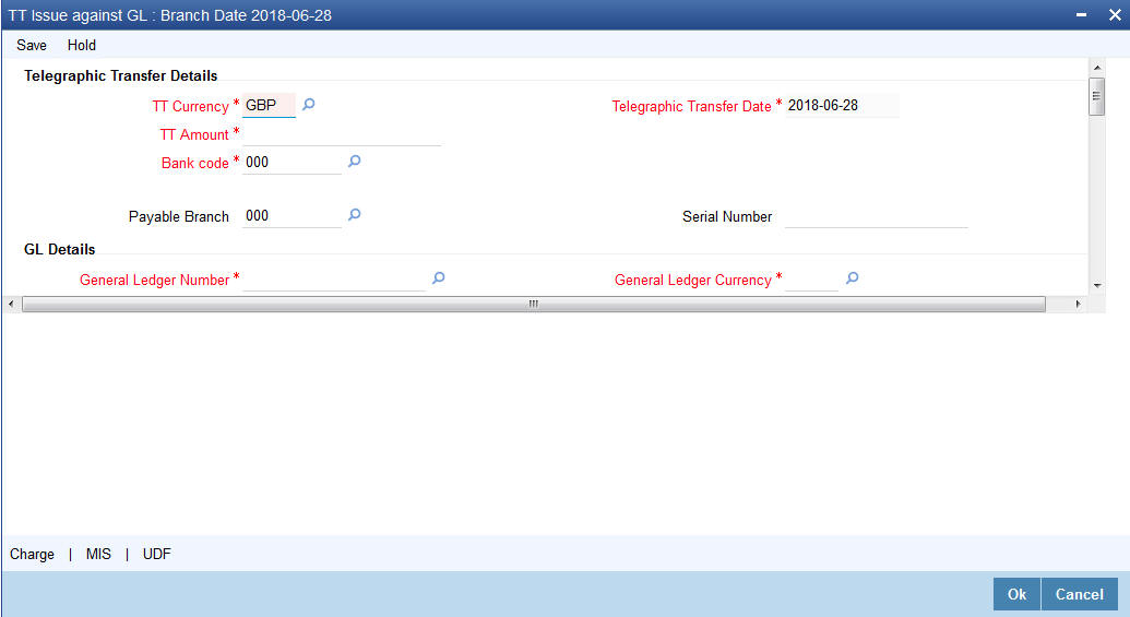

You can issue a Telegraphic Transfer against a GL account for your customer through the ‘TT Issue against GL’ screen. You can also invoke this screen by typing ‘8317’ in the field at the top right corner of the Application tool bar and clicking on the adjoining arrow button.
On invoking this screen, the External Reference Number and the Instrument Type of the transaction are displayed.
Bank Code
Specify the bank code or select a bank code from the list of values.
TT Currency
Payable Branch
General Ledger Number
Specify the account number of the GL against which a TT is issued.
General Ledger Currency
Specify the GL currency in this field.
General Ledger Title
TT Amount
Serial Number
Specify the Serial number printed on the TT.
Remitter Name
Remitter Address
Remitter ID Number
Specify the remitter ID number.
Narrative
Specify description/remarks for the transaction. This is not mandatory.
Beneficiary Name
Specify the name of the beneficiary.
Beneficiary Address
Txn Ccy Rate
The system displays the transaction currency.
Charges
TT Amount
The system displays the TT amount.
Total Amount
Generated Test Key
The generated test key is system populated. This field is system populated at Enrich stage.
Refer the section titled ‘Specifying the charge details’ under ‘Capturing a Cash Deposit’ in this manual for further details.
Refer the section titled ‘Specifying MIS details’ under ‘Capturing a Cash Deposit’ in this manual for further details.

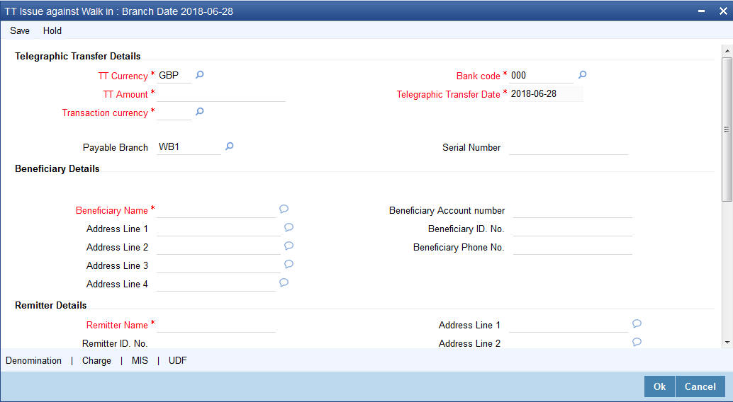

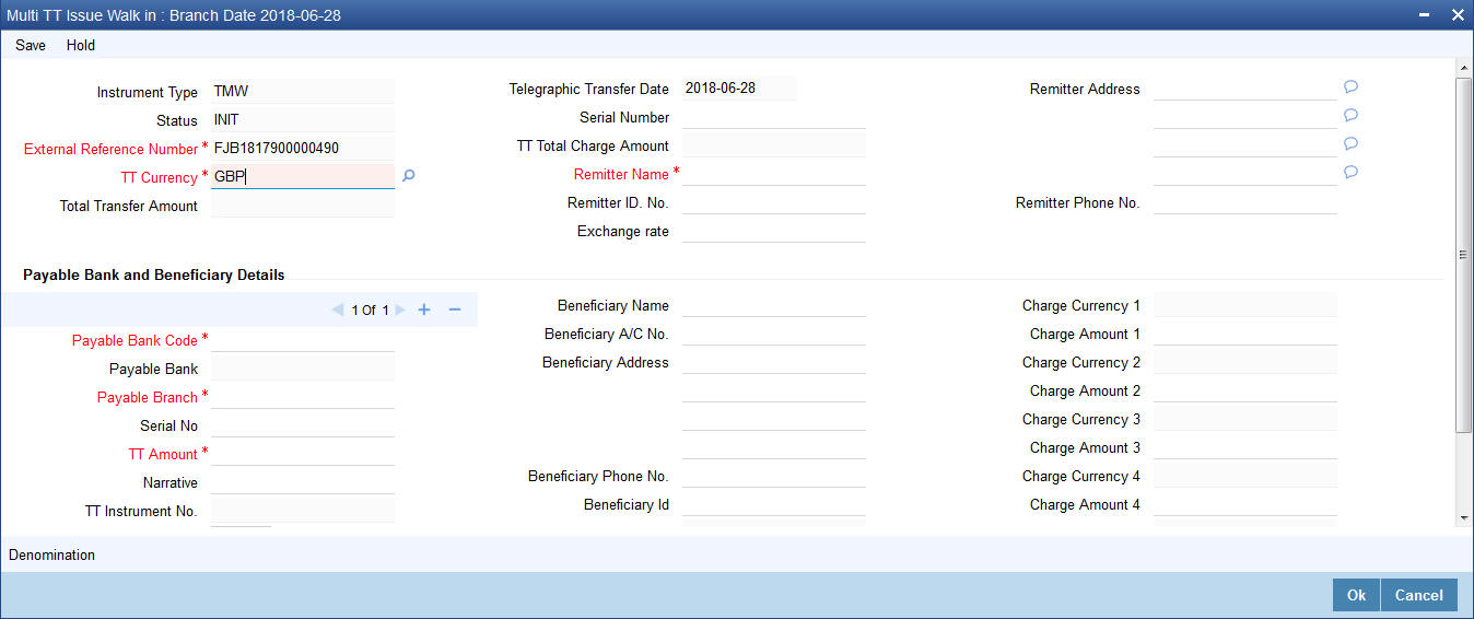

You can issue a Telegraphic Transfer to any walk-in customer through the ‘TT Issue (Walk-In)’ screen. You can invoke this screen by typing ‘8316’ in the field at the top right corner of the Application tool bar and clicking on the adjoining arrow button.
When you invoke the screen, the External Reference Number and instrument type of the transaction are displayed.
Bank Code
TT Currency
Specify the currency in which the TT is being issued.
Payable Branch
Specify the branch where the TT amount should be paid out.
Specify the currency in which the customer is making the payment.
TT Amount
Specify the amount for which the TT needs to be drawn in the transfer currency.
The date on which the instrument has been issued is displayed here.
Remitter Name
Remitter Address
Remitter ID Number
Specify the beneficiary Identification number.
Narrative
Beneficiary Name
Specify the name of the beneficiary in whose favor the telegraphic transfer is done.
Beneficiary Address
Specify the address of the beneficiary in whose favor the telegraphic transfer is done.

Click on the MIS tab to capture details pertaining to MIS.
Refer the section titled ‘Specifying MIS details’ under ‘Depositing Cash’ in this manual for further details.

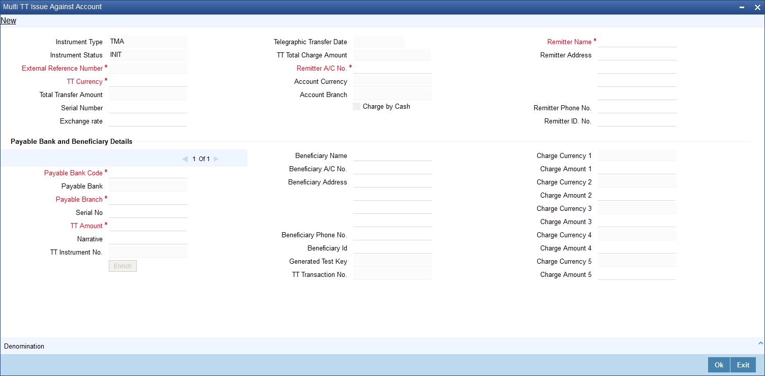

Issuance of multiple TT against a customer account with multiple beneficiaries respectively from single transactions is performed through this screen. The beneficiaries can be in different banks. The charge for this TT would be the sum of individual charges for each of the beneficiary banks. The charge can be collected either in cash or debited to the customer account. You can invoke the ‘Multiple TT Issue against Account’ screen, by typing ‘8324’in the field at the top right corner of the Application tool bar and clicking on the adjoining arrow button.
When you invoke this screen, the External Reference Number, Instrument Type and Instrument Status is defaulted.
Specify the following details in this screen:
TT Currency
Total Transfer Amount
The value in this field is defaulted. The sum total of the multiple TT amount is displayed in this field.
Specify the telegraphic transfer date.
Remitter Account Number
Specify the account number of the customer or select an account number from the adjoining option list.
To view the joint holder’s details of an account and the mode of operation maintained at the account level, place the cursor on the Remitter Account Number field and press Ctrl+J. The system displays the ‘Joint Holder’ screen.
Remitter Name
Remitter Address
Remitter ID Number
Charge by Cash
Check the box “Charge by Cash” to select the charge mode that is by cash or from account.
Payable Bank Code
Payable Bank
The name of the payable bank is displayed here.
Payable Branch
Serial Number
Specify the serial number.
TT Amount
TT Instrument Number
The instrument number of the generated child TT’s is system populated.
Narrative
Specify remarks pertaining to the transaction.
Beneficiary Name
Beneficiary Address
TT Transaction Number
The system displays the Telegraphic Transfer transaction number in this field.
On clicking the ‘Enrich’ button, the following fields are defaulted:
Test Key
This field stores the test key generated at Enrich Stage.
TT Total Charge Amount
The value in this field is defaulted. The Total Charge will be equal to sum of all the Charges as computed and returned by the ARC of Individual Child TTs in the Enrichment Stage.
Charge Amount 1 to 5
These fields are defaulted by the system. It computes all 5 charges (if applicable) for each individual child TT from their respective ARC and populates the same in the fields Charge 1,Charge 2, Charge 3, Charge 4, and Charge 5.
Charge Currency 1 to 5
The currency in which charge has to be deducted is displayed in these fields.
The Telegraphic Transfer transaction number is defaulted in this field.
In this block, you can capture details of the currency denominations for the charge, if the Charge by Cash is Y.
Issuance of Multiple TT against a walk-in customer with multiple beneficiaries from a single transaction is possible through this facility. You can invoke the ‘Multiple TT Issue against Walk in’ screen, by typing ‘8323’ in the field at the top right corner of the Application tool bar and clicking on the adjoining arrow button.
TT Currency
Specify the TT currency or select a currency for the TT from the adjoining option list.
Select the telegraphic transfer date in this field.
Remitter Name
Remitter Address
Remitter ID Number
Payable Bank Code
Payable Bank
Payable Branch
Serial Number
TT Amount
The system generates the instrument number of the generated child TT’s.
Narrative
Beneficiary Name
Beneficiary Address
On clicking the ‘Enrich’ button, the system populates the following details.
This field is auto populated. The Total Charge will be equal to sum of all the Charges as computed and returned by the ARC of Individual Child TTs in the Enrich Stage.
Test Keys
This field stores the test key generated. This field is defaulted at Enrich state.
The system displays the telegraphic transfer transaction number in the field.
These fields are defaulted by the system. It computes all 5 charges (if applicable) for each individual child TT from their respective ARC and populates the same in the fields Charge 1, Charge 2, Charge 3, Charge 4, and Charge 5.
The currency in which the charges need to be deducted is defaulted in these fields.

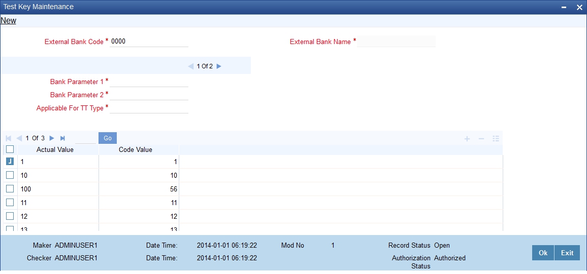

With this facility a unique Test Key is generated for Individual TT remittance when the funds are being remitted to another bank. It is also beneficial for validating funds remitted from external banks payable at the branches of Home Bank. The generated Test Key is a part of the outgoing TT message. The test key generation is based on the following parameters:
You can invoke the ‘TT Test Key Maintenance screen by typing ‘STDTTKEY’ in the field at the top right corner of the Application tool bar and clicking on the adjoining arrow button.
Specify the following details in this field:
External Bank Code
Select the external bank code from the adjoining option list. The option list displays all the bank codes as maintained in the ‘Clearing Bank Code Maintenance’.
External Bank Name
This field is defaulted as per your selection in the external bank code field.
Bank Parameter 1
Select the bank parameter from the drop down list. The available parameters are as follows:
Bank Parameter 2
Based on your selection in the Bank Parameter 1 field, select the appropriate value from the drop down list. The list of values displayed are as follows:
Applicable for TT type
Select the appropriate value from the drop down list. The list of values displayed are as follows:
Actuals
Specify the actual value in this field.
Code Value
Specify the code value in this field.

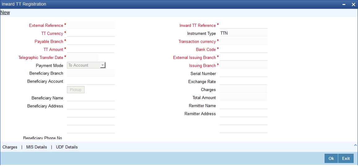

With this facility an inward remittance, that is, remittance from a external bank, is processed in the following manner:
Any charges, if applicable, is calculated and collected from the customer. The charges are calculated based on the remitting bank and branch, beneficiary branch, amount, and so on. The charges can be collected either in cash or debited to a customer account. At the time of processing this inward remittance, the test key sent by the remitting bank is also validated
You can invoke this screen by typing ‘8322’ in the field at the top right corner of the Application tool bar and clicking on the adjoining arrow button.
When you invoke the screen, the External Reference Number and Instrument type of the transaction are displayed.
TT Currency
Specify the currency in which the customer is receiving the payment.
TT Amount
Specify the amount that the customer is receiving.
Specify the Telegraphic Transfer Date.
Payable Branch
Specify the branch where the TT amount is paid out.
Payment Mode
Select the appropriate option from the drop down list to indicate whether the TT is Payable by Immediate Liquidation to Account or Payable by Deferred Liquidation.
Beneficiary Account
Select the beneficiary account number from the adjoining option list.
To view the joint holder’s details of an account and the mode of operation maintained at the account level, place the cursor on the Beneficiary A/C field and press Ctrl+J. The system displays the ‘Joint Holder’ screen.
Beneficiary Branch
The beneficiary’s home branch is displayed in this field on the selection of the beneficiary account.
Beneficiary Name
Beneficiary Address
Narrative
Instrument Number
The system displays the instrument number.
Inward TT Reference
Specify the Reference No. of the Inward Inter Bank TT.
Bank Code
Issuing Branch
Select the branch of the external bank where the TT has been issued. Only the branches of the External Bank for which the Bank Code is selected, is listed
Serial Number
Remitter Name
Remitter Address
Remitter ID Number
Input Test Key
Specify the Test Key sent by External Bank on the fax message of the TT
Click this button to retrieve details and compute charges if applicable. The following details are computed by the system:
Exchange Rate
Specify the rate of exchange.
Charges
The system displays the exchange to be used for the transaction in case the transaction
currency is different from the transfer currency.
Total Amount
The system computes the total amount to be paid by the walk-in customer by adding the charge amount to the TT amount.
Click on the ‘Charges’ button to capture charge related details.
Refer the section titled ‘Specifying the charge details’ under ‘Depositing Cash’ in this manual for further details.
Click on the MIS button to capture details pertaining to MIS.
You can capture these details in the ‘UDF’ button of the screen.

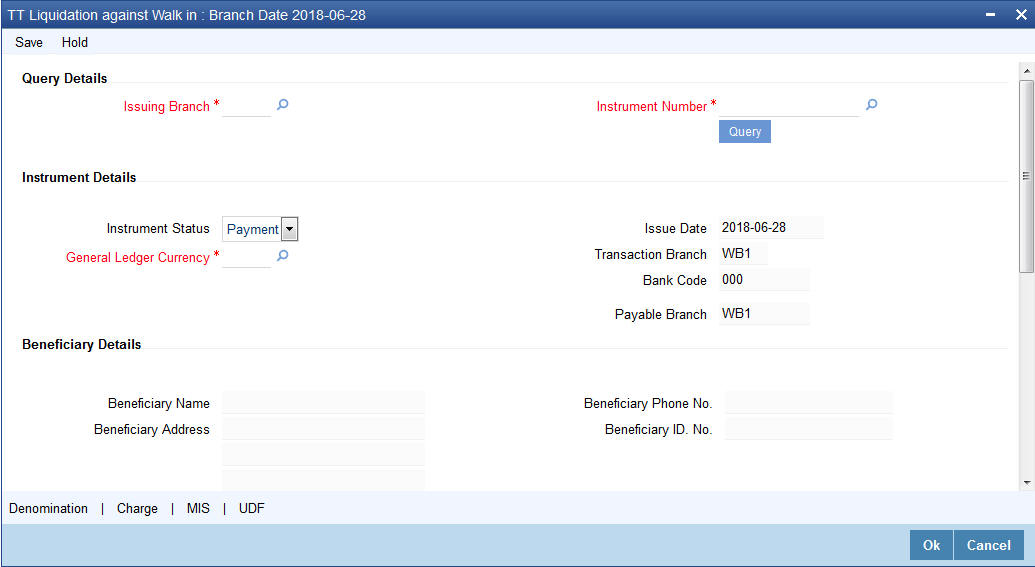

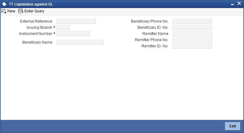

You can liquidate a telegraphic transfer drawn on your branch against a GL through the ‘TT Liquidation Against GL’ screen. You can invoke this screen by typing ‘8320’ in the field at the top right corner of the Application tool bar and clicking on the adjoining arrow button.
On invoking this screen, the External Reference Number of the transaction is displayed. Select the branch code in the ‘Issuing Branch’ field and the instrument number of the TT to be liquidated in the ‘Instrument Number’ field.
The following details will be auto populated:
Remitter Name
The name of the remitter is defaulted in this field.
The phone number of the remitter is defaulted in this field.
Remitter ID Number
The remitter ID number is defaulted in this field.
Test Key
The Test Key sent by External Bank on the fax message of the TT is defaulted in this field.
Beneficiary Name
The name of the beneficiary in whose favour the telegraphic transfer is done is defaulted in this field.
The phone number of the beneficiary is defaulted in this field.
The beneficiary Identification number is defaulted in this field.
Bank Code
The bank code of the clearing bank is displayed here.
Payable Branch
The system displays the current branch code (where the transaction is being captured).
Instrument Status
This indicates the mode of liquidation of the TT transaction. You can select the mode of liquidation to any of the values available in the adjoining drop-down list:
GL Currency
The GL currency is defaulted to the instrument currency. However you can change it. The adjoining option list displays all the currency codes maintained in the system. Choose the appropriate one.
GL Number
The GL into which the amount should be liquidated is displayed here.
TT Currency
Displays the currency in which the instrument was issued.
TT Status
The system displays the last event that has been triggered for the transaction. This corresponds to the status of the instrument.
The system displays the date on which the TT was issued.
Beneficiary Address
The address of the beneficiary of the transaction is displayed here.
Passport/IC No
The passport number or a unique identification number of the customer is displayed here.
Narrative
The remarks associated with the transaction are displayed here.

You can liquidate a TT against an account through the ‘TT Liquidation Against Account’ screen. You can invoke this screen by typing ‘8321’ in the field at the top right corner of the Application tool bar and clicking on the adjoining arrow button.
The following fields will be auto populated:
Remitter Name
The name of the remitter is defaulted.
Remitter ID Number
The remitter ID number is defaulted.
Test Key
The Test Key sent by External Bank on the fax message of the TT is defaulted.
Beneficiary Name
The name of the beneficiary in whose favor the telegraphic transfer is done is defaulted.
The phone number of the beneficiary is defaulted.
The beneficiary Identification number is defaulted.
Bank Code
The clearing bank code is displayed here.
Payable Branch
The branch where the TT has to be liquidated is displayed here.
Instrument Status
Specify the liquidation mode. You can choose any of the following values available in the drop-down list:
TT Status
Account Currency
The currency of the chosen account is displayed here.
TT Currency
TT Amount
Account Number
Specify the account into which the TT should be liquidated.

The Charges, MIS and UDF tabs will be displayed at this stage. This block allows you to capture charge related details.
Refer the section titled ‘Specifying the charge details’ under ‘Depositing Cash’ in this manual..

You can liquidate a Telegraphic Transfer for a walk-in customer and give the customer an equivalent amount in cash. In order to capture such a transaction, invoke the ‘TT Liquidation (Walk-In)’ screen. You can invoke this screen by typing ‘8319’ in the field at the top right corner of the Application tool bar and clicking on the adjoining arrow button.
Remitter Name
The phone number of the remitter is defaulted.
Remitter ID Number
Test Key
Beneficiary Name
The name of the beneficiary in whose favor the telegraphic transfer is done, is defaulted.
Beneficiary Address
The address of the beneficiary is displayed her.
Instrument Status
The system displays the liquidation mode of the TT. However, you can change it.
The adjoining drop-down list displays the following values:
Bank Code
Instrument Currency
The system displays the currency in which the TT has been issued.
TT Instrument Amount
The amount for which the cheque amount has been issued is displayed here.
Payable Branch
The branch where the transfer amount is being paid out (current branch) is displayed here.
TT Status
The status of the transaction is displayed here.
Passport/IC Number
GL Currency
Narrative
Note
The Inter Bank Outward TT Issuance will not be available for the Payment in the Liquidation Process. The Inter Bank Outward TT will be available for only Refund and Cancel event at the Refund at the Issuing and Payable branch respectively, under the TT Liquidation Process.
The Denomination, Charges, MIS and UDF tabs are displayed at this stage.
In this block, you can capture details of the currency denominations involved in the transaction. Refer the section titled ‘Specifying denomination details’ under ‘Depositing Cash’ for further details.

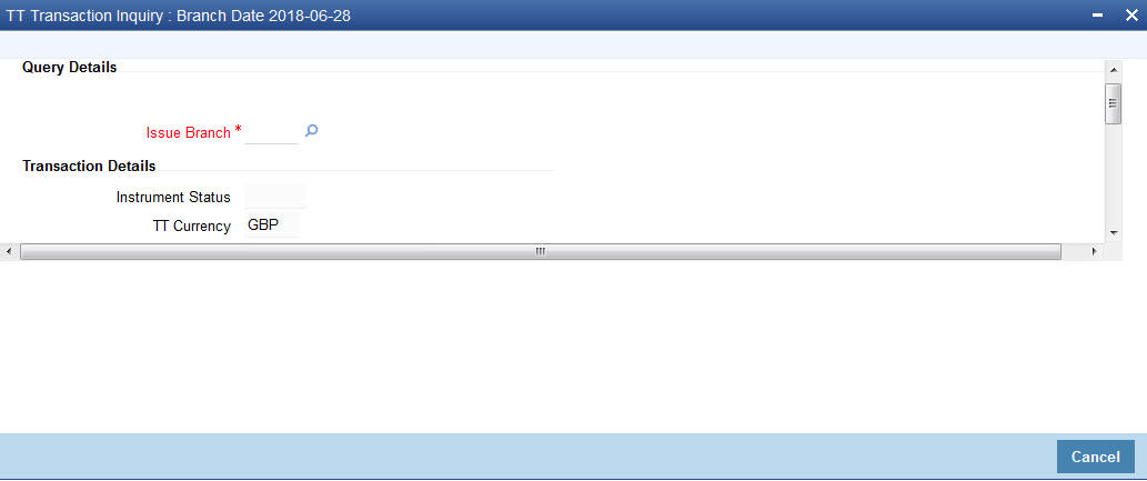

You can query a Telegraphic Transfer transaction for a specified branch and Instrument Number. This can be done by using the ‘TT Inquiry’ screen. You can invoke this screen by typing ‘7795’ in the field at the top right corner of the Application tool bar and clicking on the adjoining arrow button.
Issue Branch
Specify a branch for which you wish to query the TT transaction. Or select a branch from the list of values.
Instrument Number
Specify an instrument number of the TT transaction that needs to be queried.
After you specify the above details, click ‘Ok’ button.
The system will display the following details based on the instrument number:
Clicking ‘Query’ button, the system validates if all the mandatory details are specified. This button will be disabled after the first click.

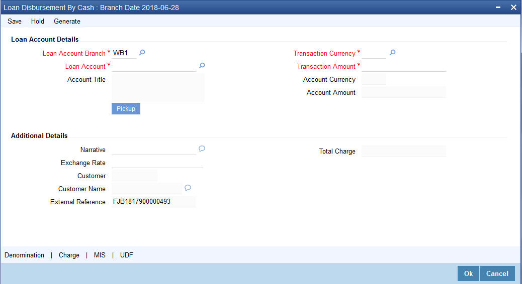

You can manually disburse loan amount by cash using the ‘Loan Disbursement by Cash’ screen. You can invoke this screen by typing ‘5001’ in the field at the top right corner of the Application tool bar and clicking on the adjoining arrow button. The screen is displayed below:
The system displays a unique number.
Product
The retail teller product code ‘LDCH’ is displayed in this field.
Loan Account Branch
Specify the loan account branch from which the amount is to be disbursed. You can also select the appropriate branch from the adjacent option list. The list displays all the branches maintained in the system.
Loan Account
Specify the loan account number from which the amount is to be disbursed. You can also select the appropriate account number from the adjacent option list. The list displays all the valid loan accounts maintained in the system.
Disbursement Currency
Specify the currency of the disbursement amount. You can also select the appropriate currency from the adjacent option list. The list displays all the currencies maintained in the system. The denomination tracking will be against this currency.
Disbursement Amount
Specify the disbursement amount.
Narrative
Specify any remarks for the transaction.
After specifying the above details, click ‘Save’ button. The following screen along with the loan details is displayed:
The details specified in the first screen are displayed here. However, you can capture the following details:
Disbursement Amount
The disbursement amount mentioned in the first screen is displayed here. However, you can modify the same. Specify the disbursement amount and click ‘Recalculate’ button to calculate the total cash being disbursed.
Total Cash Disbursed
The total cash disbursed, after deducting the charges is displayed.
Exchange Rate
Loan Account Title
You can specify any title or remarks for the loan account.
Narrative
You can specify denomination details if you have checked the ‘Denomination Tracking Required’ option in the ‘Function Workflow Definition Detail’ screen.
Units
Specify the number of units for each denomination.
Total Amount
The total amount for each denomination is displayed.
On saving the transaction, it will move to the enrichment stage for further processing.

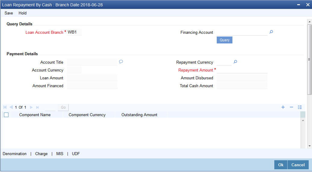

You can manually repay retail loan amount by cash using the ‘Repayment towards Loan’ screen. You can invoke this screen by typing ‘5401’ in the field at the top right corner of the Application tool bar and clicking on the adjoining arrow button. The screen is displayed below:
Here, you query the loan details by specifying the following:
Loan Account Branch
Specify the branch of the loan account for which the amount is to be repaid.
Loan Account Number
Specify the loan account number for which the amount is to be repaid.
Click ‘Save’ button. The total amount financed, disbursed, the total outstanding amount for each component and currency is displayed in the following screen:
Specify the following in this screen:
Loan Account Branch
Loan Account Number
Repayment Currency
Specify the currency of repayment amount. You can also select the appropriate currency from the adjacent option list. The list displays all the valid currencies maintained in the system. The denomination tracking will be against this currency.
Repayment Amount
Specify the amount to be repaid.
Narrative

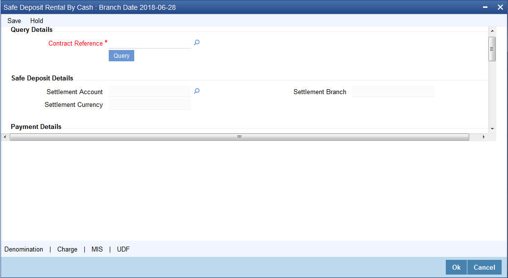

Your customer can pay rental for the safe deposit box either by cash or from the account. The cash payment is processed through the ‘Safe Deposit Rental By Cash’ screen as detailed below:
You can invoke the ‘Safe Deposit Rental By Cash’ screen by typing ‘3401’ in the field at the top right corner of the Application tool bar and clicking on the adjoining arrow button. The following screen is displayed:
In this screen, select the Contract Reference Number of the transaction from the option list and click Populate.
Settlement Account
The system will display the account selected at the contract level. You can modify this, if required.
Settlement Branch
The system will display the branch selected at the contract level. You can modify this, if required.
Settlement Currency
The system will display the currency selected at the contract level. You can modify this, if required.
The system displays the following details from the DL contract schedules:
You can modify the values in these fields
Total Charges
The system displays sum of total teller product (ARC) level charges in Transaction Currency.
Net Amount
The system displays the sum of Transaction Amount and Total Charges and will be in Transaction Currency. Denomination Tracking will be done for the Net Amount in Transaction Currency.
Narrative
Specify the narrative.
Product
The system displays the product.
Related Customer
The system displays the related customer.
Customer Name

In this screen, you can enter the details pertaining to Denomination, Charge, MIS and UDF:
Enter the following detail:
Specify the denomination in which the cash should be paid.
After entering the denomination click ‘Populate’. The system will default the units for the denomination specified. You can modify the denomination and units if required.
If you do not enter any preferred denomination after clicking ‘Populate’, the system will default the denomination code and other details to the extent of the transaction amount. If you wish to modify these details, you may do so by clicking ‘Clear’, specifying the preferred currency and then clicking the ‘Populate’ button.
Refer the corresponding section under ‘Depositing Cash’ for details on MIS and UDF

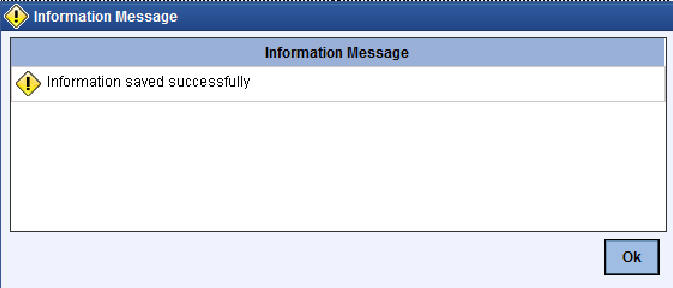

Click the save icon. The following screen is displayed:

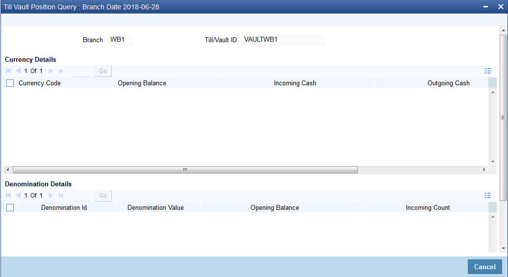

You can view the cash position for all the currencies in the Till for the current day and view the vault position including denomination, at any given point of timein the ‘Till Vault Position Query’ screen. You can invoke this screen by typing ‘TVQR’ in the field at the top right corner of the Application tool bar and clicking the adjoining arrow.
Here you can view the following details:
Branch Code
The system displays the current branch code.
Till/Vault ID
The system displays the identification of the currently logged in user.
Currency Code
The system displays the code of the currency available in the Till.
Opening Balance
The system displays the opening balance in the Till for the day.
Incoming Cash
The system displays the incoming cash in the Till for the day.
Outgoing Cash
The system displays the outgoing cash in the Till for the day.
Total Cash
The system displays the total cash currently available in the Till.
Check one of the Till details record to view the following currency details:
Denomination ID
The system displays the denomination code for the currency in the selected till details record.
Denomination Value
The system displays the value of the corresponding denomination ID.
Opening Balance
The system displays the opening balance in the till for the day in terms of denominations.
Incoming Cash
The system displays the incoming cash in the Till for the day in terms of denominations.
Outgoing Cash
The system displays the outgoing cash in the Till for the day in terms of denominations.
Total Cash
The system displays the total cash currently available in the Till for the day in terms of denominations.
You can sell foreign currency from the branch through the CASA account. You can do this by debiting corresponding account currency from CASA account. You can capture this foreign currency sale transaction through the ‘FX Sale against Account’ screen. You can invoke this screen by typing ‘8206’ in the field at the top right corner of the Application tool bar and clicking on the adjoining arrow button.
Account
Specify the CASA account to be debited for the foreign currency sale from the adjoining option list.
To view the joint holder’s details of an account and the mode of operation maintained at the account level, place the cursor on the Accounts field and press Ctrl+J. The system displays the ‘Joint Holder’ screen.
Account Description
The description of the customer account gets defaulted based on the selected account number.
Account Branch
The account opening branch detail gets defaulted based on the selected account number.
Account Currency
Amount
The system displays the amount.
FX Currency
Specify the foreign currency sold by the bank to the customer from the adjoining option list.
FX Amount
Specify the total value of the foreign currency sold to the customer.
This Check box will have the value Y by default only if you have set the required parameter to ‘Yes’ in ‘FBTB_PARAMS.
On clicking the pickup button, the following details will be defaulted:
Narrative
You can input additional remarks for the transaction, if there are any.
Currency Rate
Specify the current exchange rate of the currency.
Negotiated Rate
Charges
The system displays the charge amount associated with the retail teller product FXSA in account currency.
Net Amount
It is the sum of actual account currency amount and the charges incurred.
Passport/IC no
Specify either the passport number or the unique identification number of the customer.
Beneficiary Name
Specify the name of the beneficiary which will be reflected in the advice.
Beneficiary Address
External reference
This is the unique transaction number generated by the system for each transaction. The host system identifies a branch transaction with the external reference number.
You can modify any of the charges for any of the components. In case of modification, you need to click ‘Recalculate’ button. The system will compute the new charge amount and display the same. In case you modify the charge details and don’t click on this button, the system will trigger the charge recalculation internally, when you click the save button.
This screen allows you to capture details pertaining to MIS. Click on the ‘MIS’ button to invoke the following screen:
Note
ARC Maintenance will be done for the FXSA product with the required accounting entries.
For details on the ARC maintenance, refer the section on ARC Maintenance screen in Utility Payments user manual.
