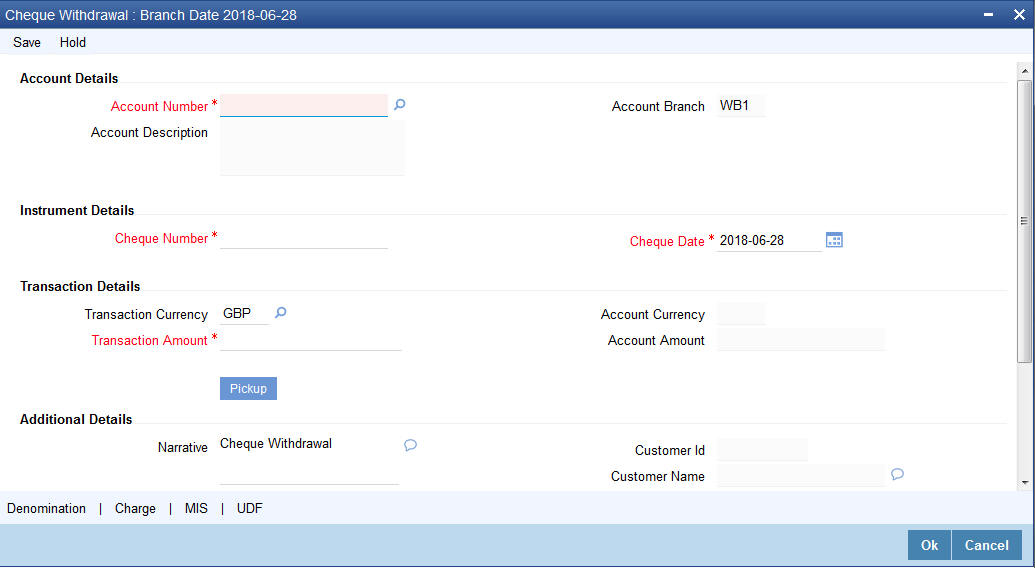

Your customer can withdraw money from his/her account by issuing a cheque on the account. You can capture such a transaction through the ‘Cheque Withdrawal’ screen. You can invoke this screen by typing ‘1013’ in the field at the top right corner of the Application tool bar and clicking the adjoining arrow button.
Here you can capture the following details:
Account Number
Specify the customer account into which the cash needs to be deposited.
Note
In case of multiple accounts with the same account number, the system will display a list of account numbers with account branches to select.
To view the joint holder’s details of an account and the mode of operation maintained at the account level, place the cursor on the Account Number field and press Ctrl+J. The system displays the ‘Joint Holder’ screen.
For more information on the ‘Joint Holder’ screen refer to the section ‘Joint Holder Maintenance’ in the Core User Manual.
Account Branch
The system displays the logged-in branch. If you specify another account number and tab out of the Account Number field, the system displays the corresponding account branch.
Account Description
Enter a brief description on the account.
Cheque Number
Specify the MICR number displayed on the cheque leaf.
Cheque Date
Specify the date displayed on the cheque leaf.
Transaction Currency
The system displays the local currency. If you specify another account number and tab out of the Account Number field, the system displays the currency associated with the account.
Transaction Amount
Specify the amount that should be debited from another account in terms of transaction currency. If the account to be debited is a Trust account, this amount should be within the cash withdrawal limit defined for the debited account class.
Account Currency
The system displays the logged-in currency. If you specify another account number and tab out of the Account Number field, the system displays the currency associated with the account.
Account Amount
The system displays the transaction amount. You cannot modify it..
Narrative
The system displays ‘Cheque Withdrawal’. You can modify it, if required.
In the single stage flow, if there is an transaction level override or error during approval then the transaction will be moved to the pending queue. Without save action being initiated, the transaction will not be in pending queue.
On clicking Pickup button, the system populates the values in all the callforms of the screen and clicking pickup button is mandatory if you make any changes to the Transaction amount and exchange rate after first pickup.
Once you click ‘Pickup’ button, then on amendment of xrate, amount, charge, pickup will be mandatory before save.
Customer ID
The system displays the customer ID based on the account that is specified.
Exchange Rate
The system displays the exchange rate used to convert the transaction currency into account currency. If the transaction currency is the same as the account currency, the system will display the exchange rate as ‘1’.
Negotiated Cost Rate
Specify the negotiated cost rate that should be used for foreign currency transactions between the treasury and the branch. You need to specify the rate only when the currencies involved in the transaction are different. Otherwise, it will be a normal transaction.
Negotiation Reference Number
Specify the reference number that should be used for negotiation of cost rate, in foreign currency transaction. If you have specified the negotiated cost rate, you need to specify the negotiated reference number also.
Note
Oracle FLEXCUBE books the online revaluation entries based on the difference in exchange rate between the negotiated cost rate and transaction rate.
Reject Code
Specify the Reject Code. The adjoining option list displays the list of all the reject codes maintained in the system. You can choose the appropriate one.
Note
If you reject a cheque without giving the reject code then that cheque can be reused. However, if you enter the reject code then the cheque will be rejected.
Total Charge
The system calculates the charges applicable to the transaction and displays the amount here.
External Reference Number
The system generates and displays a unique number based on the branch-specific sequence number generation logic. The Host system identifies a branch transaction with the external reference number.
In this block, you can capture details of the currency denominations involved in the transaction through the following fields:
Currency Code
The system displays the currency of the account.
Denomination Code
The system defaults the denomination code as maintained in the ‘Denomination Maintenance’ screen.. For every currency, the various denominations are assigned separate denomination codes..
Denomination Value
The system computes the face value of the denomination and displays it. For instance if the denomination code represents a USD 100, the value will be displayed as ‘100’.
Units
Indicate the number of units of the specified denomination. By default, till contents are decremented for outflow transactions like cash withdrawal. To reverse this default behavior, you can specify units in negative.
Total Amount
The system computes the denomination value by multiplying the denomination value with the number of units. For instance, if the denomination code represents a USD 100 and the number of units is 10, the denomination amount will be ‘1000’.

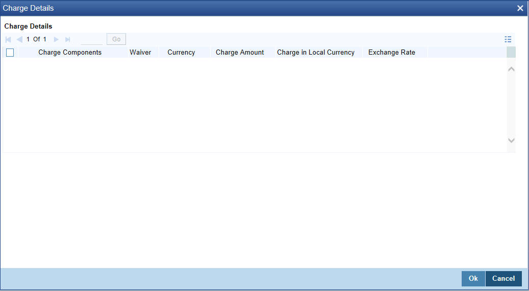

This block allows you to capture charge related details. Click on the ‘Charges’ tab and invoke the following screen.
Charge Component
The system displays the charge component that is levied on the transaction.
Waiver
This option is unchecked by default, thereby indicating that the charge needs to be levied. However, you can check this option to waive the charge. If you check this option, you will have to click the ‘Recalculate’ button to re-compute the net amount to be credited to the account.
Charge Currency
The system displays the currency in which the charge has to be levied.
Charge Amount
The system displays the charge amount in the charge currency. However you can change it. You will then have to recalculate the charge and net transaction amount.
Charge in LCY
In case the transaction currency is different from the local currency, the system will compute the local currency equivalent of the charge and display it here.
Exchange Rate
The exchange rate used for the currency conversion is displayed here. If the charge currency is the same as the transaction currency, the system will display ‘1’ as the exchange rate.
Charge Currency
This block allows you to capture details pertaining to MIS. Click on the ‘MIS’ tab to invoke the following screen:
You can capture the following details here:
This block allows you to capture details pertaining to MIS. Click on the ‘MIS’ tab to capture the following details:
Transaction MIS
Specify the transaction MIS. The adjoining option list displays a list of transaction MIS codes maintained in the system. You can choose the appropriate one.
Composite MIS
Specify the composite MIS. The adjoining option list displays a list of composite MIS codes maintained in the system. You can choose the appropriate one.
You can capture these details in the ‘UDF’ tab of the screen.
UDF Name
The system displays the various User-Defined Fields (UDFs) that you have maintained for the product in the Host.
UDF Value
Specify the value for the each UDF that is displayed.
Note
The MIS-related fields displayed here are based on the MIS configuration done at the Host.
Refer the ‘MIS’ User Manual of Oracle FLEXCUBE Host, for further details about MIS.
Click save icon to save the transaction.
The system displays overrides on a separate window. You can either accept or reject the overrides and proceed with saving the transaction. If you click ‘Reject’ button, the screen will remain in the enrichment stage for you to make changes to charge elements. Then if you click ‘Save’, the system will initiate reversal of the transaction without reversing the charges.
The authorization process is similar to that of cash deposit.

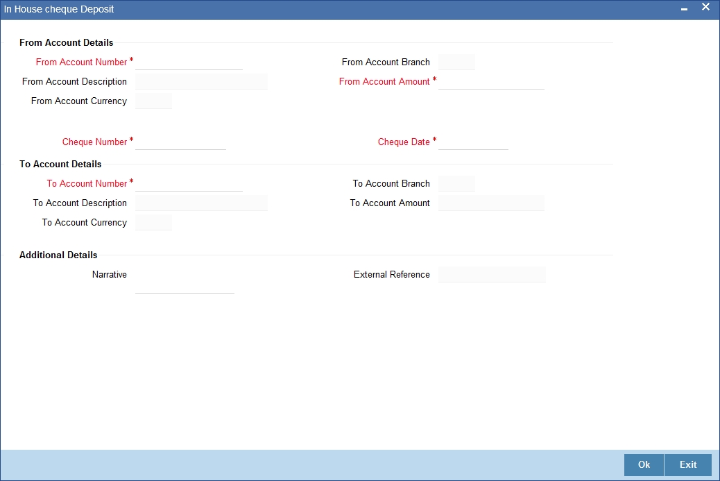

The In-house cheques will deposit using the existing Outward Clearing Data Entry screens if Customer float days are greater than zero for the product or if sufficient funds are not available during cheque deposited from existing LOCH screen. If the in-house cheques are initiated using Outward Clearing Data Entry screen, the system will follow the regular life cycle of inward clearing contract creation and return handling like other normal clearing cheques.

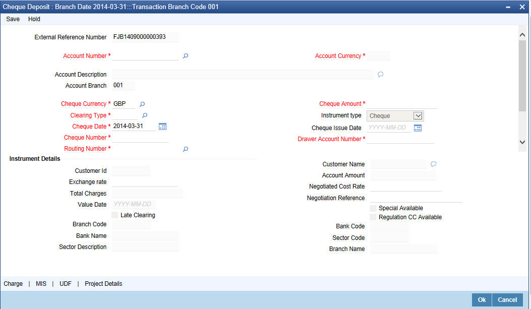

You can deposit a cheque into your customer’s account through the ‘Cheque Deposit’ screen. You can invoke this screen by typing ‘6501’ in the field at the top right corner of the Application tool bar and clicking the adjoining arrow button.
External Reference
The system generates a unique number based on the branch-specific sequence number generation logic and displays it here. The Host system identifies a branch transaction with the external reference number.
Account Number
Specify the customer account number into which the cash needs to be deposited.
Note
Account Currency
The system displays the currency associated with the account.
Account Description
The system displays the description of the account number chosen.
Account Branch
Cheque Currency
Cheque Amount
Specify the amount that needs to be deposited to the account; in terms of local currency.
Clearing Type
Specify the product that is maintained in the system for the transaction. The adjoining drop-down list displays the outward and inward clearing products. For example:
Cheque Issue Date
To specify the issue date of the cheque, click on the adjoining calendar icon and select the appropriate date.
Note
If the difference between the ‘Cheque issue date’ and the ‘Cheque Date’ is greater than the ‘Cheque Stale Days’ maintained at the ‘Branch Parameters Maintenance’ screen, an error message will be displayed stating that the cheque is a stale one. However, a stale cheque validation would not be done if the field ‘Cheque Stale days’ is not maintained at the ‘Branch Parameters Maintenance’ screen.
Cheque Number
Specify the MICR number displayed on the cheque.
Drawer Account Number
Specify the account number on which the cheque is drawn.
Routing Number
Specify the routing number for cheque clearance. .The adjoining option list displays all routing numbers along with the Branch codes and Bank Codes. You can select the appropriate one.
Narrative
The system defaults the narrative as 'Cheque Deposit - Cheque no - Cheque Number – Drawer A/c Number - Account Number'. Once you specify the ‘Cheque Number’ and ‘Drawer Account Number’, the system replaces the field values respectively on tabbing out from the field.
Clicking ‘Pickup’ button, the system displays the following details:
Customer ID
The system displays the customer ID based on the account specified.
Exchange Rate
Account Amount
The system displays the cheque amount in terms of account currency.
Total Charges
Specify the reference number that should be used for negotiation of cost rate, in foreign currency transaction. If you have specified the negotiated cost rate, then you need to specify the negotiated reference number also.
Late Clearing
The system indicates whether the cheque has been cleared on the same day or is marked for late clearing.
Regulation CC Available
Check this box to indicate that the ‘Reg CC’ facility is available for the transaction.
Special Available
Check this box to indicate that the ‘special availability’ facility is available for the transaction.
Bank Code
The system displays the clearing bank code based on the routing number.
Bank Name
The system displays the name of the clearing bank based on the routing number.
Branch Code
The system displays the branch code of the clearing bank, based on the routing number.
Branch Name
The system displays the branch in the clearing bank, based on the routing number.
Sector Code
The system displays the sector code of the clearing bank, based on the routing number.
Sector Description
The system displays the description of the sector.
Note

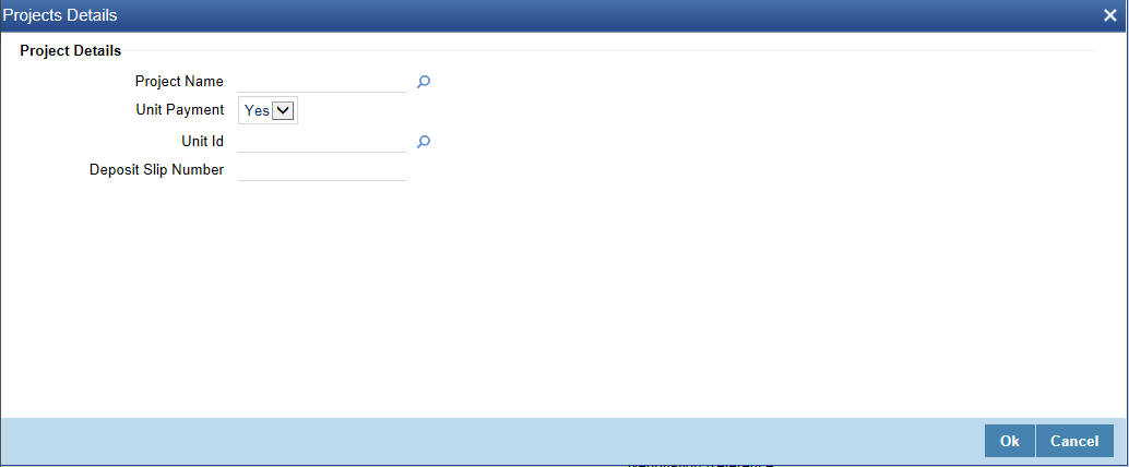

You can capture project details under ‘Project Details’ tab. Note that this tab will be applicable only if the cheque is being deposited into a Trust account.
Specify the following details:
Project Name
Specify the developer project name for which payment is being made. The adjoining option list displays all valid projects maintained in the system. You can select the appropriate one. Input to this field is mandatory.
Unit Payment
Indicate whether the transaction is a unit payment or not by choosing the appropriate value from the adjoining drop-down list. The following values are available:
Unit ID
Specify the unit ID of the project.The adjoining option list displays all unit IDs along with the unit holder names corresponding to the project name chosen. You can select the appropriate one.
If you specify the Project Name, the system will display the Unit Ids in the list of values here.
Deposit Slip Number
Specify the deposit slip number for the payment.
Click save icon to go to the next stage.

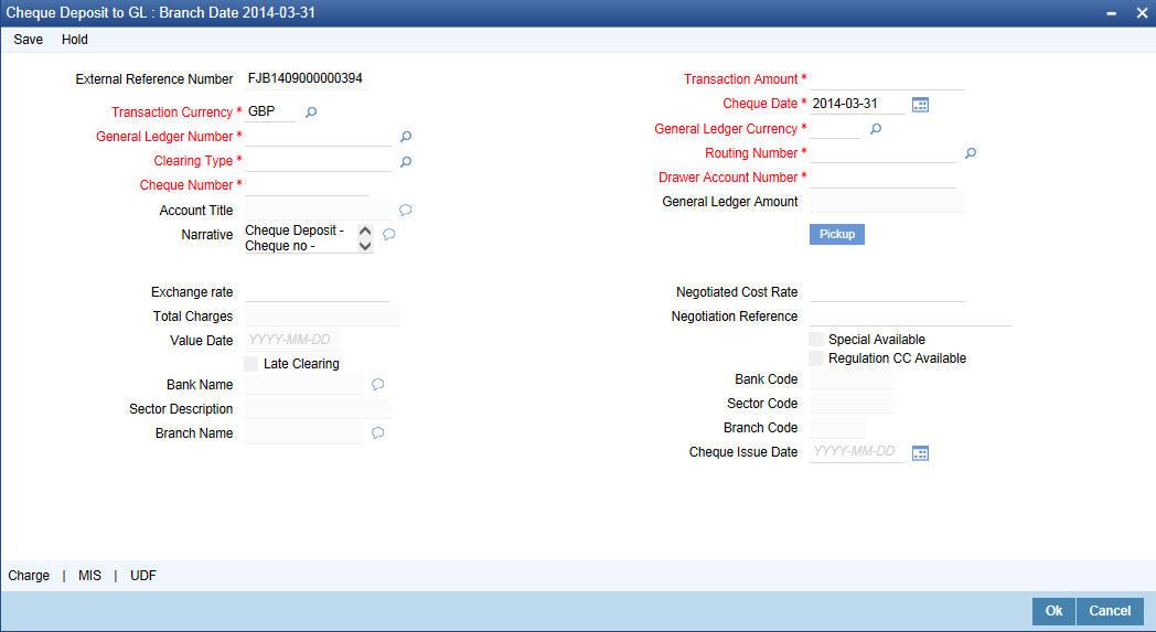

Your customer can deposit a cheque into a GL. You can capture this transaction through the ‘Cheque Deposit to GL’ screen. You can invoke this screen by typing ‘6520’ in the field at the top right corner of the Application tool bar and clicking on the adjoining arrow button.
Transaction Amount
Specify the amount that needs to be deposited into the GL.
The system defaults the account currency as the transaction currency. However, you can modify it. The adjoining option list displays all the currency codes maintained in the system. You can select the appropriate one.
Cheque Date
The system defaults the system date as the cheque date. However, you can edit it from the adjoining calendar.The chosen date will then be seen in the ‘YYYYMMDD’ format.
General Ledger Number
Specify the GL into which the cheque is being deposited. The adjoining option list displays all the GL codes maintained in the system. You can select the appropriate one.
General Ledger Currency
Specify the currency of the GL into which the customer is depositing a cheque. The adjoining option list displays all the currency codes maintained in the system. You can select the appropriate one.
Clearing Type
Select the appropriate one.
Routing Number
Cheque Number
Specify the account on which the cheque is drawn.
General Ledger Amount
The system adds the charges to the transaction amount and displays the total amount that will be credited to the GL.
Account Title
On specifying the account number, the corresponding account title (description) is displayed.
Narrative
The system defaults the narrative as 'Cheque Return - Cheque no - Cheque Number - Reject Reason'. Once you specify the 'Cheque Number' and 'Reject Reason', the system replaces the field values respectively on tabbing out from the field.
Exchange Rate
The system displays the exchange rate used to convert the transaction currency into GL currency. If the transaction currency is the same as the GL currency, the system will display the exchange rate as ‘1’.
Total Charges
The system displays the service charges applicable to the transaction.
Note
Special Available
Late Clearing
Refer the section titled ‘Specifying instrument details’ and ‘Capturing instrument details’ under ‘Depositing a Cheque’ for further details about maintaining instrument details for this transaction.
Bank Name
Branch Name
Sector Code

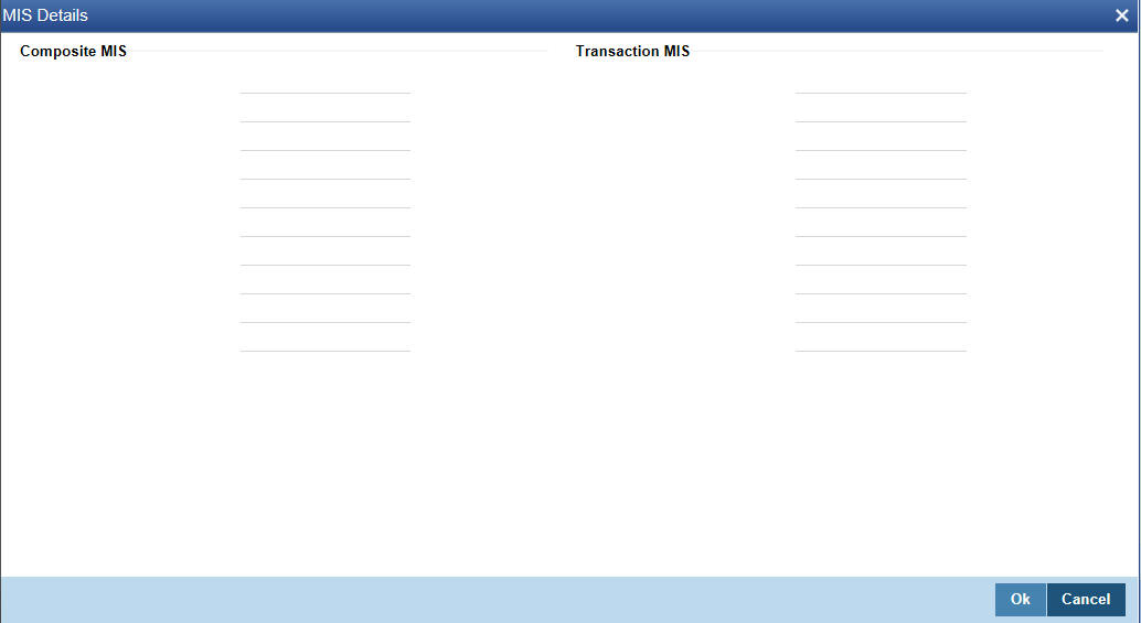

Charge Details sub-screen allows you to capture charge related details for the transaction. Click on the ‘Charge Details’ tab to view the Charge Detailsscreen.Refer the section titled ‘Specifying charge details’ under ‘Withdrawing Cash against a Cheque’ for further details.
This block allows you to capture details pertaining to MIS. Click on the ‘MIS’ tab to invoke the MIS Details screen.Refer the section titled ‘Specifying the MIS details’ under ‘Withdrawing Cash against a Cheque’ for further details.
The approver can fetch this transaction for his/her task list and authorize it. The authorization process is similar to that of cash deposit.
You can capture the UDF details under ‘UDF’ tab. Click the tab button ‘UDF’. The system displays the following details:
Refer the corresponding section under ‘Depositing Cash’ in the chapter ‘Cash Transactions’ of this User Manual for further details.
Refer the chapters titled ‘Transaction Workflow’ and ‘Common Operations’ in this User Manual for details on the authorization process.
You can capture deposit transactions for cheques issued by your bank to your customers through the ‘In House Cheque Deposit’ screen. You can invoke this screen by typing ‘LOCH’ in the field at the top right corner of the Application tool bar and clicking on the adjoining arrow button.
From Account Number
Specify the drawer account number. The adjoining option list displays all the accounts maintained in the logged-in branch. You can choose the appropriate one.
To view the joint holder’s details of an account and the mode of operation maintained at the account level, place the cursor on the From Account Number field and press Ctrl+J. The system displays the ‘Joint Holder’ screen.
From Account Branch
The system displays the current logged in branch. This means that you will be able to specify an account that resides in the current branch only.
From Account Description
From Account Currency
The system displays the currency of the drawer account.
From Account Amount
Specify the transferrable amount in the currency associated with the From Account.
Cheque Number
Specify the cheque number.
Cheque Date
Specify the cheque date from the adjoining calendar.
Product
The system displays the code of the retail teller product that will be used in the Host for processing the transaction.
To Account Number
Specify the beneficiary account that needs to be credited with the cheque amount. The adjoining option list displays all the accounts maintained across different branches in the Host. You can choose the appropriate one. However, the option list will display the values only on specifying the ‘to account branch’ field.
If you have already specified the branch codes for the beneficiary account in the ‘To Account Branch’ field, the option list will display only those accounts that belong to the chosen branch.
To Account Branch
Specify the branch where the beneficiary account resides. The adjoining option list displays all the branch codes maintained in the system. You can choose the appropriate one.
To Account Currency
The system displays the currency of the beneficiary account.
Amount
Specify the amount for which the cheque has been drawn.
Narrative
Here, you can enter remarks for the transaction.

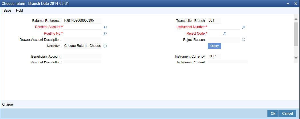

Transaction Branch
The current logged branch code is displayed here.
Remitter Account
Specify the remitter account number. Alternatively, you can select remitter account number from the option list. The list displays all valid remitter account number maintained in the system.
Instrument Number
Specify the instrument number. Alternatively, you can select instrument number from the option list. The list displays all valid instrument number maintained in the system.
Reject Code
Specify the reject code. Alternatively, you can select reject code from the option list. The list displays all valid reject code maintained in the system.
Reject Reason
The system displays the reason for the selected reject code.
Drawer Account Description
The system displays the description of the specified drawer account number based on the details maintained at ‘Customer Account Maintenance’ level.
Routing No
Once the drawee account number is specified, you can select the routing number from the adjoining option list. Alternately, you can choose a routing number along with the Branch codes and Bank Codes from the adjoining list and view the corresponding cheque number and account number.
Narrative
After specifying the mandatory details, click ‘Query’ button, to display the following values:
To view the joint holder’s details of an account and the mode of operation maintained at the account level, place the cursor on the Drawee Accounts Number field and press Ctrl+J. The system displays the ‘Joint Holder’ screen.
System displays the following details under ‘Charge Details’ section:
Waiver
Check this box to waive the charge.
Charge Amount
System displays the calculated charge amount here. You can amend this, if required.

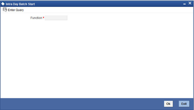

You can invoke 'Intra Day Batch Start' screen by typing 'BABIDBAT' in the field at the top right corner of the Application tool bar and clicking the adjoining arrow button.
Select the function ID of the batch to be executed. Click 'OK' button. The system triggers the batch process.

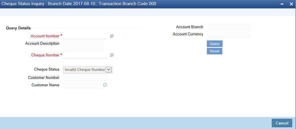

You can query the details of a cheque by specifying the customer’s account number and cheque number in the ‘Cheque Status Inquiry’ screen. You can invoke this screen by typing ‘CQIN’ in the field at the top right corner of the Application tool bar and clicking on the adjoining arrow button.
Account Number
Specify the account number. The adjoining option list displays all the valid account numbers maintained in the account branch selected. You can choose the appropriate one.
Account Branch
Specify the branch code. The adjoining option list displays all the valid branch codes maintained in the system. You can choose the appropriate one.
Account Description
The system displays a brief description on the account.
Account Currency
The currency of the chosen account is displayed here.
Cheque Number
Specify the cheque number. The adjoining option list displays all the valid cheque numbers maintained in the account number selected. You can choose the appropriate one.Click ‘Reset’ button once you specify the account number and cheque number. The following details will be displayed in the screen:

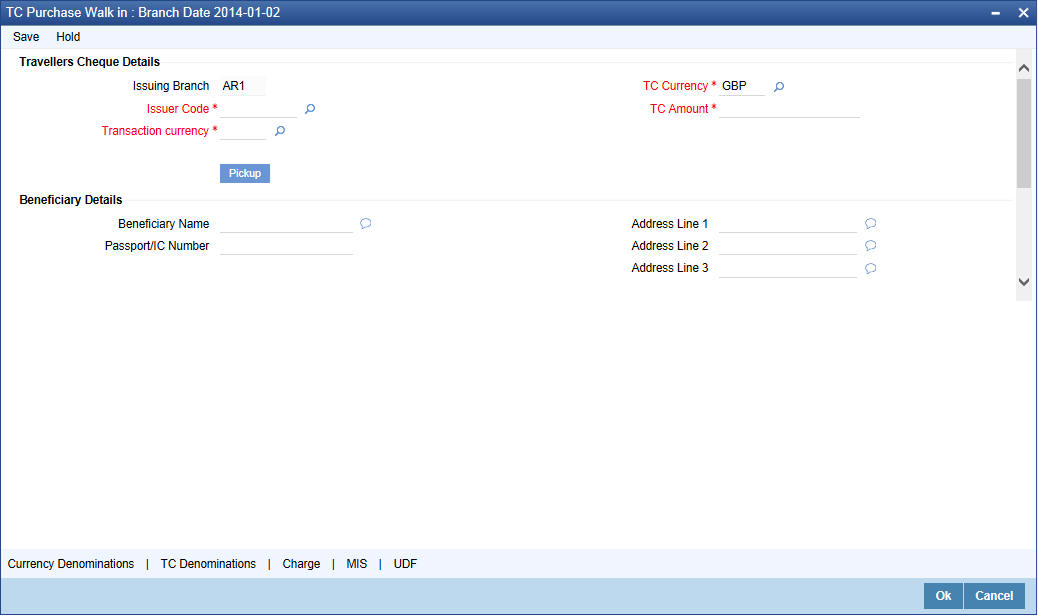

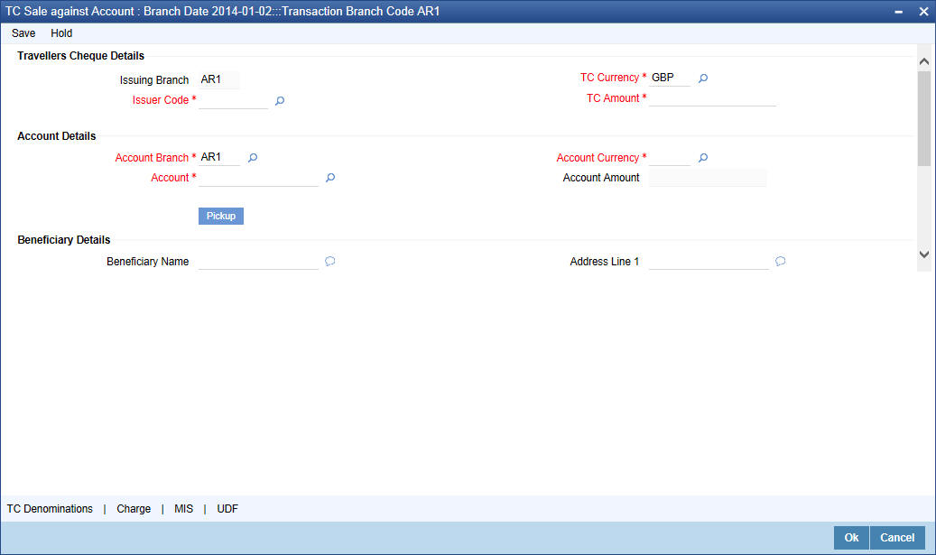

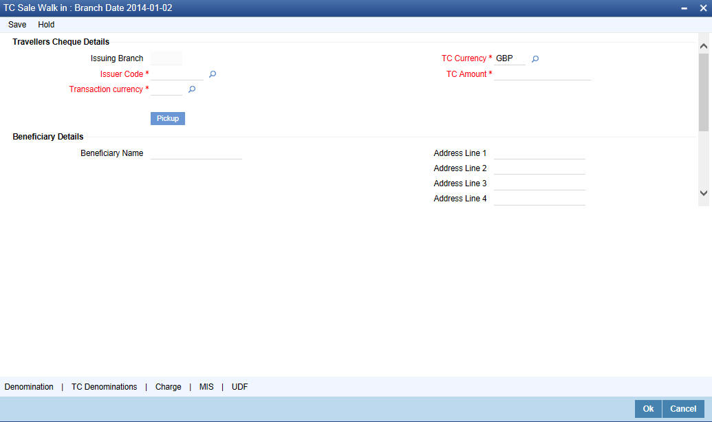

You can issue a Traveller’s Cheque (TC) for your customer against his/her savings account. In order to capture this transaction, you need to invoke the ‘TC Sale (Against A/C’) screen by typing ‘1009’ in the field at the top right corner of the Application tool bar and clicking on the adjoining arrow button.
Here, you can capture the following details:
Issuing Branch
The current logged – in branch is displayed.
Instrument Type
The instrument type corresponding to a TC issued to customers against their savings account is displayed here.
Instrument Status
The system displays the event that is triggered for the transaction. This corresponds to the status of the instrument.
Issuer Code
Specify the issuer code to validate the TC details for sale from the adjoining option list.
Account Branch
Specify the branch in which the customer account is maintained for issuing the TC from the adjoining option list.
Account
Specify the customer account against which you are issuing the TC. The adjoining option list displays all the accounts maintained in the system. Select the appropriate one.
To view the joint holder’s details of an account and the mode of operation maintained at the account level, place the cursor on the Account field and press Ctrl+J. The system displays the ‘Joint Holder’ screen.
Account Currency
The account currency of the specified customer account is displayed here.
TC Currency
The transaction currency of the specified customer account is displayed here.
TC Amount
Specify the amount for which the TC is being issued.
Narrative
Here, you can enter remarks about the transaction.
Click the save icon to go to the next stage.
Once you click ‘Pickup’ button, then on amendment of xrate, amount, charge, pickup will be mandatory before save. Clicking ‘Pickup’ button, the system defaults the following details:
Related Customer ID
The customer identification number of the payment initiator is displayed here based on the chosen account number.
Customer Name
The customer name pertaining to the related customer ID is displayed here.
Exchange Rate
Total Charge
The system computes the charges applicable for the transaction and displays it here.
Beneficiary Name
Specify the beneficiary name.
Beneficiary Address
Specify the beneficiary address.
Account Amount
The system displays the amount to be debited from the account (in the account currency) after calculating the applicable charges. This amount depends on the charge method – whether inclusive or exclusive.
Recalc
Click ‘Recalc’ button to update amount/charge details.
In this block you can enter the TC denomination details through the following fields:
TC Description
Select the TC denomination from the adjoining option list. The list displays all the TC denominations maintained in the branch system.
TC Denomination
The number of available units in the denomination is displayed.
Currency
The TC Currency is displayed here.
Count
Enter the number of TCs against each denomination in Count.
Series
Select the TC series from the option list.
Start Number
Specify the starting serial number of TC against each denomination and press TAB.
The following details are displayed:
End Number
The system displays ending serial number of TCs against each denomination based on the TC count you have specified.
TC Amount
The system displays the TC amount based on the value of denomination and the number of TCs against that denomination.
System Count
The count of denominations available in the system is displayed.
This block allows you to capture charge related details. Click on the ‘Charges’ to invoke the Charge Details screen.
Refer the section titled ‘Specifying MIS details’ under ‘Withdrawing Cash against a Cheque’ for further details.
This block allows you to capture details pertaining to UDF. Click on the ‘UDF’ tab to invoke the UDF Details screen.
Refer the section titled ‘Specifying the UDF details’ under ‘Withdrawing Cash against a Cheque’ for further details.

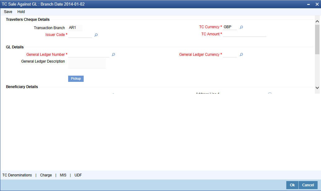

You can issue a Traveller’s Cheque (TC) for your customer against General Ledger account. In order to capture this transaction, you need to invoke the ‘TC Sale (Against GL)’ screen by typing ‘8205’ in the field at the top right corner of the Application tool bar and clicking on the adjoining arrow button.
Issuer Code
Branch
Instrument Type
The instrument type corresponding to a TC issued against GL account is displayed here.
Instrument Status
TC Currency
Specify the currency of the TC.
Specify the currency of the GL against which the TC is being issued. The adjoining option list displays all the currency codes maintained in the system. Choose the appropriate one.
TC Amount
Specify the GL against which you are issuing the TC. The adjoining option list displays all the GL accounts maintained in the system. Select the appropriate one.
GL Description
The system displays the description of the GL account number chosen.
Narrative
Customer Number
Exchange Rate
The system displays the exchange rate used to convert the TC currency into GL account currency. If the TC currency is the same as the account currency, the system will display the exchange rate as ‘1’.
Total Charge
Total Amount
Beneficiary Name
Specify the name of the beneficiary in whose favour the TC is being drawn.
Beneficiary Address
Specify the address of the beneficiary.
Recalc
In this block you can enter the TC denomination details.
Refer the section titled ‘Specifying TC Denomination Details’ under ‘Selling a TC against an Account’ for further details.
Refer the section titled ‘Specifying MIS details’ under Withdrawing Cash against a Cheque’’ for further details.
This block allows you to capture details pertaining to UDF. Click on the ‘UDF’ tab to invoke the UDF Details screen:
Refer the section titled ‘Specifying the UDF details’ under Withdrawing Cash against a Cheque’’ for further details.

You can sell a TC to any walk-in customer through the ‘TC Sale (Walk-In)’ screen. You can invoke this screen by typing ‘8204’ in the field at the top right corner of the Application tool bar and clicking on the adjoining arrow button.
Branch
Issuer Code
Instrument Type
The instrument type corresponding to a TC issued to walk-in customers is displayed here.
Instrument Status
Transaction Date
Enter the date of issue of the TC. This is deemed to be the application date by default, and can be changed if necessary.
TC Currency
Specify the currency in which the TC is being issued.
Account Currency
The system defaults the branch currency as the account currency. However you can change it. The adjoining option list displays all the currency codes maintained in the system. You can select the appropriate code.
TC Amount
Narrative
Once you click ‘Pickup’ button, then on amendment of xrate, amount, charge, pickup will be mandatory before save. On pick up, the fields that are currently enabled in the enrich stage will alone be retained as enabled fields.
Exchange Rate
The system displays the exchange rate used to convert the TC currency into transaction currency. If the TC currency is the same as the transaction currency, the system will display the exchange rate as ‘1’.
TC Amount in A/C Currency
Specify the TC amount in the TC currency.
Total Charge
Actual Amount
The system adds the charge amount to the TC amount and displays the total transaction amount.
Recalc
Click ‘TC Denominations’ to enter the TC denomination details.
Click ‘Currency Denominations’, to capture details of the currency denominations involved in the transaction.
Refer the section titled ‘Specifying denomination details’ under ‘Withdrawing Cash against a Cheque’ for further details.
This block allows you to capture charge related details. Click on the ‘Charges’ to invoke the Charge Details screen:
This block allows you to capture details pertaining to UDF. Click on the ‘UDF’ tab to invoke the UDF Details screen. Refer the section titled ‘Specifying the UDF details’ under ‘Withdrawing Cash against a Cheque’ for further details.

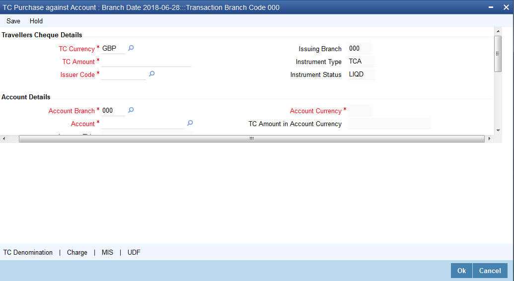

You can purchase a TC through the ‘TC Purchase (Against A/C)’ screen. You can invoke this screen by typing ‘1409’ in the field at the top right corner of the Application tool bar and clicking on the adjoining arrow button.
Issuing Branch
Account Number
Specify the customer account against which you are purchasing the TC. The adjoining option list displays all the accounts maintained in the system. Select the appropriate one.
Account Branch
Specify the Branch in which the customer account needs to be selected for issuing the TC. The adjoining option list displays all the branches maintained in the system. Select the appropriate one.
TC Currency
TC Amount
Specify the amount as indicated on the TC instrument being purchased.
Issuer Code
Account Currency
The transaction currency of the chosen customer account is displayed here.
Narrative
Related Customer ID
Customer Name
Customer name pertaining to the Related customer ID will be defaulted and displayed here.
Exchange Rate
The system displays the exchange rate used to convert the TC currency into account currency. If the TC currency is the same as the account currency, the system will display the exchange rate as ‘1’.
Total Charge
Total Amount
The system deducts the charge amount from the TC amount and displays the total transaction amount.
In case you change the TC amount, you will have to click the ‘Recalc’ button to re-compute the total transaction amount and the total amount.
This block allows you to capture charge related details. Click on the ‘Charges’ to invoke the Charge Details screen. Refer the section titled ‘Specifying charge details’ under ‘Withdrawing Cash against a Cheque’ for further details.
This block allows you to capture details pertaining to MIS. Click on the ‘MIS’ tab to invoke the UDF Details screen.

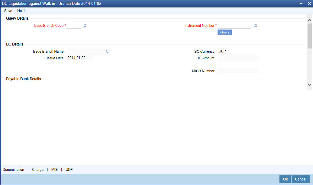

You can liquidate a TC from a walk-in customer and give him/her the equivalent amount in cash. In order to capture such a transaction, invoke the ‘TC Purchase (Walk - In)’ screen. You can invoke this screen by typing ‘8003’ in the field at the top right corner of the Application tool bar and clicking on the adjoining arrow button.
Issuing Branch
Issuer Code
Instrument Type
Instrument Status
TC Currency
Account Currency
TC Amount
Specify as indicated on the TC instrument being purchased.
Narrative
Beneficiary Name
Specify the name of the beneficiary of the transaction.
Beneficiary Address
Specify the address of the beneficiary of the transaction.
Exchange Rate
Related Customer ID
System displays the customer ID applicable to walk-in customers.
Total Charge
Total Amount
Beneficiary Name
Beneficiary Address
Passport/IC Number
Specify the customer’s passport number or any other identification number.
In this block, you can capture details of the currency denominations involved in the transaction.

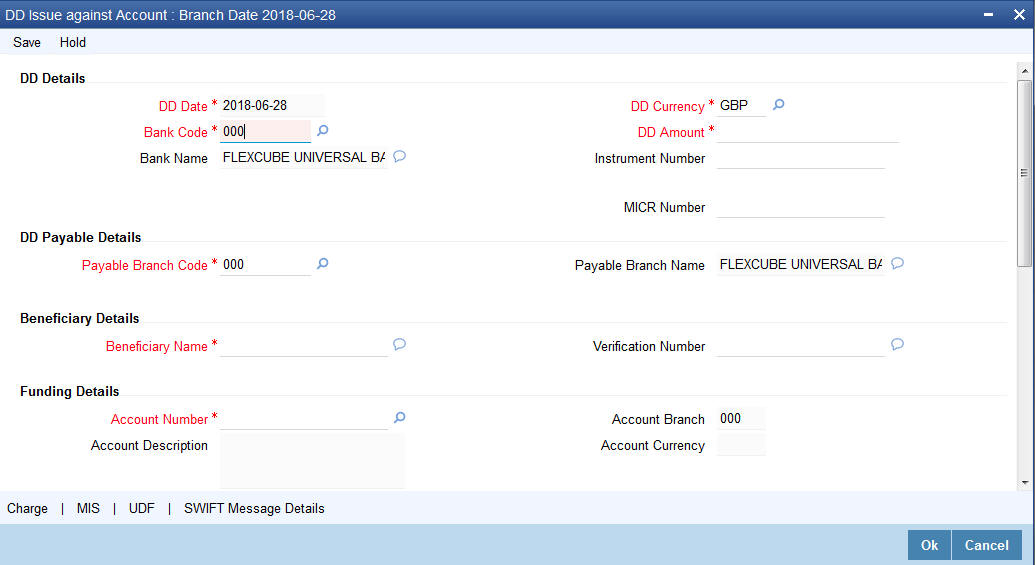

You can issue a Demand Draft (DD) for your customer against his/her savings account. In order to capture this transaction, you need to invoke the ‘DD Issue Against Account’ screen by typing ‘1014’ in the field at the top right corner of the Application tool bar and clicking on the adjoining arrow button.
DD Date
The date of DD issue is displayed here.
Bank Code
Specify the code of the bank that is issuing the DD. The adjoining option list displays all the bank codes maintained in the system. Select the appropriate one.
Bank Name
The system displays the name of the bank.
Payable Branch Code
Specify the branch code at which the DD should be encashed or redeemed. The adjoining option list displays all the branches maintained in the system. Select the appropriate one.
Payable Branch Name
The system displays the name of the branch.
DD Currency
Specify the currency of the DD.
DD Amount
Specify the amount for which the DD is being drawn.
Instrument Number
Specify the instrument number. On save, system validates the instrument number.
If the instrument number is available then the system moves the transaction to the enrich stage.
If the instrument number is not available then the system raises an error message as “Instrument number entered is not valid”
If the instrument number is not specified then the system displays the instrument number at the final stage of web branch transaction.
MICR Number
Specify the MICR number of the cheques.
Beneficiary Name
Specify the name of the beneficiary in whose favour the DD is being drawn.
Verification Number
Specify the customer’s verification number.
Account Number
Specify the customer account against which you are issuing the DD. The adjoining option list displays all the accounts maintained in the system. Select the appropriate one.
Account Description
Account Branch
Select the branch code from the adjoining option list.
Account Currency
Dispatch by Post/Courier
Check this box to dispatch the DD by post or courier.
Use Account Address
Check this box to default the address maintained at the account level.
Address
Specify the address to which the demand draft should be delivered. From the adjoining option list, you can choose the valid account address maintained in the system.
Narrative
The system defaults the ‘DD Issued in favour of <Beneficiary Name> here. However you can modify this.
External Reference
Issuing Branch
The branch code of the issuing branch is displayed here.
Instrument Number
The instrument number is displayed here.
Customer Number
The customer number is displayed here.
Account Branch
The code of the branch where the account resides is displayed here.
Customer Name
Specify the name of the customer.
Exchange Rate
The exchange rate is displayed here.
Account Title
The title of the account is displayed here.
Customer ID
The customer ID is displayed here.
Charges
The total charges applicable are displayed here.
MICR Number
Specify the MICR number displayed on the DD being issued.
Charge Amount
Specify the charge amount.
Note
Refer the section titled ‘Specifying charge details’ under ‘Capturing a cash deposit’ for further details.
Refer the section titled ‘Specifying the MIS details’ under ‘Capturing a cash deposit’ for further details.
You can capture UDF details in the ‘UDF’ tab of the screen.
Refer the section titled ‘Specifying the UDF details’ under ‘Capturing a cash deposit’ for further details.

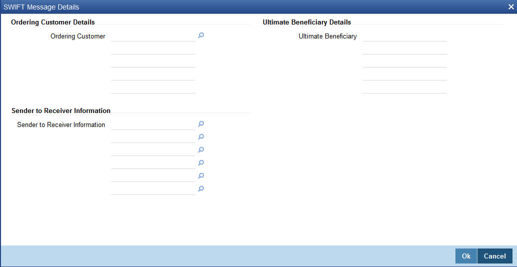

Click ‘SWIFT Message Details’ button from ‘DD Issue against Account’ screen to invoke SWIFT Message Details sub screen.
You can capture the following SWIFT Message details in the ‘SWIFT Message Details’ tab:
Ordering Customer Details
Specify the name and address or the account number of the customer ordering the transaction. Alternatively, you can select the ordering customer from the option list. The list displays all valid options.
Ultimate Beneficiary Details
Specify the ultimate beneficiary details. The Ultimate Beneficiary refers to the Customer to whom the amount of the component is to be paid.
Sender to Receiver Information
Specify the sender to receiver information. Alternatively, you can select the sender to receiver information from the option list. The list displays all valid options.
For more details about viewing customer / account instructions, refer the section titled ‘Viewing Customer / Account Instructions on ‘F6’ Key-Press’ and Viewing Customer / Account Instruction Details in Override Screen’ in this user manual.

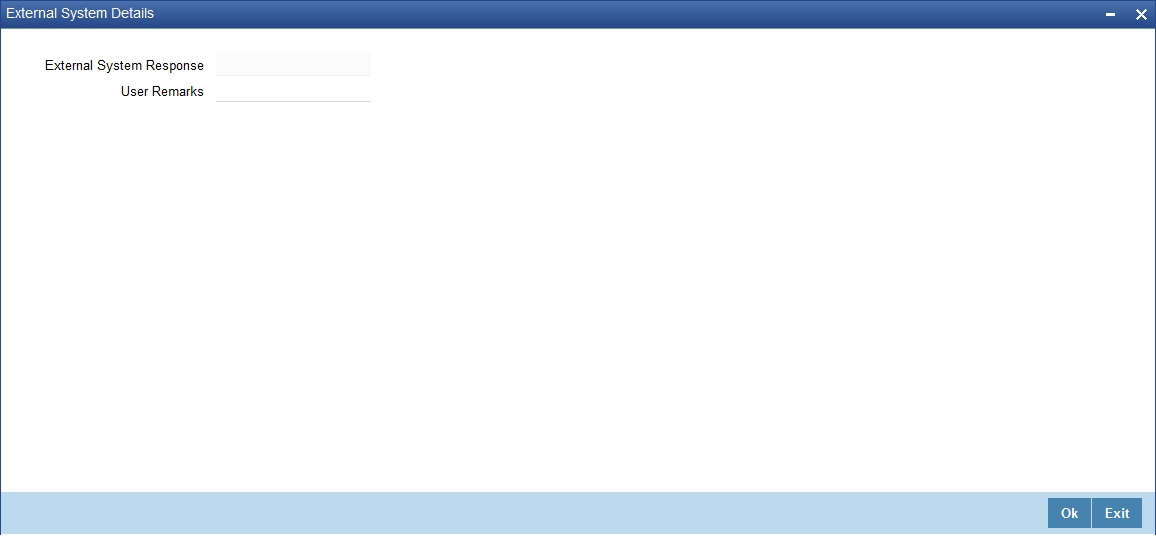

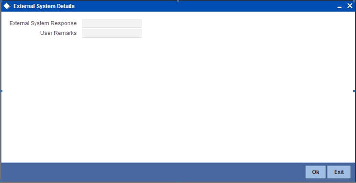

OFAC check enables the application to call an external web service to perform black list check for customer and customer accounts and give warnings appropriately while transacting with black listed customers. You can also capture your remarks before overriding the black list warning.
Click ‘OFAC Check’ button in ‘Bills and Collections - Contract Input - Detailed’ screen to view the OFAC check response in the ‘External System Detail’ screen On clicking ‘OFAC Check’ button, system will build the request XML and call the web service. The ‘External System details’ screen displays the response is received from the external system and you will be also allowed to enter your remarks in this screen. The response received will also be sent to Oracle FLEXCUBE Database layer for any further interpretations of the same. This button can be made visible while carrying out the actual customization. Request building response interpretation in the database layer needs to be done as part of customization to enable this.
Here, you can view /capture the following details:
External System Response
The response from the external system regarding the black listed customer is displayed here.
User Remarks
Specify your remarks regarding the black listed customer here.

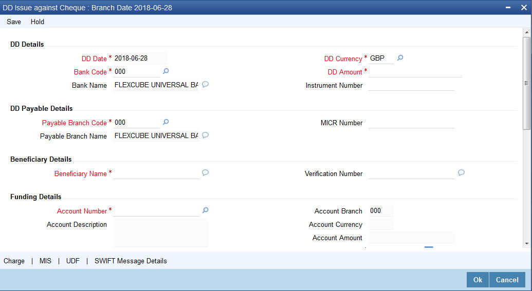

You can issue a Demand Draft (DD) for your customer against an in-house cheque drawn on his/her savings account. In order to capture this transaction, you need to invoke the ‘DD Issue Against Cheque’ screen by typing ‘8330’ in the field at the top right corner of the Application tool bar and clicking on the adjoining arrow button.
DD Date
Bank Code
Bank Name
Payable Branch Code
Payable Branch Name
DD Currency
DD Amount
Instrument Number
If the instrument number is not available then the system raises an error message as "Instrument number entered is not valid"
MICR Number
Beneficiary Name
Verification Number
Specify the customer's verification number.
Account Number
Account Description
Cheque Number
Specify the number of the cheque being drawn for DD sale.
Account Branch
Account Currency
Account Amount
The amount to be credited to the account is displayed here.
Cheque Date
Specify the date of the cheque from the adjoining calendar.
Use Account Address
Address
Narrative
Issuing Branch
Instrument Number
Customer Number
Account Branch
Customer Name
Exchange Rate
Account Title
Customer ID
Charges
Charge Amount
You can capture the UDF details in the ‘UDF’ tab of the screen.
Note
Depending on the ‘Display Type’ selected for customer / account in ‘Instruction Maintenance’ screen, the instruction will be displayed at the time of saving the input stage and authorizing the transaction.
You can capture the SWIFT Message details in ‘SWIFT Message Details’ tab.
Refer section 'Specifying SWIFT Message Details' under 'Issue a DD Issue against an Account' section in this chapter.

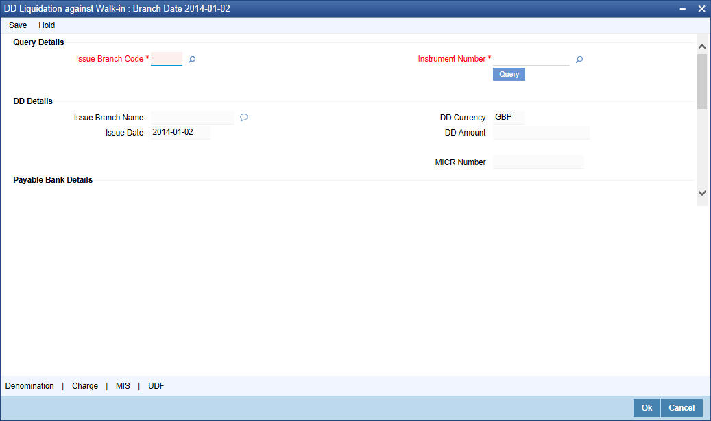

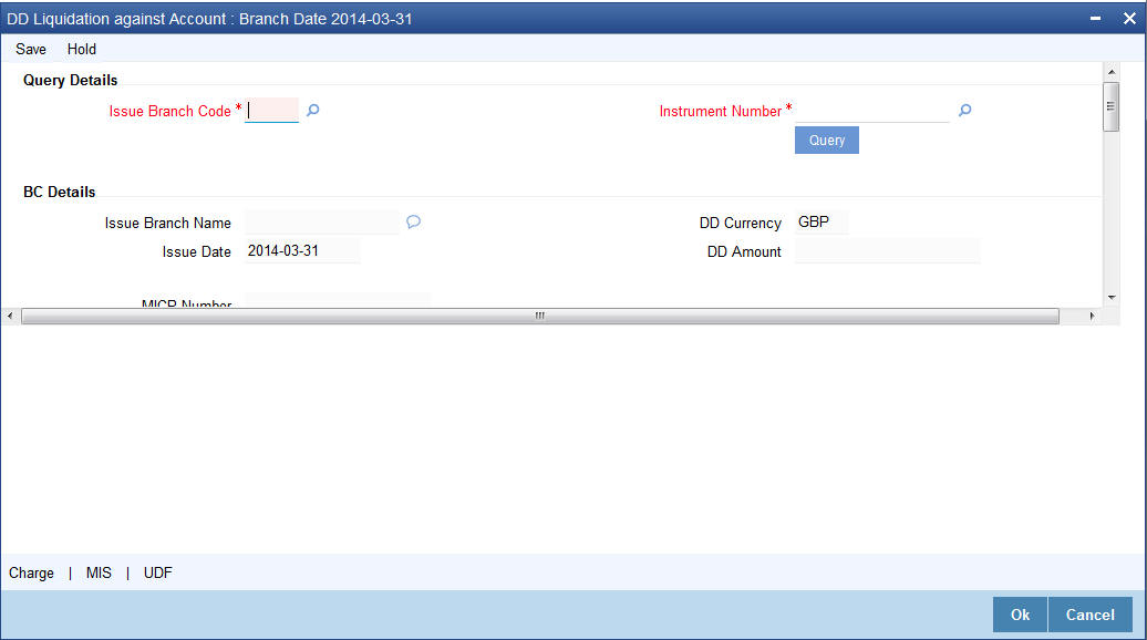

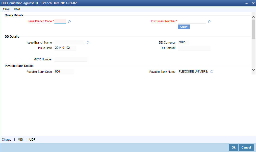

You can liquidate a DD drawn on your branch against a GL through the ‘DD Liquidation against GL’ screen. You can invoke this screen by typing ‘8311’ in the field at the top right corner of the Application tool bar and clicking on the adjoining arrow button.
Issue Branch Code
Select the issue branch code from the adjoining option list.
Instrument Number
Select the instrument number of the DD that should be liquidated form the adjoining option list. This field allows you to capture the issuer code while selecting the instrument number.
Issue Branch Name
The system displays the name of the issue branch based on the issue branch code.
Issue Date
The system displays the date of issue of the DD.

You can liquidate a DD drawn on your branch against an account through the ‘DD Liquidation Against Account’ screen. You can invoke this screen by typing ‘8312’ in the field at the top right corner of the Application tool bar and clicking on the adjoining arrow button.
Here you can specify the following details:
Issue Branch Code
Instrument Number
Select the instrument number of the DD to be liquidated from the adjoining option list. This field allows you to capture the issuer code while selecting the instrument number.
Issue Branch Name
the system displays the name of the issue branch based on the issue branch code.
Issue Date
DD Currency
The system displays currency of the DD currency captured during 'Issue'.
DD Amount
The system displays the DD amount captured during 'Issue'.
MICR Number
The system displays the MICR number of the cheques captured during 'Issue'.
Payable Bank Code
The system displays the name of the payable bank code captured during 'Issue'.
Payable Bank Name
The system displays the name of the bank captured during 'Issue'.
Payable Branch Code
The system displays the name of the payable branch code captured during 'Issue'.
Payable Branch Name
The system displays the name of the branch captured during 'Issue'.
Beneficiary Name
The system displays the beneficiary in whose favour the DD is being drawn captured during 'Issue'.
Verification Number
The system displays the customer's verification number which was captured during 'Issue'.
Liquidation Mode
Specify the mode of liquidation from the adjoining drop-down list.
GL Currency
Specify the GL Currency. Alternatively you can select the GL currency from the option list. The list displays all valid currencies maintained in the system.
GL Number
Specify the GL number. Alternatively you can select the GL number from the option list. The list displays all valid GL numbers maintained in the system.
GL Amount
The system displays the GL amount.
GL Description
The system displays the GL description.
Narrative
The system defaults the ‘DD Liquidation - <Instrument No.> here. However you can modify this.
Transaction Amount
Total Charge
The system displays the total charge.
Exchange Rate
Specify the exchange rate.
Note

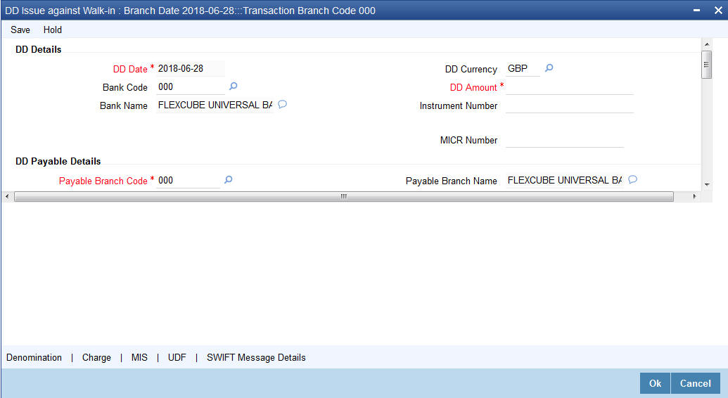

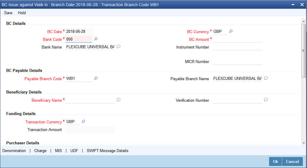

You can issue a DD to any walk-in customer through the ‘DD Issue Walk-In’ screen. You can invoke this screen by typing ‘8305’ in the field at the top right corner of the Application tool bar and clicking on the adjoining arrow button.
DD Date
Bank Code
Bank Name
Payable Branch Code
Payable Branch Name
DD Currency
DD Amount
Instrument Number
MICR Number
Beneficiary Name
Verification Number
Specify the currency in which the customer is making the payment.
Transaction Amount
The system displays the total transaction amount.
Purchaser Name
Specify the name of the purchaser.
Verification Number
Specify the purchaser’s verification number.
Address
Narrative
Transaction Currency Rate
The system displays the exchange to be used for the transaction in case the transaction currency is different from the DD currency.
Charges
The system computes the charges applicable to the transaction and displays the amount here.The mode of charge collection is Cash.
Total Amount
The system computes the total amount to be paid by the walk-in customer by adding the charge amount to the DD amount.
Refer the section titled ‘Specifying denomination details’ under ‘Capturing a cash deposit’ for further details.
This block allows you to capture charge related details. You need to click on the ‘Charges’ tab to invoke the Charge Details screen.The system displays the charge applicable to the transaction. You can waive it if required. You then need to click ‘Recalc’ button to re-compute the net amount payable to the customer.
This block allows you to capture details pertaining to MIS. Click on the ‘MIS’ tab to invoke the MIS Details screen:
OFAC Check enables the application to call an external web service to perform black list check for customer and customer accounts and warn the users appropriately while transacting with black listed customers. This will also allow capturing the user remarks in such scenarios before overriding the black list warning.
To invoke this screen, click ‘OFAC Check’ button in ‘DD Issue Walk-In’ screen.
This button can be made visible while carrying out the actual customization. Request building, response interpretation in the database layer needs to be done as part of customization to enable this feature.
On clicking this button, system will build the request XML and call the web service. Once the response is received from the external system, the user will be allowed to enter his remarks in the screen displayed. The response received will also be sent to Oracle FLEXCUBE Database layer for any further interpretations of the same.

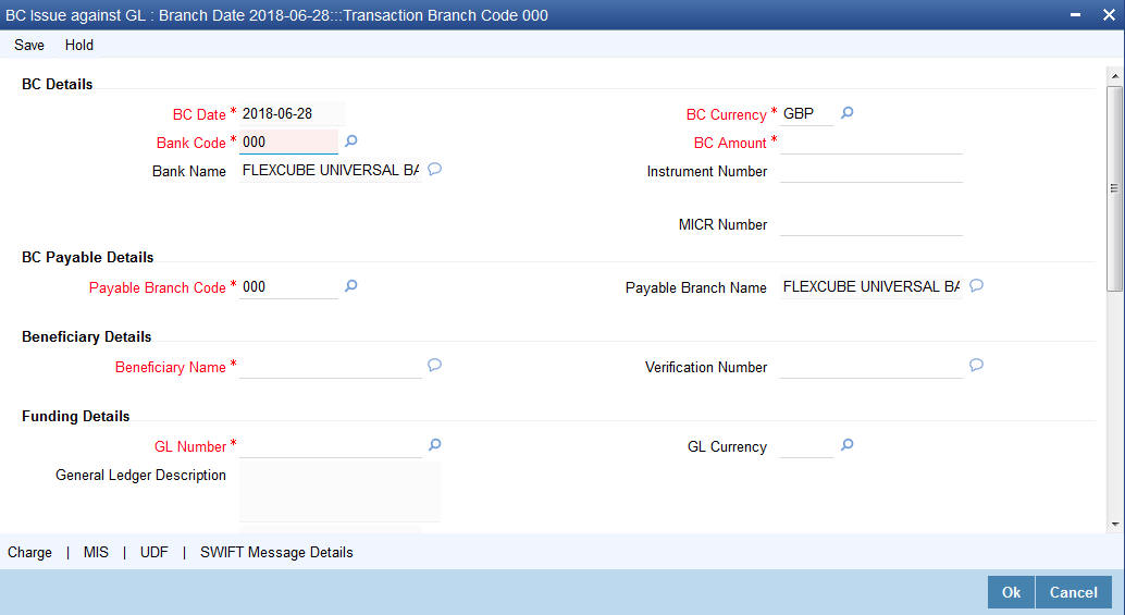

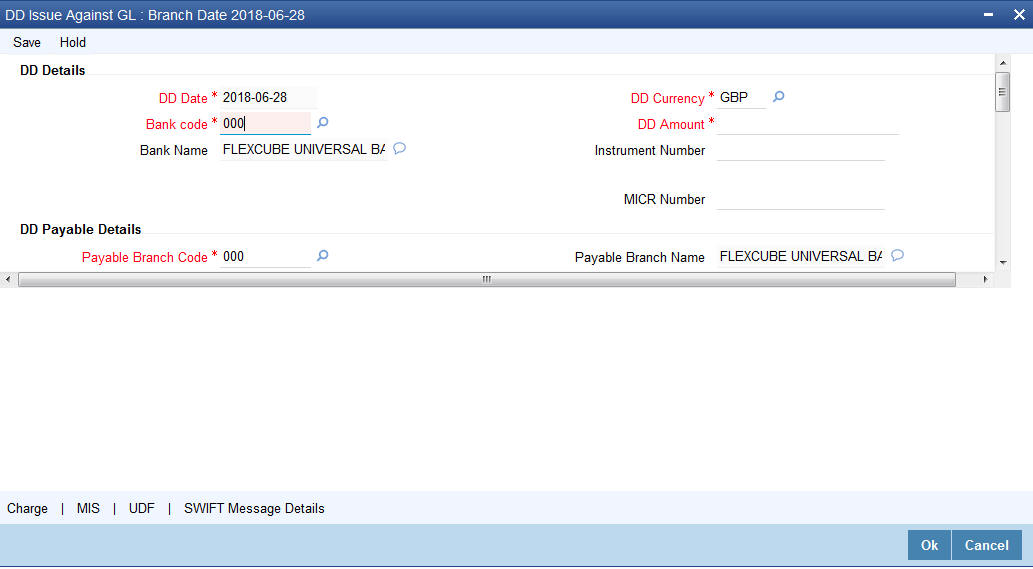

You can issue a DD against a GL account for your customer through the ‘DD Issue against GL’ screen. You can invoke this screen by typing ‘8306’ in the field at the top right corner of the Application tool bar and clicking on the adjoining arrow button.
DD Details
DD Date
The system displays the date on which the DD is being issued.
Bank Code
Specify the clearing bank code. The adjoining option list displays all the clearing bank codes maintained in the system. Choose the appropriate one.
Bank Name
Payable Branch Code
Payable Branch Name
DD Currency
Specify the in which the DD is being issued. The adjoining option list displays all the currency codes maintained in the system. Choose the appropriate one.
DD Amount
Instrument Number
If the instrument number is not available then the system raises an error message “Instrument number entered is not valid”.
MICR Number
Specify the MICR number as displayed on the DD instrument.
Beneficiary Details
Beneficiary Name
Specify the name of the beneficiary in whose favor the DD is being issued.
Verification Number
Funding Details
GL Number
Specify the GL against which the DD is being issued. The adjoining option list displays all the GL codes maintained in the system. Choose the appropriate one.
GL Description
The system displays the description of the specified GL account.
GL Currency
Specify the currency of the GL against which the DD is being issued. The adjoining option list displays all the currency codes maintained in the system. Choose the appropriate one.
GL Amount
The GL amount is displayed here.
Delivery Details
Address
Additional Details
Narrative
The system displays the currency of the GL as the currency in which the transaction entries will be posted. However, you can change it by choosing the appropriate currency code from the adjoining option list.
Charges
In case you change the charge amount or the DD amount, you will have to click ‘Recalc’ button to re-compute the total transaction amount.
Total Amount
The system adds the charge amount to the DD amount and displays the total transaction amount.
Instrument Number
This block allows you to capture charge related details for the transaction. You can waive it if required. You then need to click ‘Recalc’ button to re-compute the net amount payable to the customer.
Refer the section titled ‘Specifying MIS details’ under ‘Capturing a cash deposit’ for further details.
Refer the section titled ‘Specifying UDF details’ under ‘Capturing a cash deposit’ for further details.

Here, you can view the following details.
The response from the external system regarding the black listed customer will be defaulted here.
User Remarks
You can specify your remarks here.

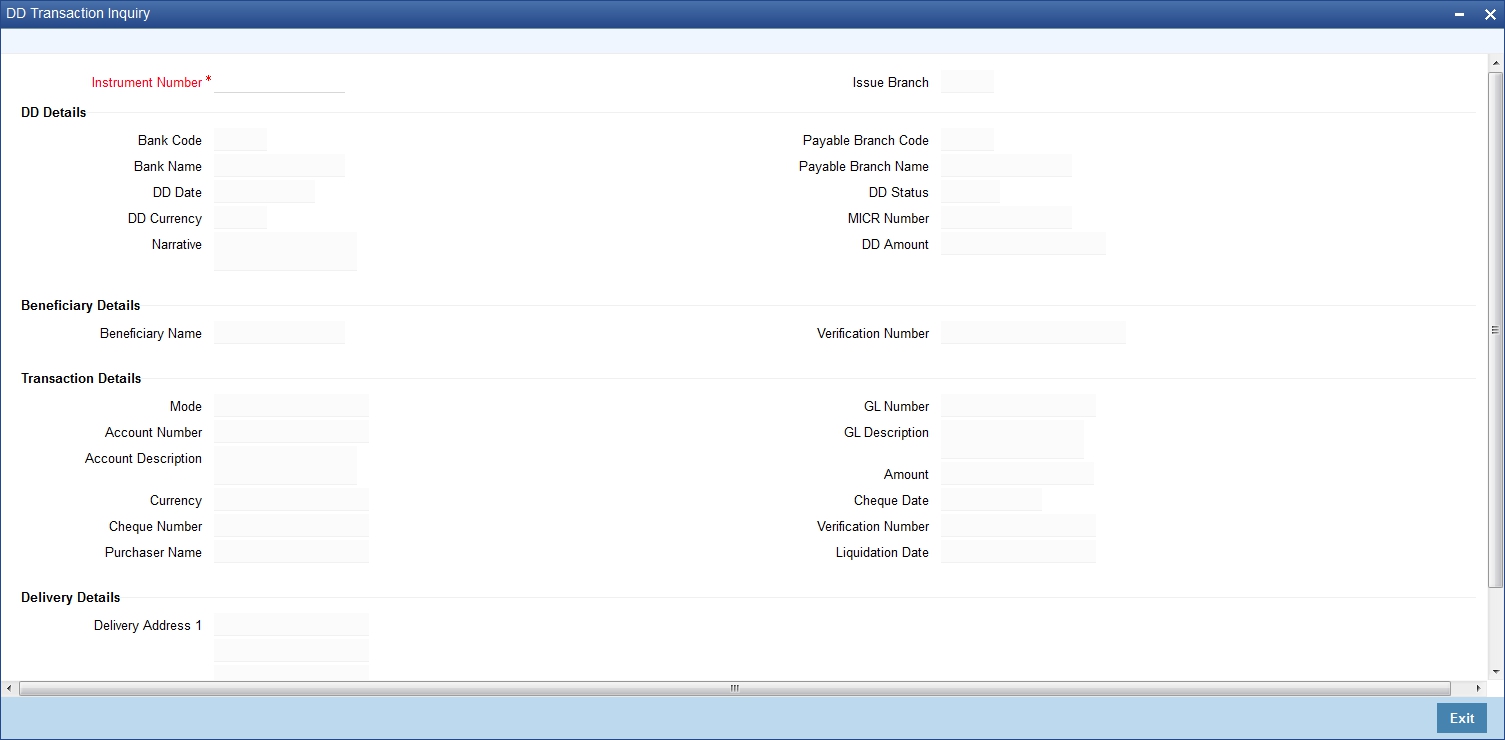

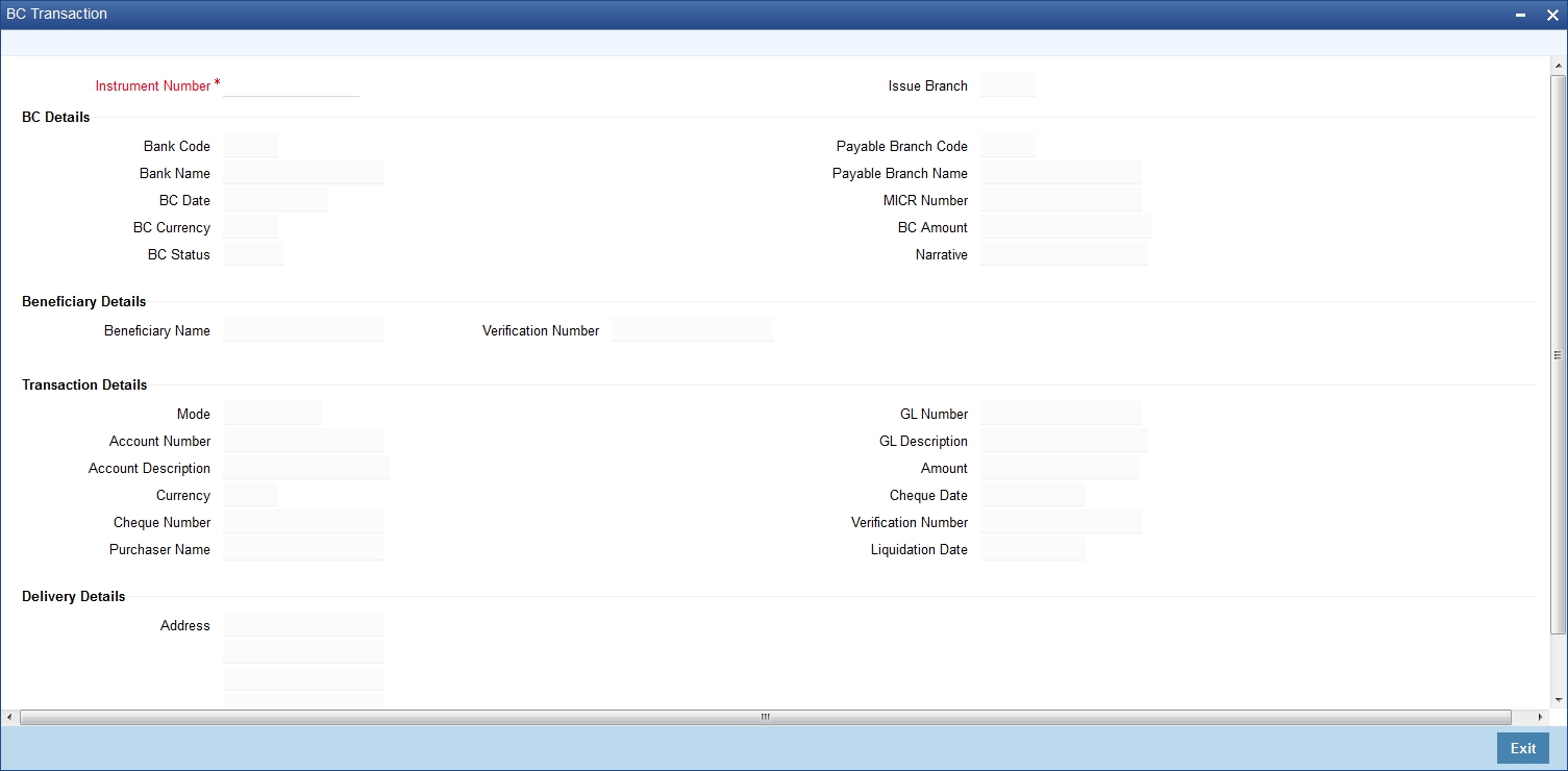

You can query on the details of a DD transaction based on the issue branch and the instrument number of the DD transaction. For a liquidated contract only liquidation details are displayed. You can achieve this through the ‘DD Inquiry’ screen. You can invoke this screen by typing ‘7789’ in the field at the top right corner of the Application tool bar and clicking on the adjoining arrow button.
Here you can query on the details of a DD based on the following fields:
Instrument Number
Specify the instrument number from the adjoining option list.
Issue Branch
The system displays the issue branch
Bank Code
The system displays the bank code.
Bank Name
DD Date
DD Currency
The system displays the DD currency.
DD Status
The system displays the status of the issued DD.
Payable Branch Code
The system displays the payable branch code.
Payable Branch Name
MICR Number
The system displays the MICR number of the cheques.
DD Amount
The system displays the amount for which the DD is being drawn.
Print Status
Check this box to print the instrument.
Note
During loan disbursement, if the issuing branch is selected as a branch other than the transaction branch then the “Print Status’ check box is updated as unchecked during DD creation
Narrative
The system defaults the ‘DD Issued in favour of <Beneficiary Name>’ for liquidated instruments.
The system defaults the ‘DD Liquidation - <Instrument No.>’ for liquidated instruments.
Beneficiary Name
Verification Number
Mode
The system displays the funding mode based on the mode of payment for funding DD.
Account Number
Account Description
Currency
Cheque Number
The system displays the cheque number.
Purchaser Name
GL Number
Select the account number of the GL against which a BC is issued from the adjoining option list.
GL Description
The system displays a brief description on the general ledger.
Amount
The system displays the amount based on funding.
Cheque Date
The system displays the cheque date,
Verification Number
The system displays the customer verification number.
Mode
Account Number
Account Description
Currency
Date
Specify the date of liquidation.
GL Number
GL Description
Amount
The system displays the amount based on the liquidation
Address
Clicking ‘Query’ button, the system validates if all the mandatory details are specified. This button will be disabled after the first click.

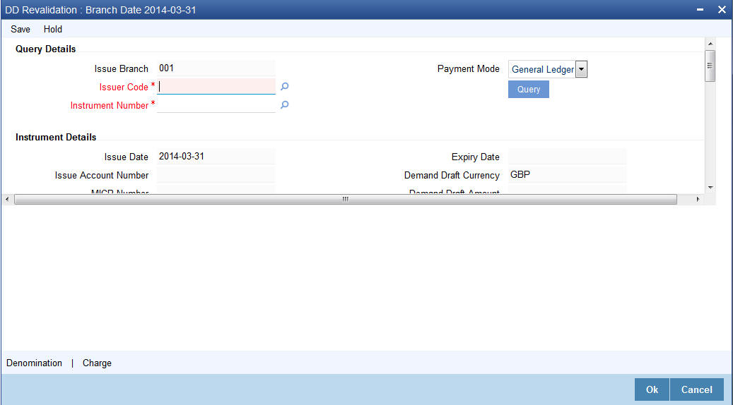

You can re-validate the expired DD instrument using ‘Revalidation of DD Instrument’ screen.
System will allow re-validating instrument only if,
To invoke ‘Revalidation of DD Instrument’ screen, type ‘DDRV’ in the field at the top right corner of the Application tool bar and click on the adjoining arrow button.
You need to specify following details here:
Issue Branch
The system defaults the current branch as the issue branch.
Issuer Code
Specify the issuer code of the cheque book. Alternatively, you can select the issuer code from the option list. The list displays all valid options maintained in the system.
Instrument Number
Specify the instrument number for the issuance of duplicate DD instrument from the adjoining option list.
Payment Mode
The system will collect charges based on the payment mode selected at the query stage.
System displays the following instrument details in this screen:
You need to specify the following details:
Revalidation Reason
Specify the reason for the re-validation of DD instrument. The reason specified here will be shown in the revalidated instrument report.
Revalidation Frequency
System defaults re-validation frequency maintained in the ‘Instrument Type Definition’ screen; however, you can override the re-validation frequency in days, months or years.
New Expiry Date
System generates new expiry date for the re-validated instrument calculated as,
‘Old Expiry Date + ‘Revalidation Period’.
You need to specify the following details under ‘Payment Details’ section:
Charge Account
Specify the charge account number from which the charge needs to be collected from the adjoining option list.
Charge Currency
Specify the currency applied for the charge from the adjoining option list.
The system displays the beneficiary details.
Instrument Type
The system displays the instrument type.
The system displays external reference number.
If you have selected ‘Payment Mode’ as ‘Cash’ at query stage, you need to specify Denomination details.
Total Amount
The system computes the total amount based on the specified denomination details, iIf you have selected ‘Payment Mode’ as ‘Cash’ at query stage.
Refer the section titled ‘Specifying denomination details’ under ‘Withdrawing cash against a Cheque’ in this manual for further details.
Refer the section titled ‘Specifying the charge details’ under ‘Withdrawing cash against a Cheque’ in this manual.

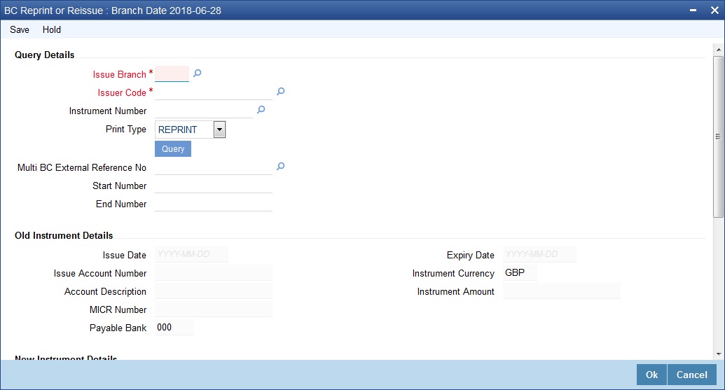

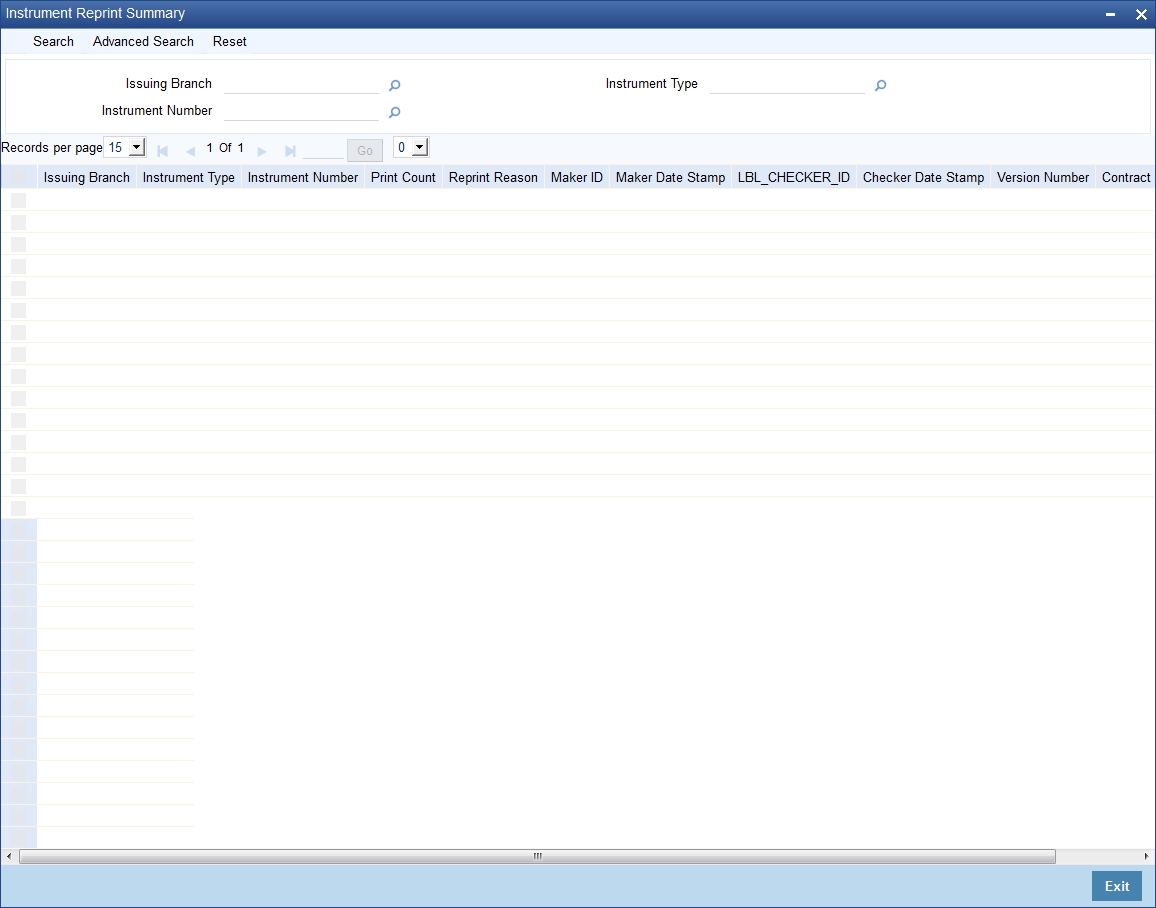

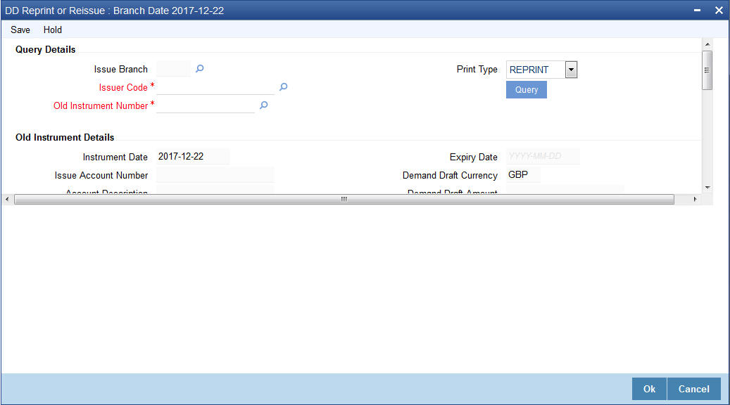

Oracle FLEXCUBE reprints / reissues the DD due to one of the following reasons:
To invoke ‘DD Reprint / Reissue’ screen, type ‘DDRP’ in the field at the top right corner of the Application tool bar and click on the adjoining arrow button.
You need to specify the following details on this screen.
Issue Branch
Specify the code that identifies the branch that issued the instrument. The option list displays all valid branch codes maintained in the system. Choose the appropriate one.
Issuer Code
Old Instrument Number
Specify the number of the instrument that you wish to reprint. The option list displays all valid instrument numbers issued at the selected branch. Choose the appropriate one.
Print Type
Select print type from the drop-down list. The list displays the following values:
Note
If you select ‘Print Type’ as Reissue or Reprint and if the ‘Print Status’ check-box in ‘Instruments Transaction Query Screen’ is unchecked then system displays an error message
The system displays the following old instrument details
New Instrument Number
Specify the new instrument number for the reissuance/reprinting of a new DD instrument.
New MICR Number
Specify the new MICR Number captured for the new Instrument.
Reprint / Reissue Reason
Specify the reason that should be verified during the auditing of DD reprint / Reissue. This is a mandatory field.
Reprint / Reissue Count
The system displays the count of the current reprint / Reissue operation.
Note
In order to keep track on reprints, the system will count the number of times the instrument is printed. These details will be verified by branch official or auditor.
Beneficiary Name
The system displays the beneficiary name.
Address Line 1-3
The system displays the address.
Demand Draft Status
The system displays the demand draft status.
External Reference
The system displays the external reference number.
Click ‘Save’ to retain the incremented reprint / Reissue count and audit details.

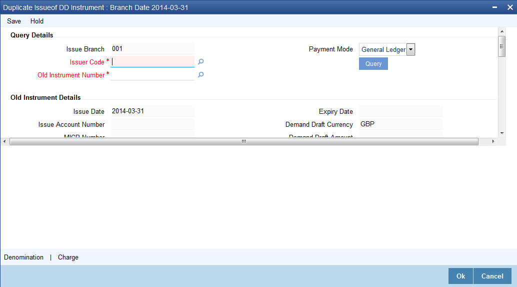

You can issue the duplicate DD instrument using ‘Duplicate Issue of DD Instrument’ screen. System will allow duplicate issuance of DD instrument only if,
To invoke ‘Duplicate Issue of DD Instrument’ screen, type ‘DDDI’ in the field at the top right corner of the Application tool bar and click on the adjoining arrow button.
Issue Branch
Specify the branch where DD has been issued.
Issuer Code
Payment Mode
Select the payment mode for the duplicate issuance of the instrument from the drop-down list. System will apply charges only for the duplicate issuance of an instrument. Cancellation charges will be waived.
The system displays the following old instrument details:

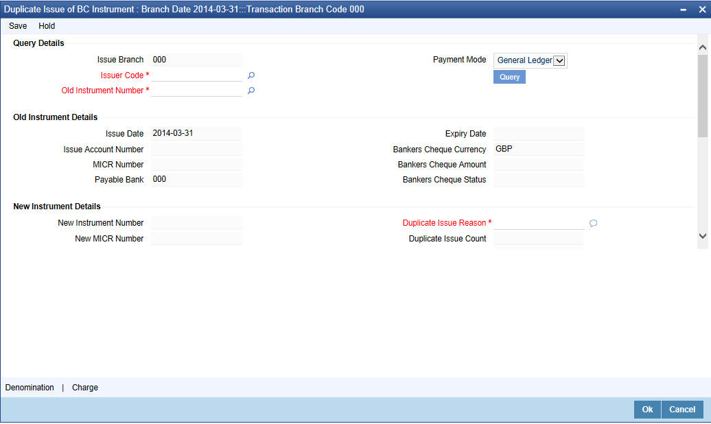

Select the new instrument number from the adjoining option list.
New MICR Number
Duplicate Issue Reason
Specify the reason for the duplicate issuance of DD instrument.
Duplicate Issue Date
Specify the duplicate issue date.

You can view the summary of instrument reprint in the ‘Instrument Reprint Summary’ screen. You can invoke this screen by typing ‘ISSRPDET’ in the field at the top right corner of the Application tool bar and clicking on the adjoining arrow button.
Here you can query the reprint summary details based on the following details:
Issuing Branch
Specify the branch assigned to issue the instrument reprint. The adjoining option list displays all valid branches maintained in the system. You can choose the appropriate one.
Instrument Number
Specify the number of the instrument that should be queried. The adjoining option list displays all valid instrument numbers maintained in the system. You can choose the appropriate one.
Instrument Type
Specify the type of the instrument that should be queried. The adjoining option list displays all valid instrument numbers maintained in the system. You can choose the appropriate one.
Based on the aforementioned queries, the system displays the following fields:

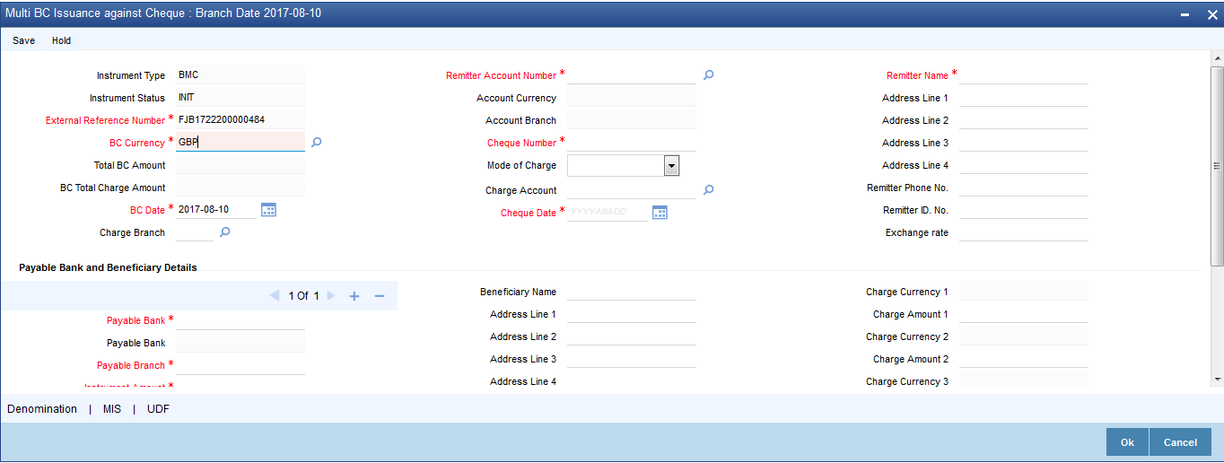

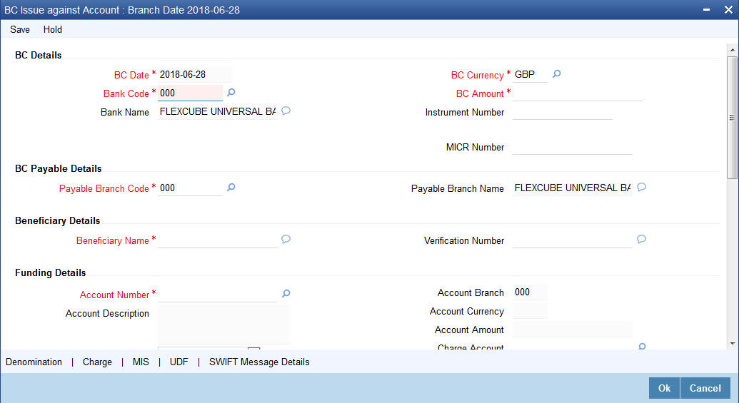

You can sell Bankers cheque (BC) against a customer’s savings account. In order to capture this transaction, you need to invoke the ‘BC Issue Against Account’ screen by typing ‘1010’ in the field at the top right corner of the Application tool bar and clicking on the adjoining arrow button.
In this screen, you need to specify the following details:
BC Date
The system defaults the BC date to the system date.
Bank Code
Specify the bank code that is issuing the BC. The adjoining option list displays all the bank codes maintained in the system.
Bank Name
The system displays the name of the bank based on the bank code selected.
Payable Branch Code
Specify the branch where the BC should be payable. The adjoining option list displays all the branch codes maintained in the system. Choose the appropriate one.
Payable Branch Name
The system defaults the payable branch name based on the payable branch code selected.
BC Currency
The system displays the currency of the banker’s cheque.
BC Amount
Specify the amount for which the BC is being issued.
Instrument Number
If the instrument number is not available then the system raises an error message as “Instrument number entered is not valid”.
MICR Number
Specify the MICR number displayed on the BC being issued.
Beneficiary Name
Specify the name of the beneficiary in whose favor the BC is being issued.
Verification Number
Specify the verification number.
Account Number
Specify the customer account against which you are issuing the BC. The adjoining option list displays all the accounts maintained in the system. Select the appropriate one.
Account Description
The system displays a brief description on the account based on the account number selected.
Account Branch
The system displays the account branch based on the account number selected.
Account Currency
The system displays the account currency based on the account number selected.
Account Amount
The system displays the amount in account currency based on the BC amount.
Mode of Charge
Select the mode of charge through which the charges are collected for the BC issuance from the drop-down list. The list displays the following values:
Charge Account
Specify the charge account number which has to be debited. Alternatively, you can select the charge account from the option list. The list displays all charge accounts maintained in the system. This field is enabled if you select the ‘Other Account’ option in the ‘Mode of Charge’ field. You can validate the total denomination amount in the Denomination screen, if you select the ‘Mode of Charge’ as Cash.
Check this box to dispatch the cheque book by post or courier.
If you check ‘Dispatch by Post /Courier’, then the 'Use Account Address' or 'Address' should be mandatory.
Use Account Address
Address
Specify the address to which the banker’s cheque should be delivered. From the adjoining option list, you can choose the valid account address maintained in the system. The system displays the address of the customer if the check box ‘Use Account Address’ is checked.
Narrative
The system defaults the ‘BC Issued in favour of <Beneficiary Name>’ here. However you can modify this.
The system updates the beneficiary name based on the name specified in ‘Beneficiary Name’. However you can modify it.
Total Charge Amount
The system displays the total charge amount for the issued BC.
Instrument Type
Specify the instrument type
Customer Id
Specify the customer Id.
Customer Name
Specify the customer name.
Exchange Rate
Total Charge
System displays the total charge.
Account Title
The system displays a brief title for the chosen account.
Customer ID
Charges
Account Amount
Note
This block allows you to capture charge related details such as the following:
Charge Component
The system defaults the charge components applicable to the transaction.
Waiver
You can waive a certain charge for the customer by checking this box against the charge component.
Charge Amount
The system displays the charge amount to be deducted for the corresponding charge component. You can edit the amount.
Charge in LCY
Exchange Rate
Cost Center
Select a cost center from the list of values. The MIS code assigned to the cost center related to the account is displayed here.
LOAN_TYPE
Select the type of the loan from the adjoining option list.
LOAN TERM
Select the term of the loan from the adjoining option list.
Contracts in Various Currencies
Select the currency to which the contract belongs.
Account Officer
Select the account officer who is in-charge of executing this transaction.
Standard Industrial Code
Select the industry to which the customer belongs.
You can capture the UDF details in the ‘UDF’ tab of the screen.Specify the following details.
Field Name
All UDFs specified for the account class is displayed here.
Field Value
The value for each UDF is displayed here. You can alter this value if necessary.
Note
Depending on the ‘Display Type’ selected for customer / account in ‘Instruction Maintenance’ screen, the instruction will be displayed the time of saving the input stage and authorizing the transaction.
To invoke this screen, click ‘OFAC Check’ button in ‘Banker’s Cheque Sale (Against Account) ’screen.
User Remarks

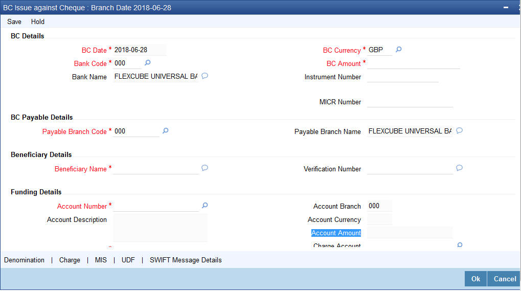

You can sell Bankers cheque (BC) against an in-house cheque drawn on customer’s savings account. In order to capture this transaction, you need to invoke the ‘Bankers Cheque Sale Against Account’ screen by typing ‘8335’ in the field at the top right corner of the Application tool bar and clicking on the adjoining arrow button.
BC Date
The system defaults the BC date to the system date. However you can change it using the adjoining calendar.
Bank Code
Specify the code of the bank that is issuing the BC. The adjoining option list displays all the bank codes maintained in the system.
Bank Name
Payable Branch Code
Payable Branch Name
BC Currency
The system displays the local currency of the banker's cheque.
BC Amount
Instrument Number
If the instrument number is not available then the system raises an error message as "Instrument number entered is not valid".
MICR Number
Beneficiary Name
Verification Number
Account Number
To view the joint holder’s details of an account and the mode of operation maintained at the account level, place the cursor on the Account number field and press Ctrl+J. The system displays the ‘Joint Holder’ screen.
Account Description
Cheque Number
Specify the number of the cheque being drawn for BC sale.
Account Branch
Account Currency
The currency of the account is displayed here.
Account Amount
The system displays the amount in account currency based on the currency.
Cheque Date
Mode of Charge
Charge Account
Check this box to dispatch the BC by post or courier.
Use Account Address
Address
Specify the address to which the banker's cheque should be delivered. From the adjoining option list, you can choose the valid account address maintained in the system. The system displays the address of the customer if the check box 'Use Account Address' is checked.
Narrative
The system defaults the ‘BC Issued in favour of <Beneficiary Name> here. However you can modify this.
External Reference
The system generates a unique number based on the branch-specific sequence number generation logic and displays it as the 'External Reference’.
Total Charge Amount
Instrument Number
The system displays the instrument number.
Customer Id
The system displays the customer Id.
Customer Name
The system displays the customer name based on the customer Id.
Exchange Rate
Total Charge
Account Title
Account
The system displays the customer account based on the account specified.
Charges
Account Amount
Charge Component
Charge Currency
The system displays the currency in which the charge has to be deducted.
Waiver
Charge Amount
Charge in LCY
Exchange Rate

You can close an account and pay the account balance (by issuing a BC) to the customer using the ‘Close out Withdrawal by Bankers Cheque’ screen. You can invoke this screen by typing ‘1300’ in the field at the top right corner of the Application tool bar and clicking on the adjoining arrow button.
On invoking this screen, the External Reference Number of the transaction, the Account Branch, and Account No are displayed.
Specify an account number or select an account number from the list of values.
Account Number
Account Description
Account Branch
Account Currency
Account Amount
BC Date
Bank Code
Bank Name
Payable Branch Code
Payable Branch Name
Instrument Number
MICR Number
The system displays the MICR number.
Serial Number
The system displays the serial number.
Beneficiary Name
Check this box to dispatch the bankers cheque by post or courier.
Use Account Address
Address
Narrative
Enter remarks about the transaction.
External Reference
The system generates a unique number based on the branch-specific sequence number generation logic and displays it as the 'External Reference'.
Charge Details block allows you to capture charge related details.
For more details, refer the section ‘Specifying Charge Details’ under ‘Selling a BC against an Account’ in this manual.
MIS Details block allows you to capture details pertaining to MIS.
For more details, refer the section ‘Specifying MIS Details’ under ‘Selling a BC against an Account’ in this manual.
You can capture the UDF details in the ‘UDF’ tab of the screen.Refer the section titled ‘Specifying the UDF details’ under ‘Capturing a cash deposit’ for further details.
Click save icon to go to the next stage – Authorization.

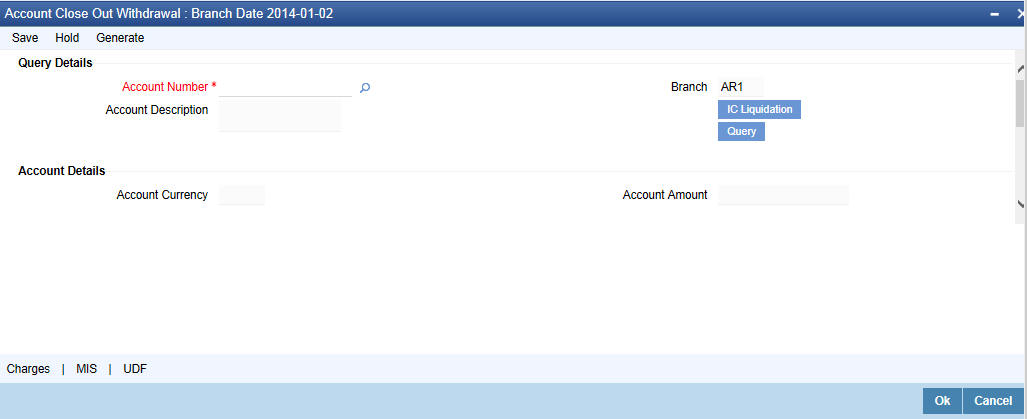

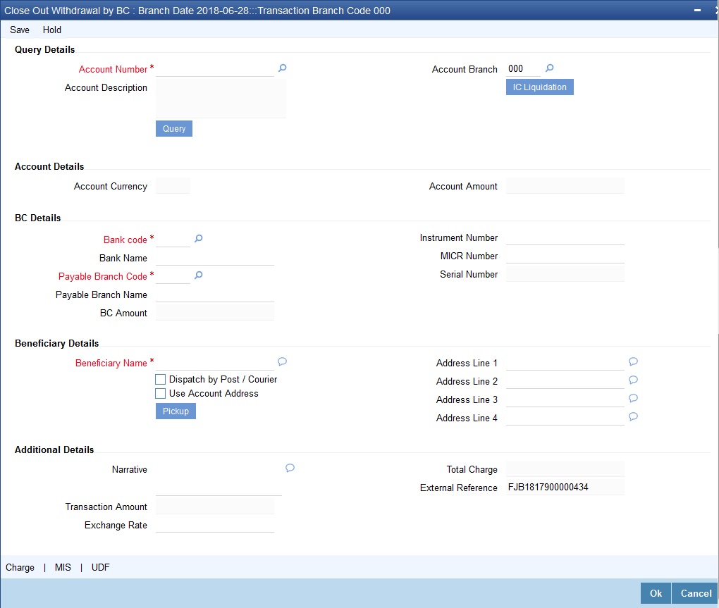

You can close an account and pay the account balance to the customer using the ‘Account Close out Withdrawal’ screen. You can invoke this screen by typing ‘1320’ in the field at the top right corner of the Application tool bar and clicking on the adjoining arrow button.
On invoking this screen, the External Reference Number of the transaction, the Account Branch, and Account Number are displayed.
The system displays the external reference number based on the account number selected.
Account Number
Select the account number from the adjoining option list.
Branch
The system displays the branch based on the account number selected.
Account Description
External Reference
Branch
The system displays the branch code.,
Account Number
Specify the customer account number.
Account Description
Account Currency
Account Amount
Offset Branch
Select the offset branch from the adjoining option list.
Offset Account
Specify the offset account that should be used to post this transaction. The adjoining option list displays all the accounts maintained in the system. Choose the appropriate one.
Account Title
The system displays the account title.
Offset Currency
The system displays the offset currency.
You can capture these details in the ‘UDF’ tab of the screen.Refer the section titled ‘Specifying the UDF details’ under ‘Capturing a cash deposit’ for further details.
In the Authorization stage, you need to assign the transaction to a teller who will authorize or reject the transaction.
You can issue a BC against a GL account for your customer through the ‘BC Issue against GL’ screen. You can invoke this screen by typing ‘8302’ in the field at the top right corner of the Application tool bar and clicking on the adjoining arrow button.
On invoking this screen, the ‘External Reference Number’ and the ‘Banker’s Cheque Date’ are displayed. You need to specify the following details:
BC Date
Bank Code
Bank Name
Payable Branch Code
Payable Branch Name
BC Currency
The system displays the local currency of the banker's cheque. However you can modify it.
BC Amount
Instrument Number
If the instrument number is not available then the system raises an error message as ”Instrument number entered is not valid”.
MICR Number
Beneficiary Name
Verification Number
GL Number
GL Description
GL Currency
Specify the currency of the GL against which a BC is issued or select a GL currency from the list of values.
GL Amount
The system displays the amount in GL account currency.
Address
Specify the address to which the banker's cheque should be delivered. From the adjoining option list, you can choose the valid account address maintained in the system. The system displays the address of the customer if the check box 'Use Account Address' is checked in the ‘BC Issue Against Account’ screen.
Narrative
External Reference
Specify the GL currency.
General Ledger Title
Txn Ccy Rate
The system displays the transaction currency.
Charges
Total Amount
The system displays the total amount of the transaction.
Instrument Number
Customer ID
The system displays the customer ID.
Customer Name
The system displays the customer name based on the customer ID
To invoke this screen, click ‘OFAC Check’ button in ‘BC Issue Against GL ’screen.
User Remarks
You can issue a BC to any walk-in customer through the ‘BC Issue Walk-In’ screen. You can invoke this screen by typing ‘8301’ in the field at the top right corner of the Application tool bar and clicking on the adjoining arrow button.
BC Date
Bank Code
Select the clearing bank code for the transaction. The adjoining option list displays all the bank codes maintained in the system.
Bank Name
Payable Branch Code
Payable Branch Name
BC Currency
Select the currency in which the BC is being issued from the adjoining option list.
BC Amount
Specify the amount for which the BC needs to be drawn in the cheque currency.
Instrument Number
MICR Number
Beneficiary Name
Specify the name of the beneficiary in whose favor the BC is being drawn.
Verification Number
The system defaults the transaction currency. However it can be modified.
Transaction Amount
The system displays the total transaction amount based on the currency.
Purchaser Name
Verification Number
Check this box to dispatch BC by post or courier.
Address
Narrative
External Reference
To invoke this screen, click ‘OFAC Check’ button in ‘BC Issue Walk-In’ screen.
User Remarks

Click on the Charges tab to capture charge related details.

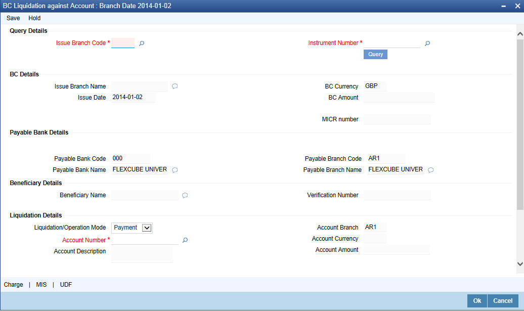

You can liquidate a BC against an account through the ‘BC Liquidation Against Account’ screen. You can invoke this screen by typing ‘8309’ in the field at the top right corner of the Application tool bar and clicking on the adjoining arrow button.
Issue Branch
Instrument Number
Select the instrument number of the BC that needs to be liquidated from the adjoining option list. This field allows you to capture the issuer code while selecting the instrument number.
External Reference
Issue Branch Code
Instrument Number
Issue Branch Name
The system displays the issue branch name based on the branch code.
Issue Date
The system defaults the Issue date. However you can change it using the adjoining calendar.
BC Currency
The system displays the local currency of the banker’s cheque captured during ‘Issue’..
BC Amount
The system displays the BC amount captured during 'Issue'.
MICR Number
Payable Bank Code
Payable Bank Name
Payable Branch Code
Payable Branch Name
BC Status
The system displays the status of BC.
Beneficiary Name
The system displays the beneficiary in whose favour the BC is being drawn captured during 'Issue'.
Verification Number
The system displays the customer's verification number captured during 'Issue'.
Liquidation/ Operation Mode
Select the mode of liquidation or operation to be performed on the issued BC from the drop-down list. The list displays the following values:
Account Number
Specify the customer account number. The adjoining option list displays all the accounts maintained in the system. Select the appropriate one.
Account Branch
Account Description
Account Currency
Account Amount
Narrative
The system defaults the ‘BC Liquidation - <Instrument No.>’ here. However you can modify this.
External Reference
Note
If the system date is greater than the expiry date, then the system will not allow liquidating the instrument and will display the following error message as “Instrument Validity has expired and needs Revalidation”.
If the check box ‘Allow Revalidation’ is checked in the ‘Instrument Product maintenance’ screen, then you can re-validate the instrument using ‘Revalidation of DD/BC Instrument’ screen. After revalidation, system will allow liquidating the instrument as the expiry date gets extended by the revalidation period.
In addition to the details defaulted from the previous stage, you can capture the following information:
Click on the MIS tab to capture details pertaining to MIS.
Click save icon to save the transaction. The approver can fetch this transaction for his/her task list and authorize it. The authorization process is similar to that of cash deposit.

You can liquidate a BC drawn on your branch against a GL through the ‘BC Liquidation Against GL’ screen. You can invoke this screen by typing ‘8308’ in the field at the top right corner of the Application tool bar and clicking on the adjoining arrow button.
You can capture the following details:
Instrument Number
Issue Branch Code
Select the issue branch code where the BC is payable from the adjoining option list .
Issue Branch Name
Issue Date
BC Currency
BC Amount
Payable Bank Code
Payable Bank Name
Payable Branch Code
Payable Branch Name
MICR Number
BC Status
Beneficiary Name
Verification Number
GL Number
GL Description
GL Currency
GL Amount
Narrative
External Reference

You can liquidate a DD or a walk-in customer and give the customer an equivalent amount in cash. In order to capture such a transaction, invoke the ‘BC Liquidation Walk-In’ screen. You can invoke this screen by typing ‘8307’ in the field at the top right corner of the Application tool bar and clicking on the adjoining arrow button.
Instrument Number
Issue Branch Code
Issue Branch Name
Issue Date
BC Currency
The system displays currency of the BC captured during 'Issue'.
BC Amount
Payable Bank Code
Payable Bank Name
Payable Branch Code
Payable Branch Name
MICR Number
The system displays the MICR number of the cheques which was captured during 'Issue'.
BC Status
Beneficiary Name
The system displays the beneficiary in whose favour the BC is being drawn captured during 'Issue'..
Verification Number
Liquidation Mode
Select the mode of liquidation from the adjoining drop-down list.
The currency of the transaction is displayed here.
Transaction Amount
The system displays the transaction amount based on the currency.
Narrative
External Reference
Refer the section titled ‘Specifying the MIS details’ under ‘Withdrawing cash against a Cheque’ in this manual.

You can query a BC transaction for a specified branch and Instrument Number. This can be done using the ‘BC Inquiry’ screen. You can invoke this screen by typing ‘7790’ in the field at the top right corner of the Application tool bar and clicking on the adjoining arrow button.
Instrument Number
Specify an instrument number of the BC transaction that needs to be queried.The adjoining option list displays all the instrument numbers maintained in the system. Choose the appropriate one.
Payable Branch Name
Issue Branch
Specify a branch for which you wish to query the BC transaction. You can also select a branch from the adjoining option list.
After you specify the above details, click ‘Ok’ button. Based on the specified data, the following details will be displayed:
Bank Code
Bank Name
BC Date
BC Currency
The system displays the local currency of the banker’s cheque.
BC Status
Payable Branch Code
Payable Branch Name
MICR Number
Specify the MICR number.
BC Amount
Specify the BC amount.
Narrative
Print Status
Note
During loan disbursement, if the issuing branch is selected as a branch other than the transaction branch then the “Print Status’ check box is updated as unchecked during BC creation.
Beneficiary Name
Verification Number
Specify the passport/IC Number.
Mode
The system displays the mode of liquidation based on the mode of payment.
Account Number
The system displays the account number of the customer.
Account Description
The system displays a brief description on account.
Currency
The system displays the currency based on funding.
Cheque Number
Purchaser Name
The system displays the purchaser name.
GL Number
The system displays the general ledger number.
GL Description
The system displays a brief description on GL.
Amount
Cheque Date
The system displays the cheque date.
Verification Number
The system displays the verification number.
Liquidation Date
The system displays the date on which BC is liquidated.
Multi Reference Number
The system displays the consolidated reference number of the BCs issued. This field is applicable only for multiple BCs issued either through BC Multi Issuance screen or using Bulk Upload.
Address Line 1 to 4
The system displays the address of the customer.

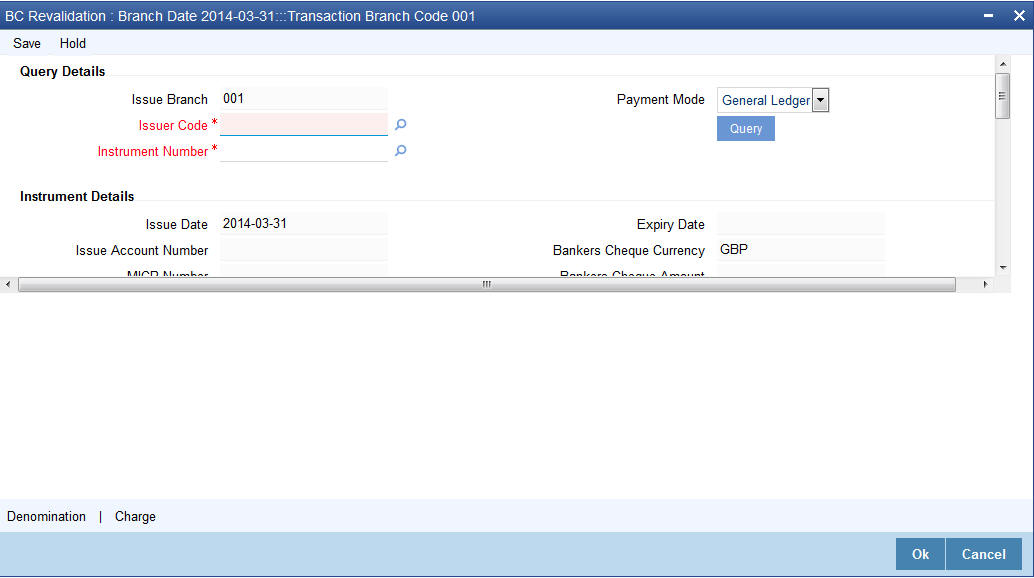

You can re-validate the expired BC instrument using ‘Revalidation of BC Instrument’ screen.
To invoke ‘Revalidation of BC Instrument’ screen, type ‘BCRV’ in the field at the top right corner of the Application tool bar and click on the adjoining arrow button.
Issue Branch
Specify the branch where BC has been issued.
Issuer Code
Instrument Number
Specify the instrument number for the issuance of duplicate BC instrument from the adjoining option list.
Payment Mode
Select the payment mode for the re-validation of the instrument from the drop-down list. System will apply charges only for the re-validation of an instrument. Cancellation charges will be waived.
The system displays the following instrument details:
Revalidation Reason
Specify the reason for the re-validation of BC instrument. The reason specified here will be shown in the revalidated instrument report.
System defaults re-validation frequency maintained the ‘Instrument Type Definition’ screen; however, you can override the re-validation frequency in days, months or years.
New Expiry Date
Charge Account
Charge Currency
Instrument Type
On various grounds such as improper printing and issue of duplicate instruments, Oracle FLEXCUBE allows you to reprint a banker’s cheque. The system keeps a track of such reprints so that the bank officials or auditors can ascertain the reasons and validity of multiple instrument printing.
To invoke ‘BC Reprint / Reissue’ screen, type ‘BCRP’ in the field at the top right corner of the Application tool bar and click on the adjoining arrow button.
Issue Branch
Issuer Code
Instrument Number
Multi BC External Reference No
Select the multi BC external reference number from the option list. The list displays all valid options.
Start Number
Specify the start number.
End Number
Specify the end number.
Print Type
Select the print type from the drop-down list. The list displays the following values:
Note
If you select ‘Print Type’ as Reissue or Reprint and if the ‘Print Status’ check-box in ‘Instruments Transaction Query Screen’ is unchecked then system displays an error message.
Specify the new instrument number.
New MICR Number
Specify the new MICR number.
Reprint/Reissue Reason
Specify the reason for reprint/reissue. During auditing, the official or the auditor will verify the validity of the reason specified here. This information is mandatory.
Reprint/Reissue Count
The system displays the count of the current reprint operation. You cannot modify this.
Beneficiary Name
Address 1-3
The system displays the address of the beneficiary.
Instrument Status
The system displays the instrument status.
You can view a summary of all reprint operations using ‘Instrument Reprint Summary’ screen. For more information on this, refer to the section ‘Viewing Instrument Reprint Summary’ in this chapter.
You can issue the duplicate BC instrument using ‘Duplicate Issue of BC Instrument’ screen.
System will allow duplicate issuance of instrument only if,
To invoke ‘Duplicate Issue of BC Instrument’ screen, type ‘BCDI’ in the field at the top right corner of the Application tool bar and click on the adjoining arrow button. Following screen is displayed:
Issue Branch
Issuer Code
Payment Mode
The system displays the new instrument number.
New MICR Number
Specify the reason for the duplicate issuance of BC instrument.
Duplicate Issue Count
The system displays the duplicate issue count.

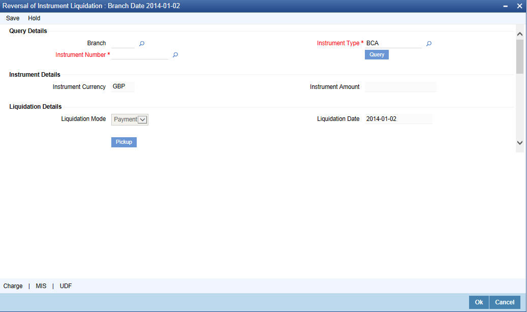

You can reverse the liquidated BC/DD instruments through the ‘Reversal of BC/DD Liquidation’ screen. You can invoke this screen by typing ‘8304’ in the field at the top right corner of the Application tool bar and clicking on the adjoining arrow button.
Issue Branch
Specify the branch where the instrument is issued. The adjoining option list displays all the branches that are maintained in the system. You can select the appropriate one.
Instrument Type
Specify the instrument type which is to be reversed. The adjoining option list displays all the DD and BCs based on the branch selected. You can select the appropriate one.
Instrument Number
Specify the instrument number which is to be reversed. The adjoining option list displays the valid instrument numbers based on the instrument type selected. You can select the appropriate one.

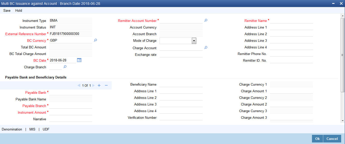

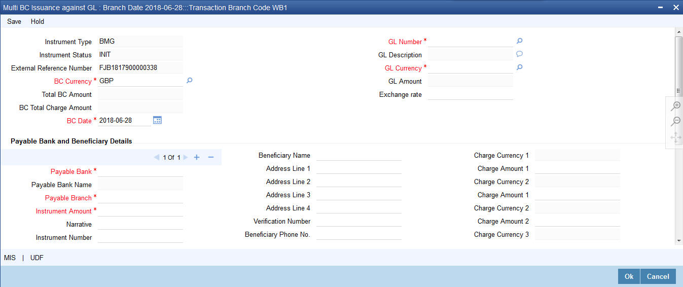

You can issue Multi BC against a customer’s savings account. To capture this transaction, you need to invoke the ‘Multi BC Issue Against Account’ screen by typing ‘8332’ in the field at the top right corner of the Application tool bar and clicking on the adjoining arrow button.
You can specify the following details:
Instrument Type
The system displays the instrument type corresponding to the multi BC issued to customers against their account.
Instrument Status
External Reference
The system displays a unique reference number generated based on the branch-specific sequence number generation logic.
BC Currency
The system displays the currency of the banker’s cheque. You can modify it.
Total BC Amount
The system displays the sum total of multiple BC amount.
BC Total Charge Amount
The system displays the total charge amount computed for the issued multiple BC.
BC Date
The system defaults the BC date to the system date. You can modify it.
Remitter Account Number
Specify the account number of the remitter. Alternatively, you can select the account number from the option list. The list displays all valid accounts maintained in the system.
Account Currency
Account Branch
Mode of Charge
Charge Account
Exchange Rate
