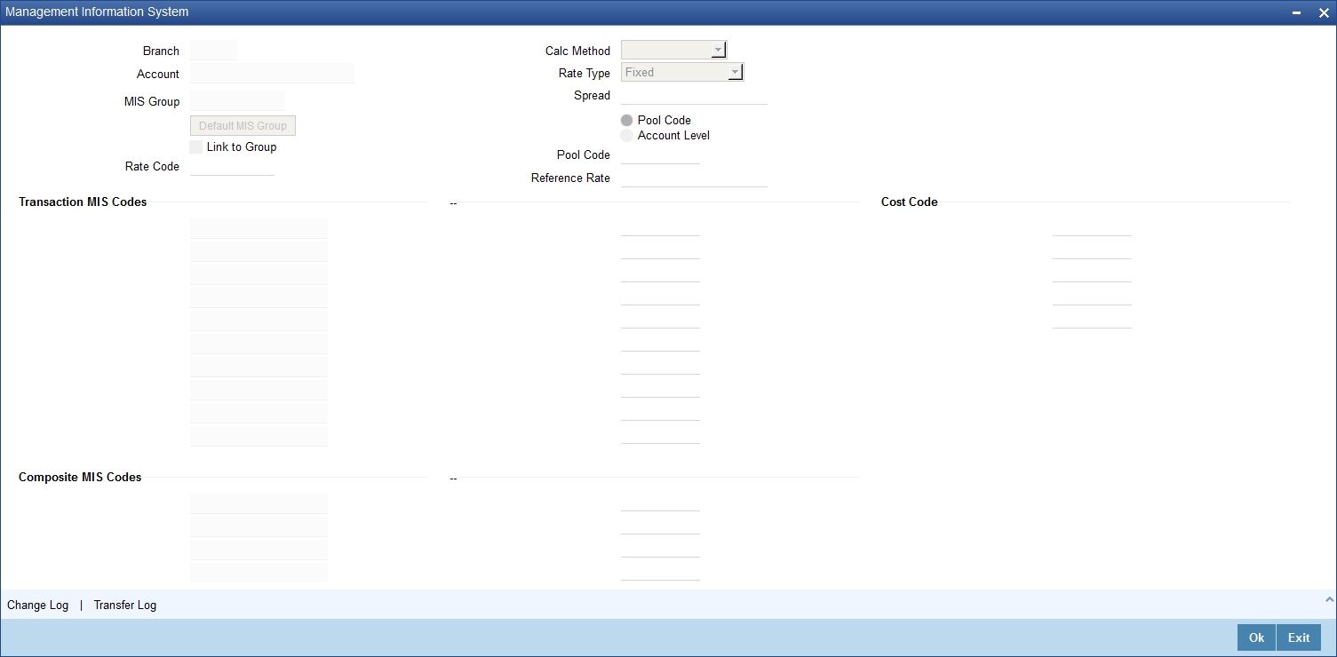

MIS
This invokes the ‘Management Information System’ screen.

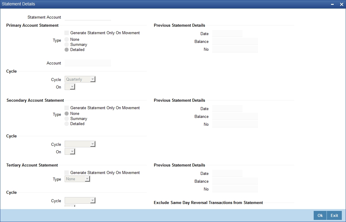

Statement
This invokes the ‘Statement Details’ screen.

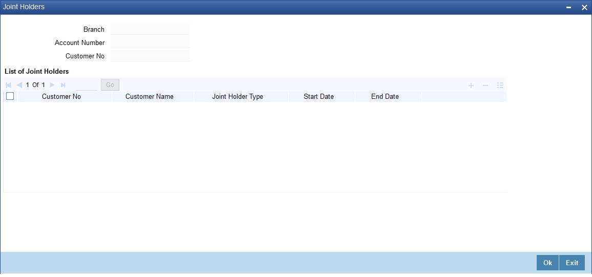

Joint Holders
This invokes the ‘Linked Entities’ screen

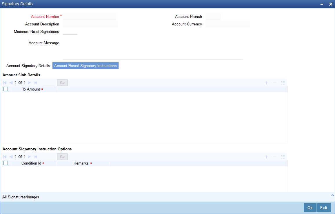

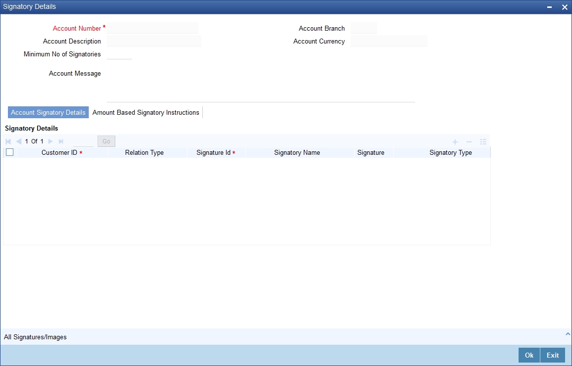

Account Signatory
This invokes the ‘Signatory Details’ screen.

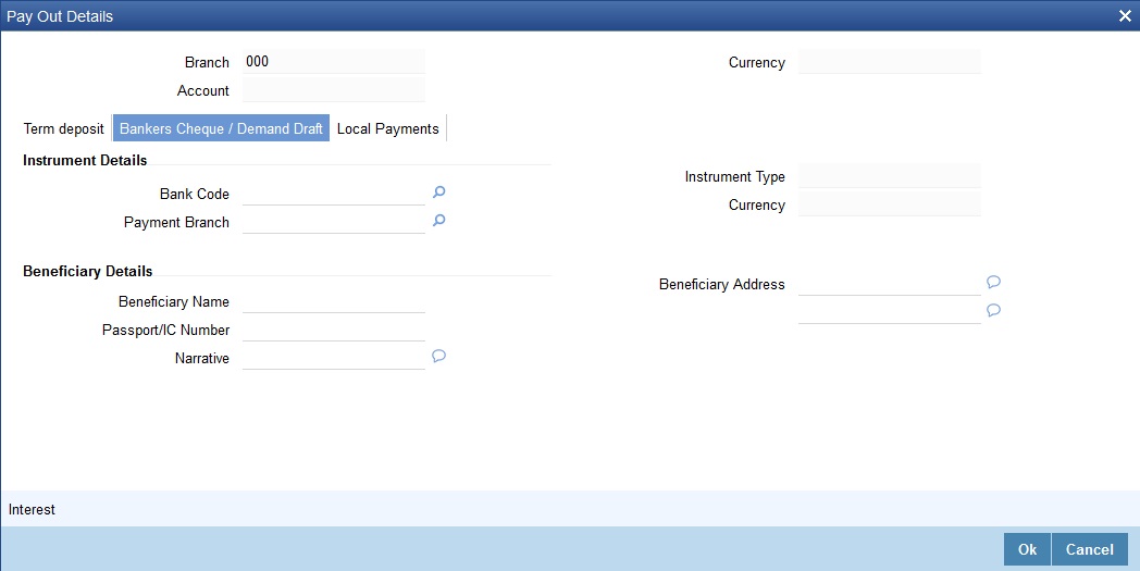

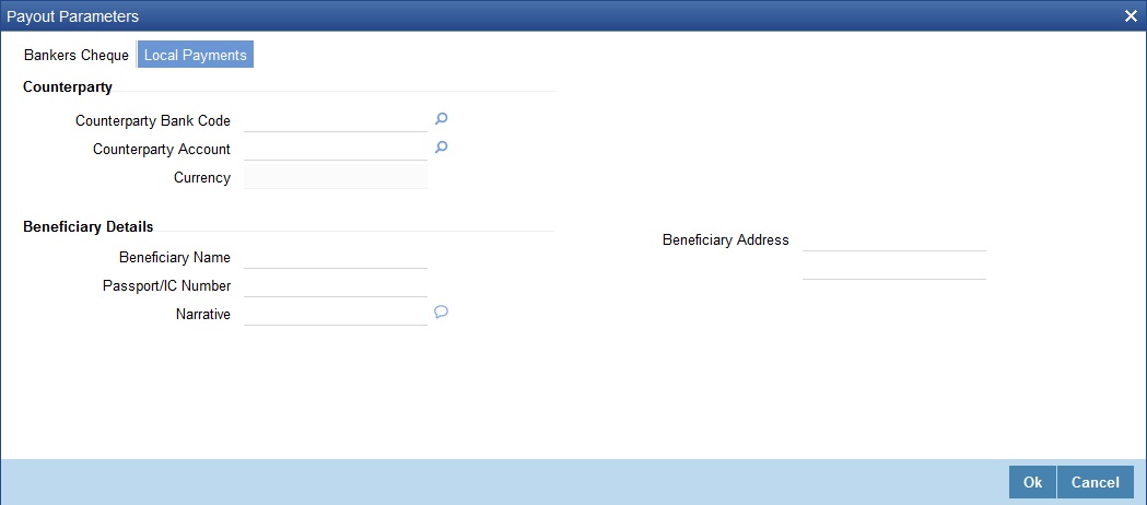

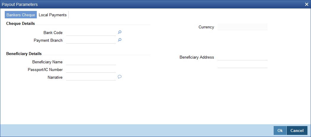

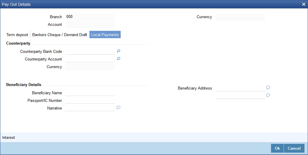

TD Payout Details
This invokes the ‘Term Deposit Payout Details’ screen.

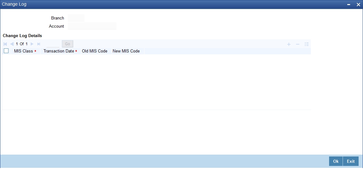

Change Log
This invokes the ‘Customer Address Change Log’ screen.

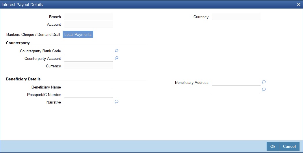

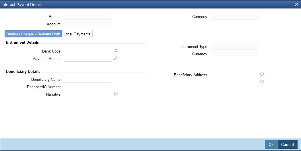

Interest Payout Details
This invokes the ‘Term Deposit Interest Payout Details’ screen.

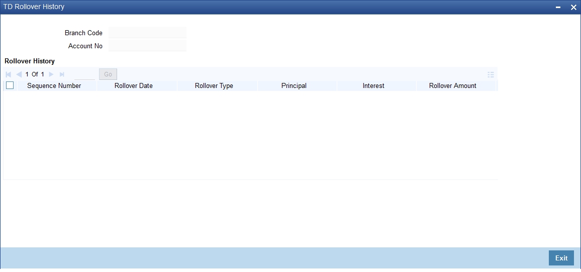

Rollover History
This invokes the ‘rollover History’ screen.

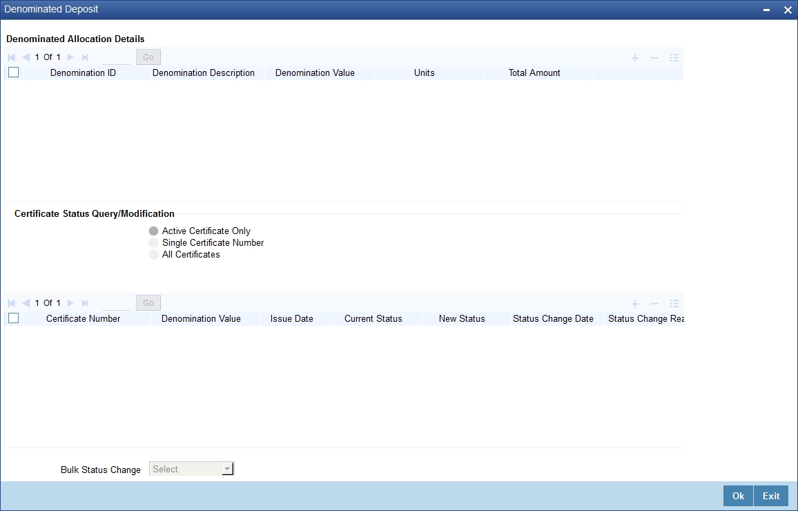

Denominated Deposit
This invokes the ‘Denominated Deposit’ screen.

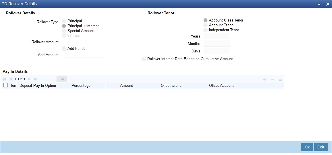

Rollover Details
This invokes the ‘TD Rollover Details’ screen.

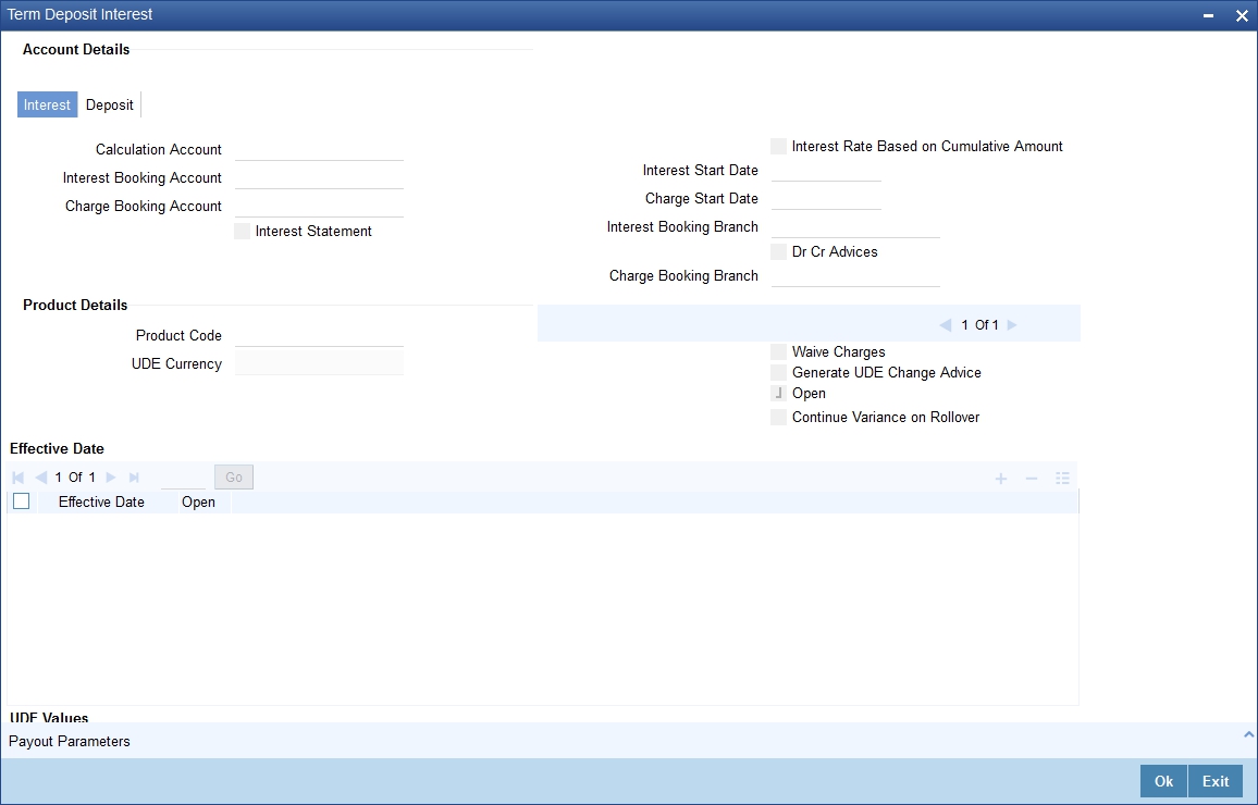

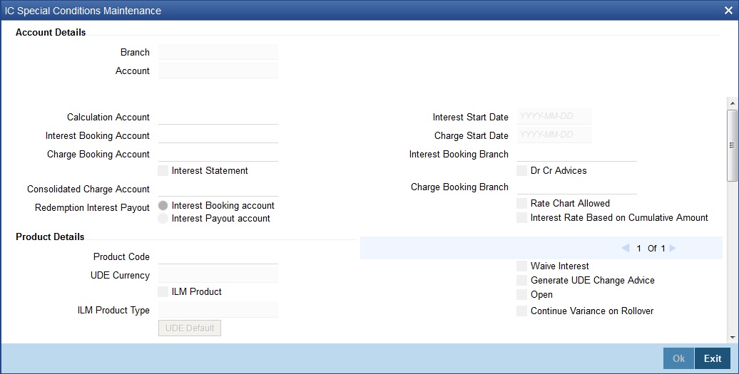

5.3 Specifying Interest Details
Click ‘Interest’ button on the ‘Deposit Account Booking’ screen and invoke the ‘IC Special Conditions Maintenance’ screen.
You can specify the following details:
Branch Code
The Branch Code to which the account belongs (for which you are defining special conditions) is displayed in this field.
Account
The account number of customer (for which you are defining special conditions) is displayed in this field.
Calculation Account
Specify the account for which interest will be calculated. The TD account populated will be the calculation account.By default, it will be same as the customer account. However you can change it.
Interest Booking Account
You can select the account for booking interests on transaction processed at your bank.
At the time of creating an IC product, if you have maintained the booking account type as Interest (in the ‘Interest and Charges – Product Definition’ screen), the Interest will be liquidated into the Interest Booking account. By default, the TD account is defaulted as the interest booking account. However, you have the option of booking interest to a different account belonging to another branch also. The accounts maintained in the selected Booking Branch will be available in the adjoining option list. You can select the appropriate account. Interest will then be liquidated into the selected account.
Charge Booking Account
You can select the account for booking charges on transactions processed at your bank
At the time of creating an IC product, if you have maintained the booking account type as Charge (in the ‘Interest and Charges – Product Definition’ screen), the charge will be liquidated into the Charge Booking account. By default, the customer’s account in the current branch will be displayed in this screen (in the ‘Charge Booking Account’ field). However, you have the option of booking charge to a different account belonging to another branch also. The accounts maintained in the selected Booking Branch will be available in the adjoining option list. You can select the appropriate account. Charges will then be liquidated into the selected account.
Interest Statement
Check this box to indicate that you would like to generate an interest statement for the account. The Interest Statement will furnish the values of the SDEs and UDEs and the interest rule that applies on the account.
Interest Start Date
Specify the date from which the interest accruals of TD account begins. You can specify the date as of booking the TD or any date in the future. If you specify a date in future, the system will post entries for account opening (DEBK event) on the account opening date with the value date as interest start date. It will start interest accrual calculation on the date specified in this field and post entries for IACR event.
Charge Start Date
For the account for which you are defining special conditions, you must specify the date from which you would like to apply charges. Charges for this account will be calculated according to the special conditions that you define subsequently.
By default, charges on an account would be applied when the free banking period (if any) elapses. This means that the Charge Start Date is arrived at by the System by adding the Free Banking Period days (if any, specified for the Term Deposit used by the account) to the Account Opening Date. If no Free Period has been indicated for the account class used by the account, the Charge Start Date is defaulted to the Account Opening Date (that is, charges on the account would be applied right from the account opening date) and displayed in the Special Conditions Maintenance screen.
You can override the default Charge Start Date and specify the desired start date for charge application.
Interest Booking Branch
By default, the customer’s account in the current branch will be displayed in this screen (in the Interest/Charge Booking Account and Interest/Charge Booking Branch fields). However, you have the option of booking interest/charge to a different account belonging to another branch also. You can select the Interest/Charge Booking Branch from the option-list available. The accounts maintained in the selected Booking Branch will be available in the option-list provided for Interest/Charge Booking Account. You can select the account from this list. Interest/Charge will be liquidated into the selected account.
Interest booking account will be validated with the interest booking branch on save. If interest book account branch and interest booking branch are different, then the system displays an error, ”Booking account not valid for branch.”
Dr Cr Advices
You can indicate whether you want to generate an interest liquidation advice for a customer account. Check this box to indicate that the system must generate payment advices when interest liquidation happens on an account. The advices are generated in the existing SWIFT or/and MAIL format. No advices will be generated if you leave this box unchecked.
By default, the customer’s account in the current branch will be displayed. However, you have the option of booking charge to a different account belonging to another branch also. You can select the Charge Booking Branch from the option-list available. The accounts maintained in the selected Booking Branch will be available in the option-list provided for Charge Booking Account. Charge will be liquidated into the selected account.
Rate Chart Allowed
The system defaults this preference from account class and it indicates that the system should calculate TD interest based on the LDMM float rate maintained in the ‘LD MM Floating Rate input’ screen (CFDFLTRI), If it is checked, the system will pick interest rates based on different tenors, amount slab, currency and effective date for a TD. The system does not allow you to amend it.
Note
During account creation for TDs, if ‘Rate Chart Allowed’ is checked, the system does not allow IC rate code. During IC calculation, if the rate code is maintained for the UDE then the system derives the interest rate from the Rate Maintenance done in ‘LD MM Floating Rate input’ screen (CFDFLTRI).
Continue Variance on Rollover
This is defaulted based on the Interest and Charges product. However, you can modify this. If you have modified this, then during save, the system will prompt that ‘Continue variance on Rollover Flag is modified’. You can proceed.
Check this box to enable continued variance on rollover. If you check this, then the system will default account variance as current value to the rollover deposit for the next cycle.
If you do not check this, then the account variance will not be carried forward to next rollover cycle.
Interest Rate Based on Cumulative Amount
Check this box to indicate that the system should arrive at the interest rate of a new deposit using the deposit amount/principal balance of other active deposits, under the same account class, customer and currency.
The cumulation of the amount for arriving at the interest rate is done at the account level during the save of the below events:
Note
Refer the section ‘Calculating Interest Rate Based on Base Amount’ in this User Manual for details about arriving at interest rate based on cumulative amount.
Consolidated Charge Account
Specify the account for posting consolidated charges. The adjoining option list displays all valid accounts maintained in the system. You can select the appropriate one.
Currency
Specify the term deposit currency.
Product Details
Specify the following details:
Product Code
Specify an interest product in order to allow calculation of interest. When you apply an interest product on the account, interest for the account will be calculated according to the interest rule attached to the product.
Multiple interest products can be attached to TD account class. But, a TD can be created with one interest product attached. Charge product is not supported for TD accounts.
UDE Currency
Specify the UDE currency for the product that you apply on the account. UDE values that you specify for the account subsequently will be taken to be in this currency.
Waive Interest
This box is unchecked by default. However, you cannot waive interest on a TD. Leave this box unchecked.
Generate UDE Change Advice
Check this box to indicate that interest rate change advice has to be generated for the account at EOD. The system generates interest rate change advices for accounts when the interest rate changes as part of EOD. For those accounts, when interest rate changes the details are handed off for rate change advice generation and the same is generated in the pre determined SWIFT format as per MT 935.
If the advice format is maintained in MAIL / FAX formats, then message type UDECA will be used
The advice tag used for interest rate change is ‘RTCHG_ADVICE’. The advice format for interest rate change as per MT935 is given below:
Status
Tag
Field Name
Content/Options
No.
M
20
Transaction Reference Number
16x
1
O
23
Further Identification
16x
2
O
25
Account Identification
35x
3
M
30
Effective Date of New Rate
6!n
4
M
37H
New Interest Rate
1!a12d
5
O
72
Sender to Receiver Information
6*35x
6
M = Mandatory, O = Optional
Open
You can temporarily stop applying an IC product on a TD by un-checking this box. The product will cease to be applied on the term deposit. You can make the product applicable again by checking this box.
External Pricing
External Pricing
External pricing check box will be enabled when interest product selected is enabled for external pricing.
To view the details of external pricing enabled interest products, select '+' button and add the interest product which is enabled for external pricing by selecting from the list.
Once the product is added, you can add the effective date and then select 'UDE Default' which defaults all the UDEs linked to selected interest product and the values against the same which are returned by external pricing system.
Effective Date
Indicate the following details:
Effective Date
The ‘Effective Date’ of a record is the date from which a record takes effect. You can maintain different values for a UDE, for different effective dates, for an account. When interest is calculated on a particular day for an account with special conditions applicable, the value of the UDE corresponding to the date will be picked up.
Typically, you would want to open records with different Effective Dates if the values of UDEs vary within the same liquidation period.
Open
Typically, you would want to open records with different effective dates if the values of UDEs vary within the same liquidation period.
If this box is unchecked, then on save system displays the error message "Special condition not maintained for the account”.
UDE Values
Specify the following details.
User Defined Element ID
Specify the UDE for which value is given. The adjoining option list lists all UDEs maintained for the Interest Rule. You can select the appropriate one.
UDE Value
Specify the value of the UDE. For a fixed interest rate, you can specify a numeric value.
Note
UDE ID/variance and UDE value/variance of previous rollover dates cannot be modified..
Rate Code
If you want to use a floating rate instead of a fixed rate, you should specify a valid IC rate code. The system will pick up the applicable rate based on the branch, currency and effective date combination maintained for the rate code in the ‘Interest & Charges Rate Input’ screen (ICDRATMA). For a given tenor, the system picks up the applicable rate as per the effective dates defined for the rate code. If a floating rate has to be used instead of fixed rate, IC rate code defined in the screen ‘ICDUDVAL’ will be defaulted to the TD account. On every rate change for the effective dates, the system will apply new rate to TD account effective from that date.
In the corresponding IC rule, you need to ensure that UDE Type is maintained as ‘Rate’ for interest rate pick-up for this account.If at the IC Rule, the UDE Type is maintained as "Rate as Rate Code”, then the rate for IC rate code will be resolved and defaulted to TD account and rate pick-up will happen only during events (Book / Liqd / Roll).
TD Rate Code
Specify the rate code to be used for TD calculation. The adjoining option list displays all rate codes maintained using the ‘LD MM Floating Rate Input’ screen (CFDFLTRI). You can select the appropriate one. You can use TD rate code only when you have checked ‘Rate Chart Allowed’ option for the account class that is linked to the IC product.
In the corresponding IC rule, you need to ensure that UDE Type is maintained as ‘Rate as Rate Code’ for interest rate pick-up for this account.
Refer the chapter ‘Annexure B – IC Rule Set-up’ in this User Manual for further details about IC rules.
Variance
Specify the variance in the interest rate. This is the variance alone. The effective rate will be the sum of the TD rate code and the variance that you specify here. You can modify it anytime.
Note

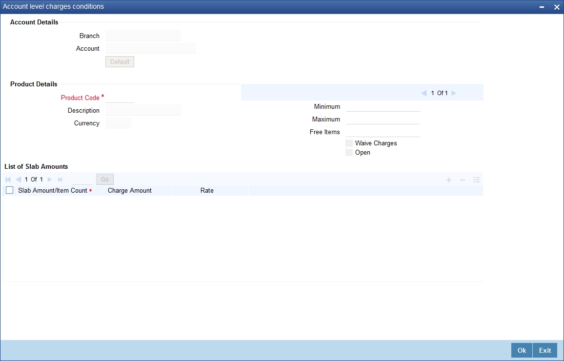

5.4 Specifying Charge Details
Click ‘Charges’ button on the ‘Deposit Account Booking’ screen and invoke the ‘Account level charges conditions’ screen. This screen is not applicable for Term Deposits.
Branch Code
Account
The Account number of customer (for which you are defining special conditions) is displayed in this field.
You can click the ‘Default’ button to default the Charge Products and the corresponding details applicable for the account. You can then modify these values to define the special conditions.
5.4.1 Specifying Product Details
Product Code
The system defaults a product when you click the ‘Default’ button at the time of account creation. You must modify it to identify the Charge product using which the applicable charges would be collected.
Currency
The charges would be collected in the currency defined for the selected charge product, and this currency is displayed on the screen.
Minimum and Maximum
You must indicate the charge amount range, representing the minimum and maximum charge that can be applied for the account.
Free Items
You must indicate the number of free items for which the customer will not be charged.
Open
By default, each charge consolidation charge setup that you set up is enabled and active. You can also disable the setup by checking the ‘Open’ box.
Waive Charges
You can choose to waive charges for an account.

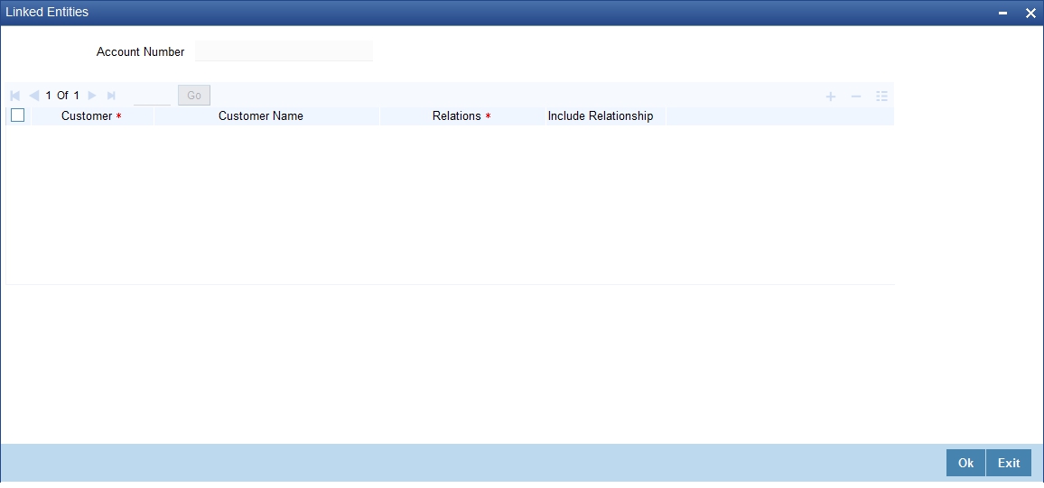

5.5 Specifying Linked Entities
Click ‘Linked Entities’ button on the ‘Deposit Account Booking’ screen and invoke the ‘Linked Entities’ screen.
Customer
Select the customer from the option list with whom you want to establish the relationship with the account that you are maintaining.
Description
In this field, the system displays the name of customer that you have selected in the previous field. You cannot change the description.
Relations
By default, the system will select the customer of the account as the Primary Holder. This is a pre-shipped relationship and you will not be allowed to change the relationship.
Include Relationship
Check this box to indicate that relationship should be inherited for all transactions.

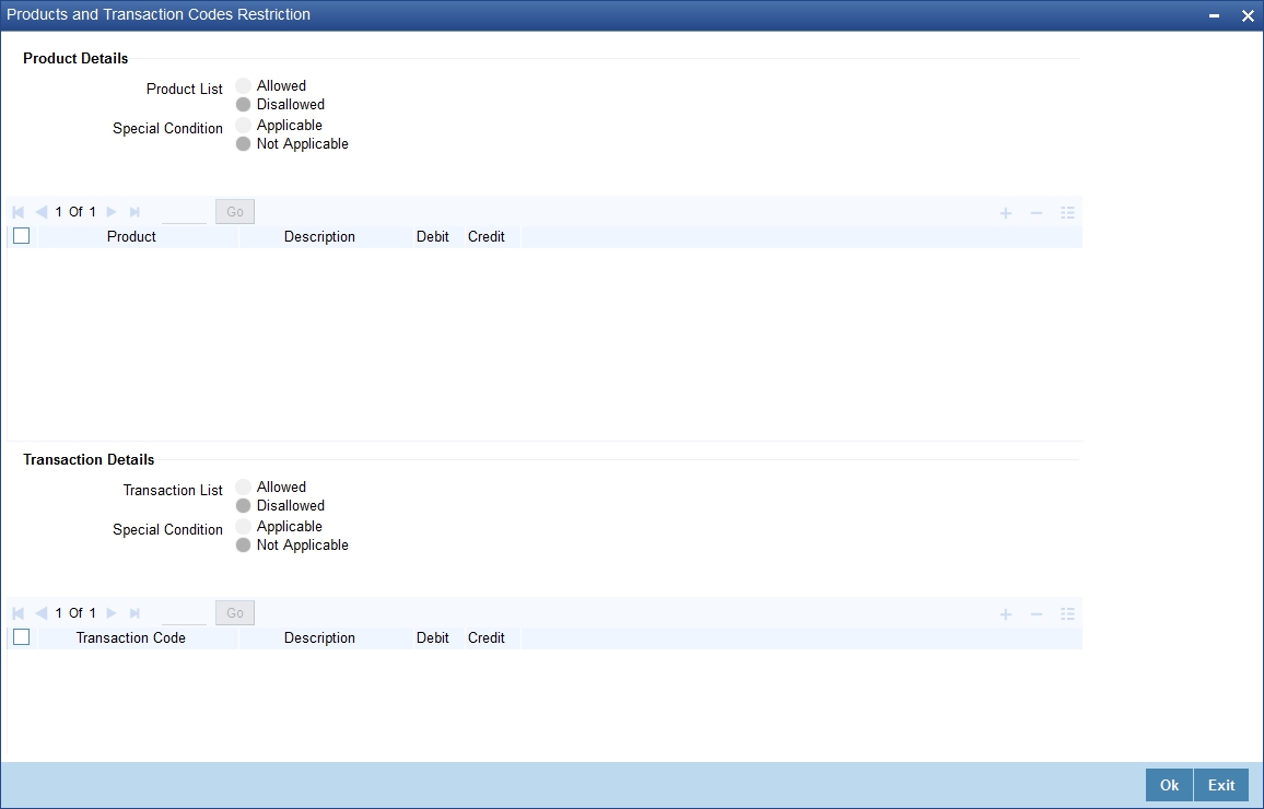

5.6 Specifying Restrictions
Click ‘Restrictions’ button on the ‘Deposit Account Booking’ screen and invoke the ‘Products and Transaction Codes Restriction’ screen.
Product Details
Indicate the following preferences.
Special Condition
By default, the restrictions maintained at the account class level will be displayed here. When you define product restriction attributes for an account itself, rather than for the account class to which it belongs, it is referred to as a Special Condition. You can apply special conditions by selecting the option ‘Applicable’. If you opt to define special conditions for an account the ‘restrictions’ defined for the Account Class, to which the account belongs, will NOT apply to this account. If you wish to continue with the account class restrictions, opt for ‘Not Applicable’.
Product List
Specify the restriction type here. The options available are:
Product
You can select the products and specify the type of transaction (Dr, Cr or both) that you would like to allow/disallow for each product. In contracts involving the selected products, the accounts would be used for processing the selected type of transaction. For instance, assume that for the account A1, you have allowed ‘Dr’ for the product ABCD. This would mean that if a Dr entry for the product ABCD is passed to the account, A1, it would go through but in case a Cr entry is passed for this product, then the system will display a message indicating that the transaction is restricted for the account.
Description
The system displays the description for the product code that which you have specified
Debit
During transaction processing, the system will validate whether any restrictions are placed on the account based on the product code. If you have indicated to allow ‘Dr’ Transactions for the product ABCD, and attempt to post a debit entry, the system will seek an override. If the message has been configured as an ‘override’ instead of an ‘error’, you will be able to continue the transaction, despite the restrictions, by providing appropriate reasons for the same. Otherwise you cannot continue with the transaction.
During maintenance or online operations, in the respective contract screens for the restricted transactions, when you specify the customer account, the system checks whether the account is restricted for the product that has been selected, or the debit/credit transaction type. If so, an override is sought when such contracts are saved.
Credit
During transaction processing, the system will validate whether any restrictions are placed on the account based on the product code. If you have indicated to allow ‘Cr’ transactions for the product ABCD, and attempt to post a credit entry, the system will seek an override. If the message has been configured as an ‘override’ instead of an ‘error’, you will be able to continue the transaction, despite the restrictions, by providing appropriate reasons for the same. Otherwise you cannot continue with the transaction.
Transaction Details
Special Condition
By default, the restrictions maintained at the account class level will be displayed here. When you define transaction code restriction attributes for an account itself, rather than for the account class to which it belongs, it is referred to as a Special Condition. You can apply special conditions by selecting the option ‘Applicable’ at the account level. If you opt to define special conditions for an account the ‘restrictions’ defined for the Account Class, to which the account belongs, will NOT apply to this account. If you wish to continue with the account class restrictions, opt for ‘Not Applicable’.
Transaction List
Transaction Code
Likewise, you can maintain restrictions for transaction codes as well. Transaction code based restrictions are allowed only for entries initiated from the Data Entry module. Otherwise you should use product code based restriction.
Description
The system displays the description for the transaction code that you have specified
Debit
During transaction processing, the system will validate whether any restrictions are placed on the account based on the transaction code. If you have indicated to allow ‘Dr’ transactions for a particular transaction code, and attempt to post a credit entry, the system will seek an override. If the message has been configured as an ‘override’ instead of an ‘error’, you will be able to continue the transaction, despite the restrictions, by providing appropriate reasons for the same. Otherwise you cannot continue with the transaction.
Credit
During transaction processing, the system will validate whether any restrictions are placed on the account based on the transaction code. If you have indicated to allow ‘Cr’ transactions for a particular transaction code, and attempt to post a debit entry, the system will seek an override. If the message has been configured as an ‘override’ instead of an ‘error’, you will be able to continue the transaction, despite the restrictions, by providing appropriate reasons for the same. Otherwise you cannot continue with the transaction.
5.7 MIS Details
5.7.1 Specifying MIS Details
Click ‘MIS’ button on the ‘Deposit Account Booking’ screen and invoke the ‘Management Information System’ screen.
Branch Code
The current logged-in branch code is displayed here
Account
The TD account number is displayed here.
MIS Group
For an account, the transaction type of MIS class will be picked up from the account class.
Rate Code
Specify the rate code. You can also select the appropriate one from the adjoining option list, which displays all valid rate codes maintained in the system.
Calc Method
Specify the method to be considered for MIS related component computation.
Rate Type
If you have indicated that rates maintained for the individual account should be picked up for MIS refinancing you have to specify the Rate Type that is to be used. The options available are:
Spread
Specify the spread that should be applied if rate type is selected as ‘floating’ type.
Pool Code/Account Level
Define the Pool Code/Account Level to which the account class or product belongs.
Pool Code
For an account, the pool code will be picked up from the account class.
Transaction MIS Group
Composite MIS Group
The composite type of MIS class will be defaulted from those defined for the customer.
Cost Code
For an account, the cost codes will be picked up from the account class.
5.7.2 Viewing Change Log
Click ‘Change Log’ button on the ‘Management Information System’ screen and invoke the ‘Change Log’ screen. If MIS reclassification occurs, through changing of the MIS codes for the ‘Customer Type’ of MIS classes, the system will store the changes made, in the Customer MIS ‘Change Log’ screen.
Here you can view the following details:
Branch Code
The current logged-in branch code is displayed here.
Account
The system displays the TD account number.
Change Log Details
You can view the following details:

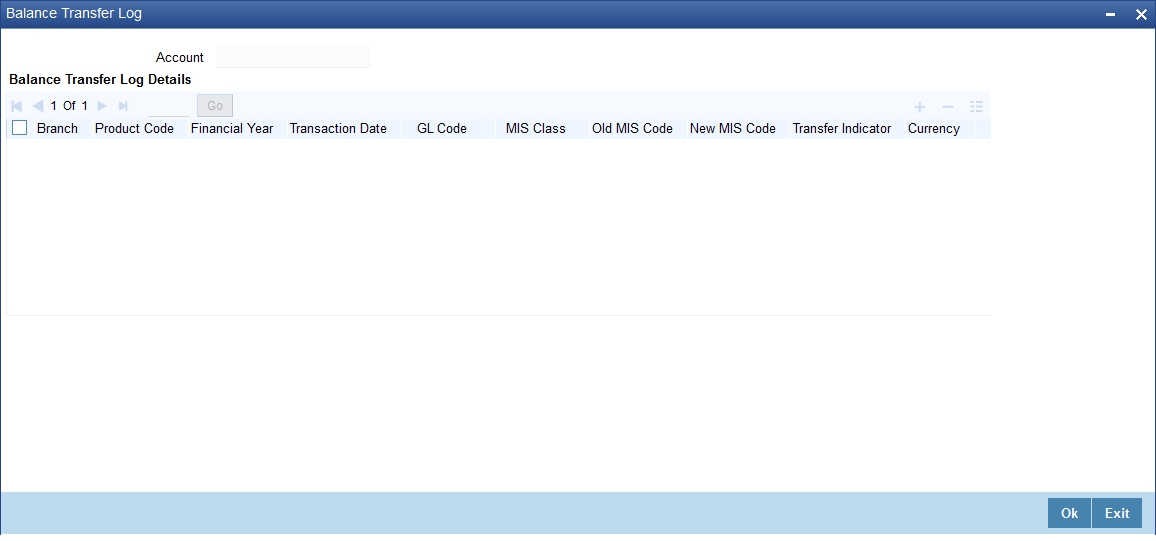

5.7.3 Viewing Transfer Log
Click ‘Transfer Log’ button on the ‘Management Information System’ screen and invoke the ‘Balance Transfer Log’ screen. When MIS reclassification occurs with respect to a customer, account or contract, the balances in a GL associated with the old MIS code in each case are transferred to the GL for the new MIS code, if the option of transferring MIS balances upon reclassification has been set in the ‘Chart of Accounts’ screen for the GL.
Account
Balance Transfer Log Details
5.8 Specifying Statement Details
Click ‘Statement’ button on the ‘Deposit Account Booking’ screen and invoke the ‘Statement Details’ screen.
Primary A/C Statement
This refers to the type of statement to be generated periodically by the system, for this account. You can specify whether you want a detailed or summary statement or if you do not want a statement for this account at all.
Generate Stat. Only On Movement
Check this box to indicate that an account statement should be generated for the account only when there has been a movement of funds into the account or when funds have been transferred out of the account.
For instance, let us assume that on the August 21, 2001, you have set the account statement generation frequency as Daily for the account LI020804. On the September 5, 2001, there has been no movement of funds in the particular account. If you have opted for the Generate Only on Movement option, the system will not generate a statement message for September 5, 2001.
If you choose not to enable this option, account statements will be generated regardless of whether there has been a movement of funds or not.
Type
Account
The system displays the account number for which you are setting the statement details.
Cycle
You can specify the frequency for generating the account statements. To specify the frequency of the statements, click on the adjoining drop-down list. The following list is displayed:
On
For a weekly statement you specify the day of the week on which account statements should be generated and for fortnightly and monthly statements the dates of the month. To specify for weekly statements, click on the adjoining drop-down list. The following list of days will be displayed:
To specify for monthly statements enter a number between 1 and 31 (corresponding to the system date).
If you set the statement date to 30, then account statements will be generated on:
If you set the statement date to 31, then account statements will be generated on:
For a fortnightly statement, you could specify 1 and 15
For all other cycles, account statement will be generated on the last day of that cycle.
Secondary A/C Statement
Tertiary A/c Statement
Statement Account
Specify the account for which the statement has to be generated. The adjoining option list displays all valid accounts maintained in the system. You can select the appropriate one.
Exclude Same Day Reversal trns from Stmt
If you do not wish transactions booked and reversed on the same day to be reflected in the account statement, you can specify the preference here. This feature is applicable only for the customer account legs and not for the related GL legs. Also, reversals made through the DE module will not be considered for exclusion.
This specification is defaulted from the account class linked to the account. You can change it for a specific account.
5.9 Specifying Joint Holder Details
Click ‘Joint Holders’ button on the ‘Deposit Account Booking’ screen and invoke the ‘Joint Holders’ screen.
Account Number
The system displays the account number here.
Customer No
The system displays the customer account number.
Branch Code
The system displays the branch code of the current branch.
List of Joint Holders
You can add the joint holder details in this section if the selected account type is ‘Joint’. Maintain the following details:
Customer Number
Specify the customer Id for the joint holder. The adjoining option list displays the list of all valid customer numbers. Select the appropriate one.
Customer Name
The system displays the customer name based on the selected customer number.
Joint Holder Type
Indicate the type of authority. Select the appropriate one from the drop-down menu. The options are:
Start Date
Specify the date from which the joint holding of the account begins.
End date
Specify the date on which the joint holding of the account ends.

5.11 Specifying Account Signatory Details
Click ‘Signatory’ button on the ‘Deposit Account Booking’ screen and invoke the ‘Signatory Details’ screen.
Here you can capture the following details:
Account Branch
The system defaults the current branch here.
Account Number
This is the account number to which signatories are to being linked.
Account description
The system displays the description for the account you have selected.
Account Currency
The system displays the account currency.
Minimum Number of Signatories
Specify the minimum number of signatories necessary to endorse an instrument involving the account.
Note
If the linked or replicated signatories are less than the specified minimum number, system will display an error message.
Account Message
Specify a brief description about particular signatories. It can be related to the name, number and the type of signatory your customer is. You can specify a maximum of 4000 characters as account message length.
For instance you can capture a message like - "This signatory is a joint account holder with rights to sign instruments only up US 8000".
5.11.0.1 Account Signatory Details Tab
Customer ID
Enter the customer ID you want to link to the account
You can link a customer signatory to an account either by:
Note
If the signatory ID that you specify has not been maintained, the System displays an over­ride. On confirming the override, you will be allowed to save the signatory details. An error message is displayed if you enter a duplicate Signatory ID. Each time you capture a new Signatory ID at the account level you must identify the relationship of the signatory with the customer.
Relation Type
The relation of the customer to the signature.Signature ID
Specify the signatory identification number.
Signatory Name
The system displays the corresponding name of the signatory ID specified.
Signature
The details of the signature. Click the Signature button to fetch the signature.
Signatory Type
Specify the signatory type.
Approval Limit
Specify the amount up to which the account signatory can approve for debits.
Signatory Message
The system displays the message corresponding to the signatory.
5.11.0.2 Amount Based Signatory Instruction Tab
You can maintain account signatory instructions for different amount slabs in this tab.Click on ‘Amount Based Signatory Instruction, tab to invoke the following screen:
Amount Slab Details
To Amount
Specify the slabs by setting a ‘To Amount’. The amount slab will start from zero and the first value entered will set the slab from zero to that amount. The amounts will be arranged in ascending order.For next slab, an amount above the previous ‘To Amount’ will be considered as the ‘From’ value.
For example, If the ‘To Amount’ entered are as below
To Amount
10,000
100,000
1,000,000
Then the maintenance will indicate the below amount slabs:
From Amount
To Amount
0
10,000
Above 10,000
100,000
Above 100,000
1,000,000
Account Signatory Instruction Options
For each amount slab, you can define different conditions in this section.
Condition Id
Specify a unique Id for condition to be set.
Remarks
Give a brief description for the condition id.
Required Signatories
You can define different conditions for the amount slabs in this section.
Signature Type
Select the signature type required from the option list.The list displays the signature types as maintained in static type maintenance screen.
Note
The signature type cannot be repeated for a condition.
Required No. of Signatories
Specify the number of signatories for each signatory type.This number should be less than or equal to the total number of signatories maintained under the signatory type.
Note
The Amount Based Signatory Instructions tab will be enabled in the following RT screens only if the value of param ‘AMOUNT_BASED_SV’ is Y in CSTM_BRANCH_LOC_PAR­AMS.

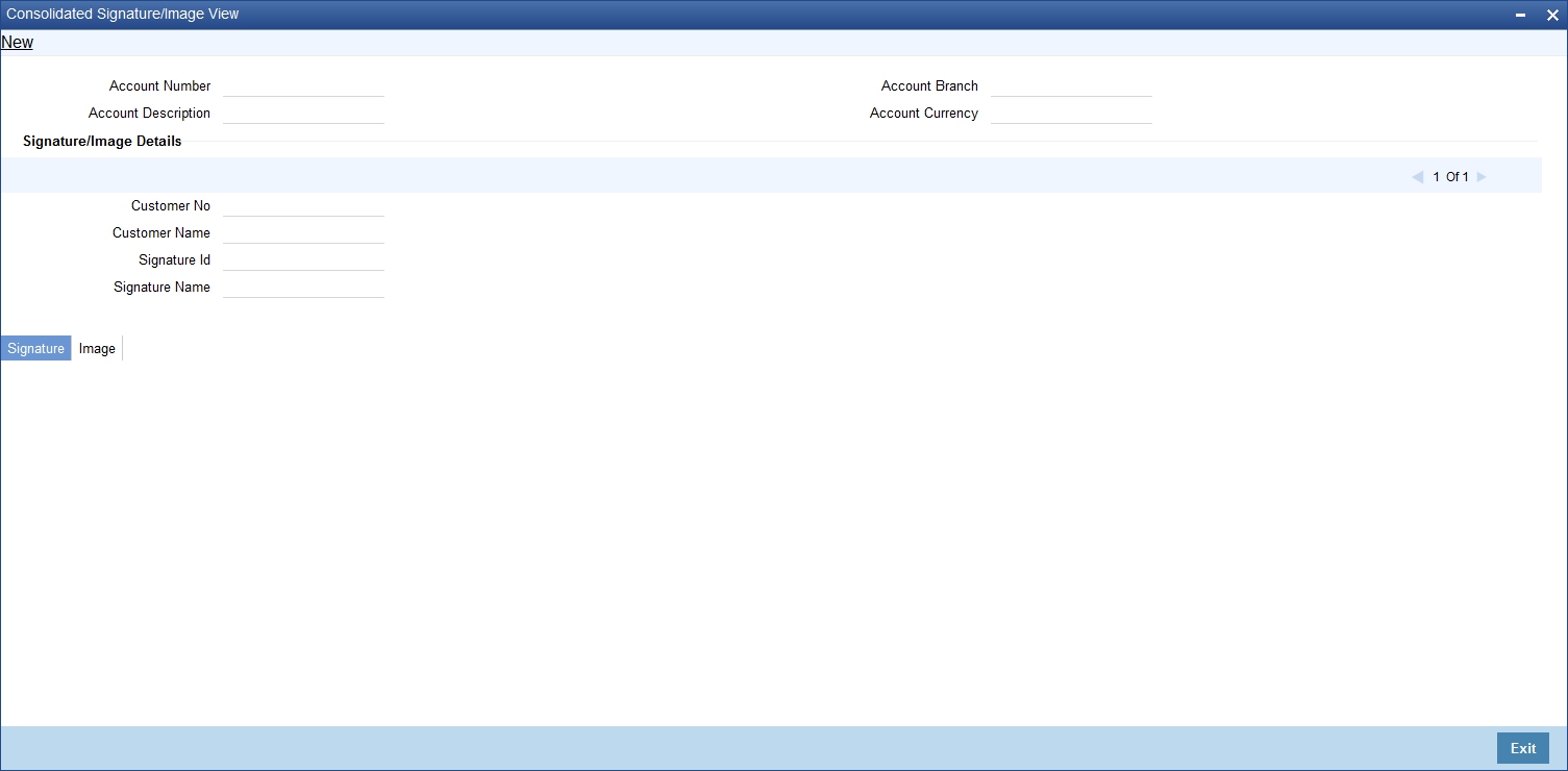

5.11.0.3 All Signatures/Images button
Click on ‘All Signatures/Images’ button to view ‘Customer Signature/Image Consolidated View’ screen.
The following details will be displayed in the above screen
The ‘Signature/Image’ tab displays nine signatures/Images for a signature id in a single pane with three signatures/Images in a row.
If there is more than one signature id linked to a customer account, then they would be displayed in different pages.
Each image is provided with the following buttons:

5.12.3 Bankers Cheque/DD Tab
Click ‘Banker’s Cheque/DD’ tab to capture cheque related details if you have opted for TD pay-out through a banker’s cheque.
Cheque Details
Bank Code
Specify the bank code of the Bankers cheque.
Currency
The system displays the TD currency. You cannot modify it.
Payable Branch
Specify the payable branch for the cheque. The adjoining option list displays all branch codes linked to the specified bank code. You can select the appropriate one.
Instrument Type
Instrument type of the TD will be defaulted here based on the payout type value selected in the main screen, if you have selected ‘Payout Type’ as ‘Demand Draft’ or ‘Bankers Cheque’.
Beneficiary Details
Beneficiary Name
Specify the name of the beneficiary for the pay-out.
Passport/IC Number
Specify the passport number or identification card number of the beneficiary for the pay-out.
Narrative
Specify the description for the pay-out.
Beneficiary Address
Specify the address of the beneficiary for the pay-out.
5.12.4 Specifying Local Payment Details
Click ‘Local Payment’ tab to capture pay-out details if you have opted for TD pay-out through Local Payment transfer to another account.
The following details are captured here:
Counterparty
Counterparty Bank Code
Specify the bank code of the counter party for the pay-out.
Counterparty Account
Specify the account name of the counter party for the pay-out.
Currency
Specify the currency of the counter party for the pay-out.
Beneficiary Details
Beneficiary Name
Beneficiary Address
Passport/IC Number
Specify the passport or identification card number of the beneficiary for the pay-out.
Narrative
The system will process TD payout through Local Payment transfer using a bridge GL that is specified for the account class in the ‘Deposit Account Details’ screen.
Refer the section ‘Maintaining Deposit Details’ in the chapter Term Deposit Maintenance’ for details about the bridge GL
5.12.5 Capturing Payout Interest Details for Child TD
As mentioned before, if you have opted for creation of a child TD on maturity of the parent TD, you need to specify interest details of the child TD. Click ‘Interest’ button on the ‘Term Deposit Payout Details’ screen and invoke the ‘Term Deposit Interest’ screen.
In this screen, the system defaults all the parameters maintained for the parent TD. However, you can modify them.
This screen comprises two tabs viz:
5.12.6 Interest Tab (interest preferences for Child TD)
You need to capture the following details here:
Interest Tab
You can capture the following interest-related details.
Calculation Account
Select the calculation account of the child term deposit from the option list. All the CASA accounts and the current TD account for which child TD is to be created will be available for selection in the option list.
You can select the accounts for booking interests on transactions processed at your bank.
You can select the accounts for booking charges on transactions processed at your bank.
Interest Statement
You can also indicate if you would like to generate an interest statement for the account. The Interest Statement will furnish the values of the SDEs and UDEs and the interest rule that applies on the account.
Specify the account. The option list consolidated change account
Dr Cr Advices
You can indicate whether you want to generate an interest liquidation advice for a customer account. Check the ‘Debit/Credit Advices’ box to indicate that the system must generate payment advices when interest liquidation happens on an account. The advices are generated in the existing SWIFT or/and MAIL format. No advices will be generated if you leave this box unchecked.
The preference you have made in the Customer Account Class screen will be defaulted here. However, you can choose to change your preference to generate or suppress these Advices.
Interest Start Date
The system displays the Maturity date of the parent TD as the interest start date for the child TD. However, you can modify it. Interest for this account will be calculated according to the special conditions that you define subsequently.
Charge Start Date
By default, charges on an account would be applied when the free banking period (if any) elapses. This means that the Charge Start Date is arrived at by the System by adding the Free Banking Period days (if any, specified for the account class used by the account) to the Account Opening Date. If no Free Period has been indicated for the account class used by the account, the Charge Start Date is defaulted to the Account Opening Date (that is, charges on the account would be applied right from the account opening date) and displayed in the Special Conditions Maintenance screen.
Consolidated Charge Branch
Select the charge booking branch from the option-list available. You have an option of booking interest/charge to a different account belonging to another branch. The accounts maintained in the selected booking branch are available in the option-list provided. The system liquidates the Interest/Charge into the selected account
Product Code
Specify the product code.
UDE Currency
Check this box to generate the UDE change advice.
Waive Charge
This box is unchecked by default. However, you cannot waive charge on a TD. Leave this box unchecked.
Open
Check this box to make the product applicable again. More than one product may be applicable on an account class at the same time. You can temporarily stop applying a product on an account class by ‘closing’ it. You can achieve this by un-checking the box ‘Open’. The product will cease to be applied on the account class.
Interest rate based on cumulative amount
Check this box if child TD account has to be considered for cumulation. Cumulation is applicable only for rate chart allowed TDs.
Effective Date
Specify the effective date of a record which is the date from which a record takes effect. The system displays the maturity date of the parent TD. However, you can change it.
Open
Specify the open records with different Effective Dates if the values of UDEs vary within the same liquidation period.
UDE ID
Specify the UDE ID for the account.
UDE Value
Specify the values for a UDE, for different effective dates, for an account. When interest is calculated on a particular day for an account with special conditions applicable, the value of the UDE corresponding to the date will be picked up.
Rate Code
Specify the rate code for the account. TD rate code is not applicable for Child TD.
Variance

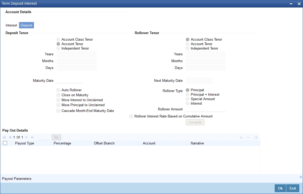

5.13 Deposit Tab (Deposit Preferences for Child TD)
Click ‘Deposit’ tab to capture deposit-related details of the child TD, if you have opted for creation of a child TD on maturity of the parent TD.
The system defaults all the parameters maintained for the parent TD in this screen. However, you can modify them.
Deposit Tenor
Select the deposit tenor type. The following options are available.
The tenor should be specified within the minimum and maximum tenor limits maintained at the account class level. The tenor months cannot be greater than 11 months and if tenor months is specified, the tenor days cannot be greater than 30 days.
Years
This indicates the number of years in the original tenor.
Months
This indicates the number of months in the original tenor.
Days
This indicates the number of days in the original tenor.
If the maturity date falls on the holiday, the system adjusts it to next working day.
Rollover Tenor
The deposit tenor has following options as below,
Years
This indicates the number of years in the rollover tenor.
Months
This indicates the number of months in the rollover tenor.
Days
This indicates the number of days in the rollover tenor.
The tenor is represented in terms of years, months and days. For example, if the deposit tenor is 185 days, it should be represented as 0 years, 6 months and 5 days. You need to specify the values in the appropriate fields.
Maturity Date
The system defaults the maturity date from the default tenor from the account class. However, you can modify this date. On this date the term deposit account gets
Auto Rollover
Check this field to automatically rollover the deposit you are maintaining. You have to indicate ‘Rollover Type’ on selecting this option
Close on Maturity
Check this box to close the term deposit account on maturity date and transfer the amount as per the pay-out details maintained for the child TD.
Move Interest to Unclaimed
Check this box to move the interest amount to the unclaimed GL mapped at the IC product in the accounting roles on grace period end date. If you select this option, you will need to check the box ‘Move Principal to Unclaimed’.
Check this box to move the principal amount to the unclaimed GL mapped at the IC product in the accounting roles and liquidate the interest amount to the interest booking account on grace period end date. If you select this option, the principal liquidation account should be the term deposit account.
Rollover interest rate based on cumulative amount
Check this box to opt for cumulation at the time of rollover.Next Maturity Date
On selecting the rollover for the TD account, the system defaults the next maturity date from the previous tenor of the deposit.
Deposit Tenor
The system calculates the tenor of the deposit account to the difference between Interest start date and Maturity date and displays it. In case of change in maturity date, the system changes the value of this field.
Rollover Type
Indicate the components that should be rolled over by choosing one of the following options:
Rollover Amount
If a special amount is to be rolled over, you have to specify the amount (less than the original deposit amount) in this field.
Payout Type
Indicate the method for initial funding during account creation.
Choose one of the following options:
Percentage
Specify the percentage of the amount that be rolled over.
Offset Branch
The system populates the branch code of the account from which fund is transferred to TD account.This field returns the branch code if the account is selected and NULL is returned if GL is selected.
Account
Specify the account number/ GL from which the fund is transferred to TD account. If it is Pay-In mode in GL then the system displays only GL’s and if the Pay-In mode is Account then only accounts are displayed in the option list.
Narrative
Specify remarks about the transaction.
5.13.1 Specifying Pay-out Parameters for Child TD
Click ‘Payout Parameters’ button on the ‘Term Deposit Interest’ screen and invoke the ‘Payout Parameters’ screen. Here you can specify pay-out preferences for the child TD.
This screen comprises two tab viz:
5.13.2 Bankers Cheque Tab (for auto pay-out of Child TD)
By default this tab is displayed on invoking the screen. You need to capture the following details in case you want to redeem the child TD using a banker’s cheque.
Cheque Details
Bank Code
Currency
Specify the currency in which the cheque is drawn.
Payable Branch
Beneficiary Details
Beneficiary Name
Passport/ IC Number
Specify the passport or IC number of the beneficiary for the pay-out.
Narrative
Beneficiary Address
5.13.3 Local Payment Tab for Child TD
Click ‘Local Payment’ tab to capture payment details if you want to redeem the child TD through a Local Payment transfer to another account.
Counterparty
Specify the account name of the counterparty for the pay-out.
Currency
Specify the currency for the pay-out.
Beneficiary Details
Beneficiary Details
Specify the details of the beneficiary
Beneficiary Name
Passport/IC Number
Specify the Passport/IC Number of the beneficiary
Narrative
Give a brief description for the payout.
Beneficiary Address
Specify the address of the beneficiary.

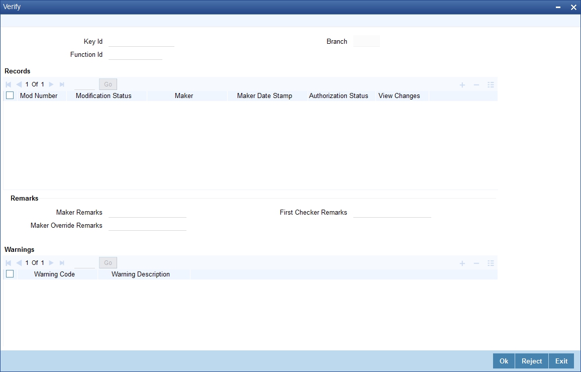

5.14 Viewing Change Log
Click ‘Change Log’ button on the ‘Deposit Account Booking’ screen and invoke the ‘View’ screen.
5.15 Interest Payout Details for Banker’s Cheque / DD and Local Payment
5.15.1 Capturing Interest Payout Details for Banker’s Cheque / DD and Local Payment
You can capture interest payout details for Banker’s Cheque / DD and PC in the ‘Term Deposit Interest Payout Details’ screen.
You can capture the following details:
Branch Code
Branch code of the current branch is defaulted here.
Account
Account number of TD is defaulted here from the main tab.
Currency
Currency code of the TD account is defaulted here.
5.15.2 Banker’s Cheque / DD Tab
On invoking the ‘Term Deposit Interest Payout Details’ screen, this tab is displayed by default. You can specify the following details:
Cheque /DD Details
You can specify the following cheque or DD details here:
Bank Code
Specify the bank code. The adjoining option list displays all the bank codes maintained in the system. You can choose the appropriate one.
Payable Branch
Specify the branch from which the interest is payable. The adjoining option list displays all the bank codes maintained in the system. You can choose the appropriate one.
Instrument Type
The system displays the instrument type.
Currency
The system displays the currency.
Beneficiary Details
You can specify the following beneficiary details here:
Beneficiary Name
Specify the beneficiary name.
Passport Number
Specify the passport number of the beneficiary.
Narrative
Enter a brief description of the beneficiary.
Beneficiary Address
Specify the beneficiary address.
5.15.3 Local Payment Tab
Click ‘PC’ tab on the ‘Term Deposit Interest Payout Details’ screen. The following screen will be displayed.
Counterparty
You can specify the following counterparty details here:
Specify the counterparty bank code. The adjoining option list displays all the counterparty bank codes maintained in the system. You can choose the appropriate one.
Specify the counterparty account. The adjoining option list displays all the counterparty bank codes maintained in the system. You can choose the appropriate one.
Currency
The system displays the instrument currency.
Beneficiary Details
Beneficiary Name
Passport Number
Narrative
Beneficiary Address
Note
The system supports the following payout options for interest payout:
If payout details are maintained for interest component then interest liquidation happens on the basis of payout details maintained for interest component. However, if payout de­tails are not maintained for interest component then interest liquidation happens on the ba­sis of interest book account specified.
If payout type is chosen as Account or GL for interest component then interest liquidation happens on the basis of offset account mentioned in the ‘Term deposit payout details’ multi grid. If payout type is chosen as Demand Draft /Banker’s Cheque or Local Payment for interest component then interest liquidation happens on the basis of payout details main­tained in the ‘Interest Payout Details’ sub screen.
Interest payout through as Demand Draft /Banker’s Cheque or Local Payment happens through the same bridge GL used for principal payout.
The system does not support payout option as Term Deposit.
Interest payout is not supported if rollover type is interest or principal and interest. For In­terest rollover type interest liquidation will be done based on the interest book account.
5.16 Viewing Rollover History Details
You can view Rollover History details in TD Rollover History screen. Click on ‘Rollover History’ to invoke this screen.
The following details are defaulted in the above screen:
For Rollover Type, P = PRINCIPAL, I = PRINCIPAL + INTEREST, T = INTEREST and S = SPECIAL AMOUNT.
Note
On rollover, the adjusted rollover tenor of the TD account is updated in the fields Tenor Years, Tenor Months and Tenor Days.
If the rollover tenor is 1 year, 5 months and 7 days, then the rollover history is updated as

5.18 Specifying Denominated Deposit Details
You can capture denominated deposits details in the ‘Denominated Deposit’ screen. To invoke this screen click the button ‘Denominated Deposit’ on ‘Deposit Account Booking’ screen.
Denomination Allocation Details
The following denomination allocation details are captured here:
Denomination ID
Specify the denomination id here. Alternatively you can also select the denomination ID from the adjoining option list. The list displays all denomination ids allowed at the account class level.
Denomination Description
This is defaulted from the account class level.
Denomination Value
Units
Specify the required units here.
Total Amount
The Total Amount which is Denomination value x Units is displayed here.
Certificate Status Query/Modification
After a deposit is opened, you can perform a query or modification on the certificate status of a deposit. Select the type of query or modification that you want to perform on the certificates from the following options:
Certificate Number
Select the certificate number from the adjoining option list for which the status has to be changed or queried on.
Denomination Value
This is defaulted from the account level.
Issue Date
The date of issuance of the certificate to the deposit is displayed here.
Current Status
The current status of the certificate is displayed here
New Status
You can select the new status of the certificate from the adjoining drop-down list. The following options are available for selection:
Note
Only valid certificate status which are allowed to be modified manually will be available in the drop down
Status Change Date
The status change date is defaulted here
Status Change Reason
Specify the reason for status change of the certificate. You can enter up to 225 characters.
Bulk Status Change
Select the appropriate bulk status change option from the drop-down list:
Note
Bulk Status Change Reason
Click ‘Populate’ button. System calculates and displays the following details:
Denomination Allocation Pending Amount
This indicates the amount for which the denomination is yet to be allocated.
Certificate Allocation Pending Amount
This indicates the amount for which the certificate is yet to be allocated.
Term Deposit Amount
This indicates the deposit amount.

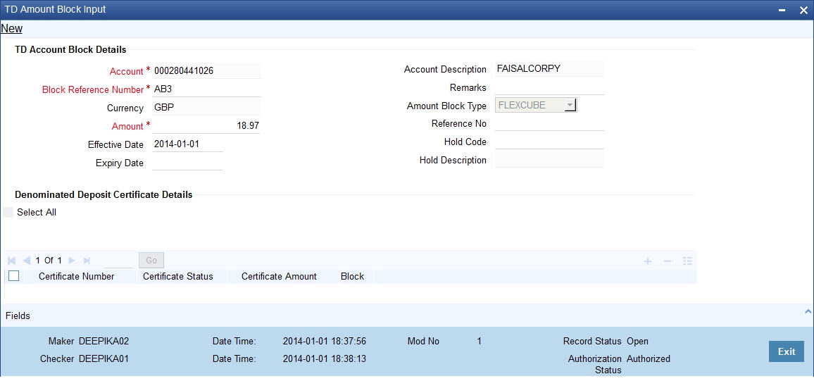

Deposit certificate statuses are available for modification as detailed below. Certain status changes are based on occurrence of events on the term deposit account.
Current Certificate Status
Action
Status of the existing certificate after the action
Status of the new certificate
Issued
Account not opened due to unsuccessful pay-in transaction
Cancelled
Amount Block to the deposit certifi­cate
Amount Blocked
Re-denomination of the certificate
Modified
Re-denominated
Redemption of the deposit ( partial or full)
Redeemed
Rollover of the deposit
Cancelled
**.In ICDBADHC screen on trying to issue new certificate with ‘Rollover Issu­ance’ as 'Y' ,then the status of the old certifi­cate will get changed as “Cancelled”. Else the previous status only will be retained.
Rollover Issue
Certificate lost /damaged
Lost/Damaged
Duplicate
Re-denomi­nated
Amount Blocked
Modified
Re-denominated
Redeemed

5.18.1 Denomination Allocation
Before allocation of the denominations the ‘denomination allocation pending amount’ and ‘term deposit amount’ will be equal and once the denominations are allocated on click on the ‘Populate’ button, the ‘Denomination Allocation Pending Amount’ field will display the difference between the Term deposit amount and the total of the total amount field (i.e. Term Deposit Amount – Total of the Total Amount field). If you fail to click the ‘Populate’ button, then on ‘Save’ the fields are updated.
There will be a validation for the ‘Denomination Allocation Pending Amount’ to be ‘Zero’ on save of the deposit. If the validation fails then system displays an error message like:
Allocation of Denomination is not done for the full term deposit amount’

5.19 Rollover Details
You can capture Rollover Details in the ‘TD Rollover Details’ screen. To invoke this screen click the button ‘Rollover Details’ on ‘Deposit Account Booking’ screen.
You can specify the following details here:
Rollover Details
Rollover Type
Select the component that should be rolled over. The options are as follows:
Note
In case of Discounted Interest, only Principal can be rolled over. The ‘Cumulative’ option is not allowed. The interest computed during deposit booking with discounted option will be paid to the interest booking account. When ‘Amount block’ option is checked at the product level, the amount block will be created on the TD account to the extent of the credited discounted interest. This amount block will use the Hold Code which has ‘Hold Type’ as Discounted TD in the ‘Hold Maintenance’ screen. This is to safeguard the bank from withdrawal of interest by the customer. The amount block created automatically by the system can be manually removed in case of premature closure. Closure is allowed on the amount blocks manually and amendment of these amount blocks is not allowed. TD amount blocks will be available in the ‘Amount Block Input’ screen.
Note
If 'Close on Maturity' option is checked and there is an amount of TD blocked, then the TD will be forcibly rolled over on the maturity date. However, the maturity instruction on the TD account will not be altered.
Rollover Amount
Specify the special amount to be rolled over.
Add Funds
Check this box to add additional funds for rollover.
Add Amount
Specify the additional amount to be considered for rollover in TD account currency.
Note
'For Rollover Type, ‘Special Amount’, ‘Add Funds’ and ‘Add Amount’ fields will be auto populated.
Rollover Tenor
Select the rollover tenor for the TD account. This is mandatory if ‘Auto Rollover’ box is checked. The options are as follows:
The default account class tenor is displayed as tenor in days, months and years which you cannot change. However, you can change the default option during rollover. When you save it, the system displays an override message ‘Re-pick account class tenor on rollover restrictions exists at account class’.
If ‘Re-pick up Account Class Tenor on Rollover’ is checked at the account class level, then by default, this option is selected. If you select this option, then the following are applicable:
On rollover, the system displays the original tenor of the TD in terms of days, months and years. However, you can change the default option during rollover. When you save it, the system displays an override message ‘Re-pick account class tenor on rollover restrictions exists at account class’. If ‘Re-pick up Account Class Tenor on Rollover’ is unchecked at the account class level, then by default, this option is selected. If you select this option, then the following are applicable:
The tenor should be specified within the minimum and maximum tenor limits maintained at the account class level. If it is not within the minimum and maximum limit, then the system will display an error message "Rollover tenor does not fall in the range of minimum and maximum tenor allowed”. The rollover tenor for independent tenor should not be null.
On save, system updates the ‘Next Maturity Date’ accordingly.
Note
System validates that the rollover tenor is within the minimum and maximum tenor allowed for the account class. If this validation fails, then system displays the error message, “Roll­over tenor does not fall in the range of minimum and maximum tenor allowed”.
The next maturity date will be adjusted based on the holiday treatment at account class level. The tenor in ICDREDMN screen will remain the same after holiday adjustment. On query from STDCUSTD after rollover, Deposit tenor will be populated with the holiday ad­justed tenor and original tenor with the actual tenor before holiday adjustment.
Years
Specify the number of years in the rollover tenor.
Months
Specify the number of months in the rollover tenor.
Days
Specify the number of days in the rollover tenor.
Rollover Interest Based on Cumulative Amount
Check this box to arrive at the rollover interest rate of a new deposit using the cumulative amount of other active deposits, under the same account class and currency.
Note
Payin Details
Select the Payin Details for debiting the additonal amount for rollover from the drop down list. The list displays the following values:
If the offset account provided has limits attached, then on save the system will display a mes
sage as “The limits/Collateral attached is used for Payin.”
Percentage
Specify the percentage of payout for each payout option specified.
Amount
Specify the amount to be transferred to TD.
Offset Branch
The system displays the branch code of the account to which fund is transferred from TD account.
Offset Account
Specify the account number/ GL from which the fund is transferred to TD account on rollover. This field will return the branch code if the account is selected and NULL will be returned if GL is selected. If pay-out mode is GL then the system displays only GLs in the option list.
Note
5.20 Maintaining Amount Blocks
Oracle FLEXCUBE allows you to facilitate creation of manual amount blocks and closure of the same for TD accounts. You can maintain the amount blocks using ‘Amount Block Input’ screen. To invoke this screen type ‘STDAMBLK’ in the field at the top right corner of the Application tool bar and click the adjoining arrow button.
Account
Specify the TD account that needs to be blocked. The adjoining option list displays all active, open and authorized TD accounts that are available for blocking.
To view the joint holder’s details of an account and the mode of operation maintained at the account level, place the cursor on the Account field and press Ctrl+J. The system displays the ‘Joint Holder’ screen.
For more information on the ‘Joint Holder’ screen refer to the section ‘Joint Holder Maintenance’ in the Core User Manual.
Account Description
The system displays the description of the specified account number based on the details maintained at 'Deposit Booking' screen.
Currency
System defaults the currency of the specified account.
Amount
Specify the amount details. The amount to be blocked cannot be greater than the available balance in TD account.
Amount Block Type
Select the type of amount block from the drop-down list. Following are the options available in the drop-down list:
Note
The amount block type should always be 'FLEXCUBE' for the manually blocked amounts. From front end, the system will not allow you to create, modify or close a record which has 'Amount Block Type' as 'Loan'.
Auto deposits created under the Auto Deposit account class (mapped in CASA account class -> Auto Deposit subsystem -> Account class field) cannot be blocked using this screen. However, deposit created manually under this Auto Deposit account class in STDCUSTD can be blocked.
Amendment of block amount not supported for Discounted Deposits and Mudarabah Sweep Deposit.
Hold Code
Specify the hold code. The hold codes are maintained in the 'Hold Maintenance' screen. Specify the reason for amount block here. In case of discounted TDs, the hold code and description will be automatically defaulted.
Amount Block Number
The system displays the amount block number when the new operation is initiated.
Effective Date
Specify the effective date from when the block becomes effective. The effective date can be current / future dated. If you do not specify the effective date, system defaults the current date here.
Expiry Date
Specify the expiry date. If you do not specify the expiry date, on save, system defaults the current date here. The block will be released on EOTI of the specified expiry date.
The record status will remain as open until the block record is closed. This is irrespective of amount block expiry; however, you cannot modify the amount block after the expiry date.
Reference Number
Specify the reference number.
Hold Description
The system displays the description for the hold code specified.
Remarks
Specify remarks, if any.
Denominated Deposit Certificate Details
Amount blocking of a denominated certificates can be done using ‘TD Amount Block Input’ screen. In case of manual TD amount block, you can designate the denominated certificates supporting the block. Once a certificate is designated for block, the status of the certificate will be modified to 'Amount Blocked' from issued, re-denominated, rollover issue or duplicate status automatically.
Specify the following details for capturing amount block details for denominated deposit certificates:
Select All
Check this box to select all certificates for the account.
Certificate Number
Select the certificate number from the option list. The list displays all active certificates issued for the account.
Certificate Status
This indicates the current status of the certificate selected.
Certificate Amount
This indicates the amount of the certificate.
Block
Check this box to block a certificate.

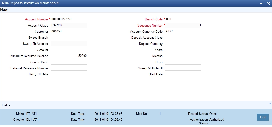

5.21 Deposit Instructions
5.21.1 Specifying Deposit Instructions
You can give instructions for processing auto created deposits. The values you specify here will override the parameters you have maintained in the Account Class maintenance.
Invoke the ‘Term Deposits Instruction Maintenance’ screen from the Application Browser to maintain the deposits instructions specifically for the auto created deposits. Type ‘ICDINSMT’ in the field at the top right corner of the Application tool bar and click the adjoining arrow button.
You can set the terms and a condition for a deposit as follows:
Account Number
Specify the account number of the term deposit. The adjoining option list displays all valid TD accounts maintained in the system. You can select the appropriate one.
Account Class
The system defaults account class of the CASA account.
Customer
The system defaults the customer of the CASA account.
Sweep Branch
Specify the branch where the sweep-to account resides. The adjoining option list displays all valid branch codes maintained in the system. You can select the appropriate one.
Sweep to Account
Specify the account to which the sweep is carried out. The adjoining option list displays all valid accounts maintained in the sweep to branch. You can select the appropriate one.
Amount
Specify the amount which to be swept to 'Sweep To Account'.
Minimum Required Balance
Specify the minimum balance required for creation of auto deposit. Only the amount above this limit will be used for auto creating deposits.
Source Code
Specify a code assigned for the sweep.
External Reference Number
The system displays the identification number of the transaction in the source system.
Branch Code
The system displays the branch code of the branch where the TD account resides.
Sequence Number
The system generates a sequence number for the instruction you are maintaining and displays it here.
Account Currency Code
The system defaults the CASA account currency.
Deposit Account Class
The system defaults the Default Auto deposit account class specified in CASA account class. However, you can modify, if needed. The adjoining option list displays all active ,authorized and allowed list of auto deposit account classes specified in CASA account class. Select the appropriate one.
Deposit Currency
Specify the currency in which the auto deposit should be created. The adjoining option list displays all valid currency codes maintained for auto deposit account classes which are active and authorized. You can select the appropriate one. If you want to restrict auto deposit in account level, delete the defaulted AD account class and save the account.
Tenor
The system displays the default tenor maintained for the linked account class in terms of Years, Months, and Days.
Sweep Multiple of
Indicate the number in multiples of which the sweep should be carried out.
Start Date
Indicate the date from which instructions should be valid, using the adjoining calendar.
Retry Till Date
Indicate the date post which the instructions will be rendered invalid. Any failed sweeps after this date will not be picked up for processing the next day.
While saving term deposit instructions;

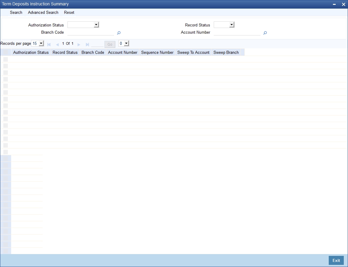

You can view summary of all instructions using the ‘Term Deposits Instruction Summary’ screen. To invoke this screen, type ‘ICSINSMT’ in the field at the top right corner of the Application tool bar and click the adjoining arrow button.
You can query on records based on any one or all of the following criteria:
Click ‘Search’ button. The system identifies all records satisfying the specified criteria and displays the following details for each one of them:
Double click on a record to invoke the detailed screen for that record.
