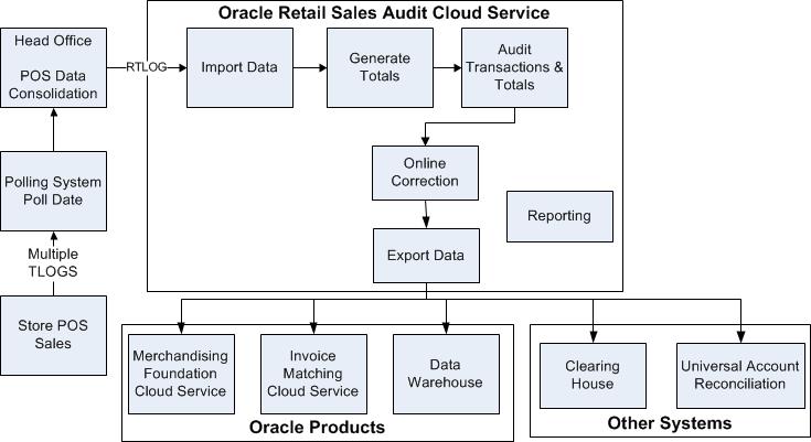

Automatic auditing is done in Sales Audit Cloud Service using batch programs. The goal of the automatic audit process is to accept transaction data from point-of-sale (POS/OMS) applications and move the data through a series of processes that culminate in clean data. Sales Audit Cloud Service uses several batch-processing modules to perform the following activities:
Import POS/OMS transaction data from the RTLog.
Perform initial validation of data during upload of data from the RTLog to Sales Audit Cloud Service.
Produce totals using user-defined totaling calculation rules that are user reviewable during the interactive audit.
Validate transaction and total data with user-defined audit rules and generate errors whenever data does not meet the criteria. The user reviews these errors during the interactive audit.
Create and export files of clean data in formats suitable for transfer to other applications.
Update the Sales Audit Cloud Service database with adjustments received from external systems on previously exported data.

Oracle Retail Sales Audit Cloud Service interfaces with the following Oracle products:
Oracle Retail Merchandising Foundation Cloud Service
Store Inventory Management Cloud Service
Oracle Retail Invoice Matching Cloud Service
Oracle Retail Insights Cloud Service
This figure displays the Sales Audit interfacing products:
Oracle Retail Sales Audit Cloud Service also interfaces with the following third-party applications:
Automated Clearing House.
Universal Account Reconciliation System.
Sales Audit Cloud Service and Merchandising Foundation Cloud Service share the same database. Sales Audit Cloud Service shares some of its master data with Merchandising Foundation Cloud Service data such as items, stores, company/location close dates, location traits, bank setup, and tender types are maintained in Merchandising Foundation Cloud Service and used in Sales Audit Cloud Service.
