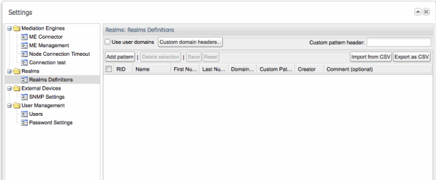

To add a pattern that defines a realm, click the Add pattern button. A new row appears at the top of the table. The pattern is editable by double clicking on the row.
Name: The name of the realm that defines a reseller.
First Number: The lower limit of the telephone numbers range.
Last Number: The higher limit of the telephone numbers range.
Domain: The domain name. The field is optional as the realm might be identified only by number range.
Comment: An optional comment line, only for convenience.
To delete a selected pattern, click Delete selection. You can import and export realm configuration to and from CSV files, which helps in maintaining the realm configuration when many patterns have been defined.
You may also provision realm patterns automatically by uploading a similar CSV file via FTP.
Realms definition
