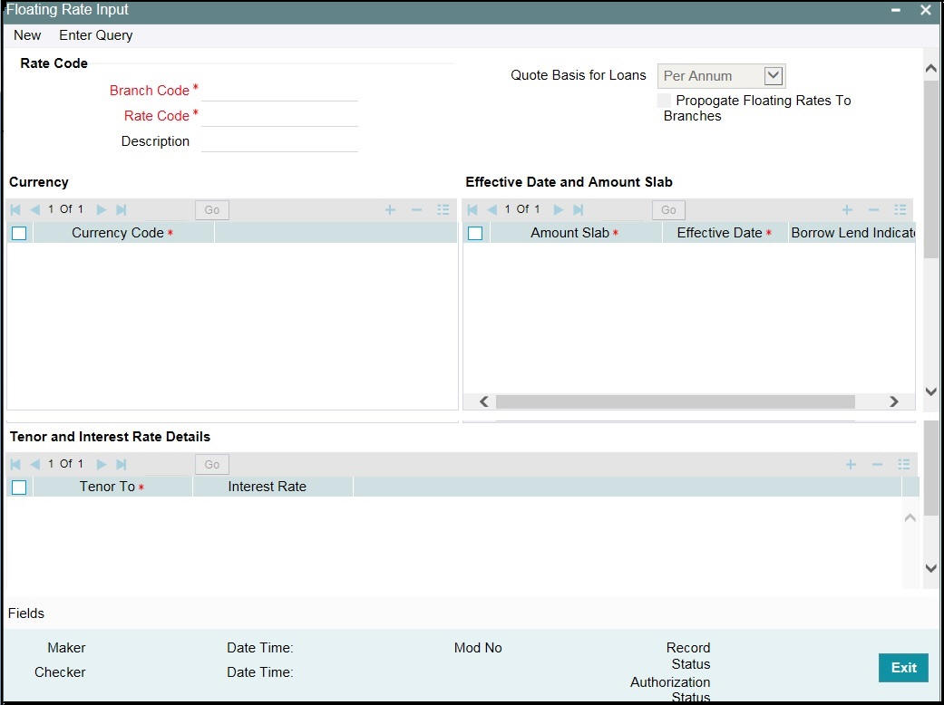

2.2 Applying Floating Interest Rate
The Interest Rate Type of a product can be one of the following:
A Floating Rate corresponds to the market rates for the day. These rates are maintained and updated daily (or whenever they change,) in the Floating Rates Table. The rates can be applied on a contract with or without a spread.
You can invoke the ‘Floating Rate Input’ screen by typing ‘CFDFLTRI’ in the field at the top right corner of the Application tool bar and clicking the adjoining arrow button.
The floating interest rates are defined through this screen.
2.2.1 Capturing Rate Code Details
Each Rate Code is associated with a currency. You can define rates for the same Rate Code in different currencies.
A Rate Code identifies a set of rates defined for a combination of Currency, Amount Limit (optional) and Effective Date. When processing a contract initiation, you should link it to the Floating Rate Table by indicating the Rate Code. The rates defined for the Rate Code are applied on the contract.
Propagate Floating Rates To Branches
Select this option to indicate that the rate code should be available across all branches.
2.2.2 Capturing Currency Details
2.2.3 Specifying Effective Date and Amount Slab Details

2.2.4 Tenor and Interest Rate Details
The rates that are applied for a given combination of Amount Limit – Effective date – Lend/Borrow Indication can be tenor based. In the table, you can define the interest rates for different tenors. The rate that is applied to a contract is based on the interest parameters specified in the ‘Interest Class Maintenance’ sub -screen of the ‘Loans and Commitment Product Definition’ screen.
The index rate code which was picked up to derive the resultant composite rate is stored as ‘Picked Up Rate Code’ for the effective date, which has the reset tenor zero.
The rates picked for the index rate codes are for the maximum amount maintained in the amount slab. The composite rate rebuilt is stored with the amount slab as “999,999,999,999.00”. After applying the additional rate (specifically when the additional rate indicator is ‘-‘), if the resultant rate becomes –ve, then it is considered as 0 as –ve rate is not allowed.

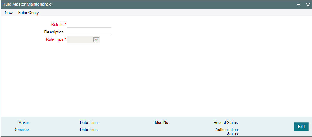

2.3.1 Rule Master Definition screen
You can invoke the ‘Rule Master Definition’ screen by typing ‘LFDRLAVL’ in the field at the top right corner of the Application tool bar and clicking the adjoining arrow button.
Rule ID and Description
Each Interest Rule is defined by a four-character code, called the Rule ID. Attributes are defined for this Rule ID, which is then linked to a product. When a contract is processed, the interest attributes defined for the Rule ID linked to the product is applied on the contract, some of which can be changed.
Rule Type
The Rule Type identifies the type of ICCF component you are defining. In this case it is Interest. The attributes applicable for a component depends on its Rule Type.
For example, you can define any component that is tenor based − an annual fee, for example - as a component of Rule Type Interest. If INTEREST1 is your main interest, your annual fee can be defined as INTEREST2, as it is tenor based. Only on an Interest type of component, you can have the floating rates.

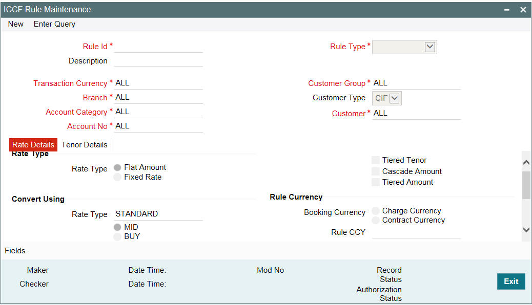

2.3.2 ICCF Rule Maintenance
You can invoke the ‘ICCF Rule Maintenance’ screen by typing ‘LFDRUMNT’ in the field at the top right corner of the Application tool bar and clicking the adjoining arrow button.
Rule ID
Specify the valid interest ‘Rule ID’ to the interest classes that you maintain in your bank. The adjoining option list displays the list of all rule IDs available in the system. You can select the appropriate one. These rule IDs are fetched from 'Rule Master Definition' screen.
Rule Description
The ‘Rule Description’ appears based on the rule id.
Rule Type The ‘Rule Type’ ‘Interest’, Charges/Fees, ‘Tax’ are defaulted from the 'Rule Master Definition' screen. You cannot change the rule type.
Specifying Rate Type
The Rate Type indicates whether the rate to be applied for the Rule ID is a flat amount or a percentage of the contract amount. The specific rates and amounts applicable have to be specified in subsequently through this screen. These rates or amounts can be changed during contract processing.
Specifying Rate Code for Foreign Currency
You can choose the rate code as ‘Mid’, ‘Buy’ or ‘Sell’ only when the basis amount currency and the rate currency is different from the contract currency. The rate code is used to arrive at the exchange rate if the rate currency is different from the contract currency.

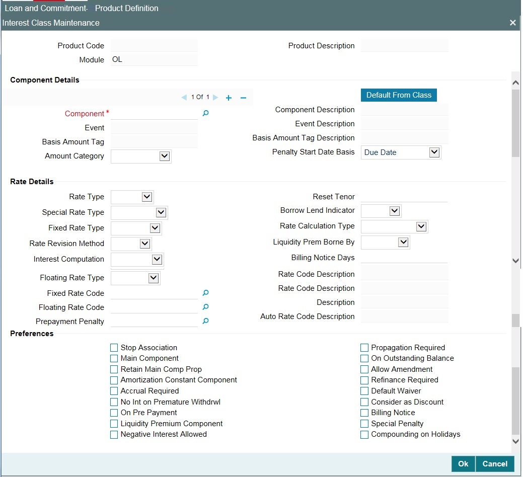

2.4 Defining Interest Details
You can specify the interest components applicable to a product in the Interest Class Maintenance’ sub -screen of the ‘Loans and Commitment Product Definition’ screen.
From the Loans and Commitment Product Definition screen (OLDPRMNT), click ‘Interest’ to access ‘Interest Class Maintenance’ sub-screen.
You should necessarily use an interest class that you have created, to indicate the interest components applicable to the product. An interest class is a specific type of interest component that you can build with certain attributes.
Associating an interest class with a product
  1. Select the appropriate Interest class from the list of classes, defined specifically for the Loans module of Oracle Lending.
  2. To associate an interest class with a loan product, click ‘Default From Class’ in the ‘Interest Class Maintenance’ sub-screen.
The attributes defined for the interest class defaults to the product. You have the option to modify the attributes defined for the class, to suit the requirement of the product you are creating.
Associating several interest classes with a product
You can associate several interest classes with a product.
  1. To add to the list of classes associated with the product, click ‘Add row’ button.
  2. Click ‘Default From Class’ and select a class from the option list that is displayed.
To navigate between the classes associated with a product, you can use the arrow icons that are provided.
To disassociate a class from the product, navigate to the class using the arrow icons described above and click ‘Delete row’ button.
For an interest class, you can define the following:
Dissociating an Interest class from a product
The interest classes defined for a product is automatically applied to all contracts involving the product. If, for some reason, you want to stop applying a particular interest class to new contracts that are initiated (involving the product), you can do so by selecting the ‘Stop Association’ check box.
In effect, stopping the application of an interest class component for a product would be equivalent to deleting the class from the product. By specifying that the application of a class should be stopped, you have the advantage of using the definition made for the class again. To do this, you have to deselect ‘Stop Association’ check box . Contracts that are subsequently initiated picks up the class.

Specifying whether Interest is to be accrued
For a product, you should specify whether accruals have to be carried out for the accruable components. If yes, the frequency of accruals (daily, monthly, quarterly, half-yearly or annually) should be specified for each product (through the ‘Loans and Commitment Product Definition Preferences’ screen).
The accruals are carried out at the specified frequency by the Automatic Contract Update function. In addition, accruals are done whenever an event (like a rate change with a Value Date, a payment, and so on.) is triggered as of a date beyond the date on which the last accruals were carried out.
Specifying the penalty start day
Oracle Lending calculates the penalty in case the loan payment is not made on the schedule date. However, if the payment date falls on a holiday, the penalty can be calculated depending on the start date that you specify in this screen:.
If you have specified that penalty start date basis as the due date, the penalty is calculated from the due date of payment even if it falls on a holiday.
If you have specified that the penalty start basis be next working day, the penalty is calculated from the working day following the holiday. Thus, the system l waives the penalty for the holiday (s).
The ‘Penalty Start Date Basis’ specifications you maintain for the Interest Class is defaulted here and the system does not allow you to change these options.
Example
Assume a loan principal payment schedule falls on 11th October 2003, which is maintained as a holiday in Oracle Lending. In addition, there is a deficit of funds in the customer’s account for making the payment.
If you have selected the due date option, Oracle Lending calculates the penalty from 11th October 2003.
If you have selected the next working day option, the system calculates the penalty from 13th October 2003 and waives the penalty for 11th and 12th October.
Rate Type - The Rate Type indicates whether the interest is a Fixed Rate, a Floating Rate or a Special amount. When creating a product, you should specify the Rate Type based on which interest is computed.
Floating Rate Code - If the Interest Rate Type has been specified as Floating, indicate the Rate Code to which the product has to be linked. The Rate Code corresponds to the rates, defined in the Floating Rates table, that have to be applied for the product. A Rate Code identifies a set of rates defined for a combination of Currency, Amount (if it is necessary) and an Effective Date.
Select the Rate Code applicable for the product you are defining from the option-list provided. The Rate Code can be changed during contract processing.
Floating Rate Type - In addition, you should specify the method in which the rates in the Floating Rates table have to be applied on the loan. It could either be automatic application (meaning the rate has to be applied every time it changes), or periodic application (meaning the rate has to be applied at a regular frequency, defined for each contract involving the product).
Borrow Lend Ind - For floating rate interest, you should also indicate if the interest rate for a given rate code to be applied, from the Floating Rates table, is the Borrow rate, Lend rate or Mid rate.
Reset Tenor - If interest rates are defined for the tenor of a contract, you should specify the Reset tenor. This will indicate the tenor for which the floating rate (when applied automatically) needs to be picked up from the Floating Rates Table, for contracts using this product.
Rate Calc Type - Interest rates based on the tenor of a contract could be applied in any of the following ways:
Example
The Floating Rates table has the following tenor-based interest rate definitions:
Tenor
Interest Rate
5
12%
15
16%
The tenor of the contract to be processed is 9 days. This falls between the 5 day and 15 day slabs for which interest rates are defined in the table.
Depending on the Rate Cycle Type specified, the interest rate for 9 days are applied as follows:
You can specify the various floating rate parameters explained above for a fixed rate type of interest. The appropriate floating rate is then applied at the beginning of the contract, however, this rate is subsequently remain fixed during the contract.
Fixed Rate Type - If the rate type is ‘Fixed’, you have to indicate whether the rate would be entered by the user or needs to be picked up from the rate maintenance table. The following options are available:
For more details, refer the section titled ‘Identifying products for agency contract creation’ in the ‘Defining the Attributes specific to a Loan product’ chapter of the Bilateral Loans User Manual.
Interest Computation - You have to specify the method to be used for computation of interest. The available options are:
Compounding on holidays - You can opt to compound interest on holidays. Select the ‘Compounding on Holidays’ option to indicate the same.
The ‘Interest Computation’ and ‘Compounding on Holidays’ options are available only for Loan and Commitments products. These options can be specified only for a product. You cannot change them at the contract level.
The example given below explains the method used for compounded interest calculation:
Assume that you have a Normal-Bearing contract with the following details:
Further, the contract has Interest and Principal payment as bullet schedules.
Case 1:

Fixed Rate Code - You would have maintained several Standard rate codes in the ‘Standard rate code maintenance’ screen. Subsequently, you would have also maintained the rates for each of these codes in the ‘Standard Rate Maintenance’ screen.
If you select the Fixed Rate Type as ‘Standard’, you have to select the appropriate rate code from the option-list provided. The Standard rates maintained for the selected rate code will be applicable on all contracts processed under the product being maintained.
Prepayment Penalty Rate Code - Likewise, select the rate code based on which the system will pick-up the prepayment penalty rate for all contracts under the product.
Specifying the prepayment details
Waiving interest on premature withdrawal - You can opt to waive Interest on premature withdrawal of the loan. Select the ‘No interest on premature withdrawal’ option to indicate that interest needs to be waived if premature withdrawal (partial of full) is done for the loan.
Reapplying Interest rate on prepayment – If the ‘Fixed’ rate type is ‘Standard’, you can opt to reapply interest when a prepayment is made.
You can reapply interest on one of the following:
Specifying the Rule ID
You can link a rule to a product. In the Product ICCF Details screen, in the Rule ID field, pick the rule you want to link to the product. For an interest type of rule, all the interest-related details have to be specified in the Product ICCF Details screen.
Specifying the Settlement Currency
The Settlement Currency is the currency in which the interest amount will be calculated. The interest amount applicable for a contract will be calculated in this currency. The appropriate conversion rate (defined for the product as the applicable Rate Type) will be applied to carry out a conversion if the repayment account is in a different currency.
Specifying whether Interest Details can be amended
A change to a contract (after it has been authorized) that involves a change in its financial details constitutes an Amendment on the contract. You can indicate whether such an Amendment, called a Value Dated Change, should be allowed for the interest component being defined.
You can amend the following through this function:
To amend a contract, you have to invoke the contract, ICCF Details’ screen of the ICCF module through the Value Dated Changes function.
Specifying whether refinancing is required
While creating a loan product, you have the option of indicating whether the accruals/liquidations involving a particular component should be tracked for refinancing. Select the check box positioned next to this field to indicate that Refinancing is required
Specifying the original component
If you enable the ‘Refinancing Required’ option, you have to identify the original component for the refinance component.
Enabling the Consider as Discount option
While defining an interest component for either the loans or the bills module, you can indicate whether the interest component is to be considered for discount accrual on a constant yield basis.
The consider as discount option is available for
The value of this field is defaulted from the ‘Interest Class Maintenance’ screen. However you can change it over here.
For Bearing contracts, if the option ‘Consider as Discount’ is checked then the option ‘Accrual Required’ also has to be checked. If the option ‘Accrual Required’ is not checked, the option ‘Consider as Discount’ is disabled.
For Discounted contracts, you can select either one of the options or both together. If the options ‘Accrual Required’ and ‘Consider as Discount’ are selected then discounted interest is considered for IRR calculation. If the option ‘Accrual Required’ is not selected and ‘Consider as Discount’ is selected, then discounted interest is considered a part of the total discount to be accrued.
If neither option is selected, the interest is directly recognized as income during interest liquidation.
Note
This option is not available if the amount category is Penalty.
Enabling Negative Interest Allowed option
Negative Interest Allowed is added at interest class level which is applicable for main interest classes of OL module. Following are the important functionalities of the ‘Negative Interest Allowed’ option.
Note
Net Negative Interest
The ’Net Negative Interest ‘ check box is available in the ‘Product Preferences’ screen.
If this check box is selected, then during interest liquidation, the system internally nets the positive and the negative amounts being paid to the customer.
This check box is only for products with negative interest allowed is selected for main component.

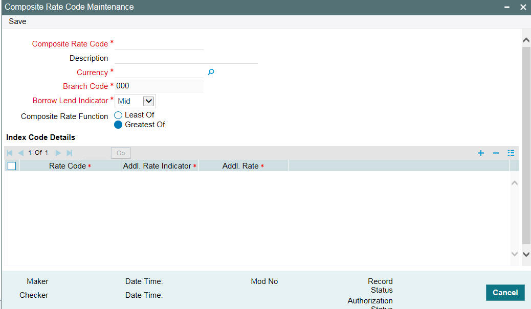

2.5.1 Maintaining Composite Rate Codes
You can maintain the composite rate code from the head office using ‘Composite Rate Code Maintenance’ screen.
You can access this screen by typing ‘OLDCMPMT’ in the field at the top right corner of the Application tool bar and clicking the adjoining arrow button.
Specify the following details here:
Composite Rate Code
Specify the code you want to maintain for the composite rate.
Description
Specify a small description for the composite rate code.
Currency
Select the currency for which the composite rate code is maintained.
Branch Code
Select the branch for which the composite rate code is maintained.
Rate Function
Select if the composite rate should be the least or greatest of the rates maintained plus the additional rate for the rate codes.
Following index code details are populated here:

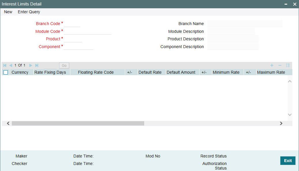

2.5.2 Specifying limits for Interest Rate Application
You can maintain tenor based, currency-wise interest limits for a combination of Product and Interest Component through the ‘Interest Limits Detail’ screen. You can access this screen by typing ‘OLDINTLM’ in the field at the top right corner of the Application tool bar and clicking the adjoining arrow button.
When an interest class for which currency-wise interest limits have been maintained is associated with a Loans product (in the Interest Class Maintenance’ screen), the product inherits the limits, by default. Such default limits can be modified if required, when the interest limits for the product and branch combination are maintained, in the ‘Interest Limits Detail’ screen.
This maintenance would be applicable for all contracts for which:
You can maintain the following information to set up the tenor-based, currency-wise interest limits for a product, interest component, and branch combination:

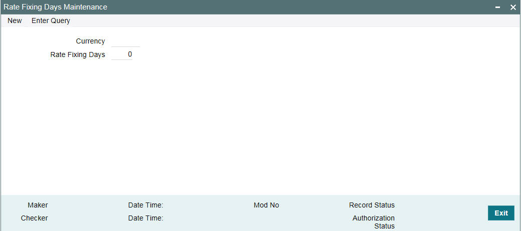

Capturing the Rate Fixing Days
The rate fixing days gets defaulted from the ‘Rate Fixing Days Maintenance’ screen. This is a numeric field. The system checks for the following:

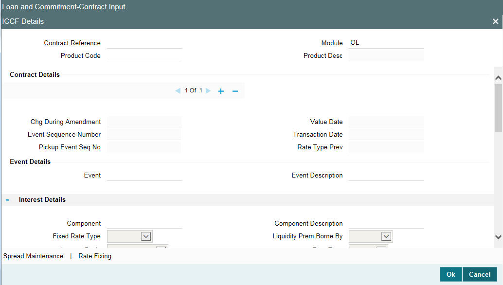

2.6 Specifying Interest Details for a Contract
When the details of a contract are captured, the interest details defined for the product involved are automatically be applied on the contract. However, you can change certain attributes.
At the time of processing the contract, you can change the following attributes:
From the ’Loan and Commitment- Contract Input’ screen, click ‘ICCF’ to access the contract ‘ICCF Details’ screen.
It is possible to define more than one interest component. You can have several interest components, which you link to a product. The contract involving the product, in turn, will be linked to these interest rules.
Example
There can be one interest rule for the main interest (for example, 14%). You can have a tenor-based commission defined as an interest rule for the same product (for example, 3%). Both these are applicable to the contract.
In the contract ‘ICCF Details’ screen use the set of two buttons to go to the next or previous that has been linked.

Choosing Revision Method
Select the revision method option for the periodic floating type of loans from the list of option provided:
While defining an interest class for either the loans or the bills module, you can indicate whether the interest component is to be considered for discount accrual on a constant yield basis.
The value for this field is defaulted from the Interest Definition and it can be changed here.
If ‘Accrual Required’ option is not selected then ‘Consider as Discount’ option is disabled for Bearing Contracts.
If you select this option the interest received against the component is used in the computation of the constant yield and subsequently amortized over the tenor of the associated contract.
Note
You are allowed to enable the Consider as Discount option for loans only when the pay­ment method specified is Discounted or True Discounted and for the Discount operation for Export bills.
For bearing type of contracts, all future interest cash flows are considered for computation of constant yield. For discount type of contracts, only the interest amount received for the components with the ‘Consider as Discount’ option enabled are considered for the computation of constant yield; subsequently the interest amount received in advance for these components is amortized over the tenor of the associated contract.
Specifying whether the Interest Component is to be accrued
While defining an interest class for either the loans or the bills module, you can indicate whether the interest component is required to be accrued.
The value for this field is also defaulted from the ‘Interest Class Maintenance’ screen. However, you can change it here.
Note
If both ‘Consider as Discount’ and ‘Accrual Required’ fields have not been enabled for the product, you cannot enable these for contracts.
If the ‘Special Penalty Component’ check box is selected for a component, then system deselects the ‘Accrual Required’ box for such components and disable it.
System automatically checks this box for late payment charge components (based on the maintenance done in ‘Interest Class Maintenance’ screen) and you cannot modify it.

2.6.1 Capturing Rate Fixing
You can fix the rate of interest for floating periodic manual type of loans while contract booking. Click ‘Rate Fixing’ button in the ‘ICCF Details’ screen, the ‘Manual Rate Revision’ screen gets displayed.
You can specify the periodic rate manually here.
The following details in the screen are displayed from the parent screen:
Reset Value Date
Specify the effective date from which the rate should be applicable for the contract.
Next Reset Date
Specify the end date of rate effective end date. The last effective date of the rate entered here.
Rate
The interest rate applicable for Main Interest Component is defaulted from previous period. However you can edit it.
Spread
The spread rate applicable for the Main Interest Component (User Input) is from the previous period. However you can edit it.
Final Rate, the net rate applicable for the Contract (Rate + Spread) gets displayed here.
Note
Current Reset Date is populated as Value date of the contract for both current dated and back valued contracts.
You can perform following operations in the ‘Manual Rate Revision’ screen:
2.6.2 Capturing Rate Fixing Days
The loan index rates (Base rates) are loaded to the system always with effective date. This means that rates upload date is same as effective date at the rates data store. Index rates available today to upload in to the system is the effective date same as today. The rates are uploaded always at the HO branch and subsequently these rates are propagated to all the transaction branches.
Whenever rate derivation is done in OBCL, the system considers the index rates as of value date prior to rate fixing days, therefore it is referred as ‘Rate Fixing Days’.
For example, if you book a contract today but you need index rate prior to 3 days, then you can mention “=3” in ‘Rate Fixing Days’. Then the system considers 3 days prior index rate.
In case index rates are not available in the system, then an error message is displayed.
OBCL does not allow EOD process when index rates are not available for a day and there are any rate exceptions that need to be reprocessed.
For bilateral loans, rate fixing is applicable during the following life cycle of a loan.
You can invoke the ‘Rate Fixing Days Maintenance’ screen by typing ‘OLDCCYRF’ in the field at the top right corner of the Application tool bar and clicking the adjoining arrow button.
Specify the following:
Currency
Enter the currency. You can maintain rate fixing days for each currency. The currency details are defined in the Currency Details screens (‘CYDCDEFE’).
Rate Fixing Days
Enter the rate fixing days. The rate fixing days must be greater than zero and not greater than 5 days.
