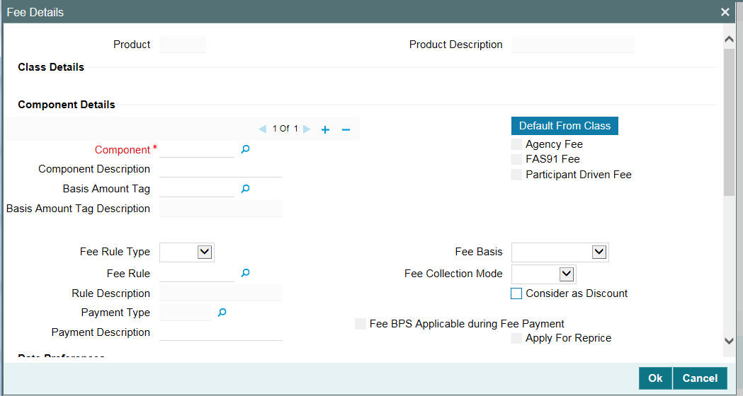

6.2.1 Associating the Component with the Product
After defining a fee component, you need to link the fee component to a product in Oracle Lending. Consequently, you can collect and accrue fees on all contracts associated with that product.
Click ’Fee’ n the Product Definition screen to invoke this screen.
Click ‘Add Row’ to add fee components. Click ‘Default From Class’ to associate the required fee component with the product. System defaults the parameters of the selected fee component. However, you can change the parameters according to your requirements.

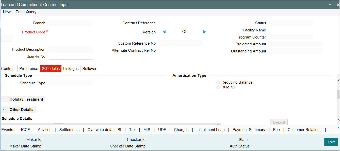

You can invoke ‘Fee Rule Maintenance’ screen by clicking ‘Fee Rule’ from the ‘Loan and Commitment- Contract Input’ (OLDTRONL) screen. You can define the slab ranges and the fee amount or rate for each slab for each of the fee components like ‘Loan Fee’ and ‘Commitment Fee’.
6.3.2 Associating Fee at Contract Level
You can associate the fee by clicking the ‘Fee’ button in the Loan and Commitment- Contract Input’ (OLDTRONL) screen.
For more information on contract details, refer to Disbursing a Loan chapter in this User Manual.

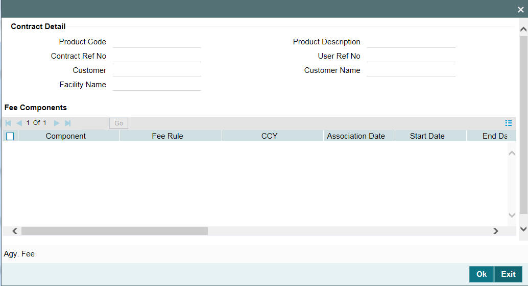

On clicking the ‘Fee’, the ‘Fee Component’ screen is displayed.
Here, the system defaults the loan fee, unused fee and commitment fee components which are maintained at the product level with which this contract is associated.
The system defaults the following details:

6.5.2 Associating the Accrual Fee Component
Click ‘Accrual Fee Details’ in the ‘Product Definition’ screen to invoke the ‘Accrual Fee Input’ screen.
Click ‘Add row’ to add fee components. Click ‘Default From Class’ to associate the required fee component with the product. System defaults the parameters of the selected fee component. However, you can change the parameters according to your requirements.
You need to specify the following details:
Accrual Method
Specify the accrual method from the adjoining drop-down list. This list displays the following values:
Basis Amount
Select the basis amount on which the fee component should be calculated from the adjoining drop-down list. This list displays the following values:
Fee Type
Specify the fee type from the adjoining drop-down list. This list displays the following values:
Payment Method
Allow Method Amendment
Select this check box to indicate that the amendment method is allowed for the accrual fee component.
Allow End Date input
Select this check box to indicate that the fee component (if applicable for the product involved in the contract) cease to be associated with a contract on the contract ‘End Date.
CLP Buy Price Diff
Select this check box to indicate that the difference between the PAR price (100%) and actual buy price is booked as fee against that component.
Note
Asset Transfer Marks
Select this option to indicate that the amortization fee component is of the asset transfer marks type. This is defaulted to the component level when details of the amortization fee are being entered.
Accrual Required
You have the option to accrue the fee earned on syndication contracts. To do this, you have to check this option.
Consider as Discount
Select this check box to indicate that the discount accrual to the component is applied.
Deferred Interest Component
Select this check box to indicate that this component should represent deferred interest. When the loan status changes to ‘Performing’ from ‘Non-performing’, the system checks the value of the backend parameter ‘ALLOW_REPERFORMING_LOAN_FUNC’. If the value of this parameter is ‘Y’, the system performs memo interest reversal. Amortization fee liquidation is done on deferred fee interest component for the memo interest amount that is moved to Real GL as part of the reversal.
Note that you can maintain only one deferred interest component for a product.
