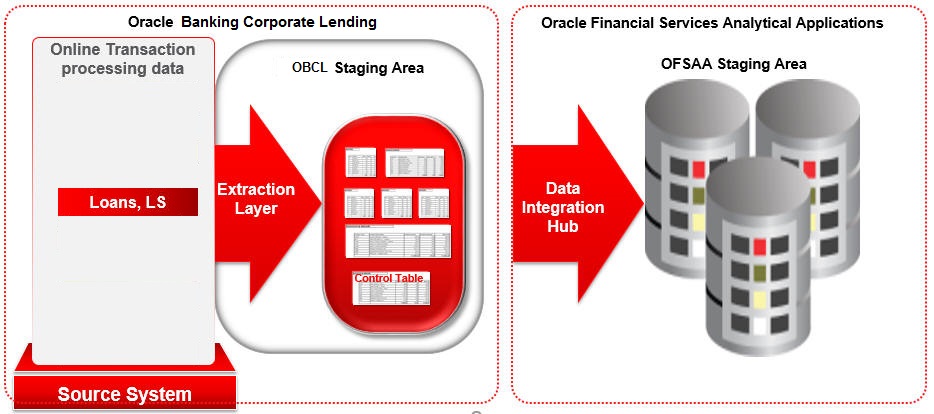

The following diagram provides information on the integration architecture followed in OBCL-OFSAA integration.
OBCL has pre-defined staging tables required for OFSAA extracts. During EOFI batch, the module wise data is extracted to staging tables in OBCL. OBCL provides a control table to indicate successful data extraction. OFSAA pulls the data from the tables in OBCL using the DIH connector.
The transfer or extraction of data from OBCL to OFSAA differs based on the staging tables as follows:
During data extraction you can check the status of the extraction routines in the table OLTB_JOB_ES_CONTROL. The column STATUS shows whether the routine is in progress (W) or has failed (F) or has completed successfully (S). At the time of extraction all the routines from maintenance table ‘OLTM_DEST_ES_TABLES’ are inserted to ‘OLTB_JOB_ES_CONTROL’ for the current extraction date with initial status as ‘W’. This status will be updated accordingly when the routine is completed successfully (S) or unsuccessfully (F).
You can have the logs generated as part of EOD for each table. EOD log captures the complete extraction process. The table level extraction log contains the details of each data transfer. The error logs are maintained in OLTBS_LOG_ES table.
Errors in the data extraction process and the failure reasons are logged in an error data store. These errors are rectified manually and the batch is run again for the failed data.
