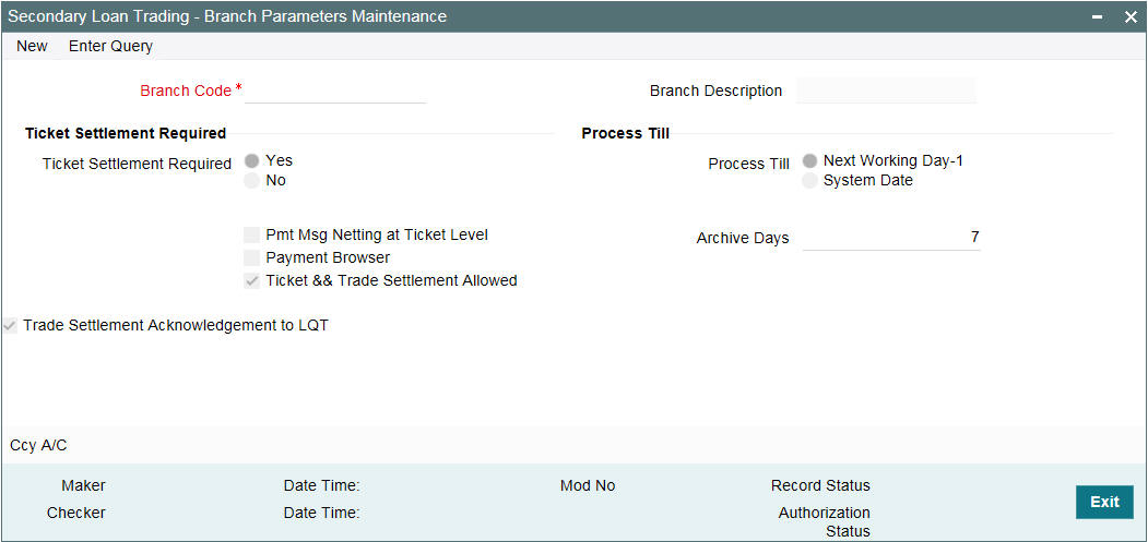

3.2 Maintaining SLT Branch Parameters
You can maintain the branch parameters specific to the SLT module in ‘Secondary Loan Trading – Branch Parameters’ screen.
You can invoke the ‘Secondary Loan Trading - Branch Parameters Maintenance’ screen by typing ‘TLDBRPRM’ in the field at the top right corner of the Application tool bar and clicking on the adjoining arrow button.
You can maintain the following details in this screen:
Branch Code
The branch code of the current branch, for which the parameters are being maintained, gets defaulted here. The description associated with the branch code is also defaulted in the adjacent column.
Ticket Settlement Required
Select the option to indicate whether ticket settlement should be enabled or not, for the branch specified.
If you select ‘Yes’, then you can perform the settlement only using the ‘Ticket Settlement’ screen. If you select ‘No’, then ticket settlements can not be carried out for that branch. In this case, all settlements need to be done at trade level, using the ‘Trade Settlement’ screen.
Note
Process Till
Select the option to indicate till which date the automatic processes of your branch should be executed if they fall due on holidays. The options available are:
Payment Message Netting at Ticket Level
Select this check box to indicate that consolidated payment messages need to be generated at ticket level. Payment messages are generated at trade level if this option is not selected.
‘Payment Message Netting at Ticket Level’ is enabled only if ‘Ticket Settlement required is selected as ‘Yes’.
Payment Browser
Select this check box to indicate that payments that are utilized for secondary loan trading should be processed using the forward processing ‘Payment Browser’.
Archive Days
Specify the number of days till which messages pertaining to secondary loan trading should be retained in the forward processing ‘Payment Browser. Messages whose dates are earlier than the archive days mentioned are archived and can be viewed only from the ‘Outgoing Message Browser’.
Ticket and Trade Settlement Allowed
Select this check box to indicate that both, ticket and trade settlements are allowed for a branch. If this check box is selected, then you can settle all trades for a ticket in the ticket settlement screen or you can settle trades individually in the trade settlement screen.
Note
Ticket settlement is not allowed if atleast one trade under the ticket is settled in trade set­tlement screen, however the reverse is allowed.
Trade Settlement Acknowledgement to LQT
Select this check box to indicate that settlement acknowledgement message to LQT must be sent at individual trade level. However, if this check box is not selected, then settlement acknowledgement message to LQT is sent at a ticket level.
Note

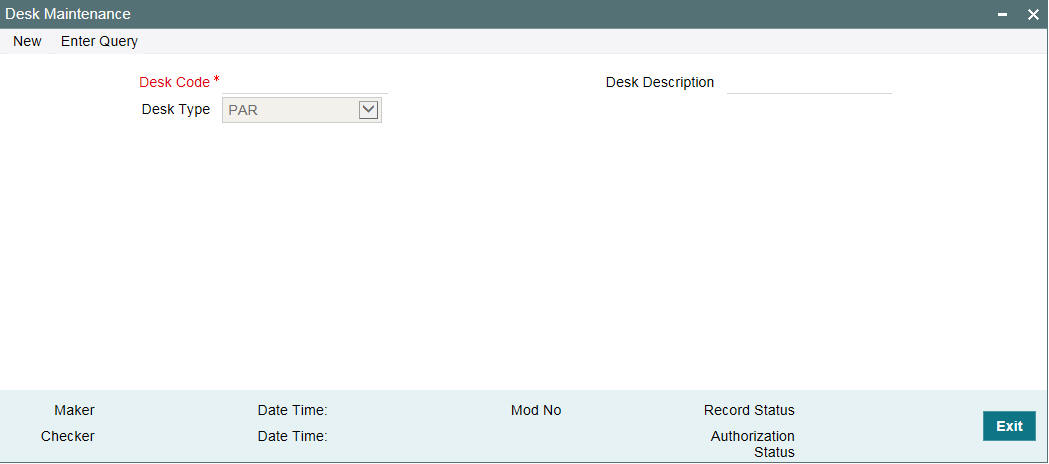

3.4 Maintaining Desk Details
Different types of desks are available for processing the deals at different priorities. You can maintain the details related to desks in ‘Desk Code Maintenance’ screen. You can invoke the ‘Desk Maintenance’ screen by typing ‘LBDDKMNT’ in the field at the top right corner of the Application tool bar and clicking on the adjoining arrow button.
You can specify the following details in this screen:
Desk Code
Specify a unique identification code for the desk and provide a suitable description for the desk code in the adjacent column.
Desk Type
Select the type of the desk from the drop-down list. The following values are provided for selection:
To process transfer of portfolio from HFI to HFS, you need to maintain a desk of the type ‘ORIGINATION-HFS.’

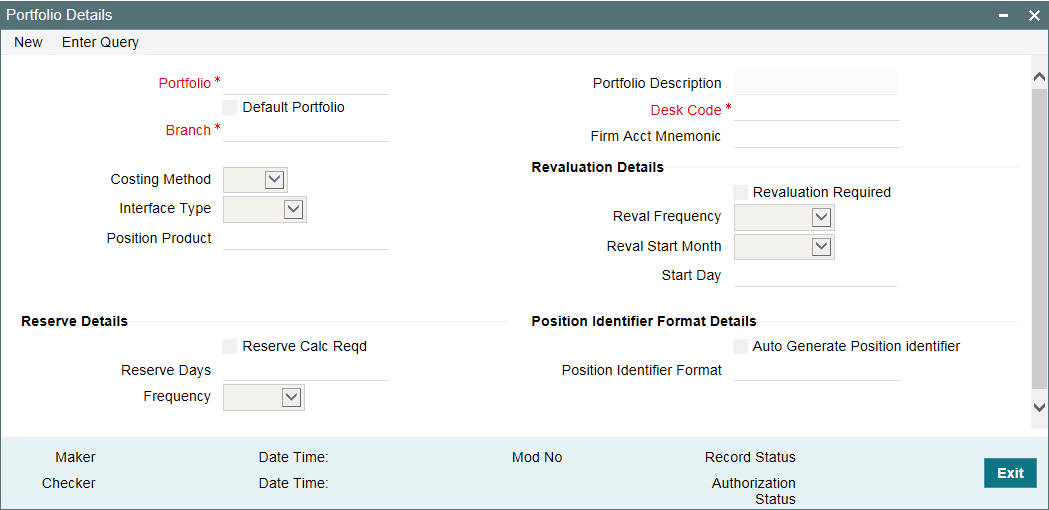

3.6 Maintaining Portfolio Details
Portfolios are maintained for a combination of branch, desk, and expense code. Every branch-desk-expense code combination is uniquely identified as a portfolio in SLT module. For instance, you have to maintain a portfolio for HFS with the Originations-HFS desk. You can maintain the details related to a portfolio in ‘Portfolio Details’ screen.
You can invoke the ‘Portfolio Details’ screen by typing ‘TLDPOMNT’ in the field at the top right corner of the Application tool bar and clicking the adjoining arrow button.
Portfolio
Select a unique identification for the portfolio from the option list provided. The option list displays a list of valid customers for the branch, desk, and expense code combination, from which you can select the required value.
Branch
Select the branch code associated with the portfolio whose details are being maintained, from the option list provided.
Desk
Select the desk code associated with the portfolio from the list of options provided. All desk codes maintained in ‘Desk Maintenance’ are displayed.
Firm Account Mnemonic
Specify a firm account mnemonic that is associated with branch code and desk code. The adjoining option list displays a list of valid CFPI firm account mnemonic uploaded through MCC.
Expense Code
Select the expense code to be used for the portfolio from the option list provided. All expense codes maintained under an MIS class gets displayed here.
Costing Method
Select the costing method to be used to arrive at a profitable price at which you can trade, from the options provided in the drop-down list. The following options are available:
Note
By default, WAC is selected for all desk types.
Position Product
Select the position product to be used to track the position details of the portfolio, from the option list provided. All position products maintained in ‘SLT Product Definition’ screen are displayed in the list.
3.6.1 Creating Portfolio IDs
Oracle FLEXCUBE automatically creates the Portfolio details whenever system receives a new Firm Account Mnemonic from e-sales.
System derives the Portfolio ID and other details using the following logic:
If the MCC maintenance does not exist, then Portfolio creation is not done and an exception is logged for the same.
Portfolio Id Maintenance is auto-authorized with 'SYSTEM' as the user id.
Note
3.6.2 Creating Position Identifiers
Position Identifiers are automatically created by the system.
3.6.3 Creating LB - OL Product and Component Mapping
A new LB OL Product and Component Mapping is created when a new portfolio is created either for CFPI and non-CFPI instances.
3.6.3.1 Maintaining Default Portfolio
System performs the following processing for maintaining the default portfolio:
3.6.3.2 Creating LB OL Product and Component Mapping
System performs the following processing for creating LB OL product and component mapping:
3.6.4 Portfolio Resolution
System derives the expense code and the desk code, and then fetches the portfolio which is mapped to the expense code, resolved desk code, branch code, and firm account mnemonic
This processing is performed only for non-CLP trades so that trades do not go for manual enrichment. However, there are no changes for CLP trades, so manual enrichment is required.
3.6.5 Specifying Revaluation Details
You can specify the following details related to the revaluation of the positions associated with the portfolio.
Reval Frequency
Select the frequency at which you need to perform a revaluation of the portfolio position, from the drop-down list provided. The following options are available:
Reval Start Month
Select the month in which the revaluation has to begin, from the drop-down list provided.
This is applicable if you specify any revaluation frequency other than daily or monthly.
Start Day
Specify the date on which the revaluation should be done during the month. For example, if you specify the date as ‘20’, revaluation will be carried out on that day of the month, depending on the revaluation frequency.
3.6.6 Specifying Reserve Calculation Details
Reserve calculation is applicable for buy trades that have not been sold for a period that exceeds a pre-defined number of days. You can specify the following preferences for reserve calculation for a trade deal.
Reserve Calculation Reqd
Select this check box to indicate that reserve calculation needs to be performed for the portfolio, if the number of days up to which a buy deal remains un-sold exceeds the ‘Reserve Days’ specified.
Reserve Days
Specify the number of days up to which a buy deal can remain un-sold, exceeding which reserve calculation for the trade gets initiated.
Frequency
Select the frequency as ‘Daily’ or ‘Monthly’ at which reserve calculation needs to be performed for trades that are marked for the same.
3.6.7 Specifying Identifier Format Details
You can specify the following details related to the position identifier.
Auto-generate Position Identifier
Select this check box to indicate that position identifier needs to be generated automatically during trade creation.
This is applicable only for ‘TRS’ desk types.
Position Identifier Format
Select the format in which position identifier needs to be generated, from the option list provided.
Note
This is applicable only if ‘Auto-generate Position Identifier’ is selected.

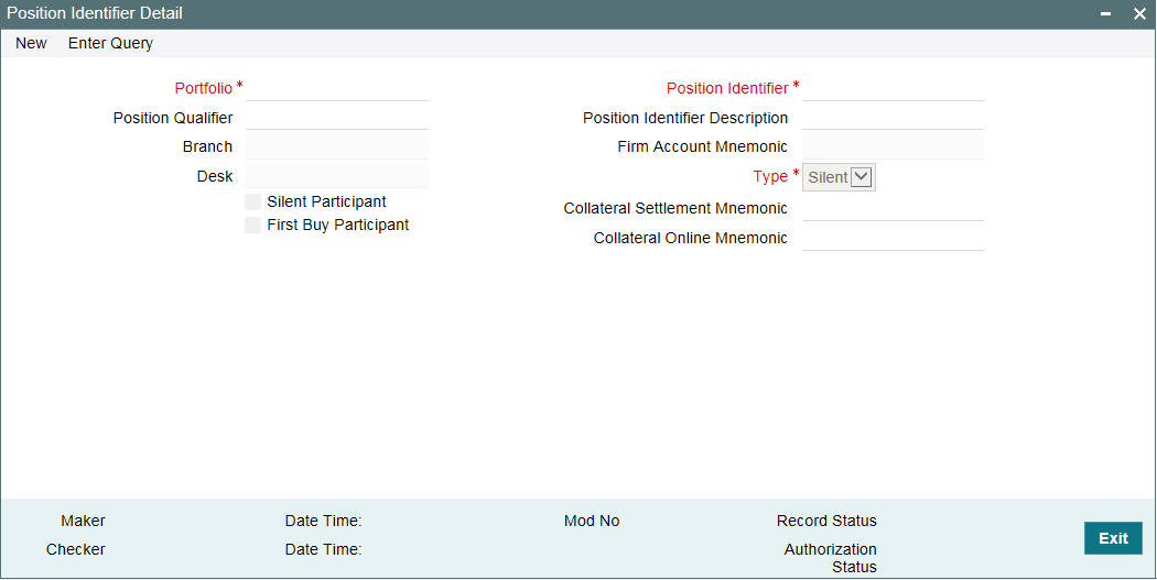

3.7 Maintaining Position Identifier Details
Position Identifier indicates the level at which position needs to be maintained for a portfolio. You can maintain settled and unsettled positions at position identifier level. You can maintain the details related to position identifier in ‘Position Identifier Detail’ screen.
You can invoke the ‘Position Identifier Detail’ screen by typing ‘TLDPIMNT’ in the field at the top right corner of the Application tool bar and clicking the adjoining arrow button.
Position Identifier
Specify a unique identification for the position identifier to be used for tracking the position of the portfolio selected.
Position Description
You can also provide a description for the identifier in the adjoining column.
Type
Select the type of the position identifier from the drop-down list. The following options are provided:
Note
For TRS trades, you need to specify the type as ‘Self’ in case of parent trades, and for corresponding swap trades the type gets defaulted as ‘Swap’.
Portfolio
The portfolio number specified in the ‘Position Details’ screen gets displayed here. The branch, desk, and expense code details associated with this portfolio are also defaulted.
Position Qualifier
Select the position qualifier from the option list provided, for identifiers of type ‘Silent’. The option list displays the list of existing customers in Oracle FLEXCUBE.
If type is ‘Swap’, the position qualifier indicates the Swap ID.
Note
Position qualifier is disabled for ‘Self’ identifier types.
Branch
Select the branch code associated with the position qualifier.
Desk
Select the desk code associated with the position qualifier from the list of options provided. All desk codes are maintained in ‘Desk Maintenance’ are displayed.
The system displays the firm account mnemonic maintained in the ‘Portfolio Maintenance’ screen. this displays only the valid CFPI firm account mnemonic uploaded through MCC and not the existing firm account mnemonic.
Silent Participant
Select this check box to indicate that the specific position identifier is a silent participant. If this option is selected, the position identifier type should be selected as ‘Self’ and the desk type as ‘Par’ or ‘Distress’. A single silent participant represents all the external participants who have bought the Participation from the bank.
You can mark a specific position identifier as a ‘silent participant’ across the branches and desk. If the position identifier for the Silent participant is not maintained, SLT-LB Handoff is in ‘Failed’ status in SLT-LB Interface browser for Participation sell.
During SLT-LB handoff, a new wrapper contract is created for all the silent participation sold across the bank entities.
Collateral Online Mnemonic
Specify the collateral online mnemonic to the margin desk account. The adjoining option list displays all mnemonics that are maintained for the collateral online customer in the system.
Collateral Settlement Mnemonic
Specify the collateral settlement mnemonic to the margin desk account. The adjoining option list displays all mnemonics that are maintained for the collateral settlement customer in the system.
First Buy Participant
Check this box to indicate that the position identifier is a first time buy investor. Only one such position identifier can be marked as first time buy investor across branches and desks. This is applicable only for non-lead agency contracts.
Tranche/DDs for the first-time buy trade CUSIP has to be created manually before the expected settlement date of trade with 100% participation from the first-time buy investor. When such tranche contracts are created, the delayed compensation fee (DCF) is calculated for the first-time buy trades between the committed settlement date and the actual settlement date.
Note

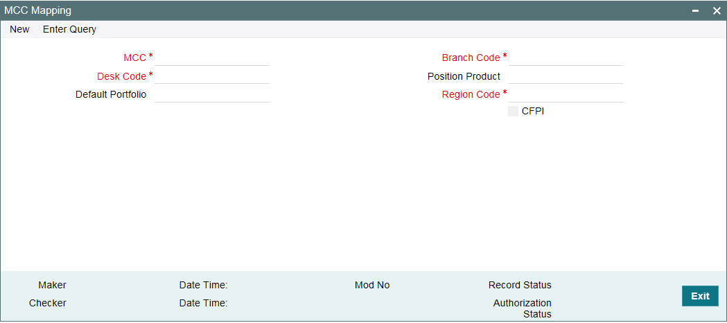

3.8 Mapping MCC
You can map strategy codes to region codes and branch codes using the ‘Strategy Code Mapping’ screen.
You can invoke the ‘MCC Mapping’ screen by typing ‘TLDSTRCM’ in the field at the top right corner of the Application tool bar and clicking on the adjoining arrow button.
Specify the following details:
MCC
Specify the MCC which you want to map to the region code and branch code. The adjoining option list displays all strategy codes maintained in the system. Choose the appropriate one. The combination of portfolio, branch desk code and Firm account mnemonic should be unique.
Note
Region Code
Specify the region code that needs to be mapped to the strategy code. This is not a mandatory field.
Branch Code
Specify the branch code that needs to be mapped to the strategy code. The adjoining option list displays all branch codes maintained in the system. Choose the appropriate one. This is not a mandatory field.
CFPI
Select this check box to indicate the branch falls under CFPI account.
Desk Code
Select the desk code from the adjoining option list. The list contains all valid Desk codes maintained in system.
Position Product
Select the position product from the adjoining option list. The list contains all valid position products maintained in system.
Default Portfolio
Specify the default portfolio that is used during the automatic creation of LB OL Product and Component mapping.

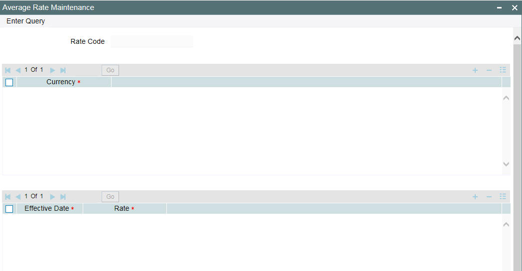

3.9 Capturing LIBOR Rate Details
You can capture the LIBOR rate to be used for computing ‘Cost of Fund’ and ‘Cost of Carry’ components of delayed compensation fee, in the ‘Average Rate Maintenance’ screen.
You can invoke the ‘Average Rate Maintenance’ screen by typing ‘TLDRTMNT’ in the field at the top right corner of the Application tool bar and clicking on the adjoining arrow button.
Rate Code
The rate code defaults to ‘LIBOR’. You cannot modify this value.
Ccy
Select the currency to be linked to the LIBOR rates, from the option list provided.
Effective Date
Specify the date on which the LIBOR rate specified becomes effective.
Rate
Specify the LIBOR rate in terms of the selected currency.
Note
The LIBOR rate information is obtained from the website ‘averagelibor.com’.

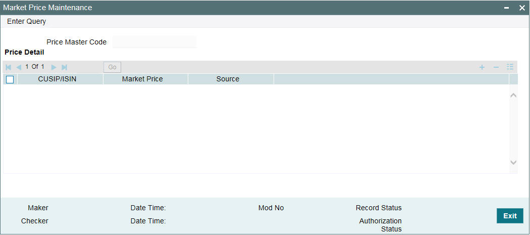

3.10 Maintaining Market Price Details
You can maintain market price ratings for all CUSIPs involved in trade, which can be used for the revaluation of the positions associated with the CUSIP.
You can capture the market price details for CUSIPs in ‘Market Price Maintenance’ screen. You can invoke the ‘Market Price Maintenance’ screen by typing ‘TLDPRCMT’ in the field at the top right corner of the Application tool bar and clicking on the adjoining arrow button.
The following details are displayed in this screen:
CUSIP/ISIN
Specify the CUSIP for which you need to maintain the market price details.
Market Price
Specify the market price associated with a CUSIP.
Source
Specify the source from where the market price for the CUSIP was obtained.
If the market price gets revised, the old value is retained in the history.

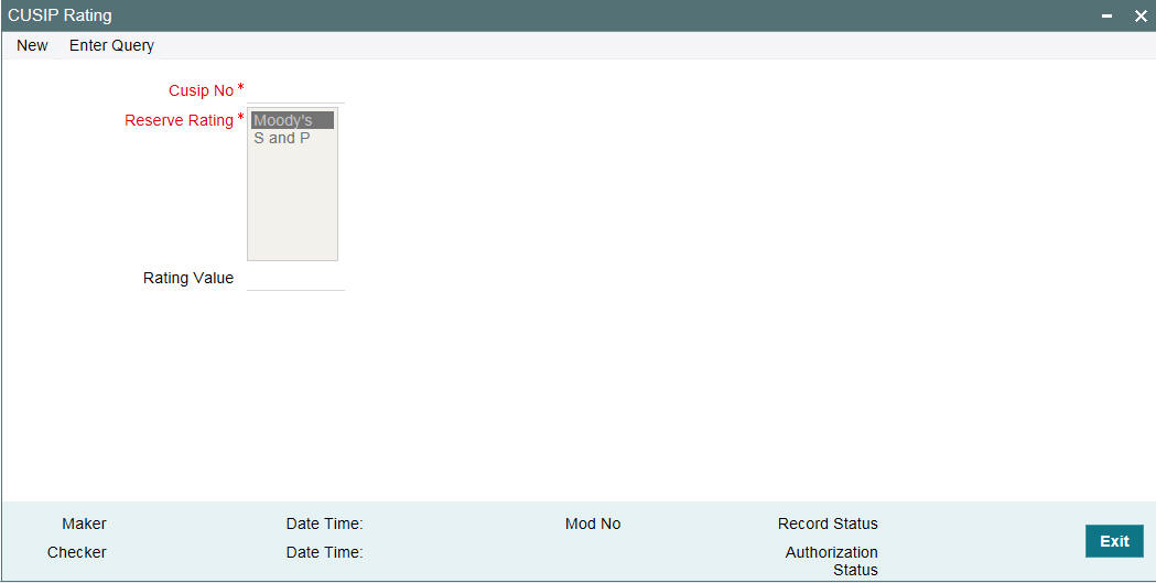

3.11 Maintaining CUSIP Rating
You need to maintain reserve ratings for all CUSIPs available at agency level to facilitate reserve calculation for a trade.
You can maintain ratings for the CUSIPs in the ‘CUSIP Rating Maintenance’ screen.
You can invoke the ‘CUSIP Rating’ screen by typing ‘TLDCUMNT’ in the field at the top right corner of the Application tool bar and clicking on the adjoining arrow button.
CUSIP/ISIN
Select the CUSIP for which you need to maintain reserve rating from the option list provided. All CUSIP available at the agency level are displayed in the list.
You can also modify the rating for a CUSIP in this screen.
Reserve Rating
Select the external rating agency from where the credit rating for the CUSIP selected, should be obtained. The following options are possible:
Rating Value
Specify the rating value obtained for the CUSIP from the external credit rating agency.

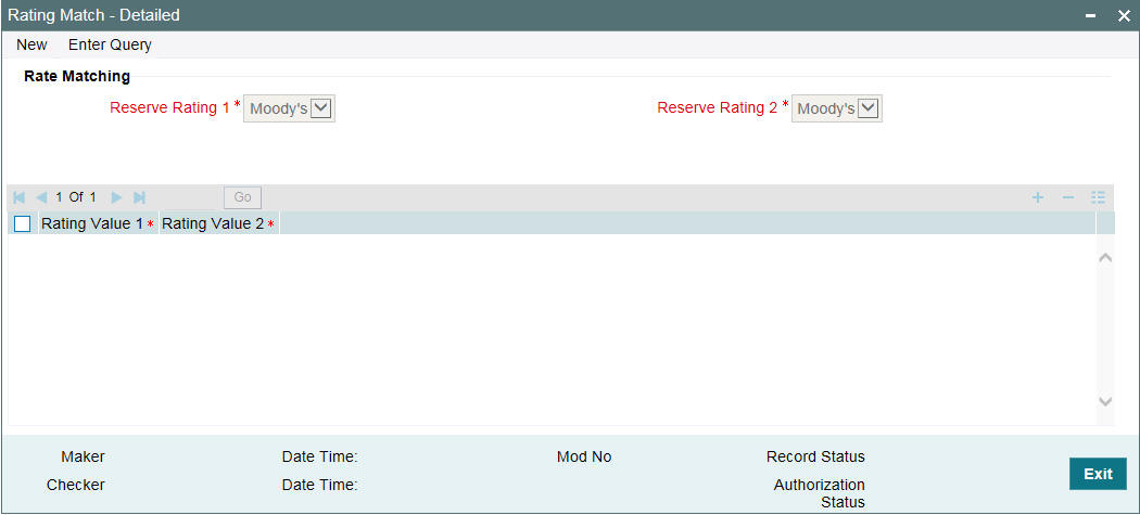

3.12 Maintaining Credit Rate Mapping
You can maintain a mapping of the credit rating values obtained from Moody’s and S&P’s in the ‘Rating Matching – Detailed’ screen.
You can invoke the ‘Rating Match -Detailed’ screen by typing ‘TLDRTMCH’ in the field at the top right corner of the Application tool bar and clicking on the adjoining arrow button.
Reserve Rating 1
Select the first credit rating agency to be considered for finding the rate match. The following options are provided:
Reserve Rating 2
Select the second credit rating agency to be considered for finding the rate match. The following options are provided:
Note
You cannot select the same value for ‘Reserve Rating 1’ and ‘Reserve Rating 2’.
Rating Value 1
Select a rating value associated with the rating agency specified in ’Reserve Rating 1’.
Rating Value 2
Select the rating value associated with the rating agency specified in ’Reserve Rating 2’.
You can maintain a mapping for all the credit values obtained from the two credit rating agencies.

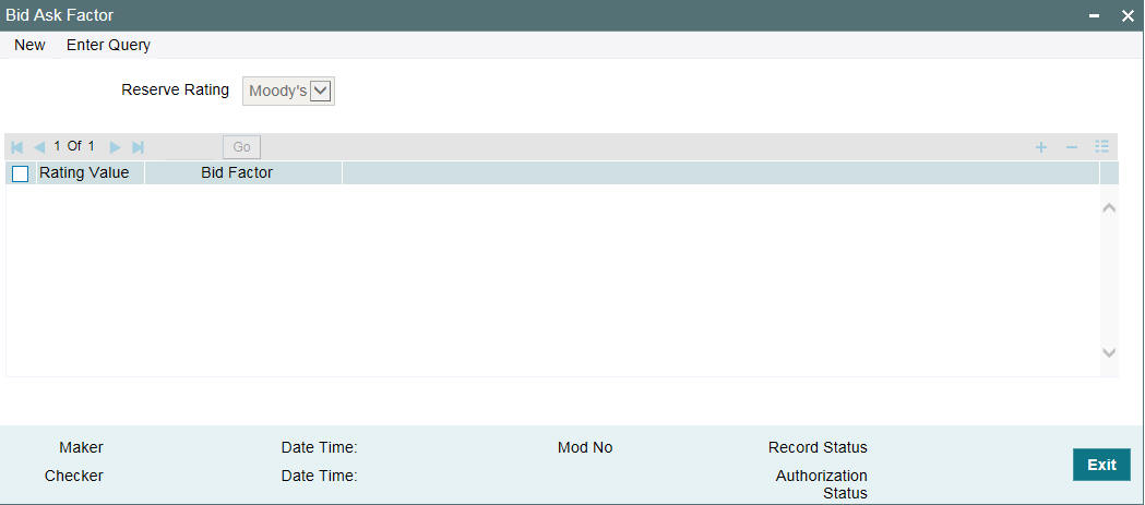

3.13 Maintaining Bid/Ask Factor
Bid price is the highest price that a buyer is willing to pay in a trade deal whereas ask rate is the lowest price that the seller is willing to accept. The ratio of the bid price to the ask price is termed as Bid/Ask factor.
You can maintain the Bid/Ask factor for the credit rating values available from S&P in the ‘Bid/Ask Factor Maintenance’ screen. You can invoke the ‘Bid Ask Factor’ screen by typing ‘TLDBDMNT’ in the field at the top right corner of the Application tool bar and clicking on the adjoining arrow button.
Reserve Rating
Select the credit rating agency for which you need to maintain Bid/Ask factor for the associated rating values. The following options are available:
Rating Value
Specify the rating value obtained from the rating agency selected.
Bid Factor
Specify the Bid/Ask factor corresponding to the reserve rating obtained from the rating agency.

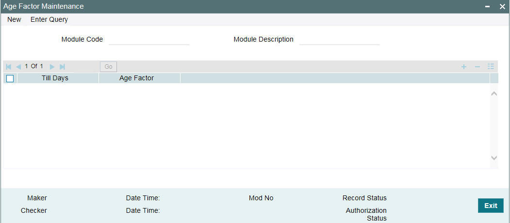

3.14 Maintaining Age Factor Details
Age factor is a value that is used for reserve calculation for trade deals. You can maintain the age factor details in the ‘Age Factor Maintenance’ screen. You can invoke the ‘Age Factor Maintenance’ screen by typing ‘TLDAFMNT’ in the field at the top right corner of the Application tool bar and clicking on the adjoining arrow button.
You can specify the following details here:
Module Code
Select the module to which you want to associate the age factors.
Module Description
The module description appears once the module code is selected.
Till Days
Specify the till days for which you want to maintain the age factor.
Age Factor
Specify the age factor associated with the till days specified.
