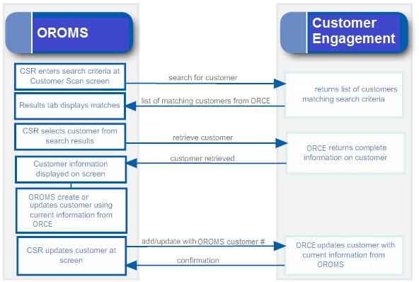

When does Order Management System communicate with Oracle Retail Customer Engagement?
• Searching for a customer: When you search for an existing customer in an Order Management System menu option, Oracle Retail Customer Engagement returns a list of customers matching the search criteria. See Notes on Searching for a Customer on Order Management System Screens for more information.
• Synchronizing customer information (add/update customer): Synchronization occurs when:
- You create a new customer in Order Management System. Order Management System sends a message indicating to create the new customer in Oracle Retail Customer Engagement.
- You retrieve an existing customer record from Oracle Retail Customer Engagement. When Oracle Retail Customer Engagement sends the current customer information to Order Management System, Order Management System creates or updates its customer record based on the information received from Oracle Retail Customer Engagement.
- You update an existing customer at a Order Management System screen. Order Management System sends an update message to Oracle Retail Customer Engagement.
- You update an existing customer through the order API, in certain cases. See Customer Synchronization through the Order API for a discussion.
- You use a periodic function to synchronize Order Management System customer records with Oracle Retail Customer Engagement. Order Management System sends its current customer information to Oracle Retail Customer Engagement and stores the Relate ID in the Customer Sold To table. See Synchronizing Customer Information through a Periodic Function for more information.

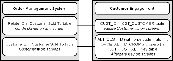

How are synchronized customers linked? A pair of synchronized Order Management System and Oracle Retail Customer Engagement customer records are linked by matching customer numbers:
• Order Management System: the Relate Id in the Customer Sold To table identifies the customer number in Oracle Retail Customer Engagement
• Oracle Retail Customer Engagement: the Alternate key in Oracle Retail Customer Engagement identifies the customer number in Order Management System. The ORCE_ALT_ID_OROMS setting in Working with Customer Properties (PROP) defines the alternate key type for the Order Management System customer number in Oracle Retail Customer Engagement.

• Search Oracle Retail Customer Engagement first: When the CSR performs a search, Order Management System first checks in Oracle Retail Customer Engagement for any matches. Unlike the process used for the order API, the customer search can send various criteria to Oracle Retail Customer Engagement. If the CSR selects a customer from the search results and enters any updates, Order Management System syncs these updates with the Oracle Retail Customer Engagement customer record.
• Search Order Management System second: If the CSR’s search does not find any matches in the Oracle Retail Customer Engagement database, Order Management System checks for any matches in its Customer Sold To table. When the CSR selects and works with a Order Management System record, Order Management System sends the current information to Oracle Retail Customer Engagement, creating the customer record there.
• Create customer if no match: If there are no matches in either database, then the CSR can create a new customer, and Order Management System sends the new customer record to Oracle Retail Customer Engagement.
Examples of these processes are provided below.
Searching Oracle Retail Customer Engagement for the customer
When the customer contacts the call center to place an order, request a catalog, create a customer membership outside of order entry, or update name and address or other information:
Searching:
• The CSR enters the search criteria at the Customer Scan Screen.
• There is at least one customer record in Oracle Retail Customer Engagement that matches the search criteria.
• The Results tab at the Customer Scan screen displays the names, home addresses, email addresses, and primary phone numbers of any customers in the Oracle Retail Customer Engagement database matching the search criteria. The Results tab displays the error message Maximum search results exceeded, please refine your search if the number of matching records exceeds the Customer Lookup Limit setting in Oracle Retail Customer Engagement Conflate. In this situation, you need to make your search criteria more specific to make sure that you can find the customer record you are looking for.
Selecting a customer from the Oracle Retail Customer Engagement search results:
• If the CSR selects a record from the Results tab:
- Order Management System requests information on the complete customer record from Oracle Retail Customer Engagement.
- Oracle Retail Customer Engagement sends the customer information, including the alternate key, if any, that maps to the Order Management System customer number.
- If the alternate key identifies an existing customer in the Customer Sold To table, Order Management System updates the customer record with the current information from Oracle Retail Customer Engagement.
- If there is not an alternate key that identifies an existing customer in Order Management System, Order Management System creates a new customer record.

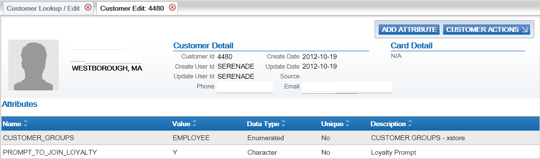

Reviewing the customer in Oracle Retail Customer Engagement: Use the Customer Lookup / Edit option in Oracle Retail Customer Engagement to search for, review, or update a customer.
Which tables? Customer records are stored in:
• Order Management System: the Customer Sold To table, except where noted below.
• Oracle Retail Customer Engagement: the CST_CUSTOMER table.
For more information: See the Information that is not mapped for a listing of some of the fields that are not mapped as part of the Oracle Retail Customer Engagement customer integration.

Customer numbers |

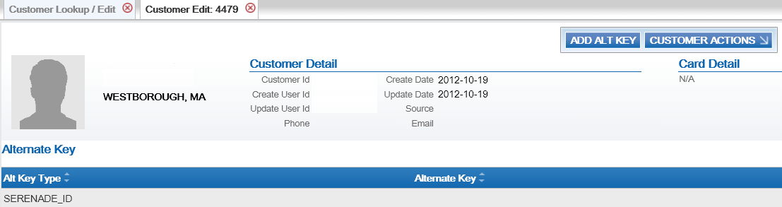

Displaying in Oracle Retail Customer Engagement: • Order Management System customer number: select Alternate Key. • Relate ID: labeled the Customer Id.
Customer number |
Alternate key SERENADE_ID |
Indicates the Alt Key Type of the alternate key in Oracle Retail Customer Engagement that maps to the Order Management System customer number. This field is available for display in Oracle Retail Customer Engagement by selecting Alternate Key in the Customer Lookup /Edit option. Oracle Retail Customer Engagement automatically creates this entry for a customer when you send the customer to Oracle Retail Customer Engagement interactively or through the Customer Engagement Add or Update Customer Message if it does not already exist based on the ORCE_ALT_ID_OROMS setting in the Oracle Retail Customer Engagement Properties file. In this situation, Oracle Retail Customer Engagement also adds a row to the CST_ALT_KEY_TYPCODE table in the Oracle Retail Customer Engagement database if it does not already exist. |
Relate id |
Customer ID |
Note: The Relate id: • is not displayed on any screen in Order Management System • is an alphanumeric field in the Order Management System Customer Sold To table |

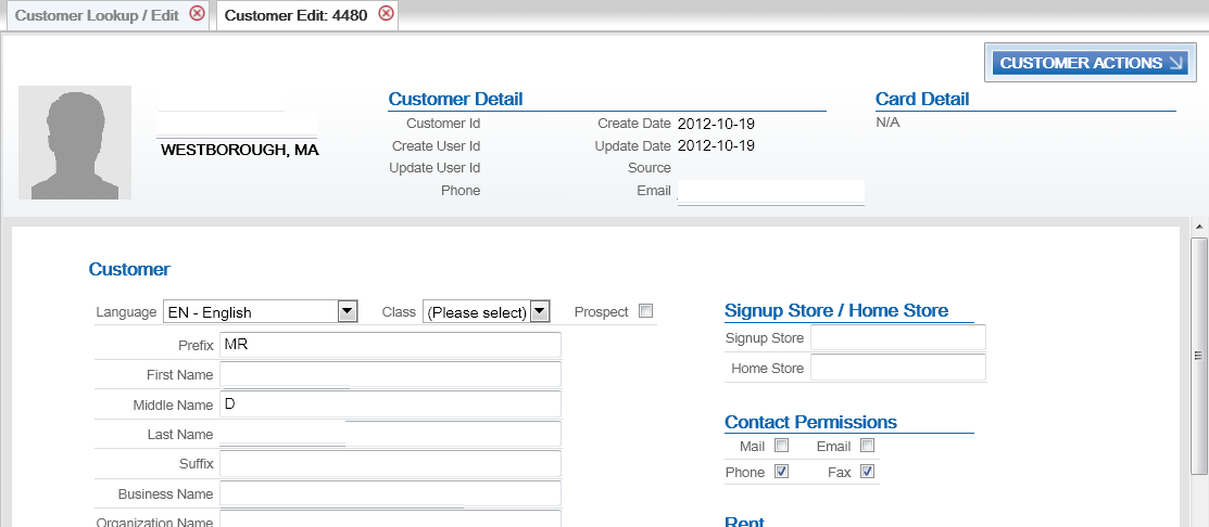

Customer-level information and permissions The customer-level permissions in Oracle Retail Customer Engagement are informational only. Displaying in Oracle Retail Customer Engagement: Included under the Customer option. See above. |
Retail Store ID |
Signup Store |
The value defined in the Default Location for ORCE Integration (K69) system control value. |
Home Store |
N/A |
Source |
Contact Center defaults when a new customer is sent to Oracle Retail Customer Engagement. |
Mail flag |
Mail contact permission flag |
Order Management System to Oracle Retail Customer Engagement: Y defaults if the Mail flag is selected; otherwise leave blank. Oracle Retail Customer Engagement does not send this setting to Order Management System. |
Opt in/out setting for primary email address |
Email contact permission flag |
Order Management System to Oracle Retail Customer Engagement: Y defaults if the Email status setting for the primary email address is O1; otherwise leave blank (N). Oracle Retail Customer Engagement does not send this setting to Order Management System. |
Day or Evening phone number |
Phone contact permission flag |
Order Management System to Oracle Retail Customer Engagement: Y defaults if a Day or Evening phone number exists; otherwise leave blank. Oracle Retail Customer Engagement does not send this setting to Order Management System. |
Do not fax |
Fax contact permission flag |
Order Management System to Oracle Retail Customer Engagement: Y defaults if the Third Phone Number Type (L53) system control value is set to FAX and the Do Not Fax field for the customer in Order Management System is unselected; otherwise leave blank. Oracle Retail Customer Engagement does not send this setting to Order Management System. |
Rent |
Rent contact permission flag |
The setting of the Default Rent Name (D11) system control value always overrides any other setting in both Order Management System and Oracle Retail Customer Engagement once the customers are synchronized; however, if the Default Rent Name (D11) system control value is blank, the setting for the customer applies. |
Gender |
Order Management System to Oracle Retail Customer Engagement: The default value defined for the profile code in the Default Male/Female Profile Code (C74) system control value. Note: Mapped only if a value is defined in the Default Male/Female Profile Code (C74) system control value, the value to pass is M or F, and the Send Profile Data to ORCE (L51) system control value is selected. Oracle Retail Customer Engagement to Order Management System: The M or F value defined for the Gender field. If a value other than M or F is passed from Oracle Retail Customer Engagement, Order Management System uses the default value defined for the profile code in the Default Male/Female Profile Code (C74) system control value. |
Birth Month and Birth Date |
Birth date |
Order Management System to Oracle Retail Customer Engagement: The month and date defined in the Birth month and Birth date fields for the customer. The year passed to Oracle Retail Customer Engagement defaults to 1900; however this year is not used if a birth year has already been defined in Oracle Retail Customer Engagement. Note: If you remove the Birth month and Birth date from the customer in Order Management System, the Birth date defined in Oracle Retail Customer Engagement is retained. Oracle Retail Customer Engagement to Order Management System: The date defined in the Birth date field, including the actual month, day, and year defined. |

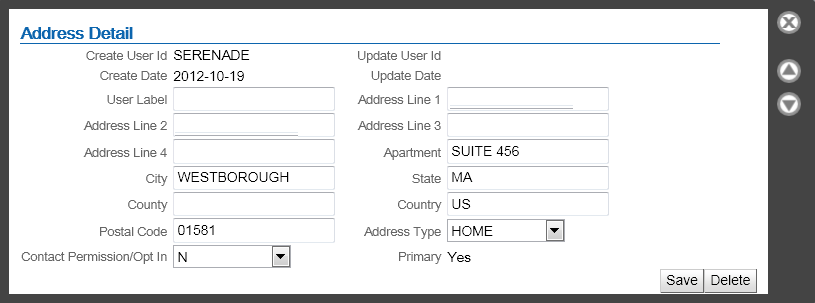

Address Note: Only the customer’s HOME address in Oracle Retail Customer Engagement is mapped to Order Management System. If more than one HOME address exists in Oracle Retail Customer Engagement, the system uses the primary HOME address. This information is required in order for Order Management System to create the customer record correctly. Oracle Retail Customer Engagement automatically creates an Address type of HOME when it receives a customer from Order Management System interactively or through the Customer Engagement Add or Update Customer Message. In this situation, Oracle Retail Customer Engagement also adds a row to the CST_ADDR_TYPCODE table for ADDRESS_TYPECODE HOME in the Oracle Retail Customer Engagement database if it does not already exist. No address validation in Oracle Retail Customer Engagement: Unlike Order Management System, Oracle Retail Customer Engagement does not require an address for a customer, and does not validate that the address includes certain required components; for example, no address lines are required. To prevent problems in Order Management System, it is important that any other means you use to create customers in Oracle Retail Customer Engagement, such as through your e-commerce site, always creates a home address when you use the Oracle Retail Customer Engagement customer integration. If a home address does not exist in Oracle Retail Customer Engagement, Oracle Retail Customer Engagement displays the customer in Order Management System without an address. Also, if certain fields for the home address are not defined in Oracle Retail Customer Engagement, these fields will be blank when you display the customer in Order Management System. However, when you update the customer’s address in Order Management System so that is passes validation, the system will also update the customer’s home address in Oracle Retail Customer Engagement Displaying in Oracle Retail Customer Engagement: Select Address.
N/A |
Primary |
Set to Yes in Oracle Retail Customer Engagement. |
Street |
Address line 1 |
Truncated in Order Management System to 32 positions. Any trailing spaces are removed. |
Apt/Suite |
Apartment |
Truncated in Order Management System to 32 positions. If deleted in Order Management System, also deleted in Oracle Retail Customer Engagement. Any trailing spaces are removed. |
Address (lines 2-4) |
Address lines 2-4 |
Truncated in Order Management System to 32 positions. Stored in the Customer Sold To Extended table. If deleted in Order Management System, also deleted in Oracle Retail Customer Engagement. Any trailing spaces are removed. |
City |
City |
Truncated in Order Management System to 25 positions. Any trailing spaces are removed. |
State |
State |
Truncated in Order Management System to 2 positions and validated against the states in the Country table. Any trailing spaces are removed. |
Postal code |
Postal code |
Truncated in Order Management System to 10 positions and validated against the SCF table. Any trailing spaces are removed. |
Country |
Country |
Must be a 2-position country code; validated in Order Management System against the Country table. Note: Use the two-position ISO country code; for example, use US instead of USA. Any trailing spaces are removed. |
Contact permission/opt in setting (address level) |
Order Management System to Oracle Retail Customer Engagement updates: • Y in Order Management System = Y in Oracle Retail Customer Engagement • N in Order Management System = N in Oracle Retail Customer Engagement Oracle Retail Customer Engagement to Order Management System updates: • Y or any setting starting with Y in Oracle Retail Customer Engagement = Y in Order Management System • N or any setting starting with N in Oracle Retail Customer Engagement = N in Order Management System Note: The mail permission setting in Oracle Retail Customer Engagement must consist of or start with the letters Y or N; otherwise, synchronizing the customer with Order Management System results in an error when validating the customer in Order Management System because the only valid settings in Order Management System are Y and N. |

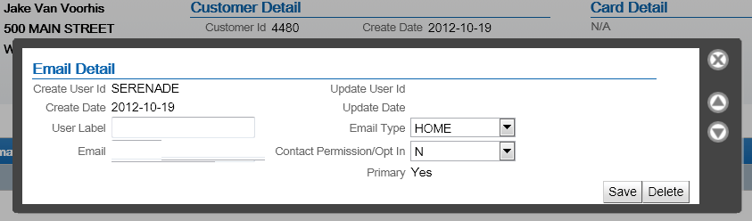

Email address In Order Management System, the primary email address is stored in both the Customer Sold To table and the Customer Sold To Email table. Additional, non-primary email addresses are stored only in the Customer Sold To Email table. Only the HOME email address that is flagged as primary in Oracle Retail Customer Engagement is eligible to be included in the integration. Oracle Retail Customer Engagement automatically creates an Email type of HOME when it receives a customer from Order Management System interactively or through the Customer Engagement Add or Update Customer Message. In this situation, Oracle Retail Customer Engagement also adds a row to the CST_EMAIL_TYPCODE table for EMAIL_TYPECODE HOME in the Oracle Retail Customer Engagement database if it does not already exist. Displaying in Oracle Retail Customer Engagement: Select Email. Optionally, highlight the email address to open the Email Detail window.
N/A |
Primary |
Email address |
Email type: HOME |
Only the HOME email address that is flagged a primary is eligible to be included in the integration. If the customer has any other email type in Oracle Retail Customer Engagement, but not a HOME email type, the email address(es) are not passed to Order Management System. Any trailing spaces are removed. |
Opt in/opt out |
Contact permission/opt in setting (email level) |
Order Management System to Oracle Retail Customer Engagement updates: • O1 in Order Management System = Y in Oracle Retail Customer Engagement • O2, O3, or O4 in Order Management System = N in Oracle Retail Customer Engagement Oracle Retail Customer Engagement to Order Management System updates: • Y in Oracle Retail Customer Engagement = O1 in Order Management System • N in Oracle Retail Customer Engagement = O2 in Order Management System • any other value in Oracle Retail Customer Engagement = no change in Order Management System |
Format |
Format preference |
• H in Order Management System = HTML in Oracle Retail Customer Engagement • T or blank in Order Management System = TEXT in Oracle Retail Customer Engagement |

- Address type: Only the address with a type of HOME is used as part of the integration. If the customer record in Oracle Retail Customer Engagement does not have a HOME address, then the address you enter for the customer in Order Management System is created as the HOME address in Oracle Retail Customer Engagement.
- Email address: Only the email address with a type of HOME is used as part of the integration.

Overview: In general, the integration keeps existing Order Management System and Oracle Retail Customer Engagement customer records synchronized when you update customer information through either system. A few things to note are listed below.

• If you delete address lines 2-4 or apartment in Order Management System, these address lines are also deleted in Oracle Retail Customer Engagement.

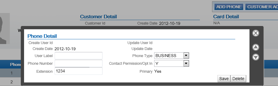

Phone number extensions: If you add an extension to an existing phone number:
• if you add the extension in Order Management System, the extension is not added to Oracle Retail Customer Engagement.
• if you add the extension in Oracle Retail Customer Engagement, the extension is not added to Order Management System and is removed when the customer information is resynchronized.

Information used for matching: The SYNCRDB periodic function uses the following information to match customer records between Order Management System and Oracle Retail Customer Engagement:
• Relate Id: Oracle Retail Customer Engagement customer number = Relate Id in the Order Management System Customer Sold To table
• Customer number: Oracle Retail Customer Engagement alternate key record whose Alt Key Type matches the ORCE_ALT_ID_OROMS setting in Working with Customer Properties (PROP) = the Order Management System customer number
• E-commerce ID: Oracle Retail Customer Engagement alternate key record whose Alt Key Type matches the ORCE_ALT_ID_WEB setting in Working with Customer Properties (PROP) = the e-commerce site’s customer number. From the ecommerce_id passed in the CWOrderIn message, and saved as the E-commerce ID in the Customer Sold To table only if the order API was unable to synchronize the Order Management System and Oracle Retail Customer Engagement customer records
• Primary email address: an email address for the customer in Oracle Retail Customer Engagement = the customer’s primary email address in Order Management System

• Relate ID: The Oracle Retail Customer Engagement customer ID is stored in the Order Management System Customer Sold To table, but is not displayed on any screens in Order Management System and is not used to search Oracle Retail Customer Engagement for a matching customer.

Email addresses never deleted from Oracle Retail Customer Engagement: Even if you change or delete a customer’s email address, this information is not visible on the screen but is retained in the Oracle Retail Customer Engagement database. For this reason, searching on the deleted or overwritten email address still finds the customer, and customer matching logic described under Customer Synchronization through the Order API uses the deleted or overwritten email address as it would use a current email address.
Phone number extension: Phone number extensions are not passed between Oracle Retail Customer Engagement and Order Management System.

Address fields: If you delete additional address fields in Order Management System, such as the second through fourth address lines and the apartment/suite, this information is also deleted in Oracle Retail Customer Engagement and does not reappear after resynchronization.
Email and phone: If you change the email address and phone numbers in Order Management System, the previous information persists in the Oracle Retail Customer Engagement database, although it is no longer displayed on the screen and does not repopulate the Order Management System customer record at resynchronization. However, if you search for a customer using the previous email address or phone number as a search criterion, the customer is eligible to be included in the search results.
