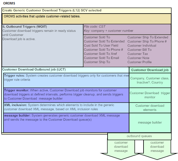

Customer information flow:
Mass customer download API: You can also use Mass Customer Download to create a batch file that contains a Mass Customer Download XML Message (CWCustomerDownload) for each sold to customer whose customer class matches the customer class defined in the MASS_CUSTDWNLD_CUSTOMER_CLASSES property. See Mass Customer Download for an overview.

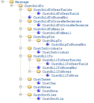

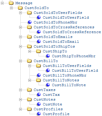

• Customer Download XML Message (CWCustomerDownload)
• Customer Download Message: Sample XML Messages

When are Customer Download Triggers Created?
The Create Generic Customer Download Triggers (L12) system control value controls whether the system creates customer download triggers in the IL Outbound Trigger table.
• If this system control value is selected, certain actions in Order Management System triggers the system to create customer download triggers in the IL Outbound Trigger table with a File code of CST. The IL Outbound Trigger table acts as a “to do” list for the customer information that requires download. See Customer Outbound Trigger Activities for a list of activities that create triggers.
• If this system control value is unselected, the system does not create customer download triggers.
To generate a customer download message:
1. The system creates customer download triggers, based on Order Management System activities that create, change, or delete customers who qualify based on the Customer Outbound Trigger Rules. See Customer Outbound Trigger Activities for a list of the activities that create the customer download triggers.
2. When the Customer Outbound job is active, it monitors the IL Outbound Trigger table for unprocessed customer download triggers. At the interval defined in the Outbound delay time, the job:
- checks for customer download triggers whose File code is CST and whose status is ready (R).
- removes duplicate customer download triggers. See Customer Trigger Cleanup.
- identifies the customer by the Key field for the customer download trigger. This field consists of company + customer code. For example, the Key 012000014776 indicates the vendor information is located in company 12 for customer 14776.
- generates the Customer Download XML Message (CWCustomerDownload).
- determines which elements to include in the customer download message, based on XML inclusion rules; see Customer Outbound XML Inclusion.
Note: The system creates a customer download message for customer outbound triggers with a delete (D) Capture type immediately, regardless of whether the Customer Outbound job is active or inactive; see Processing Customer Delete Triggers.
- sends the generated customer download message to each Customer Outbound queue whose Enabled field is selected. See Outbound Interface Queues.
For each customer download trigger, the Customer Outbound message builder determines which elements to include in the Customer Download XML Message (CWCustomerDownload), based on XML inclusion rules.
You can define Customer Outbound XML inclusion rules at the Outbound Interface XML Inclusion Screen.
XML inclusion defines which elements to include in the Customer Download XML Message (CWCustomerDownload).
• If the element is included, that element and its parents are included in the generated customer download message.
• If the element is excluded, that element and its children are excluded from the generated customer download message.
This table indicates which elements in the customer download message are included, based on which elements you flag to include or exclude.
Include element in XML message? |
Element |
Selected = Include Customer Sold To Unselected = Exclude Customer Sold To and all of its children, Customer Bill To, Customer Bill To Note, Customer Ship To, Customer Tax, Customer Notes, Customer Profile; the system sends a message with only the Message element and its attributes |
Customer Sold To |
Selected = Include Customer Bill To and its parent, Customer Sold To Unselected = Exclude Customer Bill To |
Customer Bill To |
Selected = Include Customer Bill To Note and its parent, Customer Sold To Unselected = Exclude Customer Bill To Note |
Selected = Include Customer Ship To and its parent, Customer Sold To Unselected = Exclude Customer Ship To |
Customer Ship To |
Selected = Include Customer Tax and its parent, Customer Sold To Unselected = Exclude Customer Tax |
Customer Tax |
Selected = Include Customer Notes and its parent, Customer Sold To Unselected = Exclude Customer Notes |
Customer Notes |

Order Management System Setup for the Customer Download API
Before you can generate customer download messages, you must perform the necessary Order Management System setup and processing.
Information requiring setup includes:
System Control Value |
Description |
Select this field to create customer triggers in the IL Outbound Trigger table when you create, change, or delete a customer. |
Enter the number of days to retain records in the IL Outbound Trigger table before purging them. Run the PURGIJT periodic function (program name ILR0026) to delete any records if: Last processed date is less than the current system date by the number of purge days and Status is X. You can also use the Purge option at the Work with Outbound Interface Transactions Screen to purge records. Example: Today is 5/10 and you have set this value to 1. Any record whose Last processed date is 5/10 or earlier is purged. |
Menu Option |
Description |
Use to review, delete, or resend IL outbound trigger records. |
When active, the Customer Outbound job creates a Customer Download XML Message (CWCustomerDownload) for each unprocessed customer trigger in the IL Outbound Trigger table. You can also define: • trigger rules; see Customer Outbound Trigger Rules • XML inclusion rules; see Customer Outbound XML Inclusion • the queues where the customer download message is sent; see Work with Integration Layer Process Queues Screen |
Periodic Function |
Description |
Start CUST_OUT IJCT Job (program name ILSTRCSTOT) |
Run this periodic function to start the CUST_OUT IJCT job and generate outbound triggers. |
End CUST_OUT IJCT Job (program name ILENDCSTOT) |
Run this periodic function to end the CUST_OUT IJCT job. |
Purge IJCT Download (program name ILR0026) |
Run this periodic function to purge processed IL outbound triggers, based on the Outbound Interface Trigger File Purge Days (I14) system control value: Last processed date is less than the current system date by the number of purge days and Status is X |
The customer download message contains customer information to send from Order Management System to another system, such as a retail store. See Generic Customer Download API for an overview.
Message formatting specific to customer download:
• A separate message is generated for each customer you create, change, or delete.
• Delete transactions contain only the Customer element, the program that performed the deletion, and the company. See Sample Customer Download Message: Deletion for an example.
• If you exclude the element CustomerSoldTo element and all of its children (using the Customer Outbound XML Inclusion rules), the system sends a customer download message including only the Message element and its attributes.
See Generic Download Message Formatting for more information on how the system formats all download messages.
Samples: See Customer Download Message: Sample XML Messages for sample messages.

CustShipTo A CustShipTo element is included for each existing permanent ship-to address for the customer. See Creating and Updating Ship-to Customers (WCST) for an overview. |
csh_shipto_nbr |
numeric |
3 |
A unique number to identify this ship-to address for the sold-to customer. |
csh_prefix |
alpha |
3 |
A title that belongs before the customer's name (such as “Mrs.” or “Dr.”). |
csh_fname |
alpha |
15 |
The customer’s first name. |
csh_minitial |
alpha |
1 |
The customer’s middle initial. |
csh_lname |
alpha |
25 |
The customer’s last name. |
csh_suffix |
alpha |
3 |
An addition to the customer's full name, such as (“M.D.”, “Fr.”, or “III”). |
csh_company_name |
alpha |
30 |
The name of the customer’s company. Either a last name or a company name is required. |
csh_street_addr |
alpha |
32 |
The customer’s delivery address. |
csh_addr_line_2 through csh_addr_line_4 |
alpha |
32 |
Three additional address lines. |
csh_apt |
alpha |
10 |
The customer’s apartment or suite number. |
csh_city |
alpha |
25 |
The city for the customer’s delivery address. |
csh_state |
alpha |
2 |
The state for the customer’s delivery address. |
csh_zip |
alpha |
10 |
The postal or zip code. |
csh_country |
alpha |
3 |
The three-position code identifying the customer’s country. Country codes are defined in and validated against the Country table; see Setting Up the Country Table (WCTY). |
csh_delivery_code |
alpha |
1 |
Identifies a business (commercial) or residential address. Used to calculate shipping charges for shippers that use rate tables (such as UPS). Valid values: • B = business rate table determines shipping charges • R = residential rate table determines shipping charges • N = no distinction between business and residence |
csh_po_box |
alpha |
1 |
Identifies the address as a post office box. Valid values are: • Y = this is a post office box address • N = this is not a post office box address |
csh_email_addr |
alpha |
50 |
The email address associated with the ship-to address. |
csh_match_code |
alpha |
15 |
A code used to identify duplicate customers based on a match on the customer's address. See Setting Up Match Codes (MMCH) for background. |
csh_rent_name |
alpha |
1 |
Indicates whether to include the customer's name in lists you sell to other companies for their own catalog mailings. • Y = sell the customer’s name to another company • N = do not sell the customer’s name to another company |
csh_mail_code |
alpha |
3 |
This code further defines when and under what conditions you send mail to this customer. Defined in and validated against the Mail/Call Codes table; see Working with Mail/Call Codes (WMCC). |
csh_mail_code_desc |
alpha |
30 |
The description of the mail code. |
csh_call_code |
alpha |
3 |
This code further defines when and under what conditions you call this customer. Defined in and validated against the Mail/Call Codes table; see Working with Mail/Call Codes (WMCC). |
csh_call_code_desc |
alpha |
30 |
The description of the call code. |
csh_language |
alpha |
3 |
The language code, if any, specified for the ship-to customer. Defined in and validated against the Language table; see Working with Language Codes (WLAN), Informational only. |
csh_language_desc |
alpha |
30 |
The description of the language code. |
csh_reserve_whs |
numeric |
3 |
The warehouse code to default to the Order Header for new orders created for this customer. In this situation, the system reserves inventory for the order from this warehouse only. Warehouse codes are defined in and validated against the Warehouse table. See Creating and Maintaining Warehouses (WWHS). |
csh_van_route |
alpha |
4 |
The van route assigned to the ship to customer, indicating the customer qualifies for van delivery on orders that contain the Reserve warehouse. See Van Delivery Processing for an overview. |
csh_van_route_seq |
numeric |
4 |
The sequence number assigned to the van route in order to route the van deliveries. Informational only. |
CustShipToPhoneNbr A CustShipToPhoneNbr element is included if the customer ship-to has a daytime, evening, or fax phone number. |
csh_day_phone |
alpha |
14 |
The ship-to customer’s daytime phone number. |
csh_day_ext |
alpha |
4 |
The extension associated with the daytime phone number. |
csh_eve_phone |
alpha |
14 |
The ship-to customer’s evening phone number. |
csh_eve_ext |
alpha |
4 |
The extension associated with the evening phone number. |
csh_fax_phone |
alpha |
14 |
The ship-to customer’s fax number. |
csh_fax_ext |
alpha |
4 |
The extension associated with the fax number. |
CustBillTo The message includes a CustBillTo element if a bill-to customer number is assigned to the sold-to customer. See the Bill-to field at the Second Create Customer Sold To Screen for background. |
cbt_account_nbr |
numeric |
7 |
A unique number assigned by the system to identify the bill-to customer. |
cbt_prefix |
alpha |
3 |
A title (such as “Mrs.” or “Dr.”) that belongs before the customer's name. |
cbt_fname |
alpha |
15 |
The bill-to customer’s first name. |
cbt_minitial |
alpha |
1 |
The bill-to customer’s middle initial. |
cbt_lname |
alpha |
25 |
The bill-to customer’s last name. |
cbt_suffix |
alpha |
3 |
An addition to the customer's full name (such as “M.D.”, “Fr.”, or “III”). |
cbt_company_name |
alpha |
30 |
The name of the bill-to customer’s company. The record must have either a last name or a company name. |
cbt_street_addr |
alpha |
32 |
The customer's street address or the number of the customer's post office box (entered as P.O. Box ###). This is the primary delivery address. |
cbt_addr_line_2 to cbt_addr_line_4 |
alpha |
32 |
Three additional address fields. |
cbt_apt |
alpha |
10 |
The apartment or suite number. |
cbt_city |
alpha |
25 |
The bill-to customer’s city. |
cbt_state |
alpha |
2 |
The bill-to customer’s state. |
cbt_zip |
alpha |
10 |
The bill-to customer’s postal or zip code. |
cbt_country |
alpha |
3 |
The code identifying the bill-to customer’s country. Country codes are defined in and validated against the Country table; see Setting Up the Country Table (WCTY). |
cbt_delivery_code |
alpha |
1 |
cbt_po_box |
alpha |
1 |
cbt_credit_limit |
numeric |
7.0 |
The credit limit set for the customer's account. The Credit Check program refers to this field when you process an order or change an order total. |
cbt_match_code |
alpha |
15 |
cbt_hold_bypass_fraud |
alpha |
1 |
Controls how to perform credit checking for the customer during order entry. Valid values are: • H = Hold: The system places the customer's orders on hold automatically so you can review, then manually release each order. • B = Bypass: Orders for the customer are not included in the credit check function in order entry; however, the customer is still subject to other fraud-checking, as described in for the Fraud Checking (A68) system control value. • F = Fraud: The system places the customer's orders on “fraud” hold automatically so you can review each order and release it as needed. |
cbt_print_statement |
alpha |
1 |
Not implemented. |
cbt_fax_flag |
alpha |
1 |
Not currently implemented. |
cbt_edi_flag |
alpha |
1 |
cbt_email_addr |
alpha |
50 |
The email address where the system sends purchase orders. See Purchase Order Emails for more information. |
cbt_optin_optout |
alpha |
2 |
Indicates the preferred method of correspondence for the bill-to email address. Not currently implemented for bill-to customers’ email addresses. See the cst_email_opt_in attribute for valid values. |
cbt_d_and_b_date |
numeric |
8 |
Not implemented. |
cbt_d_and_b_rating |
alpha |
3 |
Not implemented. |
cbt_language |
alpha |
3 |
The language code, if any, specified for the bill-to customer. Defined in and validated against the Language table; see Working with Language Codes (WLAN), Informational only. |
cbt_language_desc |
alpha |
30 |
The description of the language. |
cbt_currency |
alpha |
3 |
The currency code, if any, specified for the bill-to customer. Defined in and validated against the Currency Code table; see Working with Currency (WCUR). Informational only. |
cbt_currency_code_desc |
alpha |
30 |
The description of the currency. |
CustBillToUserField A CustBillToUserField element with a type of CBT is included for each user-defined field that exists for the bill-to customer associated with the sold-to customer. See Work with User Fields Screen for an overview. |
cbt_user_field_text |
alpha |
30 |
The text entered for this bill-to customer. Included only for a text-based user-defined field. |
cbt_user_field_number |
numeric |
16 |
The number entered for this bill-to customer. Included only for a numeric user-defined field. |
cbt_user_field_date |
numeric |
8 |
The date that was entered for this bill-to customer. Included only for a date user-defined field. YYYY-MM-DD format. |
cbt_user_field_display_seq_nbr |
numeric |
3 |
A value assigned to a field at the Create User Defined Field Detail Screen to control its placement on the screen. Typically, you would assign a sequence number of 10 to the field that should appear first, a sequence number of 20 to the field that should appear second, and so on. |
cbt_user_defined_file_code |
alpha |
3 |
Set to CBT. |
cbt_user_defined_seq_nbr |
numeric |
3 |
A unique number to identify the user-defined field. |
cbt_user_field_seq_nbr |
numeric |
3 |
A unique number to identify this user-defined field record for the bill-to customer. |
CustBillToPhoneNbr A CustBillToPhoneNbr element is included if there are any phone numbers identified for the bill-to customer associated with the sold-to customer. See Work with Bill To Phone Numbers Screen for information on entering phone numbers for a bill-to customer. |
cbt_day_phone |
alpha |
14 |
The bill-to customer’s daytime phone number. |
cbt_day_ext |
alpha |
4 |
The extension for the daytime phone number. |
cbt_eve_phone |
alpha |
14 |
The bill-to customer’s evening phone number. |
cbt_eve_ext |
alpha |
14 |
The extension for the evening phone number. |
cbt_fax_phone |
alpha |
4 |
The bill-to customer’s fax number. |
cbt_tax_ext |
alpha |
14 |
The extension for the fax number. |
CustBillToNote The message includes a CustBillToNote element for each note entered for the bill-to customer associated with the sold-to customer. See Work with Bill To Notes Screen for background. |
cbt_note_seq_nbr |
numeric |
3 |
A unique number assigned by the system to identify the note. |
cbt_note |
alpha |
60 |
The text of the note. |
cbt_note_entry_date |
numeric |
8 |
The date when the note was created. YYYY-MM-DD format. |
cbt_note_user |
alpha |
10 |
The user ID of the person who entered the note. |
CustTax A CustTax element is included for each existing exemption or certificate for the customer in a particular state or province. See Working with Customer Tax Status for background. |
cst_tax_country |
alpha |
3 |
The country where the customer has a reseller or other tax exemption. Country codes are defined in and validated against the Country table; see Setting Up the Country Table (WCTY). |
cst_tax_state |
alpha |
2 |
The state or province where the customer has a reseller or other tax exemption. State codes are defined in and validated against the State table, which is accessible through the Work with Countries menu option; see Setting Up the Country Table (WCTY). |
cst_tax_code |
alpha |
1 |
The tax status of the customer in the state. Valid values are: • Exempt = The customer is exempt from paying any taxes, including VAT, in this state or province. • GST Only = Not currently implemented at the state or province level. To flag a customer as eligible for Goods and Services tax only, use the Tax code setting at the customer level. • Non-Tax = Not currently implemented. • PST Only = Not currently implemented at the state or province level. To flag a customer as eligible for Provincial Sales Tax only, use the Tax code setting at the customer level. • Resale = The customer is a reseller and exempt from paying any taxes, including VAT, in this state or province. • Standard = The customer is subject to tax. Although you can create tax records using any of the codes above, retrieving tax status for any tax code but Resale or Exempt is not currently implemented. |
cst_tax_resale_exempt_nbr |
alpha |
30 |
A number that the state issues to identify a customer who is not subject to taxes on purchases. This number applies only if there is no Tax identification set up at the customer level. |
cst_tax_expiration_date |
numeric |
8 |
The date the customer's exempt or reseller certificate expires in this state. This expiration date applies only if there is not an Expiration date (Tax identification expiration date) specified at the customer level. |
CustNote A CustNote element is included for each existing informational message about the customer. Operators can enter customer notes, or they can be written by the system for actions such as address updates. See Edit Customer Notes Screen for background. |
cst_note_seq_nbr |
numeric |
3 |
A unique number assigned by the system to identify the customer note. |
cst_note_type |
alpha |
1 |
Indicates the type, if any, used identify a type of note. You can use note types to make the note display automatically in a pop-up window in order entry or order maintenance, or default into the Notes field. See Working with Customer Note Types (WNTY) for background. |
cst_note |
alpha |
60 |
cst_note_entry_date |
numeric |
8 |
The date the note was created. YYYY-MM-DD format. |
cst_note_user |
alpha |
10 |
The user or system process that created the note. |
CustProfile A CustProfile element is included for each existing profile data entry for the customer. See Work with Customer Profile Screen for an overview on capturing demographic data for customers, and see Setting Up Customer Profiles (WPFL) for setup information. |
cst_profile_code |
numeric |
3 |
Identifies the type of demographic information captured, such as gender. |
cst_profile_code_desc |
alpha |
30 |
The description of the profile code. |
cst_profile_data_code |
alpha |
1 |
Identifies the demographic response from the customer, such as female. |
cst_profile_data_code_desc |
alpha |
30 |
The description of the response. |
• Sample Customer Download Message: Creation
• Sample Customer Download Message: Deletion
The change message resembles the create message, and includes all of the information currently available for the customer.
<Message source="OROMS" target="cwi" type="CWCustomerDownload" date_created="2010-07-19" time_created="17:13:05" version="1.0">
<CustSoldTo cst_action_type="A" cst_captured_by="CSR0265" cst_company="6" cst_cust_nbr="92" cst_fname="HELEN" cst_lname="SMITH" cst_street_addr="257 APPLE STREET" cst_city="WORCESTER" cst_state="MA" cst_zip="01602" cst_country="USA" cst_delivery_code="B" cst_po_box="N" cst_orig_mail_type="C" cst_associate="N" cst_auto_cancel_bo="N" cst_commercial="N" cst_entry_date="2010-07-16" cst_ghost="N" cst_inactive="N" cst_match_code="01602SECO257L" cst_bypass_reservation="N" cst_mail_name="Y" cst_rent_name="Y" cst_seed_name="N" cst_interface_cust_nbr="000000418" cst_new_add_change="A" cst_last_chg_date="2010-07-19" cst_email_opt_in="O1" cst_do_not_fax="Y" cst_account_nbr="1234591" cst_orig_source="MEMBNOOE" cst_curr_source="MEMBNOOE" cst_curr_source_desc="MEMB SRC DON'T DISPLAY IN OE" cst_mail_code="Y" cst_mail_code_desc="Y" cst_create_user="EROOSEVELT">
<CustSoldToPhoneNbr/>
<CustSoldToCrossReferences>
<CustSoldToCrossReference cst_alternative_cust_nbr="000000415"/>
<CustSoldToCrossReference cst_alternative_cust_nbr="000000418"/>
</CustSoldToCrossReferences>
<CustBillTo cbt_account_nbr="1234591" cbt_fname="HELEN" cbt_lname="SMITH" cbt_street_addr="257 APPLE STREET" cbt_city="WORCESTER" cbt_state="MA" cbt_zip="01602" cbt_country="USA" cbt_delivery_code="B" cbt_po_box="N" cbt_credit_limit="100.00" cbt_match_code="01602SECO257L" cbt_print_statement="Y" cbt_optin_optout="O1"/>
<CustNotes>
<CustNote cst_note_seq_nbr="2" cst_note="Customer Address Change was made" cst_note_entry_date="2010-07-19" cst_note_user="EROOSEVELT"/>
</CustNotes>
</CustSoldTo>
</Message>
<Message source="OROMS" target="cwi" type="CWCustomerDownload" date_created="2010-07-19" time_created="17:13:10" version="1.0">
<CustSoldTo cst_action_type="D" cst_captured_by="CSR0372" cst_company="6" cst_cust_nbr="94"/>
</Message>
