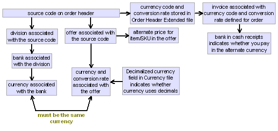

Relationships: This flowchart explains the relationships that exist when you use alternate currency pricing.

Determining the local currency and the alternate currency: The local currency is from the Local Currency Code (A55) system control value. An offer is associated with an alternate currency only if you define a currency code different from the Local Currency Code system control value, along with a conversion rate, for the offer.
Currency calculations: The system multiplies the amount in the local currency by the conversion rate to determine the amount in the alternate currency. Likewise, the system divides the amount in the alternate currency by the conversion rate to determine the amount in the local currency.
Local currency to alternate currency: The system uses this calculation when converting the local currency to the alternate currency: local amount x conversion rate = alternate (foreign) amount.
Alternate currency to local currency: The system uses this calculation when converting the alternate currency to the local currency: alternate (foreign) amount / conversion rate = local amount.

Alternate Currency Pricing Setup
Before you use alternate currency pricing, you must perform the necessary setup. Information requiring creation and setup includes:
System control values:
System Control Value
Description
Use Alternate Currency Pricing (H89)
Select this field to indicate you wish to use alternate currency pricing.
Multi Currency by Offer (E03)
Select this field to indicate you are not using multiple currency by offer functionality. You cannot use both alternate currency pricing and multiple currency by offer. See Comparing Alternate Currency Pricing with Multiple Currency by Offer for a comparison.
Define the currency code that represents the local currency code. Any other currency code represents an alternate (foreign) currency.
Credit Card Credit Acknowledgment Print Program (D22)
Define the print program used to print credit card credit acknowledgments. The base print program is CSR0559.
Refund Check Print Program (D23)
Define the print program used to print refund checks. Only print program CSR0561 prints the alternate currency amount.
Default Price Override Reason (B35)
Define the price override reason code the system uses when the calculated local price on the order detail line differs from the local price from the offer associated with the source code on the order header.
Menu options:
Menu Option
Description
Working with Currency (WCUR)
Define the currency and indicate whether the currency uses decimals.
Working with Banks (WBNK)
Create a bank for the currency.
Working with Divisions (WDIV)
Create a division for the currency, specifying the bank.
Working with Pay Types (WPAY)
Create each foreign pay type. Define the authorization service and deposit service for the pay type.
Working with Offers (WOFR)
Create offers and indicate the currency code and conversion rate for each offer. If the offer is for the local currency, you can leave the currency code and conversion rate blank.
Assigning Items/SKUs to Offers (MITM)
Define the alternate price for each item/offer and SKU/offer. You can also enter an alternate price for item price breaks or SKU price breaks.
You can also use these menu options to define the alternate price for each item/offer and SKU/offer:
Creating Item/SKU Offers (MISO)
Updating Item/SKU Offers (MUSO)
Copying SKU Offer Information (MCSO)
Working with Source Codes (WSRC)
Create source codes for each offer. The offer and division must both point to the same currency.
Setting Up Authorization Services (WASV)
Define a pay type cross reference and currency cross reference for the authorization and settlement service.
This table compares using alternate currency pricing against using multiple currency by offer. You can use this comparison to determine the type of foreign currency functionality you wish to use in Order Management System. You cannot use both alternate currency pricing and multiple currency by offer.
define the currency code for each bank.
indicate whether the currency uses decimals. If the currency does not use decimals, the system rounds to the nearest whole unit of currency.
define the shadow entity for the currency. All currencies use decimals.
define a currency code and conversion rate for each offer.
define a currency code for each offer; the conversion rate for the offer defaults from the Currency table.
define the item/offer and SKU/offer price in the foreign currency. The local amount is also indicated.
define the item/offer and SKU/offer price in the foreign currency. A local amount does not display.
store order amounts and totals in the local currency; however you can enter or review the amounts in the foreign currency.
store order amounts and totals in the foreign currency; the system converts the order values to your local currency when you enter the order and when the order is billed. The currency of the order is on the order header.
store the currency code and conversion rate for the order in the Order Header Extended table.
display the amount on the pick slip in the local currency.
display the amount on the pick slip in the foreign currency.
display the amounts on customer related reports in the local currency and alternate currency.
display the amounts on customer related reports in the foreign currency.
store invoice amounts in the local currency.
store invoice amounts in the foreign currency.
process refunds in the local currency. On refund reports, the refund amount is in the local currency and alternate currency.
process refunds in the foreign currency. On reports, the refund amount is in the foreign currency.
CS01_12 OMS 18.0 November 2018 OTN
