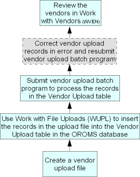

Vendor upload process:
Note: You can also schedule this process to run periodically by setting up the VNUPLD function using the PRF0086 program. See Scheduling Jobs for background.

You can create a Vendor Upload file by:
• creating your own pipe delimited file, using a text editor or spreadsheet application, or
• copying the sample file upload data, pasting the data into a text editor, and saving it with the file extension .txt.

Transfer the Vendor Upload File to Order Management System
Use the File Storage API if it is enabled and run the UPVENDR Upload Vendor File (Program name PFR0134, Parameter VNDUPL) periodic function, or
Place the file in the CWDIRECTCP_UPLOAD_ DIRECTORY, and run the UPVENDR Upload Vendor File (Program name PFR0134, Parameter VNDUPL) periodic function, or
Use the Work with File Uploads (WUPL) menu option to select and process the Vendor Upload file. The system inserts the records in the Vendor Upload file into the Order Management System Vendor Upload table. See File Upload Process for processing information.
