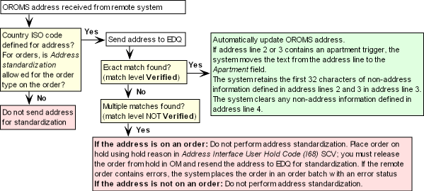

Remote Address Standardization
Order API: The system sends address information for standardization when you create or update the sold to address, bill to address, or ship to address on an order received through the Order API.
Note: The system will still send address information for standardization if the order contains the customer number instead of the customer name and address information, even if the existing customer address has already been previously cleansed.
Catalog Request Interface: The system sends address information for standardization when you create an address on a catalog request, including:
• catalog requests created using the E-Commerce Catalog Request Message (CWCatRequest); see E-Commerce Catalog Requests.
• catalog requests created through records that have been uploaded to the Catalog Request Interface table (IXCRIN); see Working with the Catalog Request Interface (WCRU).
Note: The system does not send address information for standardization when you update an address on the Change Catalog Request Screen in the Work with Catalog Request Interface (WCRU) menu option; when you submit the catalog request for processing at the Work with Catalog Request Interface Screen, the system will send the address information for cleansing.
Customer API: The system sends address information when you create or change a customer record through the Generic Customer API if the Perform Address Standardization in Customer API (I99) system control value is selected and you are using address standardization.

Interactive Address Standardization Process Illustration
Remote Address Standardization Process Illustration

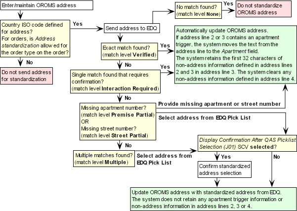

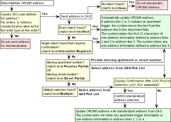

EDQ Address Standardization Process Flow
The system determines if a Order Management System address requires standardization each time you create a new address or update the following fields on an existing address:
• Street address
• Apartment/Suite
• Address lines 2-4
• City
• State/Province code
• Postal code
• Country code
Address Standardization Requirements
In order to send an address for standardization the following requirements must be met.
Requirement
Description
The EDQ Address interface must be enabled
• If the Use QAS Address Interface (I67) system control value is selected, the system uses the EDQ integration.
• If the Use QAS Address Interface (I67) system control value is unselected, the system does not retrieve address information from EDQ and instead, retains the Order Management System address.
See EDQ Setup for additional information on the required setup for the EDQ integration.
A country ISO code must be defined for the address
Country ISO codes are codes representing the international standard code used to identify a country. When the system sends address information for validation and standardization, the system sends the Country ISO code defined for the country instead of the Country code as the country code defined for the address. For example, the country code for the United States may be US and the country ISO code may be USA.
The country ISO codes supplied by EDQ for Canada and the United States are CAN and USA. You can define a country ISO code for a country in the Work with Countries (WCTY) menu option.
• If a country ISO code is defined for the address, the system sends the address for standardization.
• If a country ISO code is not defined for the address, the system does not send the address for standardization.
Note: The Order Management System integration with EDQ supports address standardization for United States and Canadian addresses; it does not support address standardization for European countries at this time.
If the address is on an order, the order type must be eligible for standardization
• If the Address standardization field for the order type is selected, the order is eligible for address standardization and the system sends the address for standardization.
• If the Address standardization field for the order type is unselected, the order is not eligible for address standardization and the system retains the Order Management System address.
If the address meets the Address Standardization Requirements, the system sends the following address fields to EDQ:
• Street address
• Apartment/Suite
• Address lines 2-3 (The system does not send address line 4)
• City
• Postal code
• Country ISO code
Once the address search completes, EDQ sends a response back to Order Management System. The EDQ Address Response Match Level returned determines the action Order Management System performs; see EDQ Address Response Match Level for more information.
Address map: The Serenade data map defines how the address information returned by EDQ is mapped to the Order Management System address. This map also defines whether the address data is returned in upper case letters and how non-address information is retained. See Serenade Map for more information.
Duplicate checking: The system sends an address for standardization prior to any duplicate customer checking. Once the address has been standardized, the system then determines if a duplicate address match already exists for the address.
Retaining Non-Address Information in Address Lines 1-4
If address lines 1, 2, or 3 contains non-address information, such as LEAVE PACKAGES ON FRONT PORCH, the EDQ Address Response Match Level determines whether EDQ retains the non-address information.
Note: When entering non-address information for an address on an order, use the Attention field to retain the non-address information for the order.
Match Level
Non-Address Information Results
None
The system retains any non-address information defined in address lines 1, 2, 3 and 4.
Verified
The system retains the first 32 characters of non-address information defined in address lines 1, 2, and 3 in address line 3. The system clears any non-address information defined in address line 4.
Premise Partial
Street Partial
Multiple
Interaction Required
The system does not retain the non-address information defined in address lines 1, 2, 3, and 4.
See Address Examples for examples of how EDQ standardizes an address and whether non-address information is retained.
Purpose: The address response match level returned by EDQ determines the action Order Management System performs.
Match Level
Address Results
None
EDQ does not update the Order Management System address because it could not find a match to the address.
Remote address standardization: The system does not standardize the Order Management System address. If the address is on a remote order and a hold reason is defined in the Address Interface User Hold Code (I68) system control value, the system places the order on user hold.
If a hold reason is not defined in the Address Interface User Hold Code (I68) system control value, the system does not assign a hold reason to a remote order at the user level.
• If the remote order does not contain any errors, the system creates the order in an open status.
• If the remote order contains errors, the system places the order in an order batch with an error status.
Interactive address standardization: The system displays the Address Standardization: No Address Match Found Screen. At this screen you can select to return to the Order Management System screen and either:
• Retain the Order Management System address without any updates from EDQ.
• Update the Order Management System address to resend it for standardization.
Apartment Triggers: EDQ does not apply apartment triggers when the match level is None. See Apartment Triggers.
Non-Address Information: The system retains any non-address information defined in address lines 1, 2, and 3 in address line 3. See Retaining Non-Address Information in Address Lines 1-4.
See Match Level None Example.
Verified
EDQ found one address match with a high level of confidence. The system automatically updates the Order Management System address with the address returned by EDQ.
Apartment Triggers: If address lines 2 or 3 contains an apartment trigger, the system moves the text from the address line to the Apartment field. See Apartment Triggers.
Non-Address Information: The system retains the first 32 characters of non-address information defined in address lines 1, 2, and 3 in address line 3. The system clears any non-address information defined in address line 4. See Retaining Non-Address Information in Address Lines 1-4.
See Match Level Verified Example.
EDQ found a single match to the Order Management System address but requires you to confirm the address update.
Interactive address standardization: The system displays the Address Standardization: Verify Recommendation Screen. At this screen you can:
• Update the Order Management System address with the recommended address returned by EDQ.
Apartment Triggers: If address line 2 or 3 contains an apartment trigger, the system moves the text from the address line to the Apartment field. See Apartment Triggers.
Non-Address Information: The system does not retain the non-address information defined in address lines 1, 2, 3, and 4.
See Match Level Interaction Required Example.
Interactive address standardization: The system displays the Address Standardization: Verify Apartment/Suite Number Screen. At this screen you can:
• Provide the missing apartment number and standardize the Order Management System address.
• Note: If you provide an apartment number that EDQ does not recognize as a valid apartment number, the system does not update the address with the apartment number you provided. Instead, you remain on the Verify Apartment/Suite Number screen until you provide a valid apartment number; you can review the pick list returned by EDQ to determine the valid apartment numbers for the address.
• Display a list of possible address matches in a pick list returned by EDQ and replace the Order Management System address with a standardized address selected from the pick list.
Note: The address matches in the pick list returned by EDQ provide an idea of the acceptable range of apartment numbers you can define for the address.
• If an address in the pick list displays as a hyperlink, you can select the address from the pick list to replace the Order Management System address with this standardized address.
• If an address in the pick list does not display as a hyperlink, you can enter the apartment number defined for the address in the Apartment number field to standardize the Order Management System address.
Non-Address Information: The system retains the first 32 characters of non-address information defined in address lines 1, 2, and 3 in address line 3. Address line 4 will be cleared of any non-address information.
Apartment Triggers:
• If you provide an apartment number for the address, and address line 2 or 3 contains an apartment trigger, the system moves the text from the address line to the Apartment field.
• If you select an address from the pick list returned by EDQ, EDQ does not apply apartment triggers to the address.
See Match Level Premise Partial Example.
Street Partial
EDQ found a match to the Order Management System address, but requires you to provide the street number for the address or select an address from a list of valid addresses returned by EDQ.
Interactive address standardization: The system displays the Address Standardization: Verify Street Number Screen. At this screen you can:
• Provide the missing street number and standardize the Order Management System address.
• Note: If you provide a street number that EDQ does not recognize as a valid street number, the system does not update the address with the street number you provided. Instead, you remain on the Verify Street Number screen until you provide a valid street number; you can review the pick list returned by EDQ to determine the valid street numbers for the address.
Note: The address matches in the pick list returned by EDQ provide an idea of the acceptable range of street numbers you can define for the address.
- If an address in the pick list displays as a hyperlink, you can select the address from the pick list to replace the Order Management System address with this standardized address returned from EDQ.
- If an address in the pick list does not display as a hyperlink, you can enter the street number defined for the address in the Street number field to standardize the Order Management System address.
Apartment Triggers:
• If you provide a street number for the address, and address line 2 or 3 contains an apartment trigger, the system moves the text from the address line to the Apartment field.
See Match Level Street Partial Example.
Multiple
EDQ found multiple matches to the Order Management System address and requires you to select an address from the list of valid addresses.
Interactive address standardization: The system displays the Address Standardization: Select from Multiple Addresses Screen. At this screen you can:
Apartment Triggers: EDQ does not apply apartment triggers when the match level is Multiple.
See Match Level Multiple Example.

Order Management System sends the address to EDQ for standardization. EDQ returns a match level of Street Partial, indicating it found multiple matches to the Order Management System address and requires you to select an address from a list of valid addresses.
The system displays the Address Standardization: Select from Multiple Addresses Screen. At this screen, you select an address from the pick list.
The system standardizes the Order Management System address.
Standardized Address:
street address:
address line 3:
city/state/zip/country:
PO BOX 1234
FAN CLUB MAIL CABLE CHANNEL
NEW YORK NY 10002-0915 US
Purpose: This screen indicates that EDQ could not find a match for the Order Management System address.
How to display this screen: This screen displays during Interactive Address Standardization when the EDQ Address Response Match Level returned by EDQ is None.
Screen Option
Procedure
Return to the Order Management System screen where you can either:
• Retain the Order Management System address without any updates from EDQ, or
• Update the Order Management System address to resend it to EDQ for standardization
Select Select/Edit. The system returns you to the Order Management System screen and does not standardize the address.
The system determines if the address requires standardization the next time you create the address or update the address; see EDQ Address Standardization Process Flow.
Purpose: Use this screen to confirm the address match returned by EDQ.
How to display this screen: This screen displays during Interactive Address Standardization when the EDQ Address Response Match Level returned by EDQ is Interaction Required, indicating EDQ found a single match to the Order Management System address but requires you to confirm the address update.
Screen Option
Procedure
Select Select. The system returns you to the Order Management System screen and standardizes the address.
Purpose: Use this screen to provide the missing apartment number for the Order Management System address or select an address from the pick list returned by EDQ.
How to display this screen: This screen displays during Interactive Address Standardization when the EDQ Address Response Match Level returned by EDQ is Premise Partial, indicating EDQ found a match to the Order Management System address but the address is missing the apartment number.
Screen Option
Procedure
Provide the missing apartment/suite number and update the Order Management System address with the recommendations returned by EDQ
Enter the apartment/suite number in the Apartment number field and select OK. The system returns you to the Order Management System screen and standardizes the address.
Apartment preface: When you enter the apartment/suite number, make sure you preface the number with apartment text, such as APT or STE; for example APT D. See Apartment Triggers for a list of valid apartment text that you can enter before the number.
Note: If you provide an apartment number that EDQ does not recognize as a valid apartment number, the system does not update the address with the apartment number you provided. Instead, you remain on the Address Standardization: Verify Apartment/Suite Number Screen until you provide a valid apartment number; you can review the pick list returned by EDQ to determine the valid apartment numbers for the address.
Display a list of possible address matches returned by EDQ
Select Matches to display a list of valid address returned by EDQ.
The address list indicates the valid apartment numbers available for the address. You can use this list to determine the apartment number to enter in the Apartment number field, or if an address displays as a hyperlink, you can select it.
When you select one of these matches:
• If the Display Confirmation After QAS Picklist Selection (J01) system control value is selected, the system advances you to the Address Standardization: Verify Recommendation (from Pick List) Screen where you can confirm the address before making any updates.
• If the Display Confirmation After QAS Picklist Selection (J01) system control value is unselected, the system returns you to the Order Management System screen and standardizes the address.
Purpose: Use this screen to provide the missing street number for the Order Management System address or to select an address from the pick list returned by EDQ.
How to display this screen: This screen displays during Interactive Address Standardization when the EDQ Address Response Match Level returned by EDQ is Street Partial, indicating EDQ found a match to the Order Management System address but the address is missing the street number.
Screen Option
Procedure
Provide the missing street number and update the Order Management System address with the recommendations returned by EDQ
Enter a valid street number in the Street number field and select OK. The system returns you to the Order Management System screen and standardizes the address.
Note: If you provide a street number that EDQ does not recognize as a valid street number, the system does not update the address with the street number you provided. Instead, you remain on the Address Standardization: Verify Street Number Screen until you provide a valid street number; you can review the pick list returned by EDQ to determine the valid street numbers for the address.
Select Matches to review a list of possible address matches returned by EDQ.
The address list indicates the valid street numbers available for the address. You can use this list to determine the street number to enter in the Street number field, or if an address displays as a hyperlink, you can select it.
Purpose: Use this screen to select an address from the pick list returned by EDQ.
How to display this screen: This screen displays during Interactive Address Standardization when the EDQ Address Response Match Level returned by EDQ is Multiple, indicating EDQ found multiple matches to the Order Management System address and requires you to select an address from the list of valid addresses returned by EDQ.
Screen Option
Procedure
Select an address from a list of possible matches
Select an address from the list of valid addresses returned from EDQ.
• If the Display Confirmation After QAS Picklist Selection (J01) is selected, the system advances you to the Address Standardization: Verify Recommendation (from Pick List) Screen where you can confirm the address before making any updates.
• If the Display Confirmation After QAS Picklist Selection (J01) is unselected, the system returns you to the Order Management System screen and standardizes the address.
Purpose: This screen allows you to review the address you selected from the pick list returned by EDQ before updating the Order Management System address.
How to display this screen: This screen displays during Interactive Address Standardization when you select an address from a list of valid addresses returned by EDQ on the following screens and the Display Confirmation After QAS Picklist Selection (J01) system control value is selected:
• Address Standardization: Verify Apartment/Suite Number Screen
• Address Standardization: Verify Street Number Screen
• Address Standardization: Select from Multiple Addresses Screen
Screen Option
Procedure
Select the address that you have selected from the pick list returned by EDQ
Display a list of possible address matches returned by EDQ and update the Order Management System address with the updates defined for one of these addresses
When you select one of these matches, the system displays the address under the Recommended Address section of the screen for you to review.

Example: The following non-address information was defined in address lines 2 and 3 for the Order Management System address:
KAT’S FRUITS AND VEGETABLES
EDQ moves the first 32 characters of this information to address line 3:
KAT’S FRUITS AND VEGETABLES LEAV
See Retaining Non-Address Information in Address Lines 1-4 for more information.
Address line 4
EDQ clears address line 4 of any information.
Apartment
EDQ updates this field with a valid apartment/suite/unit number and includes an abbreviation such as APT or STE.
Example: APT 3
Apartment Triggers
Certain text in address lines 2 and 3 and the EDQ Address Response Match Level triggers EDQ to move the text to the Apartment field on an address. For example, if you enter NO 3 in Address line 2, the system moves this text to the Apartment field.
See Apartment Triggers for a list of the text that EDQ will move from address lines 2 and 3 to the Apartment field. Any number that follows this text is also moved to the Apartment field.
City
EDQ updates this field with the valid city name for the address.
Example: WESTBORO updates to WESTBOROUGH
State code
EDQ updates this field with the valid state code for the address.
Example: MA
Postal code
EDQ updates this field with the valid zip + 4 postal code for the address.
Example: 01468 updates to 01468-1566.
Country code
EDQ translates the ISO country code for the address to the associated country code defined in Order Management System.
Example: US
OE_APP_E OMSCS 18.1 April 2019 OTN
