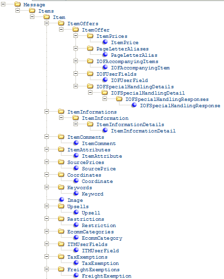

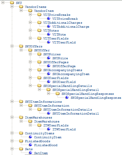

• Item Download XML Message (CWItemOut)
- Item Download Message: Sample XML

For each item download trigger, the Item Outbound message builder determines which elements to include in the item download message, based on XML inclusion rules.
You can define Item Outbound XML inclusion rules at the Outbound Interface XML Inclusion Screen.
XML inclusion defines which elements to include in the item download message.
• If the element is included, that element and its parents are included in the generated item download XML message.
• If the element is excluded, that element and its children are excluded from the generated item download message.
This table indicates which elements in the item download message are included, based on which elements you flag to include or exclude.
Include element in XML message? |
Element |
Selected = Include Item Unselected = Exclude Item and all of its children; the system sends a message with only the Message element and its attributes |
Item |
Selected = Include ItemOffer and its parent Item Unselected = Exclude ItemOffer and its children ItemPrice, PageLetterAlias, IOFAccompanyingItem, IOFUserField, IOFSpecialHandlingDetail and IOFSpecialHandlingResponse |
ItemOffer |
Selected = Include ItemPrice and its parents, ItemOffer and Item Unselected = Exclude ItemPrice |
ItemPrice |
Selected = Include PageLetterAlias and its parents ItemOffer and Item Unselected = Exclude PageLetterAlias |
PageLetterAlias |
Selected = Include IOFAccompanyingItem and its parents ItemOffer and Item Unselected = Exclude IOFAccompanyingItem |
Selected = Include IOFUserField and its parents ItemOffer and Item Unselected = Exclude IOFUserField |
IOFUserField |
Selected = Include IOFSpecialHandlingDetail and its parents ItemOffer and Item Unselected = Exclude IOFSpecialHandlingDetail and its child IOFSpecialHandlingResponse |
IOFSpecialHandlingDetail |
Selected = Include IOFSpecialHandlingResponse and its parents IOFSpecialHandlingDetail, ItemOffer, and Item Unselected = Exclude IOFSpecialHandlingResponse |
Selected = Include ItemComment and its parent Item Unselected = Exclude ItemComment |
ItemComment |
Selected = Include ItemAttribute and its parent Item Unselected = Exclude ItemAttribute |
ItemAttribute |
Selected = Include SourcePrice and its parent Item Unselected = Exclude SourcePrice |
SourcePrice |
Selected = Include Coordinate and its parent Item Unselected = Exclude Coordinate |
Coordinate |
Selected = Include Keyword and its parent Item Unselected = Exclude Keyword |
Keyword |
Selected = Include Image and its parent Item Unselected = Exclude Image |
Image |
Selected = Include Restriction and its parent Item Unselected = Exclude Restriction |
Restriction |
Selected = Include ITMUserField and its parent Item Unselected = Exclude ITMUserField |
ITMUserField |
Selected = Include TaxExemption and its parent Item Unselected = Exclude TaxExemption |
TaxExemption |
Selected = Include FreightExemption and its parent Item Unselected = Exclude FreightExemption |
FreightExemption |
Selected = Include SKU and its parent Item Unselected = Exclude SKU and all of its children VendorItem, SKUItemInformation, ItemWarehouse, FinishedGood, SetItem, VariableSet, SKUComment, SKUAttribute, UPC, SKUUserField |
SKU |
Selected = Include VendorItem and its parents SKU and Item Unselected = Exclude VendorItem and its children VITPriceBreak, VITAdditionalCharge, VITNote, and VITUserField |
VendorItem |
Selected = Include VITPriceBreak and its parents VendorItem, SKU, and Item Unselected = Exclude VITPriceBreak |
VITPriceBreak |
Selected = Include VITAdditionalCharge and its parents VendorItem, SKU, and Item Unselected = Exclude VITAdditionalCharge |
VITAdditionalCharges |
Selected = Include VITNote and its parents VendorItem, SKU, and Item Unselected = Exclude VITNote |
VITNote |
Selected = Include VITUserField and its parents VendorItem, SKU, and Item Unselected = Exclude VITUserField |
VITUserField |
Selected = Include SKUOffer and its parents SKU and Item Unselected = Exclude SKUOffer and its children SKUPrice, SKUOfferPage, SKOAccompanyingItem, SKOUserField, and SKOSpecialHandlingDetail |
SKUOffer |
Selected = Include SKUPrice and its parents SKUOffer, SKU and Item Unselected = Exclude SKUOfferPage |
SKUPrice |
Selected = Include SKUOfferPage and its parents SKUOffer, SKU, and Item Unselected = Exclude SKUOfferPage |
SKUOfferPage |
Selected = Include SKOAccompanyingItem and its parents SKUOffer, SKU, and Item Unselected = Exclude SKOAccompanyingItem |
Selected = Include SKOUserField and its parents SKUOffer, SKU, and Item Unselected = Exclude SKOUserField |
SKOUserField |
Selected = Include SKOSpecialHandlingDetail and its parents SKUOffer, SKU, and Item Unselected = Exclude SKOSpecialHandlingDetail and its child SKOSpecialHandlingResponse |
Selected = Include SKOSpecialHandlingResponse and its parents SKOSpecialHandlingDetail, SKUOffer, SKU, and Item Unselected = Exclude SKOSpecialHandlingResponse |
Selected = Include SKUItemInformation and its parents SKU and Item Unselected = Exclude SKUItemInformation and its child SKUItemInformationDetail |
SKUItemInformation |
Selected = Include SKUItemInformationDetail and its parents SKUItemInformation, SKU, and Item Unselected = Exclude SKUItemInformationDetail |
Selected = Include ItemWarehouse and its parents SKU and Item Unselected = Exclude ItemWarehouse and its child ITWUserField |
ItemWarehouse |
Selected = Include ITWUserField and its parents ItemWarehouse, SKU, and Item Unselected = Exclude ITWUserField |
ITWUserField |
Selected = Include FinishedGood and its parents SKU and Item Unselected = Exclude FinishedGood |
FinishedGood |
Selected = Include SetItem and its parents SKU and Item Unselected = Exclude SetItem |
SetItem |
Selected = Include VariableSet and its parents SKU and Item Unselected = Exclude VariableSet and its children VariableSetGroup and VariableSetItem |
VariableSet |
Selected = Include VariableSetGroup and its parents VariableSet, SKU, and Item Unselected = Exclude VariableSetGroup and its child VariableSetItem |
VariableSetGroup |
Selected = Include VariableSetItem and its parents VariableSetGroup, VariableSet, SKU, and Item Unselected = Exclude VariableSetItem |
VariableSetItem |
Selected = Include SKUComment and its parents SKU and Item Unselected = Exclude SKUComment |
SKUComment |
Selected = Include SKUAttribute and its parents SKU and Item Unselected = Exclude SKUAttribute |
SKUAttribute |
Selected = Include UPC and its parents SKU and Item Unselected = Exclude UPC |
UPC |
Selected = Include SKUUserField and its parents SKU and Item Unselected = Exclude SKUUserField |
SKUUserField |
The item download message contains item and SKU information to send from Order Management System to another system, such as a retail store or warehouse management system. See Generic Item Download API for an overview.
Message formatting specific to item download:
• Delete transactions contain all elements (based on XML inclusion rules) since an item can be identified using fields other than Item number and SKU code.
• For non-SKU’d items, the SKU element does not include the SKU_Code attribute. The following elements are not included for non-SKU’d items:
- SKUOffer and its children, SKUPrice, SKUOfferPage, SKOAccompanyingItem, SKOUserField, SKOSpecialHandlingDetail, SKOSpecialHandlingResponse.
- SKUItemInformations and its children, SKUItemInformation, SKUItemInformationDetails, and SKUItemInformationDetail.
- SKUComments and its child, SKUComment.
- SKUAttributes and its child, SKUAttribute.
- SKUUserFields and its child, SKUUserField.
• If you exclude the element Item and all of its children (using the Item Outbound XML Inclusion rules), the system sends an item download message including the Message element and Items element with no attributes.
• Explicit decimal points are included in numeric fields.
See Generic Download Message Formatting for more information on how the system formats all download messages.
Item elements:
SKU elements:
Item download message: See Item Download Message: Sample XML for a sample message.

The ItemPrice element repeats for each item price record defined for the item in the Item Price table. |

The PageLetterAlias element repeats for each page letter alias record defined for the item offer in the Page Letter Alias table. |

The IOFAccompanyingItem element repeats for each accompanying item record defined for the item offer in the Accompanying Item table. |

The IOFUserField element repeats for each item offer user field record defined for the item offer in the Item Offer User Field table. |

The IOFSpecialHandlingDetail element repeats for each special handling detail record defined for the item offer in the Item Offer User Field table. |

The IOFSpecialHandlingResponse element repeats for each item information record defined for the item’s class in the Item Class Template table. |

The ItemComment element repeats for each item comment defined for the item in the SKU Comments table. |

The ItemAttribute element repeats for each item attribute defined for the item in the Item Attribute table. |

The SourcePrice element repeats for each source price for the item in the Special Pricing by Source table. |

The Coordinate element repeats for each coordinate for the item in the Item Coordinate table. |

The Keyword element repeats for each keyword for the item in the Keyword table. |

The Restriction element repeats for each item restriction defined for the item in the Item Restriction by Country/State table. |

The ITMUserField element repeats for each item user field defined for the item in the Item User Field table. |

The TaxExemption element repeats for each tax exemption defined for the item in the Item Tax Exempt table. |

The FreightExemption element repeats for each freight exemption defined for the item in the Freight Exemption table. |

Each item download message contains one Item element and one SKU element. For example, if you update a SKU’ed item, the system generates a separate item download message for each SKU. |
SKU_Code |
alpha |
14 |
The SKU code for the item, such as style, color, and/or size. From the SKU code field in the SKU table. |

The VITPriceBreak element repeats for each vendor price break defined for the vendor item in the Vendor Item Price Break table. |
Start_date |
numeric |
7 |
The date when the special price promotion or quantity break price begins. From the Start date field in the Vendor Item Price Break table. |
Quantity |
numeric |
7 |
The quantity (in retailer’s unit of measure), that you must purchase to receive the special promotional price or quantity break price on the item from the vendor. From the Quantity field in the Vendor Item Price Break table. |
Price |
numeric |
11.4 |
The vendor’s special price, per vendor’s unit of measure, for the item if you order the quantity required (in retailer’s unit of measure). From the Price field in the Vendor Item Price Break table. |
Stop_date |
numeric |
7 |
The date when the special price promotion or quantity break price ends. From the Stop date field in the Vendor Item Price Break table. |

The SKUOffer element repeats for each SKU offer record defined for the SKU in the SKU Offer table. |
Offer_Number |
alpha |
3 |
A code that represents the offer where the SKU is advertised. From the Offer number field in the SKU Offer table. |
Gift_wrap_flag |
alpha |
1 |
Indicates if the SKU is eligible for gift wrap. • Y = The SKU is eligible for gift wrap. • N = The SKU is not eligible for gift wrap. From the G/W flag field in the SKU Offer table. |
SH_price |
numeric |
7.2 |
The price to charge the customer for special handling. From the S/H price field in the SKU Offer table. |
Special_handling_flag |
alpha |
1 |
Indicates if the SKU is eligible for any type of special handling in the offer. • Y = The SKU is eligible for special handling. • N = The SKU is not eligible for special handling. From the S/H flag field in the SKU Offer table. |
Term_payment_interval |
numeric |
5 |
The number of days between payments. From the Term payment interval field in the SKU Offer table. |
Gift_wrap_price |
numeric |
7.2 |
The price for gift wrapping the SKU. From the G/W price field in the SKU Offer table. |
Freight |
numeric |
6.2 |
The freight amount to charge for the SKU in the offer. From the Freight field in the SKU Offer table. |
Hidden_freight |
numeric |
6.2 |
The hidden freight amount to charge for the SKU in the offer. From the Hidden freight field in the SKU Offer table. |
SKO_Coupon_discount_dlr |
numeric |
7.2 |
The coupon dollar amount that is subtracted from the price when the SKU is ordered in the offer. From the Coupon discount $ field in the SKU Offer table. |
SKO_Coupon_effective_date |
numeric |
7 |
The date the coupon becomes effective. From the Coupon effective field in the SKU Offer table. |
SKO_Volume_discountable |
alpha |
1 |
Indicates if the SKU is eligible for a volume discount. • Y = The SKU is eligible for a volume discount. • N = The SKU is not eligible for a volume discount. From the Volume disc? field in the SKU Offer table. |
SKO_Featureoption |
alpha |
1 |
A code that indicates if the SKU is considered a featured item in a depiction in the offer. • F = The SKU is a featured item in the depiction. • O = The SKU is an optional item in the depiction. From the Feature/option field in the SKU Offer table. |
SKO_Pickupnew |
alpha |
1 |
A code that indicates if the SKU has been carried over from a previous offer or is new to your product offerings. • P = The SKU is a pickup item, previously sold in an offer. • N = The SKU is a new addition to your offer. From the Pickup/new field in the SKU Offer table. |
SKO_Sale_Book_ Item_Flag |
alpha |
1 |
Indicates if the SKU is on sale in the offer. • Y = The SKU is a sale item. • N = The SKU is not a sale item. From the SKO sale book item flag field in the SKU Offer table. If the Exclude Sale Item When Prorating Discounts (I65) system control value is selected, this flag controls whether the item is included in prorated discounts or is included when determining whether an order qualifies for a promotion. See the system control value for more information. |
SKO_Qty_Break_Upsl_Thrshd |
numeric |
7 |
From the SKO qty break upsl thrshd field in the SKU Offer table. |

The SKUPrice element repeats for each SKU price record defined for the SKU in the SKU Price table. |
Effective_date |
numeric |
7 |
The date the price or quantity break becomes valid. From the Effective date field in the SKU Price table. |

The SKUOfferPage element repeats for each SKU offer page record defined for the SKU in the SKU Offer Page table. |
Alias_item |
alpha |
12 |
The alternate item code for the SKU. From the Alias item field in the SKU Offer Page table. |
The SKOAccompanyingItem element repeats for each accompanying item record defined for the SKU in the Accompanying Item table. |
ACI_Qty_required |
numeric |
5 |
The amount of the SKU that must be ordered to receive the accompanying item. From the Qty req’d field in the Accompanying Item table. |
ACI_Qty |
numeric |
5 |
The number of accompanying items to add to the order. From the Qty field in the Accompanying Item table. |
ACI_Free_gift |
alpha |
1 |
Indicates if the accompanying item is a free gift. • Y = The accompanying item is a free gift. • N = The accompanying item is not free of charge. From the Free gift? field in the Accompanying Item table. |
ACI_Use_Ordered_Qty |
alpha |
1 |
Indicates if the accompanying item is ordered in the same quantity as the qualifying item. • Y = The accompanying item is ordered in the same quantity as the qualifying item. • N = The accompanying item is not ordered in the same quantity as the qualifying item. From the ACI use ordered qty? field in the Accompanying Item table. |
ACI_ITM_Number |
alpha |
12 |
The accompanying item to add to the order if the customer orders the required quantity of the qualifying item. From the ACI ITM number field in the Accompanying Item table. |
ACI_SKU_Code |
alpha |
14 |
The SKU of the accompanying item. From the ACI SKU code field in the Accompanying Item table. |
