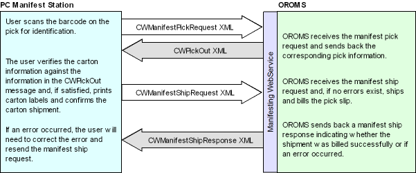

PC Manifesting Process Overview
Purpose: Use the PC Manifesting interface to process shipment confirmations between a PC manifesting system and Order Management System.
Voiding or unshipping a shipment confirmation: The current PC Manifesting interface between Order Management System and a PC manifest system does not provide the ability to unship a package or send a void request from the manifest station to Order Management System.
PC Manifesting Process:
The typical shipment confirmation process between a PC manifest system and Order Management System includes the following steps.
1. You generate pick slips for an order and send the pick slip information to the warehouse for fulfillment.
2. A user in the warehouse uses the pick slip to fulfill the order, packaging the items in one or more cartons. Optionally, you can use Working with Pick/Pack Verification (WPPV) to confirm the cartons are packed correctly.
3. A user at the PC manifest station scans the barcode on the pick slip in order to request package information from Order Management System.
Typically, the pick slip barcode includes the company code, pick control number, and pick control label number.
4. The manifest station sends a Manifest Pick Request Message (CWManifestPickRequest) to Order Management System. The CWManifestPickRequest message includes the Order Management System company code and pick control number, and optionally, the pick control label number.
5. Order Management System receives the Manifest Pick Request Message (CWManifestPickRequest) and determines if a pick slip exists for the company code, pick control number, and optionally, pick control label number defined in the CWManifestPickRequest message.
If a pick slip exists for the company, pick control number, and pick control label number specified, Order Management System:
• uses records in the Pick Control Header and Pick Control Detail tables to generate a Pick Message from Order Management System (CWPickOut) to send to the PC manifest station.
• stores a copy of the Pick Message from Order Management System (CWPickOut) in the Pick Out table. Order Management System needs to store a copy of the CWPickOut message in the Pick Out table because once the first carton for a pick control number is confirmed, the system removes the associated records from the Pick Control Header and Pick Control Detail tables. If another CWManifestPickRequest message is received from the manifest station for the pick control number, Order Management System can use the record in the Pick Out table to regenerate the CWPickOut message to resend to the manifest station.
If a pick slip does not exist for the company, pick control number, and pick control label number specified, Order Management System returns a Manifest Pick Request Message (CWManifestPickRequest) to the PC manifest station containing a description of the error in the invalid_message tag. See Manifest Pick Request Errors for a list of errors.
6. The PC manifest station receives the CWPickOut message and displays the information in the message on the manifest station screen.

7. The user at the PC manifest station verifies that the name and address information and items that display on the manifest station match the name and address information and contents of the carton at the manifesting station.
8. The user at the manifest station weighs the carton in order to enter weight information and selects the carrier to ship the carton.
9. The user at the manifest station confirms the carton shipment.
The manifest station:
• prints a label to attach to each carton. Typically, the carton label includes the following information:
- pick control number and pick control label number
- ship to customer name and address information
- carton details, such as the weight and tracking number
- name of the carrier that is shipping the carton
• sends a Manifest Ship Request Message (CWManifestShipRequest) to Order Management System, indicating the carton has been shipped and confirmed.
The CWManifestShipRequest message includes the company, pick control number and pick control label number that has been confirmed, as well as the date and time. In addition, the CWManifestShipRequest may include meter charges, the weight of the carton, the shipper used to ship the carton, and the carton’s tracking number.
Note: If the shipment is split into more than one carton, the user at the manifest station will need to confirm each carton shipment. You can print additional pick control labels using Printing Additional Pick Labels (PAPL).
10. Order Management System receives the Manifest Ship Request Message (CWManifestShipRequest) and creates an active procedure for the company code, pick control number, and pick control label number while it processes the shipment.
Shipment successful: If the Manifest Ship Request Message (CWManifestShipRequest) received from the manifest station includes valid data, Order Management System:

Shipment errors: If the Manifest Ship Request Message (CWManifestShipRequest) received from the manifest station includes invalid data, Order Management System:
• does not delete records for the pick control number in the Pick Control Header and Detail tables. The system also does not delete the record for the pick control label number in the Pick Control Label table.
• does not ship and bill the pick slip.
• returns a Manifest Ship Response Message (CWManifestShipResponse) to the PC manifest station, indicating the error that occurred. See Manifest Ship Request Errors for a list of errors.
The PC manifest station will need to resend the Manifest Ship Request Message (CWManifestShipRequest) to Order Management System once the error has been fixed.
