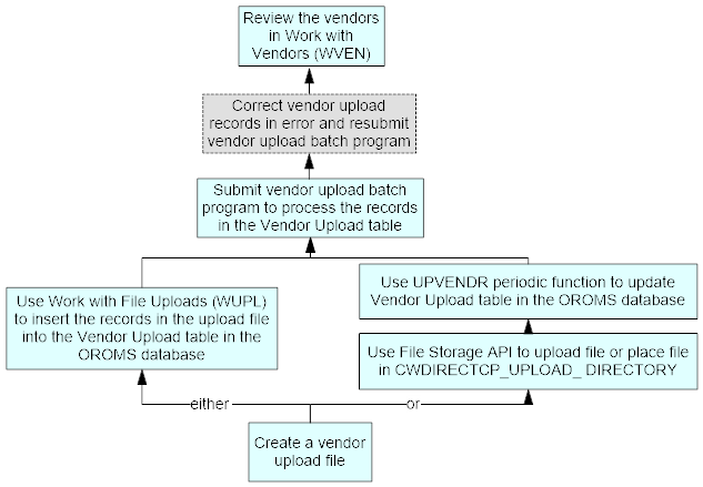

Vendor upload process:
Note: You can also schedule this process to run periodically by setting up the VNUPLD function using the PRF0086 program. See Scheduling Jobs for background.

Create Vendor Upload File
You can create a Vendor Upload file by:
• creating your own pipe delimited file, using a text editor or spreadsheet application, or
• copying the sample file upload data, pasting the data into a text editor, and saving it with the file extension .txt.
• If you wish to leave any field in the upload file blank, pass a space in an alphanumeric field and a 0 in a numeric field so that the file can be processed without errors. Leaving a field with no space or 0 is interpreted as null in the database and causes errors.
The file name should be VNDUPL.TXT.
Sample vendor upload data:
007|7|A|EXAMPLE VENDOR |1234 SAMPLE STREET |SECOND ADDRESS LINE |THIRD ADDRESS LINE |FOURTH ADDRESS LINE |WESTBOROUGH |MA|01581 |US |JOHN SMITH |5085550100| |0|ROBERT JONES |1234 REMIT SAMPLE ST |SECOND ADDRESS LINE |THIRD ADDRESS LINE |FOURTH ADDRESS LINE |SPRINGFIELD |MA|01119 |US |Y|N|Y|P|0|0|N|N|N|N|N |0|.00|.00|.00| |0| |S| |V| |VENDOR@EXAMPLE.COM |REMIT@EXAMPLE.COM |USR1 |USR2 |USR3 | |Y
Transfer the Vendor Upload File to Order Management System
Use the File Storage API if it is enabled and run the UPVENDR Upload Vendor File (Program name PFR0134, Parameter VNDUPL) periodic function, or
Place the file in the CWDIRECTCP_UPLOAD_ DIRECTORY, and run the UPVENDR Upload Vendor File (Program name PFR0134, Parameter VNDUPL) periodic function, or
Use the Work with File Uploads (WUPL) menu option to select and process the Vendor Upload file. The system inserts the records in the Vendor Upload file into the Order Management System Vendor Upload table. See File Upload Process for processing information.

Vendor Upload Process
To process: Select Submit at the Submit Vendor Upload Screen to submit the vendor upload batch program.
If you try to submit the vendor upload batch program while a vendor upload is in progress, a message indicates: VENDOR UPLOAD in progress.
The Vendor Upload batch program:
• determines if an active procedure indicates that a vendor upload batch program is already running for the company.
- If an active procedure exists, an error message indicates: Vendor Upload in progress. You cannot submit another vendor upload batch job until the job currently running is complete.
- If no active procedure exists, the system creates an active procedure for this vendor upload batch job.
• validates each vendor upload record in the Vendor Upload Table (VNDUPL).
- if the vendor upload record contains an error, the system updates the Vendor upload error field with the error message and does not transfer the record to the Vendor table. You can review vendor upload records in error on the Vendor Upload Error Report.
- if the vendor upload record is a D (delete) record type, the system updates the Vendor upload error field with the error message Delete and does not delete the Vendor record. You must manually delete the vendor.
- if the vendor upload record is an A (add) record type and passes validation, the system creates a record in the Vendor table and Vendor Extended table and deletes the corresponding vendor upload record from the Vendor Upload table.
- if the vendor upload record is an M (modify) record type and passes validation, the system updates the existing record in the Vendor table and Vendor Extended table and deletes the corresponding vendor upload record from the Vendor Upload table. Note: The system updates the existing vendor record with the information in the vendor upload record, including blanks. For example, if the vendor record has a value in the remit to name and address fields but the vendor upload record does not have these fields populated, the system updates the remit to name and address fields for the vendor to blank.
• produces the Vendor Upload Error Report, which lists each vendor upload record that contains an error. Note: Each vendor upload record in an error status is associated with only one error (the first error the system finds for the record). Once you correct the error and resubmit the vendor upload batch program, the system validates the record for additional errors.
• deletes the active procedure for the vendor upload batch program.
