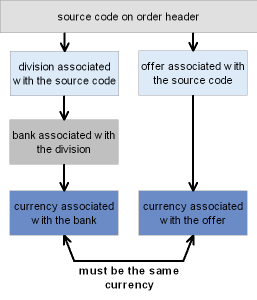

If using multiple currencies by offer: The bank code is key to your setup if you process orders in multiple currencies. The system determines that you intend to process orders in multiple currencies if the Multi Currency by Offer (E03) system control value is selected.
When processing orders in multiple currencies, you must create a separate bank for each currency you intend to use, including your local currency.
If using alternate currency pricing: You must create a separate bank for each currency you intend to use if you enable alternate currency pricing (the Use Alternate Currency Pricing (H89) system control value is selected). A currency code is required for each bank.
