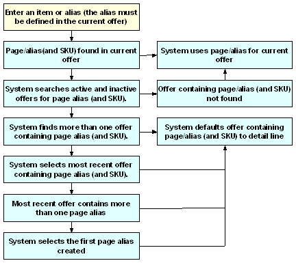

Purpose: Use this screen to define whether the system changes the offer code and alias for an item to the offer containing the item's page/alias.
Yes/no field: Select this field if you want the system to change the offer code and alias for an item to the offer containing the item's page/alias.
When you enter an item or alias in order entry, the system:
• Uses the current offer if the item's page/alias is located in the offer.
• If the current offer does not contain the page/alias or contains a page/alias but not the selected SKU, the system searches for an offer containing the item's page/alias (and SKU) and selects the most recent active or inactive offer. If the offer contains more than one page/alias, the system selects the first alias that was created. See Working with Offers (WOFR).
• If a page/alias is not found in any offer, the system uses the offer associated with the source code on the order header. See Working with Source Codes (WSRC).
Once the system selects an offer containing the page/alias (and SKU), the Offer field on the Work with Order Line screen changes to the offer containing the page/alias (and SKU). See the flow chart on the next page to see how the system searches for an offer containing a page/alias (and SKU).

How the system searches for an offer containing a page/alias:
