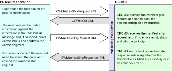

PC Manifesting Process:
The typical shipment confirmation process between a PC manifest system and Order Management System includes the following steps.
1. You generate pick slips for an order and send the pick slip information to the warehouse for fulfillment.
2. A user in the warehouse uses the pick slip to fulfill the order, packaging the items in one or more cartons. Optionally, you can use Working with Pick/Pack Verification (WPPV) to confirm the cartons are packed correctly.
3. A user at the PC manifest station scans the barcode on the pick slip in order to request package information from Order Management System.
Typically, the pick slip barcode includes the company code, pick control number, and pick control label number.
4. The manifest station sends a Manifest Pick Request Message (CWManifestPickRequest) to Order Management System. The CWManifestPickRequest message includes the Order Management System company code and pick control number, and optionally, the pick control label number.
5. Order Management System receives the Manifest Pick Request Message (CWManifestPickRequest) and determines if a pick slip exists for the company code, pick control number, and optionally, pick control label number defined in the CWManifestPickRequest message.

6. The PC manifest station receives the CWPickOut message and displays the information in the message on the manifest station screen.
Typically, the information displayed is:
• the sold to customer name and address
• the ship to customer name and address
• the order number and pick control number
• the items associated with the pick control number and label number, along with item information such as the quantity printed, the item’s weight, and harmonize code if any.
7. The user at the PC manifest station verifies that the name and address information and items that display on the manifest station match the name and address information and contents of the carton at the manifesting station.
8. The user at the manifest station weighs the carton in order to enter weight information and selects the carrier to ship the carton.
9. The user at the manifest station confirms the carton shipment.

• sends a Manifest Ship Request Message (CWManifestShipRequest) to Order Management System, indicating the carton has been shipped and confirmed.
The CWManifestShipRequest message includes the company, pick control number and pick control label number that has been confirmed, as well as the date and time. In addition, the CWManifestShipRequest may include meter charges, the weight of the carton, the shipper used to ship the carton, and the carton’s tracking number.
Note: If the shipment is split into more than one carton, the user at the manifest station will need to confirm each carton shipment. You can print additional pick control labels using Printing Additional Pick Labels (PAPL).
10. Order Management System receives the Manifest Ship Request Message (CWManifestShipRequest) and creates an active procedure for the company code, pick control number, and pick control label number while it processes the shipment.
Shipment successful: If the Manifest Ship Request Message (CWManifestShipRequest) received from the manifest station includes valid data, Order Management System:

Shipment errors: If the Manifest Ship Request Message (CWManifestShipRequest) received from the manifest station includes invalid data, Order Management System:
• does not delete records for the pick control number in the Pick Control Header and Detail tables. The system also does not delete the record for the pick control label number in the Pick Control Label table.
• does not ship and bill the pick slip.
• returns a Manifest Ship Response Message (CWManifestShipResponse) to the PC manifest station, indicating the error that occurred. See Manifest Ship Request Errors for a list of errors.
The PC manifest station will need to resend the Manifest Ship Request Message (CWManifestShipRequest) to Order Management System once the error has been fixed.

PC Manifest Message Flow
Purpose: A sample of the message flow between the PC manifest station and Order Management System is presented below.
1. A user at the PC manifest station scans a pick slip and sends a Manifest Pick Request Message (CWManifestPickRequest) to Order Management System, requesting pick slip identification.
CWManifestPickRequest message:
<Message source="ManifestStation" target="CWSerenade" type="CWManifestPickRequest">
<CWManifestPick company="7" pick_control="6" pick_label="1" />
</Message>
2. Order Management System receives the Manifest Pick Request Message (CWManifestPickRequest) and returns a Pick Message from Order Management System (CWPickOut) to the PC manifest station. The user at the PC manifest station uses the CWPickOut message to verify that the name and address information and items in the CWPickOut message match the name and address information and contents of the carton at the manifesting station.

3. The user at the PC manifest station confirms the package shipment. The manifest station prints a carton label and sends a Manifest Ship Request Message (CWManifestShipRequest) to Order Management System, indicating the carton has been shipped and confirmed.
CWManifestShipRequest message:
<Message source="ManifestStation" target="CWSerenade" type="CWManifestShipRequest">
<CWManifestShip company="7" pick_control="6" pick_label="1" batch_date="01/07/2007" batch_time="17:30:12" scan_date="01/08/2006" scan_time="08:30:10" meter_charges="1.45" weight="12.85" station_id="Manifest1" tracking_nbr="1237894598717" ship_via="01" miscellaneous_data1="9785550102" miscellaneous_data2="50865550100" miscellaneous_data3="87" />
</Message>
4. Order Management System receives the Manifest Ship Request Message (CWManifestShipRequest) and if the message includes valid data, ships and bills the pick slip. Once the pick slip has been shipped and billed in Order Management System, Order Management System returns a Manifest Ship Response Message (CWManifestShipResponse) to the PC manifest station, indicating if the shipment updates were successful.
CWManifestShipResponse message:
<Message source="CWSerenade" target="ManifestStation" type="CWManifestShipResponse" date_created="2007-01-08" time_created="09:28:48">
<CWManifestShip batch_date="01/07/2007" batch_time="17:30:12" company="7" meter_charges="1.45" miscellaneous_data1="9785550104" miscellaneous_data2="5085550103" miscellaneous_data3="87" pick_control="6" pick_label="1" scan_date="01/08/2006" scan_time="08:30:10" ship_via="01" station_id="Manifest1" tracking_nbr="1237894598717" weight="12.85" pass_fail="PASS" />
</Message>
