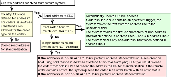

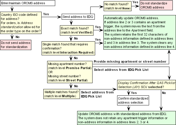

Interactive Address Standardization Process Illustration
Remote Address Standardization Process Illustration
EDQ Address Standardization Process Flow

Once the address search completes, EDQ sends a response back to Order Management System. The EDQ Address Response Match Level returned determines the action Order Management System performs; see EDQ Address Response Match Level for more information.
Address map: The Serenade data map defines how the address information returned by EDQ is mapped to the Order Management System address. This map also defines whether the address data is returned in upper case letters and how non-address information is retained. See Serenade Map for more information.
Duplicate checking: The system sends an address for standardization prior to any duplicate customer checking. Once the address has been standardized, the system then determines if a duplicate address match already exists for the address.
Purpose: The address response match level returned by EDQ determines the action Order Management System performs.
Match Level
Address Results
None
EDQ does not update the Order Management System address because it could not find a match to the address.
Remote address standardization: The system does not standardize the Order Management System address. If the address is on a remote order and a hold reason is defined in the Address Interface User Hold Code (I68) system control value, the system places the order on user hold.
If a hold reason is not defined in the Address Interface User Hold Code (I68) system control value, the system does not assign a hold reason to a remote order at the user level.
• If the remote order does not contain any errors, the system creates the order in an open status.
• If the remote order contains errors, the system places the order in an order batch with an error status.
Interactive address standardization: The system displays the Address Standardization: No Address Match Found Screen. At this screen you can select to return to the Order Management System screen and either:
• Retain the Order Management System address without any updates from EDQ.
• Update the Order Management System address to resend it for standardization.
Apartment Triggers: EDQ does not apply apartment triggers when the match level is None. See Apartment Triggers.
Non-Address Information: The system retains any non-address information defined in address lines 1, 2, and 3 in address line 3. See Retaining Non-Address Information in Address Lines 1-4.
See Match Level None Example.
Verified
EDQ found one address match with a high level of confidence. The system automatically updates the Order Management System address with the address returned by EDQ.
Apartment Triggers: If address lines 2 or 3 contains an apartment trigger, the system moves the text from the address line to the Apartment field. See Apartment Triggers.
Non-Address Information: The system retains the first 32 characters of non-address information defined in address lines 1, 2, and 3 in address line 3. The system clears any non-address information defined in address line 4. See Retaining Non-Address Information in Address Lines 1-4.
See Match Level Verified Example.
Interaction Required
EDQ found a single match to the Order Management System address but requires you to confirm the address update.
Interactive address standardization: The system displays the Address Standardization: Verify Recommendation Screen. At this screen you can:
• Update the Order Management System address with the recommended address returned by EDQ.
Apartment Triggers: If address line 2 or 3 contains an apartment trigger, the system moves the text from the address line to the Apartment field. See Apartment Triggers.
Non-Address Information: The system does not retain the non-address information defined in address lines 1, 2, 3, and 4.
See Match Level Interaction Required Example.
Interactive address standardization: The system displays the Address Standardization: Verify Apartment/Suite Number Screen. At this screen you can:
• Provide the missing apartment number and standardize the Order Management System address.
Note: If you provide an apartment number that EDQ does not recognize as a valid apartment number, the system does not update the address with the apartment number you provided. Instead, you remain on the Verify Apartment/Suite Number screen until you provide a valid apartment number; you can review the pick list returned by EDQ to determine the valid apartment numbers for the address.
• Display a list of possible address matches in a pick list returned by EDQ and replace the Order Management System address with a standardized address selected from the pick list.
Note: The address matches in the pick list returned by EDQ provide an idea of the acceptable range of apartment numbers you can define for the address.
• If an address in the pick list displays as a hyperlink, you can select the address from the pick list to replace the Order Management System address with this standardized address.
• If an address in the pick list does not display as a hyperlink, you can enter the apartment number defined for the address in the Apartment number field to standardize the Order Management System address.
Non-Address Information: The system retains the first 32 characters of non-address information defined in address lines 1, 2, and 3 in address line 3. Address line 4 will be cleared of any non-address information.
Apartment Triggers:
• If you provide an apartment number for the address, and address line 2 or 3 contains an apartment trigger, the system moves the text from the address line to the Apartment field.
• If you select an address from the pick list returned by EDQ, EDQ does not apply apartment triggers to the address.
See Match Level Premise Partial Example.
Interactive address standardization: The system displays the Address Standardization: Verify Street Number Screen. At this screen you can:
• Provide the missing street number and standardize the Order Management System address.
Note: If you provide a street number that EDQ does not recognize as a valid street number, the system does not update the address with the street number you provided. Instead, you remain on the Verify Street Number screen until you provide a valid street number; you can review the pick list returned by EDQ to determine the valid street numbers for the address.
Note: The address matches in the pick list returned by EDQ provide an idea of the acceptable range of street numbers you can define for the address.
- If an address in the pick list displays as a hyperlink, you can select the address from the pick list to replace the Order Management System address with this standardized address returned from EDQ.
- If an address in the pick list does not display as a hyperlink, you can enter the street number defined for the address in the Street number field to standardize the Order Management System address.
Apartment Triggers:
• If you provide a street number for the address, and address line 2 or 3 contains an apartment trigger, the system moves the text from the address line to the Apartment field.
See Match Level Street Partial Example.
Interactive address standardization: The system displays the Address Standardization: Select from Multiple Addresses Screen. At this screen you can:
Apartment Triggers: EDQ does not apply apartment triggers when the match level is Multiple.
See Match Level Multiple Example.

Example: The following non-address information was defined in address lines 2 and 3 for the Order Management System address:
KAT’S FRUITS AND VEGETABLES
LEAVE PACKAGES ON FRONT PORCH
EDQ moves the first 32 characters of this information to address line 3:
KAT’S FRUITS AND VEGETABLES LEAV
See Retaining Non-Address Information in Address Lines 1-4 for more information.
Address line 4
EDQ clears address line 4 of any information.
Apartment
EDQ updates this field with a valid apartment/suite/unit number and includes an abbreviation such as APT or STE.
Example: APT 3
Apartment Triggers
Certain text in address lines 2 and 3 and the EDQ Address Response Match Level triggers EDQ to move the text to the Apartment field on an address. For example, if you enter NO 3 in Address line 2, the system moves this text to the Apartment field.
See Apartment Triggers for a list of the text that EDQ will move from address lines 2 and 3 to the Apartment field. Any number that follows this text is also moved to the Apartment field.
City
EDQ updates this field with the valid city name for the address.
Example: WESTBORO updates to WESTBOROUGH
State code
EDQ updates this field with the valid state code for the address.
Example: MA
Postal code
EDQ updates this field with the valid zip + 4 postal code for the address.
Example: 01468 updates to 01468-1566.
Country code
EDQ translates the ISO country code for the address to the associated country code defined in Order Management System.
Example: US
