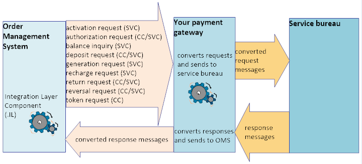

External payment service is a RESTful web service that provides an interface from Order Management System Cloud Service for sending credit card and stored value card transactions and receiving responses. Using this service, you can build a custom payment processor that maps to your payment provider.
This payment service needs to be configured to use the integration layer component of Order Management System, as this component controls payment service processing. When configuring the external payment service, the integration layer (.IL) must be defined as the primary authorization service.
Supported credit card transactions:
• authorization request
• deposit request
• return request
• reversal request
• token request
Supported stored value card transactions:
• activation request
• balance inquiry
• deposit request
• generation request
• recharge request
• return request
• reversal request
