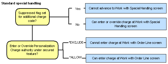

Standard special handling: The following chart summarizes how the system controls access for standard special handling formats:

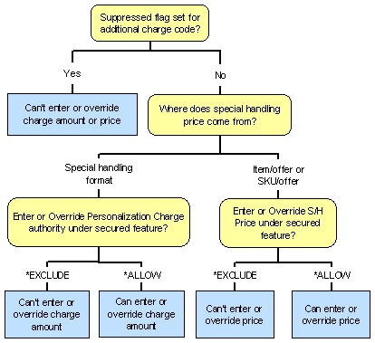

Custom special handling: The following chart summarizes how the system controls access for custom special handling formats:
