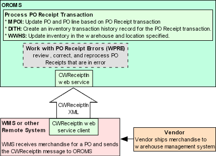

PO Receipt In information flow: This flowchart explains how PO receipt information is uploaded into Order Management System.

Purchase Order Receipt In Process
1. |
The warehouse management system receives a partial or full receipt of a PO or PO line. |
2. |
For each PO line received, the warehouse management system sends a PO Receipt In XML Message (CWReceiptIn) to Order Management System via the CWReceiptIn Web Service. Note: A separate PO Receipt In XML Message (CWReceiptIn) must be sent to Order Management System for each PO line received. |
3. |
The CWReceiptIn Web Service determines if the PO Receipt In XML Message (CWReceiptIn) is a valid XML message; see Invalid XML?. |
4. |
If the PO Receipt In XML Message (CWReceiptIn) is a valid XML message, Order Management System receives the PO Receipt In XML Message (CWReceiptIn) from the warehouse management system, and: • Determines the PO to receive; see Determining the Purchase Order to Receive. • Determines the item/SKU to receive; see Determining the Item and SKU to Receive. • Determines the quantity of the item/SKU to receive; see Determining the Quantity to Receive. • Determines the location and warehouse where the item/SKU should be placed; see Determining the Receipt Warehouse and Location. |
5. |
If Order Management System successfully processes the PO Receipt In XML Message (CWReceiptIn), the system updates the PO and the inventory information in the location and warehouse where the item/SKU was placed. See Successful PO Receipts. If Order Management System cannot successfully process the PO Receipt In XML Message (CWReceiptIn), the system places the message in an error status. See Failed PO Receipts. |

If the PO Receipt In XML Message (CWReceiptIn) received from the warehouse management system includes invalid or missing data, Order Management System does not process the PO Receipt and does not perform any updates to the PO, item warehouse, or item location.
In addition, the system creates a record in the PO Receipt Error table. You can review, correct, and reprocess PO receipt errors in the Working with PO Receipt Errors (WPRE) menu option. See Failed PO Receipts for a list of errors.
Note: If you do not see the failed PO Receipt in the Working with PO Receipt Errors (WPRE) menu option, it could be that the error occurred before the PO Receipt was received into Order Management System, such as an invalid XML error. See Troubleshooting the Purchase Order Receipt In API.

Typically, you would use the Purchase Order Receipt In API together with the Outbound Purchase Order API in order to facilitate communication between Order Management System and the warehouse management system. For example, the warehouse management system generates POs based on the information in the PO Download XML Message (CWPurchaseOrderOut) received from Order Management System; when the warehouse management system receives the items specified on the PO, the warehouse management system sends this information to Order Management System in the PO Receipt In XML Message (CWReceiptIn). See Generic Outbound Purchase Order API for more information on the processing and setup for the Outbound Purchase Order API.
The CWReceiptIn web service allows an external system to post the PO Receipt In XML Message (CWReceiptIn) directly to Order Management System and receive responses without the need of any queues.
Web service authentication? Use the Working with Web Service Authentication (WWSA) menu option to define a valid user for basic web service authentication. If you use Oracle Identity Cloud Service for password authentication, in addition to creating the web service authentication user in Work with Web Service Authentication (WWSA), you must also create a corresponding user profile in Oracle Identity Cloud Service and assign the user to the corresponding web service role defined for the Order Management application.
Using the CWReceiptIn RESTful web service: You POST inbound CWReceiptIn messages to the web service’s URI, or endpoint, of the RESTful service. The individual URL for the CWReceiptIn RESTful service uses the following format: http://server:port/SerenadeSeam/sxrs/application/CWReceiptIn, where server:port identifies the application server where the RESTful service is located and CWReceiptIn is the name of the web service to call.
Using the CWReceiptIn SOAP-based web service: The CWReceiptIn web service’s .wsdl (Web Services Definition Language) file, which is located on your application server, controls the function of the CWReceiptIn web service. You send the inbound messages to the URL, or endpoint, specified in this wsdl.
You need to embed each inbound message in the SOAP (Simple Object Access Protocol) message tags in order for the CWReceiptIn web service to receive and process it correctly.
The endpoint specified in the CWReceiptIn.wsdl file is where you need to post messages. The endpoint uses the following format: http://server:port:8080/CWDirectCPService/services/CWReceiptIn, where server:port identifies the application server where the wsdl is located and CWReceiptIn is the name of the web service to call.
Sample CWReceiptIn message in SOAP envelope: The SOAP-based CWReceiptIn web service requires that inbound messages be embedded in SOAP envelope tags. A sample XML message embedded in a SOAP envelope is presented below.

Purchase Order Receipt In: Sample XML Messages
Samples of the PO Receipt In XML Message (CWReceiptIn) are presented below.
The Purchase Order Receipt In message contains PO receipt information to receive a PO line into a specified location. The external system, such as a warehouse management system, must generate a separate message for each PO line to receive. In addition, if the PO is to be received into more than one location, the external system must generate a separate message for each location.
For more information: See:
