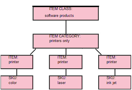

Item category codes classify and group similar items on a level below Item Class. For example, you can assign a group of items within the same item class an Item category of “printers only” to differentiate printers from the other items under that item class.

How Items are Classified and Grouped
Where you can use item category codes:
• Product relationship feature in Order Entry: see Working with Items on the Order.
• Inventory reports, such as the Item Sales Analysis Report, or the Item Stock Status Report
• Applying or excluding promotions; see Working with Promotions (WPRO).
