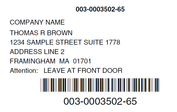

When this system control value is set to PICKLBL, the pick label includes:
• the ship-to address:
- company name
- ship to name
- street address and apartment/suite number
- address line 2
- city, state, postal code
- attention line
• the barcode for the pick label, composed of the company code (3 positions), pick control number (7 positions), and label number (2 positions).
The PICKLBL property defines whether images and barcodes print on the label.
