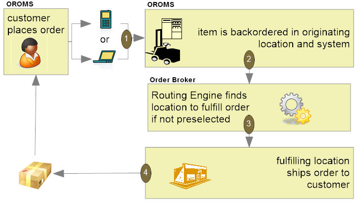

Brokered Backorder Processing Overview
Order Broker assignment: Assigning a backordered item to the Order Broker can occur through:
• order entry or order API: When you create an order that includes a backordered line, Order Management System assigns the line, if eligible, to the Order Broker for fulfillment, and withholds it from normal fulfillment processing within Order Management System.
- If the Use OROB for Fulfillment Assignment (M31) system control value is selected, the system bypasses reservation for all eligible items on an order and places them on backorder so that the Order Broker can determine the fulfilling location.
- If the Use OROB for Ship for Pickup Fulfillment Assignment (M34) system control value is set to ALWAYS, the system bypasses reservation for all eligible items on a ship-for-pickup order and places them on backorder so that the Order Broker can determine the fulfilling location.
• batch process: A periodic function finds eligible backordered lines and assigns them to the Order Broker.

Brokered Backorder Fulfillment: Initial Order Creation
1. |
The process begins when you create an order in Order Management System. If the Send B/O to OROB (K08) system control value is selected, the system sends eligible backordered items to the Order Broker to determine the fulfilling location. In addition: • If the Use OROB for Fulfillment Assignment (M31) system control value is selected, the system bypasses reservation and places all eligible items on backorder, even if the item is available in an Order Management System warehouse, in order to have Order Broker determine the fulfilling location. • If the Use OROB for Ship for Pickup Fulfillment Assignment (M34) system control value is set to ALWAYS, the system bypasses reservation and places all eligible items on a ship-for-pickup order on backorder, even if the item is available in an Order Management System warehouse, in order to have Order Broker determine the fulfilling location. The order creation can occur through interactive order entry, batch order entry, or the order API. You can also use the BROKER periodic function to submit existing backordered lines to the Order Broker for fulfillment; see Additional Order Broker Setup in Order Management System for more information. |
2. |
If the order line meets the Rules for Submitting Backorders to the Order Broker, Order Management System generates a request message to the Order Broker and creates an Order Broker record. Note: Order lines that meet the Rules for Submitting Backorders to the Order Broker do not sell out initially, even if the items are flagged with soldout control codes. See Brokering Items with Soldout Control Codes for more information. If the order includes multiple backordered lines and the Use Split Order (L56) system control value is selected, the request message includes all eligible backordered lines; otherwise, each backordered item is submitted as a separate order. Each Order Broker record has a status of R (ready) at creation. Also, the order line is updated to restrict it from standard backorder processing in Order Management System: • the Drop ship flag is set to D. • the Printed quantity is updated to the ordered quantity. • An order line that is assigned to the Order Broker for fulfillment displays a status of OBR in standard order inquiry. • the quantity to be brokered does not update the Backordered quantity for the Item Warehouse. • if the Use OROB for Fulfillment Assignment (M31) system control value is selected, the Bypass reservation flag is selected with a Backorder reason of Reservation bypassed indicating the broker backorder was created for fulfillment assignment. • if the order is a ship-for-pickup order sent for fulfillment assignment, the Bypass reservation flag is selected with a Backorder reason of Reservation bypassed indicating the broker backorder was created for fulfillment assignment. Note: Order Broker status is not displayed in Streamlined Order Inquiry (DORI). |
3. |

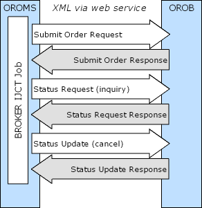

If the BROKER process in Working with Integration Layer Processes (IJCT) is active, it immediately generates the submit order request message to Order Broker to request order creation and assignment in the Order Broker. At this time, it also: • changes each Order Broker record’s status to W (waiting). • creates an Order Broker History record for each line to track the order submission (A - Send Order Request). • writes an Order Transaction History message indicating that each order line was submitted to the Order Broker (for example, Ln#: 2 Submitted To Broker). See the Brokered Backorder (Delivery or ShipForPickup) Submit Order Request Message Sample. |
4. |
The Order Broker module in Order Broker receives the submit order message. If Order Management System sent each line separately, Order Broker creates each order line as a separate order in its database; otherwise, if you use the split order option, Order Broker creates a single order including all of the order lines that were eligible for submission as brokered backorders. The Order Broker assigns each order or line to a location for fulfillment based on inventory availability and the business rules you have defined in Order Broker. At this point, the order status in the Order Broker database is new_order. |
5. |
Order Broker sends a response message to Order Management System indicating each assigned fulfilling location and the unique request ID it uses to identify each order. See the Submit Order Response Message Sample. Note: The message version is specified in the Order Broker Properties; this property must be set to 16.0 or higher in order to use broker backorders for fulfillment assignment and to use ship-for-pickup processing. |
6. |
If the Order Broker successfully created an order and assigned it to one or more fulfilling locations, Order Management System: • updates each Order Broker record with: - the fulfilling location, using the description set up through the Work with Store Cross Reference (WSCR) option. - the request ID. - a status of A (acknowledged). • writes an Order Transaction History message indicating that the order line was acknowledged by the Order Broker (for example, Ln#: 2 Acknowledged by Broker). • creates an Order Broker History record (B - Receive Order Response). |

Status inquiry request and response process: The BROKER process in Working with Integration Layer Processes (IJCT) sends periodic status inquiry requests to the Order Broker. You use the Order Broker Status Update Interval (K10) system control value to define how many minutes Order Management System should wait before sending status inquiry requests.
