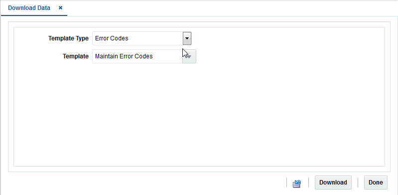

Download Data
To download data as spreadsheets:
  1. From the Tasks menu, select Foundation Data > Data Loading > Download Data. The Download Data window appears.
  2. In the Template Type field, select the type of template.
    The following template types are available:
    • Error Codes
    • GL Cross Reference
    • Reference Fields
    • Currency Rounding Rules
    • Store Data
    • Tender Types
    • Constants
  3. In the Template field, select the template you want to download.
    Figure 5-1 Download Data Window for a Template Download from ReSA
  4. Click Download.

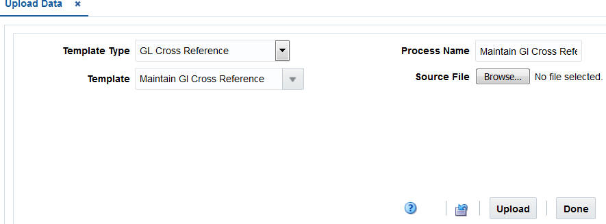

Upload Data
To upload data using spreadsheets:
  1. From the Tasks menu, select Foundation Data > Data Loading > Upload Data. The Upload Data window appears.
    • Error Codes
    • Reference Field
    • Store Data
    • Tender Types
    • Constants
  3. In the Template field, select the template of the spreadsheet.
    Figure 5-2 Upload Data Window for a Template Upload into ReSA
  4. Enter a process name in the Process Name field. The value specified in this field enables you to find the process created to identify the status of the upload and view any errors that were identified.
  5. Select the spreadsheet to be uploaded in the Source File field.
  6. Click Upload. The relevant data corresponding to the template is uploaded into the spreadsheet file specified.
