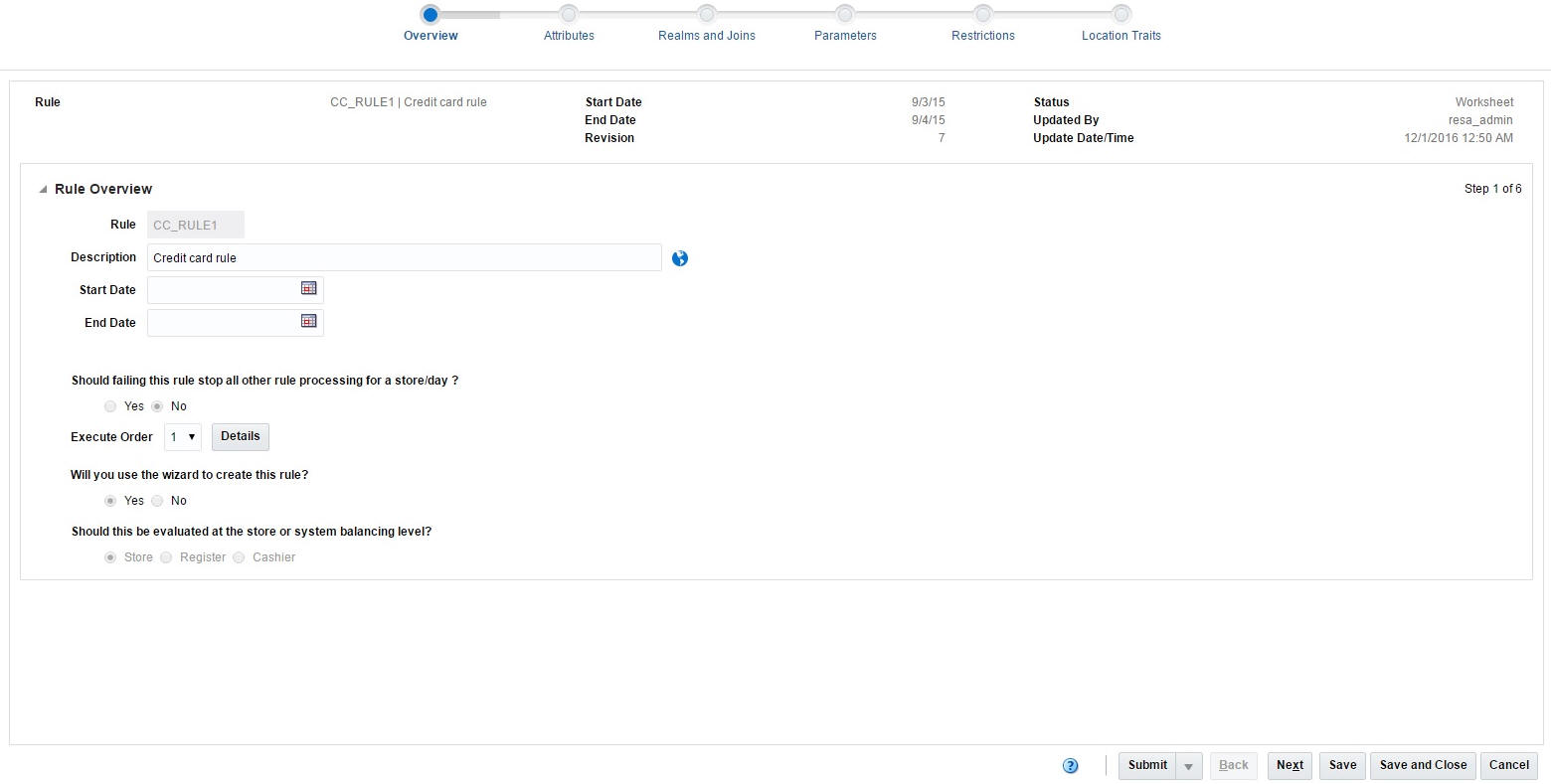

Figure 4-1 Audit Rule Overview Window
The Overview window allows you to define basic information for a rule. You can enter the following information using the Rule Overview window:
Field Description
Rule A unique ID and a description for the rule.
Start Date and End Date The period for which the rule is active.
Status The status (Worksheet, Approved, Submitted, Disabled, or Deleted) of the rule.
Revision The revision number for the rule. The revisions are tracked by the system.
Updated By User ID of the person who updates the rule. This field is recorded by the system and you cannot edit it.
Update Date/Time The date and time when the rule was last updated.
Should failing this rule stop all other rule processing for a store/day? Use this field for rules that determine whether basic data exists for a store/day. For example, there can be a rule that determines whether a basic piece of data is missing. In case the basic information is missing, it would not make sense to continue flagging errors that confuses the auditor.
Execute Order Use this field to determine the order in which rules are processed. Rules are placed into various execute groups. Within groups, rules are executed in alphabetical order.
Will you use the wizard to create this rule? Use this field to specify whether you are defining the rule using the rule definition wizard, or through a manually written rule definition function.
Should this be evaluated at the store or system balancing level? Use this field to specify whether the rules are evaluated at store, register, or cashier level.

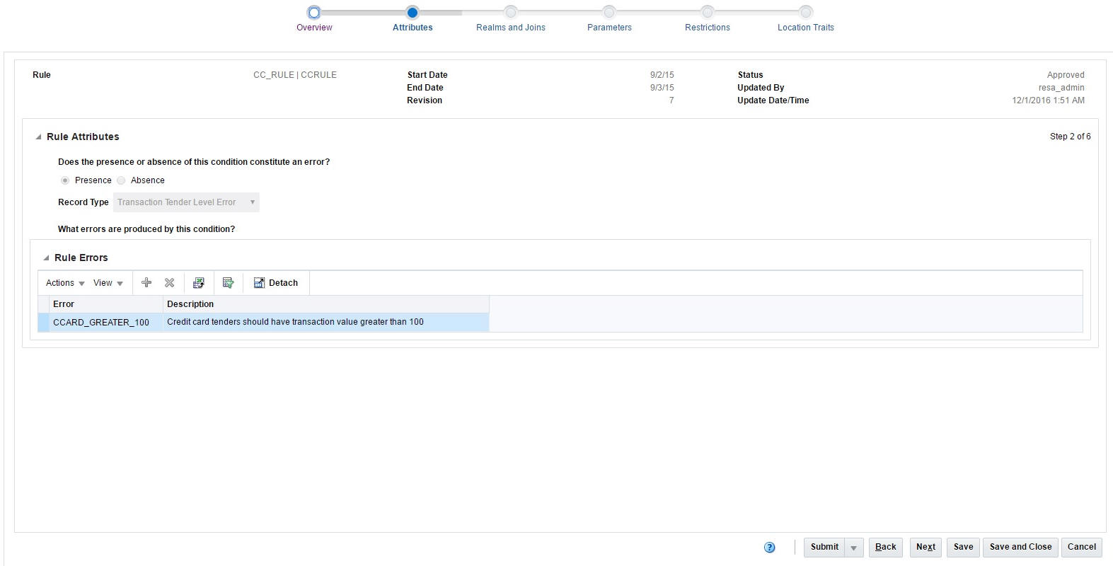

Figure 4-2 Rule Attributes Window
The Rule Attributes window allows you to define characteristics of the rule.
Field Description
Does the presence or absence of this condition constitute an error? Specify whether the rule triggers an error when a constraint condition is met (presence) or when the data does not exist in the data set (absence).
Record Type Specify the kind of record that errors are associated with.
Rule Errors You can choose to associate any predefined errors with the rule. You can view details about all errors by clicking the Error Details button.

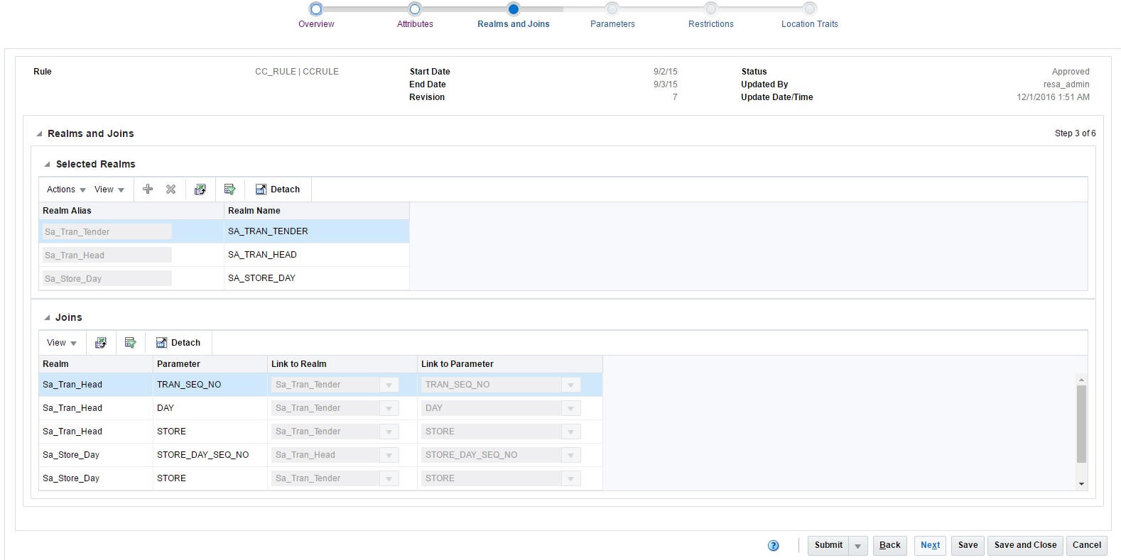

Figure 4-3 Realms and Joins Window
The Selected Realms section allows you to add existing realms (tables) to the rule. The list of available realms is displayed in the window, this list also includes the views created for each total.
Availability of realms to be added to the rule is determined by whether possible joins exist with the realms that are already added to the rule definition.
In general, you should add the general/parent tables, and then add the specific/child tables. If at any time, a realm that you want to use is unavailable, you should remove the realms already added to the rule, and try again in another order.
The Joins section displays how the realms are joined together. These joins are based on metadata defined in the system.

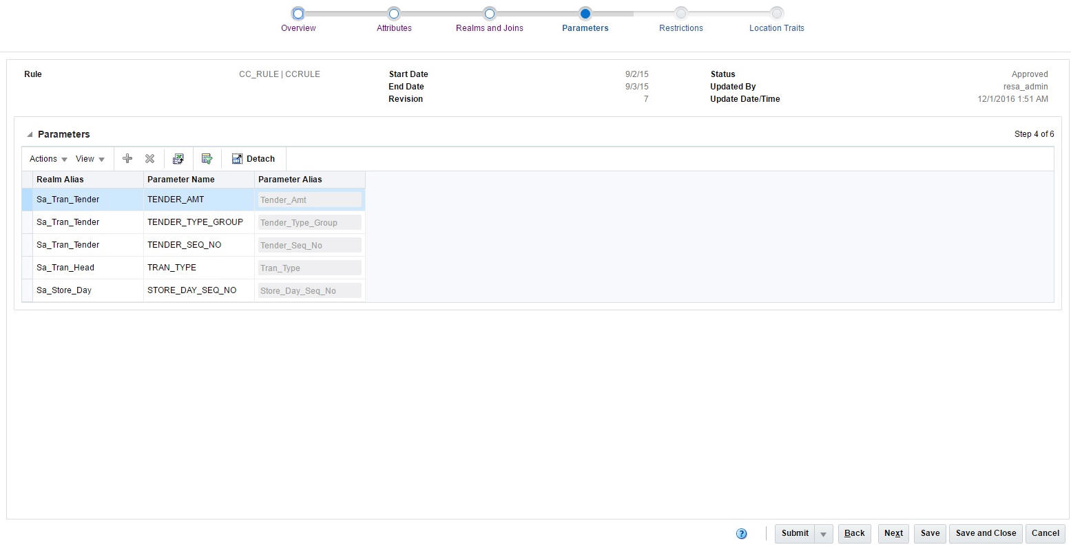

Figure 4-4 Parameters Window
The Parameters window allows you to choose the parameters for the rule. You can only choose parameters (columns) that are available in one of the realms that were previously added to the rule. You should add all parameters that you need to use in defining the constraint conditions on the rule. The system uses the parameters needed to log the errors against the correct day and record type.Begin by choosing one of the realms. The parameter list then displays a list of all of the parameters (columns) that belong to the selected realm (table/view). You must choose the parameter that you need to count or sum and any other parameters that may be used to limit the data set.

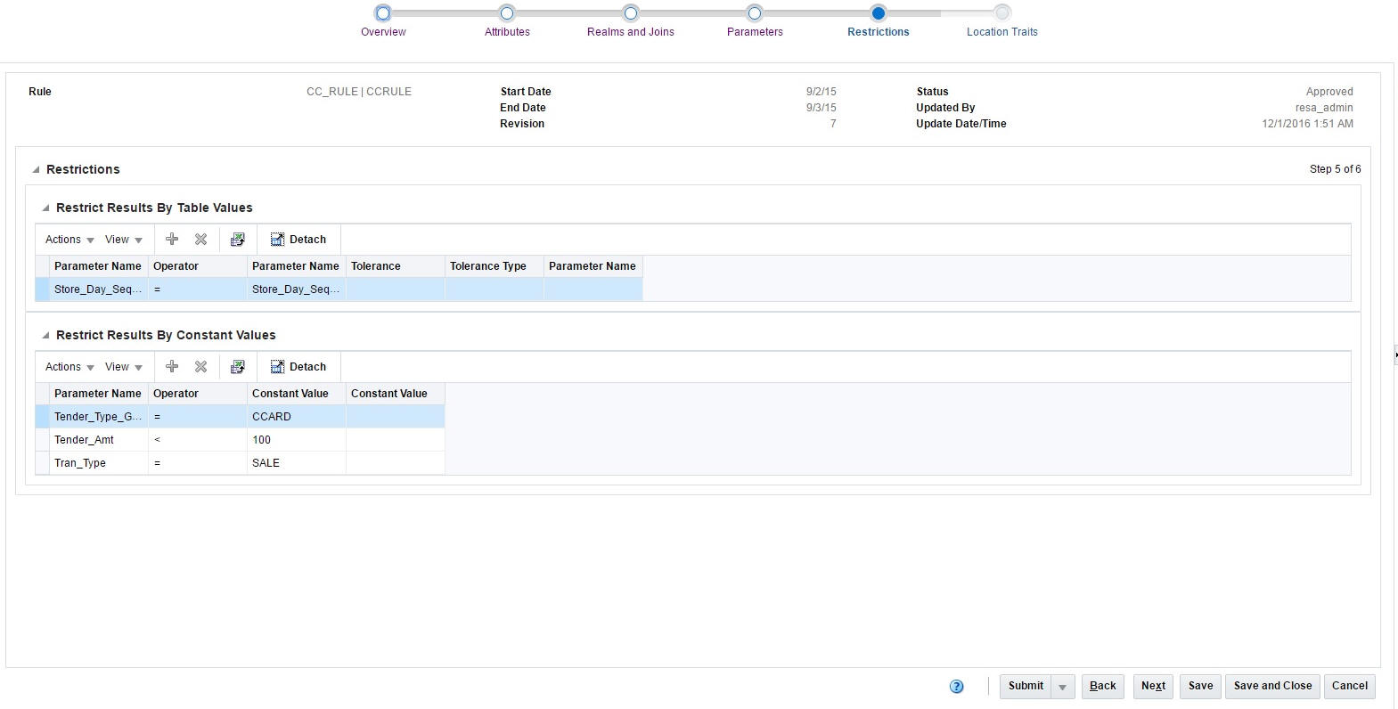

Figure 4-5 Restrictions Window
The Restrictions window allows you to limit the data set that is included in the rule. You can only define these restrictions (constraint conditions) using the parameters that were previously added to the rule.

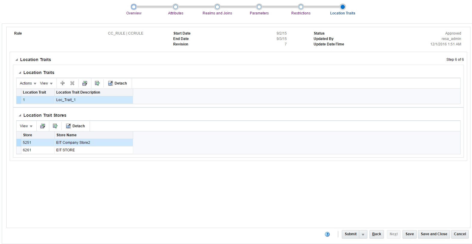

Define Location Traits
Figure 4-6 Location Traits Window
The Location Traits window allows you to associate rules with location traits which link a group of stores. Once the association is specified, the rule is applied only for those stores. If the rule is based on a total, you can execute the rule only for stores for which the total is calculated.

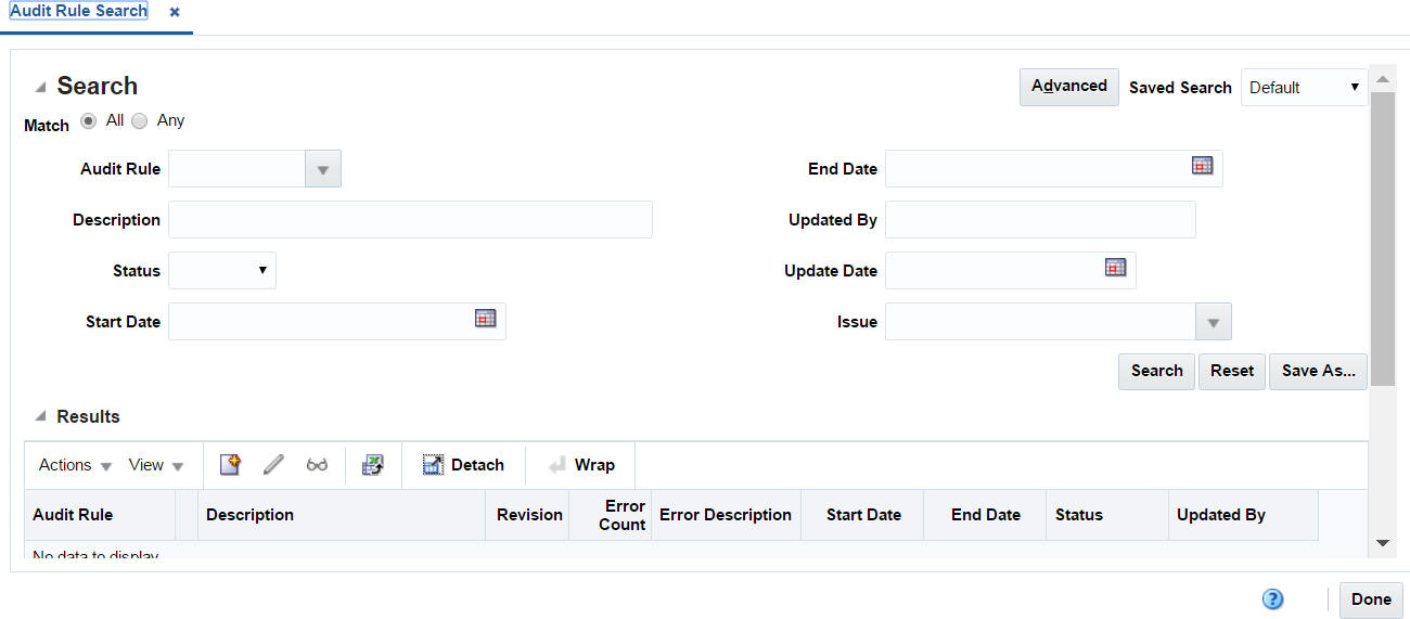

  1. From the Tasks menu, select Foundation Data > Manage Audit Rules. The Audit Rule Search window appears.
    Figure 4-7 Audit Rule Search Window
  2. Enter additional criteria as desired to make the search more restrictive.
  3. Click Search. The rules that match the search criteria are displayed in the Audit Rule Search window.
  4. If you want to view the details of any rule definition, click the rule definition and select Actions > View.
    The Rules Definition Wizard appears. You can only view all the details of the rules definition in this window.
