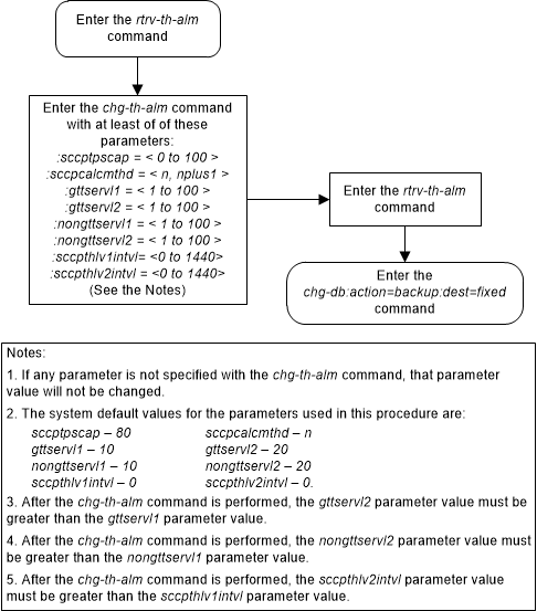

  2. Change the SCCP alarm thresholds by entering the chg-th-alm command with at least one of the SCCP alarm threshold parameters.
    If a SCCP alarm threshold parameter is not specified with the chg-th-alm command, that parameter value will not be changed. The system default values for the SCCP alarm threshold parameters are:
    • sccptpscap – 80
    • sccpcalcmthd – n
    • gttservl1 – 10
    • gttservl2 – 20
    • nongttservl1 – 10
    • nongttservl2 – 20
    • sccpthlv1intvl – 10
    • sccpthlv2intvl – 20.
    After the chg-th-alm command is performed, the gttservl2 parameter value must be greater than the gttservl1 parameter value, the nongttservl2 parameter value must be greater than the nongttservl1 parameter value, and the sccpthlv2intvl parameter value must be greater than the sccpthlv1intvl parameter value.
    For this example, enter this command.
    chg-th-alm:sccptpscap=70:gttservl1=70:gttservl2=80:nongttservl1=30:nongttservl2=40 :sccpthlv1intvl=120:sccpthlv2intvl=240

Figure 2-169 Change the SCCP Alarm Thresholds
