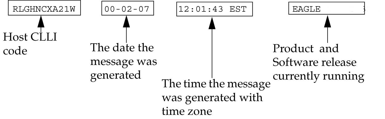

The system header information is shown in the example outputs and includes the following information:
Figure 3-1 System Header Information
