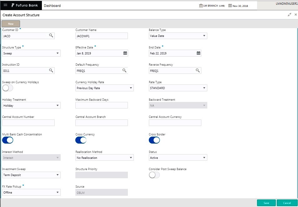

Click New button to add a new structure. Specify the following details:
Structure ID
The system displays the auto generated unique structure ID.
Structure Description
Specify a description for the new structure.
Version Number
Displays the version number
MultiBank Cash Concentration
This field will get automatically selected on save if the underlying structure created has external bank accounts.
Structure Type
Specify the Structure Type from the drop down list. The option are:
Sweep
Pool
Hybrid
Cross Currency
This field will get automatically selected on save if the underlying structure is created with accounts which are in different currencies.
Customer ID
Specify the customer. You can select the customer ID from the option list. The list displays all the customer IDs maintained in the system
Customer Description
The system displays the description of the customer selected.
Cross Border
This field will get automatically selected on save if the underlying structure is created with accounts which are from two or more different countries.
Status
Indicate the status of the Structure to be maintained. The options are:
Resumed
Paused
A user should be able view the flag 'Status' at the structure level and be able to select either Paused or Resumed for a new structure or an existing structure. Default value would be “Resumed”.
Default Frequency
Specify the default frequency at which the structure should be executed. You can select the frequency from the option list. The list displays all the frequencies maintained in the system.
The frequency defined at the structure level will get defaulted to all the account pairs in the structure, but you can override and define a specific frequency for a specific pair of account.
This changed preference will override the global preference.
Effective Date
Specify the date from which the structure becomes effective. This date cannot be less than the system date but can be a future date.
Rate Type
Specify the rate type to be used in case the underlying structure has cross currency pairs.
End Date
Specify the date till which the structure is effective. This date should always be greater than the effective date.
EOD
Check this box to execute the structure at end of day.
Allow Sweep on Currency Holidays
Check this field to allow sweep on currency holidays.
Central Account Number
Specify the Central Account to be applied to the structure. You can select the Central account from the option list. The list displays all the accounts maintained in the system.
Central Account Branch
Displays the Central Account Branch
Central Account Currency
Displays the Central Account Currency
Rate PickUp
Specify the rate pick up for the sweeps on currency holidays from the drop down list. The option are:
● Previous Days Rate
● Last Swept Rate for the Pair (when sweep frequency is not daily)
● Past 5 day Average Rate
Note
This field is active only if ‘Allow Sweep on Currency Holidays’ is selected.
Reverse Frequency
Specify the reverse frequency at which the reverse sweep for structure should be executed. You can select the frequency from the option list. The list displays all the frequencies maintained in the system.
Interest Method
Specify the Interest method for the structure from the drop down list. The options are:
● Interest
● Advantage
● Optimization
This data needs to be captured only for Pooling Structures.
Instruction Type
Specify the instruction type to be applied to the structure. You can select the instruction type from the option list. The list displays all the instruction types maintained in the system.
Reallocation Method
Specify the reallocation method for the structure from the drop down list. This refers to the method in which the interest is shared with the participating account entities. The options are:
● No Reallocation - No interest is paid back to the child accounts
● Reallocation without benefits - Interest is allocated back to child account but without the additional benefits of accumulation.
● Reallocation with benefit - Interest is allocated back to the child account with the additional benefits of accumulation.
● Central Distribution - Here the interest arrived at is credited to one central account, which can be any one of the participating accounts or a separate account.
● Even Distribution - Here the interest is evenly distributed among the participating accounts.
● Even Direct Distribution - Here Interest reward is evenly spread across all accounts with positive balances
● Percentage Based Distribution - Here pre-defined percentage of the interest is distributed among the participating accounts.
● Fair Share Distribution - Here if the interest is positive, it is distributed among the positive contributors in the ratio of their contribution and if the interest is negative, it is distributed among the negative contributors in the ratio of their contribution.
● Reverse Fair Share Distribution - Here if the interest is positive, it is distributed among the negative contributors in the ratio of their contribution and if the interest is negative, it is distributed among the positive contributors in the ratio of their contribution.
● Absolute Pro-Data Distribution - Here absolute balances of all accounts are considered and the interest would be shared proportionally to all accounts.
Investment Sweep
Investment sweep type should be selected as TD(term deposits) or MM (Money Market) at structure level.
The structure will have header account as Notional account, this account will have only one child account and that child account can have multiple other sub child accounts.
Holiday Treatment
Specify the action to be taken on the structure in case of a holiday from the drop down list. The options are:
● Next Working Date - Perform the action on the next working day.
● Previous working Date - Perform the action on the previous working day
● Holiday - Perform the action on the designated day itself
Max Backward Days
Specify the maximum number of days the system can go back to execute the structure when the execution day falls on a holiday.
Note
This field will be enabled only if ‘Holiday Treatment’ is selected as ‘Previous Working Date’.
Backward Treatment
When the ‘Holiday Treatment’ is selected as ‘Previous Working Day’ and the ‘Max Backward Days’ set is also falling on a holiday, then the system decides on the day of execution of the action based on the Backward Treatment.
Select the backward treatment to be applied from the drop down list. The options are:
● Move Forward - The action is performed on the next working day
● Holiday - Perform the action on the holiday
Note
This field is enabled only if ‘Holiday Treatment’ is selected as ‘Previous Working Date’.
Parameters like Frequency, Reverse Frequency and Instruction type which are defined at the structure level will be applicable at each account pair level in the structure however user can change these parameters at the account pair level. If the user changes them at the account pair level the system will ignore the structure level set up and go by the pair level settings
FX Rate Pickup
Specify the FX Rate Pickup for the structure from the drop down list. The options are:
Online
Offline
Default Value would be “Offline”

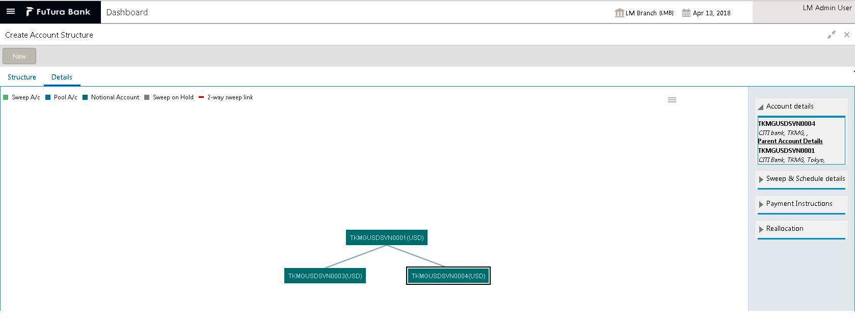

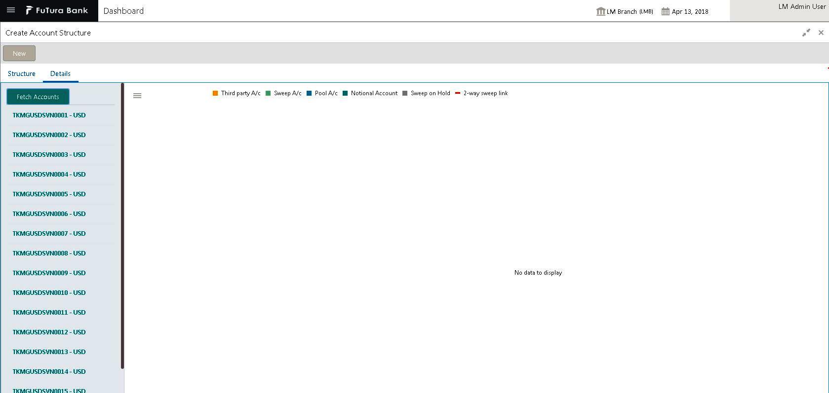

Accounts have to be fetch to create a structure. Click ‘Fetch Accounts’ button under the
Details section to add accounts.
You can view all account numbers with their currencies of that customer.

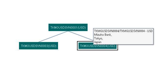

After fetching accounts for a structure, you can start creating the structure. You can drag and drop accounts into the drawing plane to make the structure.
For any account selected, click on the account to view the account details in the ‘Account Details’ section in right. You have to enter the following details:

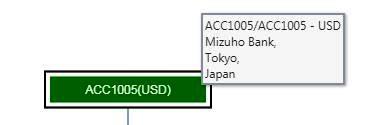

You can view the following details mouse hover on account
● Account Number - The account number of the account
● Branch - The branch to which the account belong to
● Currency - The currency of the account
● Bank - The bank to which the account belong to
Account Type
Select the account type of the account from the drop down list. The options are:
● Pool
● Sweep
To set account as a child account, drag and drop the accounts onto the parent account.
When an account is set as ‘Pool’, this account is highlighted in green in the system.
When an account selected is an external account, this account is highlighted in amber colour..
To view the parent account details of an account, select the account and click on the ‘Parent Details’ link in the right side of the application. You can view the following details:
● Parent Account Number
● Parent Account Bank
● Parent Account Branch
● Parent Branch Currency

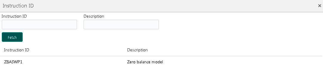

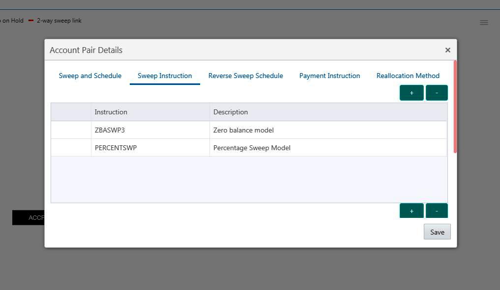

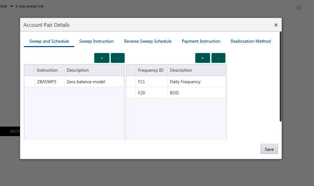

Click on a child account to set the instruction details for that child-parent account pair.
Click ‘Instruction Details’ link in the right of the application. Click ‘Edit’ button and got to Sweep Instruction to set the instruction parameters.
An option list is displayed with all the instruction IDs maintained in the system.
You can select the instruction ID from the option list. One or more instruction IDs can be selected for an account.
To set frequencies for the selected Instruction ID, click on ‘+’ button under Sweep and Schedule. An option list is displayed with all the frequencies maintained in the system.
You can select the frequencies from the option list. One or more frequencies can be selected for an instruction. Click ‘+ to add them.
Delete
Select the check box and click ‘-’ button to delete the frequency.

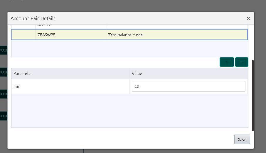

You can view the parameters values set for an instruction. Select the Instruction and Click on Parameter tab to view the parameter values set for it.

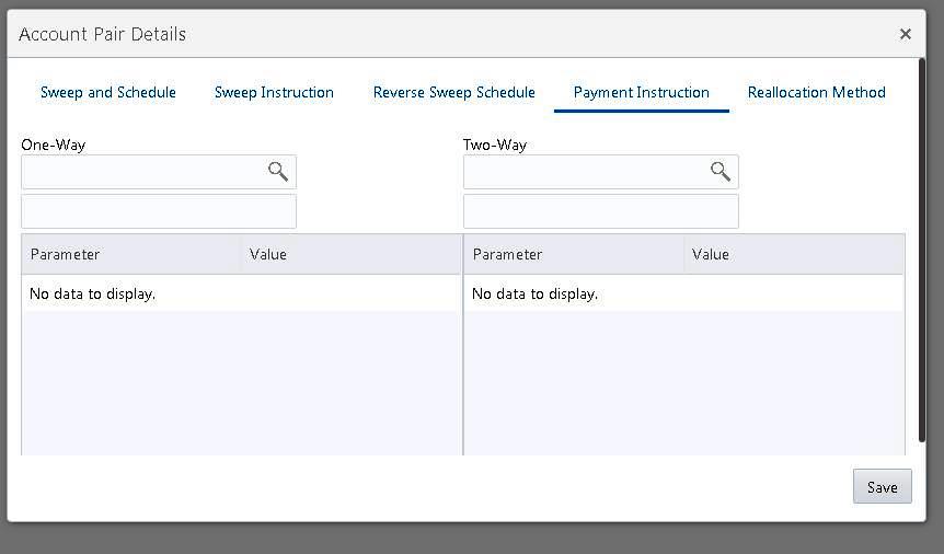

Payment details are set for the account pair based on which payment parameters will be sent to DDA to fetch the balances.
If the account pair is set for one way, only one way parameter can be viewed on screen. Else both one way and two way options can be viewed. Select the one way and two way parameters from the drop down list. The list displays all the parameters that are set for the account in payment parameters setup.
Payment Instruction for Beneficiary Account details are displayed on the payment instruction panel.

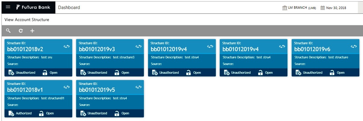

This screen is used to find out the structure. User can search records using Structure ID & Structure Description.
