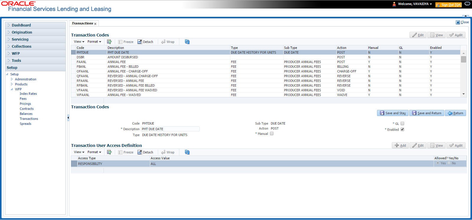

The Transactions records the system defined, consolidated list of transaction codes available in the WFP module.
The transaction codes defined on this screen are fixed, system defined, and set up during WFP installation; you cannot modify them. However, you can choose not to use a transaction code by clearing its Enabled check box. You can also choose which transactions affect the general ledger by selecting the GL check box.
The transaction codes defined here are available on the Wholesale Floor Planning Maintenance form.

To use the Transaction Codes link
On the Oracle Financial Services Lending and Leasing home screen, click Setup > Setup > WFP > Transactions
In this field: |
Do this: |
Code |
Enter transaction type code. This is a system defined code for the transactions. The first letter of the code indicates the type of task the transaction performs: P – payment F – fee O – charge off Q – reverse charge off R – reverse W – waive V – reversal of waived transaction (required). |
Description |
Enter the description associated with the Transaction code. This is a system defined field that can be modified by users (required). |
Type |
Select the transaction type. This field maps the transaction code to into Transaction types (required). |
Sub Type |
Select the sub type (required). |
Action |
Select the action type. For more information about the Action field, see the following section, A Note about the Action Field. Note: If a transaction code has an action of POST, WAIVE, or CHARGEOFF, then a REVERSE action should also be associated with this code (required). |
Manual |
Select to allow users to post these transactions on the Wholesale Floor Planning Maintenance form. |
GL |
Select to post the transaction to the general ledger when performed. |
Enabled |
Select to enable the transaction code. Note: Transactions codes which are not selected are not available in the LOVs on the WFP maintenance screens. |
Note
Transaction codes of transaction type INTEREST and PRINCIPAL cannot have a cleared Enabled check box.
