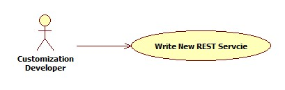

Customization developer can extend the REST tier by writing new REST services. This new REST service will consume new or existing application service. Please note that it is not possible to customize the REST services provided out of the box. Extensibility in REST tier is limited to writing new services.
References:
Please refer to workspace setup of DTO (xface) and REST service.
Please refer to Use case 1 for steps to write new REST service along with sample code.

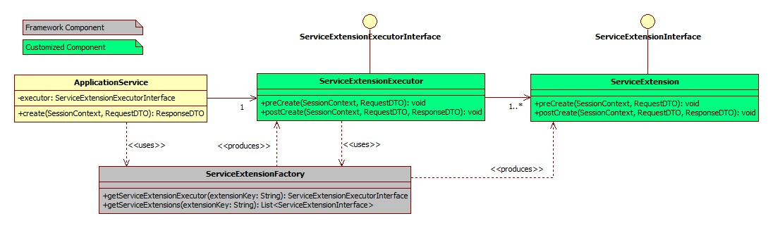

Both ‘pre’ and ‘post’ service extensions are available in the application service layer (also known as the ‘app’ layer) of OBDX.
This hook in implemented using service extension executor and service extensions. These components are explained in detail below. Customization developer can use these components suitably based on the requirement.
Below class diagram depicts the relationship between application service, extension executor and extensions. The diagram considers a sample ‘create’ method in application service.
Note: The RequestDTO and ResponseDTO components depicted in above diagram are explained in subsequent sections. For now, note that the RequestDTO contains inputs to the application service method and ResponseDTO contains output generated by the method.

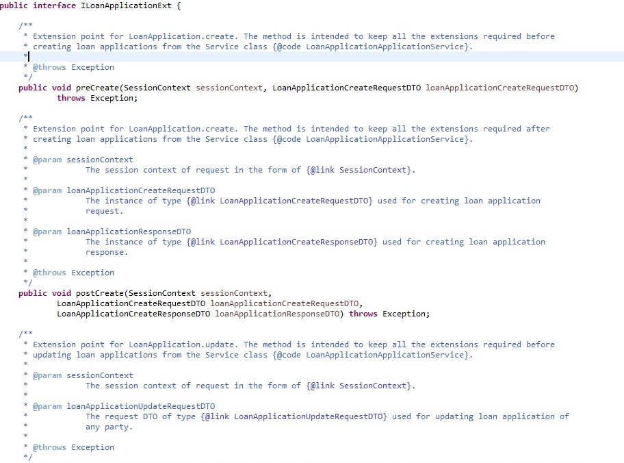

Service Extension Interface
This interface has a pair of pre and post method definitions for each application service method of the present. A service extension class has to implement this interface. The ‘pre’ method is the pre-extension hook as explained before. Similarly the ‘post’ method is the post-extension hook.
Multiple implementations can be defined for a particular service. The service extensions executor invokes all the implementations defined for the particular service both before and after the actual service executes. The signatures of these methods are:
public void pre<Method_Name>(SessionContext, <Method_Parameters>) throws Exception;
public void post<Method_Name>(SessionContext, <Method_Parameters>, ResponseDTO) throws Exception;

For example, consider below code sample

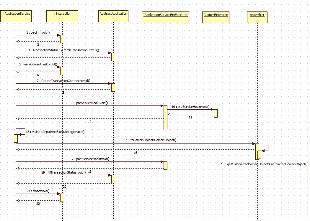

Sequence of events in service extension
Every application service method has a standard set of framework method calls as shown in the sequence diagram below.
The pre hook is provided after the invocation of fetchTransactionStatus call inside the application service. At this step, the current task code is received , any additional manipulation of the input received from the User interface channel can be done in the pre hook. Apart from this additional data coming from the screen specific to client requirements can be handled in the pre hook.
The post hook is provided after the business logic corresponding to the application service invoked has executed and before the successful execution of the entire service is marked in the status object. This ensures that the status marking takes into consideration any execution failures of post hook prior to reporting the result to the calling source. Both, the pre and the post hooks accept the service input parameters as the inputs. The post hook also accepts the Response parameter as the input.

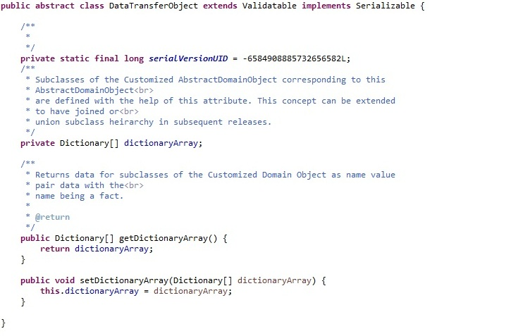

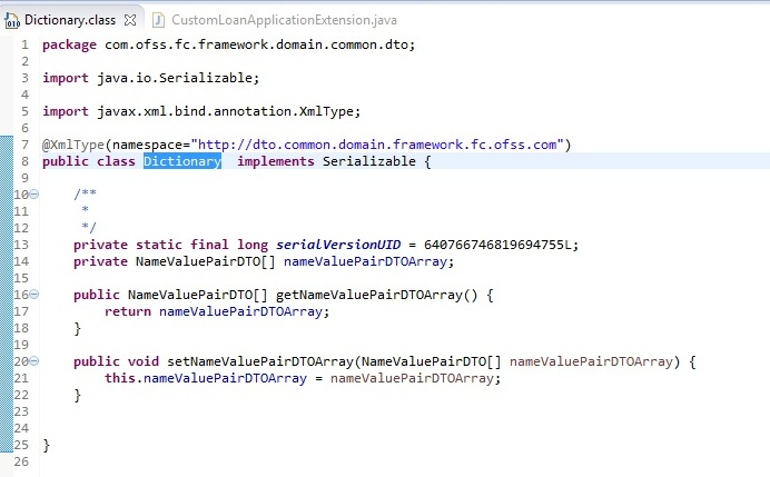

Dictionary
All data transfer objects extend a base class DataTransferObject which holds an array of Dictionary object. The Dictionary encapsulates an array of NameValuePairDTO which is used to pass data of custom data fields or attributes from the UI
User Interface layer to the host middleware. Below class diagram shows the relationship between these classes.
Dictionary class looks like
Following image shows use of dictionary with NameValuePairDTO and added it to the Data Transfer Object

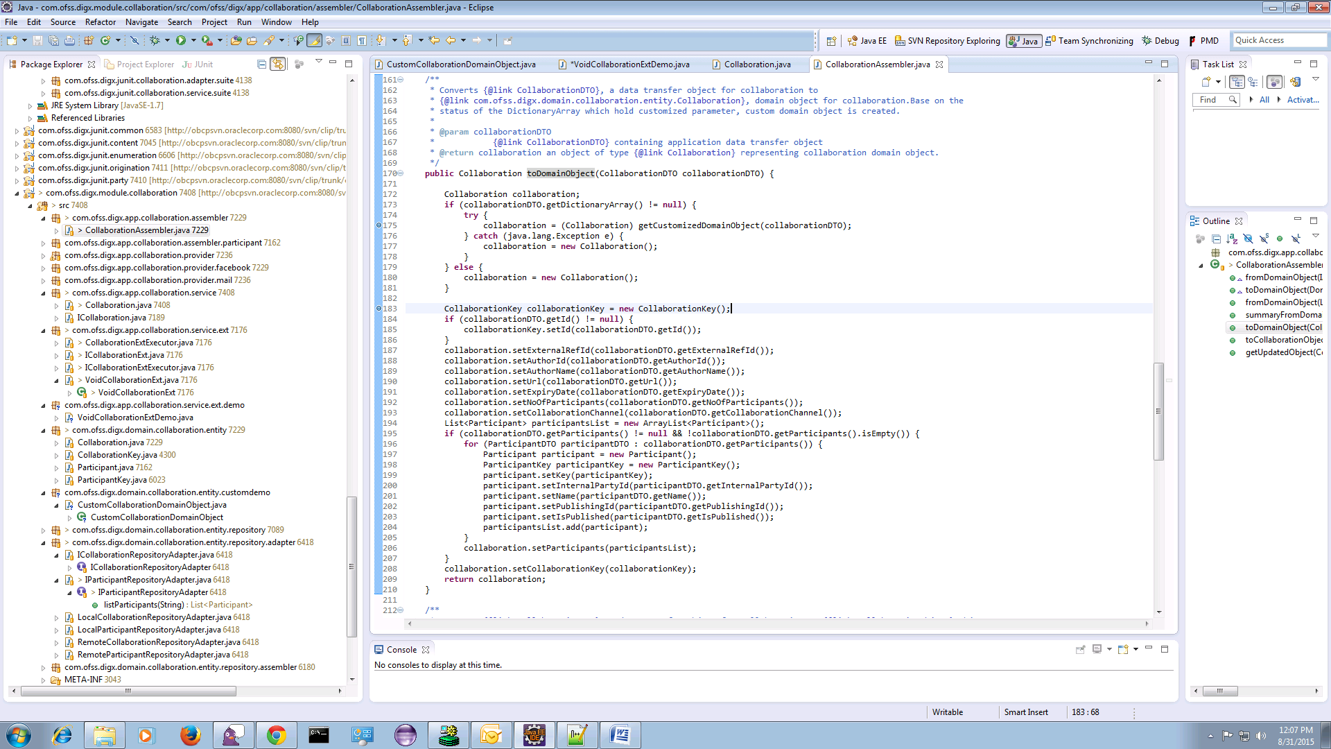

If dictionary is added to DTO then it is necessary to get customized domain Object which extends base Domain Object. Method getCustomizedDomainObject in AbstractAssembler is used for the same.
Following image shows call to get Customized domain Object if additional data (Dictionary) is added to the request DTO.
Writing Custom Domain Object
The custom domain object must extend existing domain object class. Mapping for same should be done in database as Customized Abstract Domain Object Configuration. This class contains additional fields added at UI layer and getter, setter for the same.
Below diagram shows the custom domain object and also depicts the role of Dictionary in mapping additional fields from DTO to this custom domain object.
For Example:

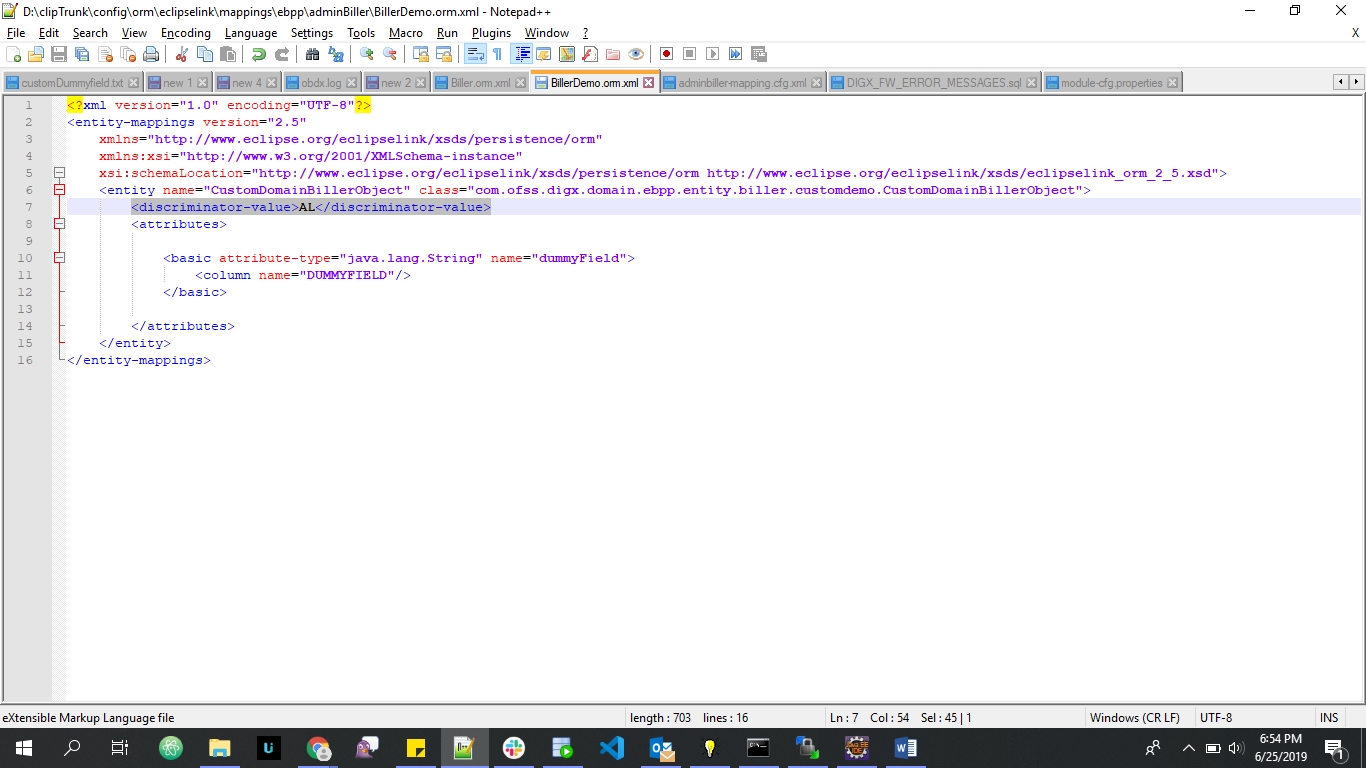

ORM Mapping
If this domain needs to be persisted in local database, then you need to create Eclipselink ORM mapping to map fields in the domain to database table. Follow these steps:
- We are going to use Eclipselink JPA inheritance strategy.
Refer to the below url to implement inheritance with Eclipselink JPA

Create a new ORM file to handle Customized Domain Object. This ORM file should contain entries only for those corresponding new fields, which you want to add.
In above screenshot, you can see that BillerDemo.orm.xml is new ORM file to handle Customized Domain object. Also you will have to add discriminator value as shown below
(see highlighted portion in above screenshot)
<discriminator-value>AL</discriminator-value>
• Add this child ORM (newly created BillerDemo.orm.xml) file’s entry in a configuration file named customized-domain-mapping.cfg.xml

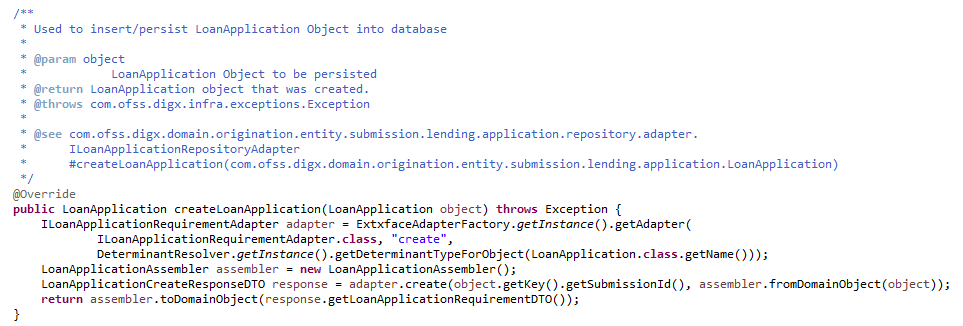

Here Assembler should fetch customized domain object. Following example shows Assembler calls getCustomizedDomainObject which returns customized domain object with mapping of nameValuePairDTOArray to this customized domain Object internally.
For example:
Sequence Diagram

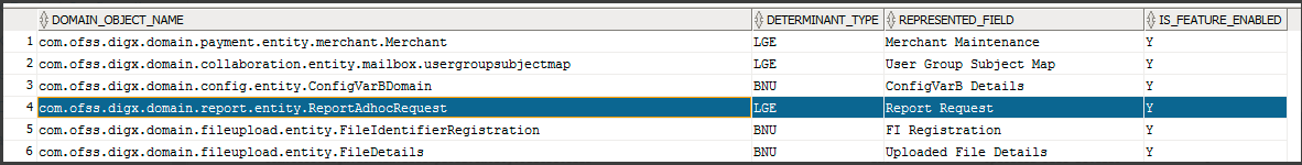

Configuring this custom domain object at appropriate entity level
insert into digx_me_entity_determinant_b (DOMAIN_OBJECT_NAME, DETERMINANT_TYPE, REPRESENTED_FIELD,
IS_FEATURE_ENABLED)
values ('<Fully qualified domain name>', '<Determinant Type>', '<Represented Name>', 'Y');
There are four possible determinant types as follows:
- Enterprise (ENT)
- Legal Entity (LGE)
- Market Entity (MKE)
- Business Unit (BNU)
Adding new Domain
The customization developer can add new domain. Below are the steps to add a new domain.
- Create new domain class. The new domain class must extend AbstractDomainObject and implement IPersistenceObject
- Identify attributes and operations supported by the domain and add them to above domain class accordingly
- The domain object will typically have associated DTO that encapsulates same fields as in domain. This DTO will be used in request and responses. An assembler will be used to map fields between domain object and the DTO. Below diagram depicts this relationship.
- Configure this new domain for appropriate entity level
REPRESENTED_FIELD, IS_FEATURE_ENABLED)
For example,
IS_FEATURE_ENABLED)
values (' com.ofss.digx.cz.domain.payment.entity.payee.Payee', 'BNU', 'New Payee', 'Y');

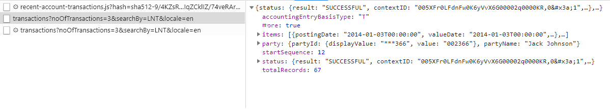

Host adapter extension to populate pagination information
This extension feature helps developer to provide information regarding pagination from the host system. This will be typically used in inquiry transactions where large number of records is expected in response. To display such large data, pagination approach is used in user interface to display limited number of records at a time. Based on user action the subsequent records are fetched. The pagination information provided by this extension can be used in UI layer to display pagination response as per developer’s requirement. The supported extension parameters are –
- more : a Boolean field to represent if any more data is available in response
- totalRecords : an Integer containing total number of records for the respective query
- startSequence : an Integer which can typically contain the sequence number of the first record in the next pagination records list.

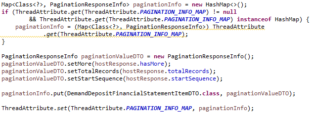

To use the above extension following steps need to be executed. •
- The response DTO of service should implement ‘com.ofss.digx.app.dto.Ipaginable’ interface and should override all the methods of this interface.
- Add following snippet in respective extxface adapter after calling ‘HostAdapterManager.processRequest(hostRequest)’.
The host specific adapter should return values for ‘hasMore’, ‘totalRecords’, ‘startSequence’ in order to set the same in the Thread attribute.
- The extension parameters set in the thread attribute will be available in the REST response as follows:

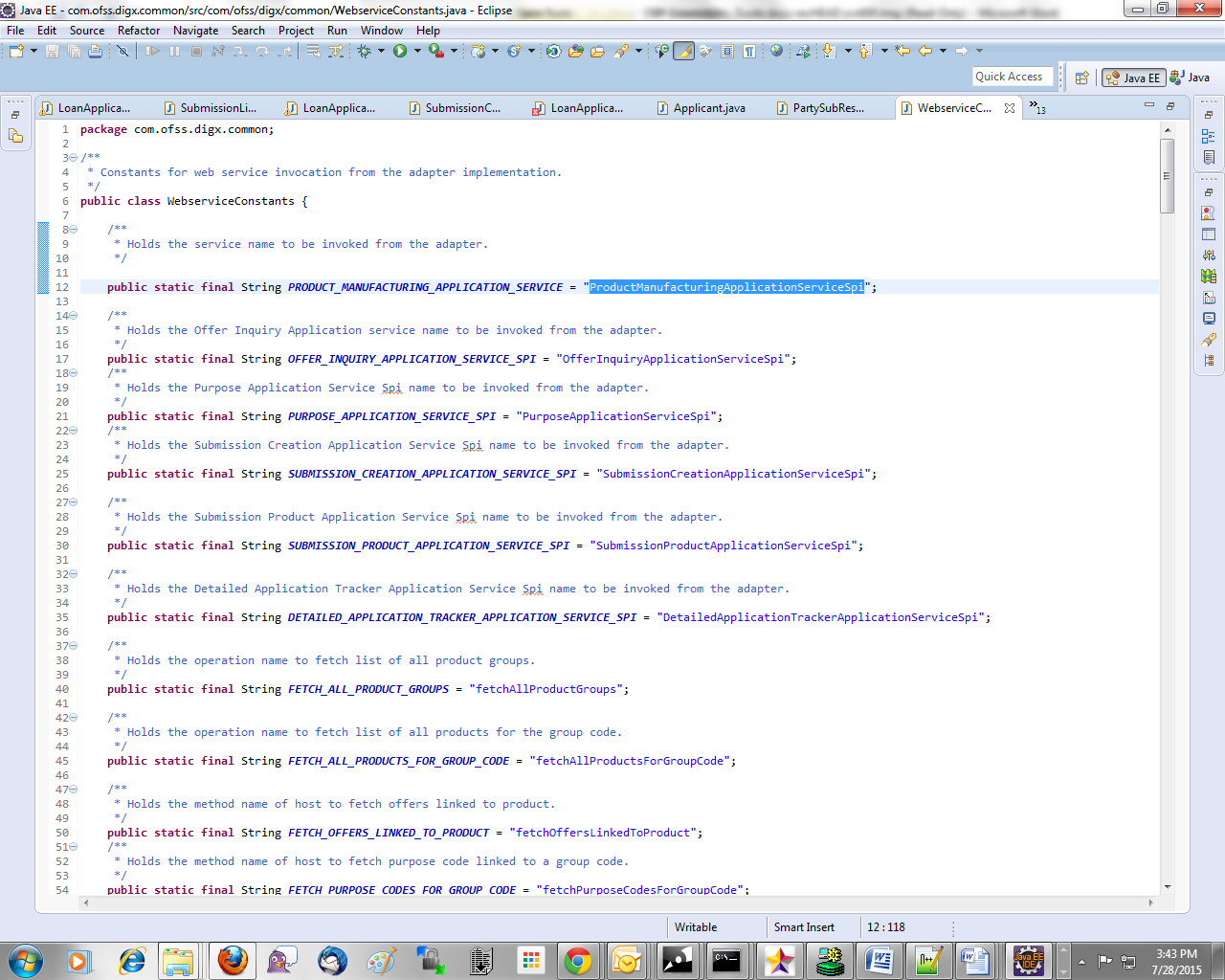

Using your own web service constants
The web service constants will change depending on the WSDL specification provided by the host system. An Example WebServiceConstants file is shown below:
Web Service Configuration
