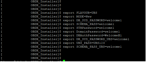

Set the environment variables
Below parameters should be set as in environment variables, depending on the Host system the installer should be executed.

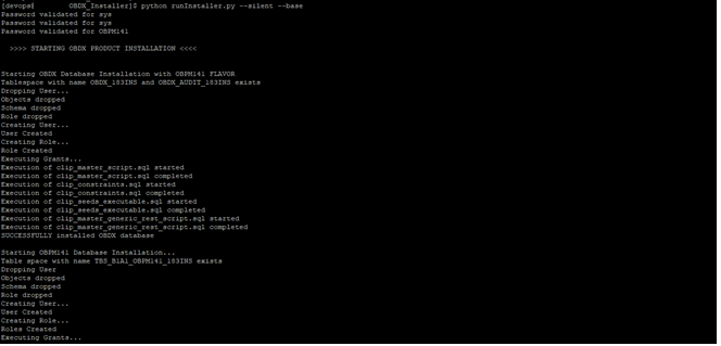

Run the runInstaller.py file with ‘--silent ’ argument along with '--base' option
Installation Status

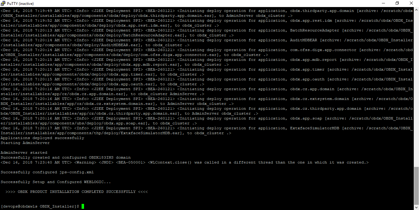

The status is displayed on the terminal to indicate the progress of the installation.
When the installation completes, the below message is displayed
